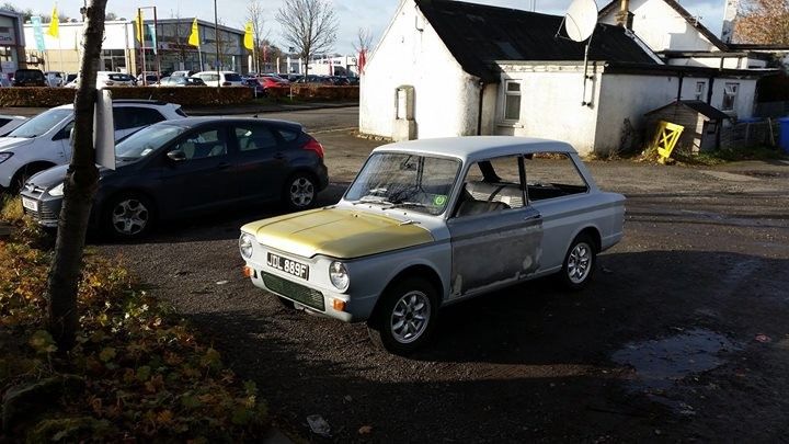

    JDL 889 F was the first car I pulled out a few years back now and restored.
    Came in running and driving looking like this.

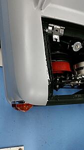

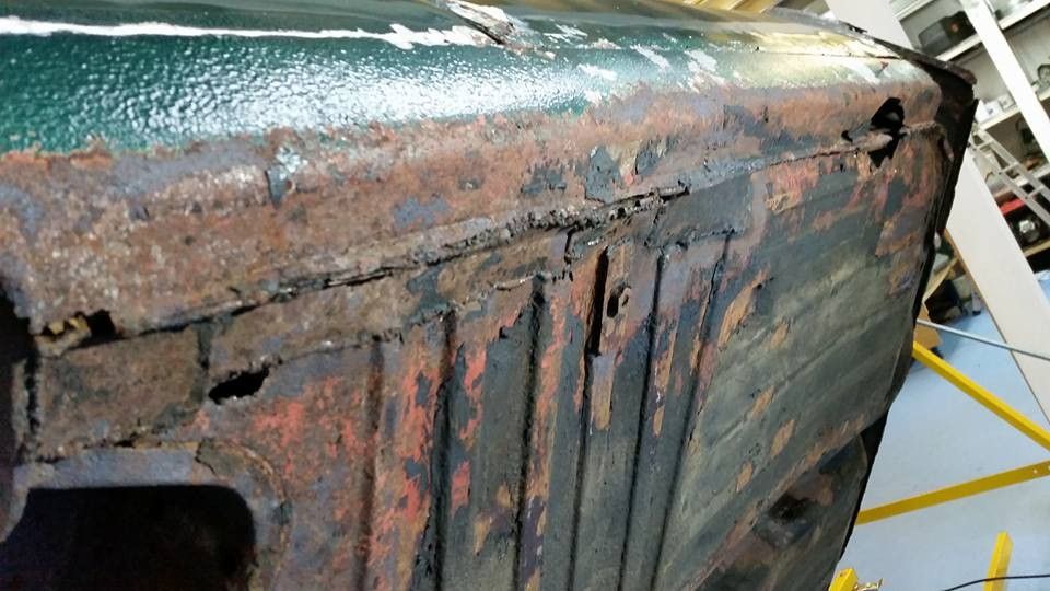

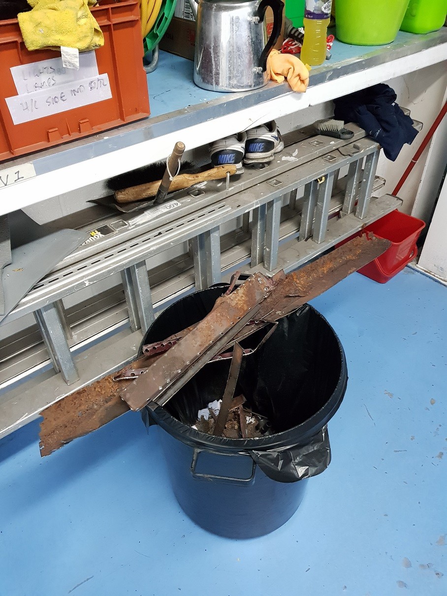

    Upon picking at it I ended up with this.
    The phrase "what lies beneath" comes to mind !
    This car had every possible bad repair done to it.
    The journey with this one was an effective map of every possible rot point in an Imp., if you want a guide to point to the rot spots and how much worse the "bit of rust" you found and brushed over can actually be, read the story

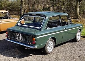

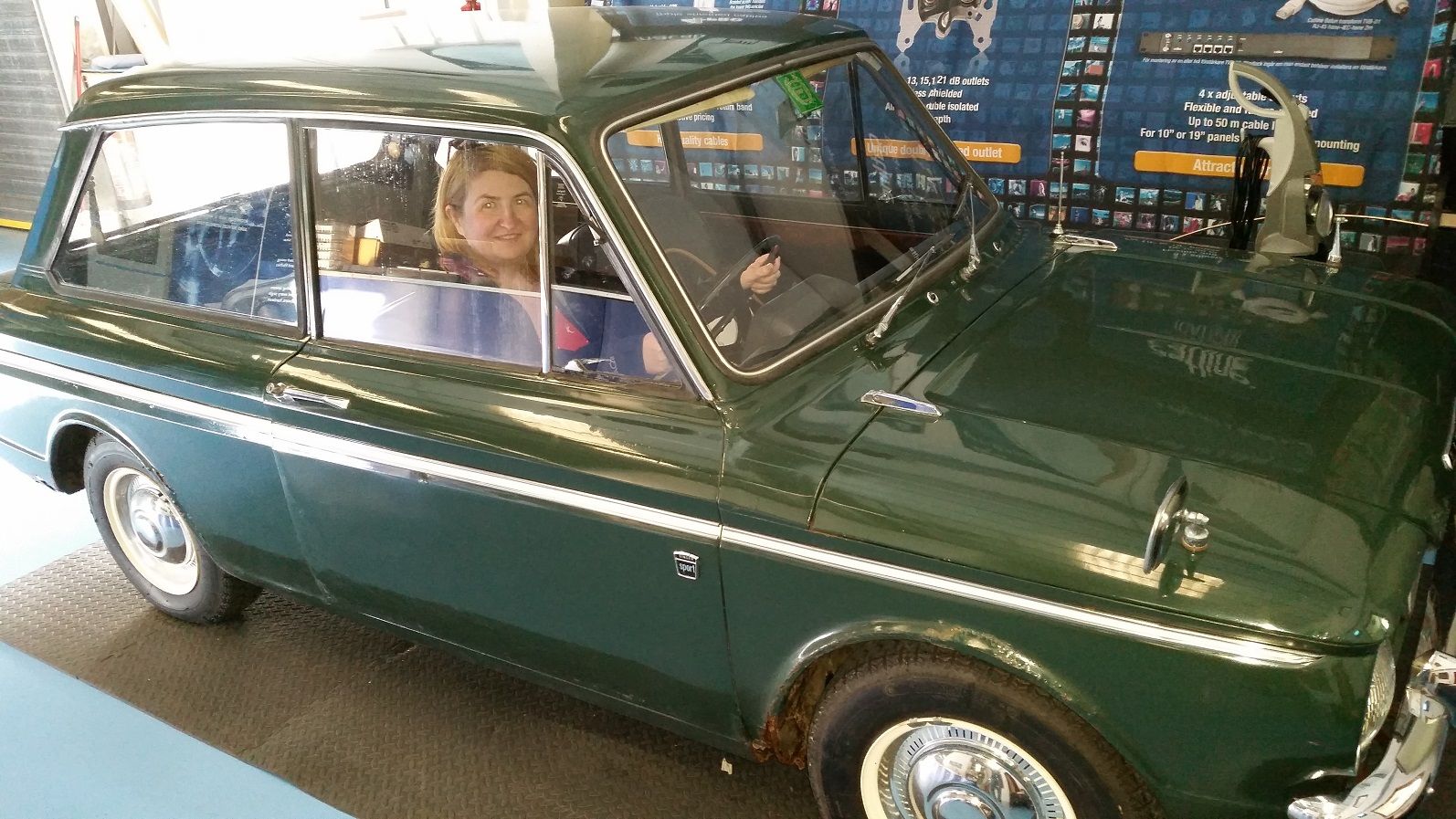

    Yes we REALLY did MOT it like this and used it as a runaround, fantastic fun, closest we had to a soft top Imp

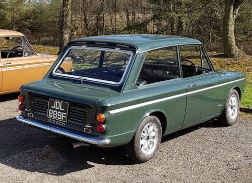

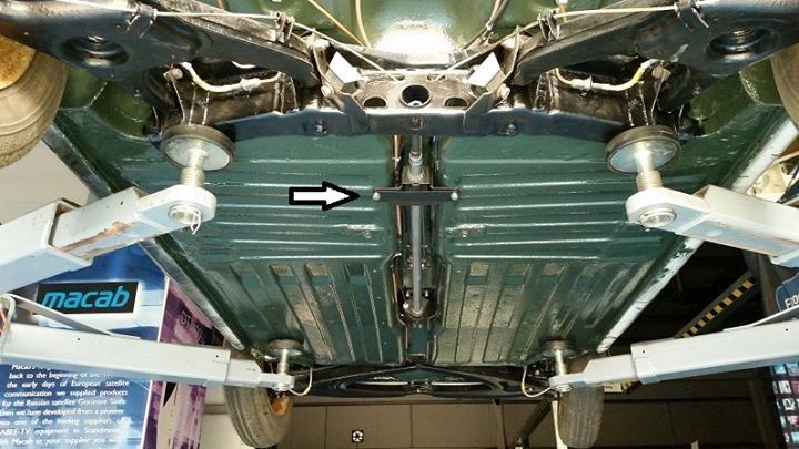

    In the end it was like this, now sold to a very nice fella who is fitting it with a BMW engine. I drove the car and did the hand of in Carlisle. Once home the new owner commented it was the bet drive he had had in "another persons imp" which I was well chuffed with. he has plenty spares being a clan owner for many years.
ID:	4467Click image for larger version
    Its journey was long an tested my patience to the limit but the result was great.

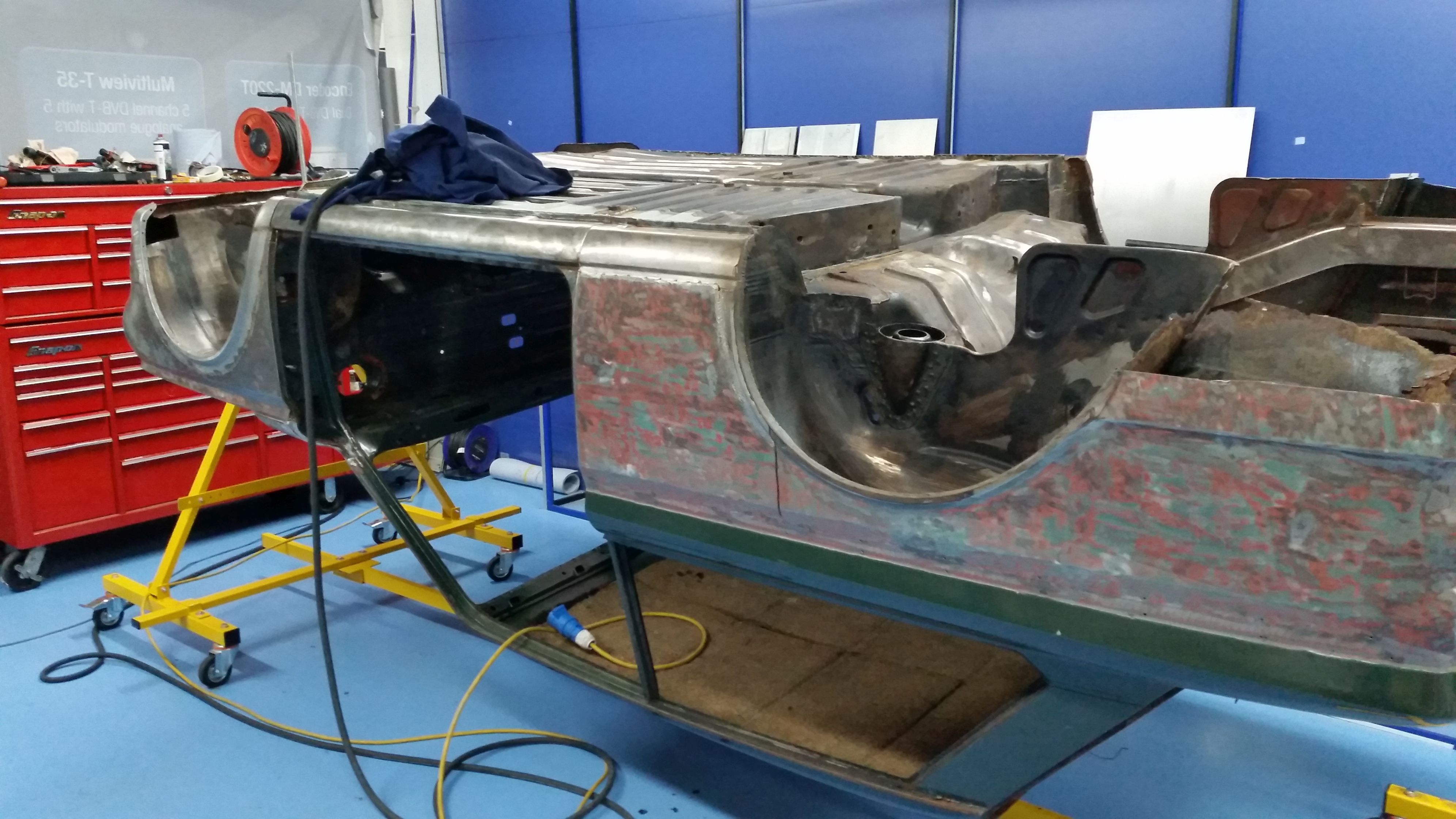

      So it arrived, all downhill after that, needless to say after not touching one of the cars for nearly 25 years its been a steep learning curve on the cars anatomy.
      I reckoned in the beginniging there was about 120 hours in George for fabrication and structural, boy was I wrong !!!
      Biggest let down has been the fit of the after market panels. We will get back to that now and again as we go through the build.

        And here the challenges started, most of the car was swept up from the floor, a prime example of why cover sills (and yes we all used them at some point) are bad bad bad.... did I say bad ?
          And some more bad news, starting to lose car piece at a time !
            And so the tear down continued, more bad news, more rot and more cutting

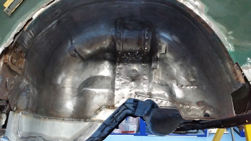

ID:	579Inner wheel tubs at front and suspension mounts had to be ripped out,

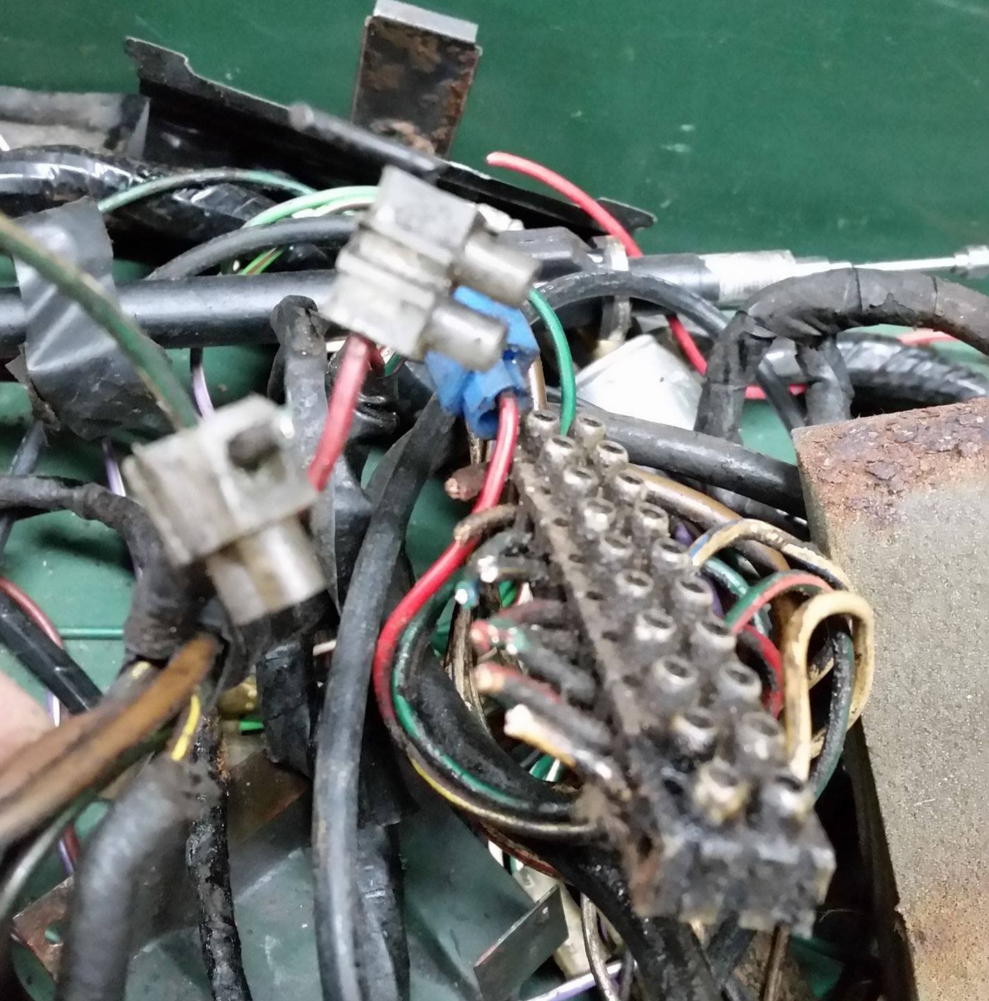

ID:	577 Typical Imp Wiring at its best ! evolving over the years !

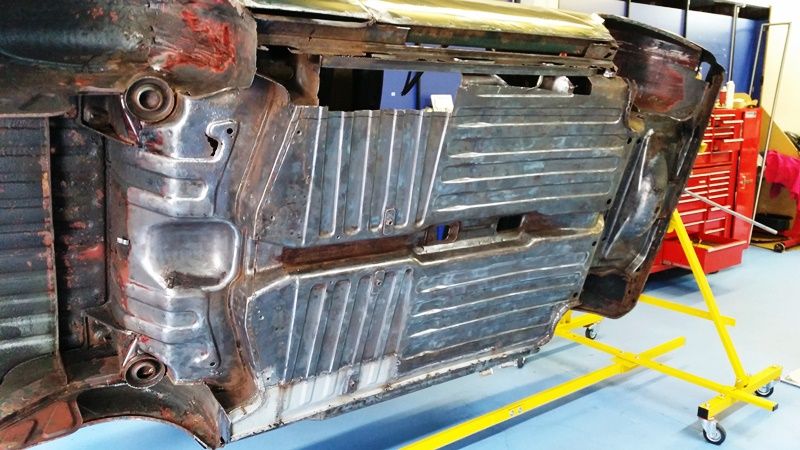

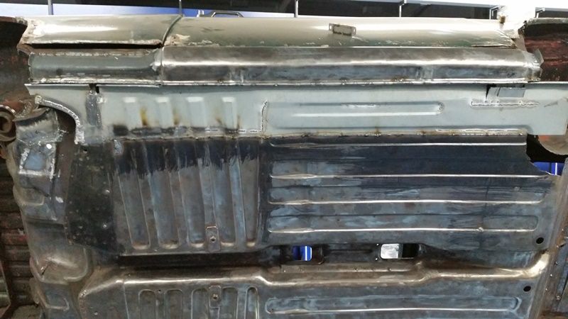

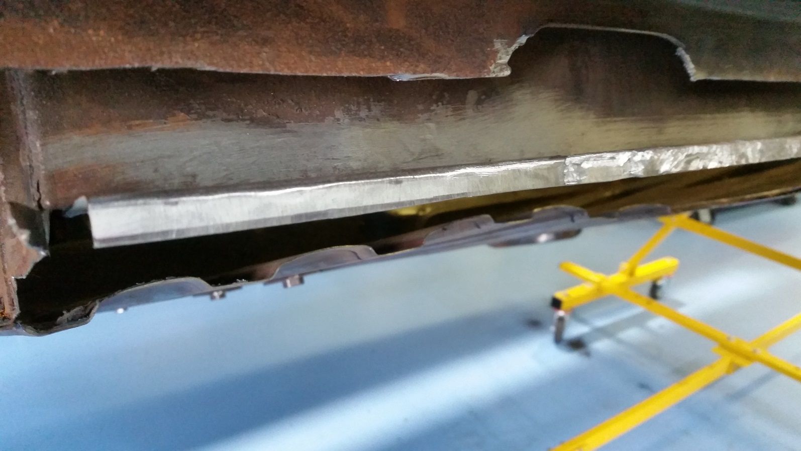

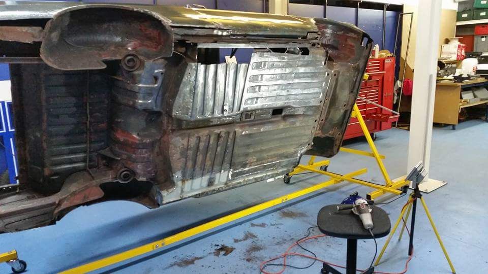

                  Sillas and floors, sills and floors, for an Imp this can be endless
                  Click image for larger version  Name:	30 PIC-06848.jpg Views:	0 Size:	1.23 MB ID:	2778 Click image for larger version  Name:	30 PIC-06904.jpg Views:	0 Size:	63.7 KB ID:	2765
                  Click image for larger version  Name:	33 PIC-06881.jpg Views:	0 Size:	1.09 MB ID:	2769 Click image for larger version  Name:	33 PIC-06884.jpg Views:	0 Size:	86.0 KB ID:	2767
                  Looks bad but coming together nicely !

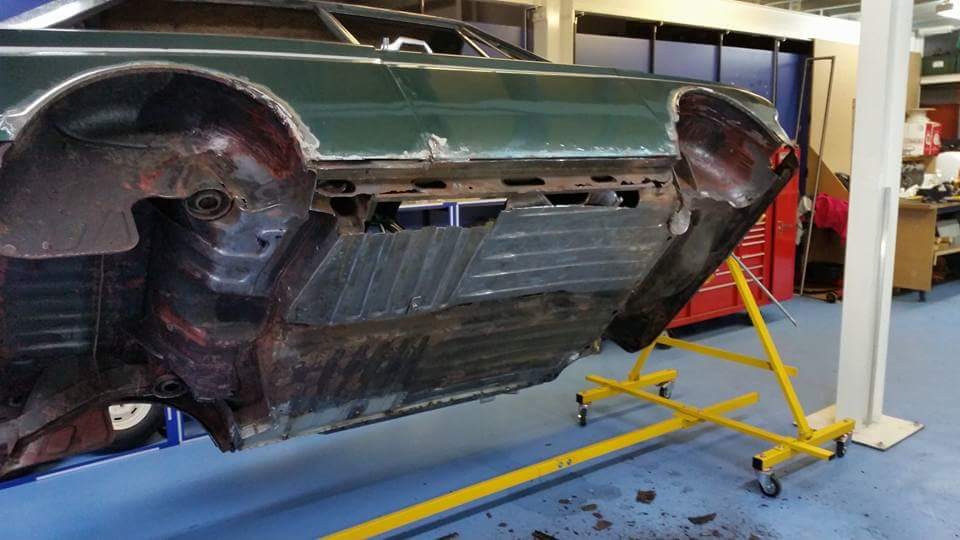

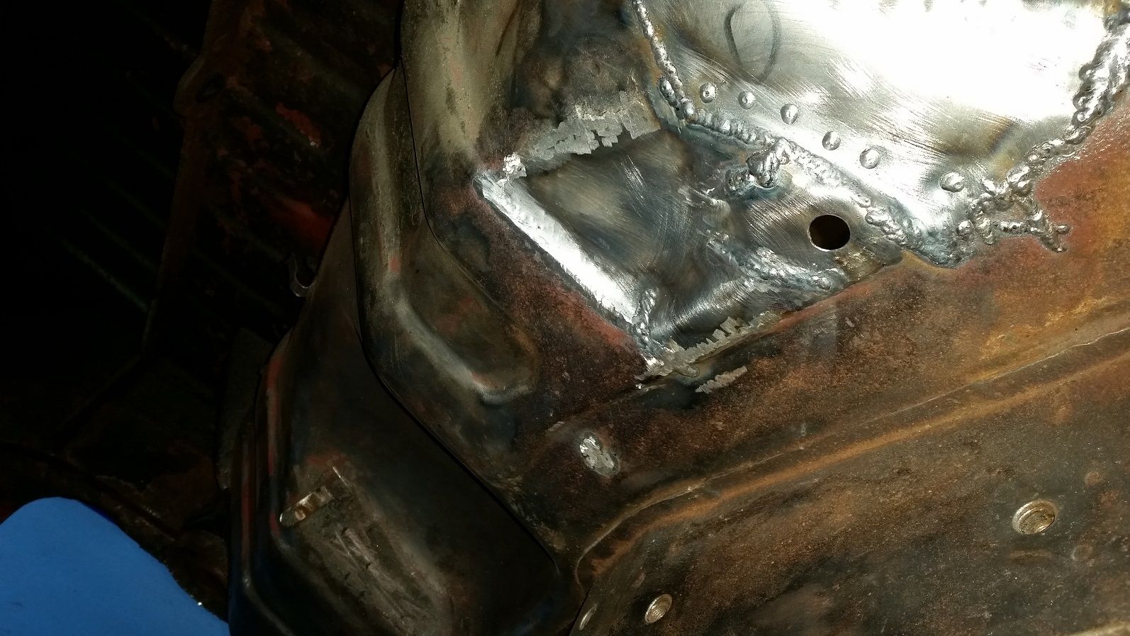

                    ​​And when it comes to imp under bellies there is ALWAYS more, should have called this car Ollie
Name:	70 PIC-06849.jpg
Name:	40 PIC-06885.jpg
Name:	45 PIC-06891.jpg
ID:	2781 Click image for larger version
Name:	45 PIC-06901.jpg

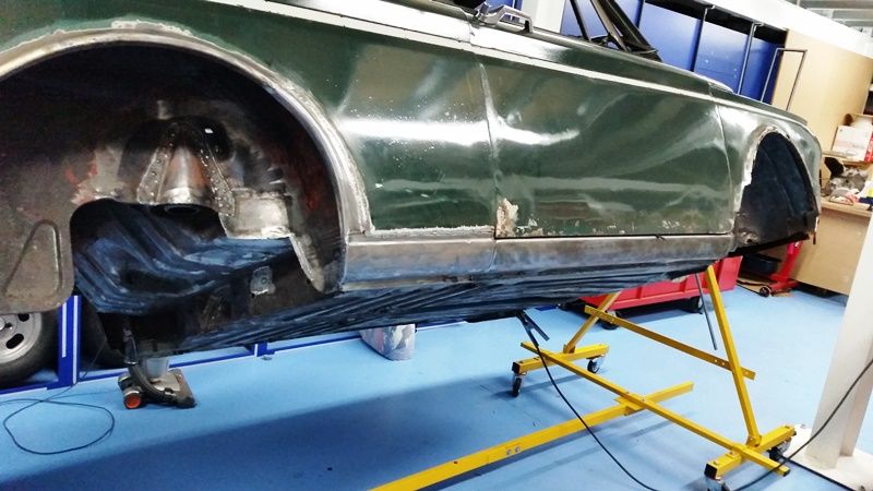

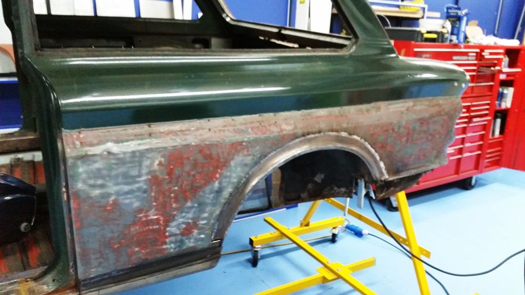

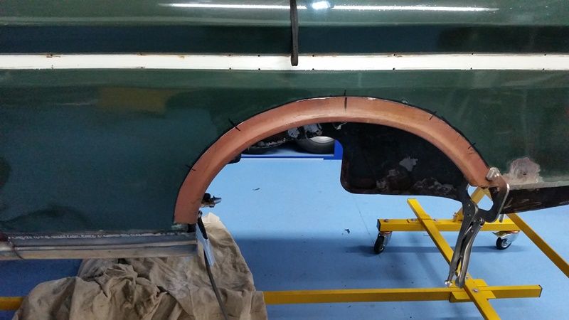

                      And onwards again with old Gerorge boy, this was a very log resto, about 18 months.
                      Time to attend to some other parts, arch repairs, lower rear wing sill covers, door corners, ends of sills at A pillar.
                      Click image for larger version  Name:	35 PIC-08189.jpg Views:	0 Size:	179.3 KB ID:	2928 Click image for larger version  Name:	45 PIC-06914.jpg Views:	0 Size:	51.0 KB ID:	2939

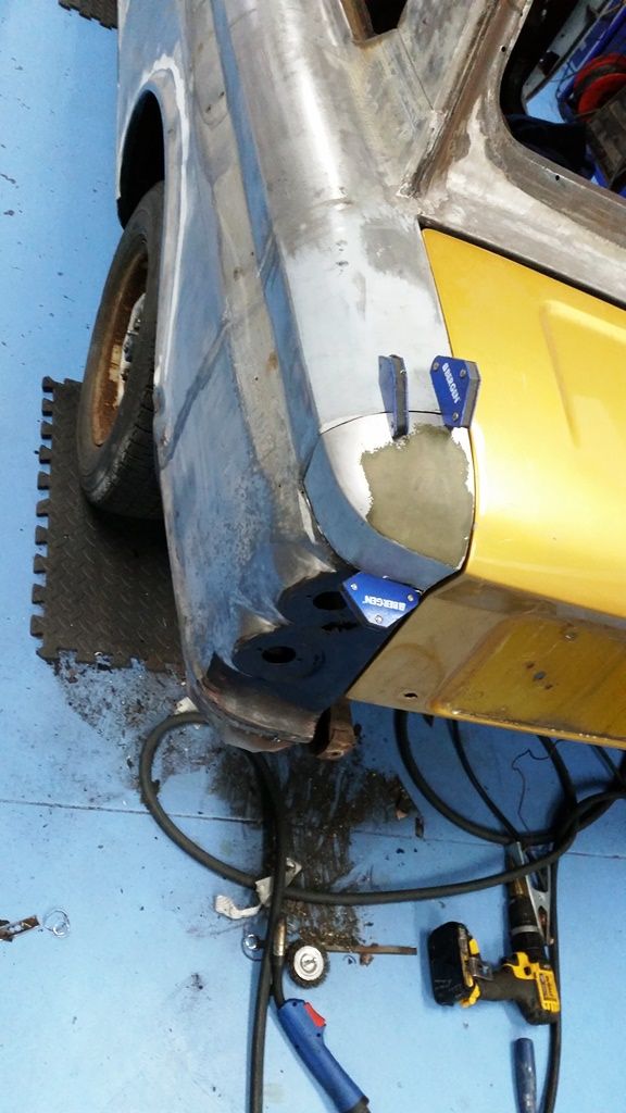

                      Door corner above and then cut out old arch and inlay new arch section, I would hve replaced more of the arch but the arch repair panel was very poor fit, so only the arch part was used.
                      See below tacked in and a start made on the rear wing cover, again this section was a very poor fit and then we are on to the A pillar step sill closing sections
                      Click image for larger version  Name:	40 PIC-06926.jpg Views:	0 Size:	92.1 KB ID:	2930 Click image for larger version  Name:	22 PIC-06871.jpg Views:	0 Size:	1.07 MB ID:	2931
                      And more on the rear windg sill cover, red devils i call these, they are of a shape but poor and as they are hand made no two are everr the same, lots of trimming and fettling, way more than is needed, better alternatives exist now but not back then
                      Click image for larger version  Name:	35 PIC-06874.jpg Views:	0 Size:	1.16 MB ID:	2932

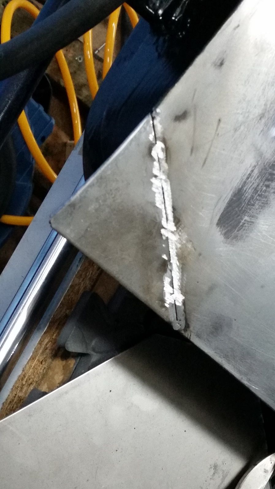

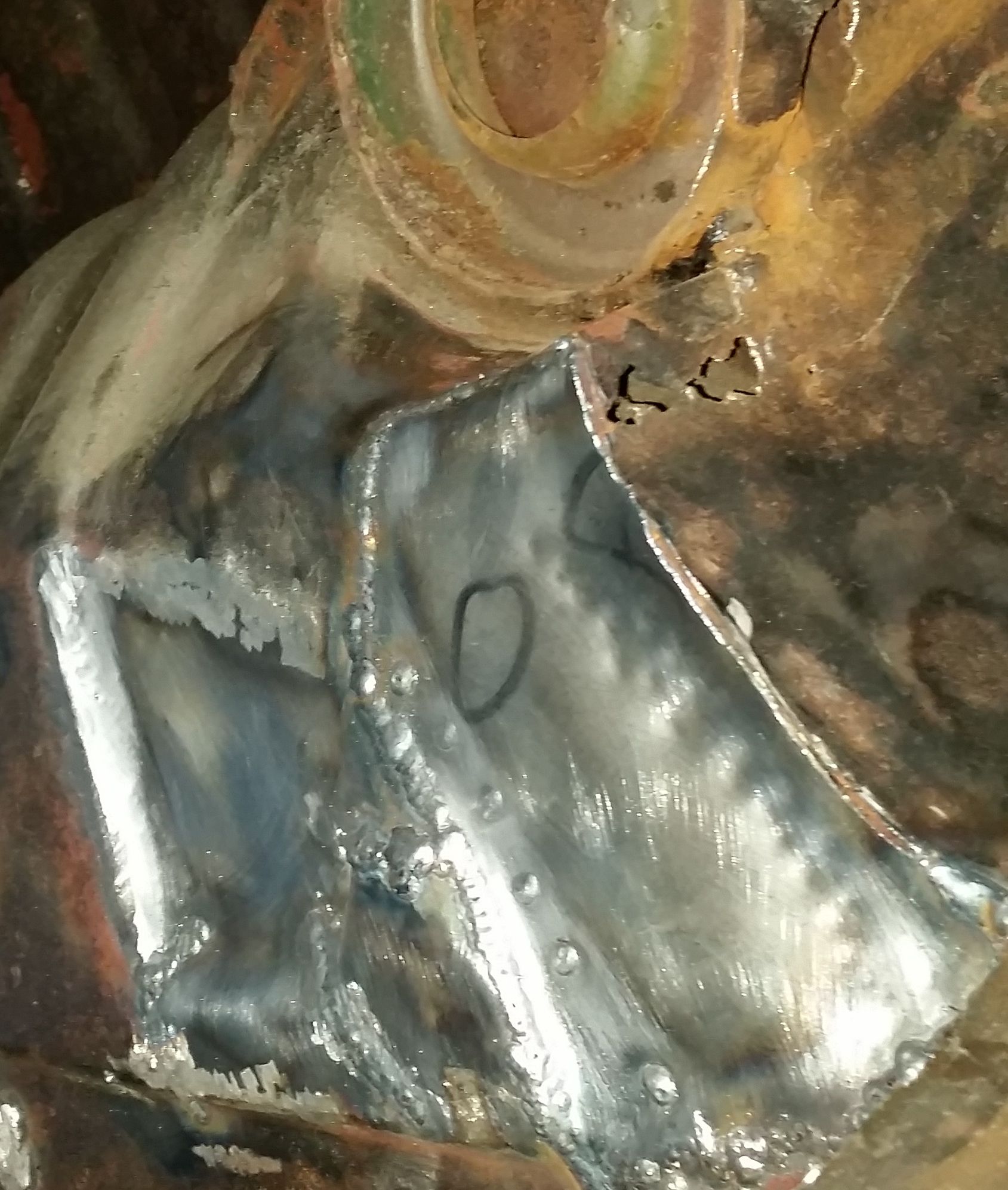

                      Rear spring supports, again the red devils needed slit, eshaped and then welded in. These were the last I ever bought, easier to make new ones from scratch and made to fit !
                      Click image for larger version  Name:	42 PIC-06899.jpg Views:	0 Size:	1.50 MB ID:	2938 Click image for larger version  Name:	38 PIC-06862.jpg Views:	0 Size:	1.63 MB ID:	2941

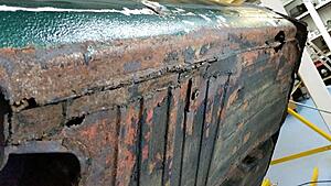

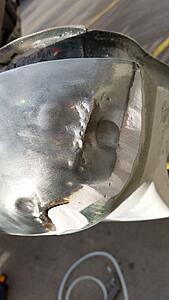

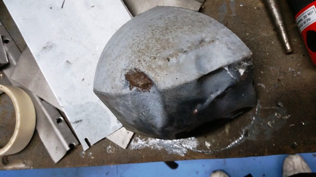

                        And so that bad back corner
                        beat it, shape it, fill it, oh no.
                        Slice dice off another back wing and add it in
                        Click image for larger version  Name:	21 PIC-07971.jpg Views:	0 Size:	1.61 MB ID:	2946
                        And cut out
                        Click image for larger version  Name:	40 PIC-06971.jpg Views:	0 Size:	77.8 KB ID:	2945

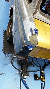

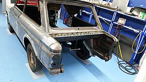

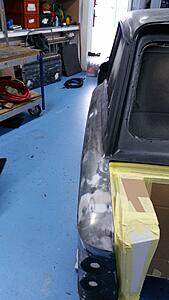

                        New piece held in place and lined up
                        Click image for larger version  Name:	59 PIC-06973.jpg Views:	0 Size:	90.3 KB ID:	2944
                        And then fully welded in and flatted off
                        Click image for larger version  Name:	PIC-08102.jpg Views:	0 Size:	1.45 MB ID:	2943
                        Click image for larger version  Name:	89 PIC-08047.jpg Views:	0 Size:	1.31 MB ID:	2947
                        The final outcome in primer
                        Click image for larger version  Name:	PIC-07071.jpg Views:	0 Size:	1.43 MB ID:	2948

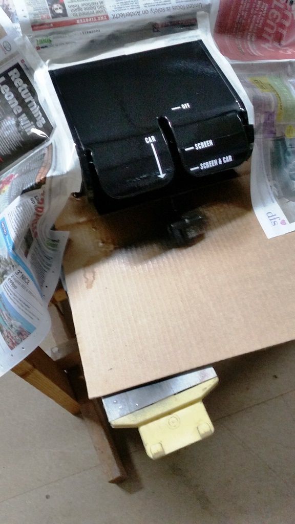

                            And in betwen all the fabrication work let us not forget all the other bits still needed in the end

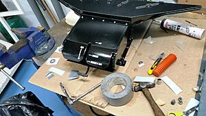

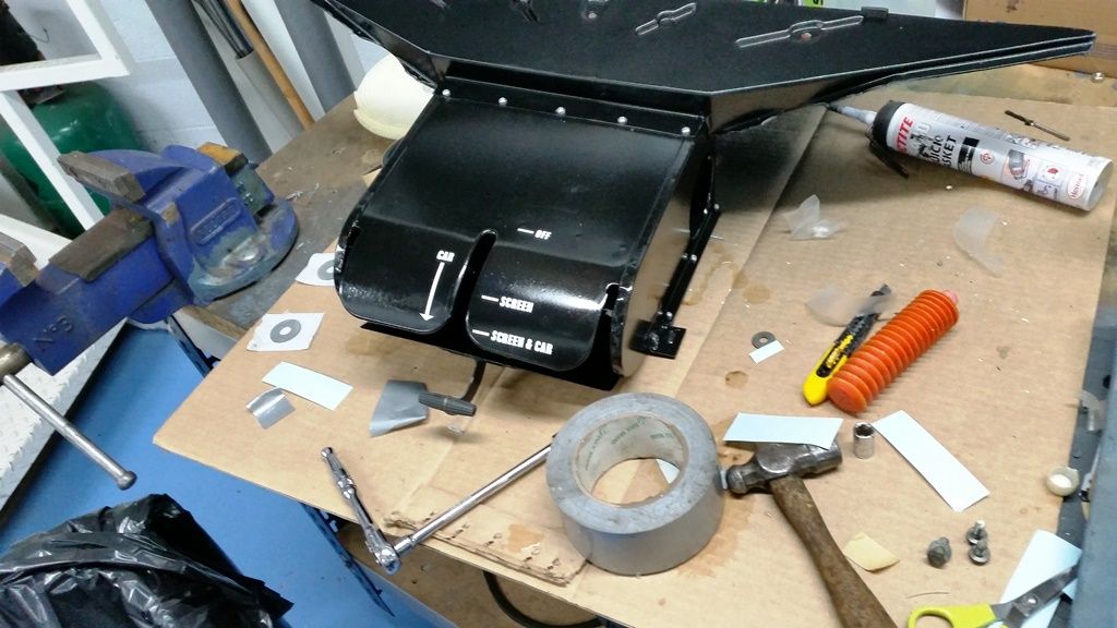

                            Heater box refurbishment !
                            All media blasted up, painted satin black and trested to a nice new set of decals from Robin Human (find him on Facebook - The Hillman Imp group
                            Click image for larger version  Name:	PIC-08030.jpg Views:	0 Size:	1.06 MB ID:	2953 Click image for larger version  Name:	PIC-08031.jpg Views:	0 Size:	1.09 MB ID:	2954 Click image for larger version  Name:	PIC-07866.jpg Views:	0 Size:	84.4 KB ID:	2952

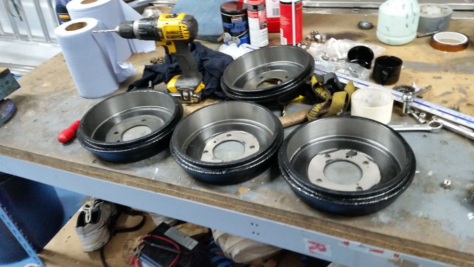

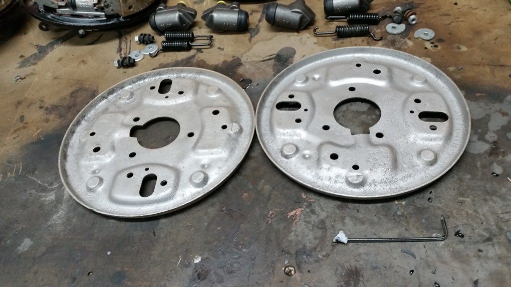

                              And of course BRAKE drum assemblies, all blasted, coated, pre-assembled complete with a set of similarly treated but internally skimmed to a fine finish ready to refit when done.
ID:	2956 Click image for larger version
ID:	2957 Click image for larger version
