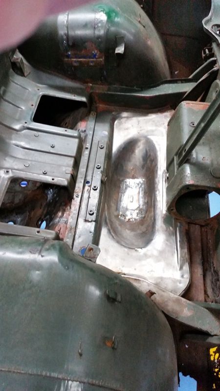

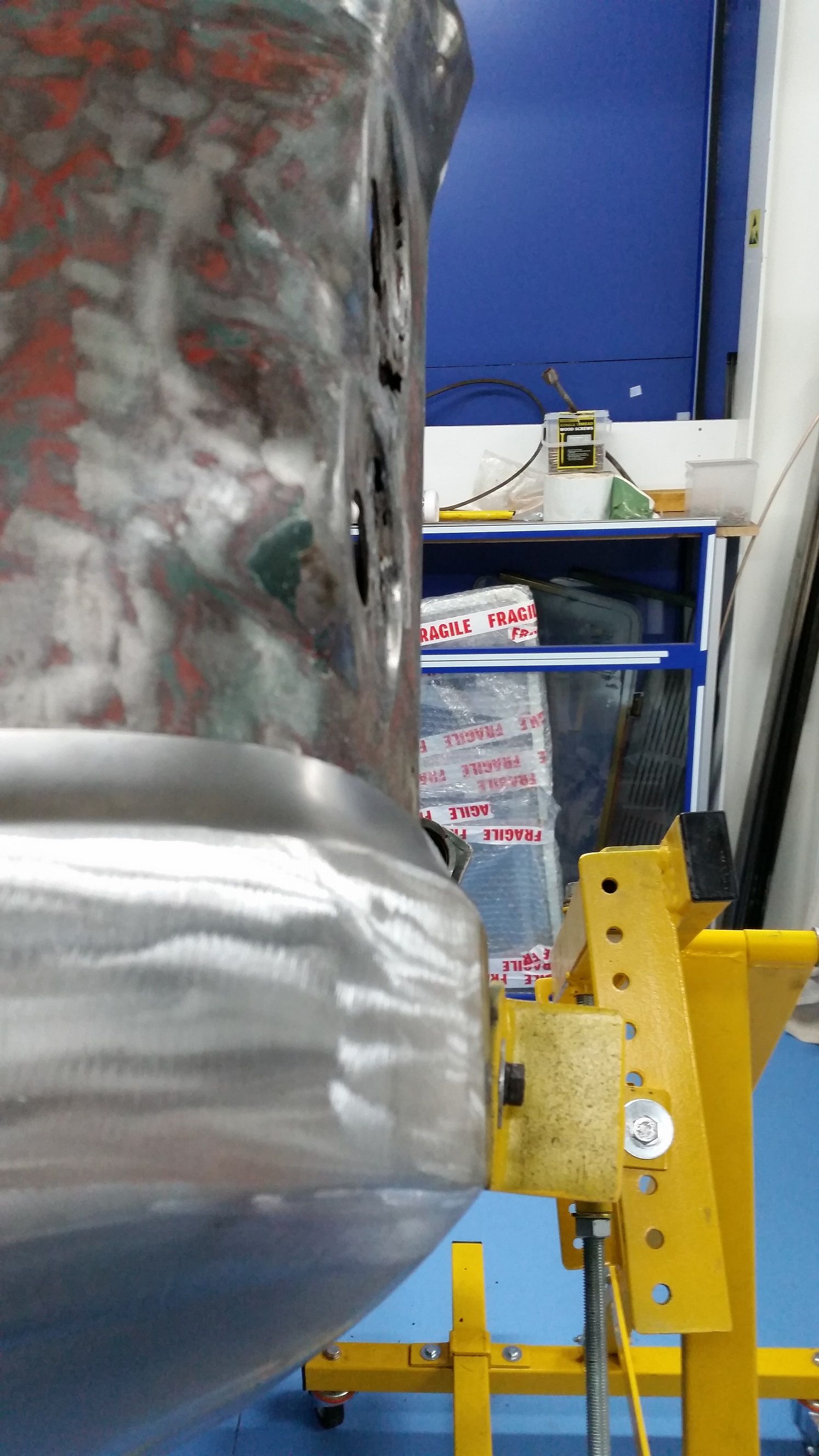

    And some bashing on curves for the bottom of the spare wheel tub, was not big enough to justify cut out panel and fit used one
    Turned out not too bad
Name:	50 PIC-06907.jpg
ID:	3067 Click image for larger version

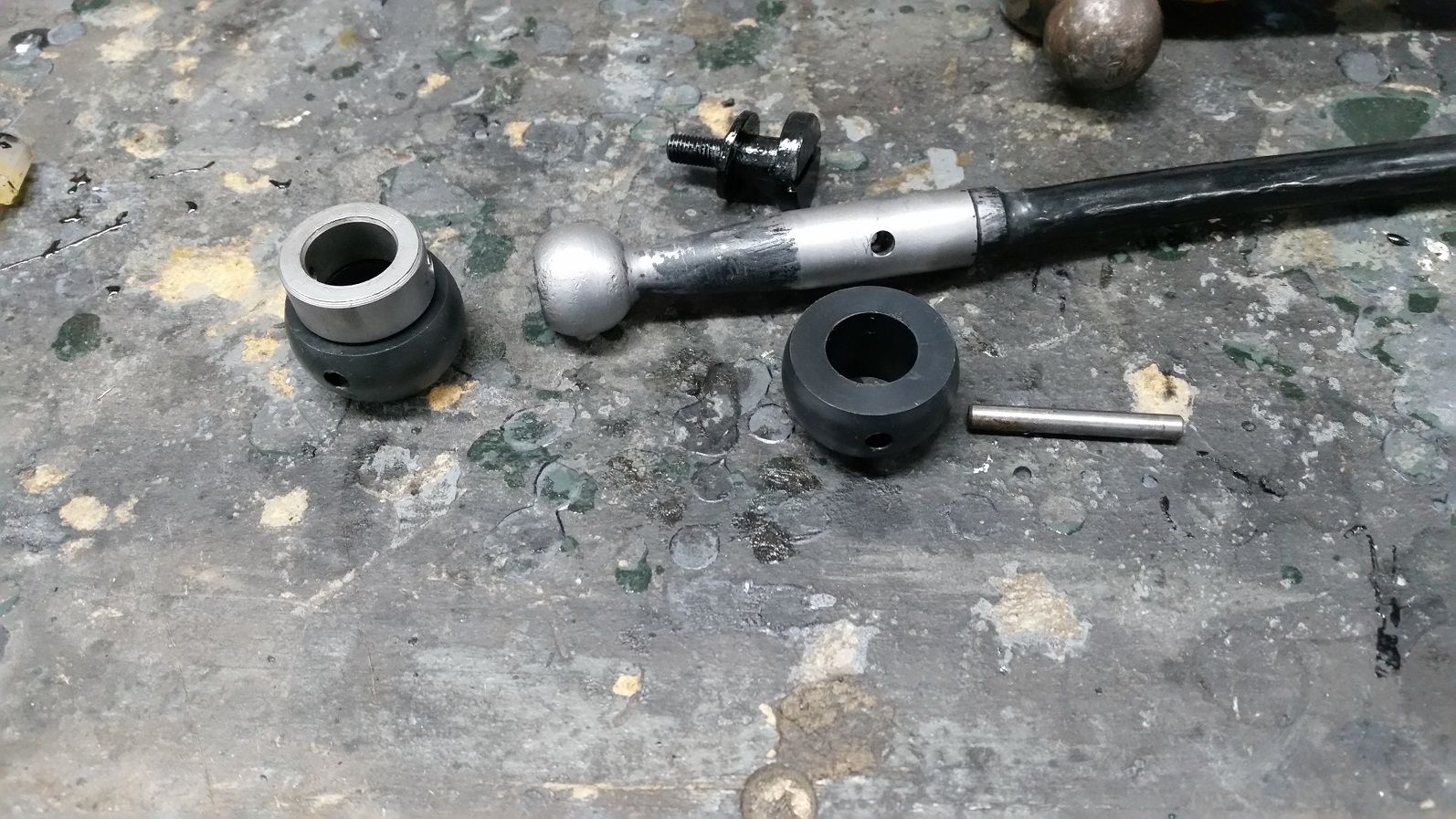

      And of course we cannot forget our balls
      Replacement of the lower ball cup in the gear change selector.
      This is the old style one, replacements these days from Bob Allan at Imp Club Spares (membership required to purchase) are now a different style and I will add an article in later next month on changing it using new balls

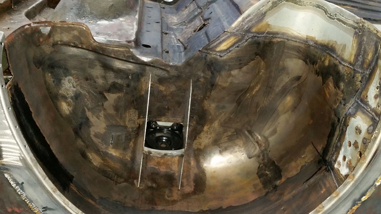

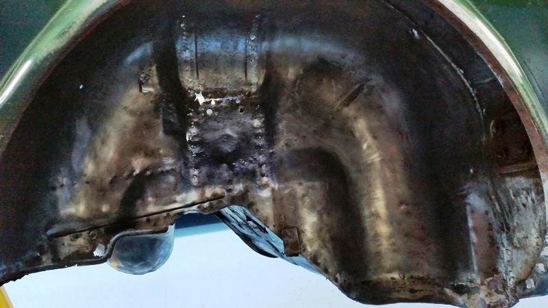

        How front suspension mounts, a notorious weak spot for imps were totally rotted so I foolishly cut these out completely and repaired the back skins (just single skin on this car as its a later shell)
        Went to order from Malcolm Anderson and unfortunately he did not have any left and could not get a hold of the fella who made them.
        So was time to make my own.
        First get the repair areas cleaned and ready

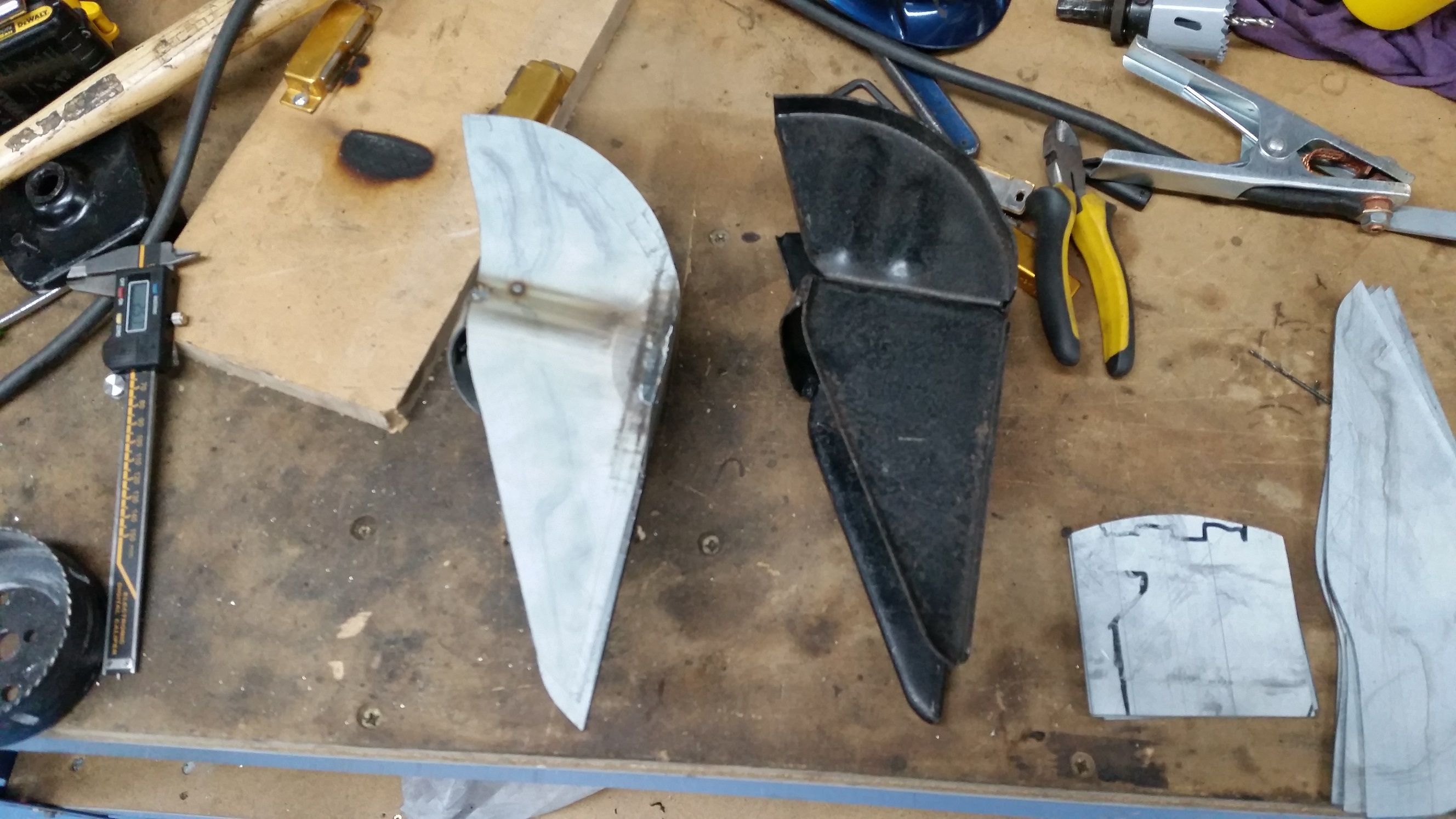

          #34

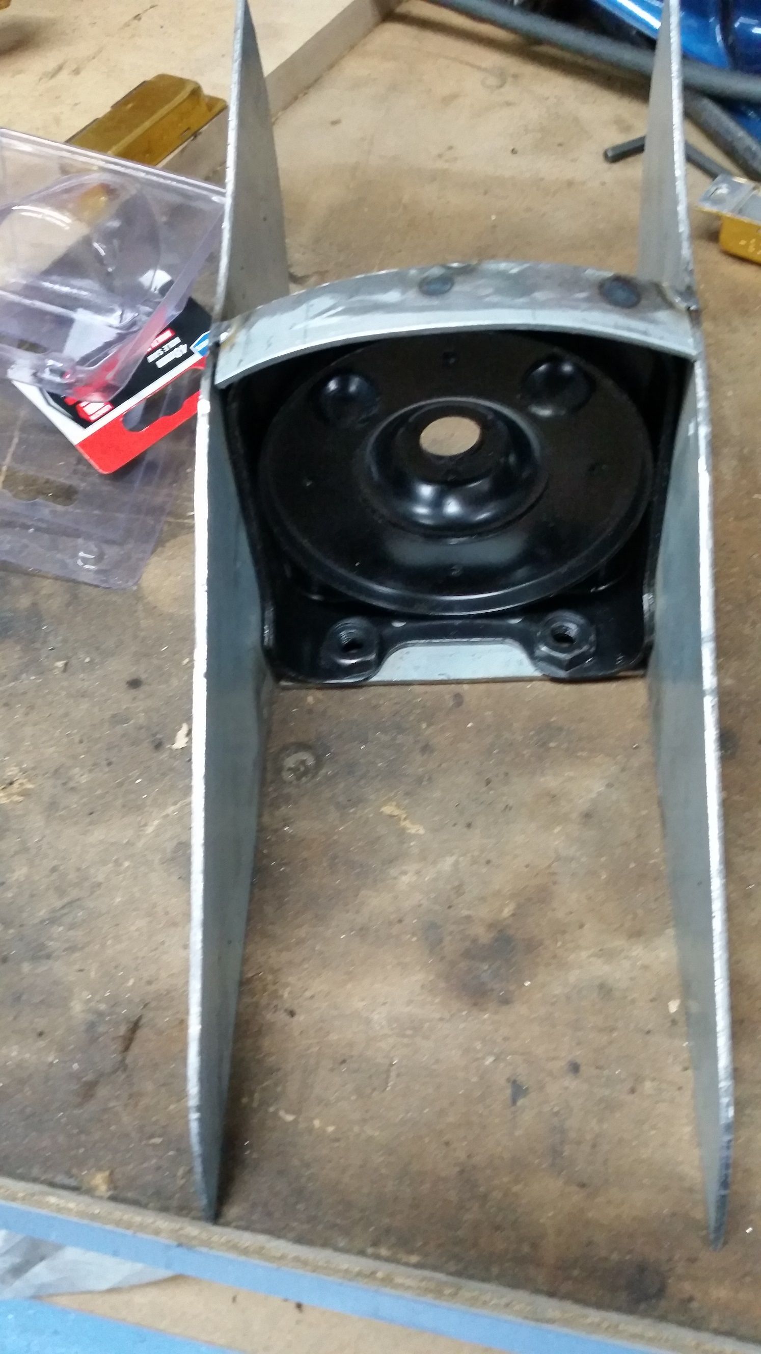

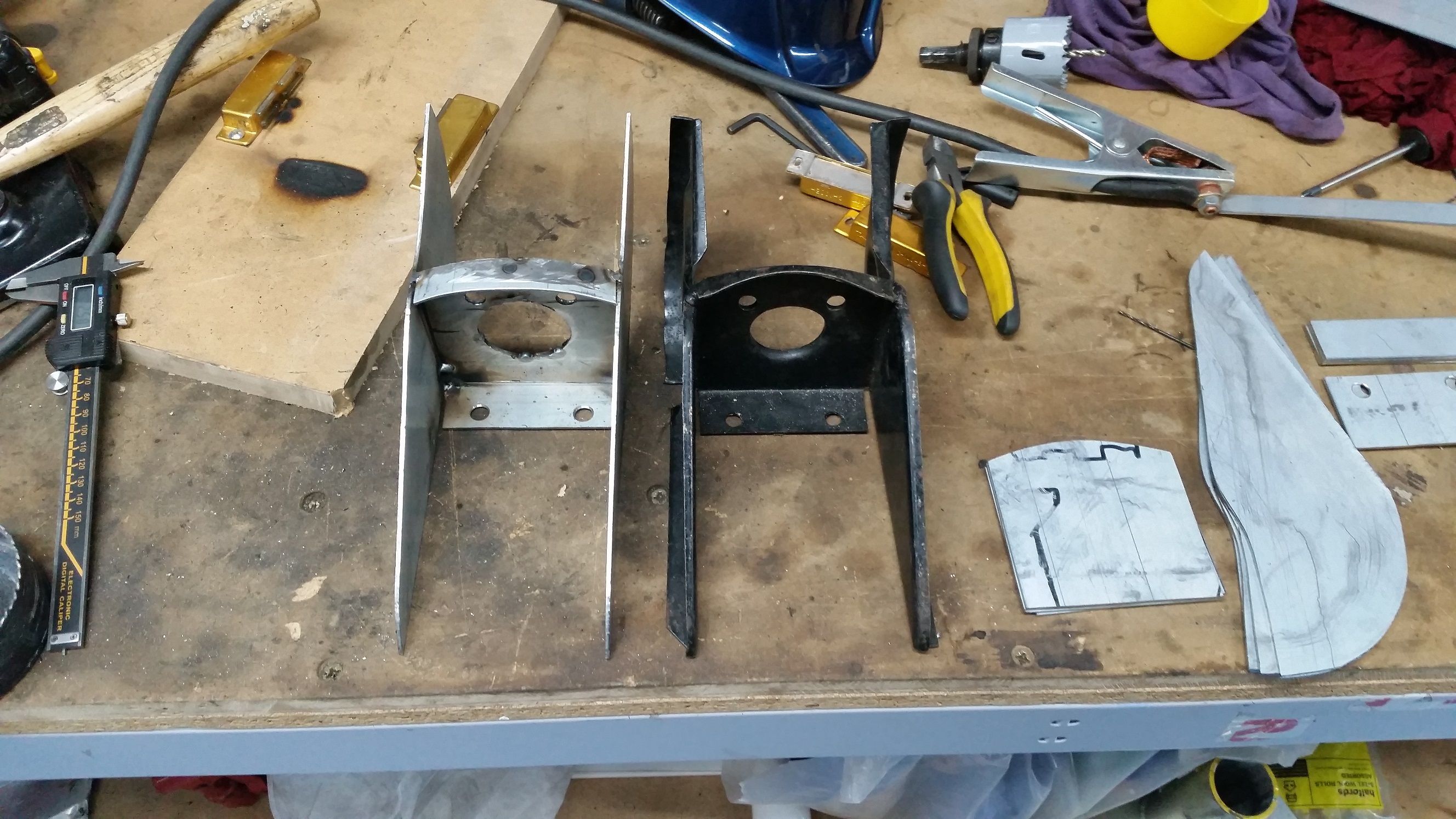

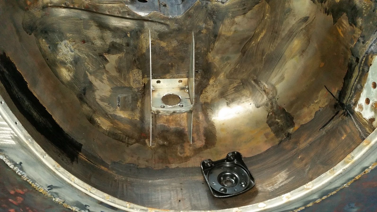

          once reapired its time to find something to fit in there, I had fitted Malcolms H mounts before and they were a great fit but with none on the horizon time to make some. Maclolm kindy let me have a factory one to use as a template, cheers Malcolm, top man.
          Unfortunately I cannot fold like Malcolms fella so I did what I know best, made some drawings and models and created the same thing but as a cut list for sheet metal, this required an upgrade so the edge sections ended up being 2mm and the double sandwich in the middle 4mm which is a bullet proff upgrade.
          See below the outcome vs original and accepts the top spring mount perfectly like an original with caveat that there is less exposed thread length out top due to the extra thickness.
Name:	33 PIC-07919.jpg
          Side view with the flat sheet cuts for the others on the right hand side
Name:	23 PIC-07917.jpg
Name:	34 PIC-07915.jpg
          Face on view

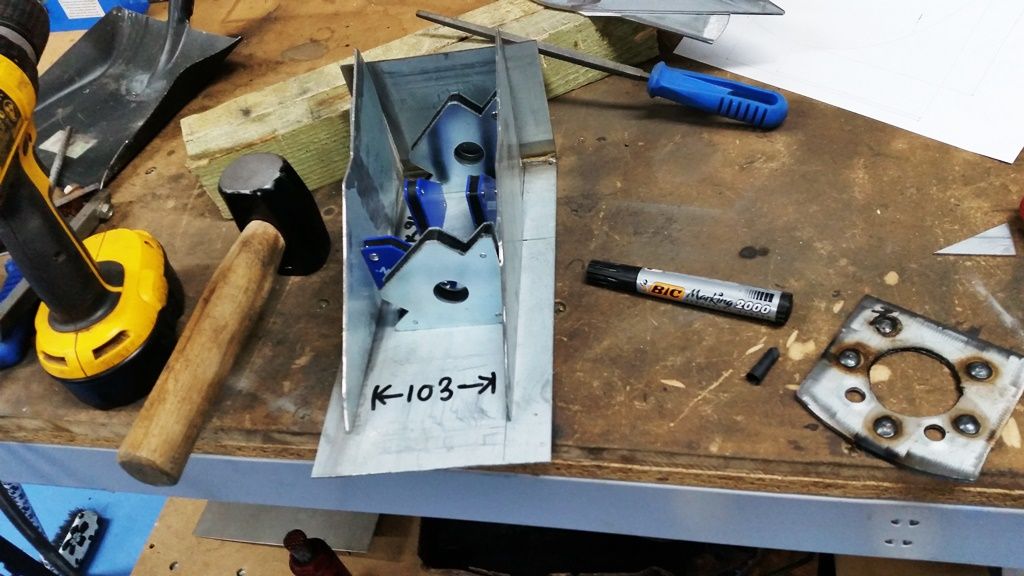

            And of course you need to get them in there and more importantly set the heights correctly so the top spring mounts are at same height on both sides, no opto flex here so old sschool.
            Using the steering rack mount as the horizontal reference getting shell level on jig I used a standard wide builders level with a small digital inclinometer on top to set the bead as level and exact same disctance from shell surface to under sid eof the bead, so now we have level shell and a reference above the location point for the H mounts.
            Not only does the H mount need to be the correct distance but also at the right andgle !
            See use of digital incinometrers, steel rules, masking tape and a bit of maths to set H mount heights and these wer then welded in place

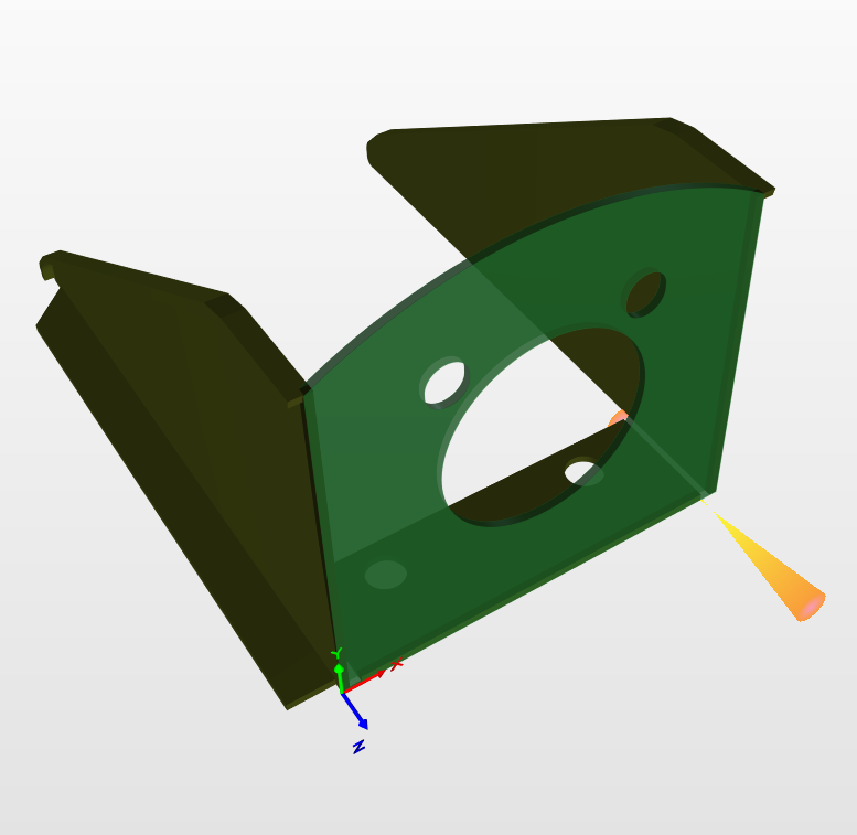

                And the original flat cut/assemble 3D model I did for the H mount lower, I have the rest and the cut list somewhere and will post it if i ever find it !

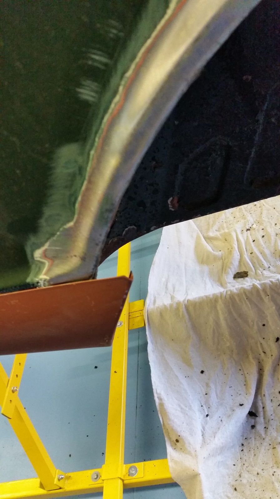

                  For rear corner repair I had several options
                  The first was fibreglass back lower corners by Chris Farren.
Name:	50 PIC-08014.jpg
                  These would have been a fantastic fit but I canned them as I prfer working with metal
                  Second was the ones I bought for the job, unfortunately those were nowhere near a good fit !
                  nothing lines up and left / right were nothing alike

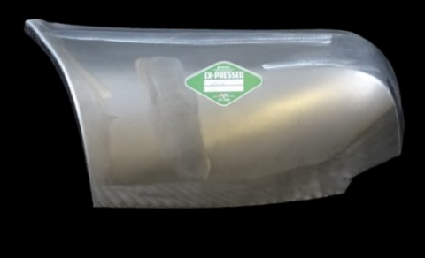

                  So new ones ordered from Expressed Steel Panels and fitted
                  Perfect fit, nearly no fettling at all.

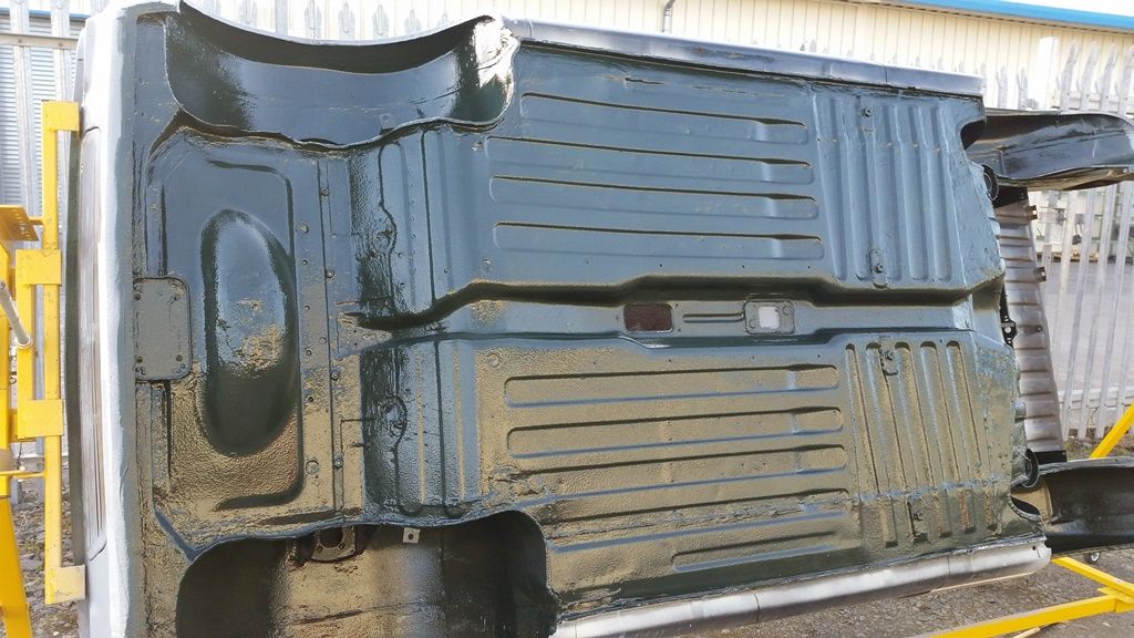

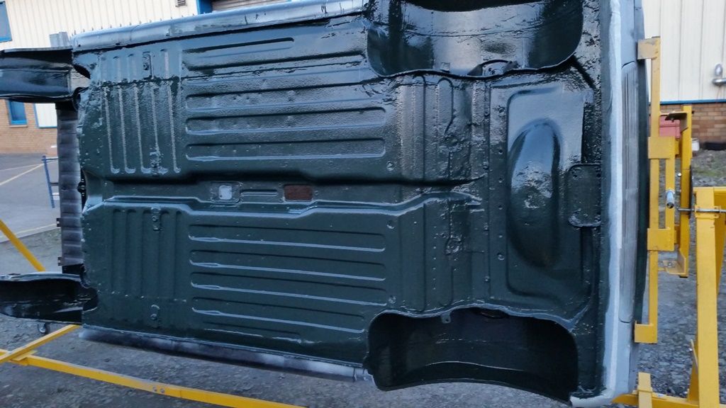

                    A couple more from the underbelly prep and paint, the paint booth I use is fantastic, ventilation is great you can hardly smell a thing !

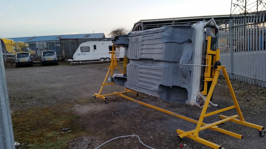

                    All done, rust treated, epoxy layers, seam sealed, primered, colour coat, gravitex hit wet on wet, more primer hit on gravitex then two coats of green.
                    I hate when you see paint chips and no paint undr it

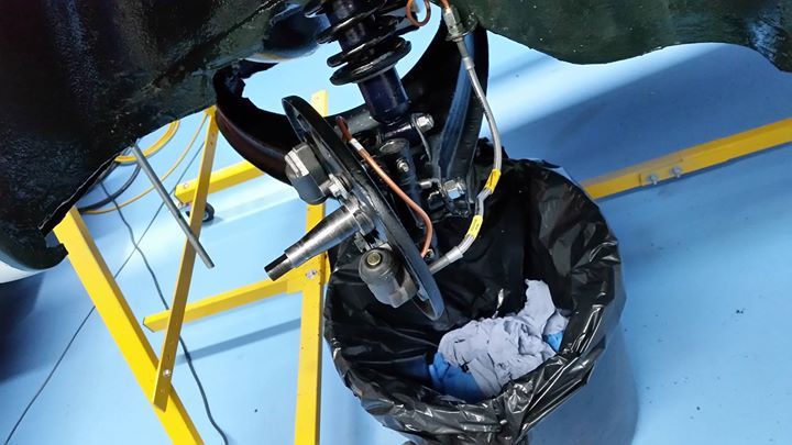

                          #42

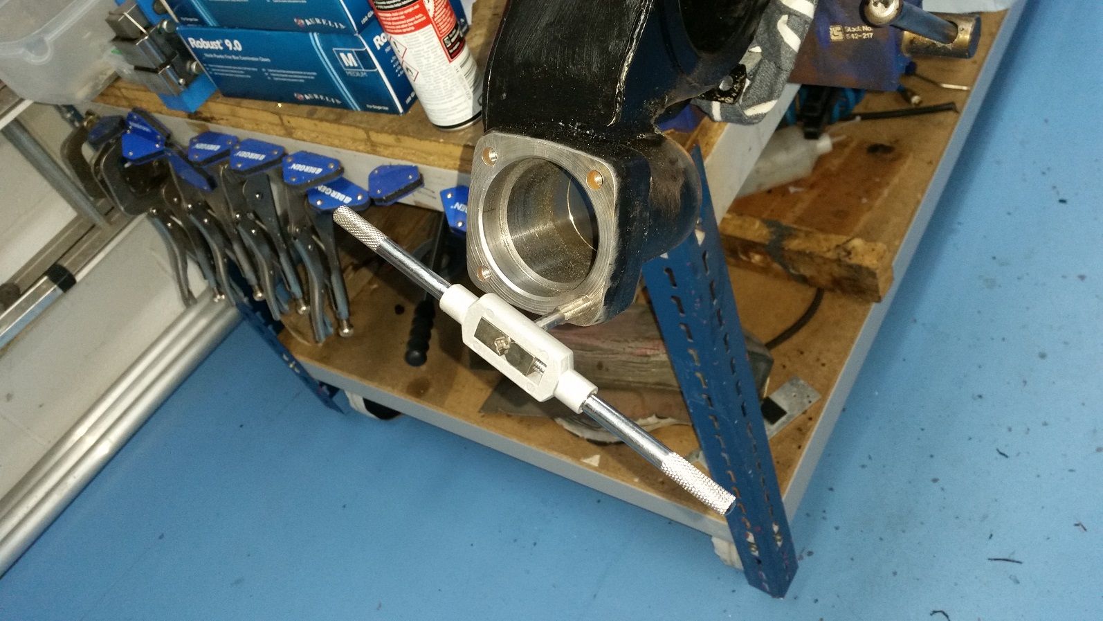

                          And least we forget the time taken cleaning and chasing threads, coating, greasing, fettling

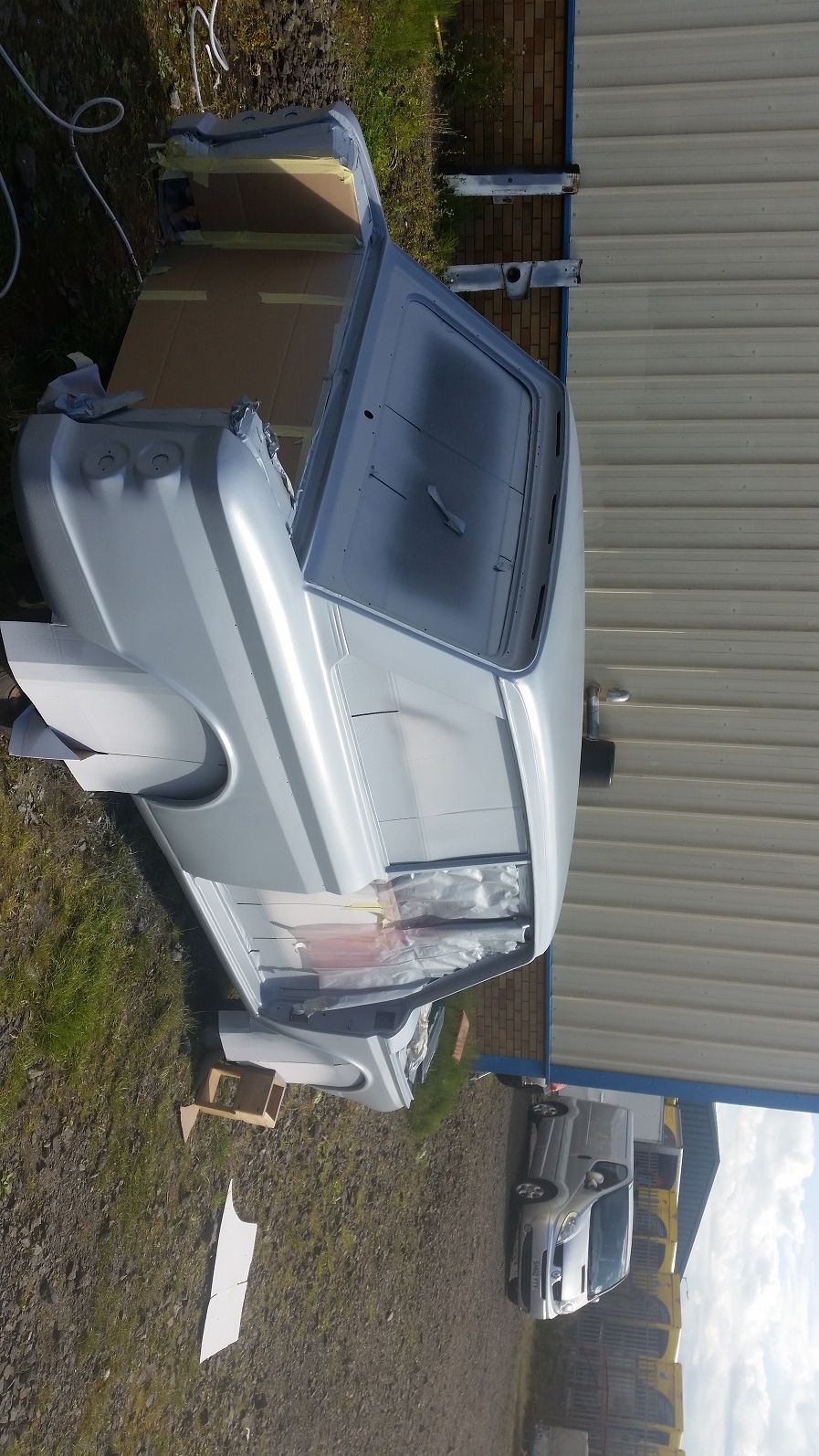

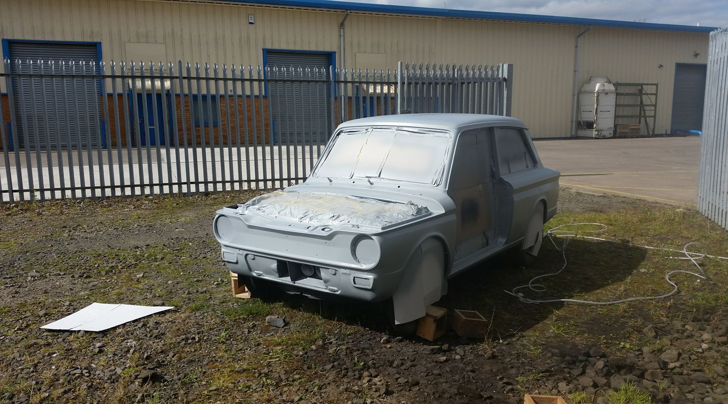

                            #43

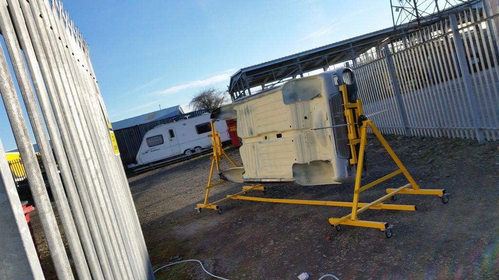

                            And of course prime time in the super duper big booth, I feel so spoiled sometimes
ID:	3983Click image for larger version

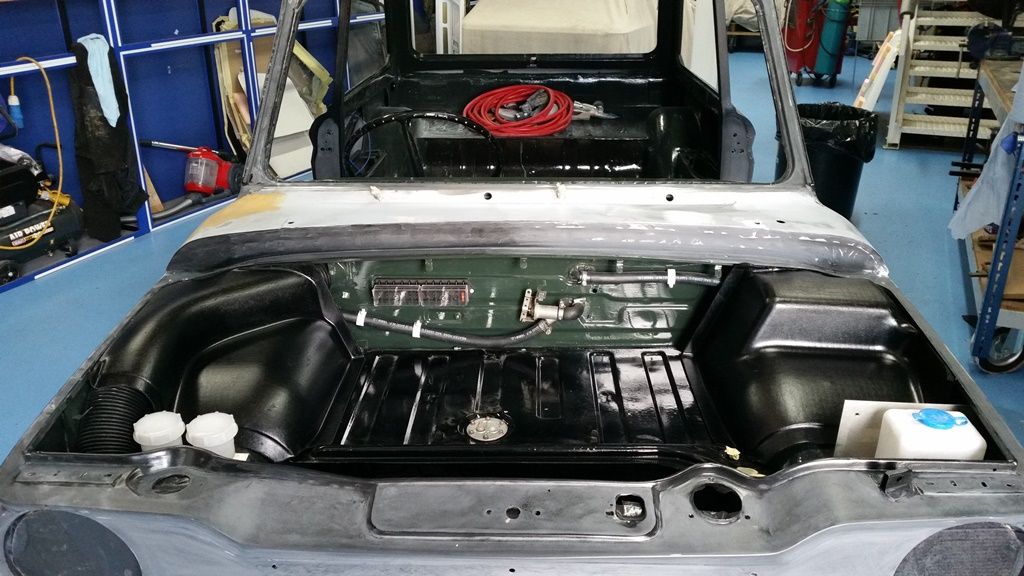

                              #44

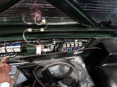

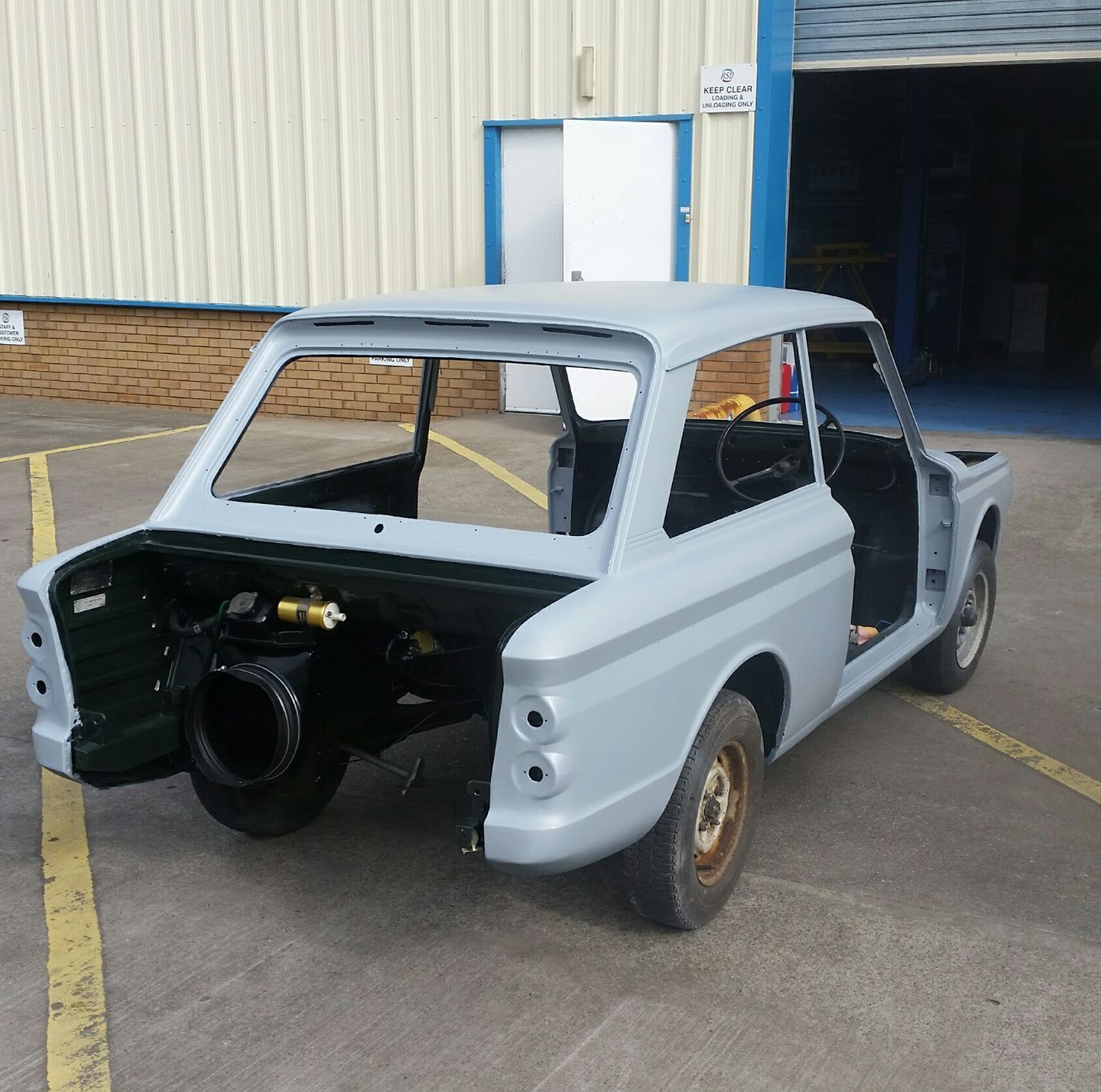

                              And then the modifications start
                              Example is the twin resevoir cylinders seen in the image and then the fuse box and wiring
ID:	3997Click image for larger version

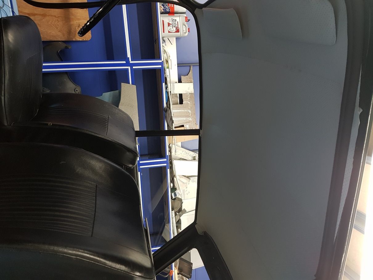

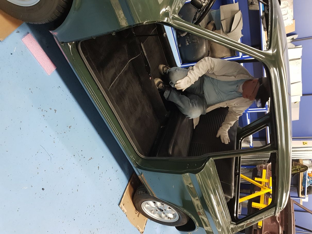

                              NOT to forget the new headlining provided by Lesley Smith (article to follow on that) and supervised by quality control expert wee baoby just after the carpets were added
                                #45
                                A closer look at the head linings remanufactured from Lesley Smith
                                Lesley also provided the sun visor covers and rear arch vinyl covers for the car.
