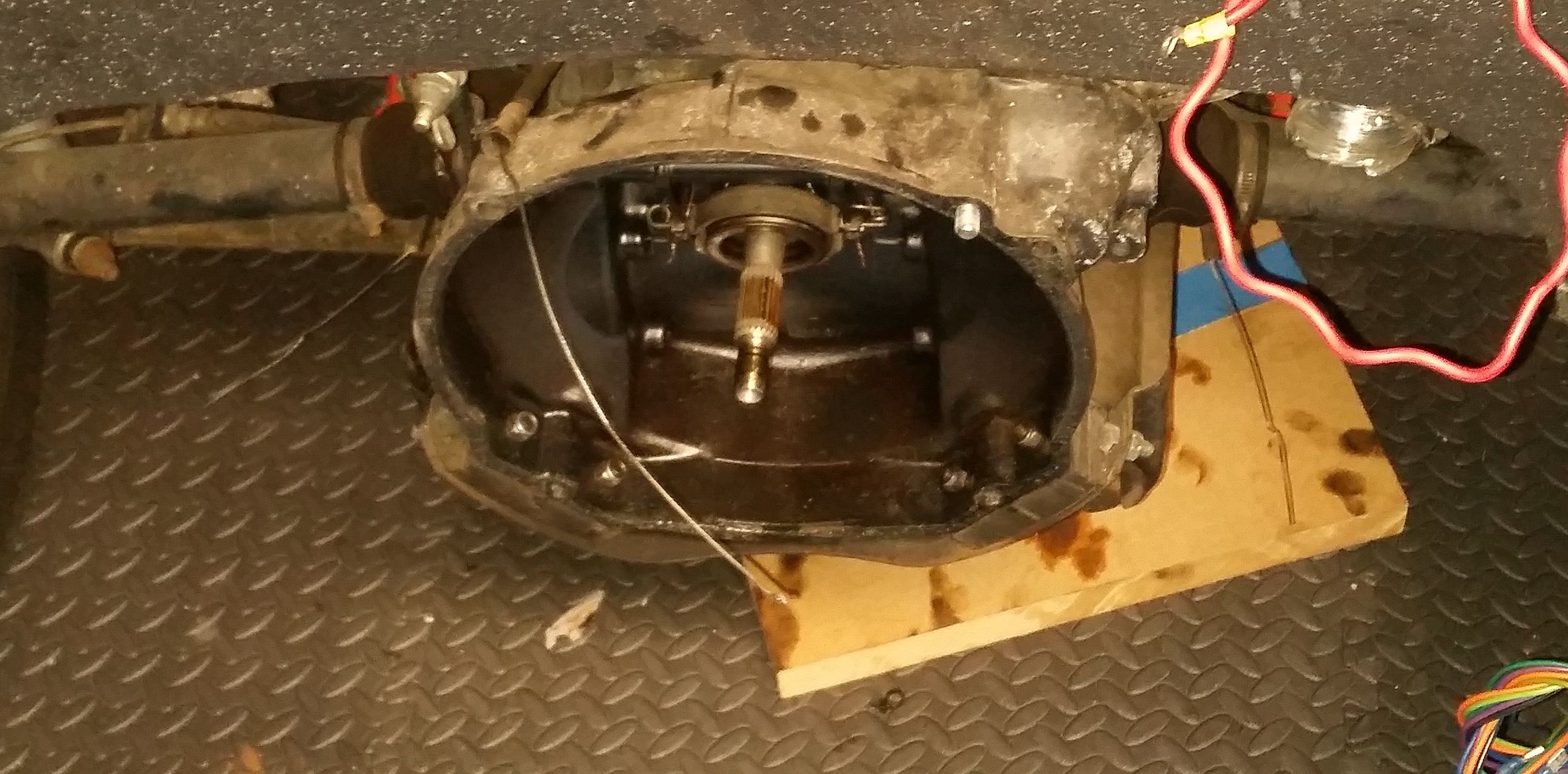

    The VW bearing you refer to should be the early one I think ? same as in the VW lump I have here so pre 1970
    Only image I have to show how close the VW bearing is in size, shape, attachment and actuating method.

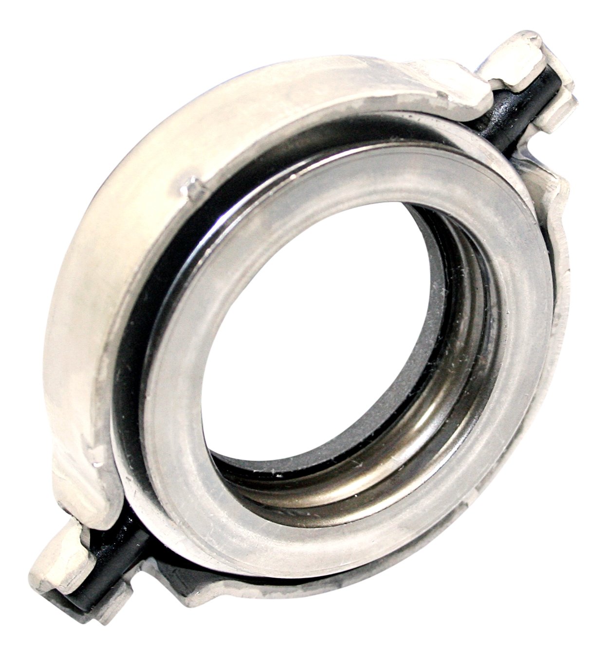

          Plastic insert where the wire clips fit in and plain steel face that touches the clutch cover pad.
          Again plastic, but has a graphite coating on the face that touches the clutch cover pad
          Better housing and clip arrangement. has a graphite coating on part that touches clutch cover This is a pressed steel housing and the one i prefer to use.EMPI
          Empi new manufactured item, not used one myself, but has a rounded part that touches the pad on clutch cover but metal to metal without a protective coating may be ok?
          There is another with a cast steel housing but cannot fit a picture of it. Depending on the type you have depends on how much you remove from imp clutch for, whether you have to drill holes deeper in bearing and whether you have to remove metal from bearing housing.
