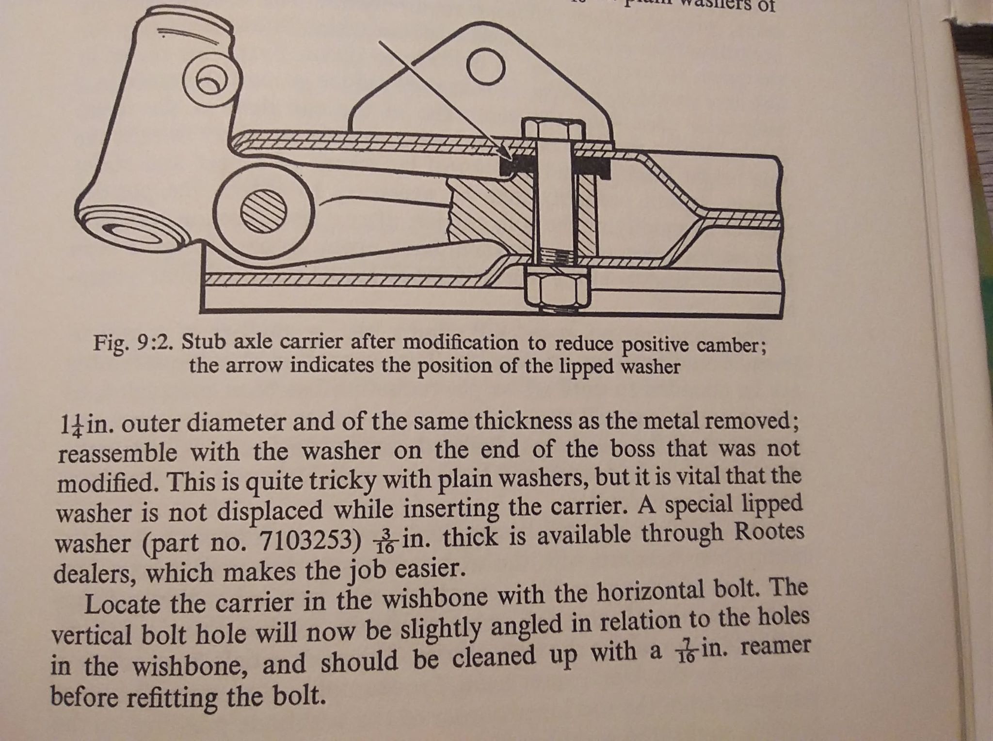

    Period Decamber Mods - Material removed from bottom face of stub axle and washer added to the top
    Click image for larger version  Name:	PIC-09608.jpg Views:	0 Size:	246.8 KB ID:	4338

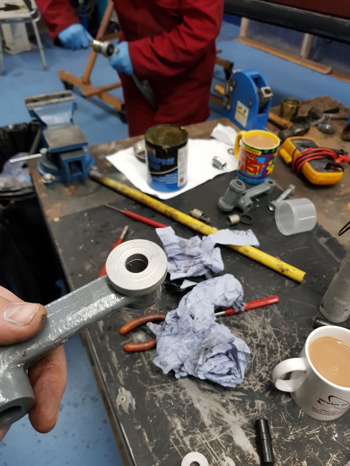

    About 1/8th removed off bottom where the vertical drop bolt for the stub axle assembly is fitted through I think was instruction
    The stub axle can then pivot on the horizontal bolt

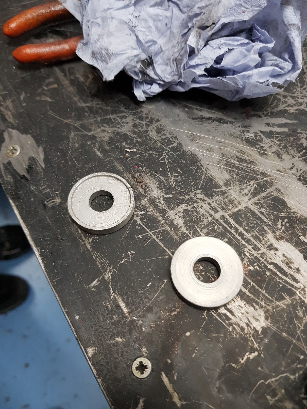

    Then to make up the gaps inside the wishbone a machined washer was used as a gap filler to prevent the wishbone being crushed when rumped up.
    The lip is only there to stop it slipping off when attached to the bone

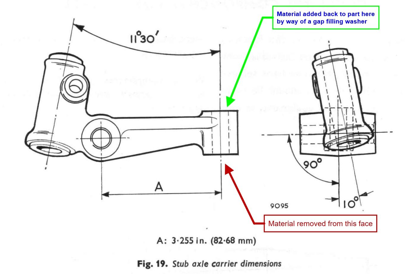

    In summary
    Click image for larger version  Name:	stub axle shim.jpg Views:	0 Size:	99.9 KB ID:	4339

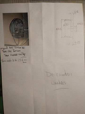

    Good point Bob. If there was a taper I did not notice.
    One from some literature showing the original Rootes part number from the washer and the other Peters own work keeping note of dimensions
    Two images courtesy of Peter nunney, cheers Peter
    Any likes being pressed should head in peters direction for these two
