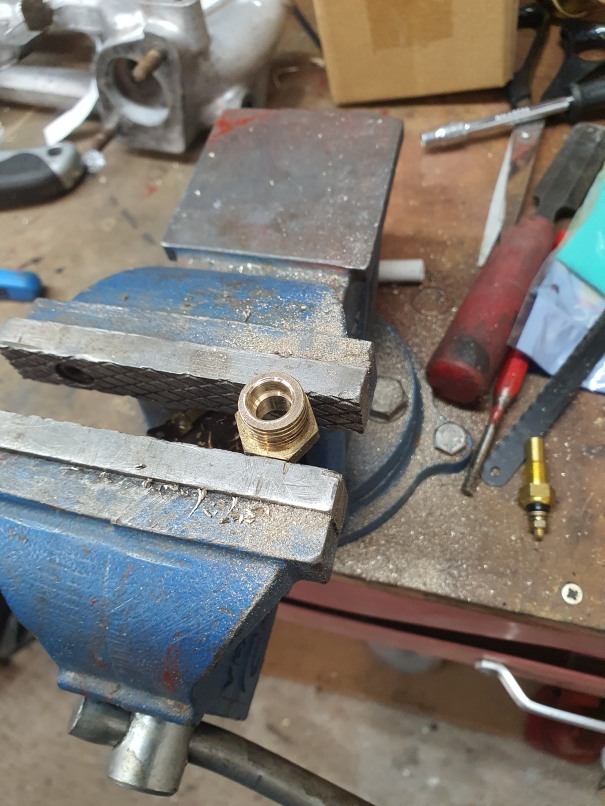

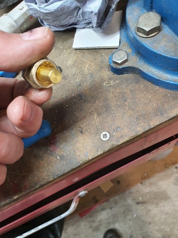

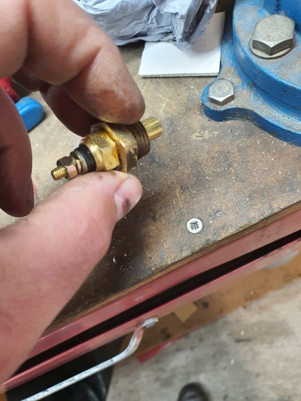

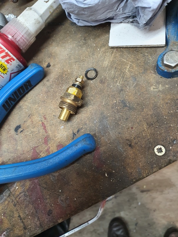

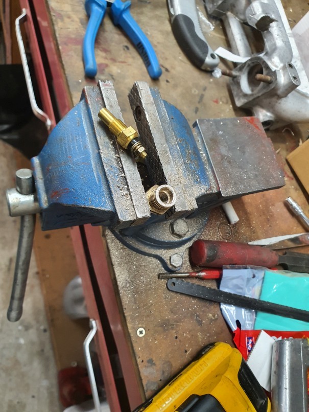

    So here I have took an old sender, cut off either end, drilled and tapped it for 1/8 thread (or can take 10mm metric) and use the old sender as the basisi for a reducer rather than finding one and waiting for it. We should all have a few old ones with the terminal lug loose right ??
    Easy enough job, some folks have asked me before why I taper and shorten the ends, answer is simple, I want the sender end in the fluid so it measures actual coolant rather than the temp of the block its threaded into, thats a fine line on an imp as a true temp sender would be on the hose rather than the block which is why a lot of people prefer capiliary guages
    Quick and a bit rough and ready however, deed is done. Need to drill the main oil gallery blank plug tomorrow, add oil pressure sender and thats 930 ready to get in
