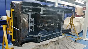

      Underbelly wise for seam sealer I did this George,
