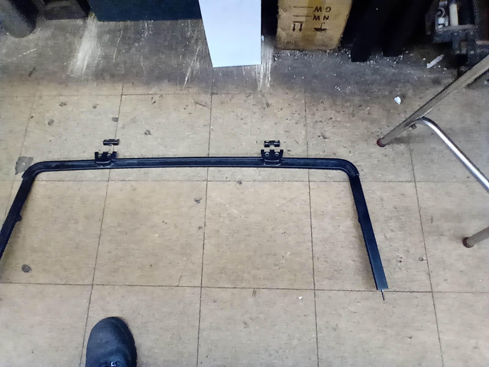

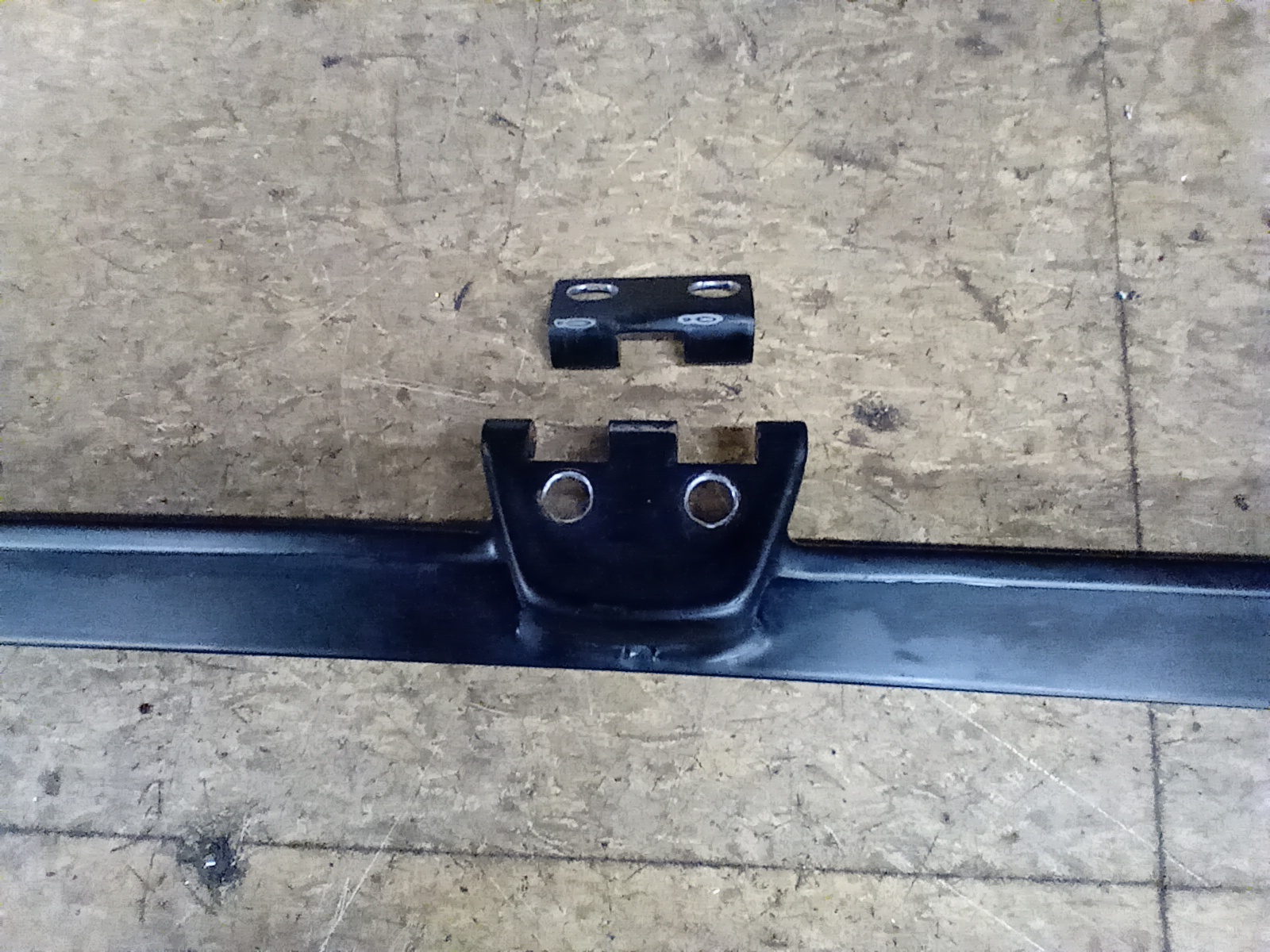

        Carried out your mod to hinge cover today Click image for larger version  Name:	IMG_20220211_083620735.jpg Size:	529.0 KB ID:	18137 Click image for larger version  Name:	IMG_20220211_083626067.jpg Size:	676.6 KB ID:	18138
        Using the grommets to cover holes
        Ordered some 3\16" dia brass and going to make new hinge pins but threaded on each end and use domed 5mm chrome nuts (bit different ) That way l can just remove rear window easier , not that l should have to?

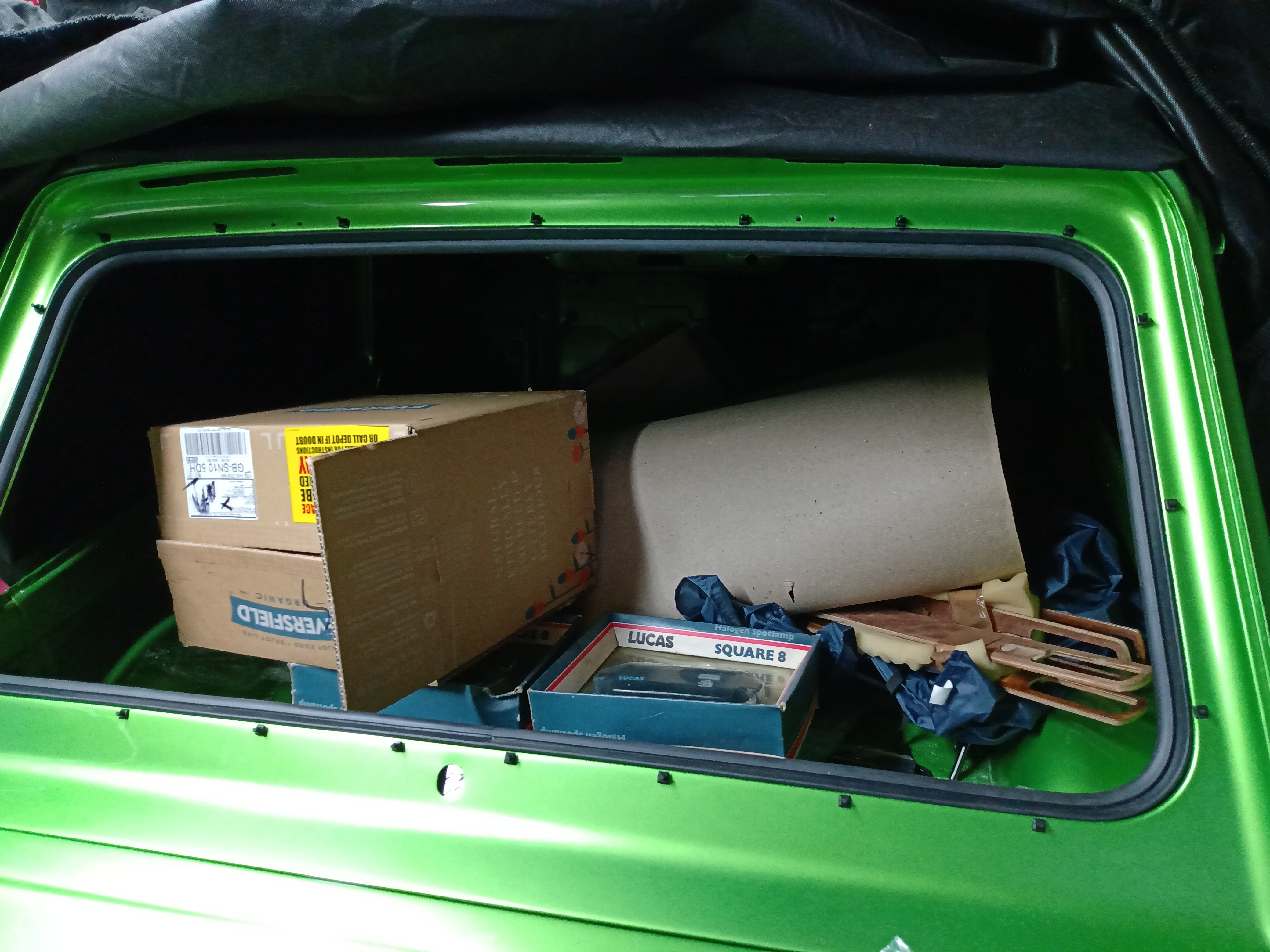

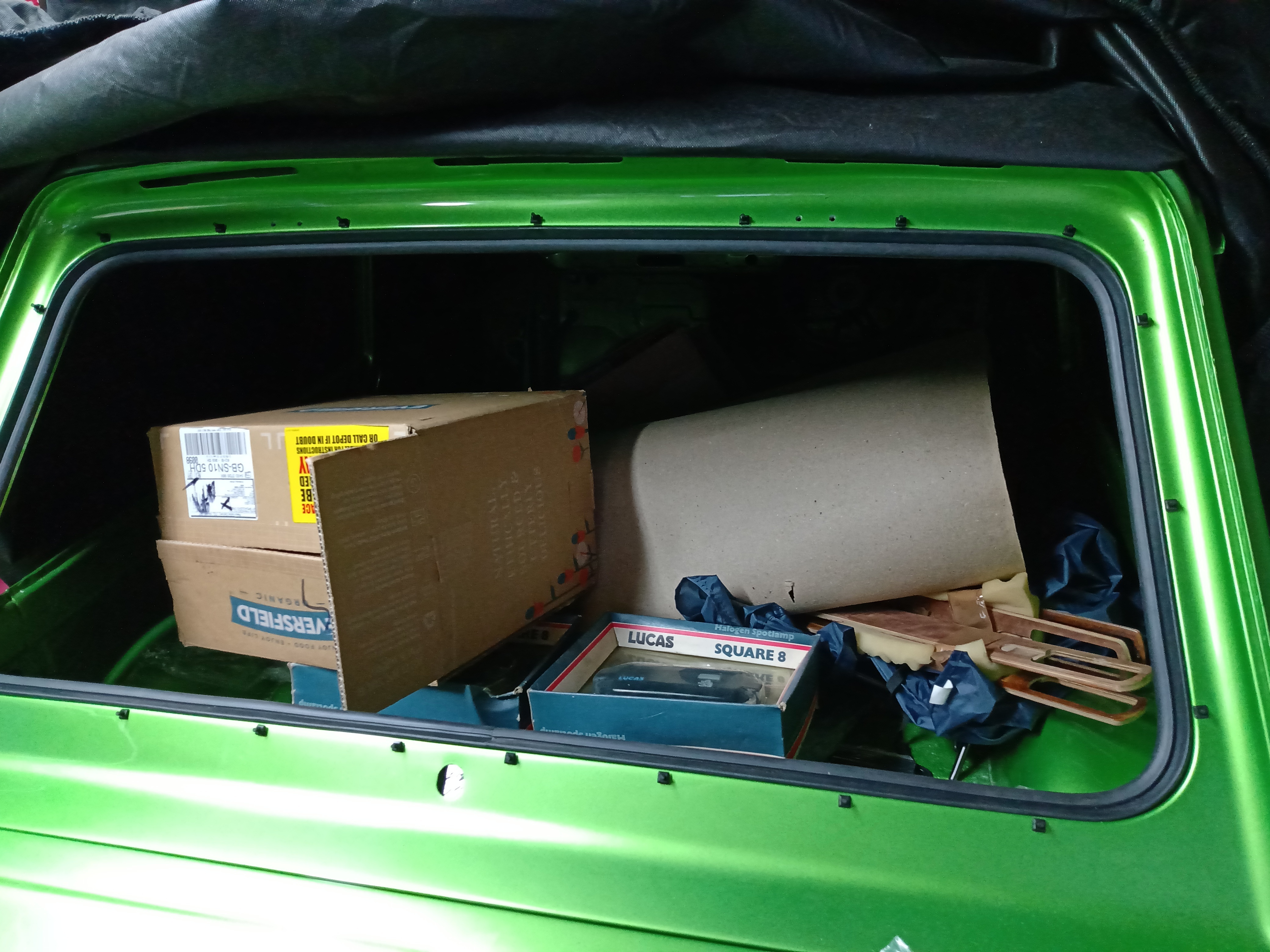

        rear hatch rubber in place, clips not so.

          #19
          I find the additional clear coat adds a fair bit of thickness to the paint making holes smaller and the centre "plug" which should spay the retaining portion cannot expand to allow the pin to pass through, pin breaks or you end up mashing the panel.
          The extra thickness also pushes the clip out further from the metal so the "neck" of the clip does not sit where it should.
          You can add anything up to 0.5mm if the panel has been skimmed/blocked or the primer/filler layer was thick then base/clear can add up to as much as 8 layers rather than the two from rootes
          Open up the holes with a small needle file and a bit of cavity wax before using clip.
          DDG is base/clear and I had same problem, I haad to take a small needle file
          Normally I use a 5mm deep 1/4 socket to tap the clip in flush, then a punch to drive the pin home.
