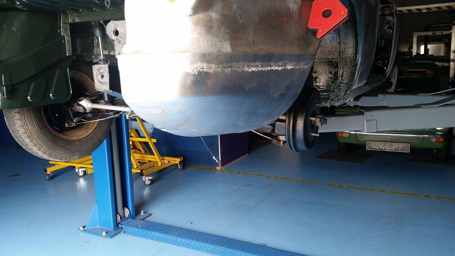

Body Panel - Suggested replacement panels for lower back of the rear wing
    L/H REAR CORNER REPAIR from Expresed Steel Panels

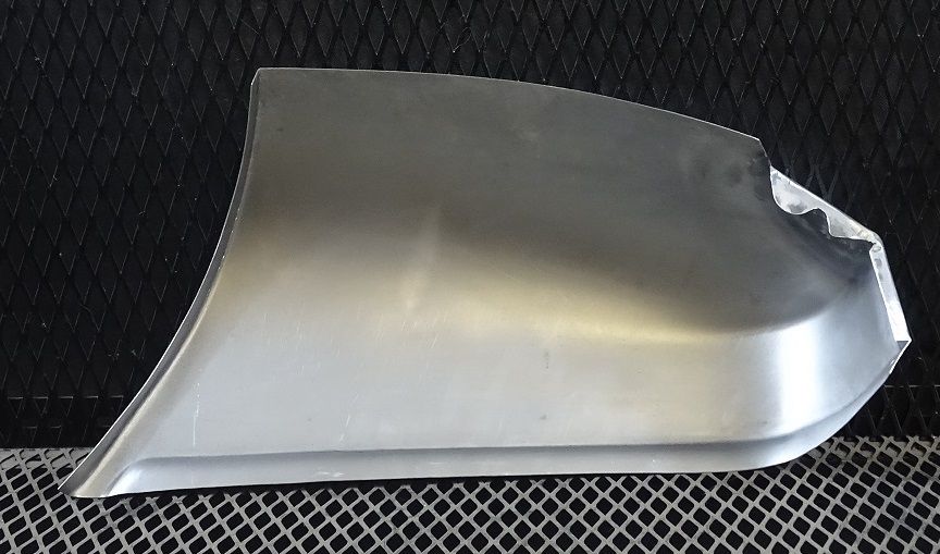

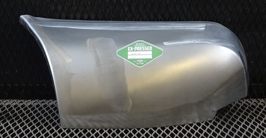

    IMP 10 and 11 are what you are after and this is what they look like (IMP10 shown)
    Click image for larger version  Name:	IMP10.jpg Views:	0 Size:	60.2 KB ID:	4896
    This time we are looking at the bottom rear lower corner, a notorious imp "rot spot". After trying to use many different suppliers and made numerous versions myself these panels from Expressed Steel are consistent in form and shape as well as being a great fit.
    They also come with a lot of excess material such as the pressed swage line above that area, it is users choice to fit or not the full panel or only what is needed.

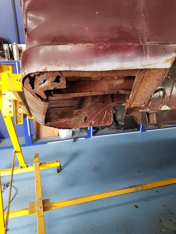

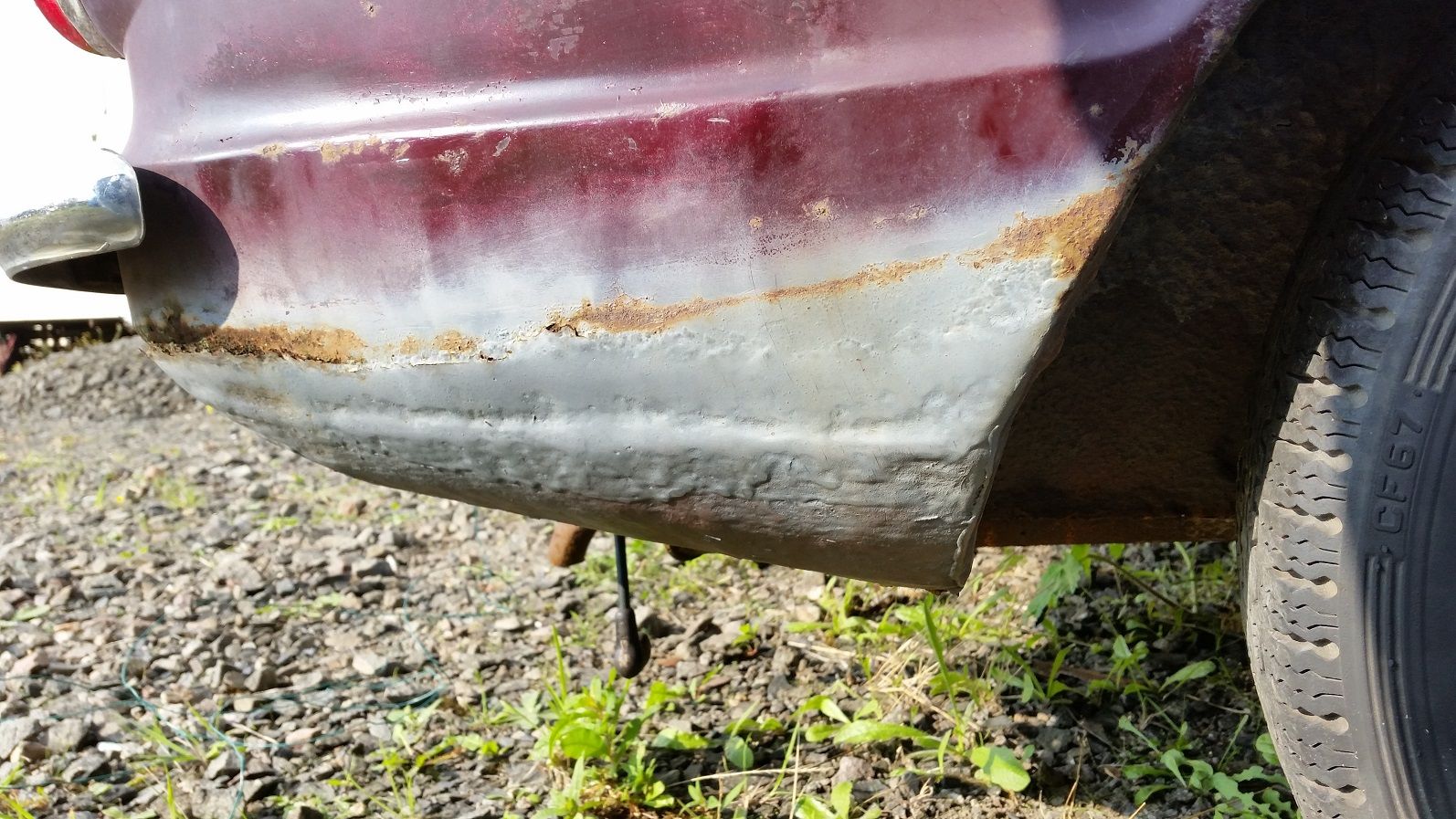

    The last ones I went to fit I ended up fitting a complete lower rear wing but here is what can be hiding under that area
    And with the crap removed, complete disaster, inner section totally toast, bunged up with filler and fiberglass.
