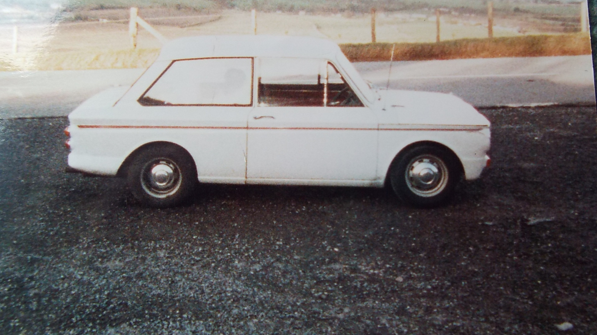

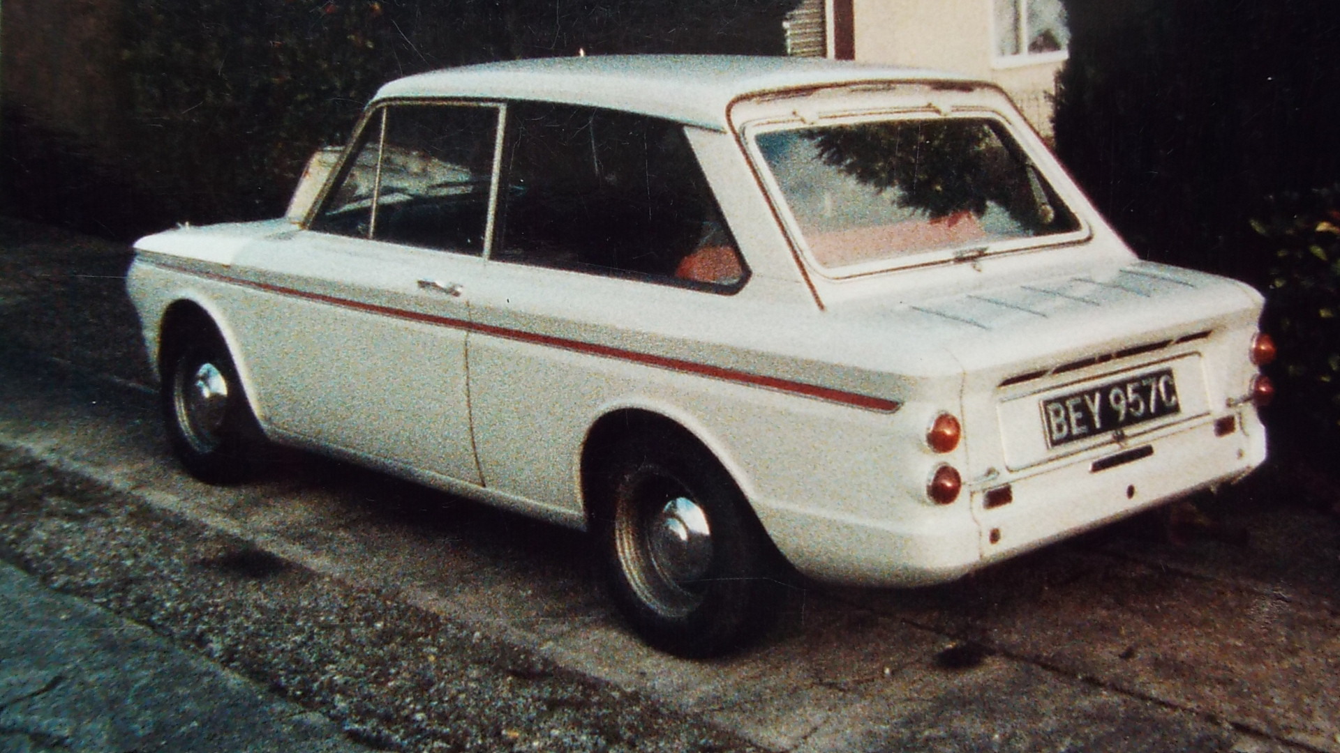

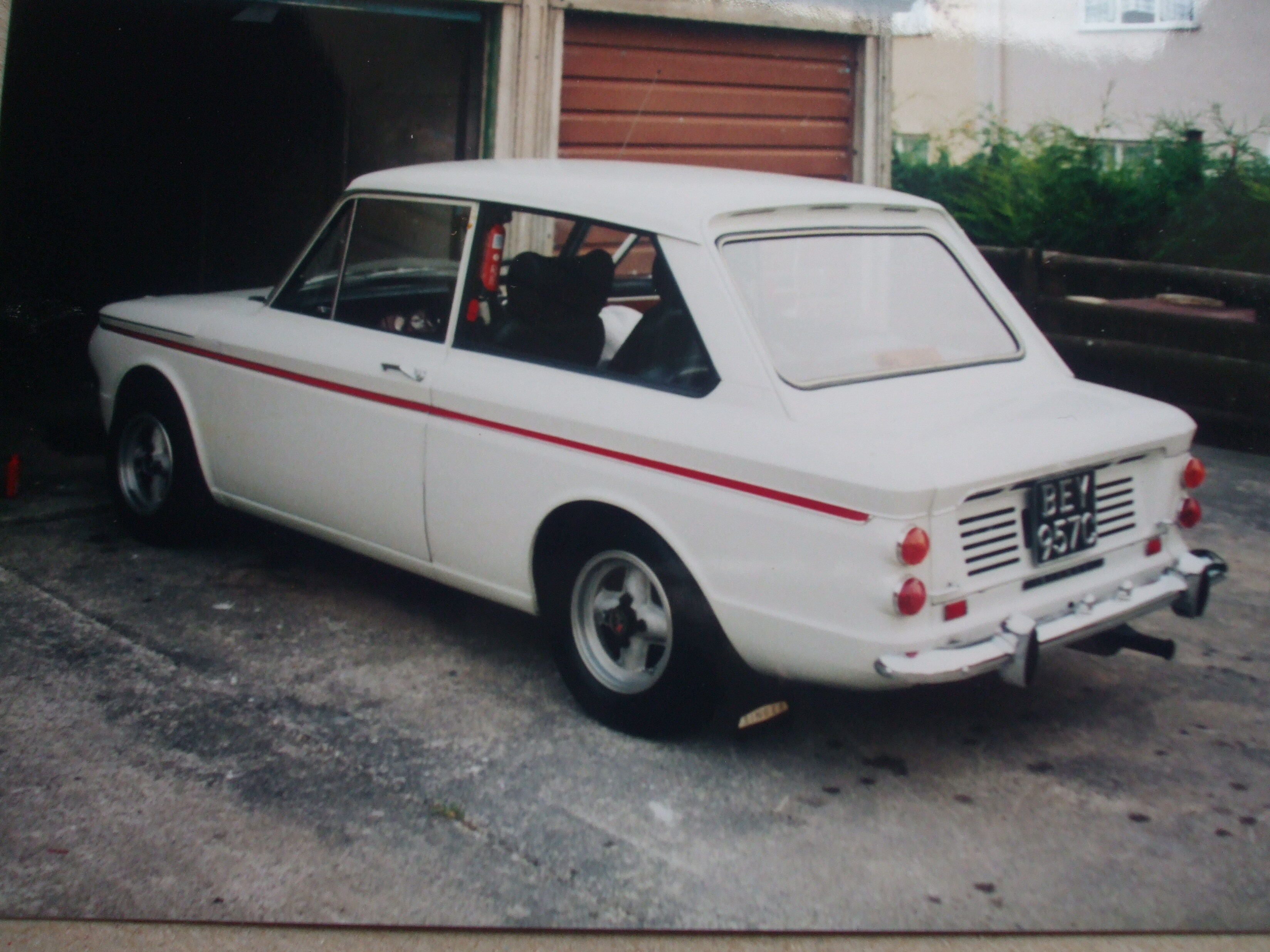

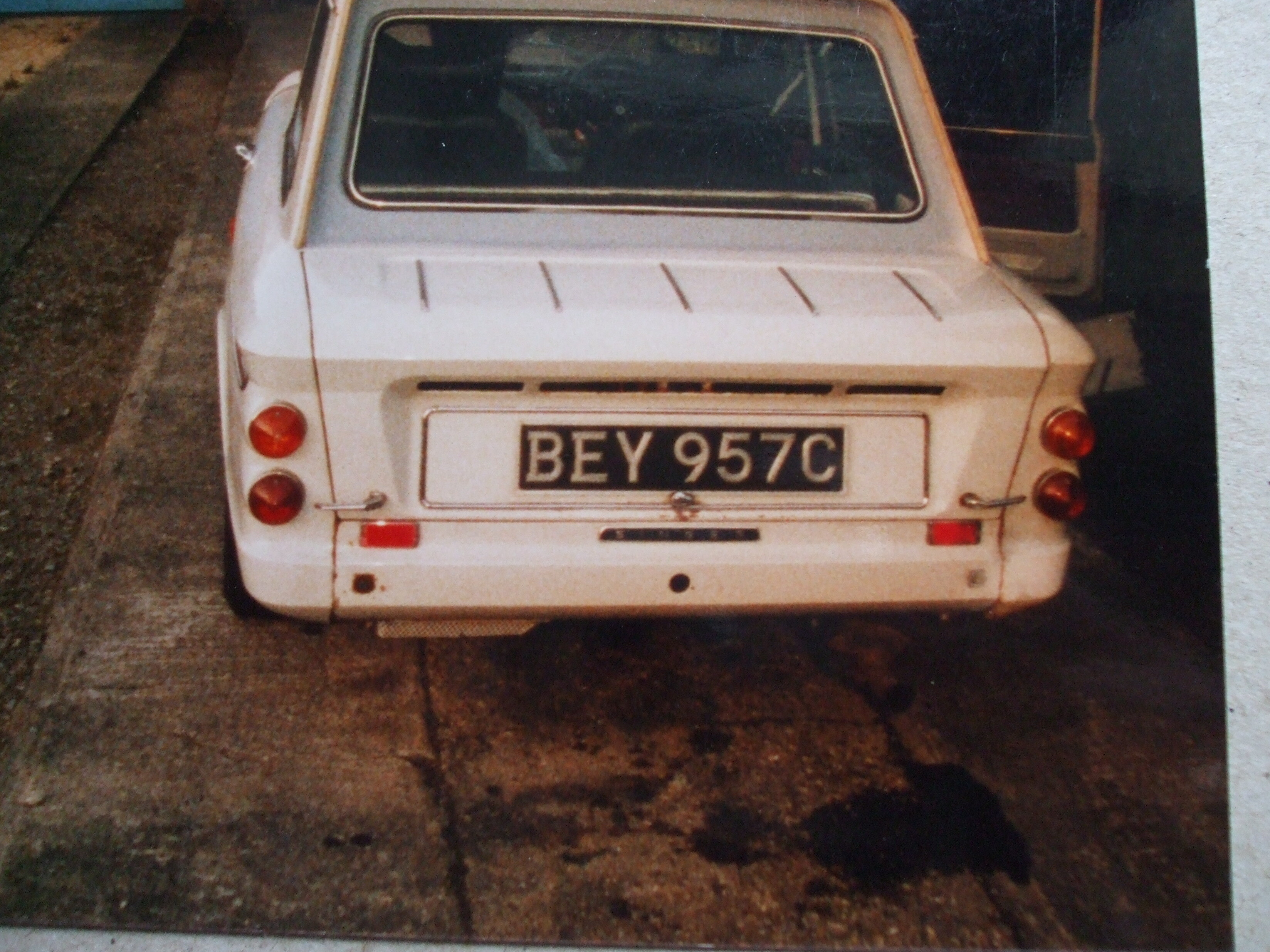

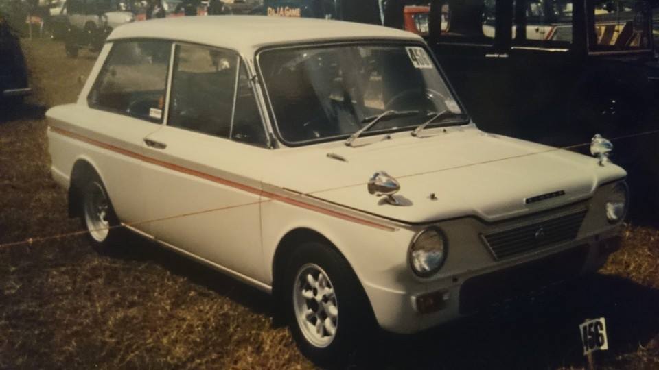

      Heres a few pics from when id just got it .
      Colour is Foam grey with a tartan red stripe ( and that pink interior )
      Click image for larger version  Name:	DSCF2328.JPG Views:	0 Size:	501.6 KB ID:	8638Click image for larger version  Name:	DSCF2109.JPG Views:	0 Size:	1.42 MB ID:	8639Click image for larger version  Name:	DSCF2329.JPG Views:	0 Size:	486.5 KB ID:	8640

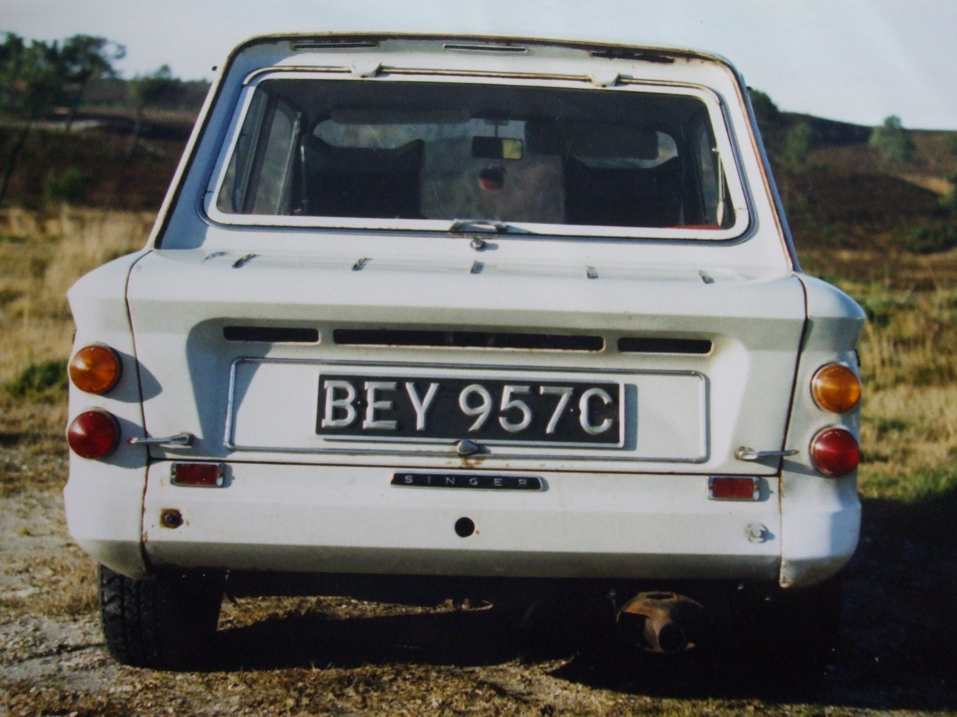

        So for the first few years i basically pissed about with it .
        Rear window leaked like a broken teabag so that went . I messed about with engine lid venting and " styling " and generally just drove it.

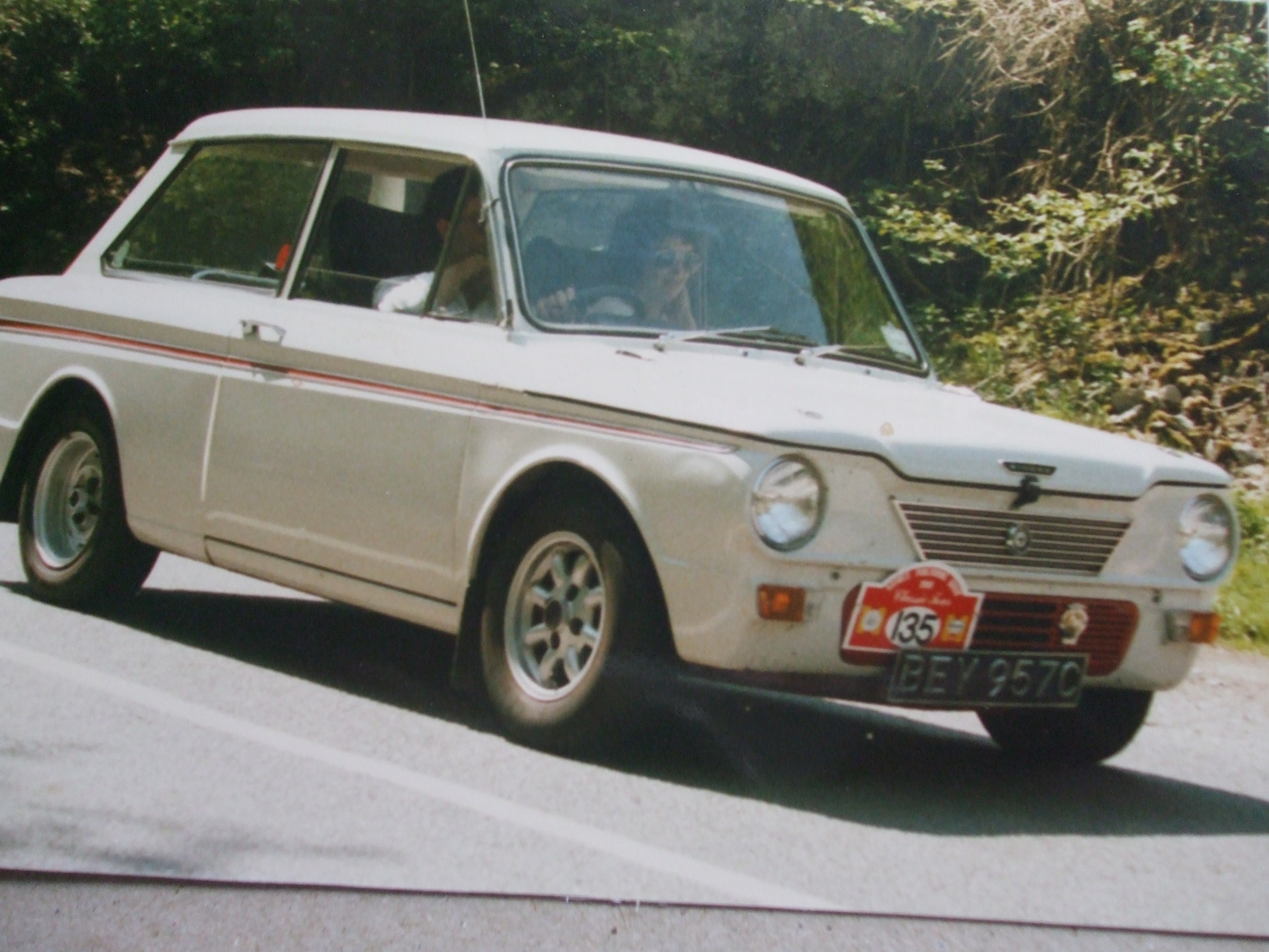

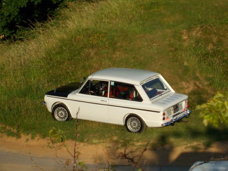

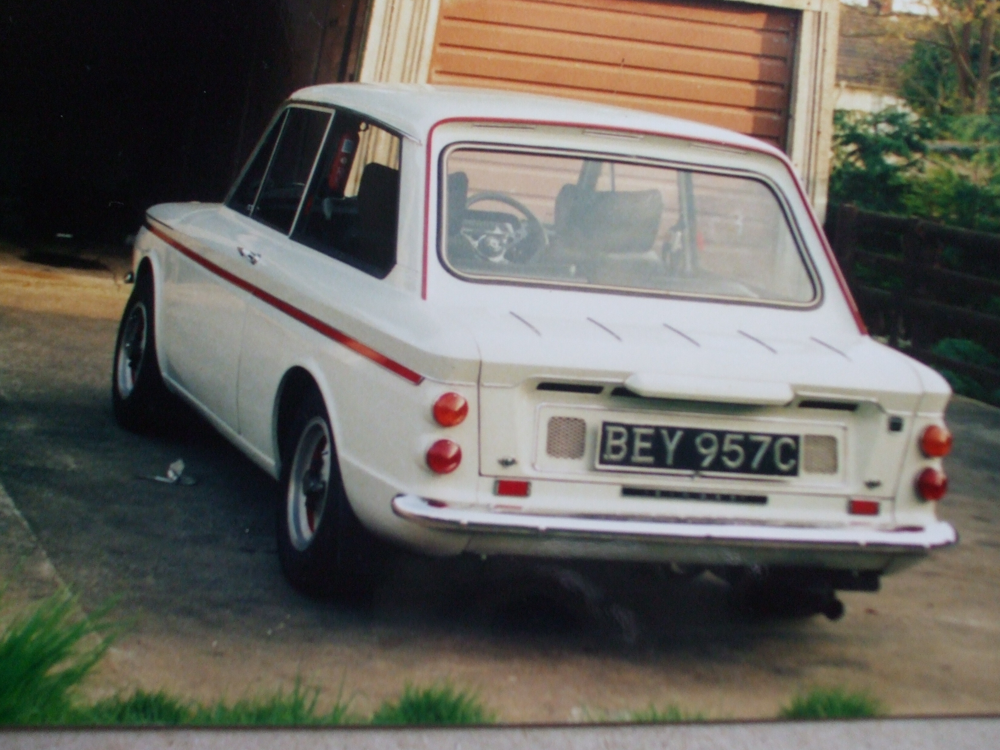

          In 94 things moved on a tad , managed to get a sport engine lid and some bumpers at last , also managed to get a set of chamois sport rear wing top trim , i wanted a Chammy sport but never managed to find one so figured id make my own version of one

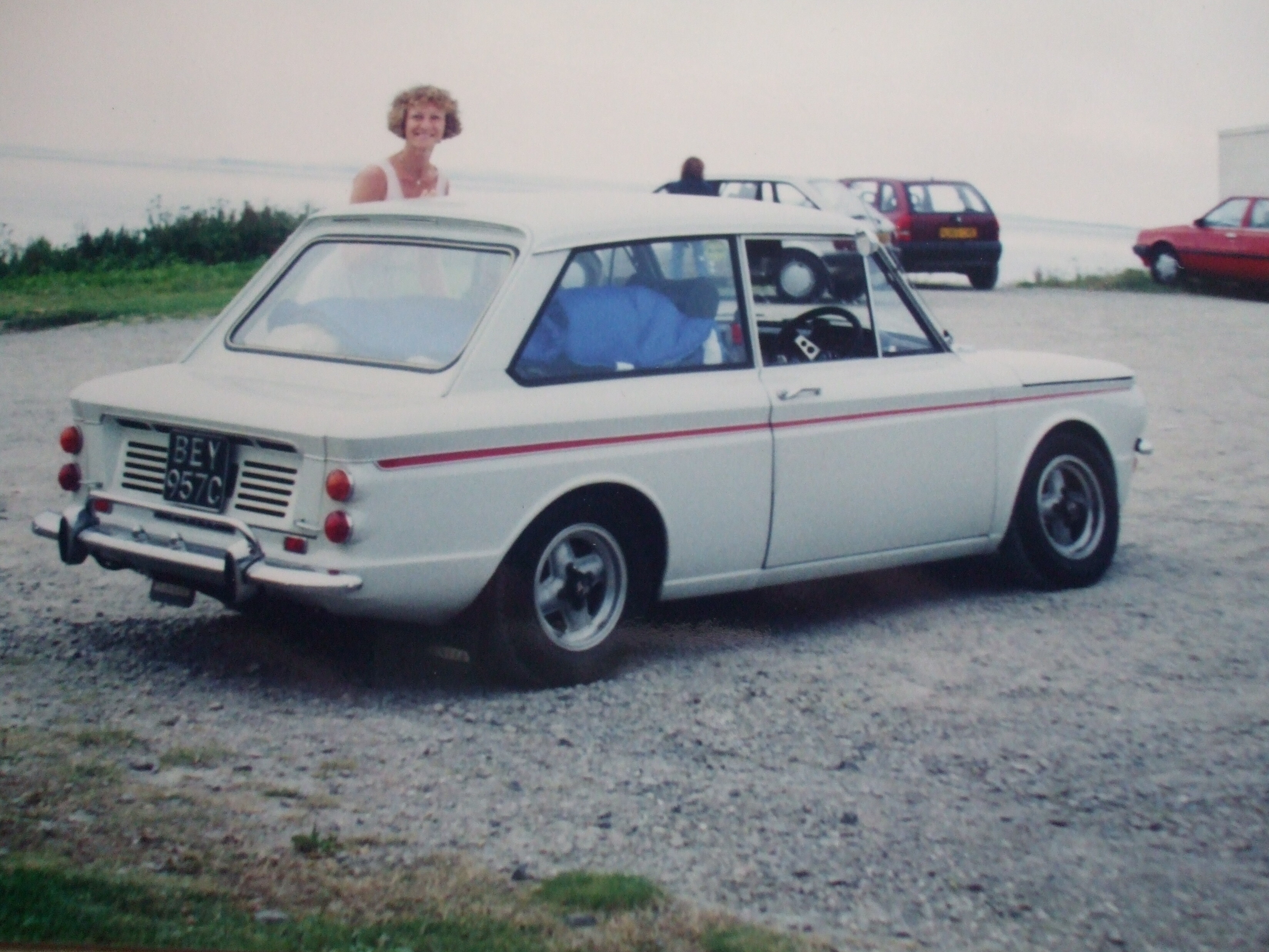

          Then a year later i got a US spec rear bumper and drove it to John O Groats for a £50 bet - cost me treble that in fuel but it was fun

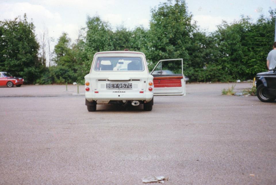

                Then the 998 died - a month before the national at Weston super mare , I knew it was fairly terminal as there was antifreeze pouring out the exhaust , turned out a liner had cracked and a chunk fell out
                A plan was hatched to kill the Vusky by stealing its running gear and other bits ,sort out the Singer then sell or scrap the Vusky .
                However as luck would have it ( for the Vusky ) a mate told me of an Imp in a local breakers with the front end caved in
                So i figured it had to be running when it hit something so go and get that . Vusky now saved from death was pulled into service and the engine was hoofed out the scrapper and bought home ,
                Three days before national i started and the day before it was in and running , it had been in the yard 2 years so i was crossing my pinkies .
                Anyway next morning i blasted it up the M5 to Weston , never changed a thing , same oil , water pump , carb and headgasket .
                Guess what ------
                It ran fine

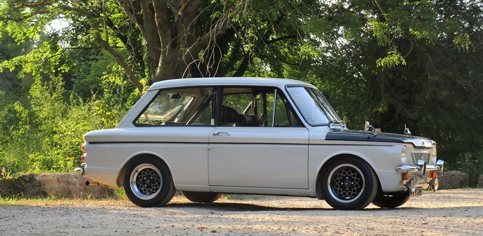

                Sometime later I acquired yet another Caledonian for breaking - sad to say i hunted these down on purpose - best engines and boxes and at the time available for pennies . I ran the scrapyard engine for a few years but it got smoky and tired so rebuilt the L4 from the Caledonian and fitted this

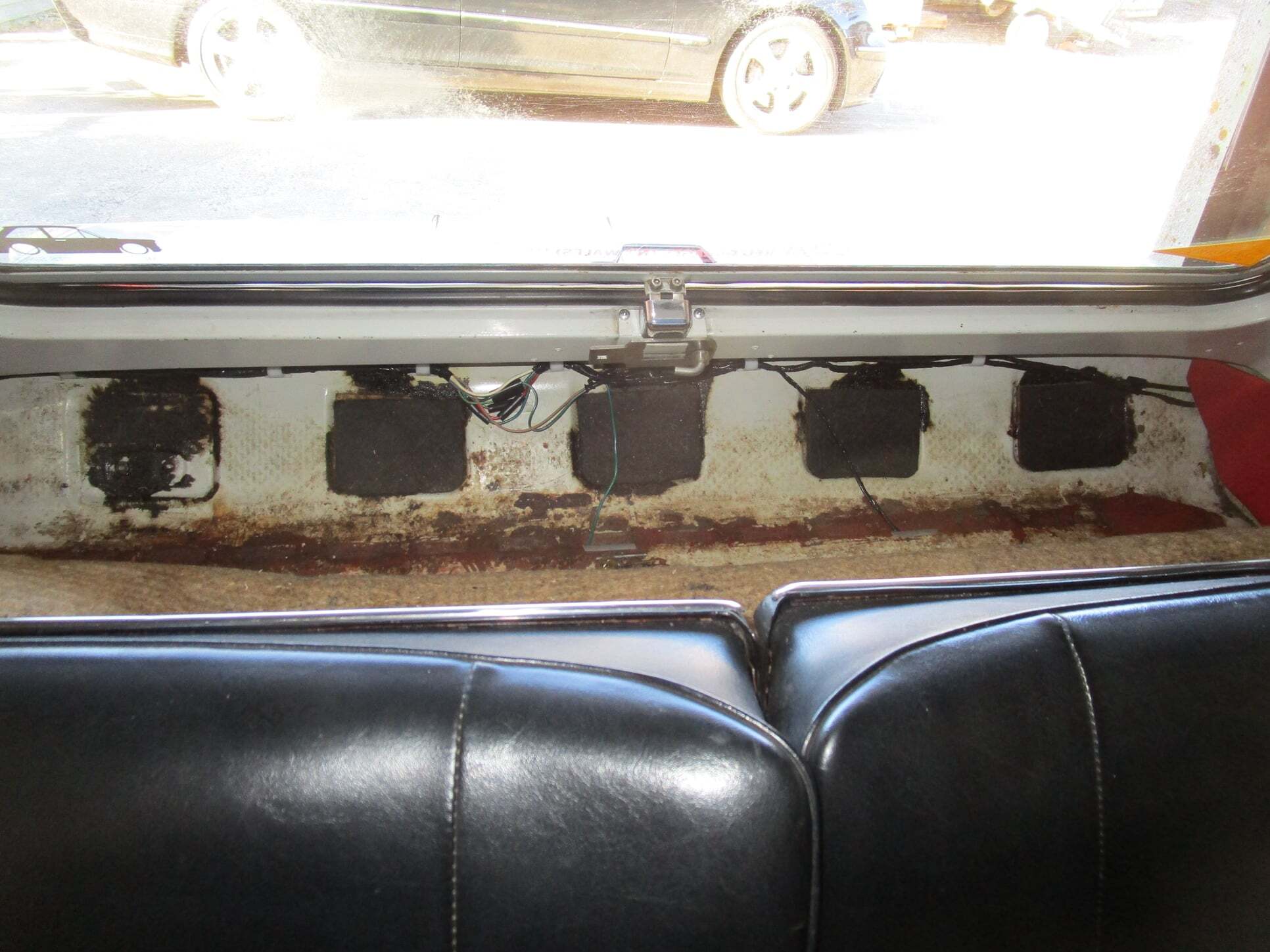

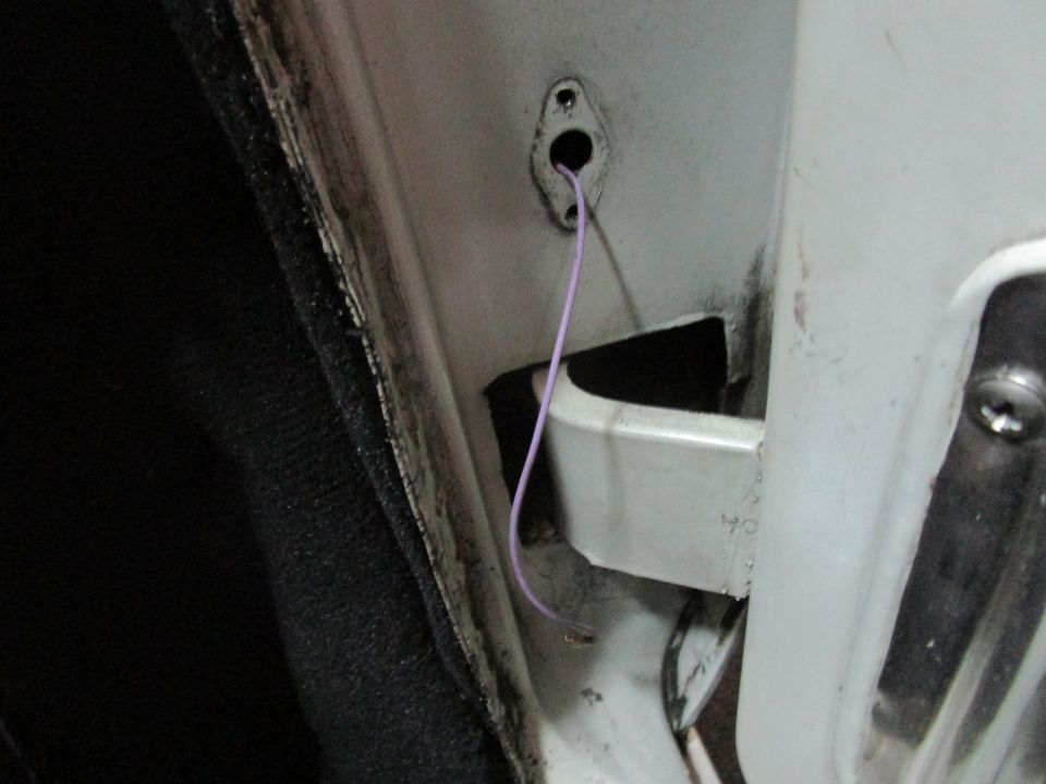

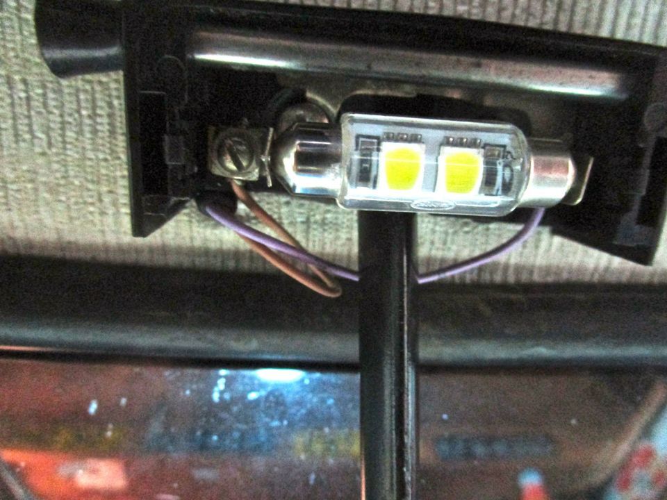

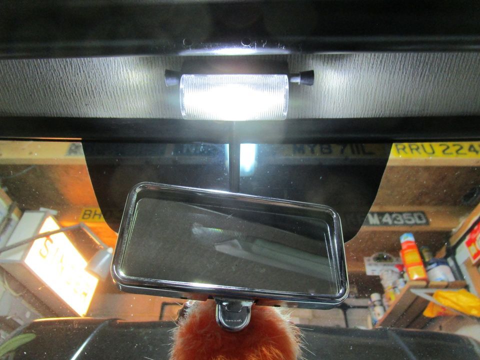

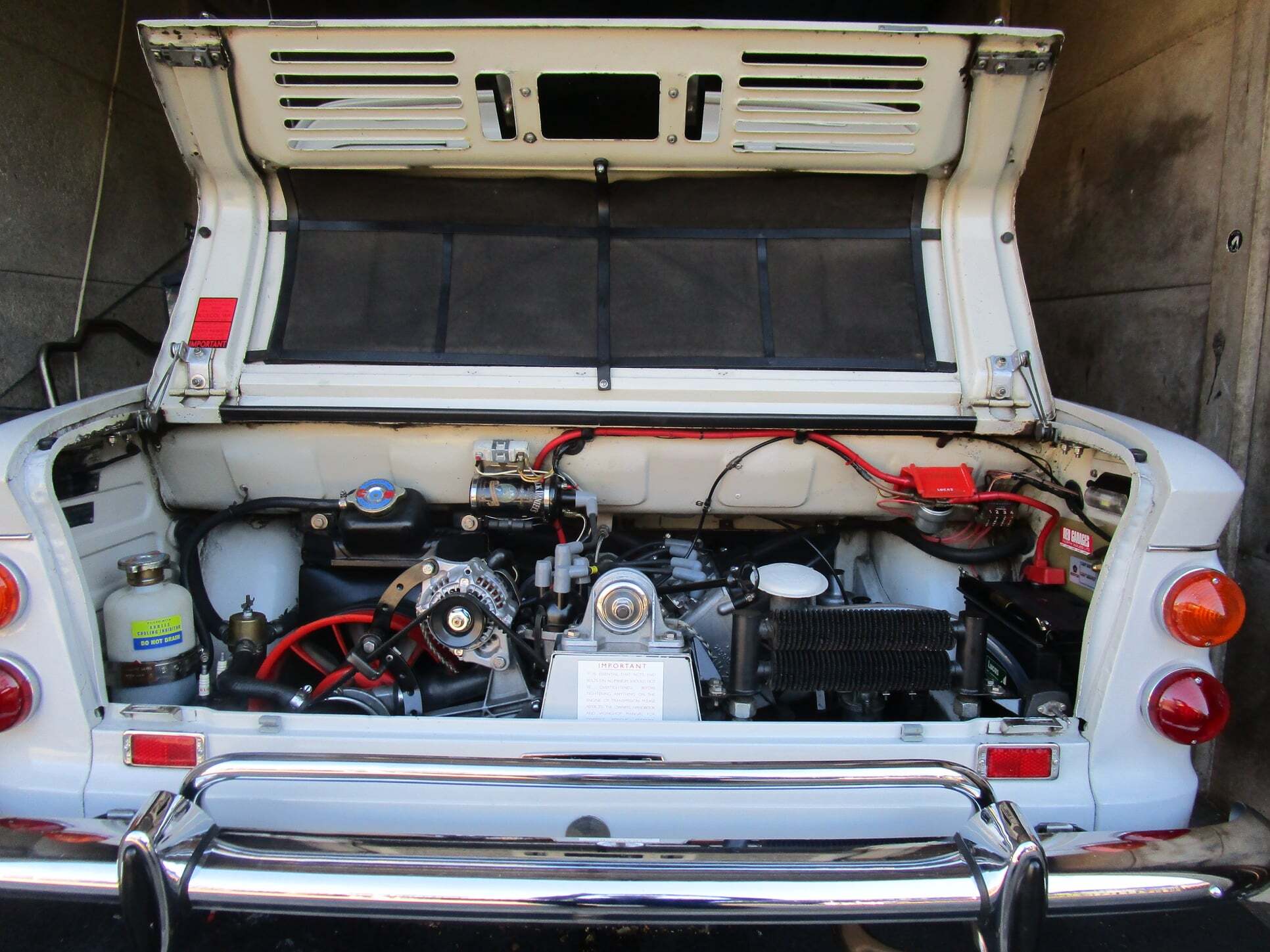

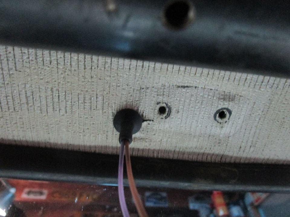

                        Rewired the entire interior light circuit on the Singer these last few evenings.
                        Many of you might recall the dash catching fire many years ago . I did rewire 90% of it but a few bits were just repaired - one being the interior light circuit .
                        On this I had to splice wire in to get it working and as such it had more joints that it should have .
                        Anyway ive replaced the lot , both door switch wires and main feed to the light , all joints are now in the boot rather than under the dash rammed in the corner of the drivers side parcel shelf .
                        All done with special Radox 155 0.25 wire that somehow will carry 13A ? , I Used the same colours as factory although the purple doesnt have the white stripe ,
                        Boot light ( also rewired ) and the interior light now also have a dash mounted on / off switch so they only come on when i choose - ie. when its dark

                        All connections for the interior light are now the two double bullet connections , easier to get at than being rammed in the corner of the parcel shelf

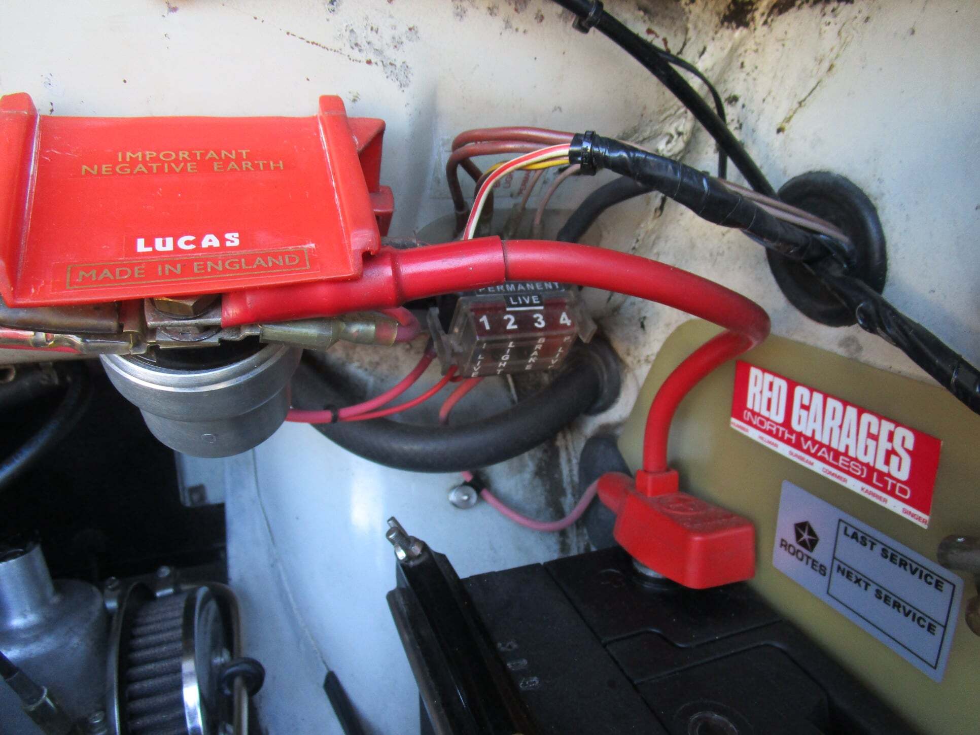

                          Finished rewiring the Singers brake light main supply to the ( now ) correct colour .
                          Just to reiterate Most Imps except the Stiletto had ignition fed brake lights - well they were actually wired from the coil meaning supply wire was white .
                          Because things have been added over the decades the coil positive was looking a tad full , There was live in , rev counter , alternator signal wire and of course the brake lights - its why i rewired the lights to permanent live .

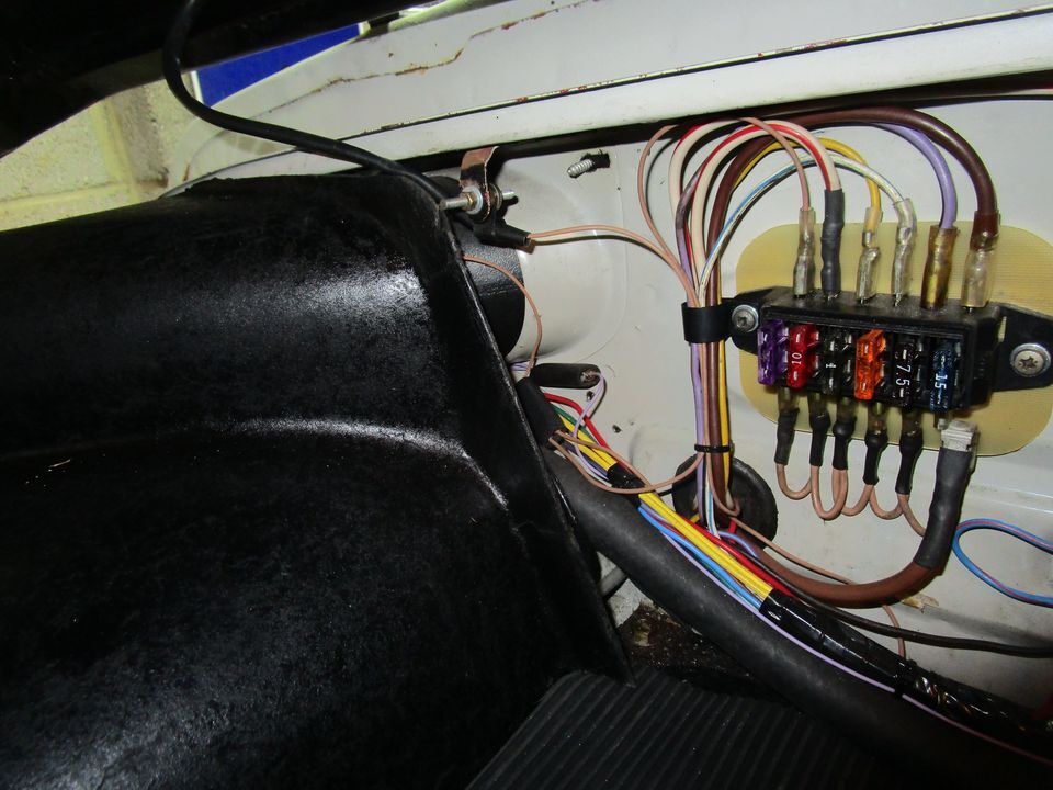

                          Wires now brown at last . When i rewired it after the fire I moved a lot of the engine bay wiring tother side of the rear bulkhead to tidy up the engine bay
                          Red live in , brown live out - even i cant feek this up
                          Less wiring in the engine bay
                          Coz a lot of its now here instead

                            It makes ahuge difference and tidy up the engine bay nicely I think.. I did that on Jims Chammy and after seeing the difference decided to do DDG like that including the starter wire.
                            Nice work again Mr Dave

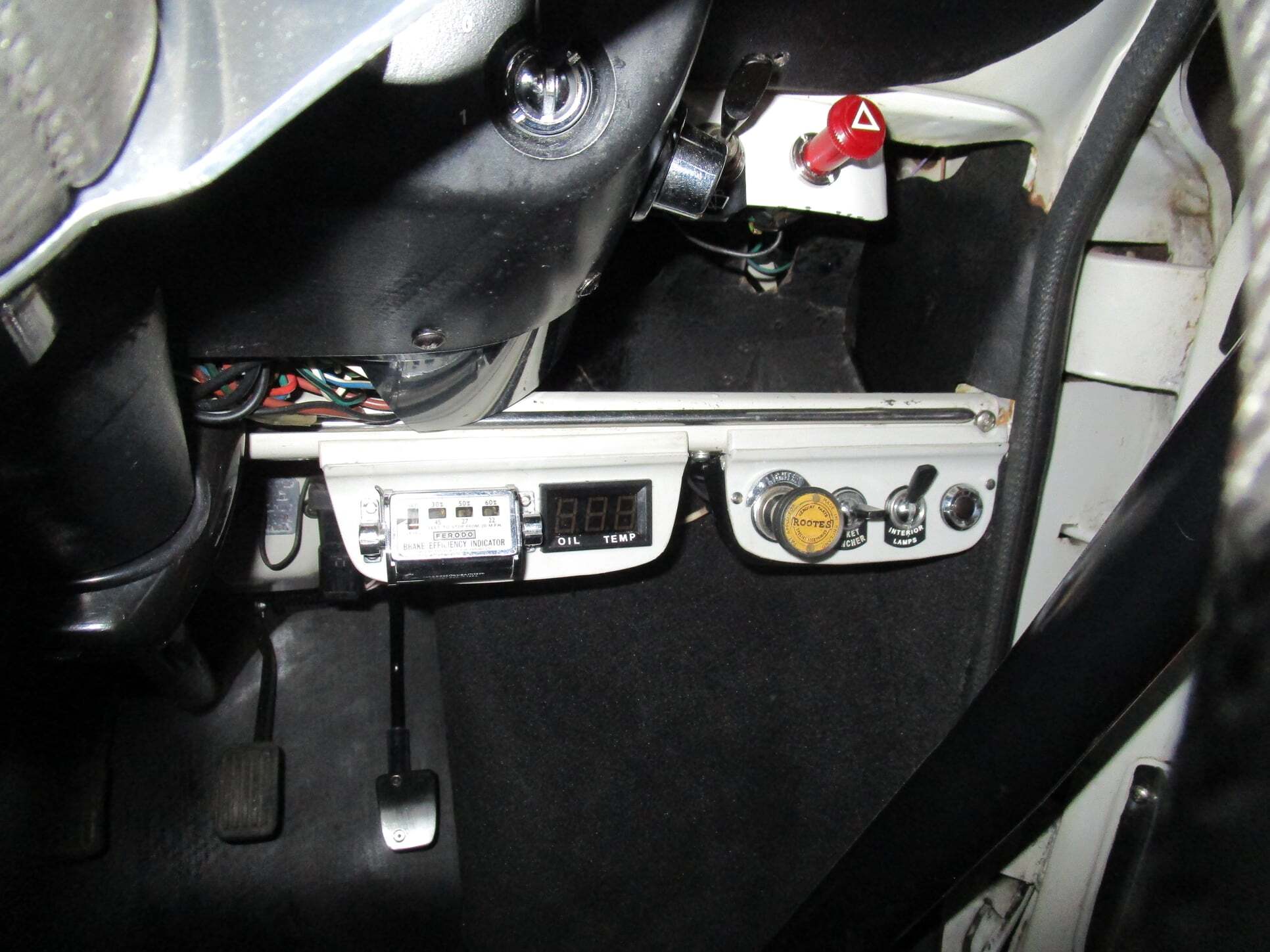

                              Made a matching mount for the oil temp gauge so it matches tother one exactly - much better
