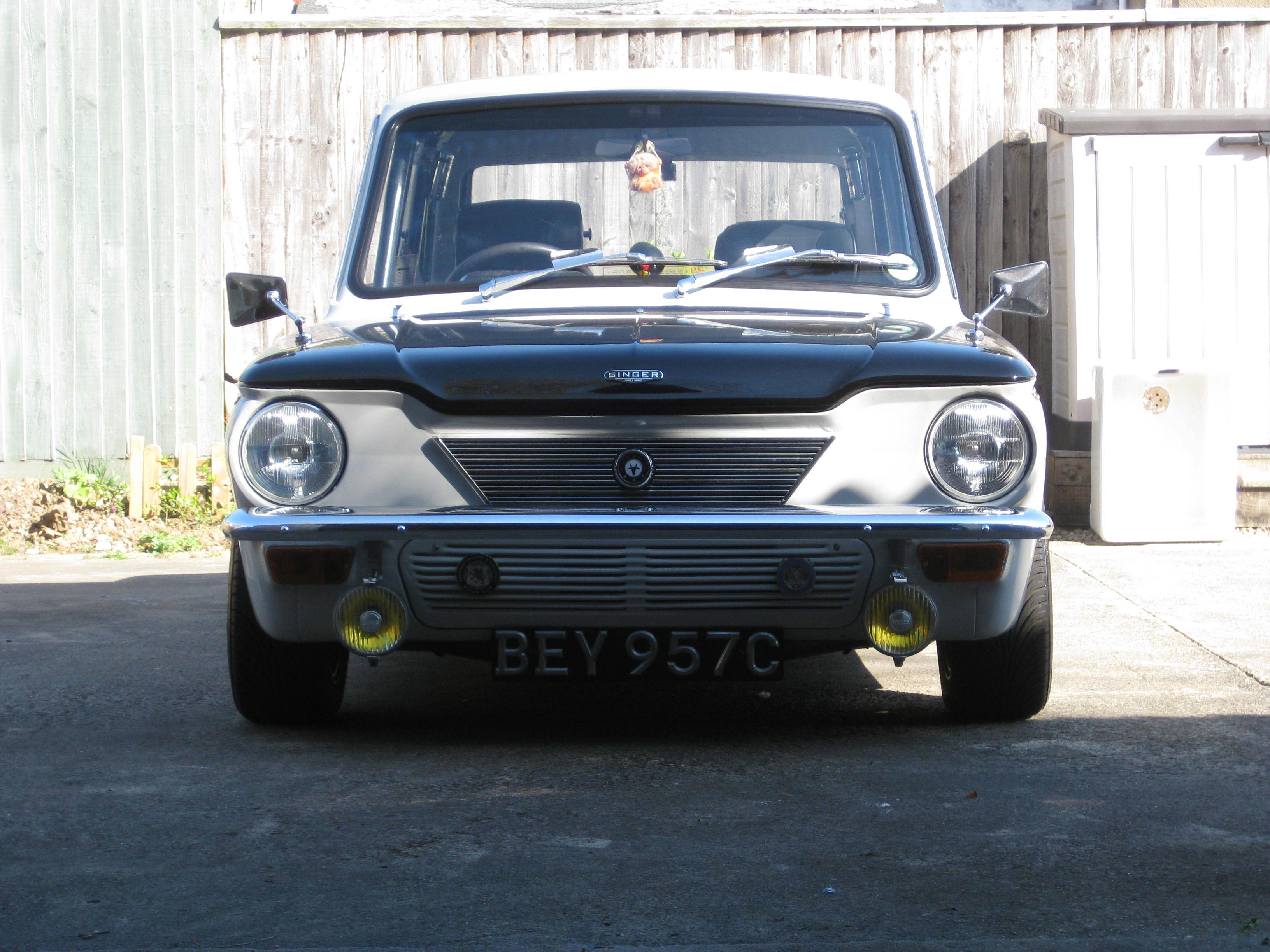

    Styling exercise
    Bumper over riders deleted

      #152
      With for me Dave, although I cheat by using them to hide the spot brackets

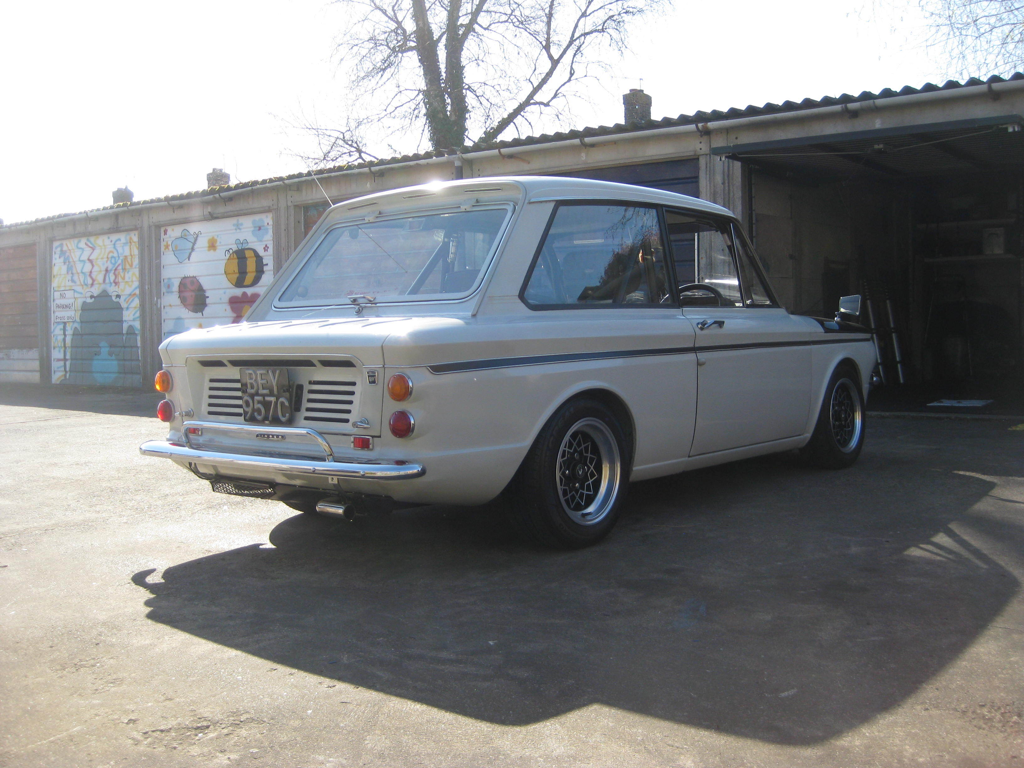

        OOT in the sunshine , Gettin used to the sans over rider look
        Click image for larger version  Name:	IMG_0188.jpg Size:	1.49 MB ID:	18875
          #154
          Damn good day for it Dave, weather was indeed nice, managed outside today as well but only few miles down road to mums and back.

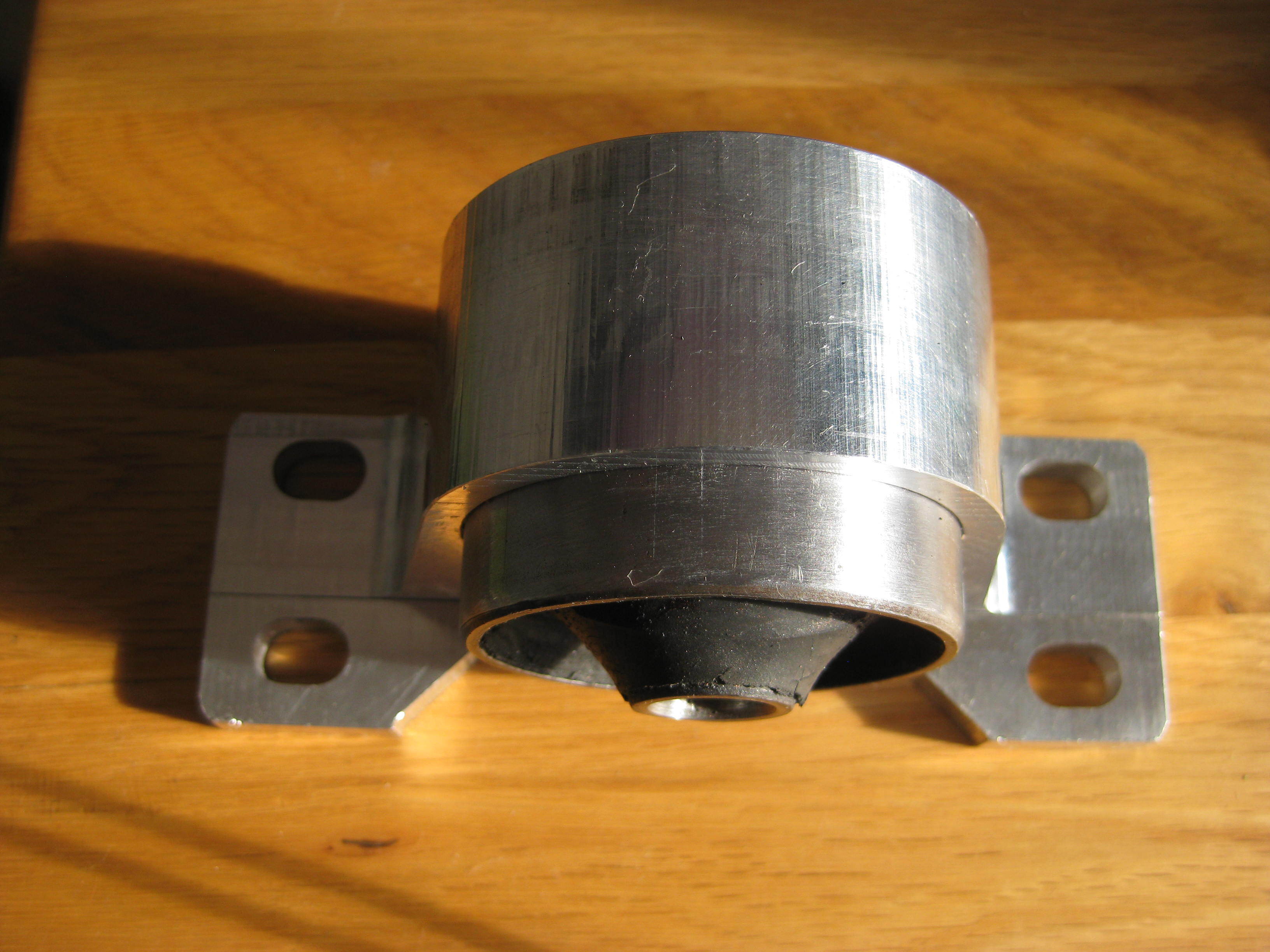

                      #160

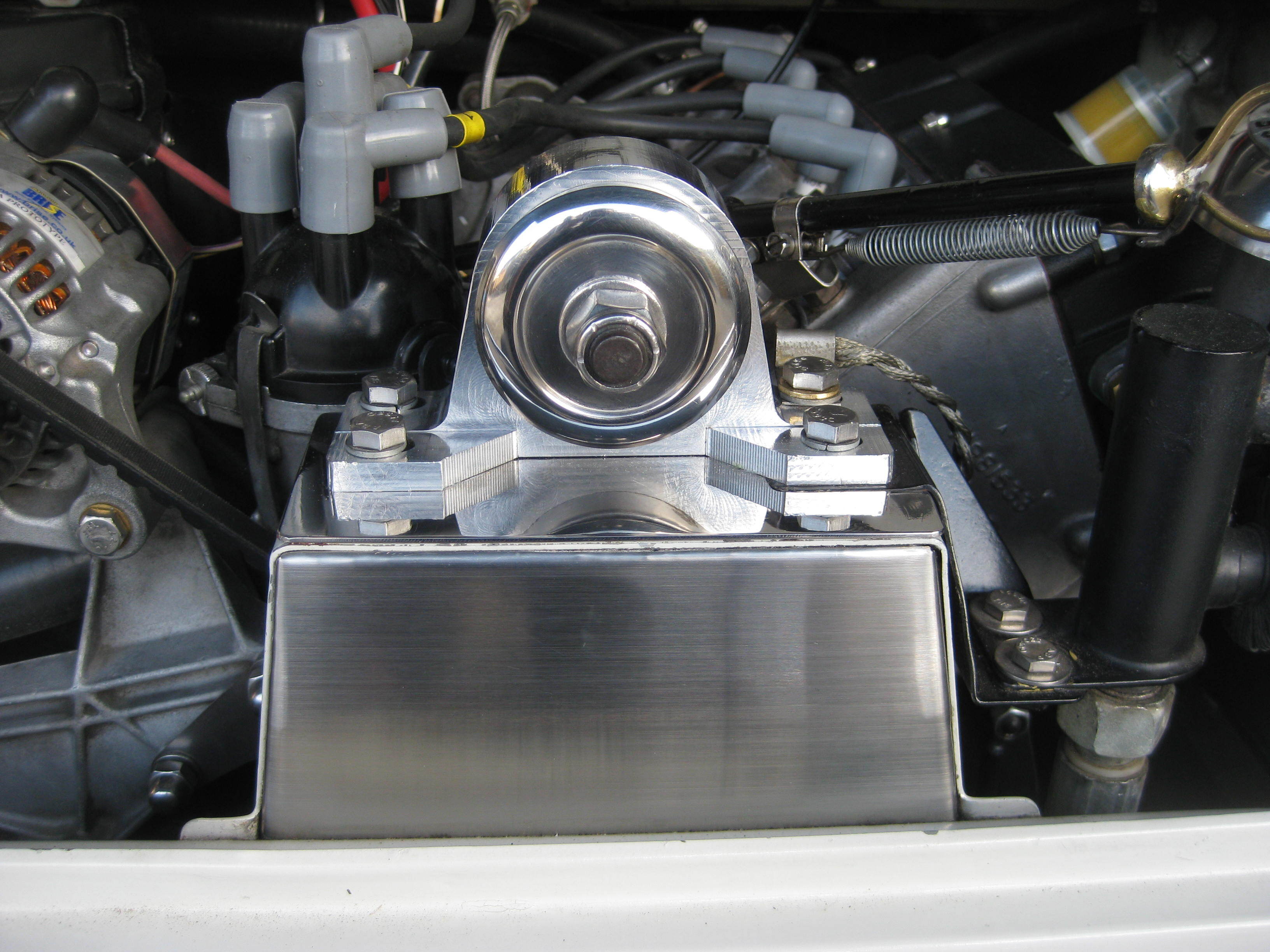

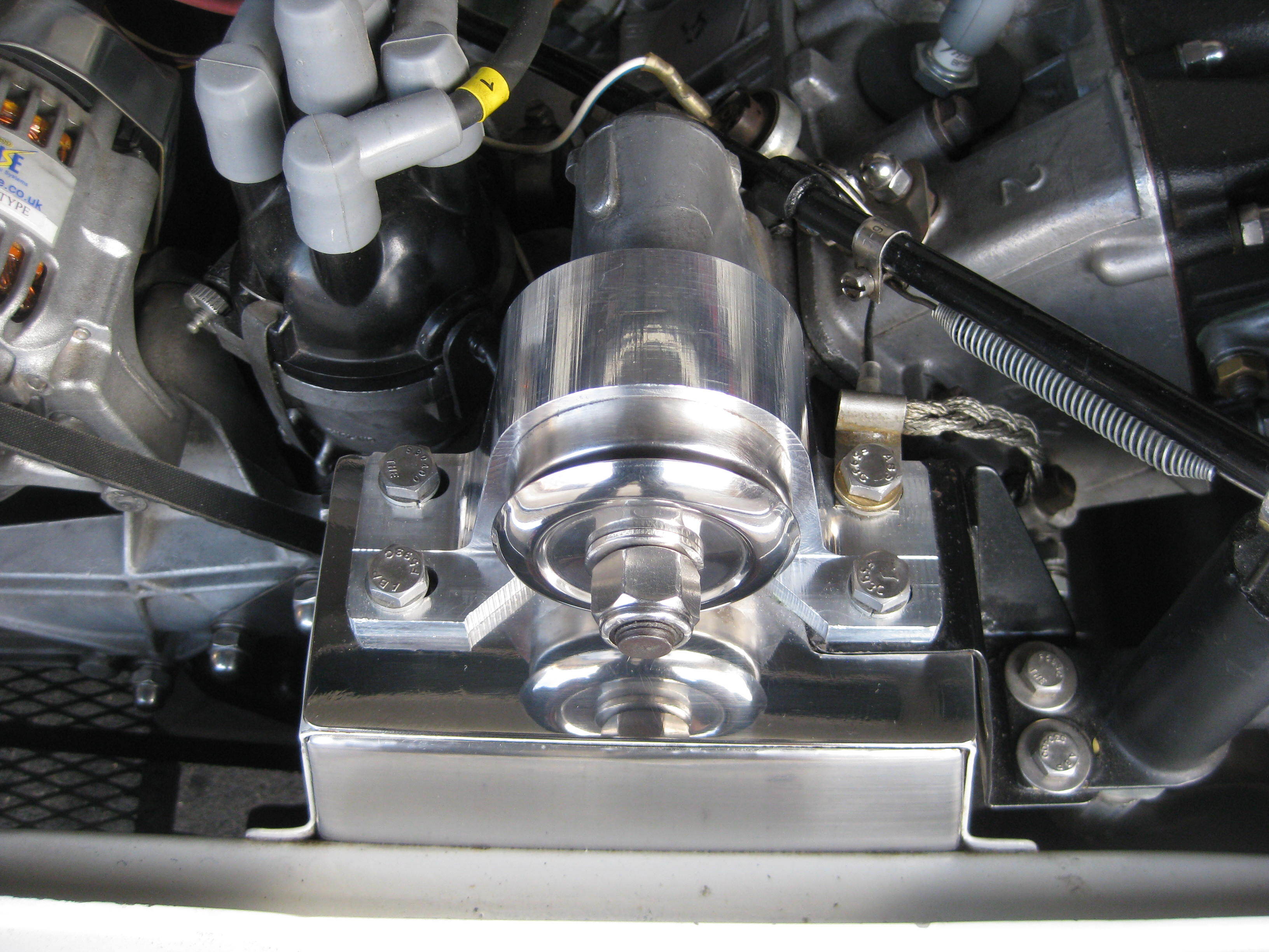

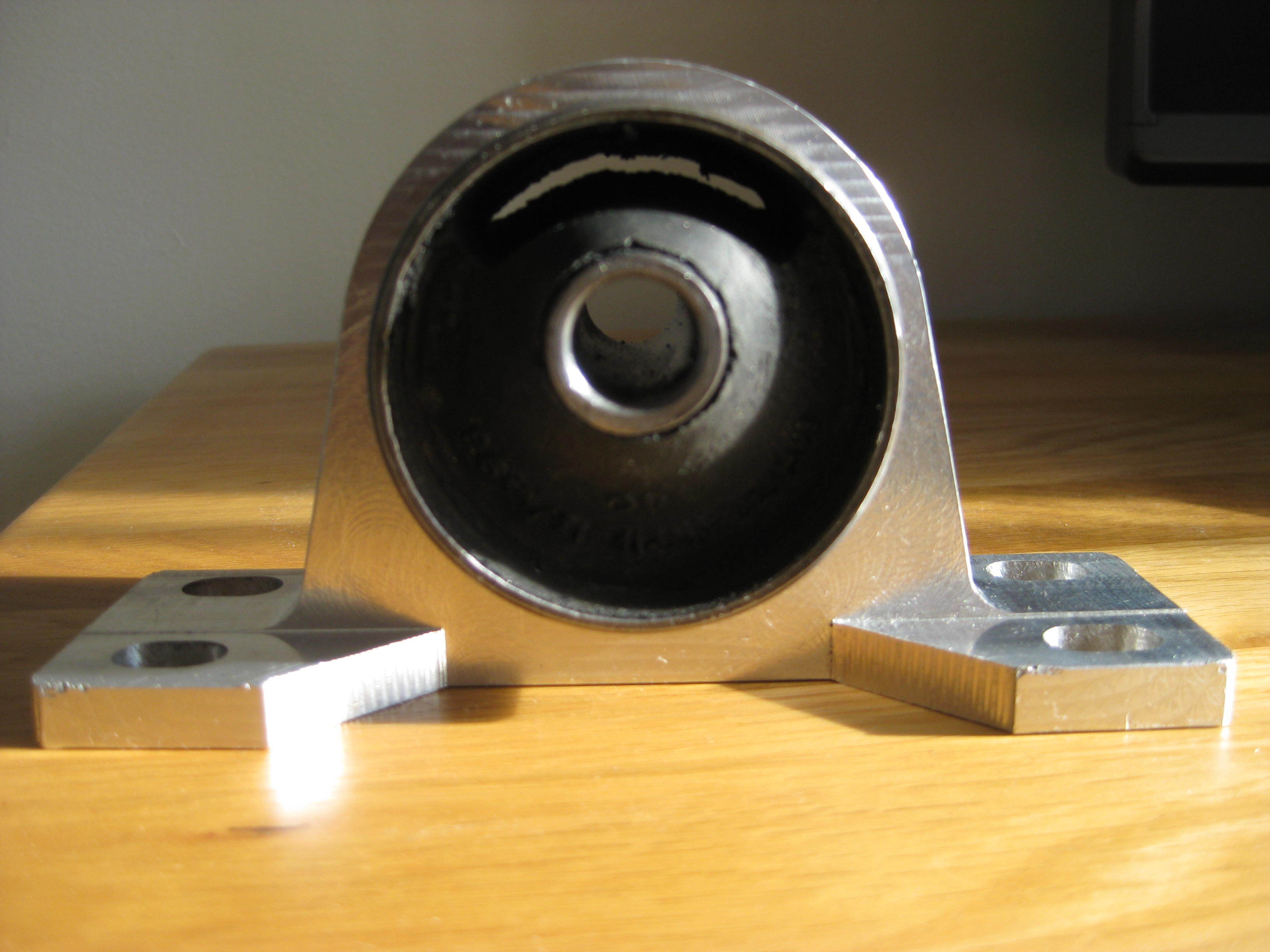

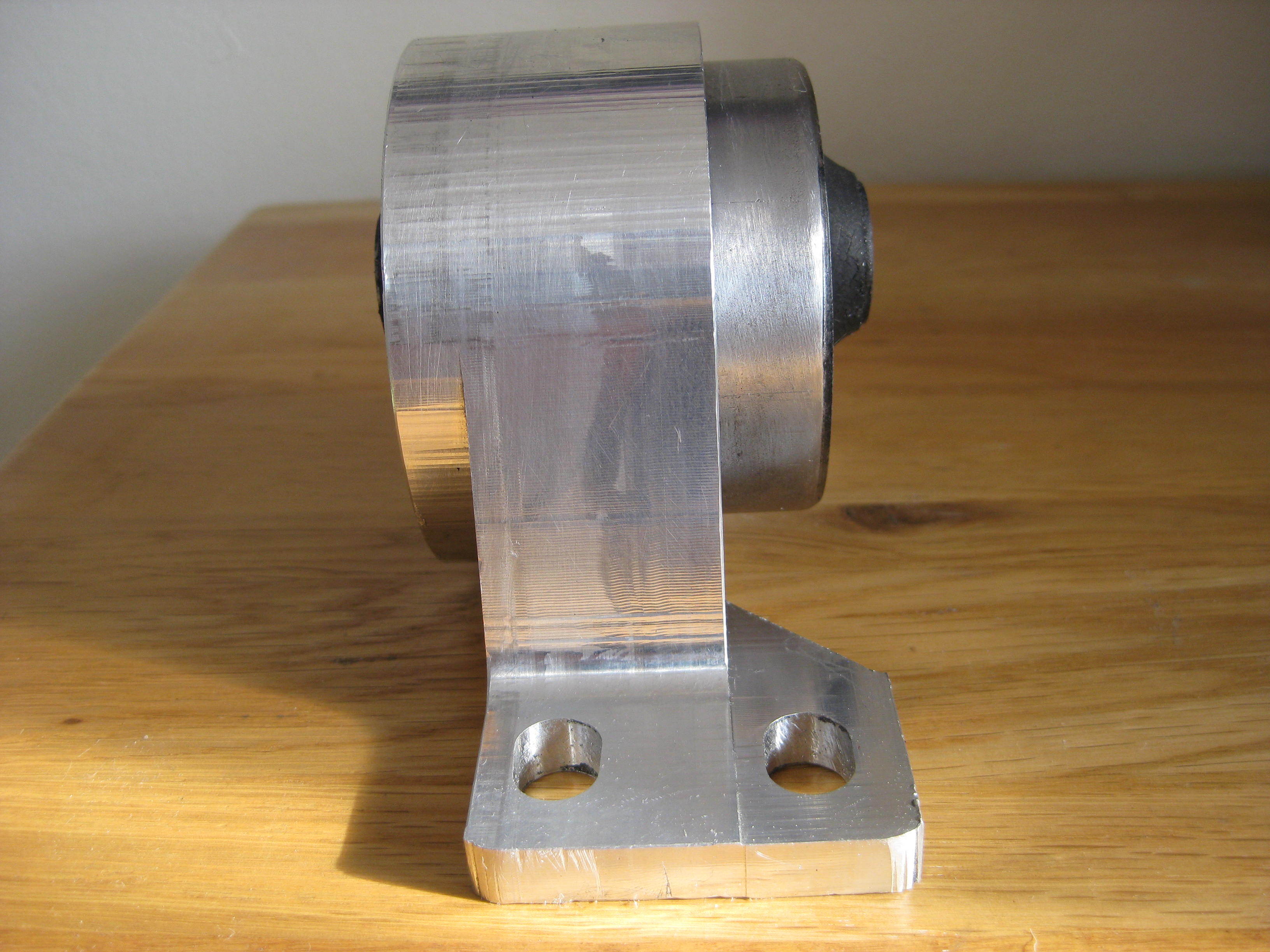

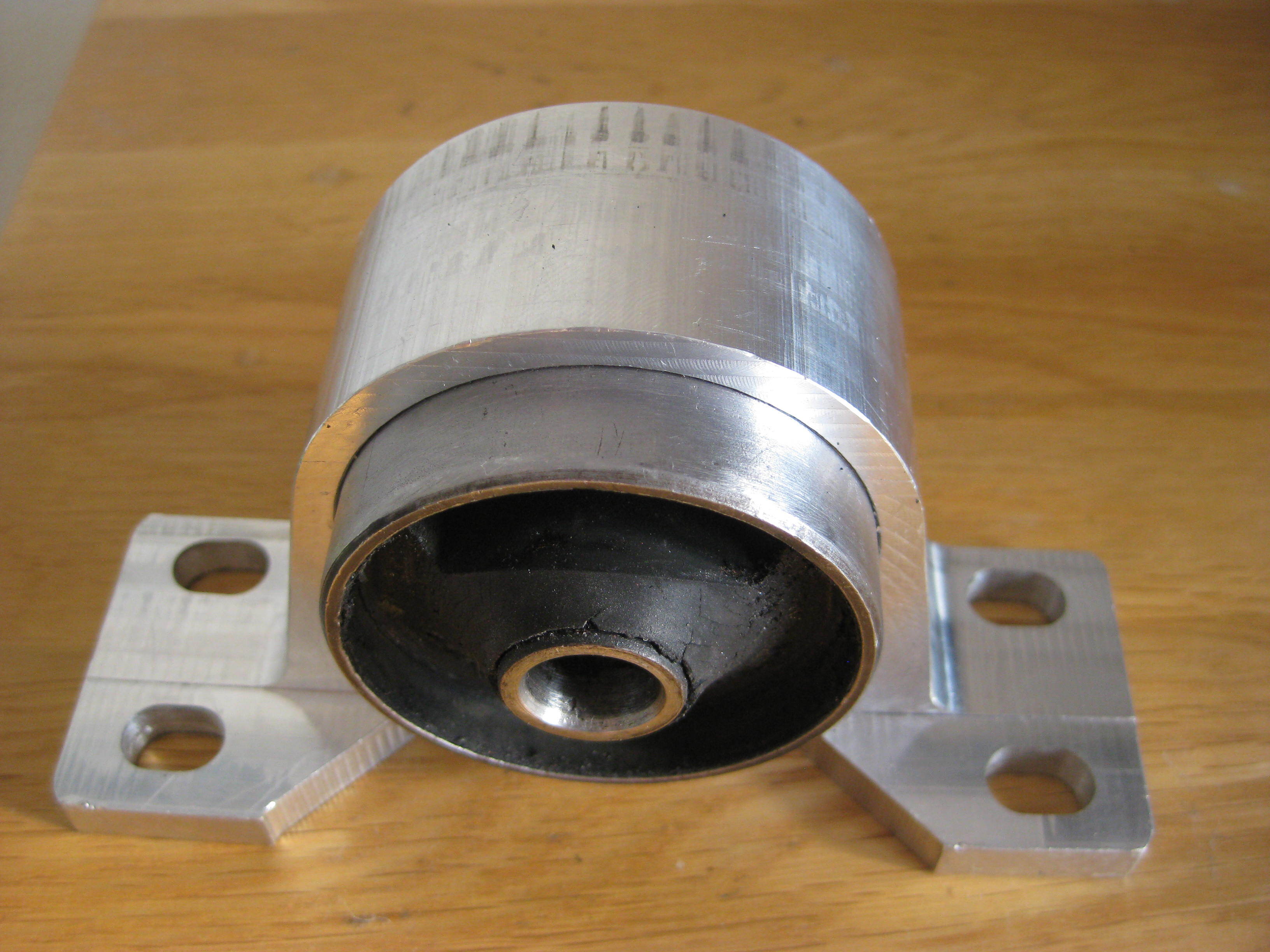

                      CNC engine mount - well why not :)

                        #161
                        And now fitted

                          #162
                          Dave, Thats the dogs wotsite, lovely work.
                          Your are certainly making sure that CNC machine is earining its keep really cool

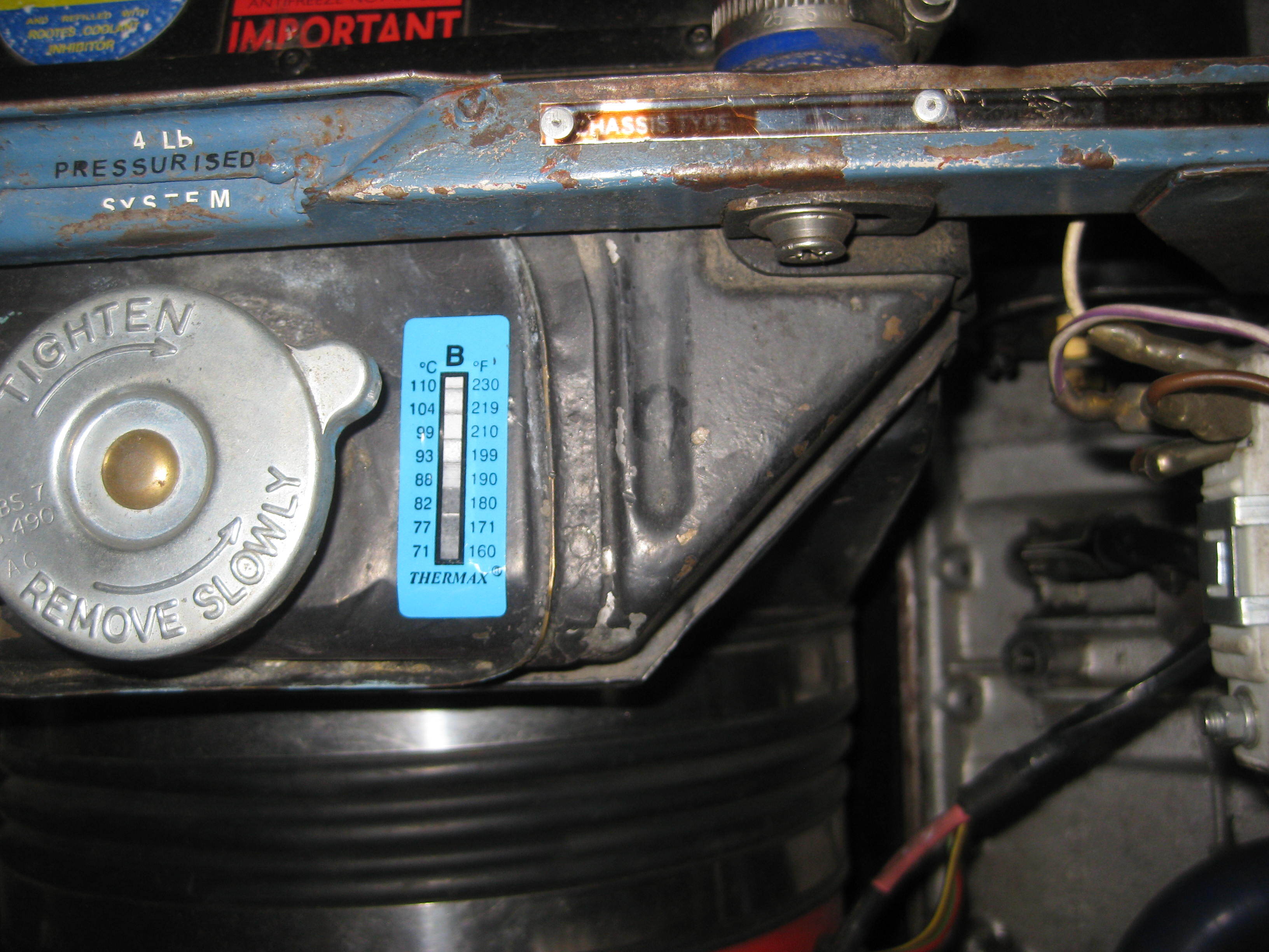

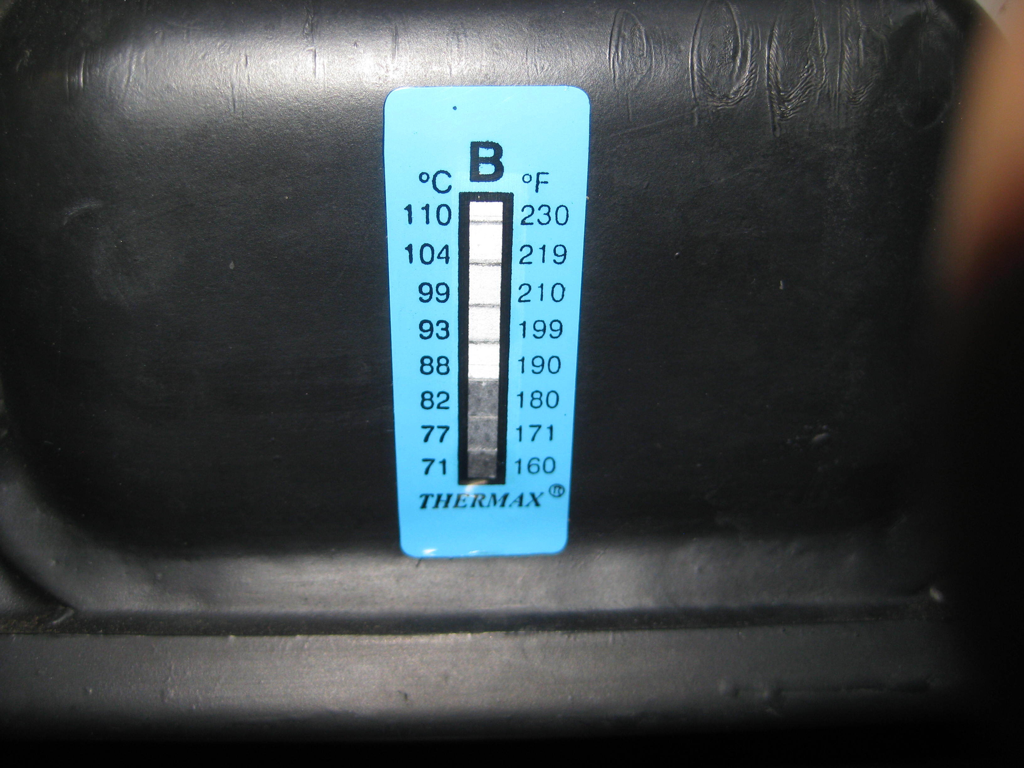

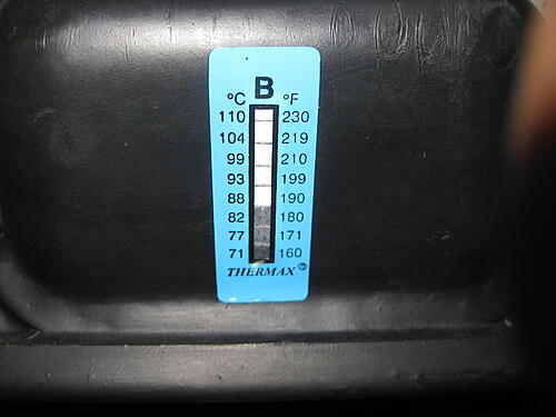

                              So a heatwave and a car with a reputation of boiling , warping heads , headgaskets etc etc ---- not a good combo except a well maintained engine and cooling system should cope fine .
                              So as a trial i stuck some Thermax heat sensitive stickery things on the rads of both - these will tell you what the temp actually is and not what the gauge tells you ( although both mine are bob on ) .
                              These just give a " max reached " temp so its not a gauge but a good indication of the hottest it got , they dont return to how they were but stay on the indicated max reached .
                              Anyhoo Heres the results of both mine - heater off obviously or we would cook - first off the Singer in 27˚C after a 10 mile thrash .
                              Second is Barnaby after 140 odd miles to the full English plus 40 odd miles this week to work and back , you can see number 4 block was just beginning to change on this so maybe 85˚C is a more accurate reading of this one

                                #165
                                Those are one pair of happy engines Dave, a real credit to your efforts
