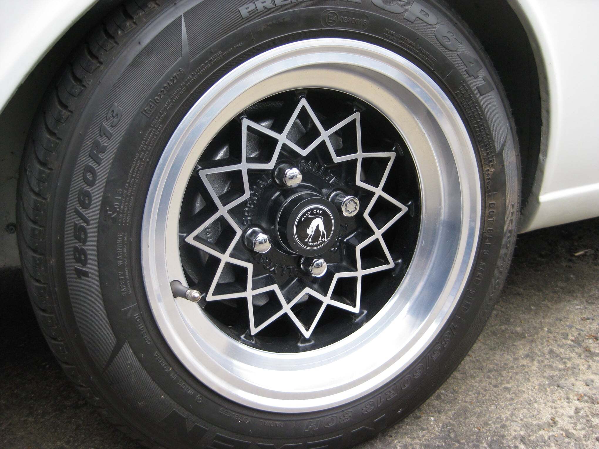

      Rear drums are now silver to match the Hayashi fronts , i used engine paint rated to 180˚C , If it cooks that off im probably dead in a ditch so should be fine
ID:	16953 Click image for larger version

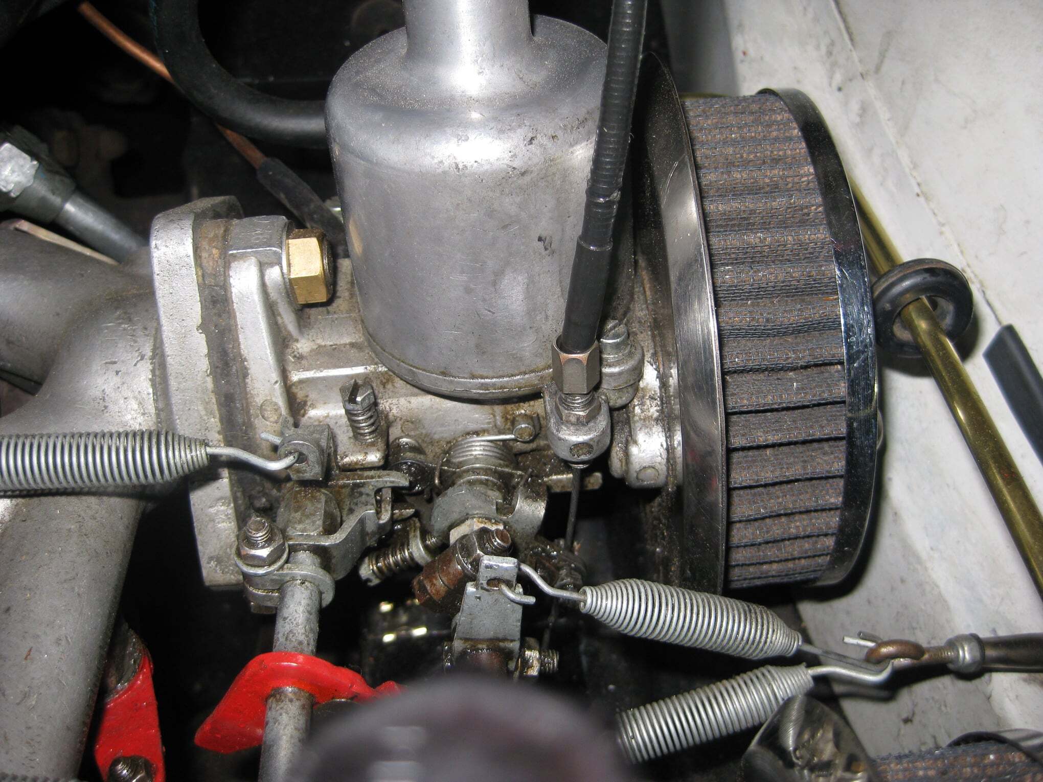

            Random bodge job / mod for today .
            Used an old bicycle brake adjuster for a choke cable stop . Easy to adjust the cable now.
            Throttle already has one

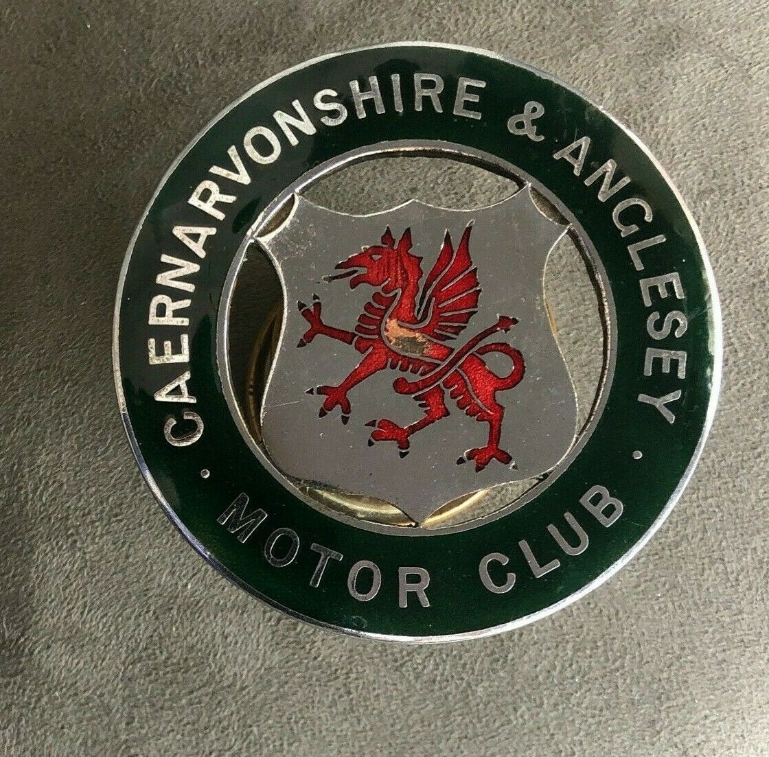

                                Badge from its home for the Singer , hard to find anything with Anglesey on it car wise , bit of damage but beggars cant be choosers
                                Click image for larger version  Name:	s-l1600.jpg Size:	322.2 KB ID:	18763
