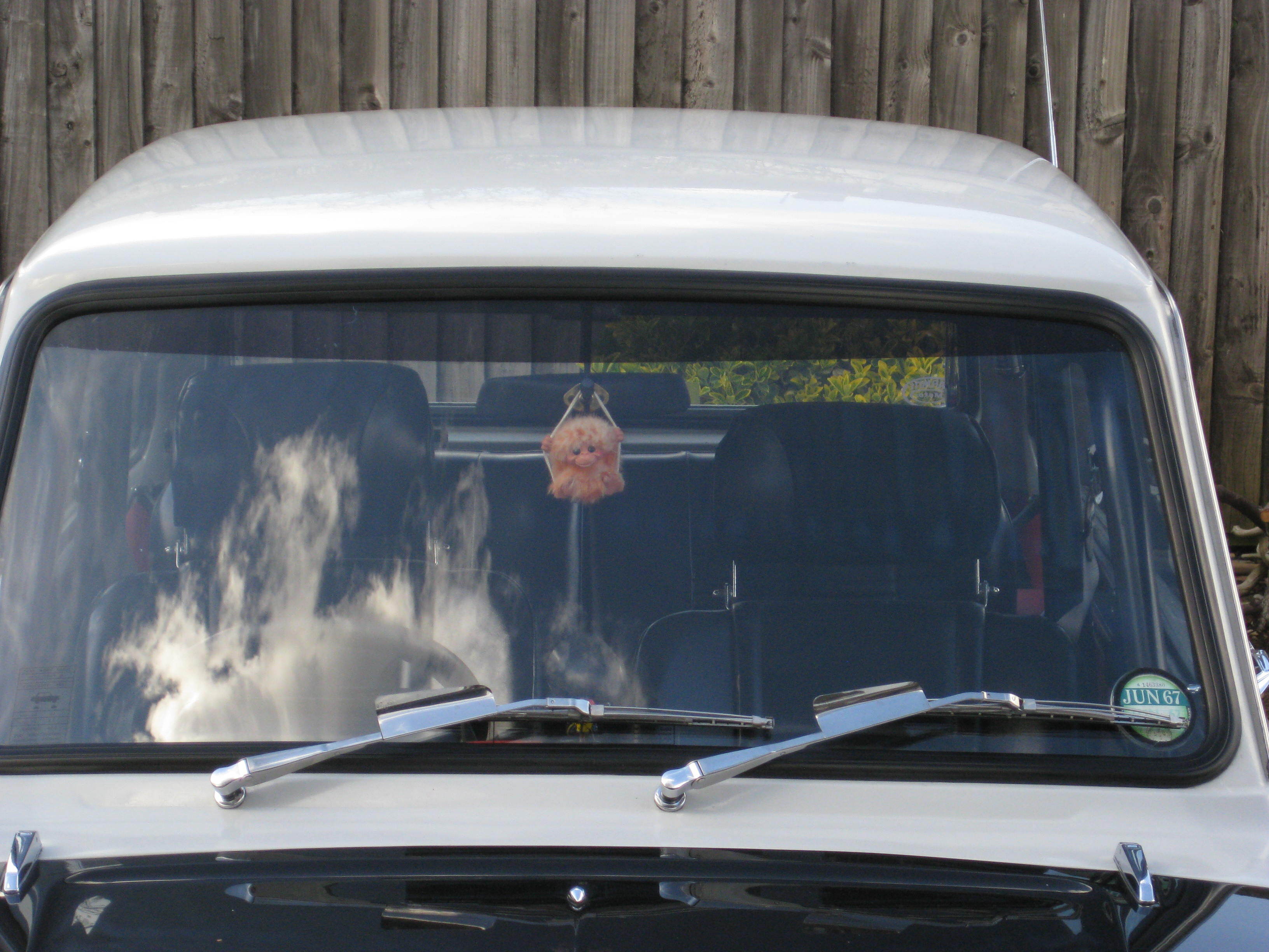

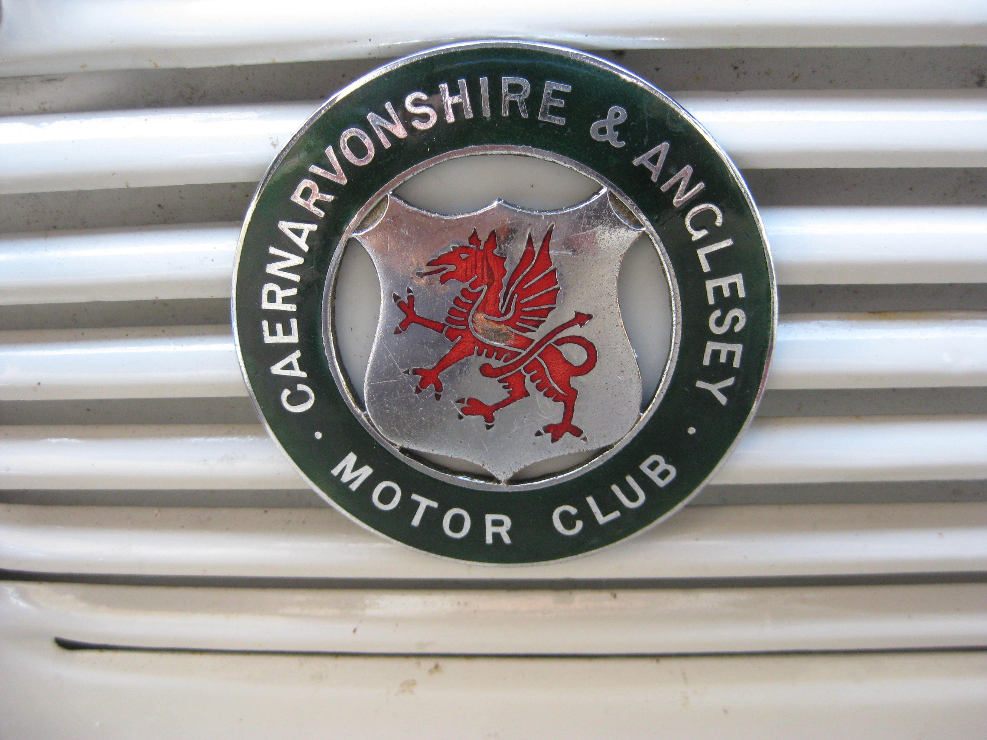

            Well the Caernarvonshire and Anglesey badge is fitted .
            No holes drilled and two minutes to take it off.
            These badges are very much a 60s thing so that and the fact its Anglesey related means it kind of fits in
            Also altered the top screen tint with a strange " never seen before " shape

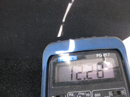

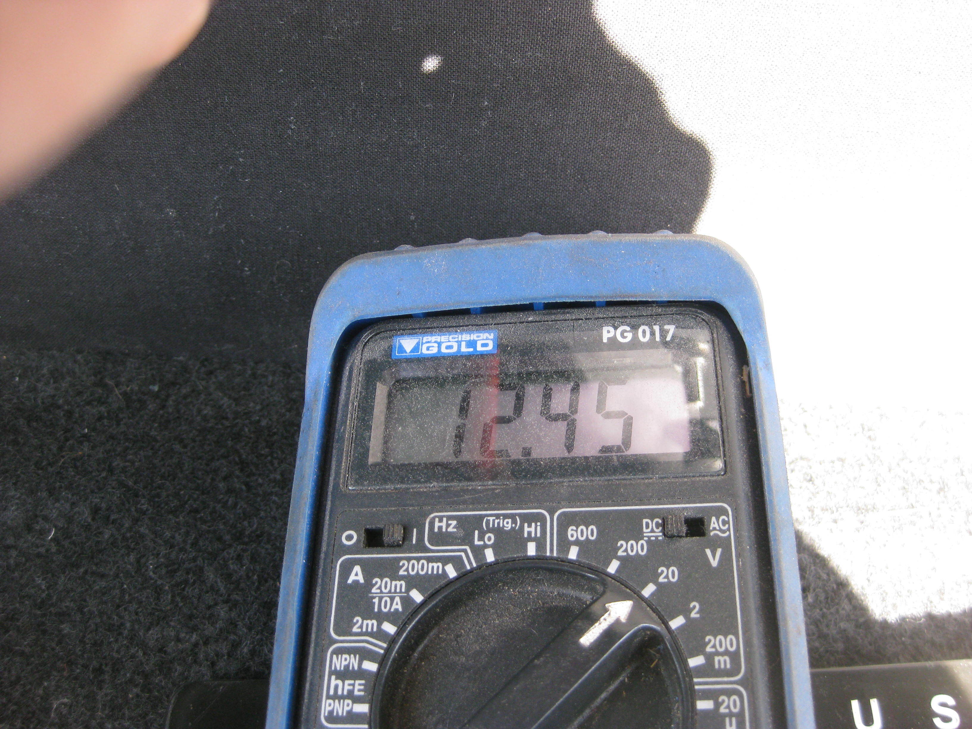

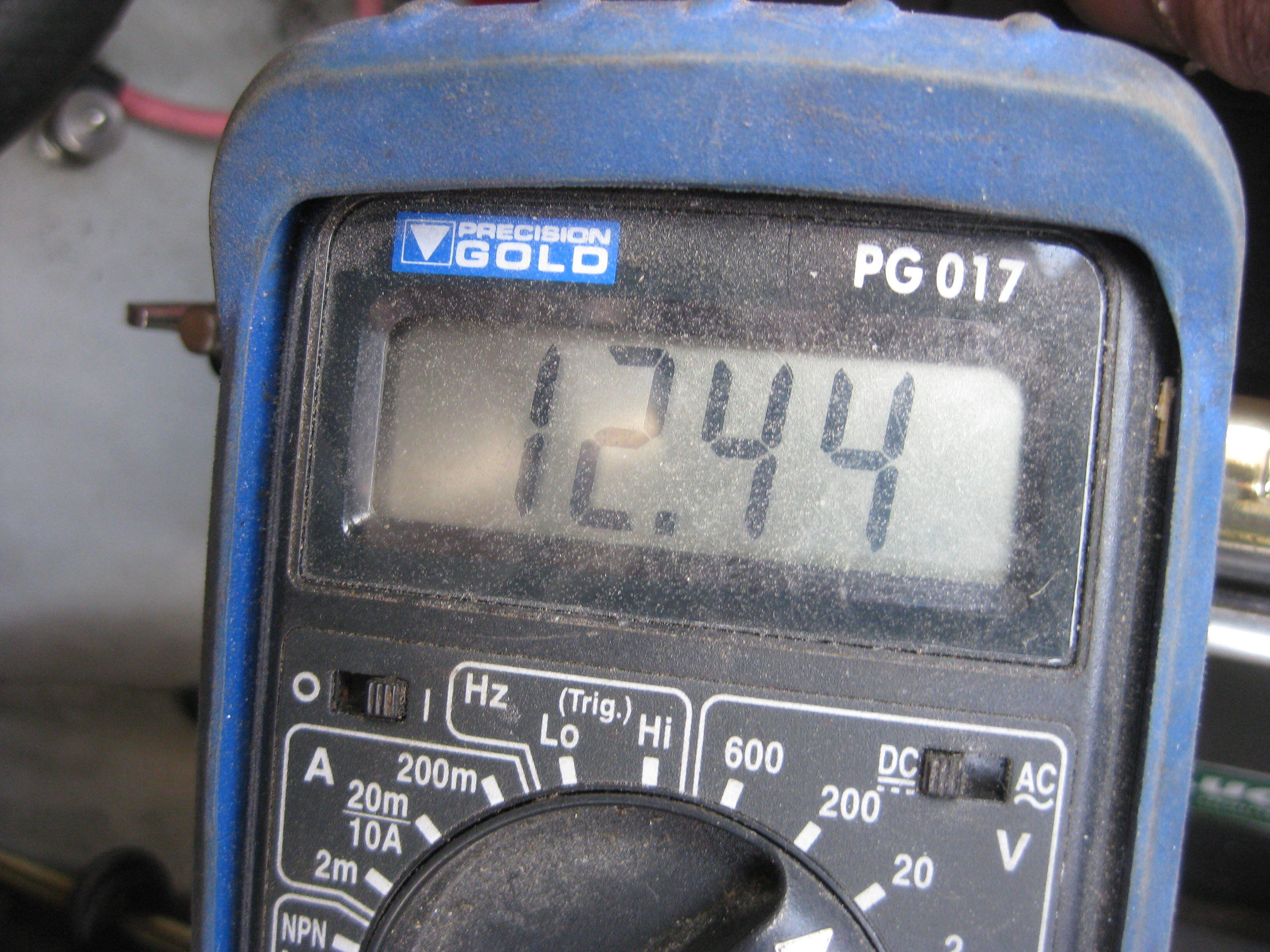

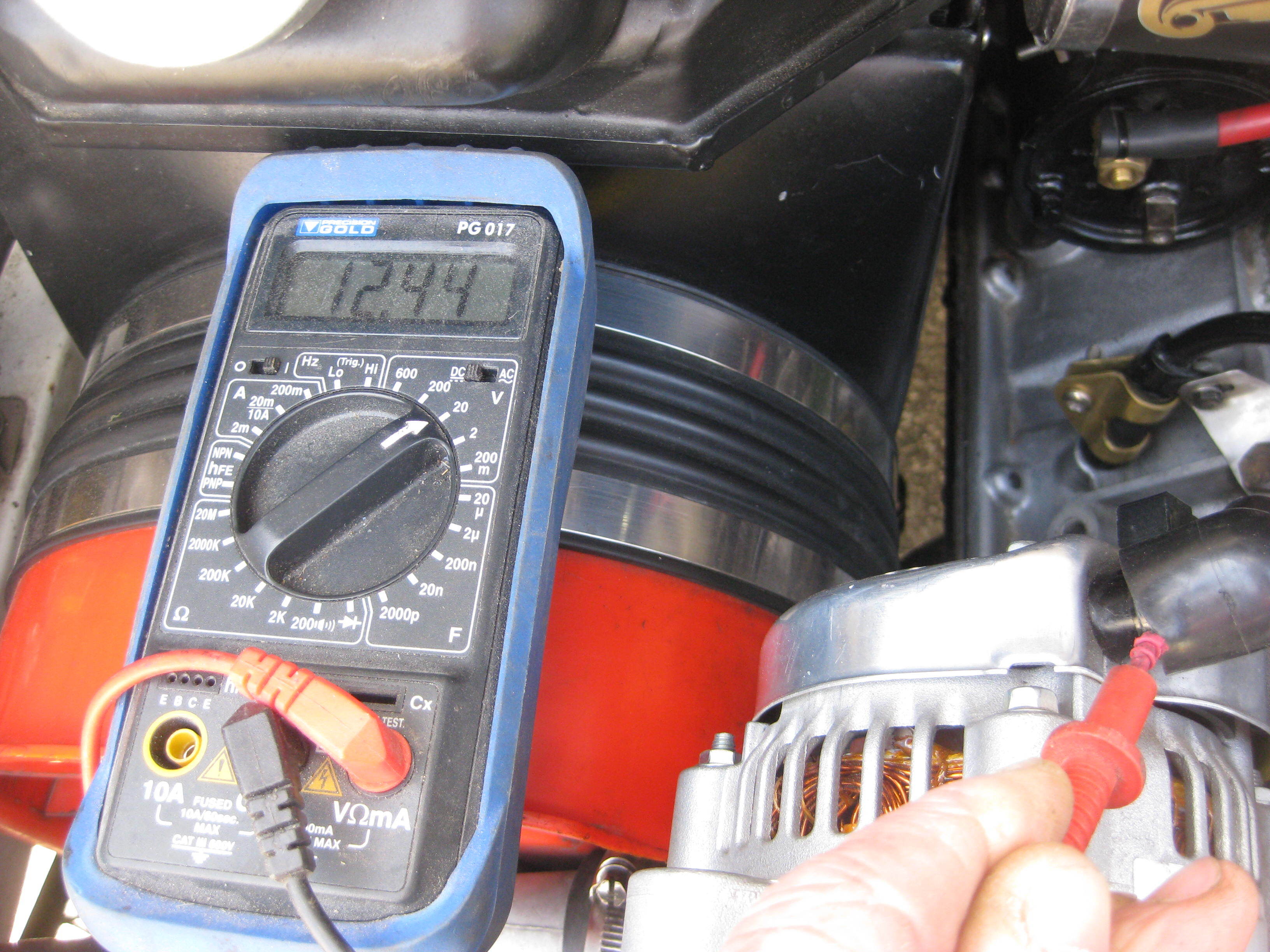

                I periodically check voltage readings on both cars to test for voltage drop . Well it looks like im loosing 0.17V at the ignition switch which i think is acceptable given Lucas ignition switches
                At the battery
                Alternator

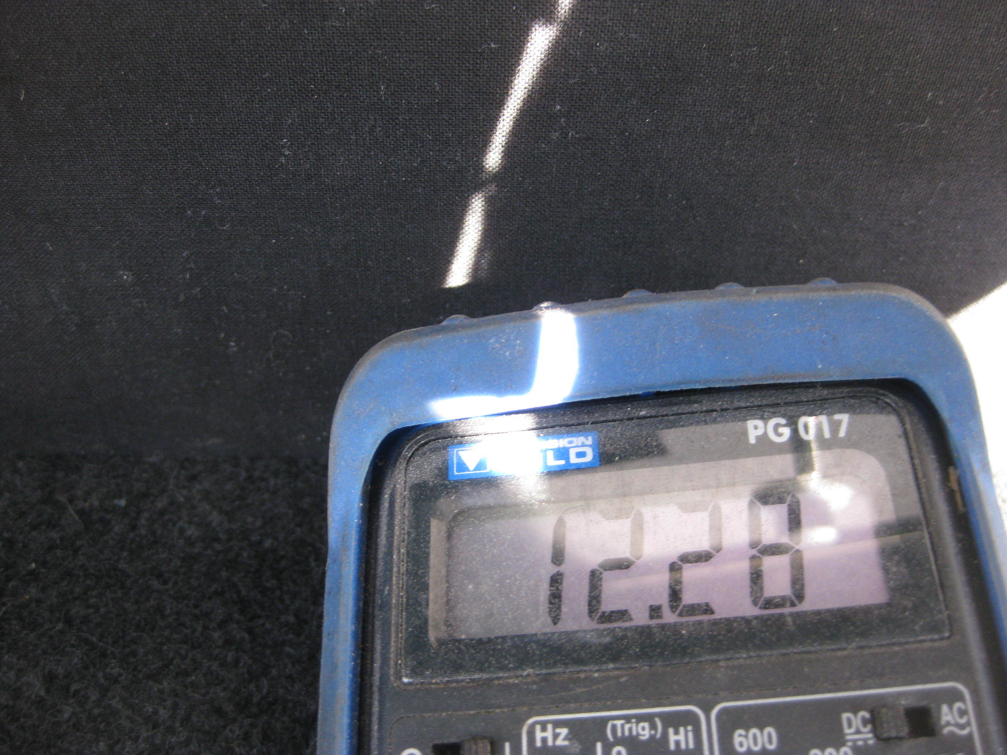

                Up front - permanent supply - strangely i gained 0.01V
                Ignition switch fed supply - a drop of 0.17V
                  #143
                  Dave
                  You are doing alright there. Wire looks in good condition
                  What is the CSA of the cable normally Dave, 6mm CSA ?
                  Quick calc based on 5A current 12.4V at source , 3m cable length loss expected
                  6mm CSA - 0.09V (0.377V @ 20A)
                  4mm CSA - 0.14V (0.565V @ 20A) this is too small so muct be at least 6mm
                  All kind of assumes room temp, that loss increases when the cables are bundled up and warn in the heater channel.
                  But that voltage drop is good, you can always put on the headlights, spots, wipers ... and measure again. but just in engine bay from batt to switch then back again,
                  If you want to save the ignition switch forever Dave drop a relay at back of it instead to keep the high current load off the switchc ontacts themselves, totally just plug in job.
                  All looking good and actually a good check to do every year or so.

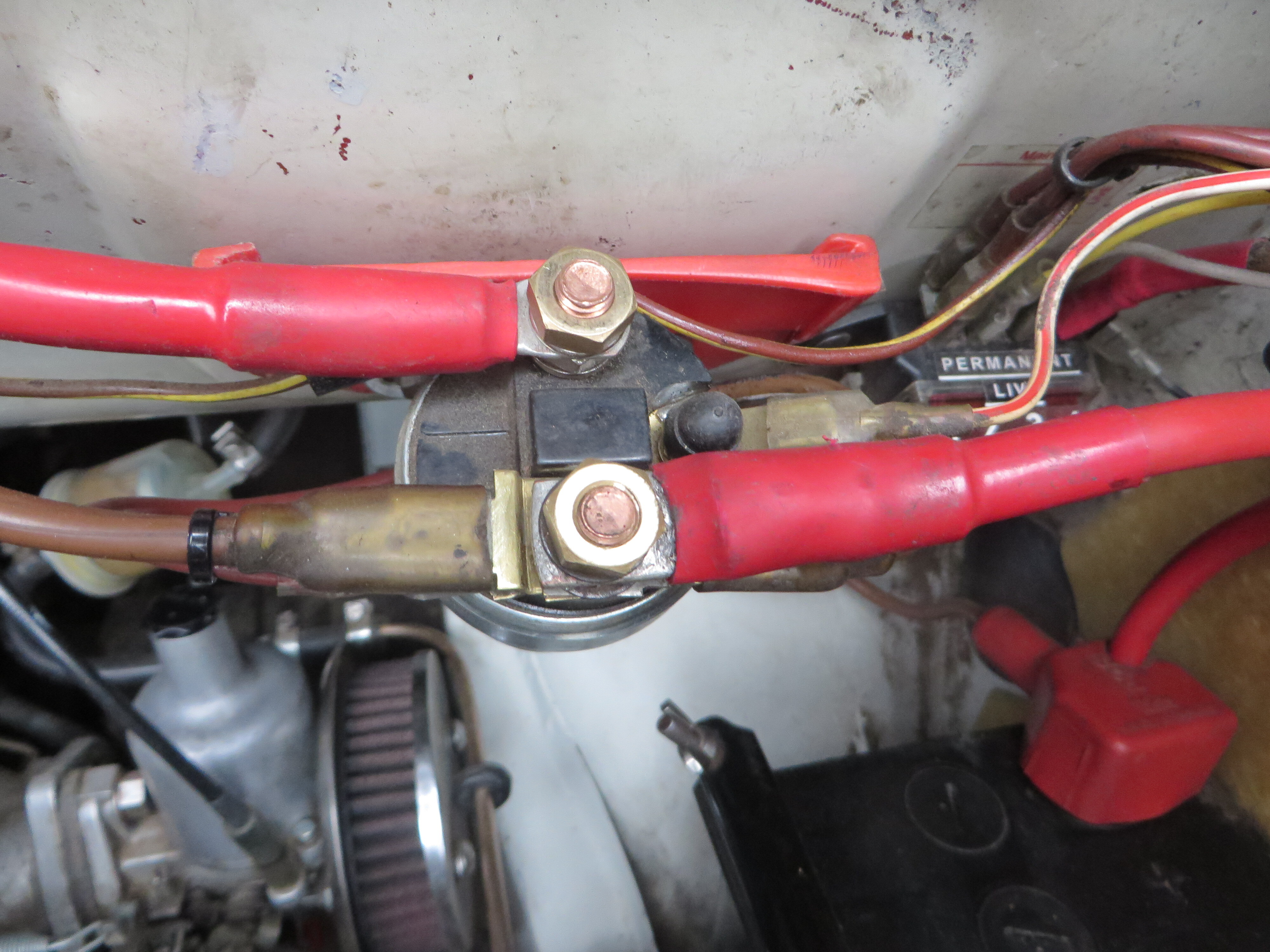

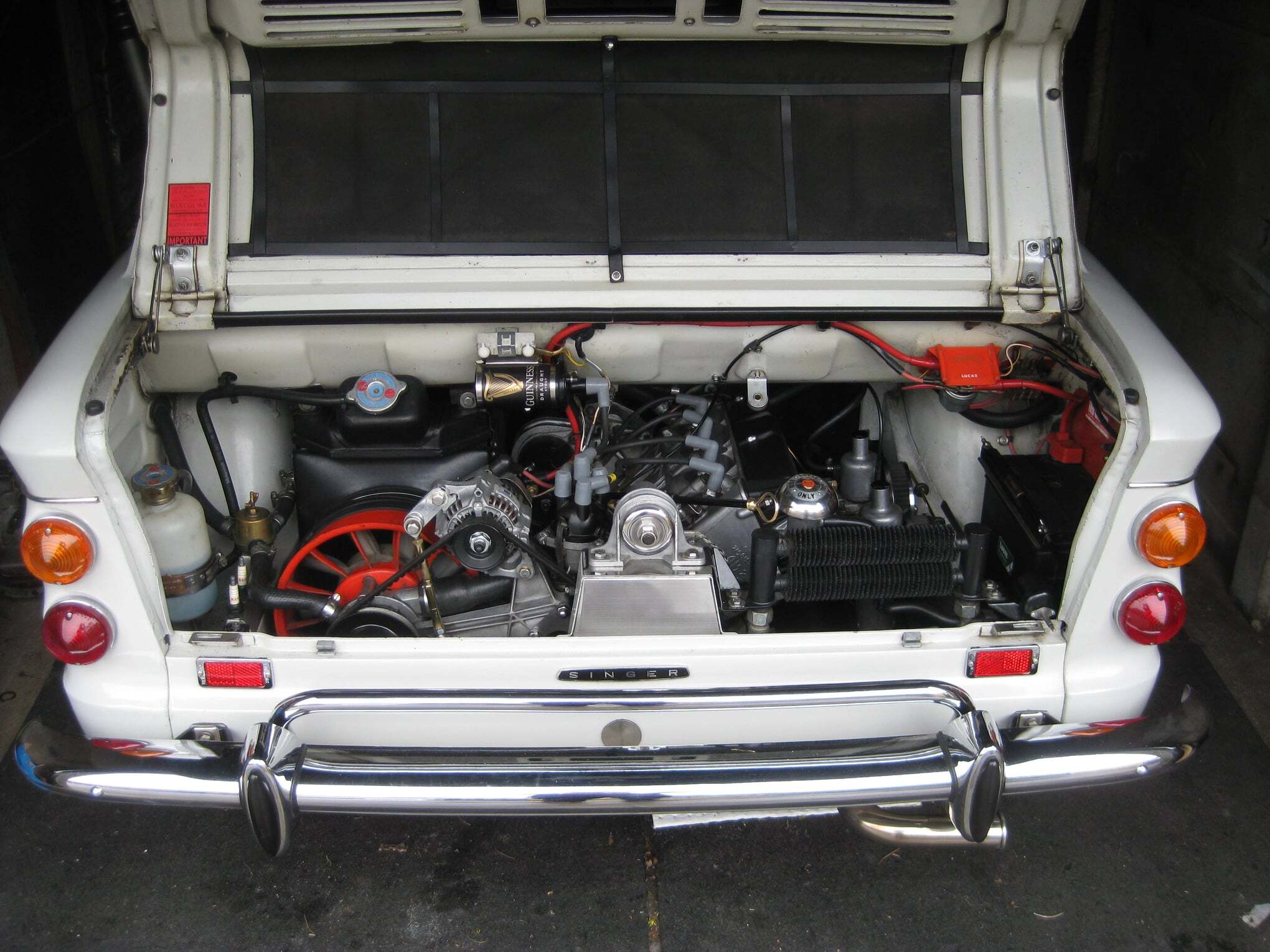

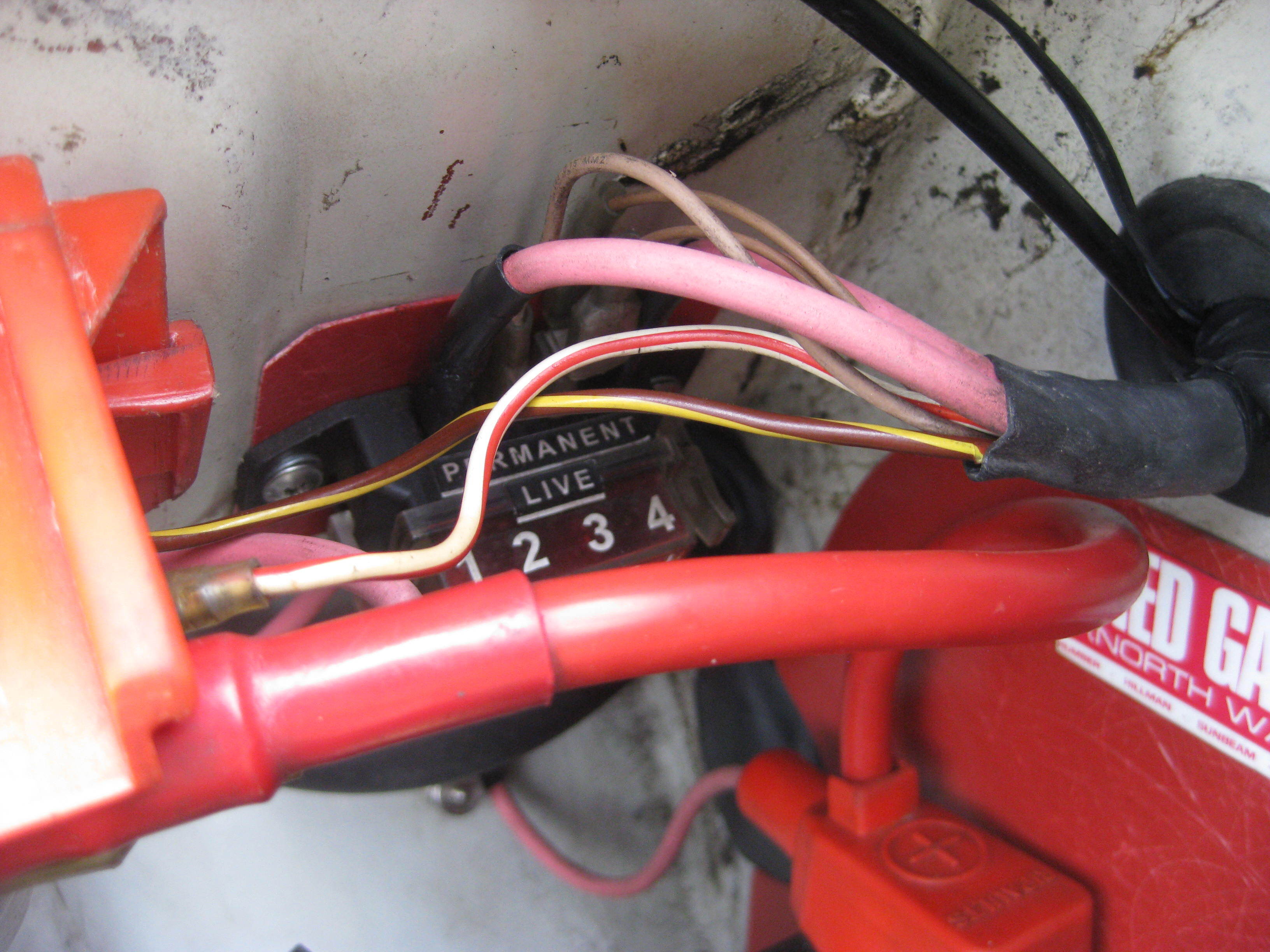

                            Well I did go ahead and alter the wiring on the Singer .
                            Ive disconnected the old brown ignition cables ( but left them in the loom )and run a 6mm CSA cable to replace them ( Huber and Suhner Radox 155 - the best you can get ) .
                            Strange wiring on MK1 Singers as one brown went to the ignition switch and one went right up to the horn.
                            Ive rewired the horns supply so its coming off the permanent fuse box in the boot therefor doing away with a cars length of old wire .
                            Re-loomed where ive been - its all working fine
                            As it is now
                            Click image for larger version  Name:	IMG_0166.jpg Size:	655.9 KB ID:	18842
                            As it was , you can just see the old twin brown wires top right
                            Click image for larger version  Name:	IMG_4486.jpg Size:	2.07 MB ID:	18843

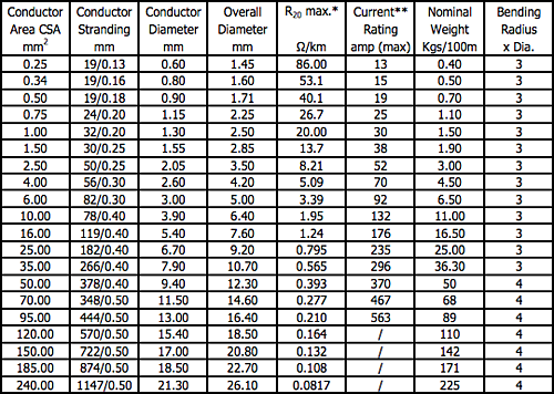

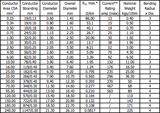

                            Radox 155S specs , So my 6mm will handle 92A - More than enough
Name:	Screen Shot 2022-04-11 at 17.41.01.png
                              #149
                              Dave, 92A is electric car areas
                              I knew those new weires were going in
                              How does the drop look now ?
