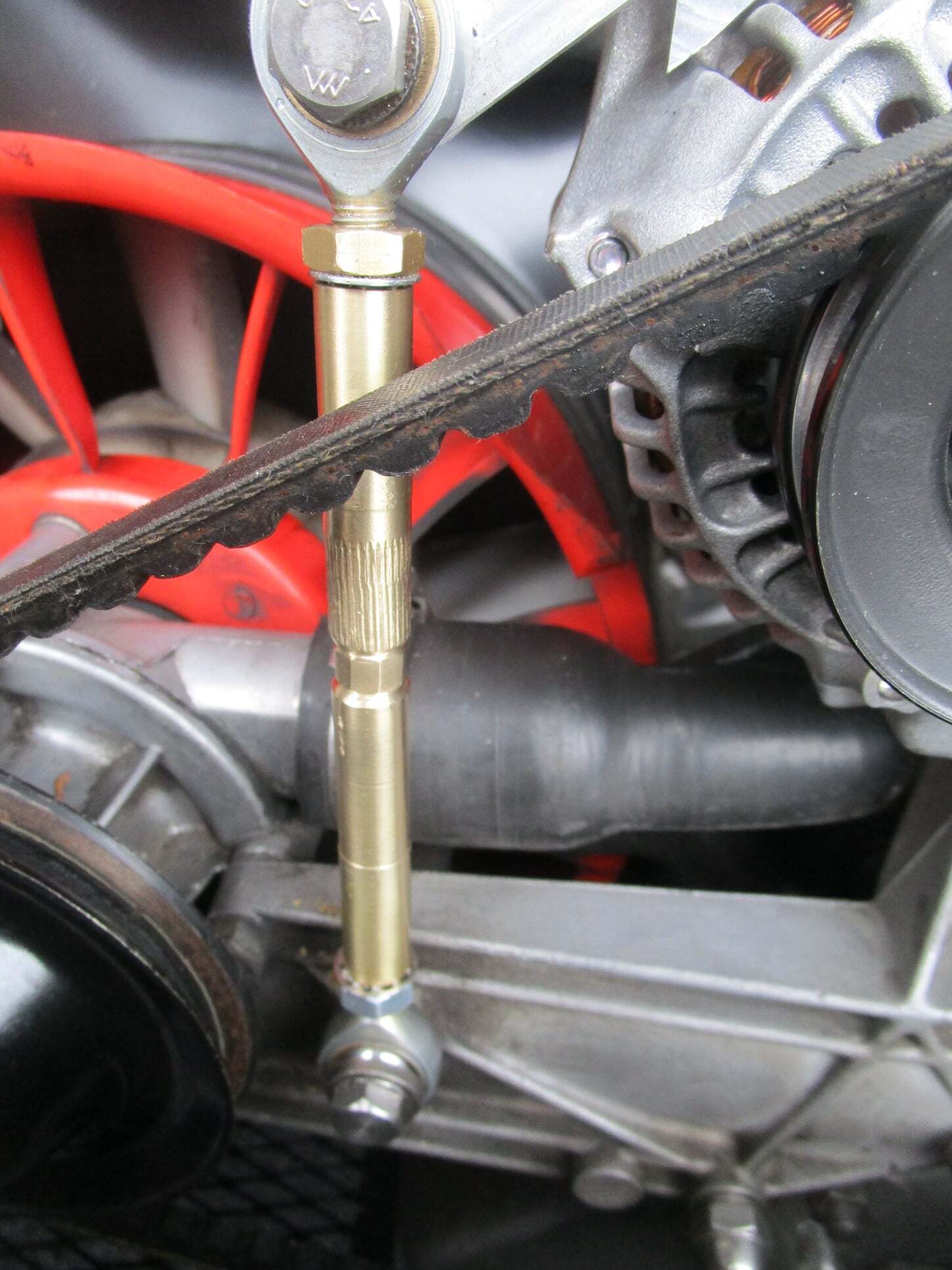

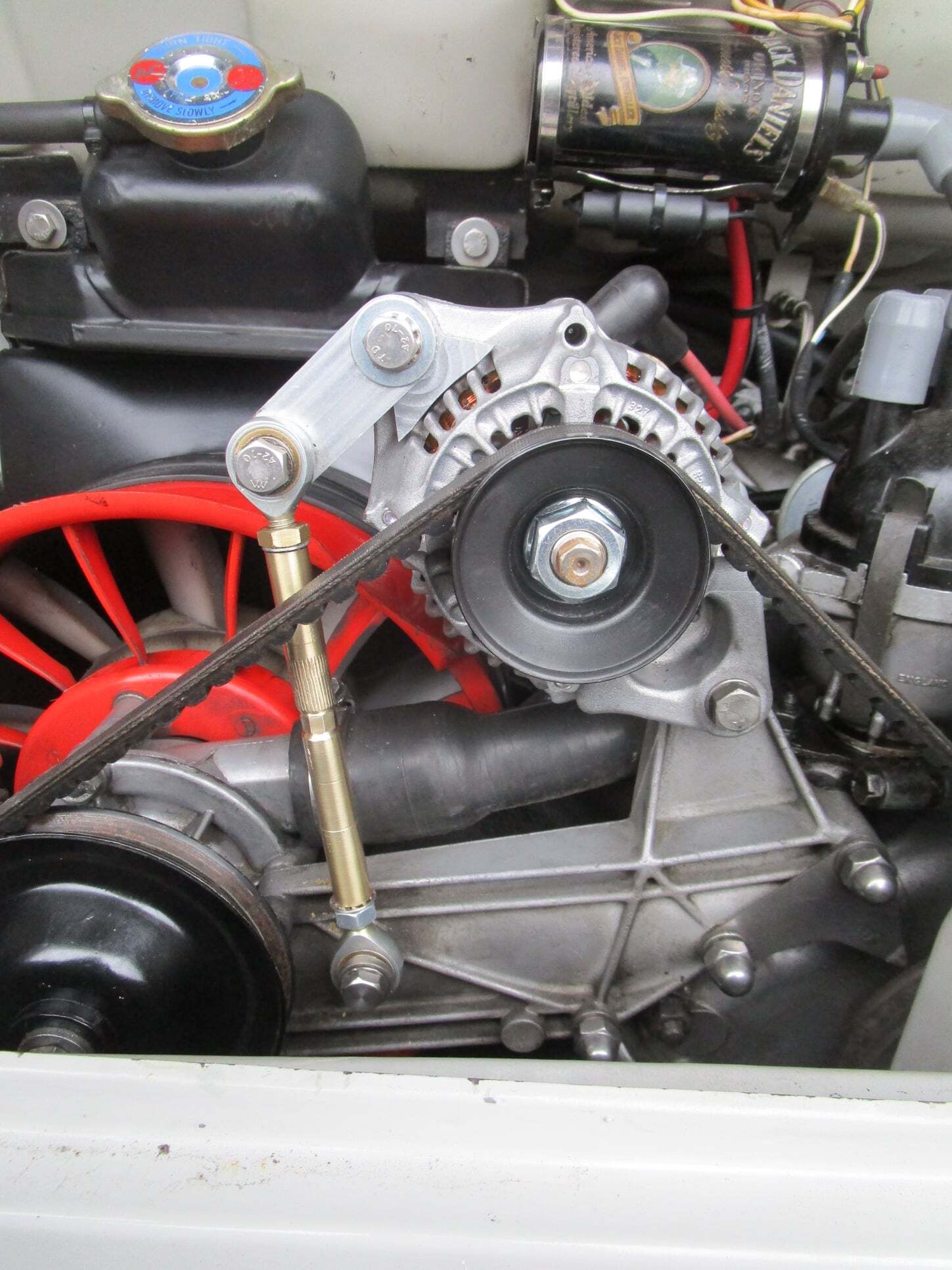

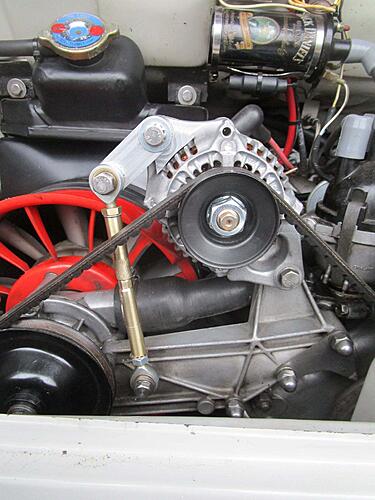

                Not done much but have hand filed a nut shape in the Alternator stay for ease of adjustment .
                Seeing as the top bolt is metric ( 13mm ) ive filed this to 10mm , 3/8th takes too much out .

                  Looks nice Dave
                  Better than the usual two flats at opposite sides tye deal
                  You getting a bit of mojo back now ?
                    #69
                    Looks nice Dave
                    Cheers , brief flutters of mojo only but thats better than zero
                      #70
                      Like that on the alternator, very cool.

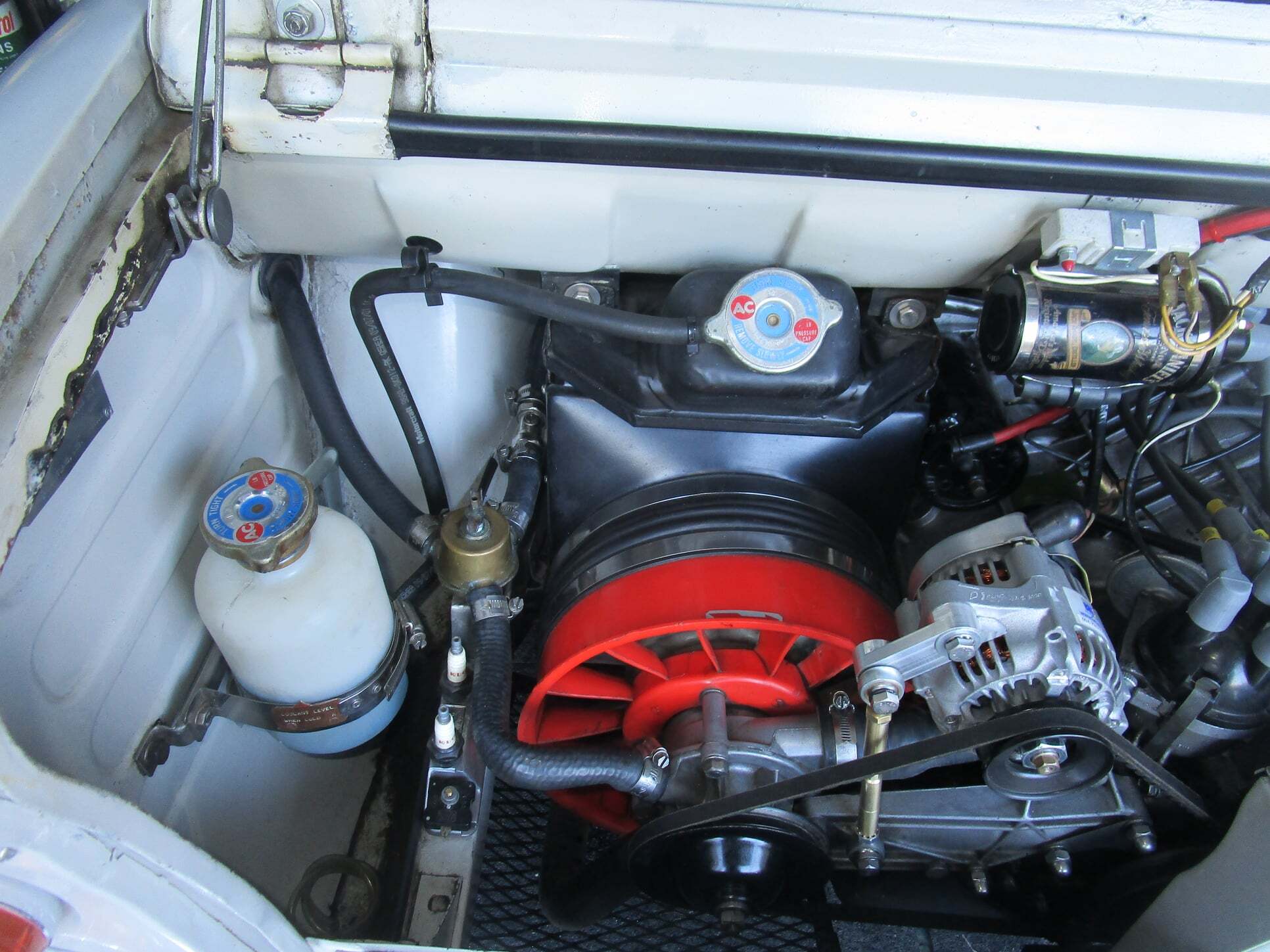

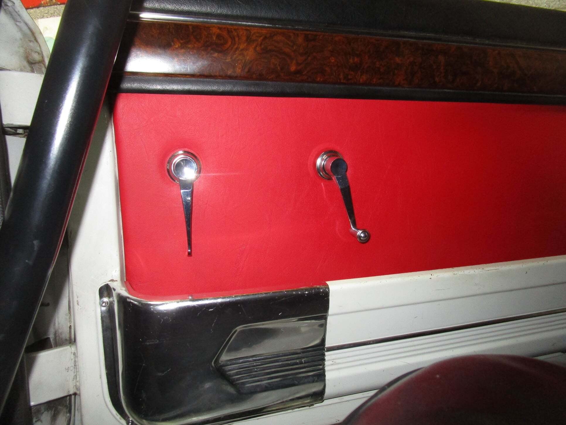

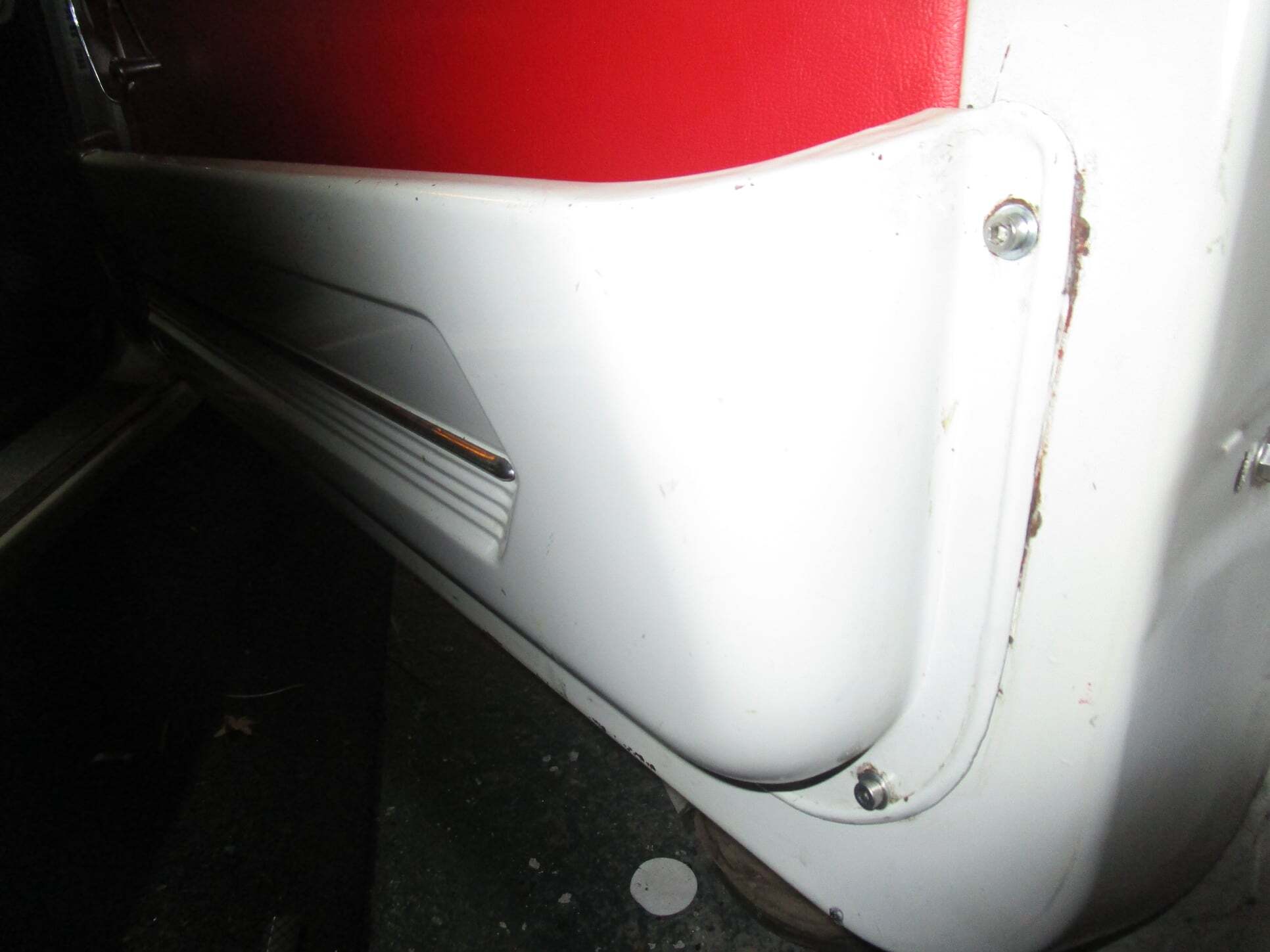

                        Finished the rivnut door pocket job on the Singer .
                        Much better than self tappers IMHO .
                        Rivnuts are M4 -0.5 to 2mm .
                        Recommended drill is 6mm but I used a 15/64 drill bit - bit tighter.
                        Bolts are M4 X 15MM Cap head in stainless with stainless washers - fitted using copper grease .…
                        In case anyone asks the ally kick plates were made by Cosmic back in the 60s

                          #72
                          Like the kick plates, very smart looking.

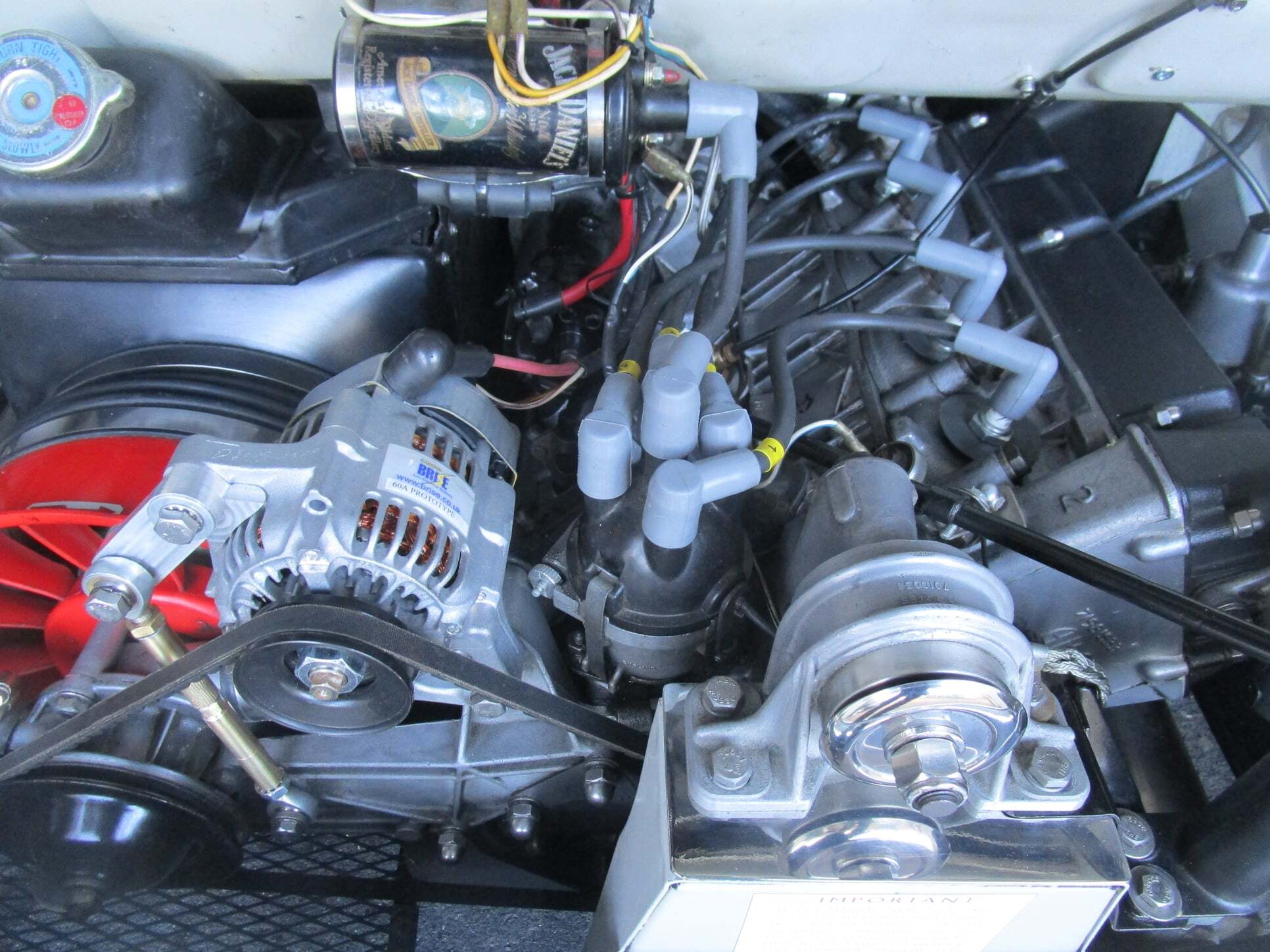

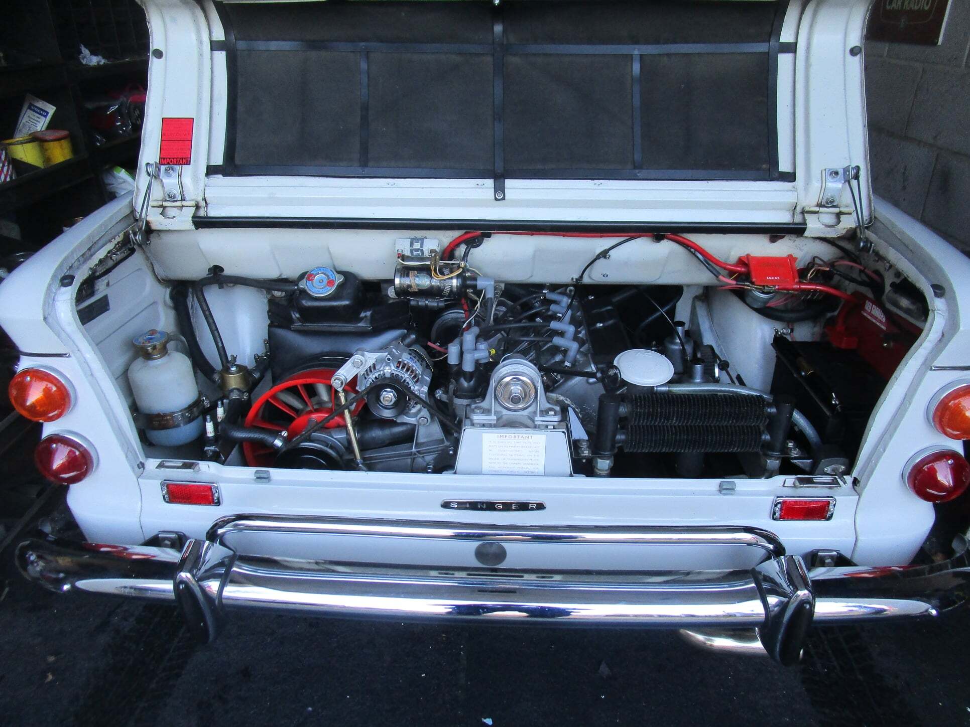

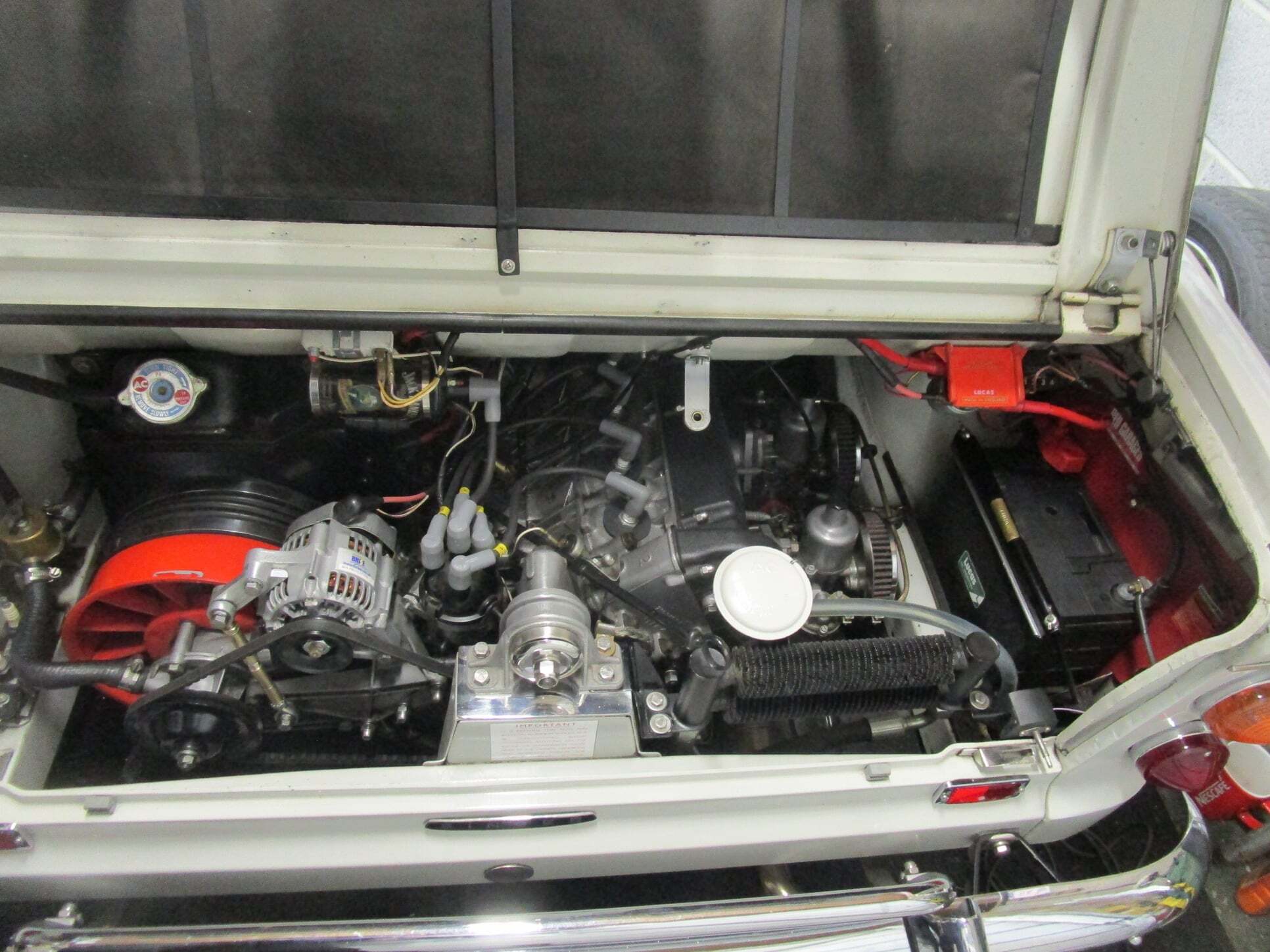

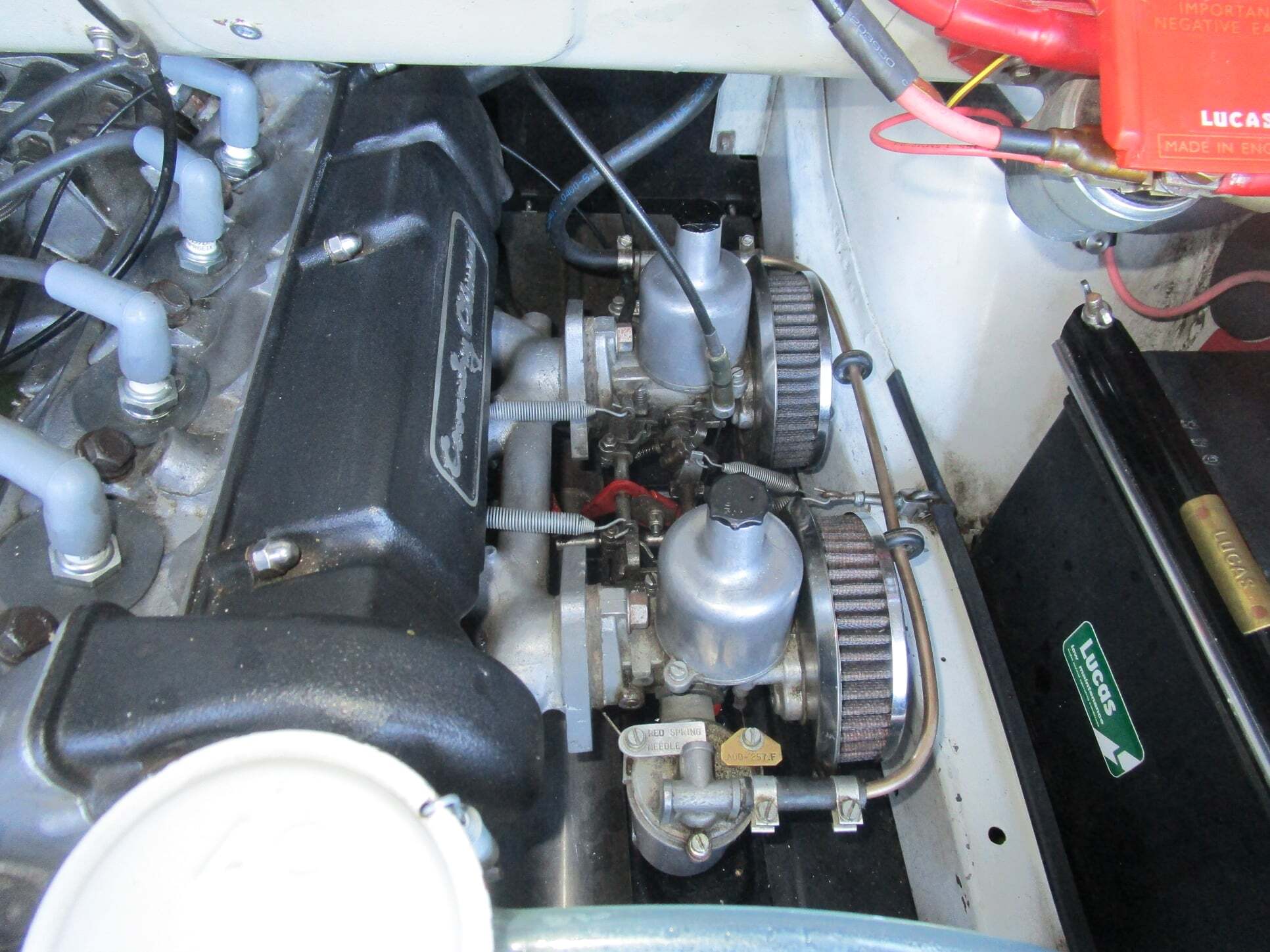

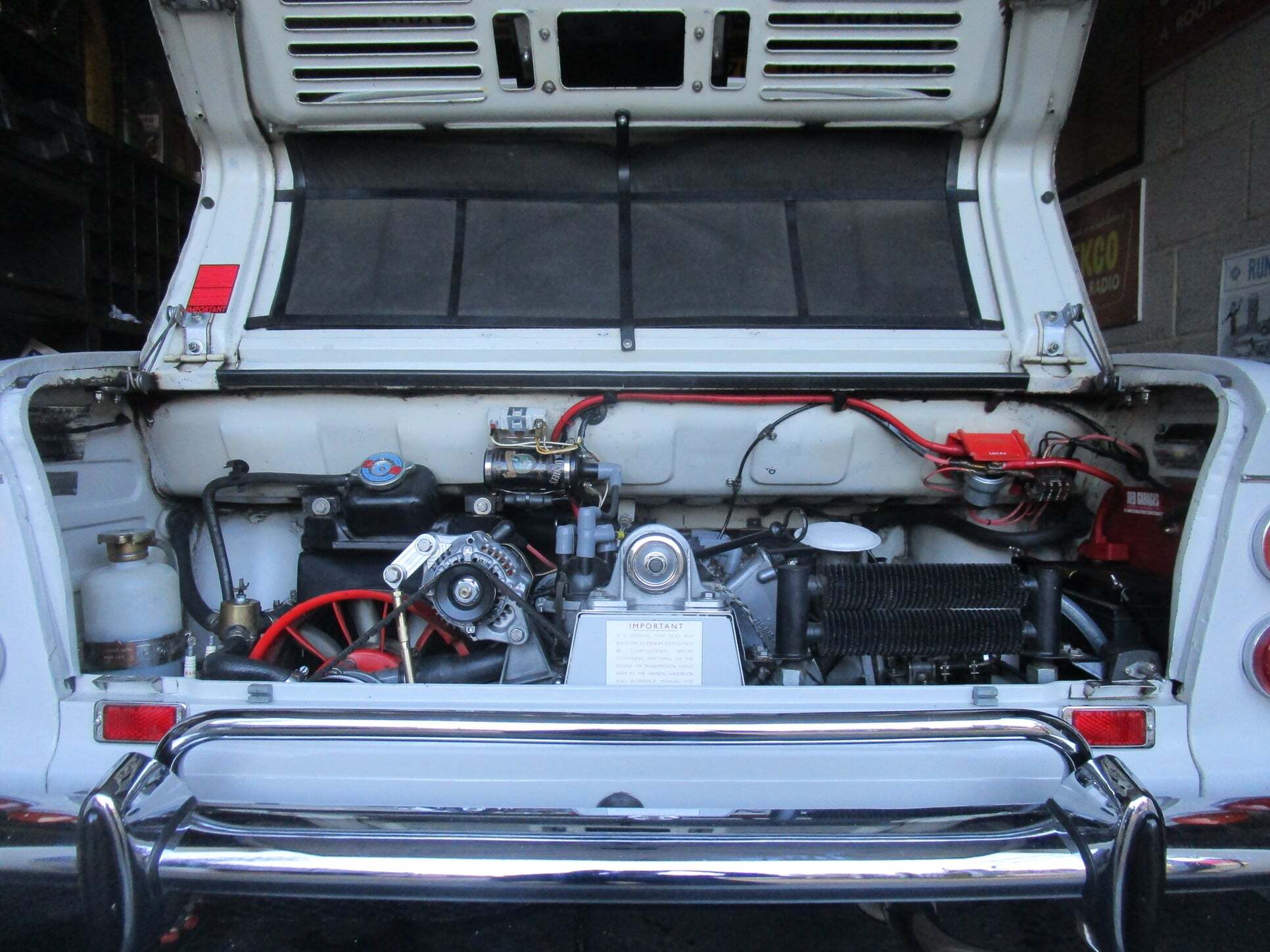

                            Singer fired up first time , been for a short run and all is well .
                            Engine bay cleaned up a bit
ID:	14098Click image for larger version
ID:	14100Click image for larger version

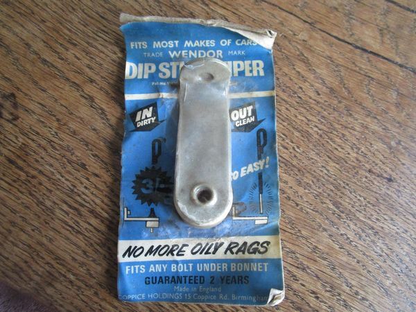

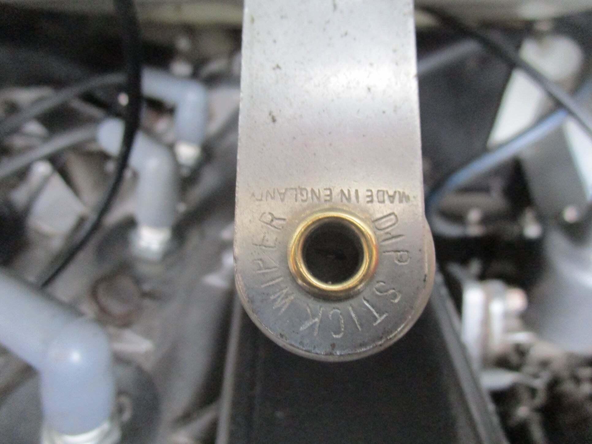

                              What to do with a random hole some muppet drilled in the rear bulkhead .
                              Fit a " probably useless " 60s dipstick wiper

                                #75
                                You'll be sorry.......
                                UH
