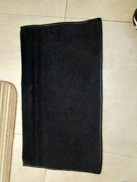

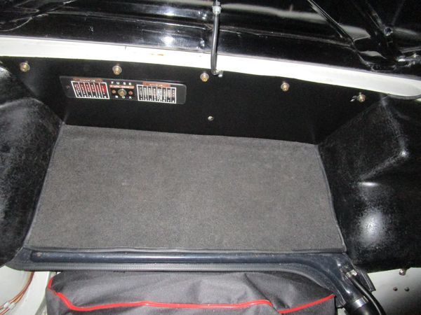

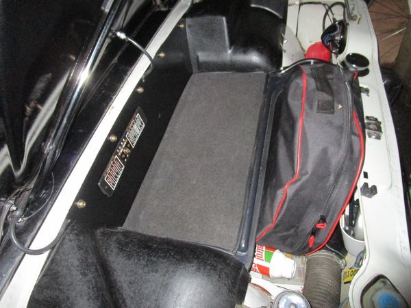

            Put some edging on the boot carpet today , I did it by hand and pricked my finger ( not fingered my prick ) rather a lot , anyway its come up OK really

              • 5364
              #36
              Looks good Dave, the door seal idea not work out, would have saved the finger
                • 846
                #37
                Bit fat , if id had a smaller one id of tried it , this worked out OK , Not for me fingers though
                  #38
                  Looks good Dave, how long did that take you to do that?
                  Not including the A+E time to mend your fingers ??????
                  Col
                    • 846
                    #39
                    Col
                    A couple hours , fingers have kind of recovered now

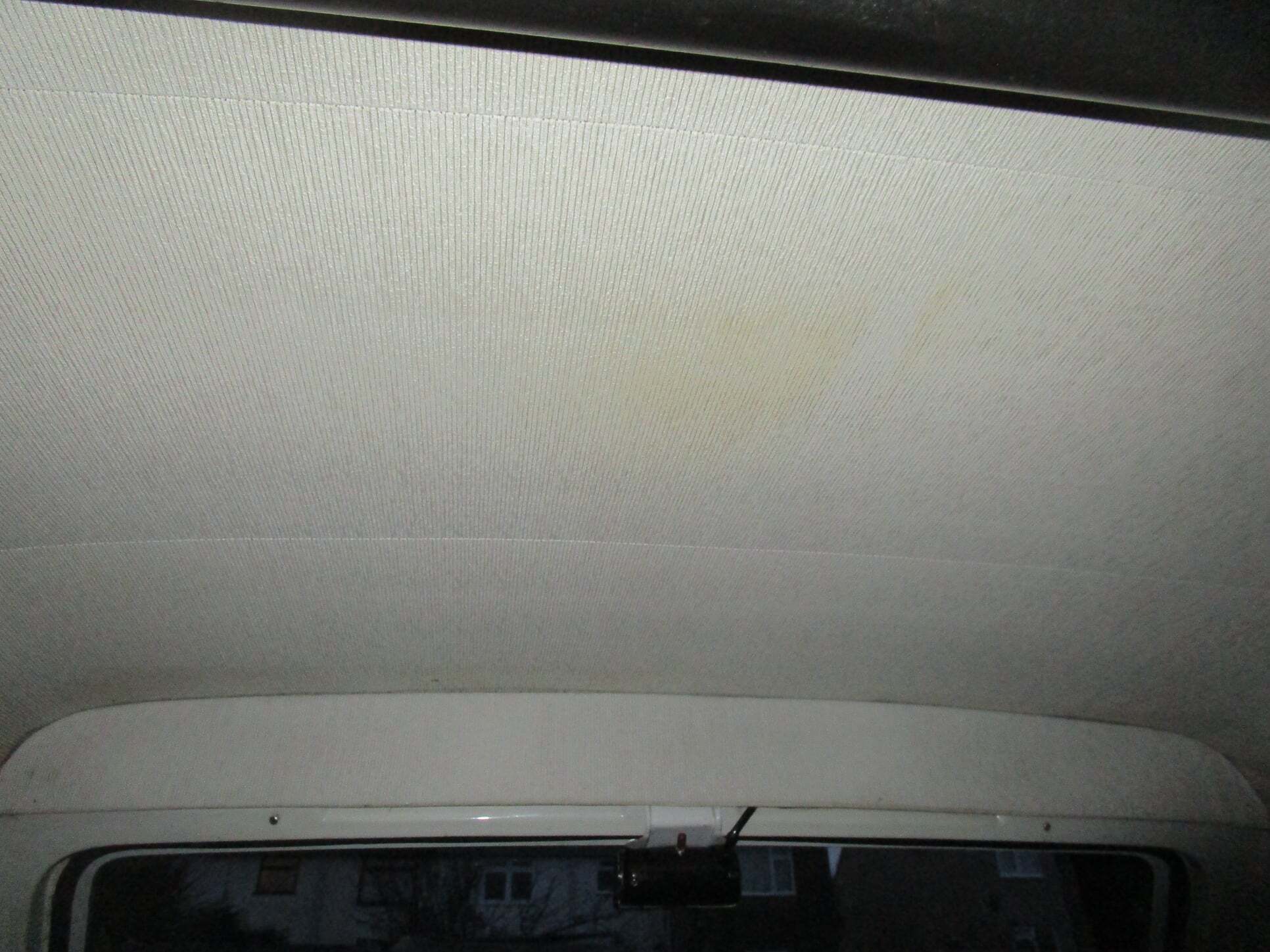

                      #40

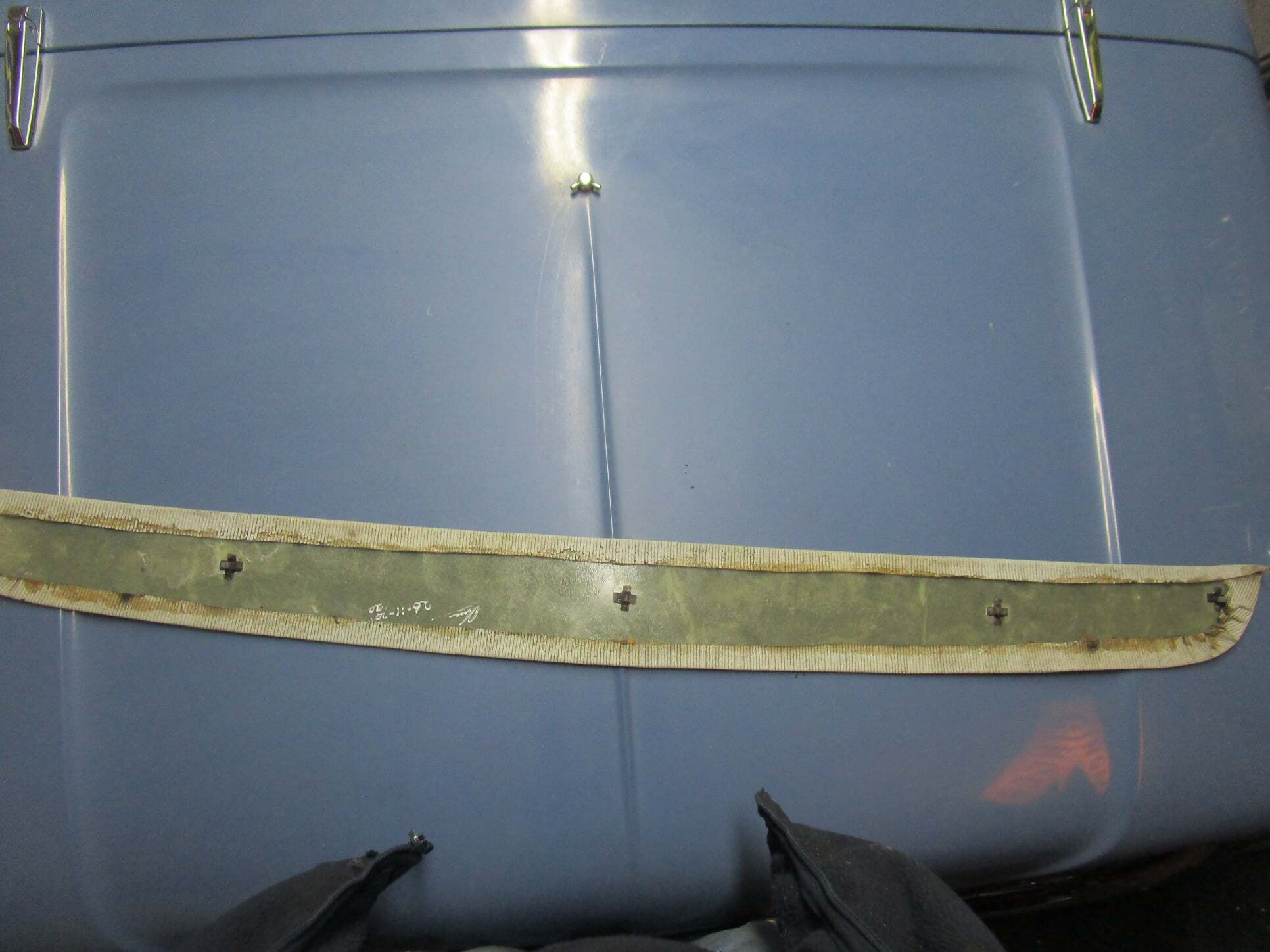

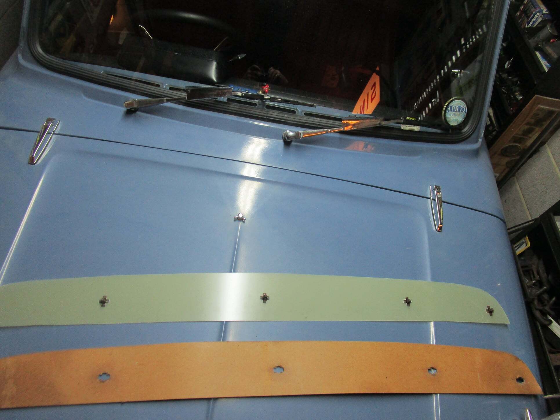

                      Repaired the rear roof panel , headining was coming off and the hardboard was warped quite bad .
                      I have some hardboard but went with a mega thin sheet of fiberglass which I covered in some 2mm closed cell foam to get the correct thickness .
                      Reused the original clips and headlining part.
                      Came out all right - no more warping one hopes

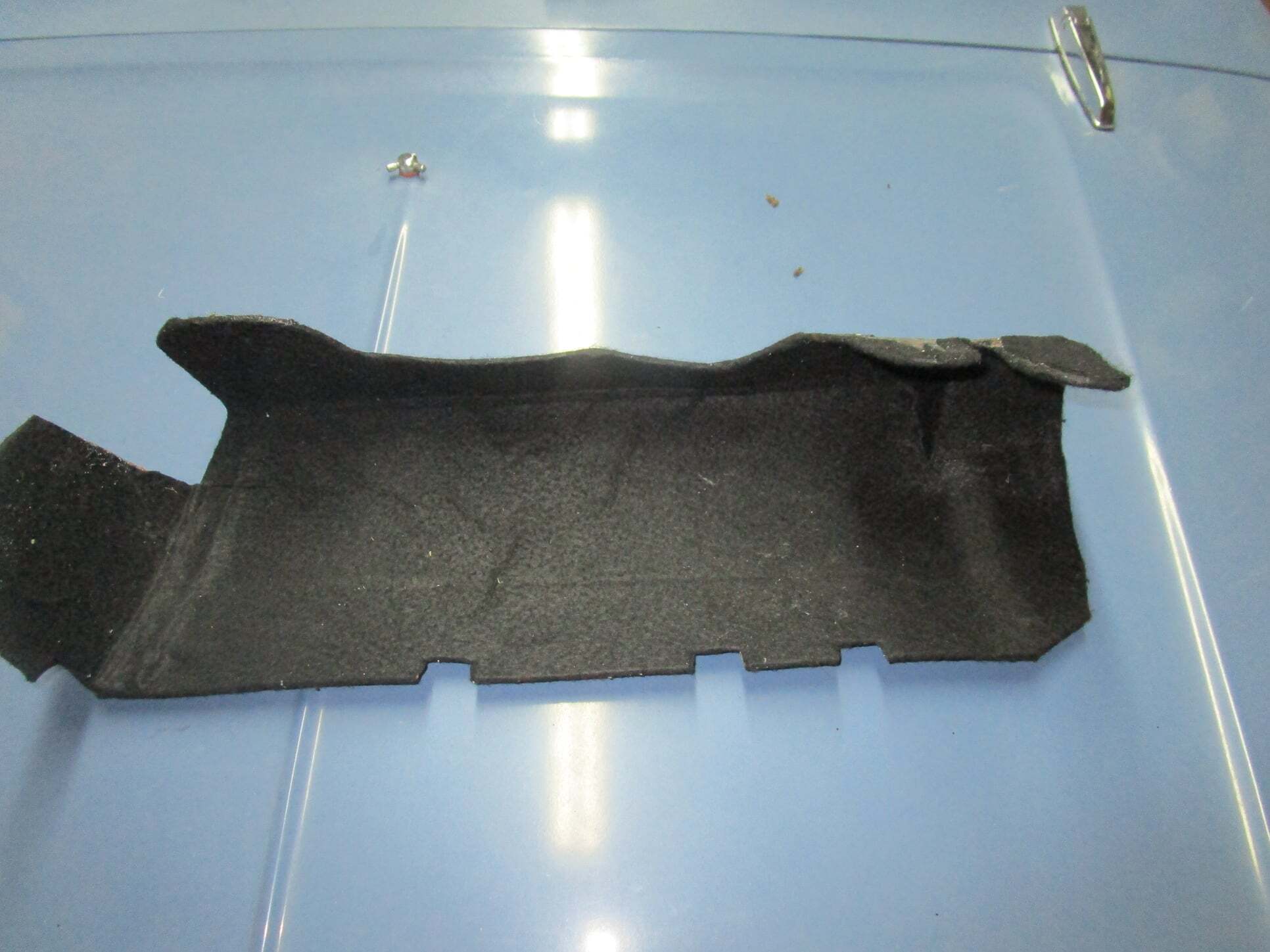

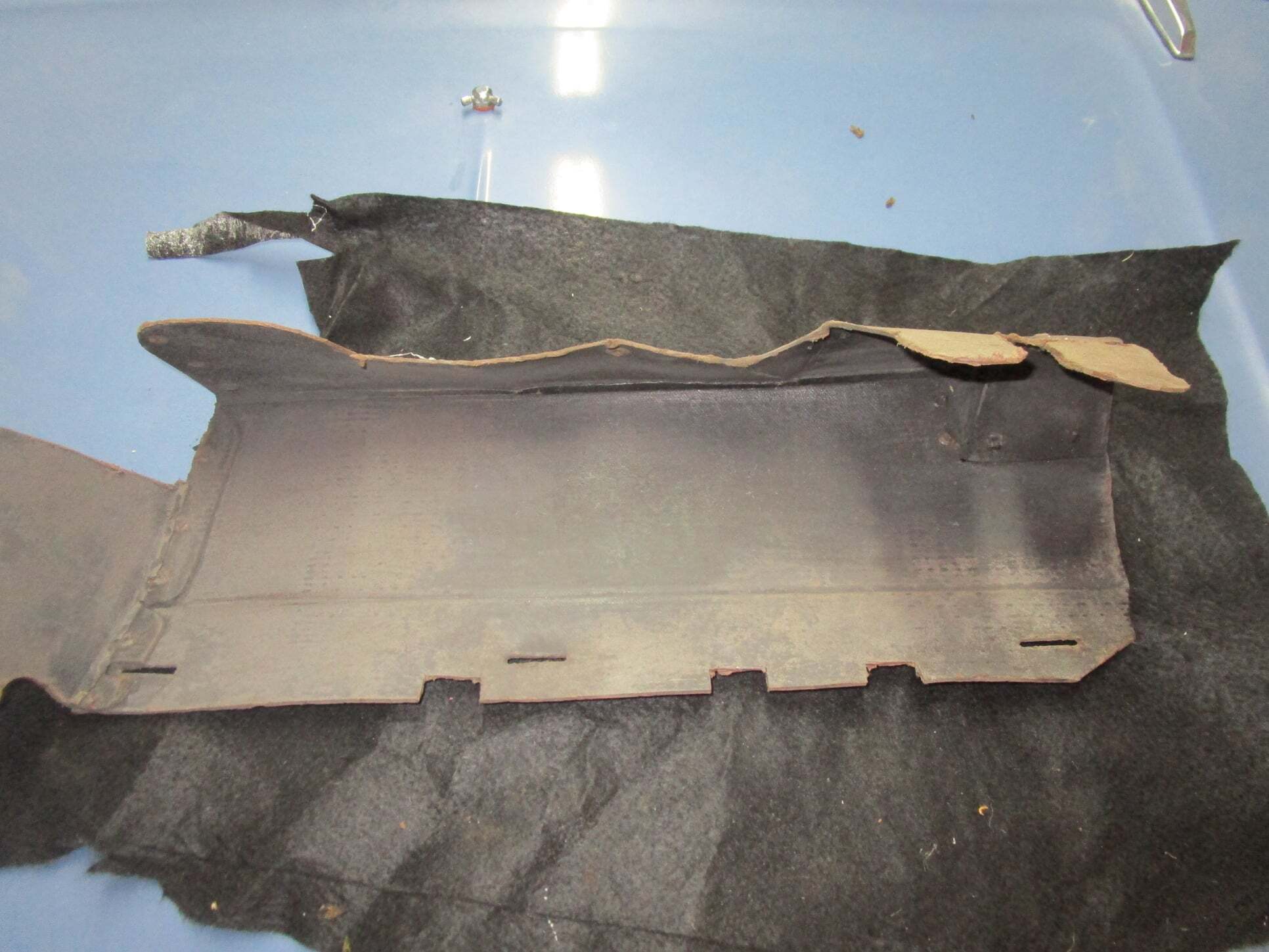

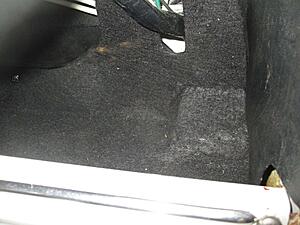

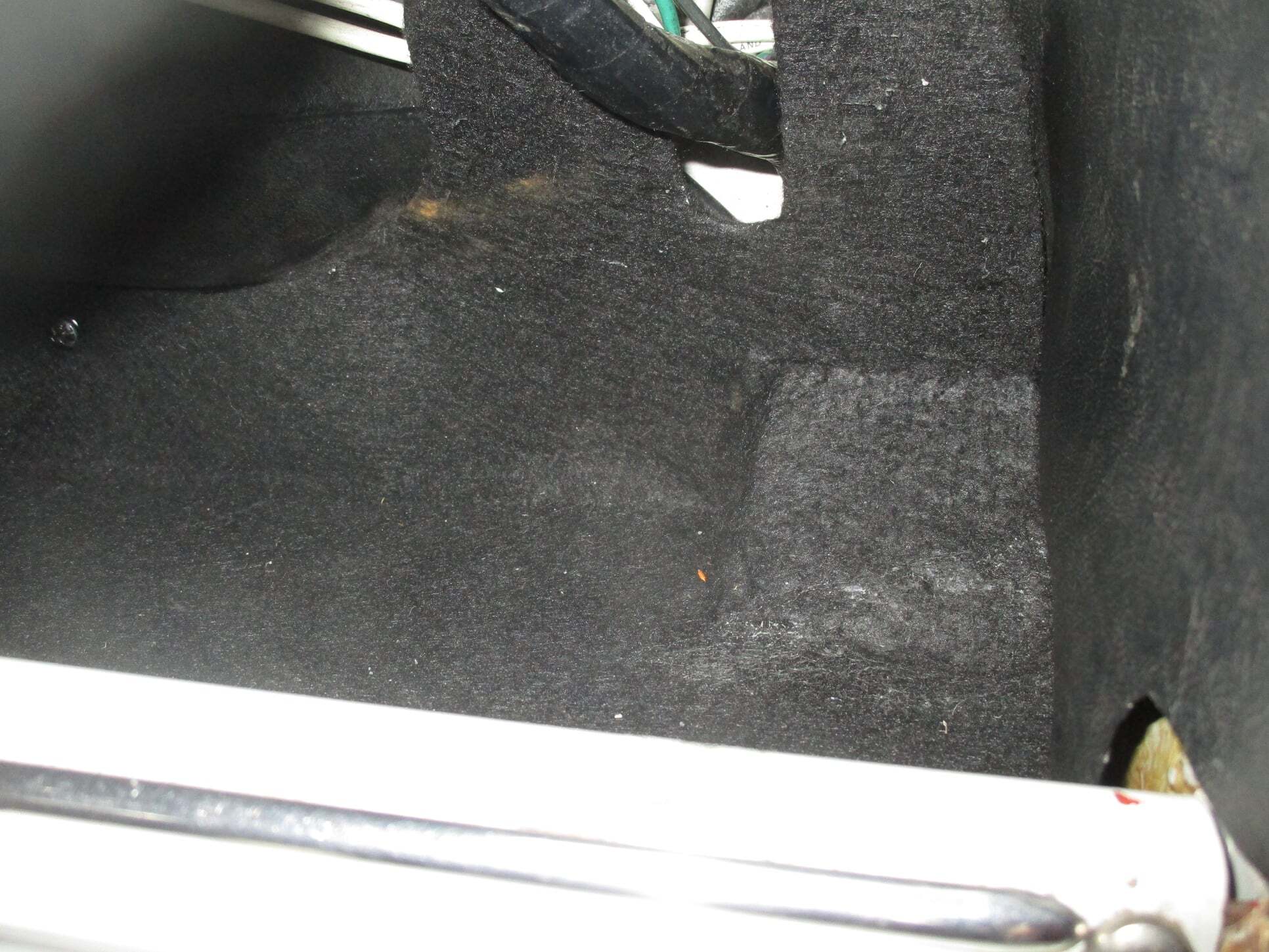

                            Final bit of interior titivation
                            Redo the drivers side parcel shelf
                            Getting it out is one thing - getting it back back in was even more of an arseache

                              #44
                              Dave, what did you cover it with ?
                                • 846
                                #45
                                Its very thin felt like stuff i cut from the back of a Ford Focus bottom boot carpet
