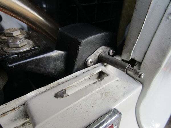

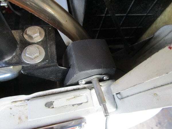

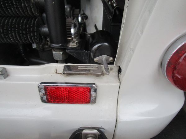

    Bored today so made a new cover for the engine bay light switch
    This time from metal :)

    Old one was a bit of tatty plastic

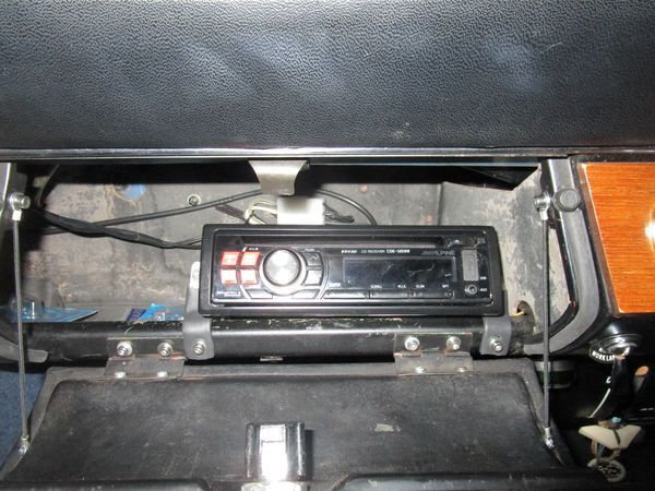

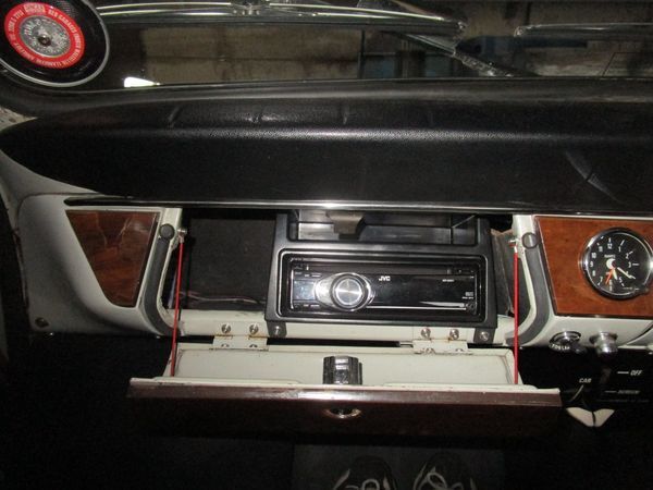

          Sorted out the Singers radio mount .
          I thought on the factory car the glovebox lid screws were captive - WRONG
          Bloody are now though - redone the radio mounting set up , all now done using rivnuts - even on the straps .
          So both cars now sorted on this front and fully rivnutted , Vuskys is poverty spec , Singers has a posh radio surround and colour coded straps .

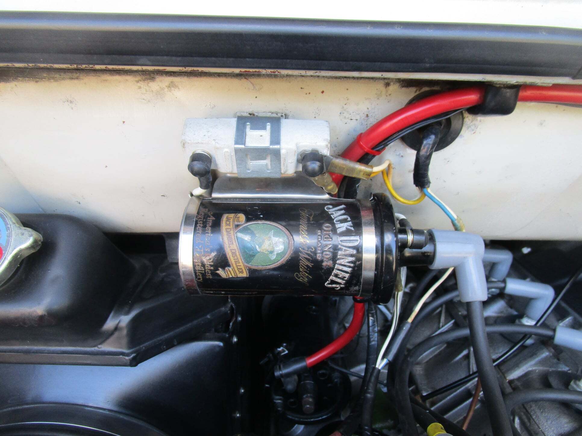

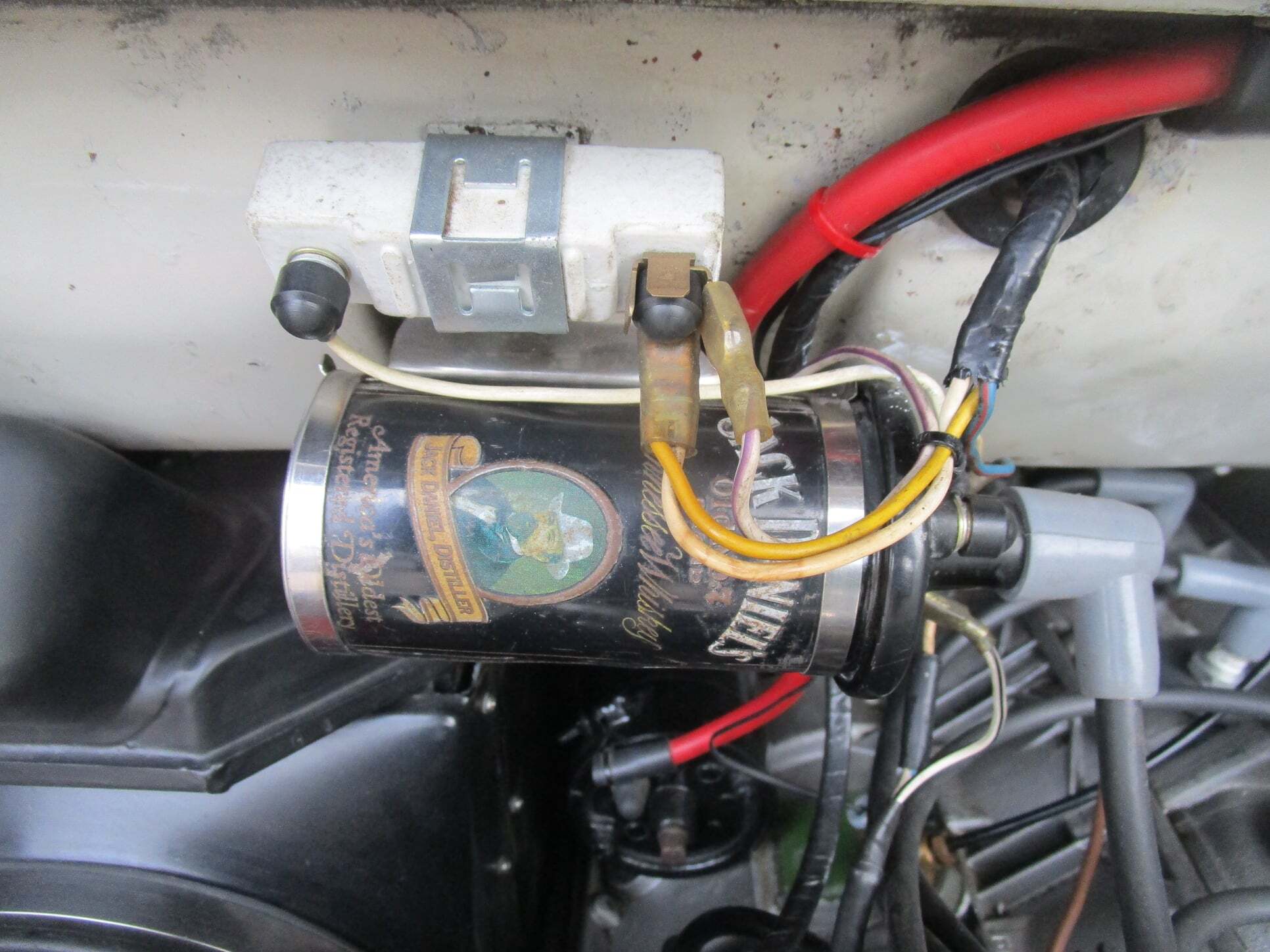

              Tidyed up the wiring around and near the coil . Set up is Mike Dents , 45,000V coil ballasted to run on 9V - therefor the points are 9V and last forever , condenser is under the coil and not in the dizzy , by far and away the best set ive ever had
              As it was
                • 4843

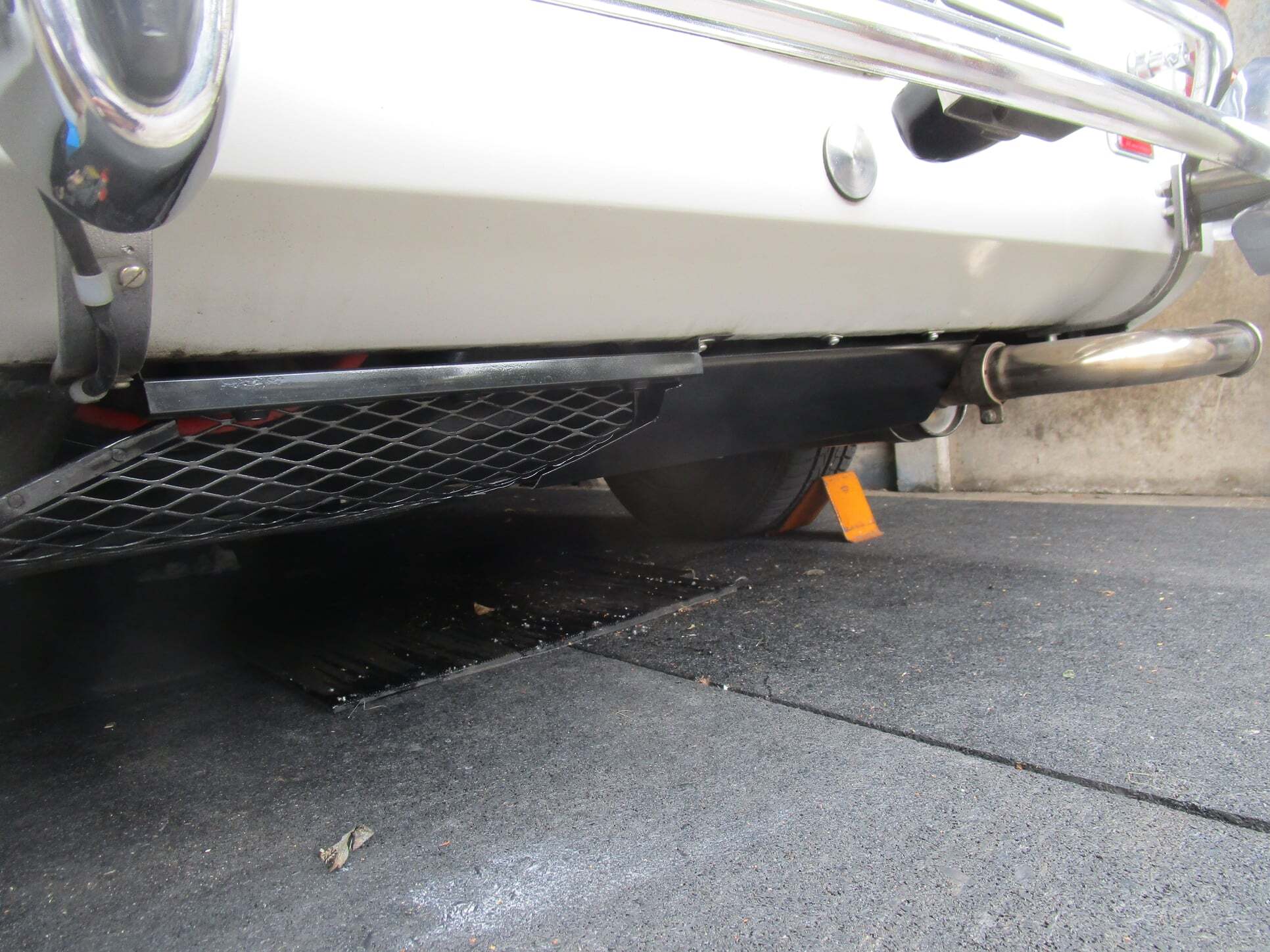

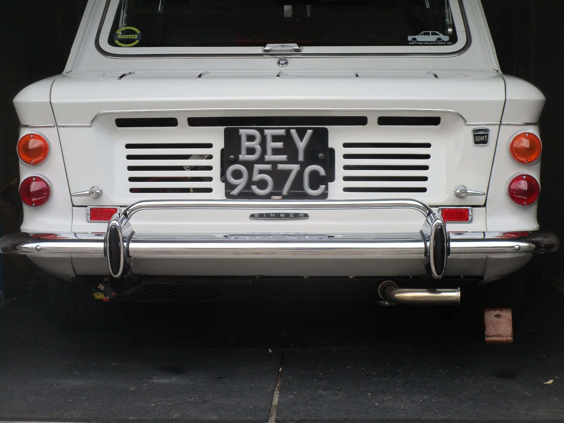

                  Made a new " hide all the entrails panel and added a bit on the end
                    • 4843
                    #99

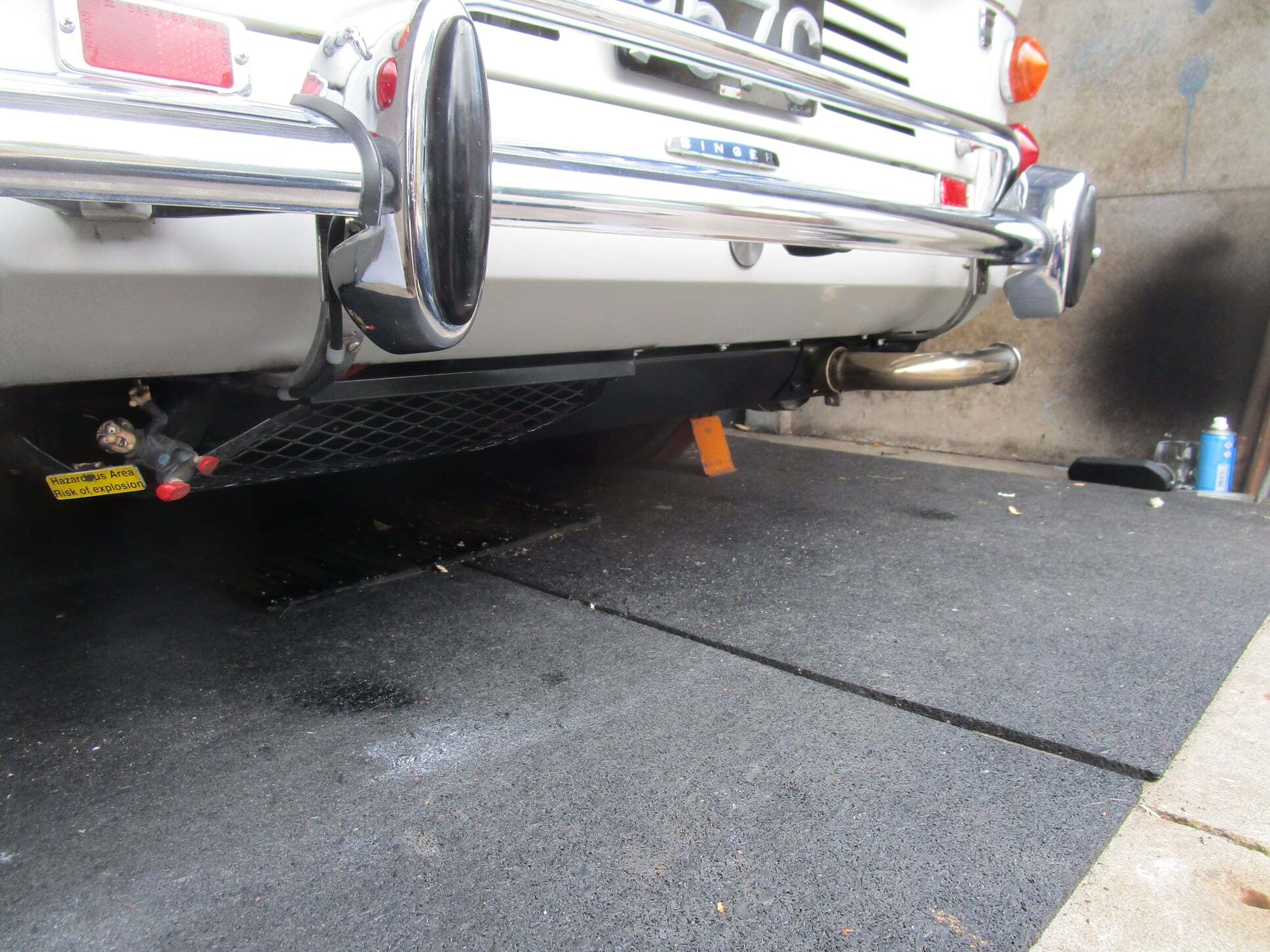

                    I wondered what the orange bit was Dave at end of exhaust, been staring for ages and just realised its the wheel chock and I need to go to spec savers
                    Very nice work
                      #100
                      Very nice work
                      i dont use the handbrake in the garage

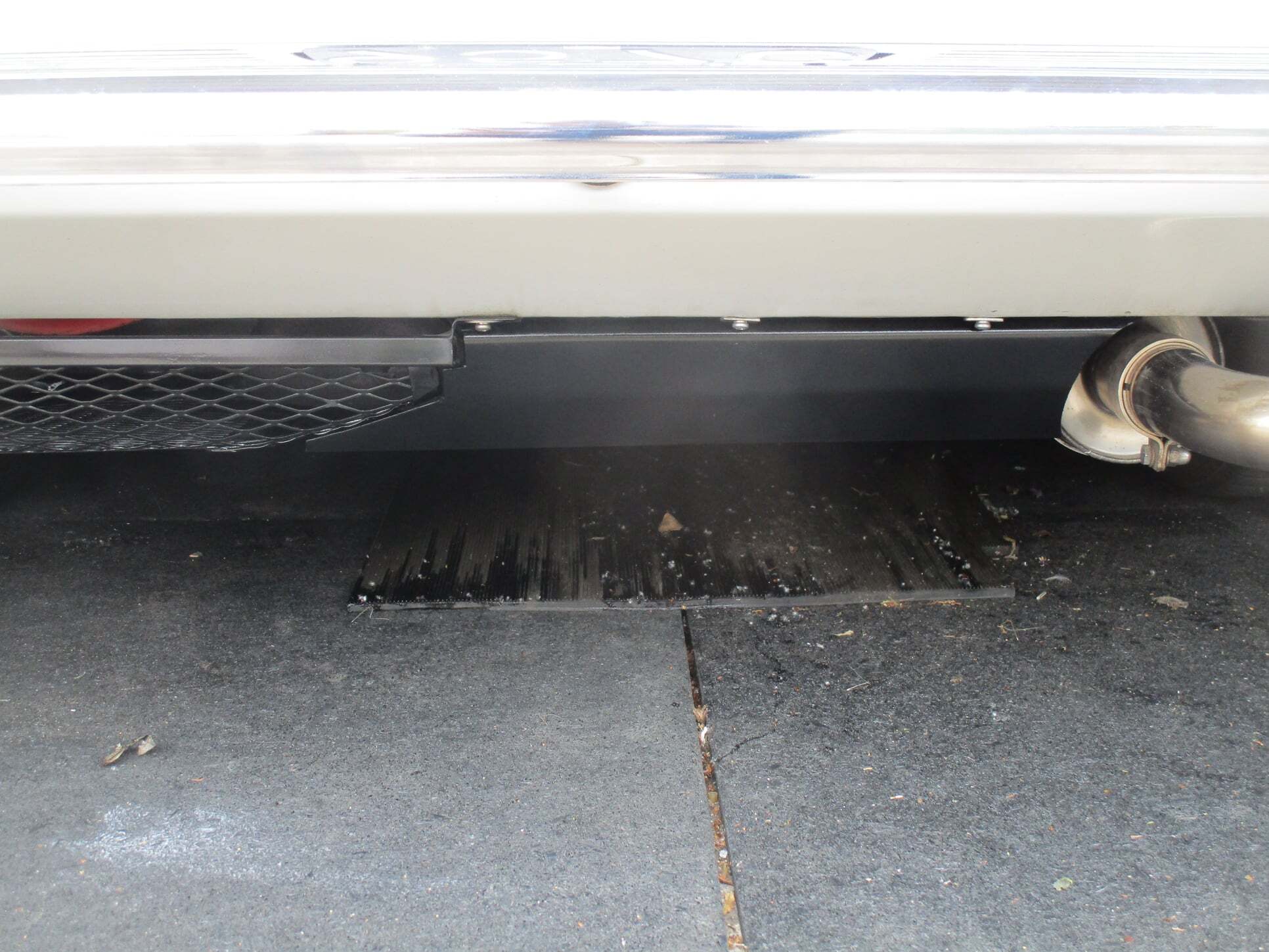

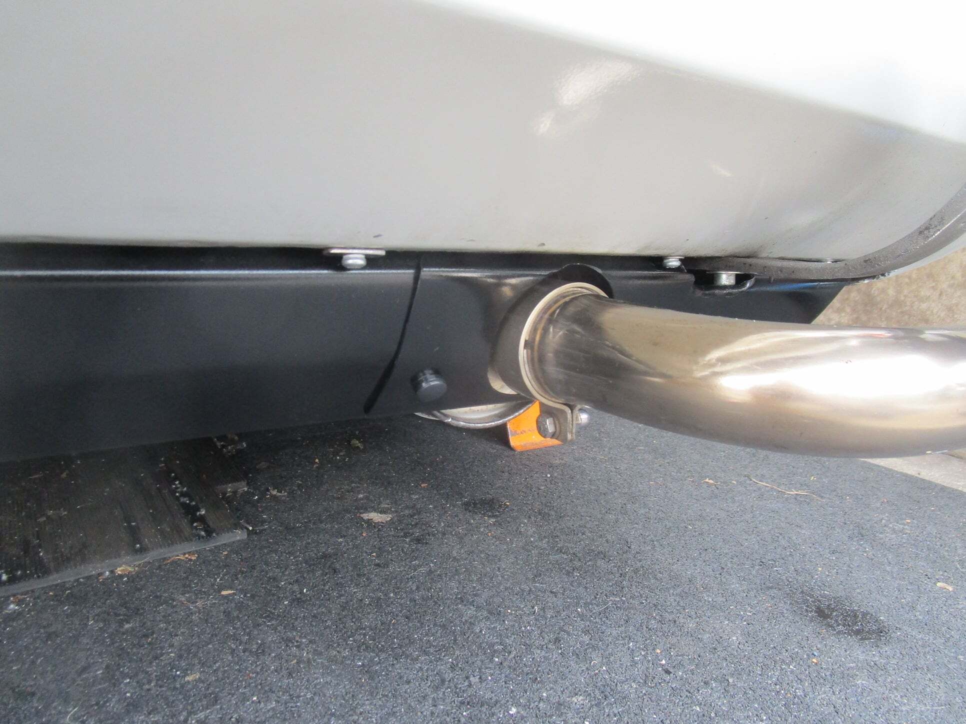

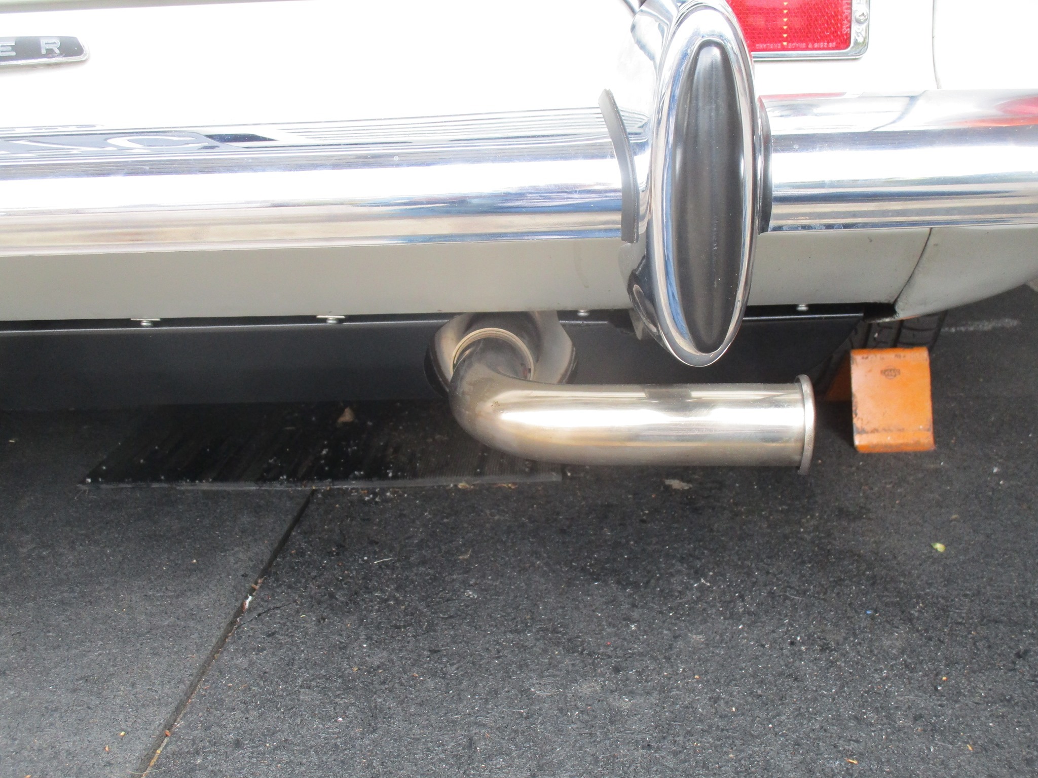

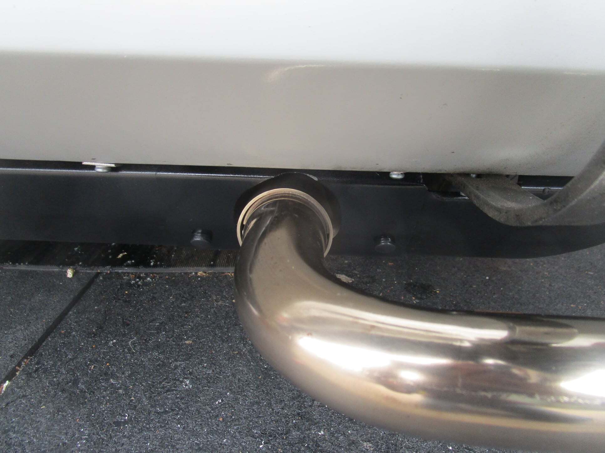

                        Final piece of the " hide all the guts panel " done .
                        Ive made a closing / link panel that covers most of the exhaust box .
                        IMHO it looks so much cleaner

                          #102
                          Looks very neat, great mod.
                          I always find it strange following an imp and watching the driveshafts.
