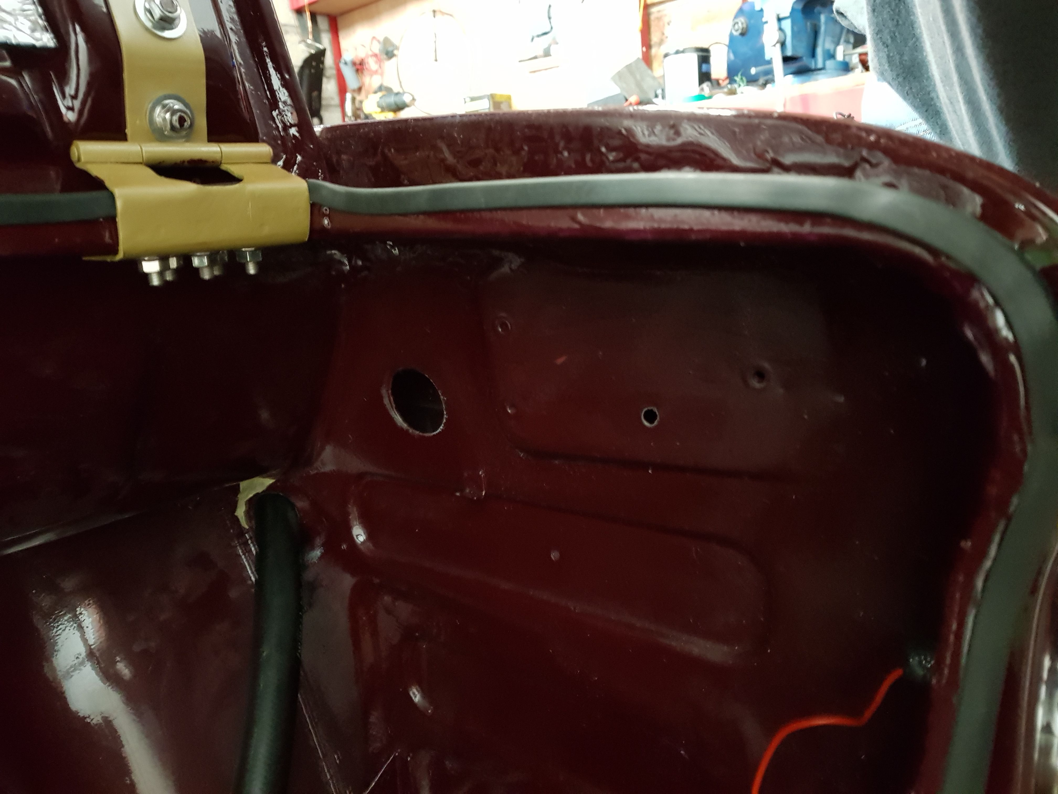

    Which is as I posted before as a drawing, sometimes it helps to relate the picture images (theory) to the real world. I have not crimped any of those connections as this is just a dummy but bear in mind that is an essential part to get right.
    As you can see there is PLENTY space above the battery with the RB340 box removed. This is the space left when nothing is in there.

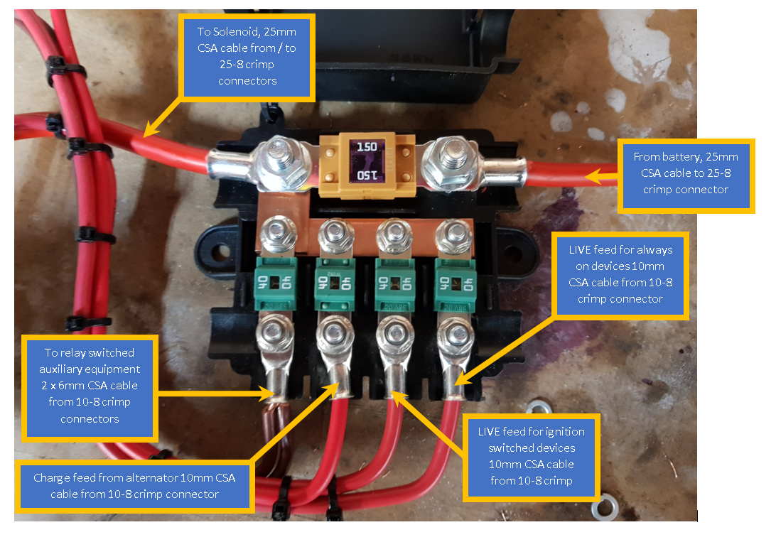

    This first part of the 8 articles covers how i will be adding fuses into the engine bay of DDG220C (see restoration stories) which I am currently restoring and wiring is up next and is an evolution over JDL889F (again see restoration stories) .
    So thought I would share the thinking up front in snippets as the ideas can easilly be applied on a case by case basis to standard imp wiring in places of the RB.
    The wiring assumes an alternator which is really a must have update.
    From the battery terminal we enter the fuse box using 25mm csa cable into a 25-8 crimped spade. (25mm ca sa - 8mm hole = 25-8 ) .
    These connections need a solid crimp, hand crimps rarely do it and a hydraulic crimp tool tends to be needed, you can buy these leads ready made from many sources cheaply.
    From the other side of that main fuse there is another lead from a 25-8 crimp using 25mm csa cable to another 25-8 crimp which terminates on the solenoid. Again ready available
    made up.
    That leaves 4 sub fuses, although I show 4 x 40A fuses these should be rated to suit what they are supplying
Name:	fused install.png

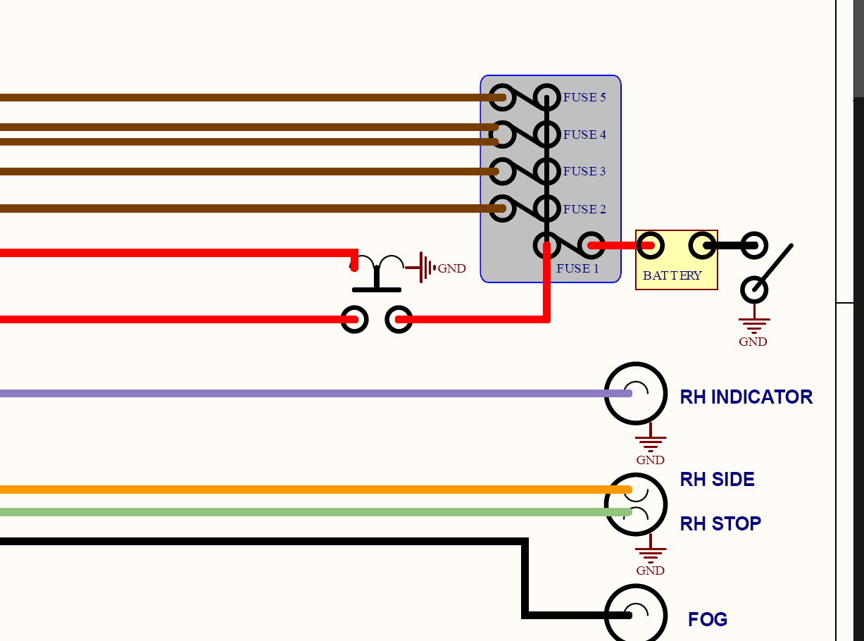

    This section matches up to the schematic drawings that will feature in the final article towards end of February

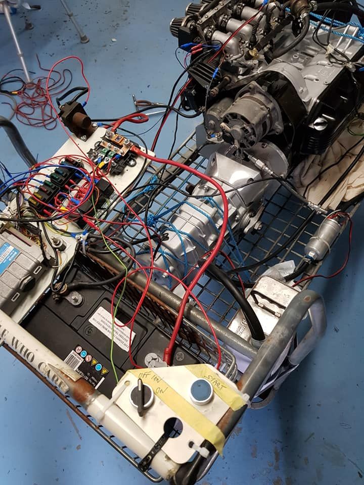

    Similar solution as used on a BMW Engine conversion
    Spot the fuse box and solenoid wired exactly as I would do it in an Imp

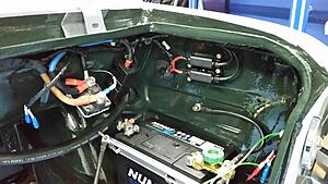

      And here is an earlier evolution in my green chammy.
      In this instance I used one mega fuse holder on its own but wired up the same, then two seperate midi fuses and holders for live and switched 12V feeds
      This one did not have the alternator fused. That one evolved after I seen an alternator wire chewed up and melt the cables !
