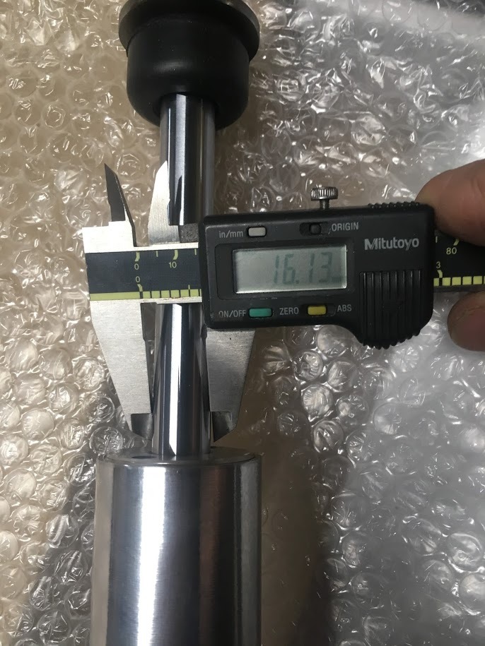

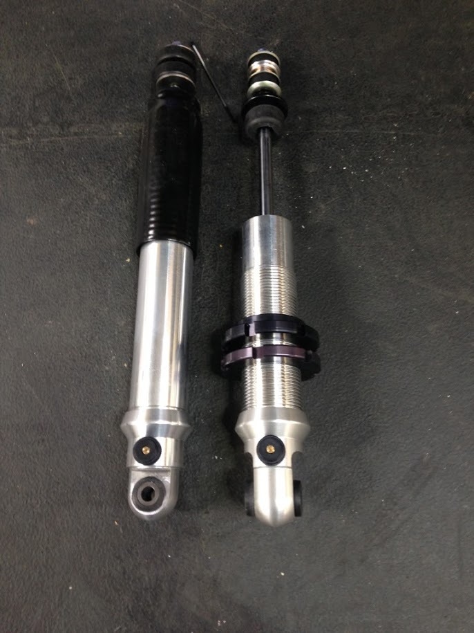

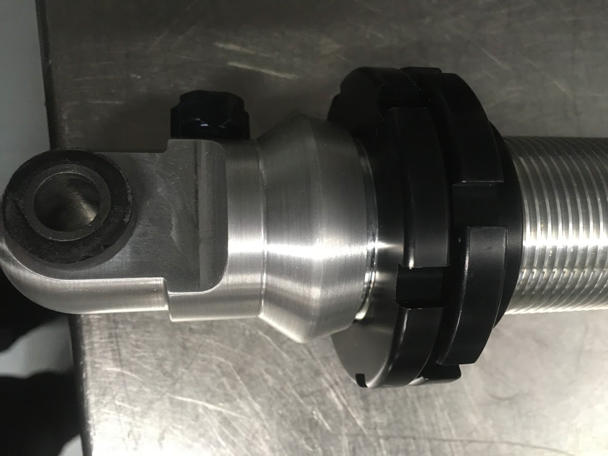

    Full car set of competition dampers based on what was considered the ultimate damper in its day the Koni. I have had Protech develop me a damper around these settings for bump and rebound with single way adjustable re-bound to keep the historic rallying period legal £520 plus P&P £15 to UK mainland.
    If anyone wants other specs like two way adjustable, shorter body etc please get in touch to discuss options. (pics to follow)

          Mike moose549 ??
            Hi Gert. They are based on the wide body damper spec as used by the works team and many people back in the day and then improved. The damper rods are thicker as per the proper Koni's so will not bend. You can have open and closed lengths as per standard and up to 2 inch shorter. Rears only £200 plus postage.
