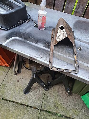

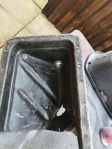

    Well the devils hands were at work today again plus I had to wait on the paint drying on the hatch

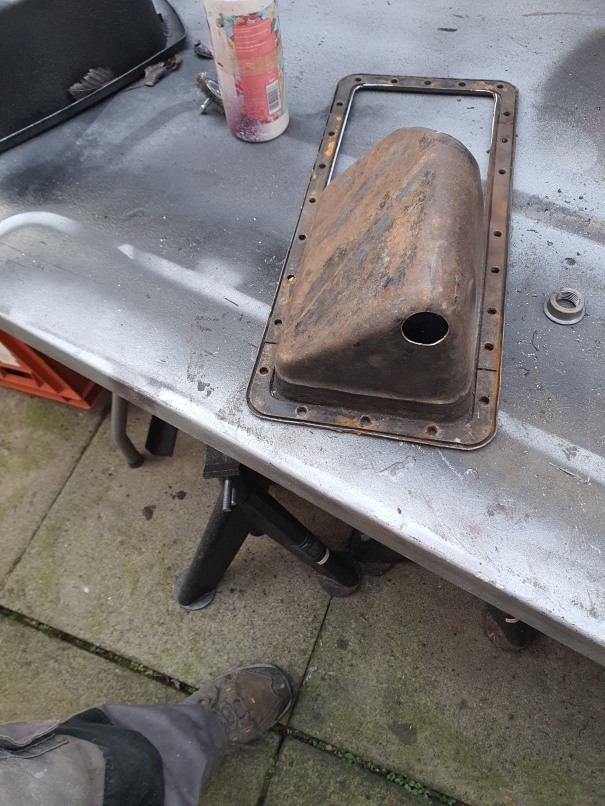

    The oil capacity externsion was easy enough but on these it was desired to move the oil filler plug from "front" to "back" in other words reverse what rootes originally did and make it like a MK 1
    Bob Picton kindly supplied the machined bosses and the sumps so I could have something to beat up and work on

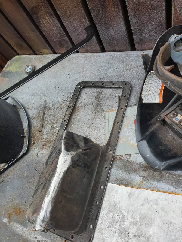

    First cut the end section out, not fully as these will be used with rear rad in palce so still needs the space for the coel and the rad itself.
    Click image for larger version  Name:	20220122_144844.jpg Size:	173.7 KB ID:	17835
    And off with the rear fille plug as well.

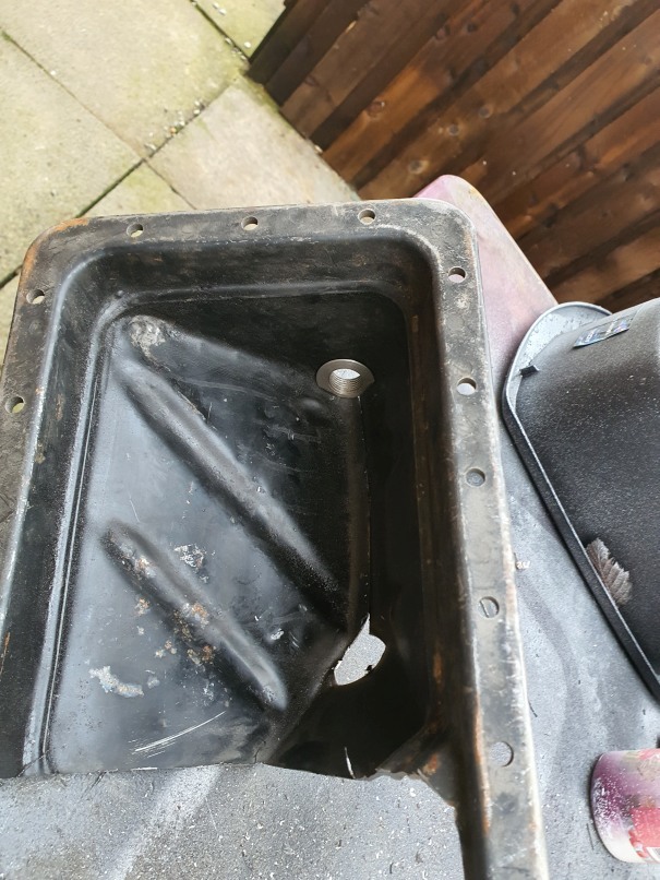

    Then drill front for new drain plug locations using the new bosses.
    Click image for larger version  Name:	20220122_150936.jpg Size:	147.0 KB ID:	17836
    Click image for larger version  Name:	20220122_145025.jpg Size:	138.6 KB ID:	17837
    Click image for larger version  Name:	20220122_144857.jpg Size:	153.9 KB ID:	17838

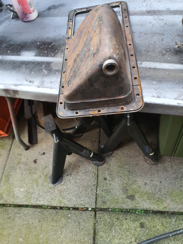

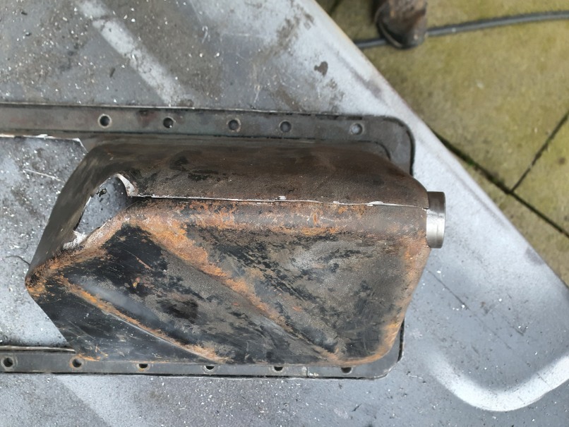

    And of course we should not forget on its apex the sump runs to the rear drain plug location so now a trim along the apax and some rough re-shaping to avoid gettinga pool of oil that will not drain
    Click image for larger version  Name:	20220122_152254.jpg Size:	168.1 KB ID:	17839
    Click image for larger version  Name:	20220122_152250.jpg Size:	173.6 KB ID:	17840
    Click image for larger version  Name:	20220122_150944.jpg Size:	142.5 KB ID:	17841
    And that should be most of the roughing work done maybe perhaps
    If its a good day tomorrow I might get some welding done and get at least the drain plugs and the apex seam/old plug location sorted out

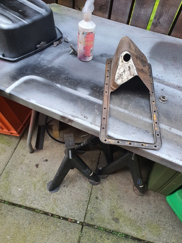

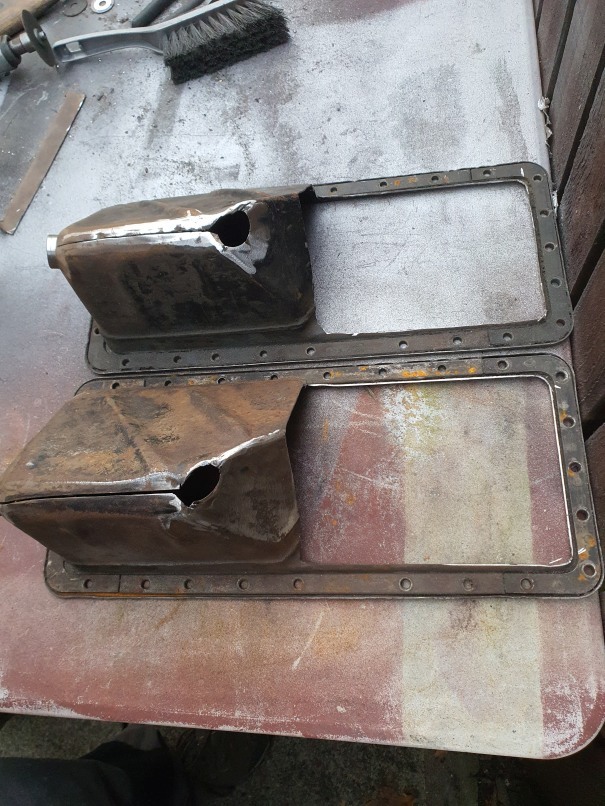

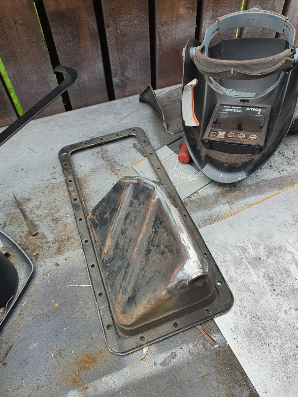

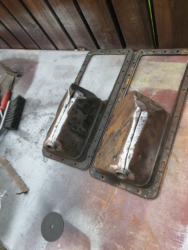

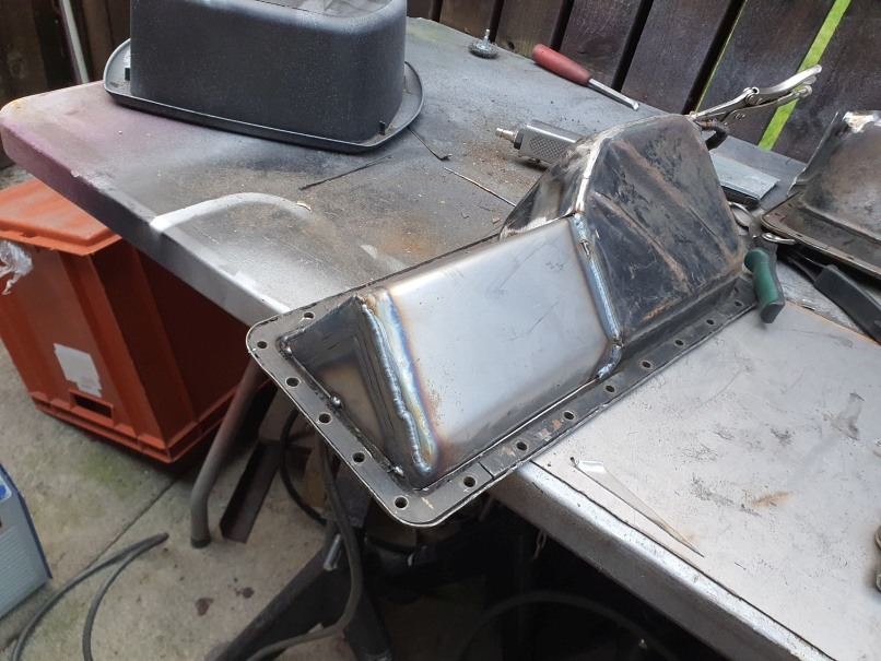

          Bit more done today, seams on both and boss welded in (boss a bit ugly but will do)
          Sheet metal in place for first one, started getting a bit cold so thats it for today

            Plenty of oil capacity in the sump now John. Looking good.
              Suprising how little Colin, I reckon only an extra litre and a bit maybe ?
              Once I have the outside up I will think aboyt the baffles, cannot make mind up on flaps or holes
                That's a decent enough increase in capacity is it not John? Will surely make a difference in the oil keeping cooler as well I would imagine. Baffles will be required no doubt, more work in doing flaps than plate with holes in it.
                  For teh flaps I was just going to use the nibbler and fold, just enough to stop it going all way forward on break and reasonable on accel
