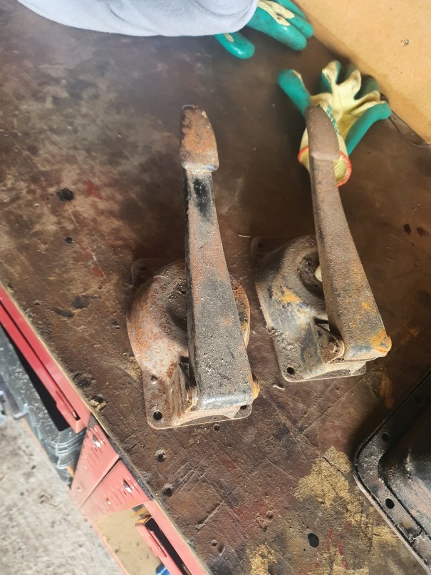

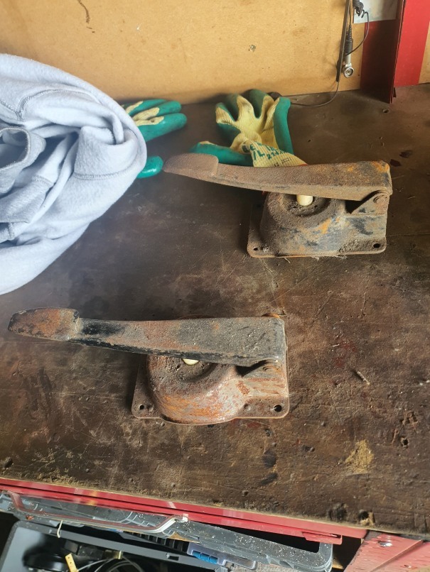

    I have quite a few of these pedals but as I do, the worst of the bunch was picked to see how they fair. It always surprised me how bad things can look yet still be of use with a little TLC.

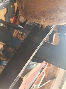

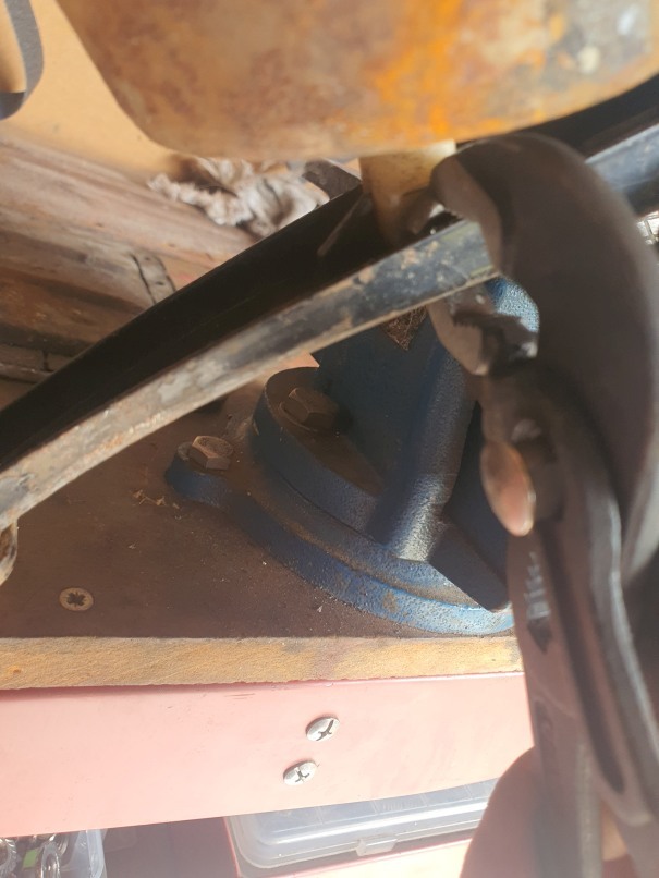

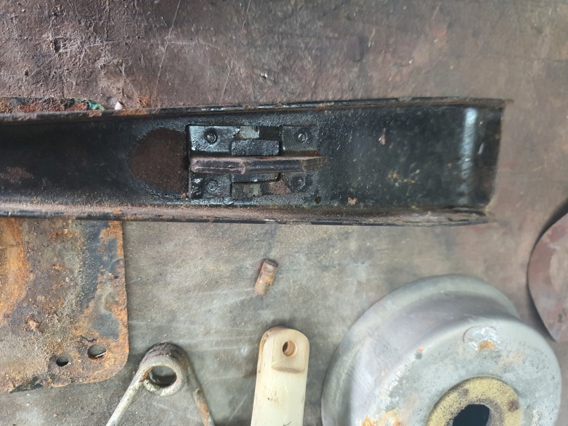

    Biggest issue I found was getting the pivot pin out, a pair of pliers and a loose nut manage to get past the lip to bend down the retaining lug and out it came with a small tap
    A closer look, its not a clip, it is a bent retaining tang, not a particularly elegant solution

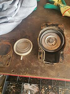

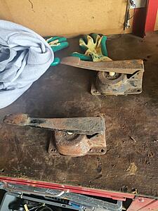

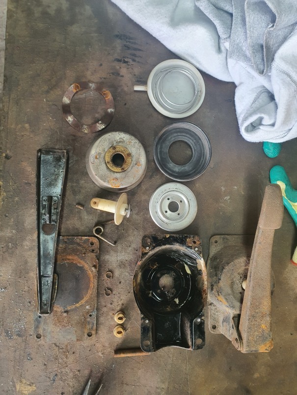

    And some of the pedal in some states of tear down.

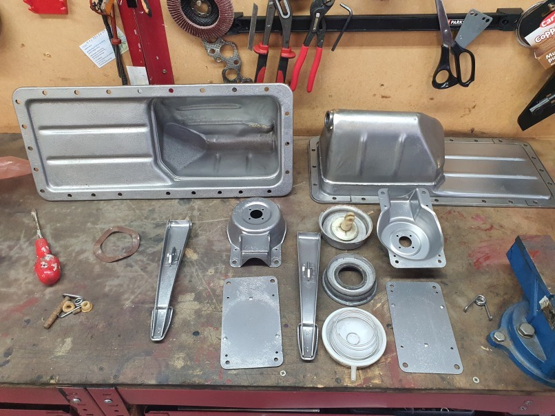

    The metal work was in a terrible state and the coatings falling off on the inside
    And finally as I do not have any blast capability, off they went for vapour blasting, local company starting out and did a great job.
      Some NOS parts (diagphram and seating cup)

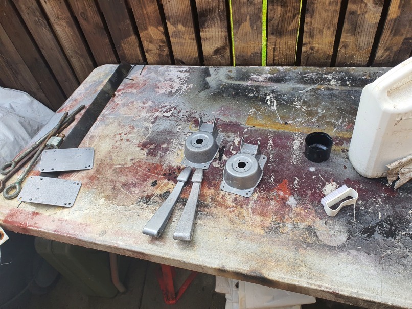

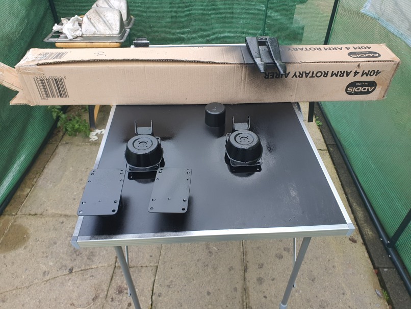

      Steel parts although vapour blasted also give a small bake/heat up and then washed down with some zinc phospate solution to kill anything in the pits and crevices then a light coat of zinc primer applied to some lifghtly warmed metal.
      Then a coat of matt black enamel paint out a can.
      Usually I would do a single coat 2K epoxy but this is pretty low exposure where it is and I prefer to keep the coatings thinner.

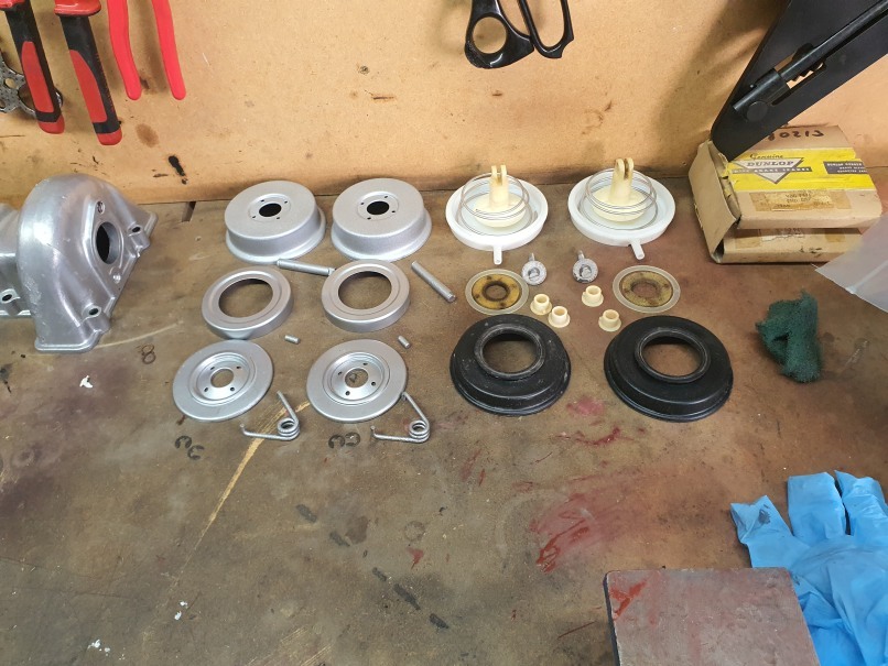

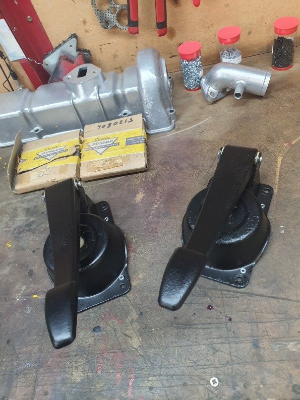

      Now thats the parts all lined up, cleaned the other parts sorted out, ready for re-assembly
      I just need to find some straight blind rivets to match the old ones, call me particular but I would like it to have the same crappy rivet finish as factory even if some nice stainless ones would do the job a bit better.
        Parts ready for re-assembly, it is truly shocking how long all these little detail parts take to do
        A quick scuff up and final coat of satin black, leave for a few days in warm just to make sure its well flashed off.

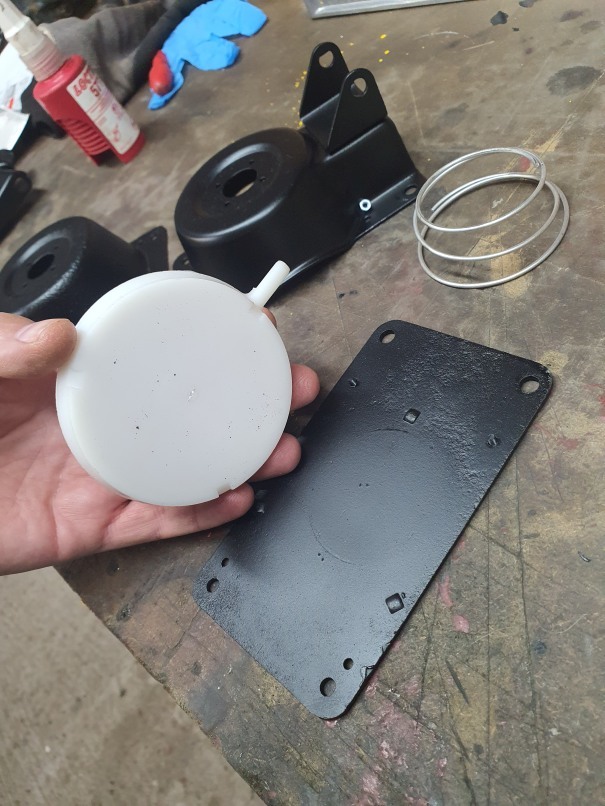

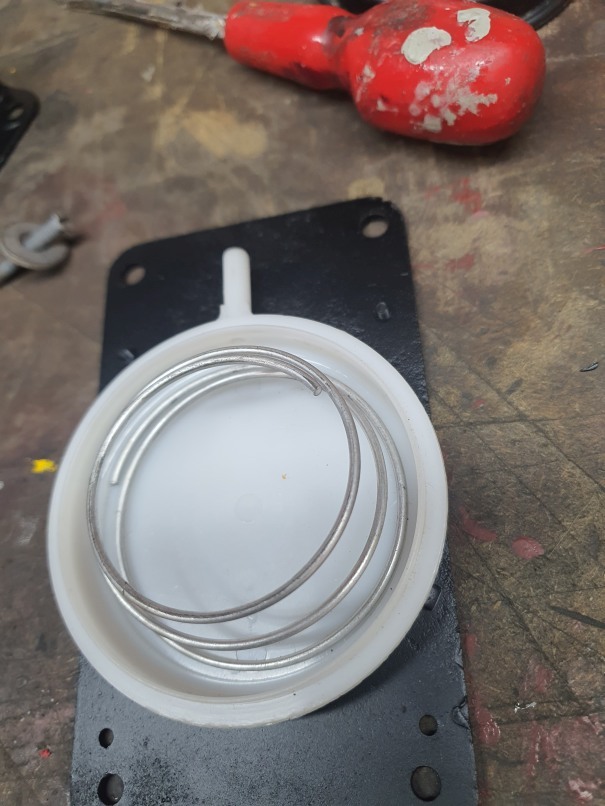

          Not an easy thing to re-assemble, the parts manual, like many other drawings, does not actually show the parts in assembly order adding to confusion. The woerkshop manual sectional drawing is correct and we have a pair of these assemblies that use the spring ring rather than the rubber seating ring
          First base correct way up, there are 3 stepped notches on the base, these locate the bottom plastic section of the bellows and the single one in line with the end is the exit for the bellows
          Click image for larger version  Name:	20221018_203402.jpg Size:	127.1 KB ID:	20251
          Click image for larger version  Name:	20221018_204023.jpg Size:	103.2 KB ID:	20250

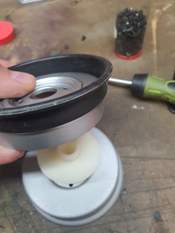

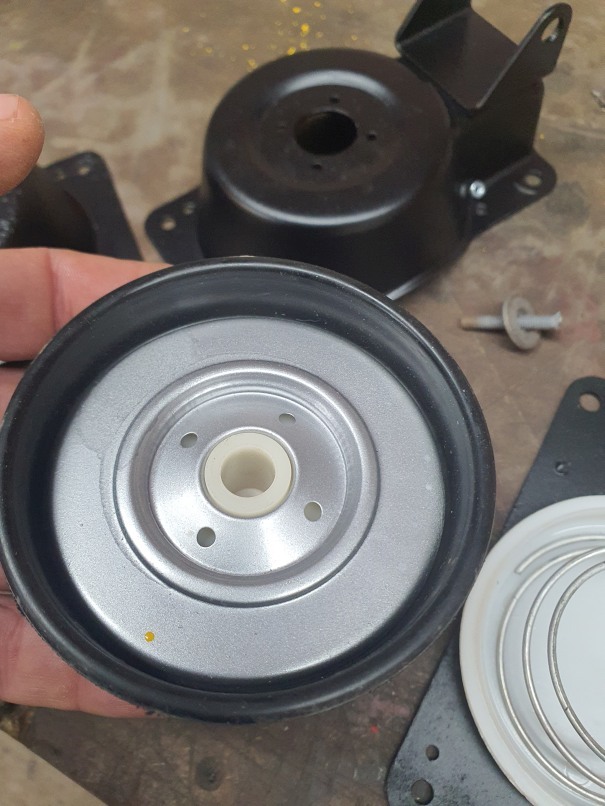

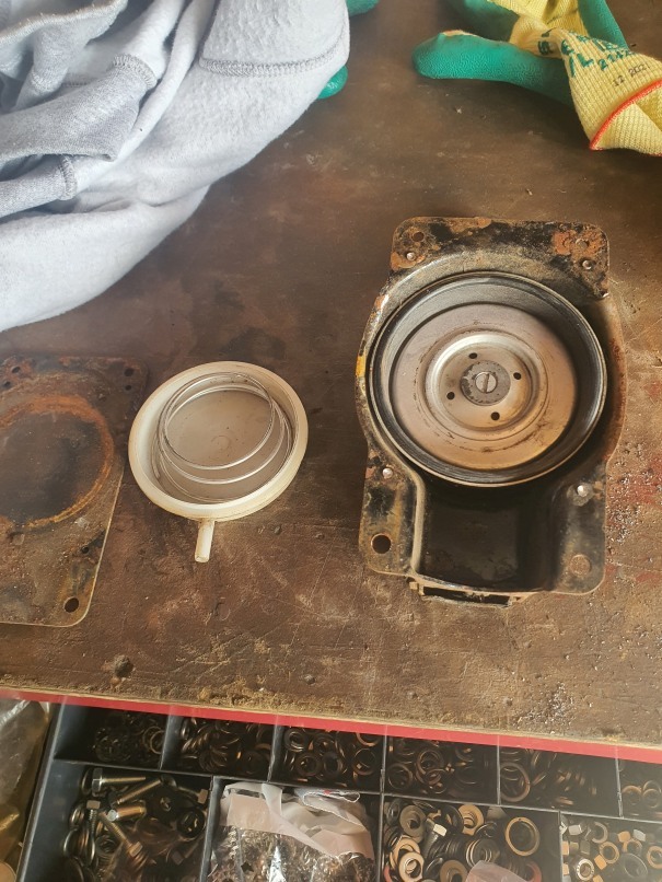

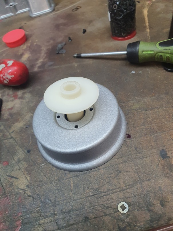

          Next up assembly of the upper section of the bellows which contains several parts
          There is the rubber section, a locating plastic ring and the metal flange that sets its primary position.
          Note the plastic locating ring has a ridge, this faces UP and the upper metal ring floars around the recess with the ridge keeping it away from the rubber
          Click image for larger version  Name:	20221018_203458.jpg Size:	84.2 KB ID:	20252
          Click image for larger version  Name:	20221018_203448.jpg Size:	146.6 KB ID:	20253
          Click image for larger version  Name:	20221018_203529.jpg Size:	81.7 KB ID:	20255
          Click image for larger version  Name:	20221018_203700.jpg Size:	118.7 KB ID:	20254

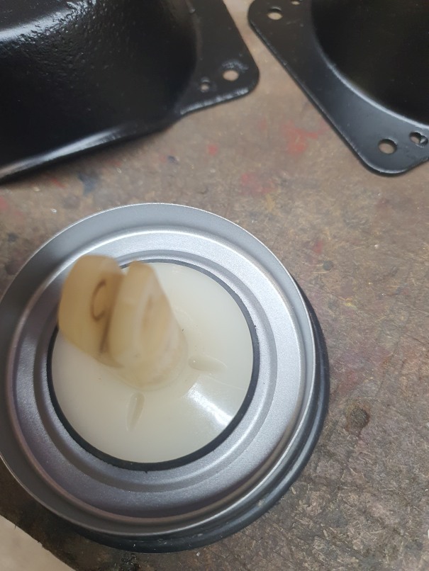

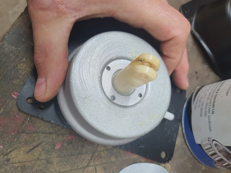

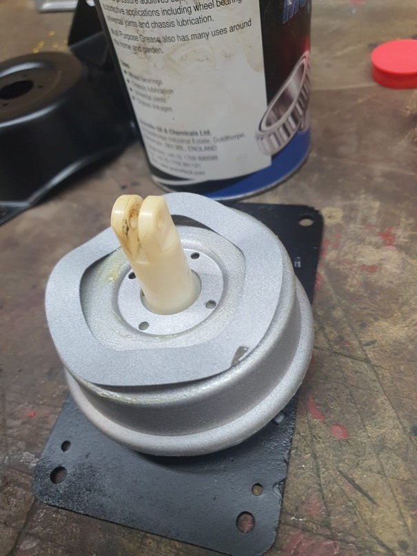

          Next is assembly of the piston which is easy enough and in order below and with this step you see how it works a little better
          Click image for larger version  Name:	20221018_204135.jpg Size:	109.4 KB ID:	20263
          Click image for larger version  Name:	20221018_204112.jpg Size:	116.6 KB ID:	20262
          Click image for larger version  Name:	20221018_203830.jpg Size:	99.9 KB ID:	20261
          Click image for larger version  Name:	20221018_203844.jpg Size:	110.3 KB ID:	20260
          Click image for larger version  Name:	20221018_204129.jpg Size:	77.8 KB ID:	20259

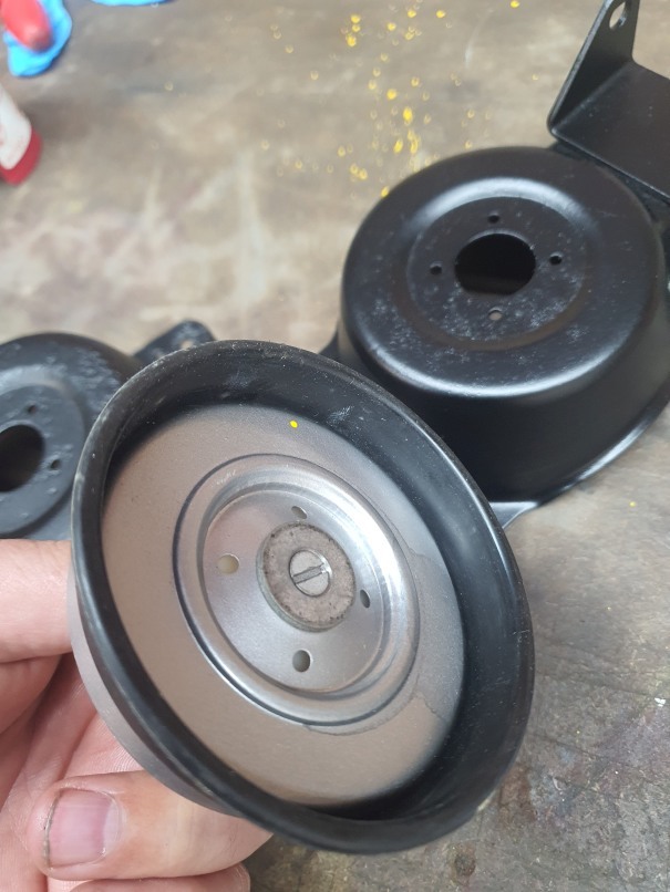

          Before you tighten that screw it MUST be tight BUT BUT BUT do NOT put too much force in it as it is seated in the plastic plunger and its not a metal insert, its just plastic threaded
          Click image for larger version  Name:	20221018_204211.jpg Size:	98.5 KB ID:	20258
          Click image for larger version  Name:	20221018_204125.jpg Size:	128.7 KB ID:	20257
          Click image for larger version  Name:	20221018_204215.jpg Size:	103.3 KB ID:	20256

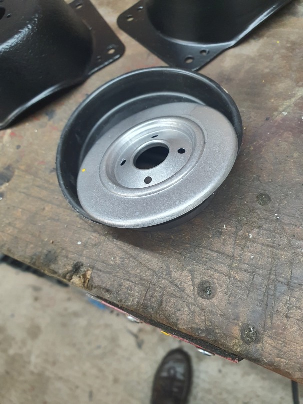

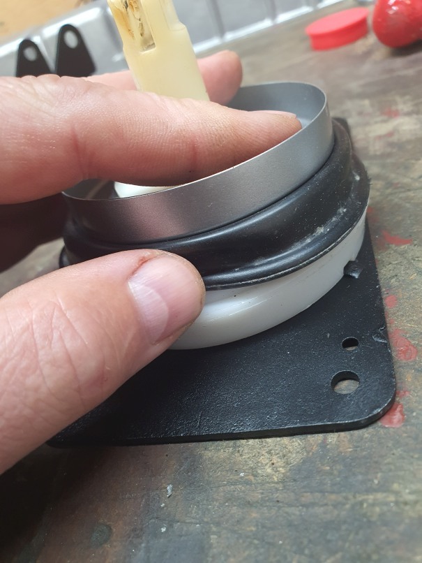

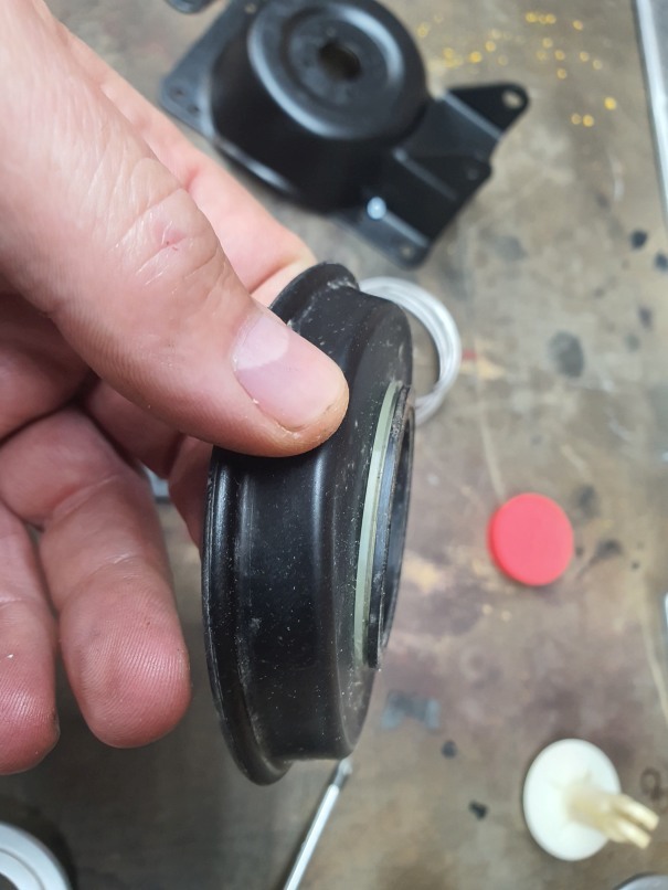

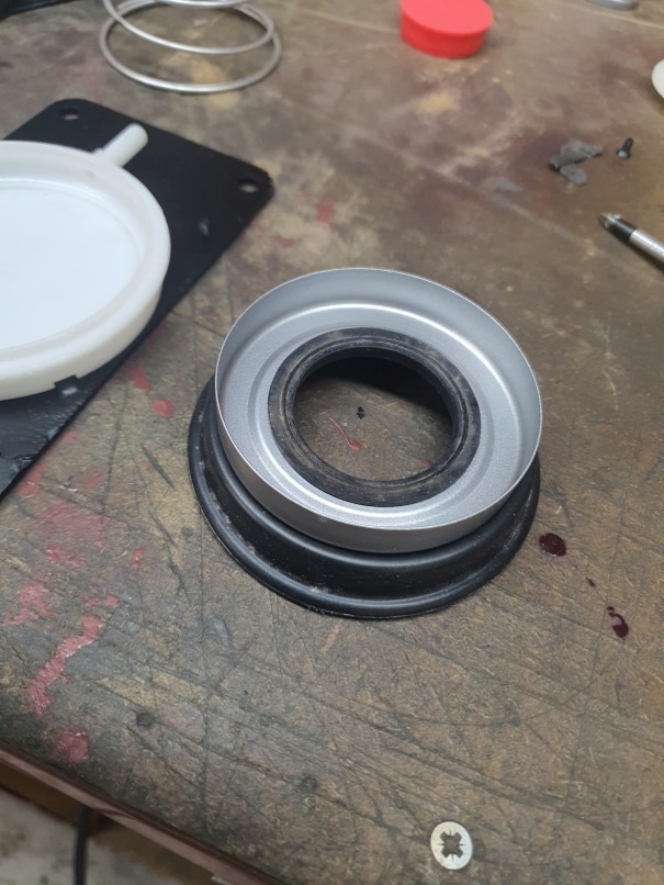

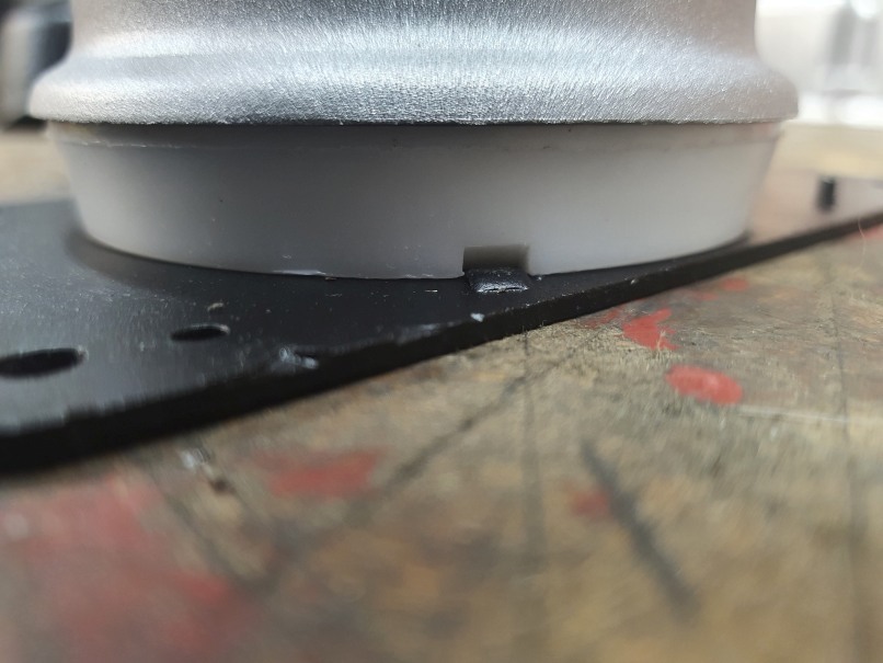

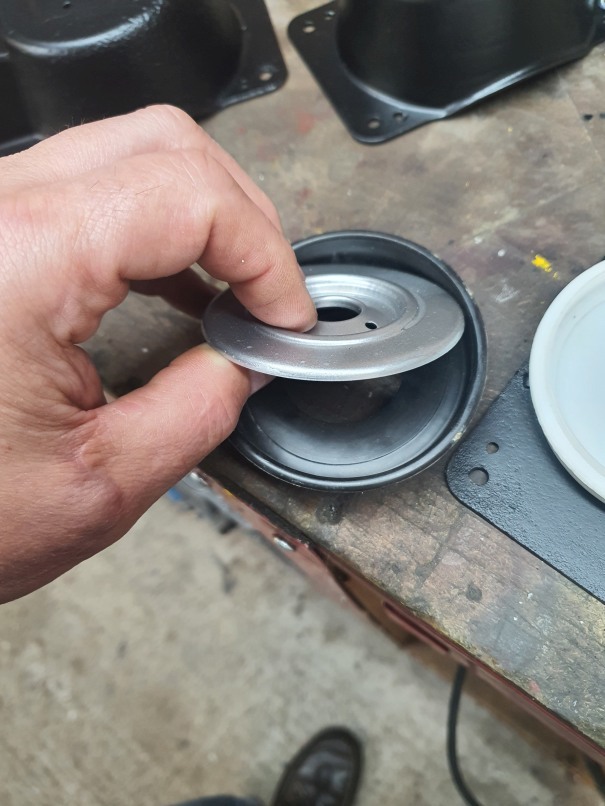

            Now the next bit is quite important, the plastic base of the bellows has a very small lip for the upper rubber part to seat onto and the metal cover holds that in place
            So its really important that it does seat correctly and be held in place
            I find it arkward but better to hold the plunger down while seat it as the upper bellows stay in place.

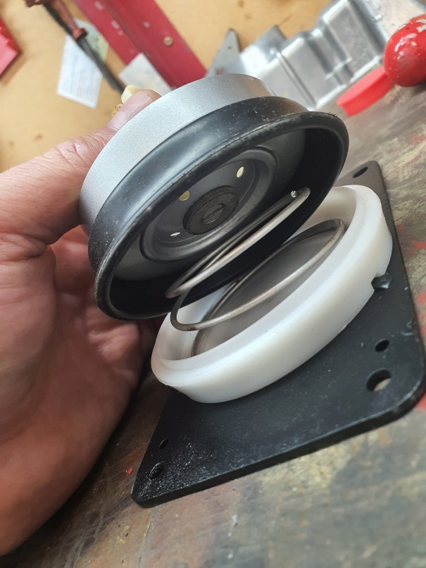

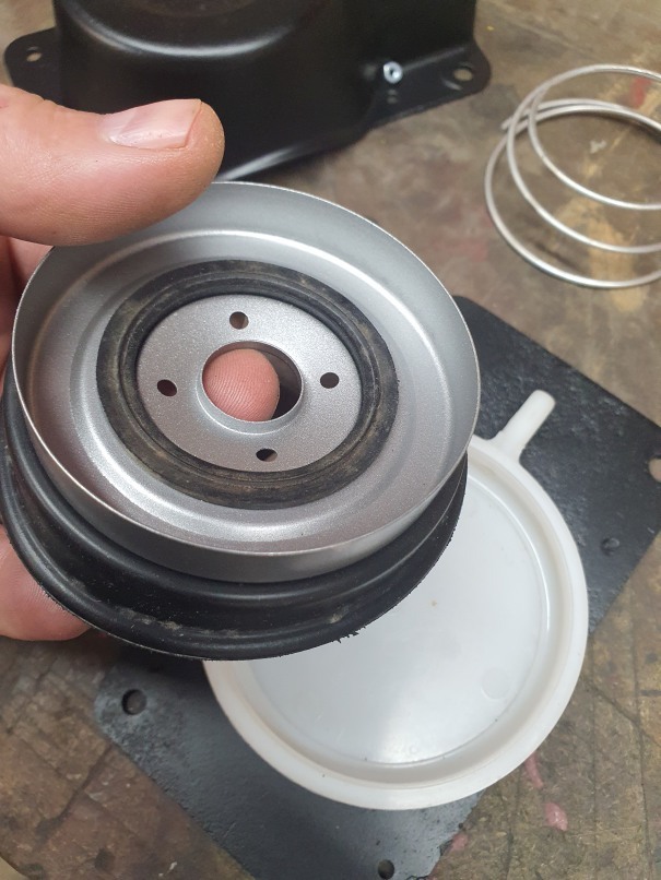

            Now in all the times I have done this, if the rubber lip and top cover are seated properly they will stay put when the plunger comes up to rest

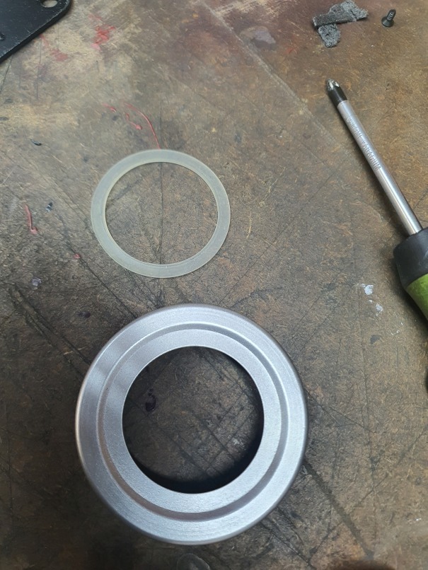

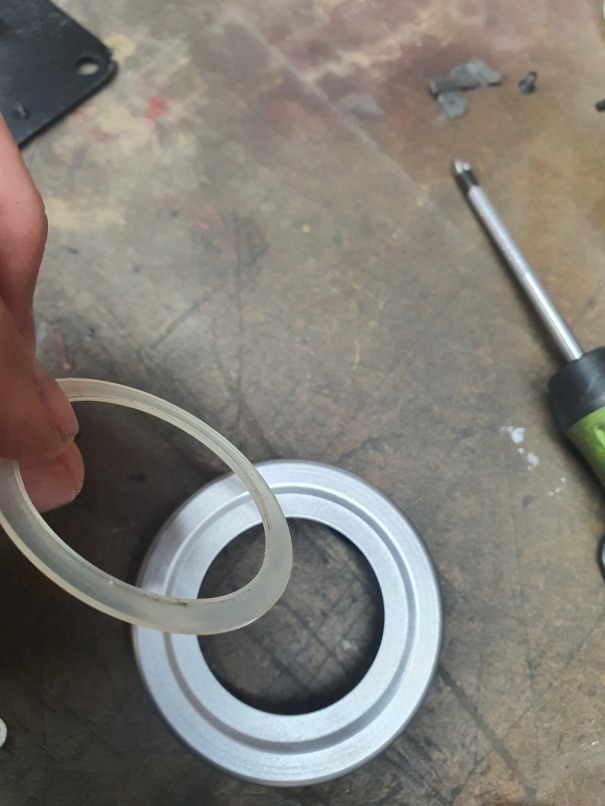

            The spring ring sits on top of the cover so add a little smear of grease

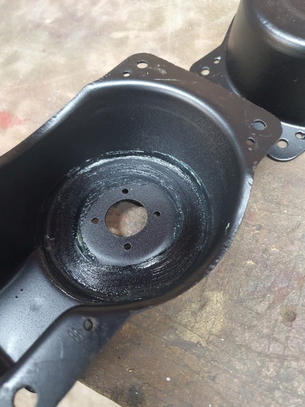

            Then a small smear on the matching surface on the top part of the assembly
            Then add the sponge washer

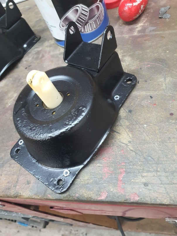

            Then the top cover can be seated and secured with several screws of riveted

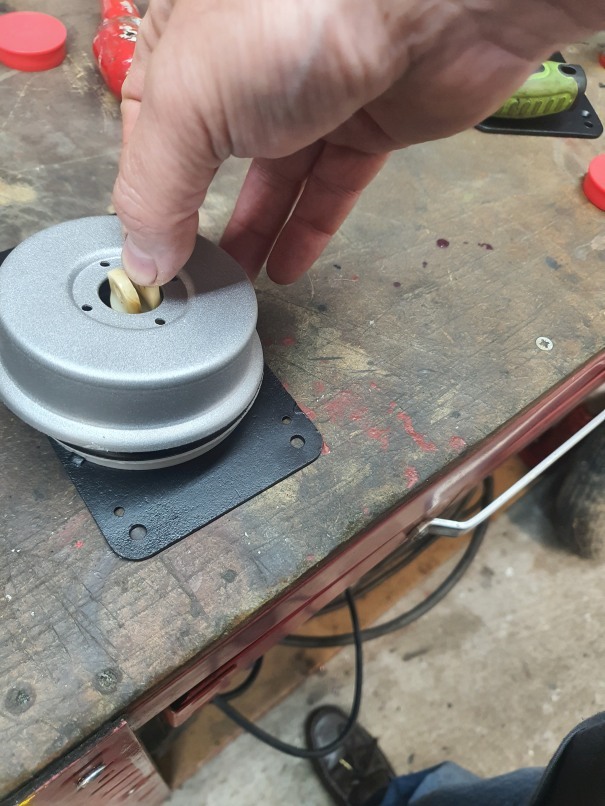

              Time for a little testing before adding the pedal assembly to it
              Air pushed when pressed
              Press actuator and while down block air connector, should stay put until unblocked
              With actuator returned to home position block air connection and apply light pressure to the actuator, it should present a lot of restance and stay put until blockage (thumb ) removed

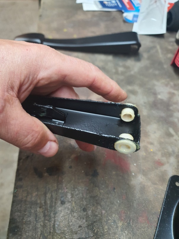

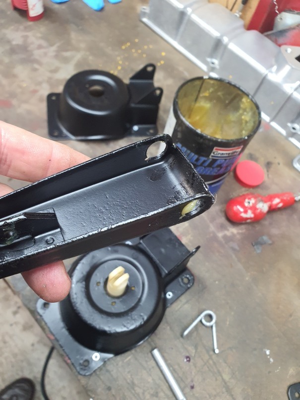

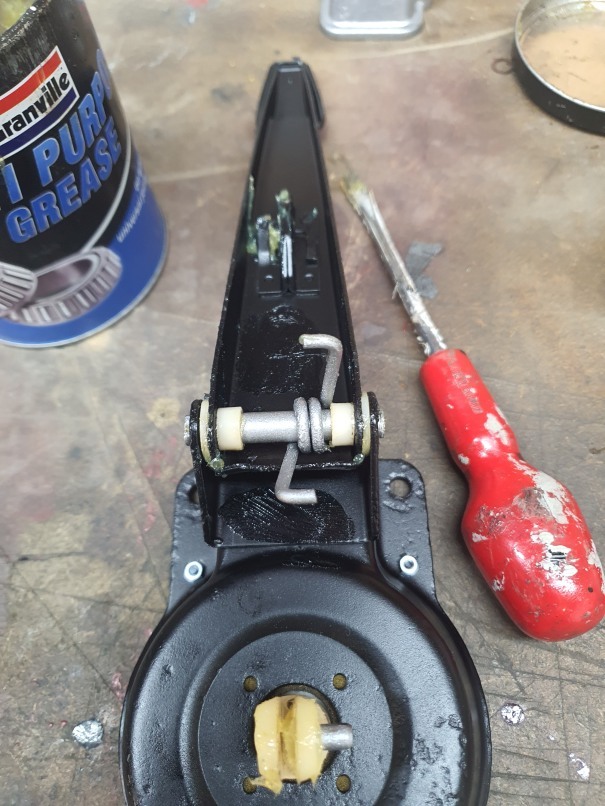

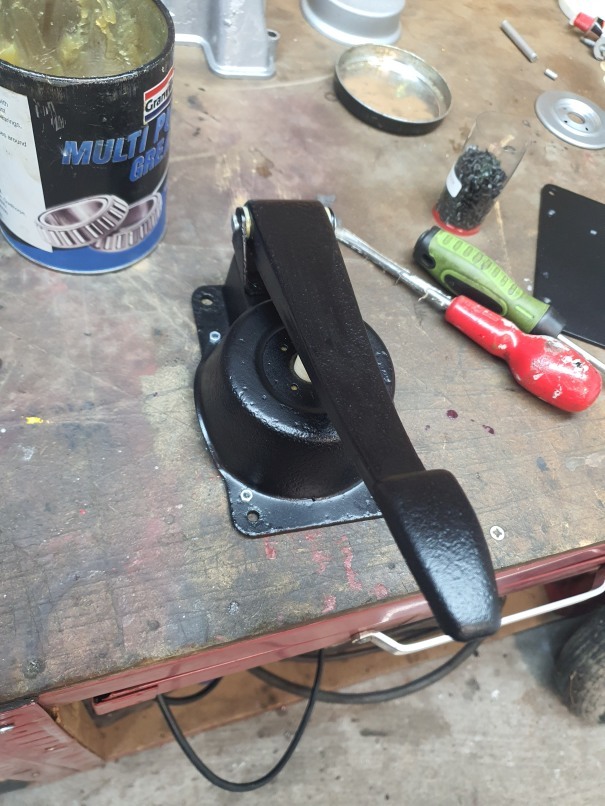

                Onwards fitting the pedal assembly
                Bit of grease in the pivot apertures
                Add the bushes

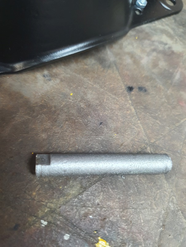

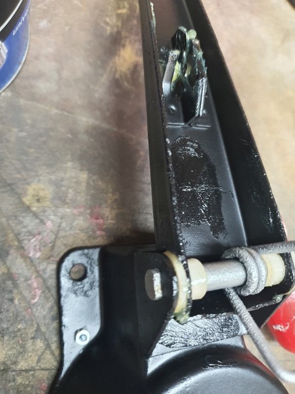

                The pivot pin as one end that is "D" shaped so make sure you fit it correct way round, mine was a little tight as the paint coating had filled up the recess

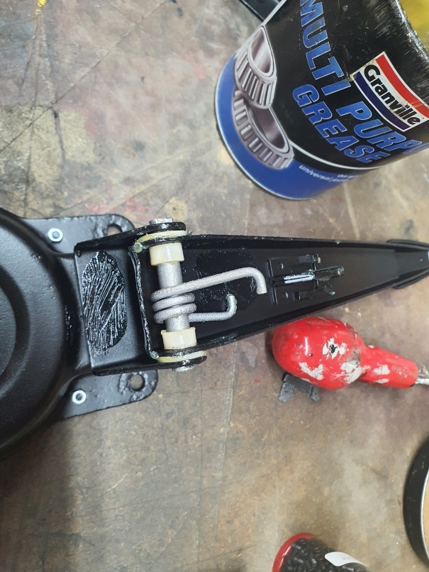

                Again a small bit of grease on the faces for the return spring which is assembvled like below including the pivot pin area

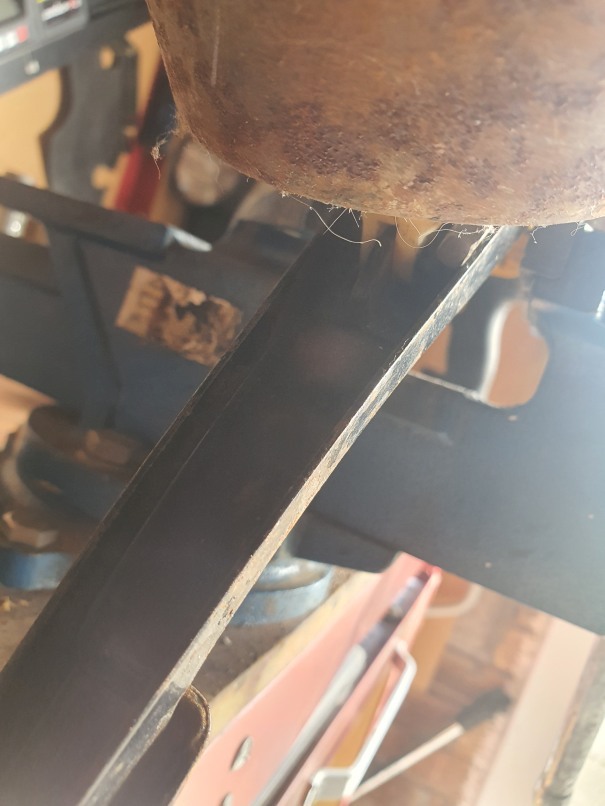

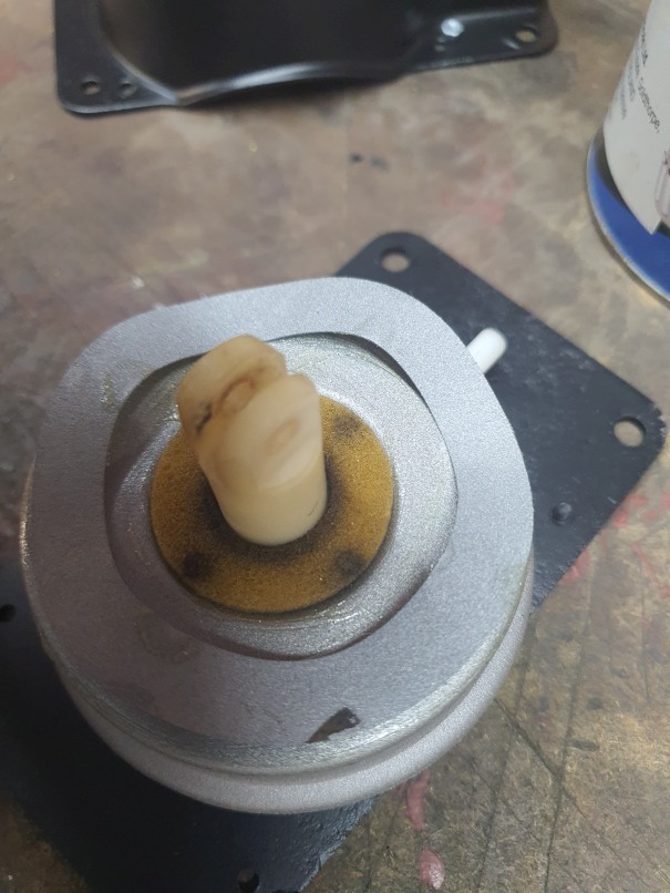

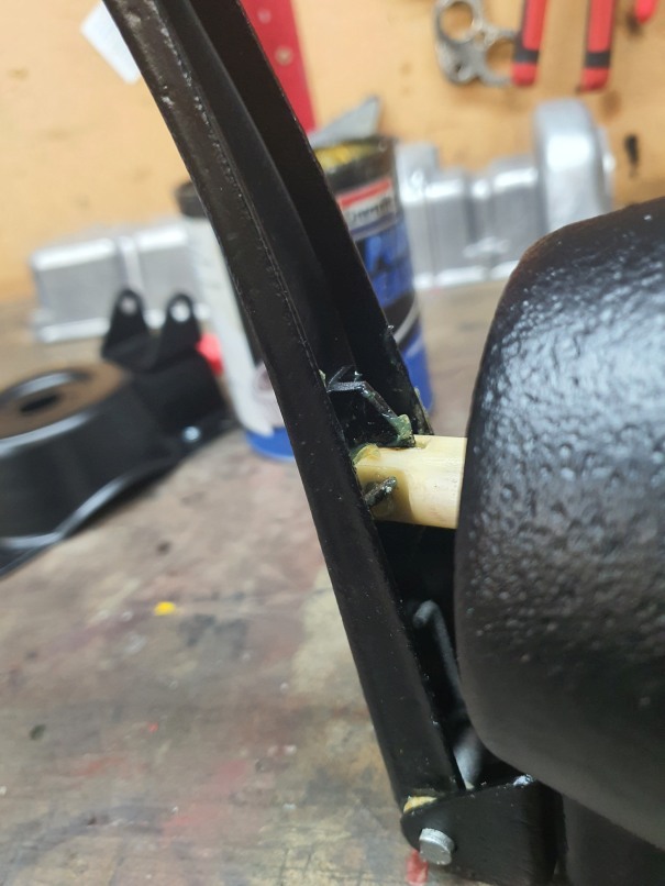

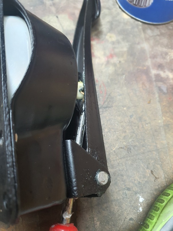

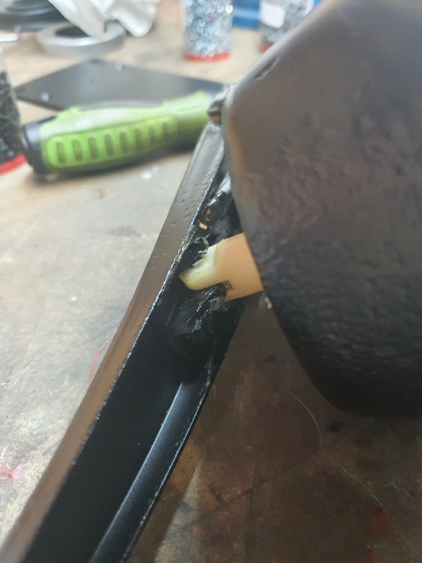

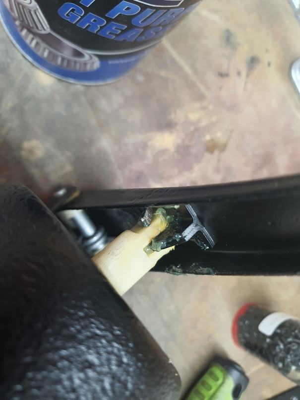

                Now next bit is fiddly, apply some grease to the pplastic piston and part insert the small pivit pin
                Push pedal down to locate the piston and push the pin into place, then both tabs either side of the pivot point on the pedal are bent to act as stops to prevent the pin dropping out, you will sratch something, so a little grease again to keep the roost away wont do any harm, it will get damp down there.
                  And finally repeat x 2 and the pedals are done
