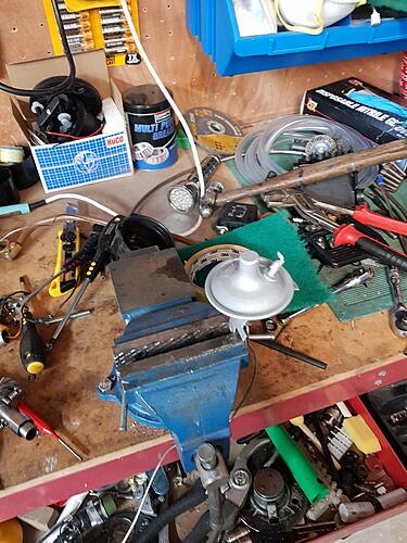

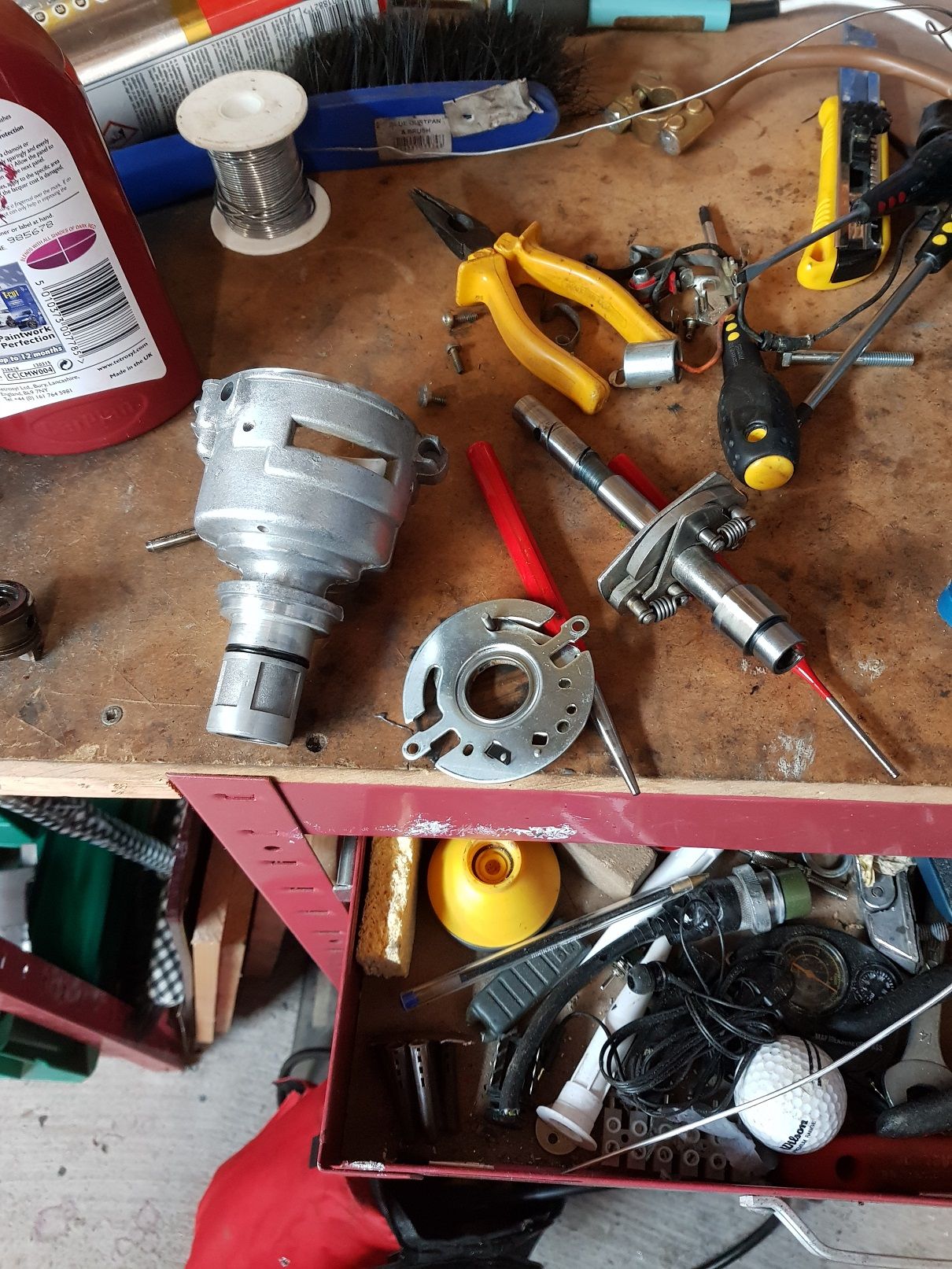

45D4 Distrinutor in bits - in case you want a look

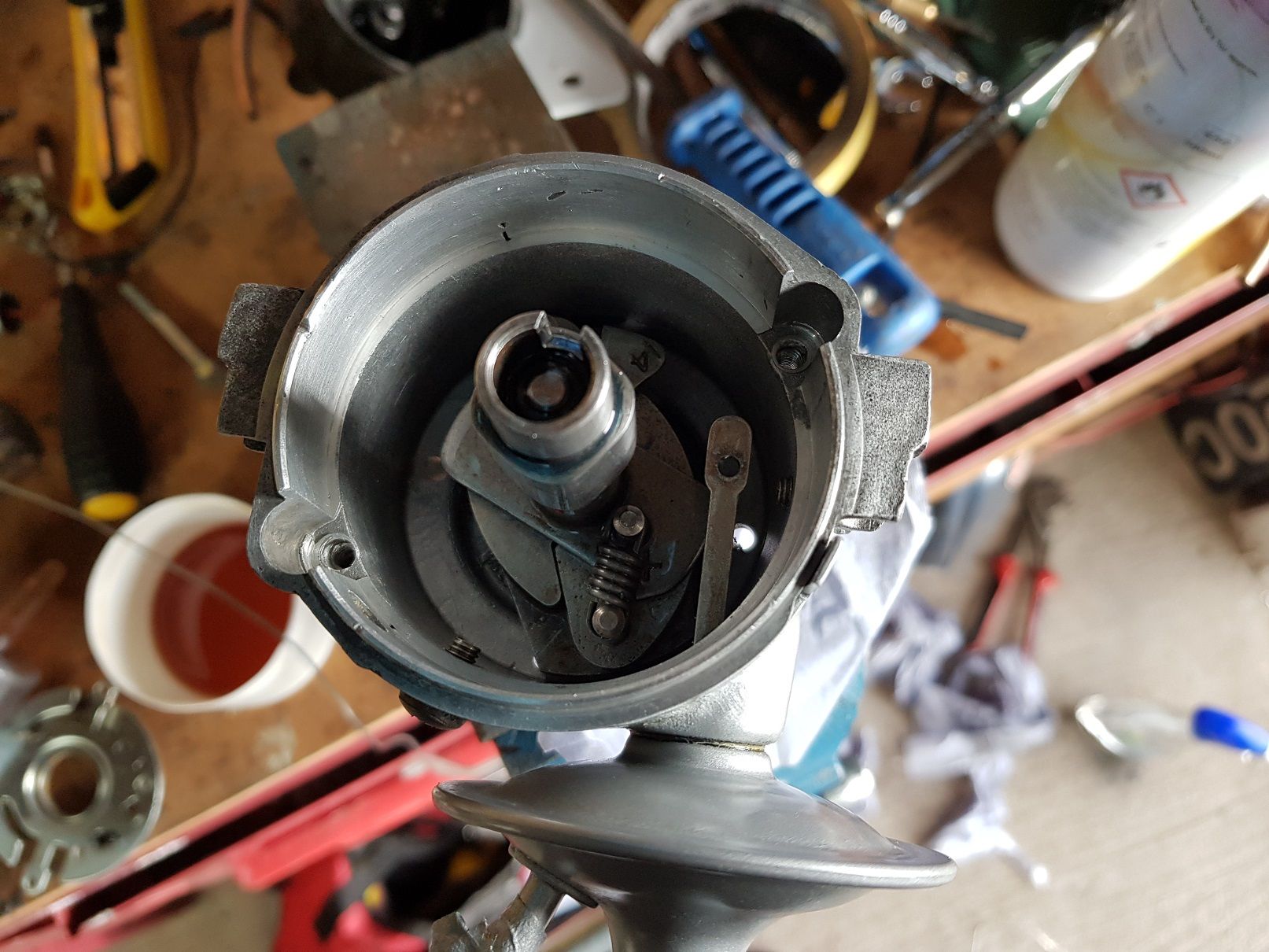

And going back together, you can see the thread on DDG 220 C for it being isntalled on engine

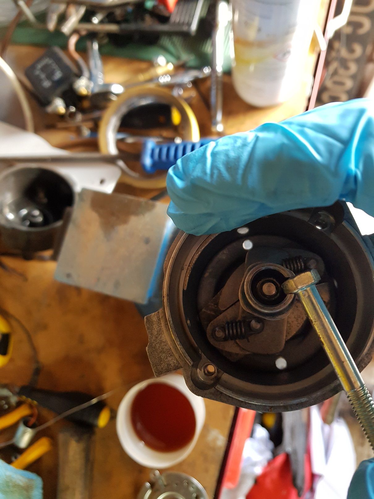

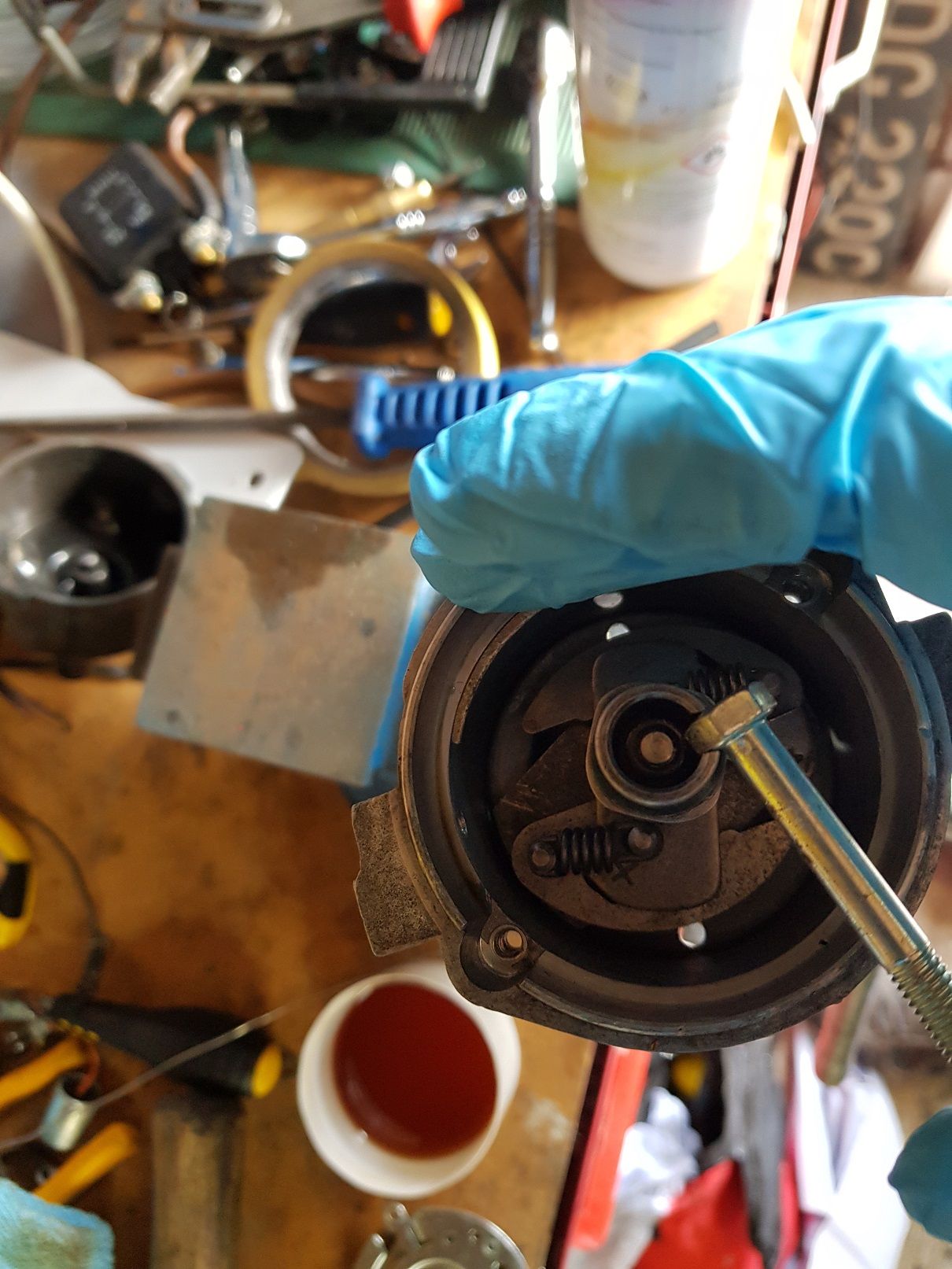

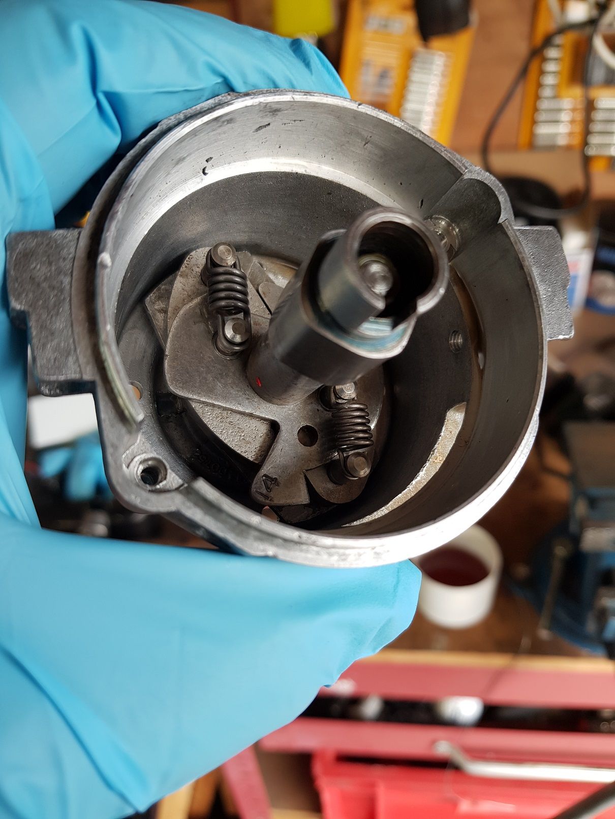

Things to note, the weights need to move free but not flop around.

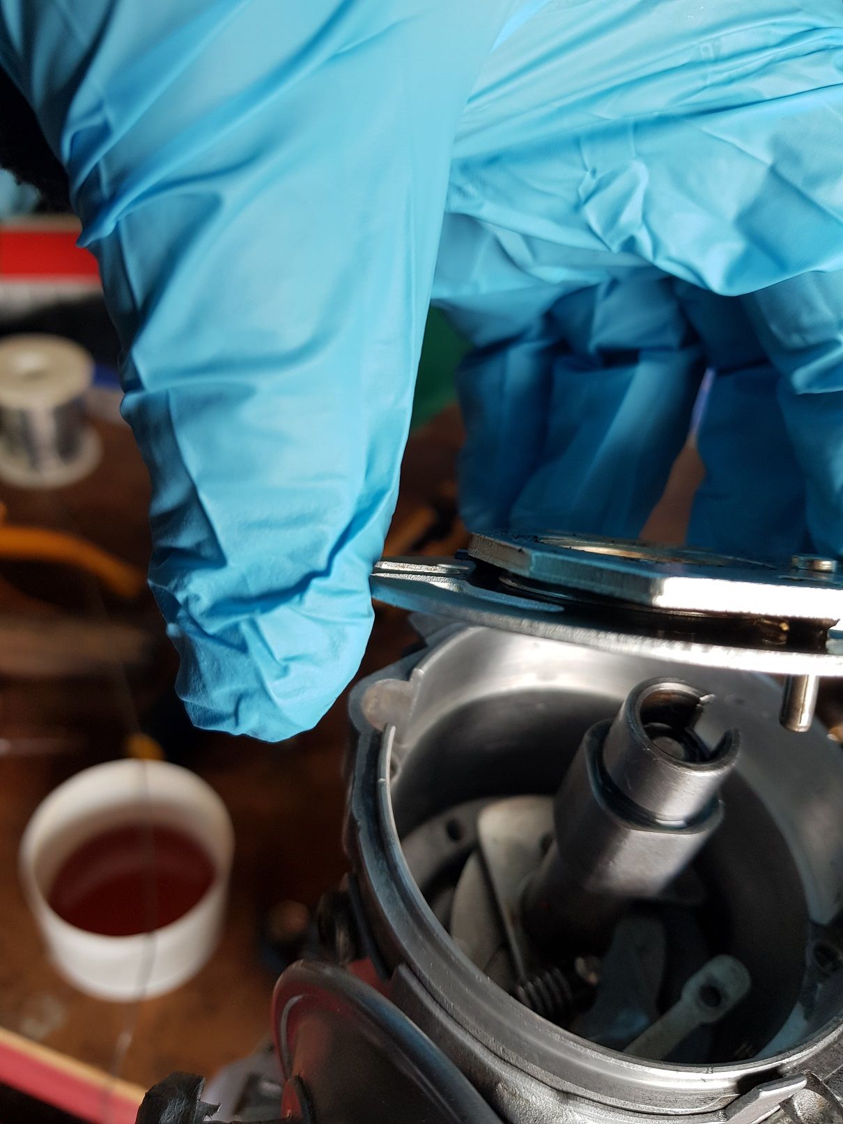

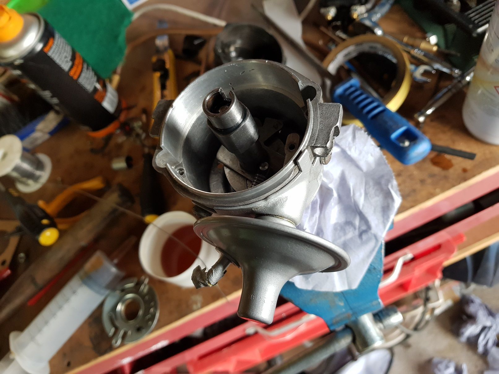

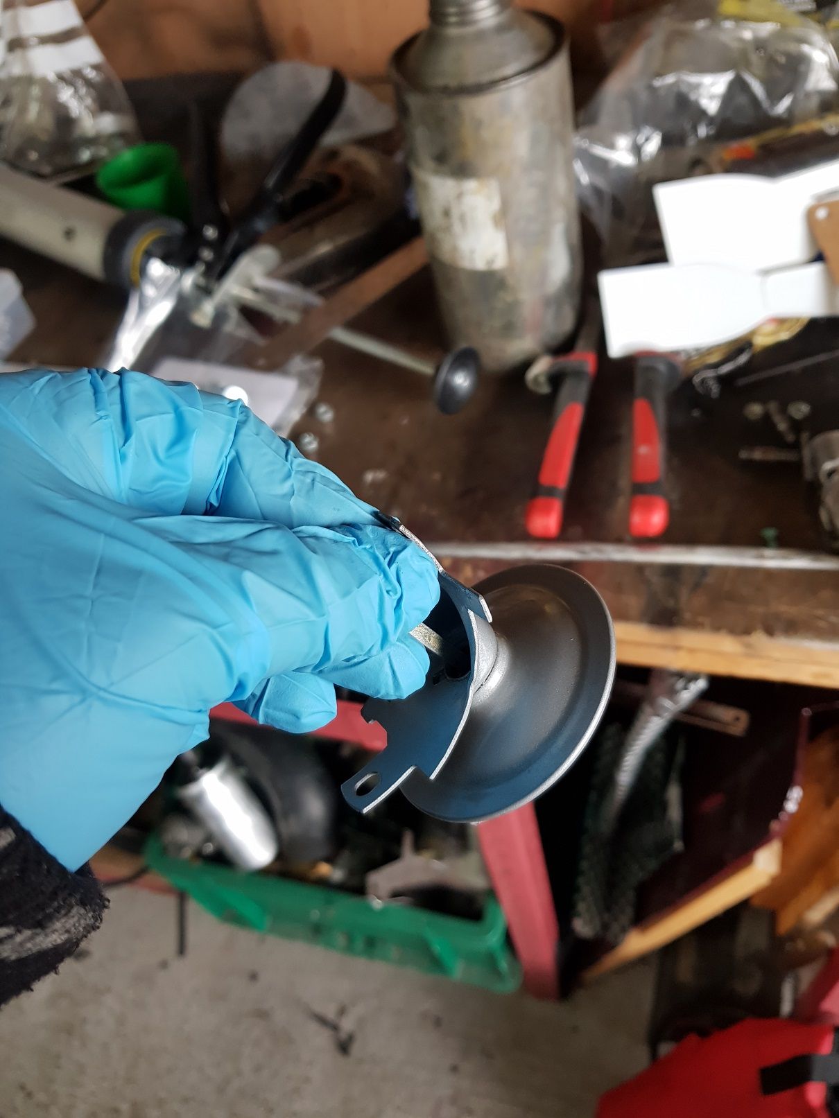

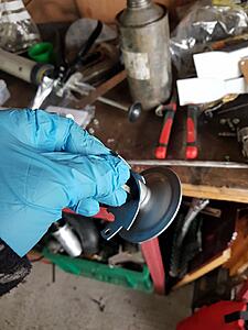

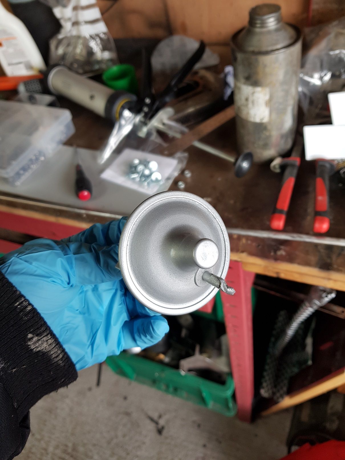

The stator plate has a small pip at bottom, this needs to locate in the hole at end of the vaccum advance actuator lever, make sure that is in there properly. the set position for your timing depends on it.

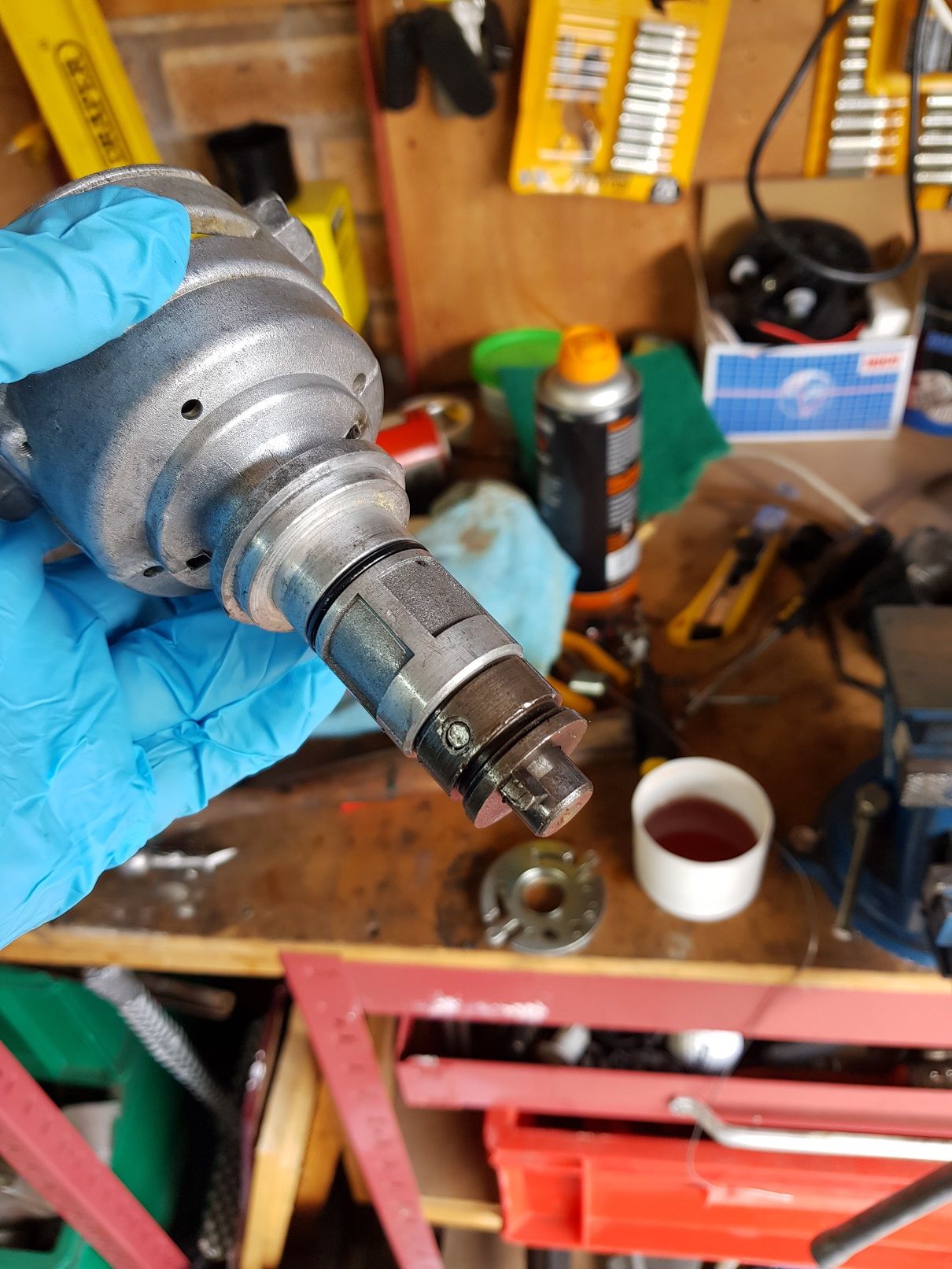

The bottom drive for the dizzy is offset to one side, dont force it into the drive gear the wrong way and most DEFINITELY do not hammer the dizzy down, it should be push fit.
