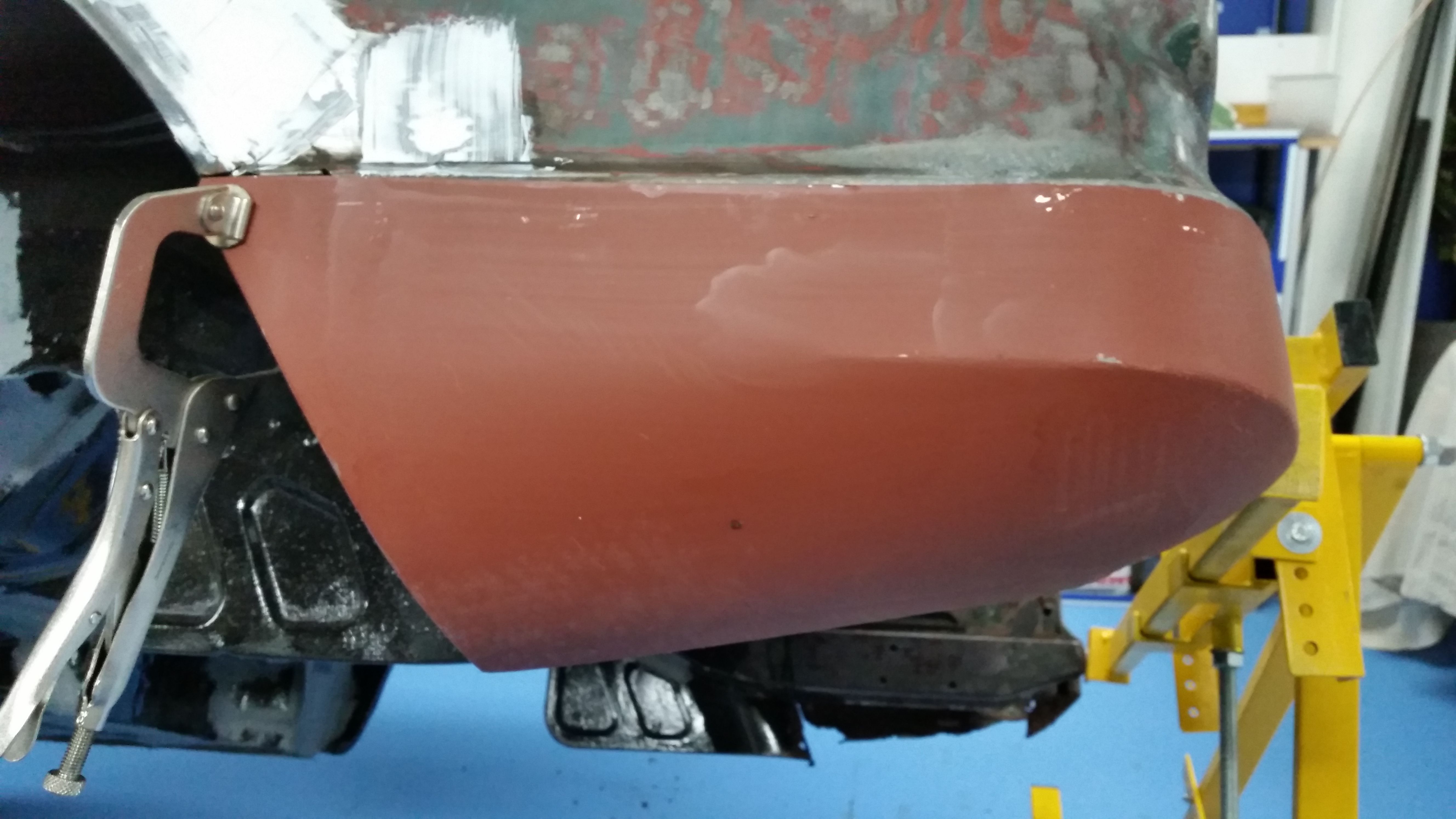

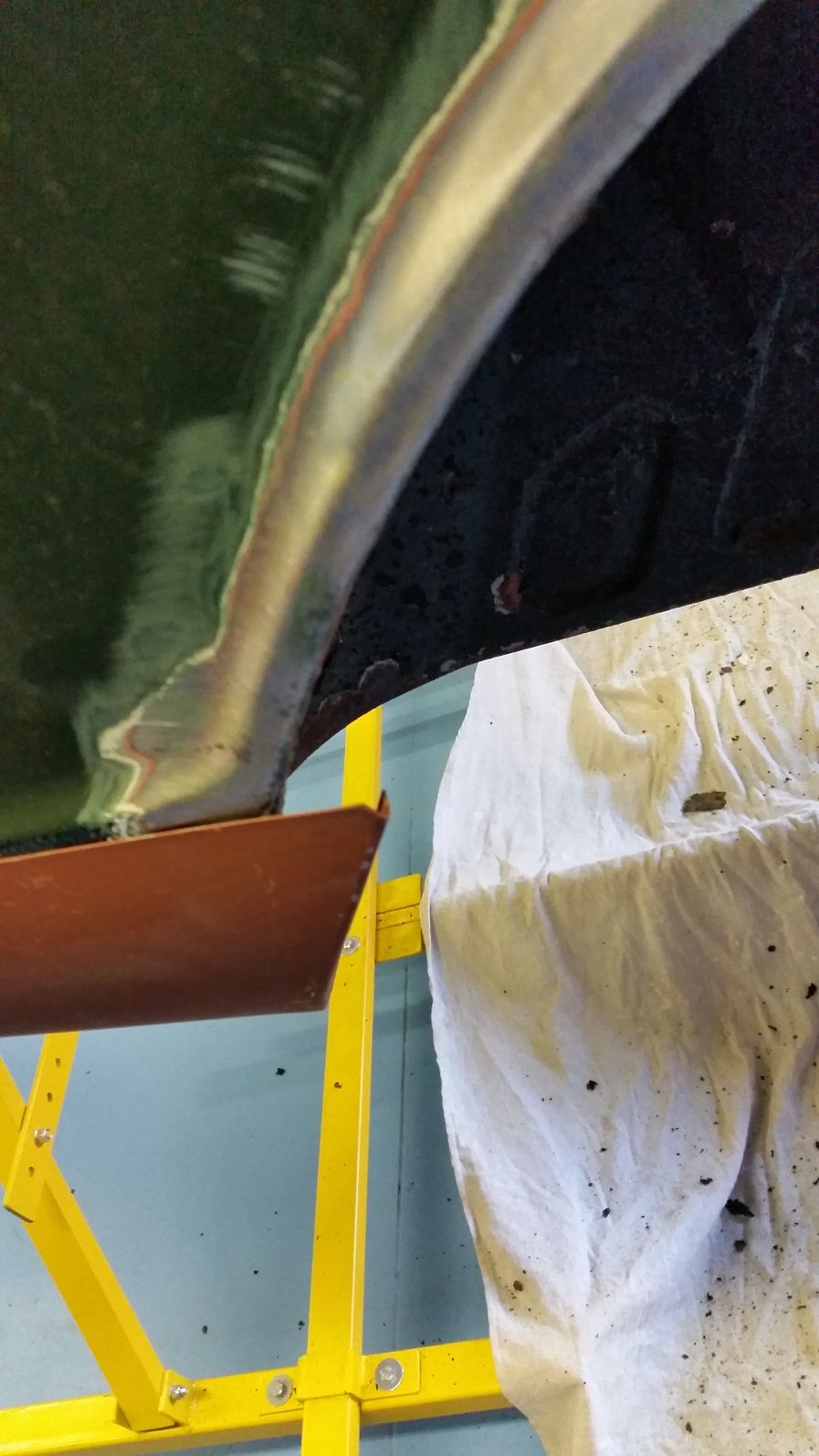

    Several panels were tried.
    Chris Farrens fibreglass ones were actually great however lining surface to surface at a joint was a pain so the idea was dropped . OK for a budget repair but not a resto.
    Click image for larger version  Name:	50 PIC-08014.jpg Views:	0 Size:	1.03 MB ID:	3605

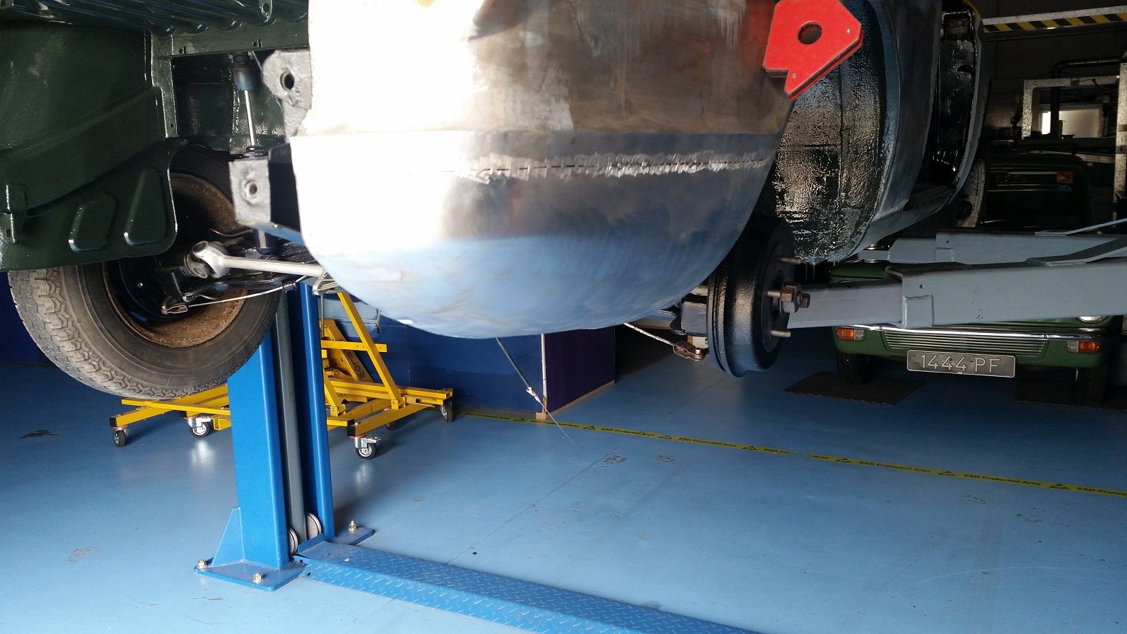

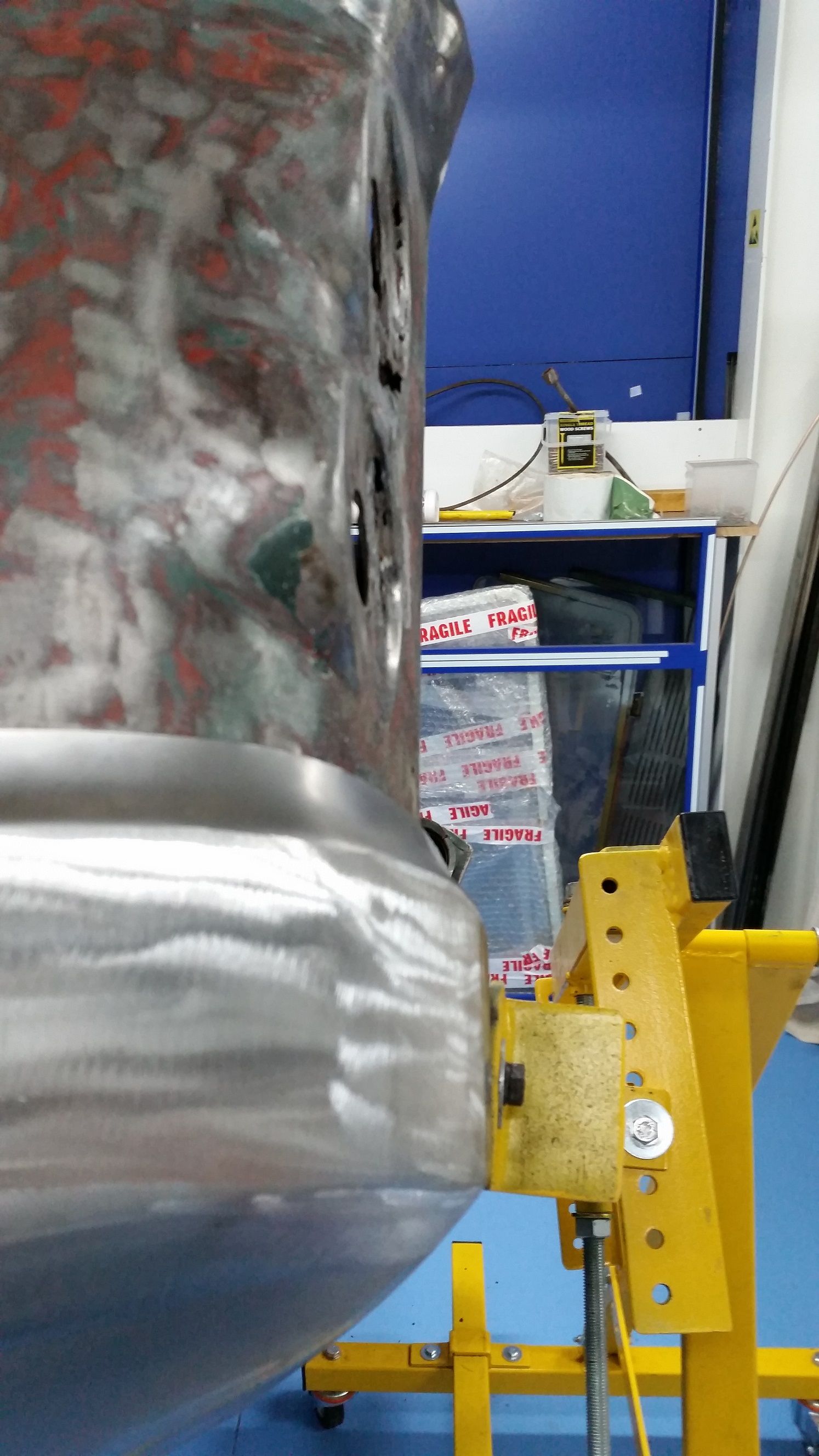

    Second panels i tried were hand made ones from Radford. Sorry Radford but way too much needed to fit, lengths were wrong, form at rear end was wrong and the curves not same left / right.

    My advice is unless you can get these cheap and i mean cheap or if they are the only option, look elsewhere on this panel.
