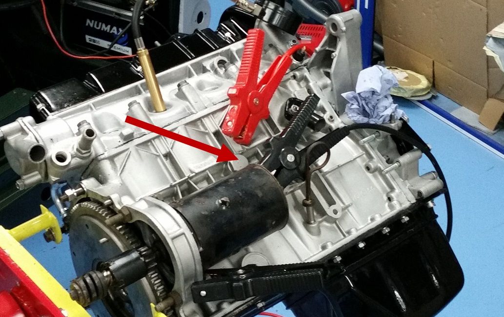

    So adding an oil pressure gauge, best place IMO is right where the oil feeds the main / BE bearings.
    It has a large blanking plug as standard and most Smiths / Durite senders have 1/8 NPT.

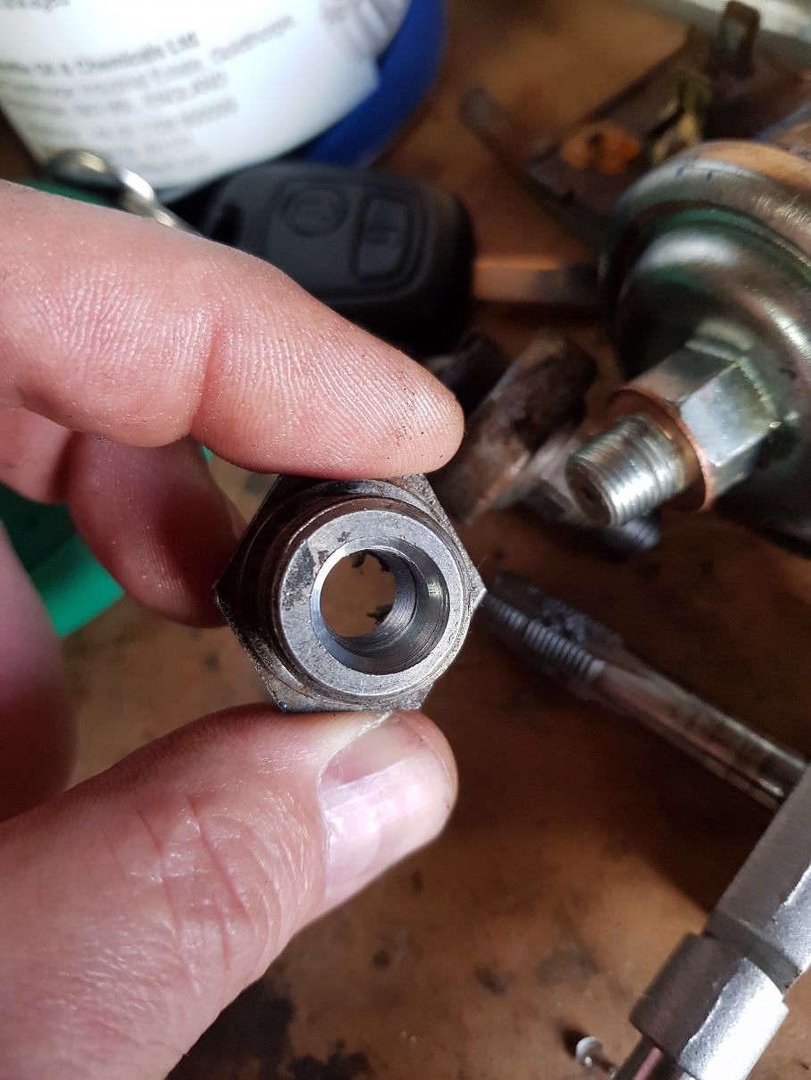

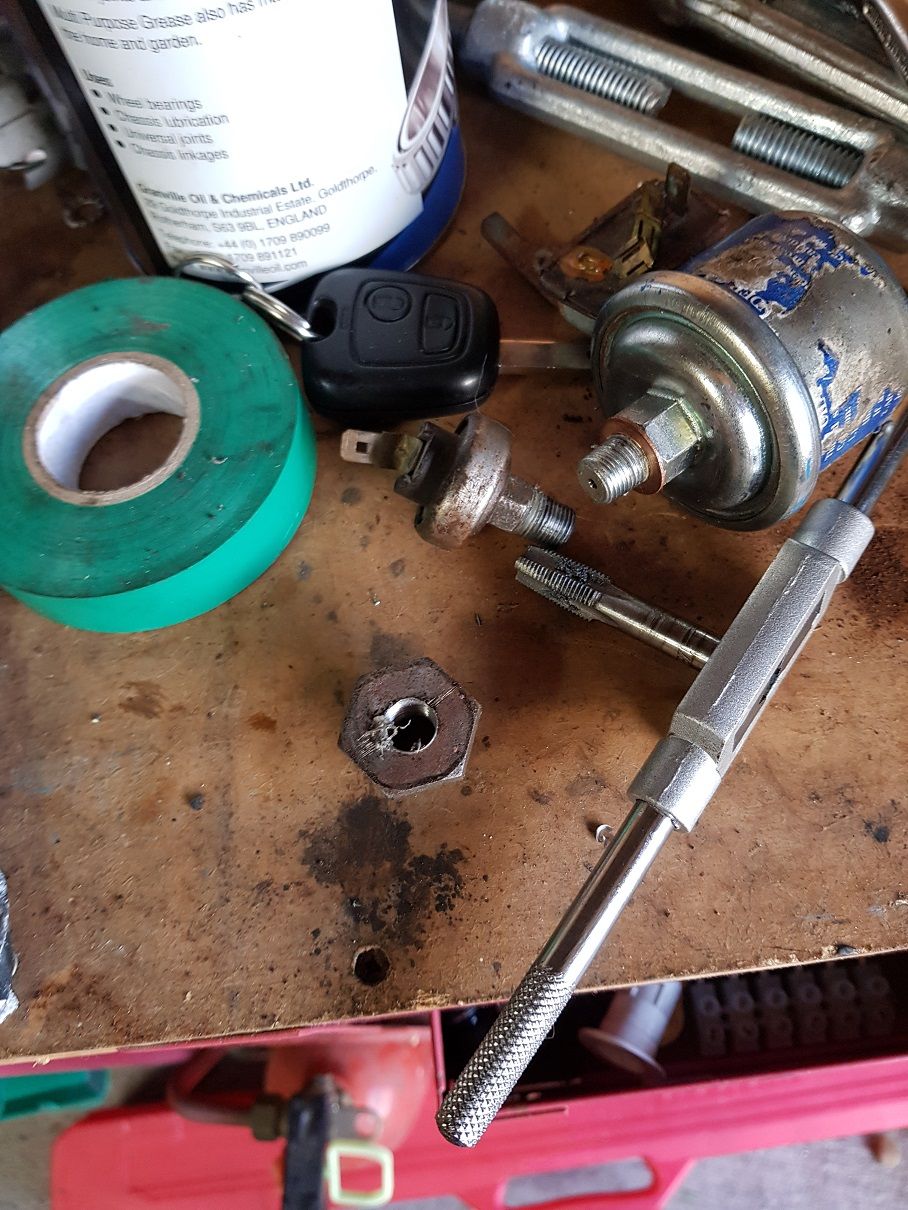

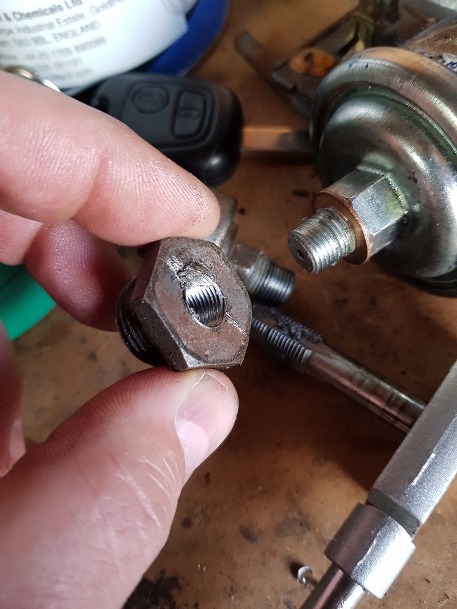

    So I pulled the plug, drilled at 7mm, back drilled from the other side with a step drill to hollow out the inner edge.
    Final drill out the actual hole and then thread with a 1/8 NPT tap. Not as good as Bobs machined parts however will do the job nicely !
    Old school bt a 1/8 NPT tap is an essential in the toolbox and supplied with most tap/die set !!!
    Takes longer to order one online than make it and way more fun.

    Wont the oil just come out that hole? :)
    • Francois
      Community Member
      • 20 November 2022
      • 7
      No leak as NPT is conical, i have the same modification on my engine that has many leaks, but not here
