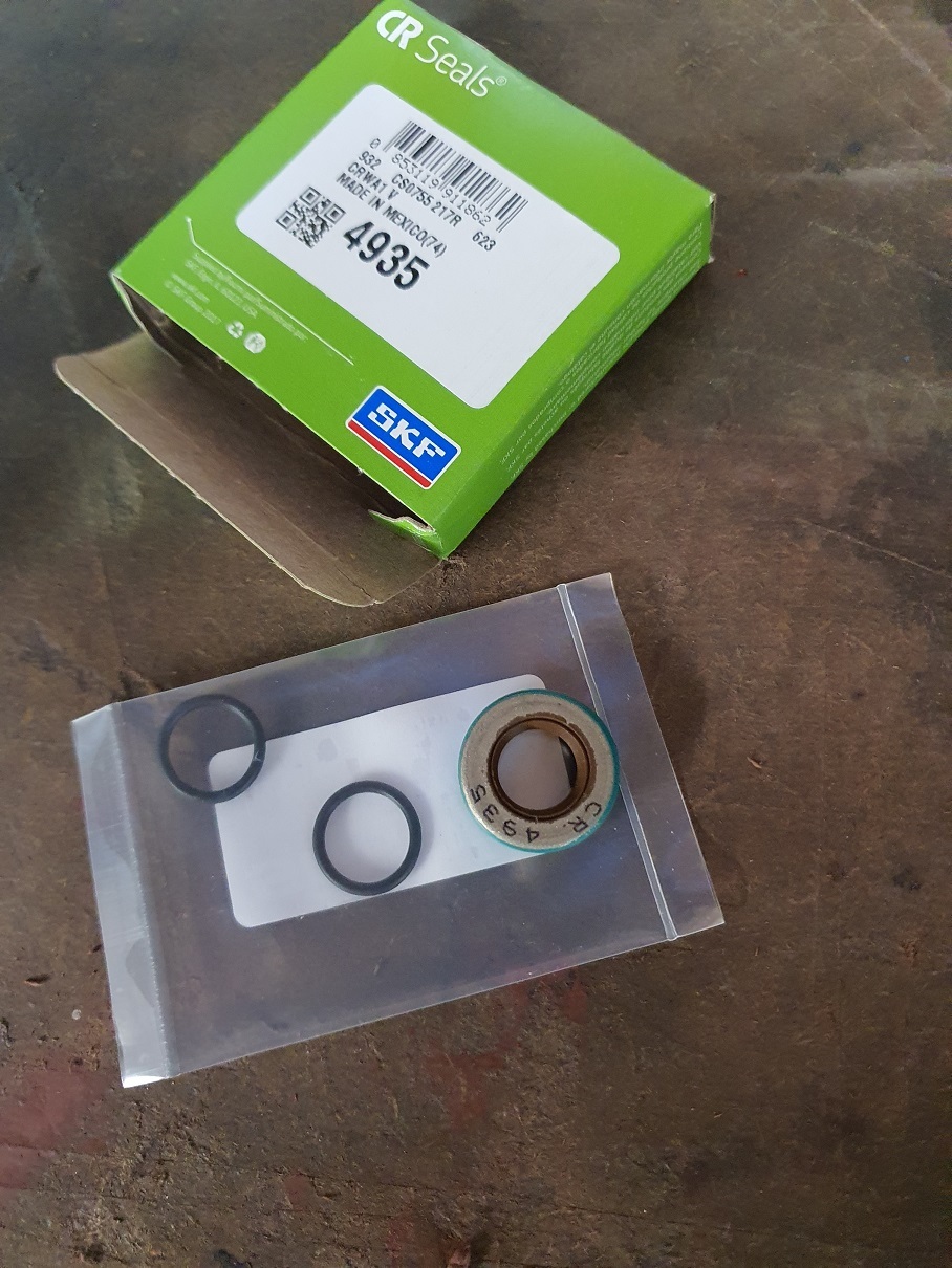

    So new o rings arrived and I also ordered a double liped seal from simply bearings to try at the end of the gearchange shaft.

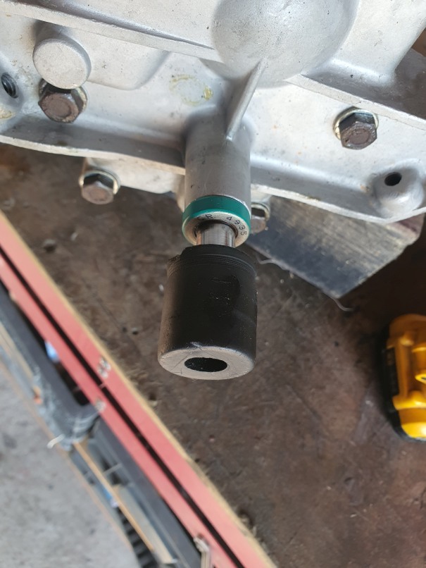

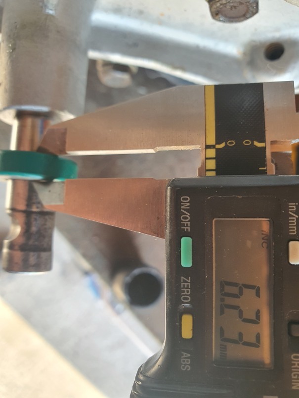

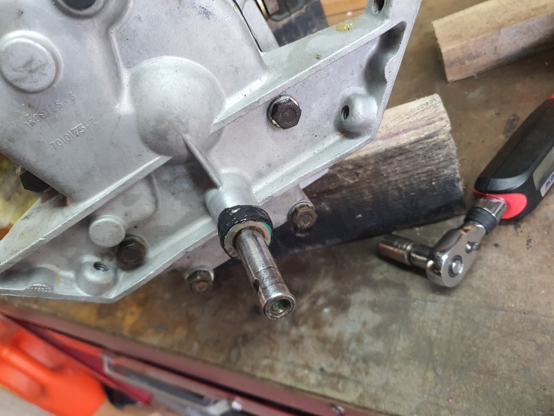

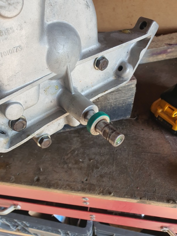

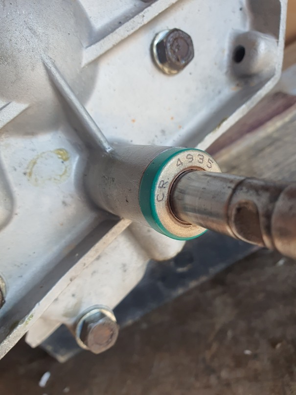

      Started off getting the back end of the box back in with a new but slightly oversize O ring then test fit the seal over the now highly polished shaft
      Problem to overcome is that the distance that can be used is about equal to the existing rubber dust boot

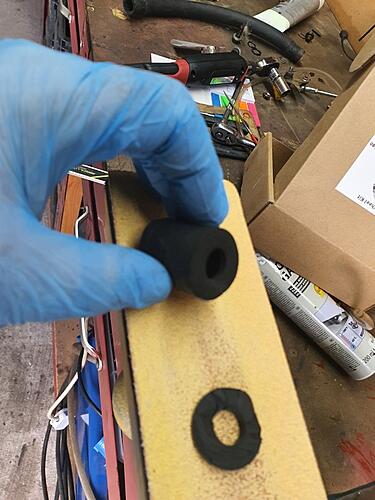

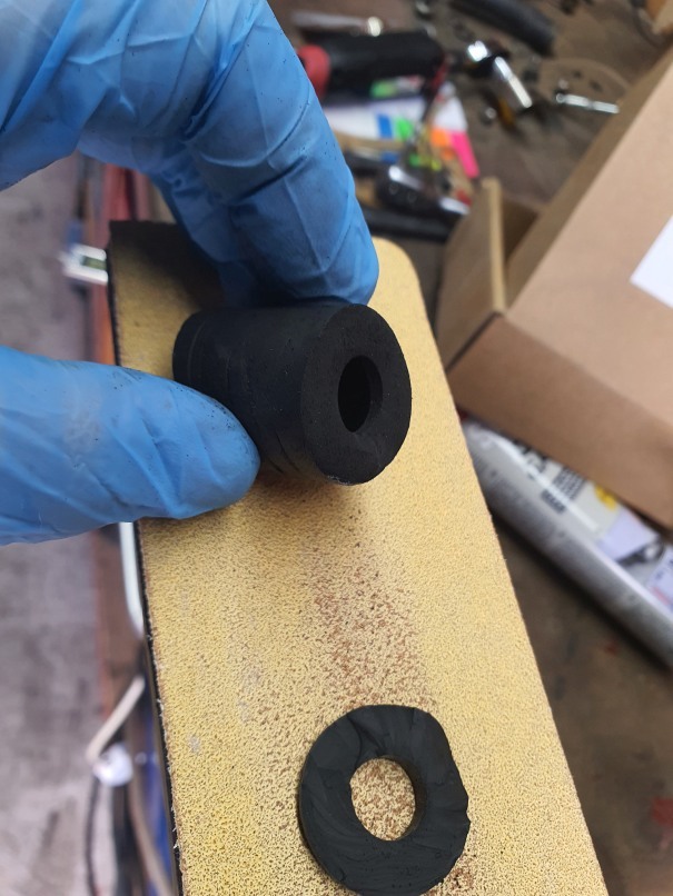

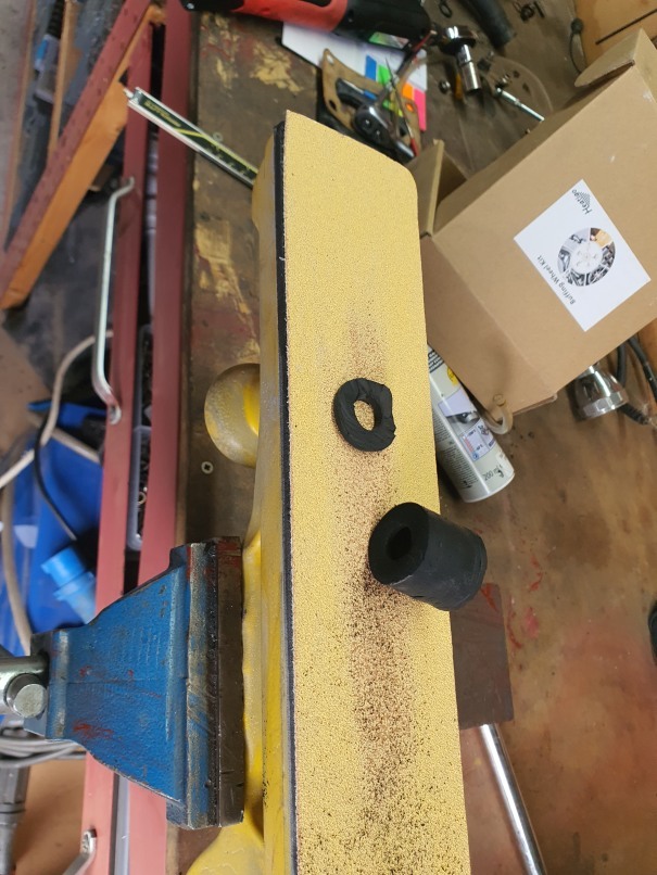

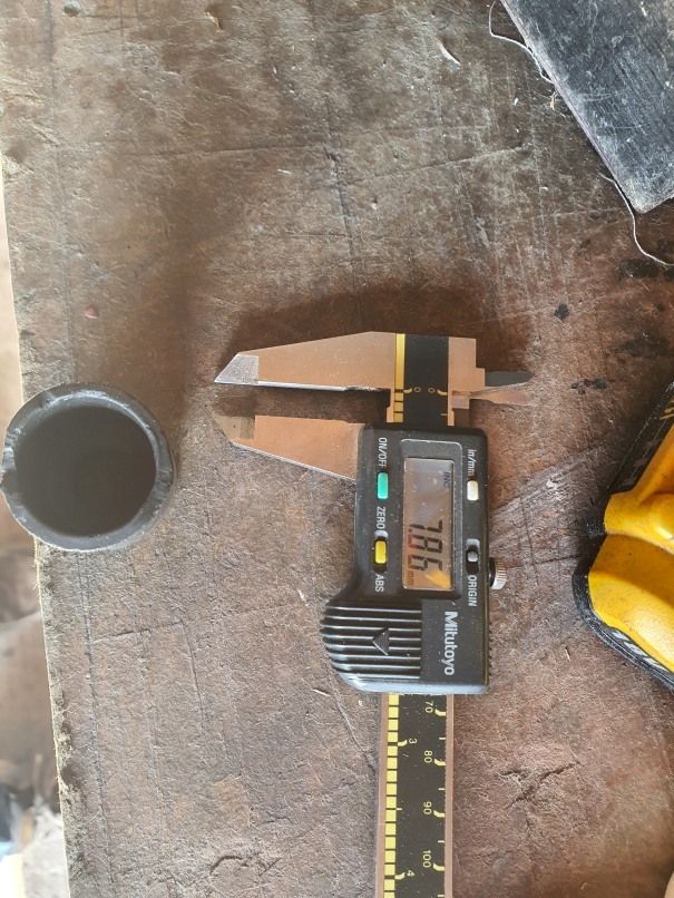

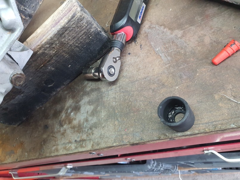

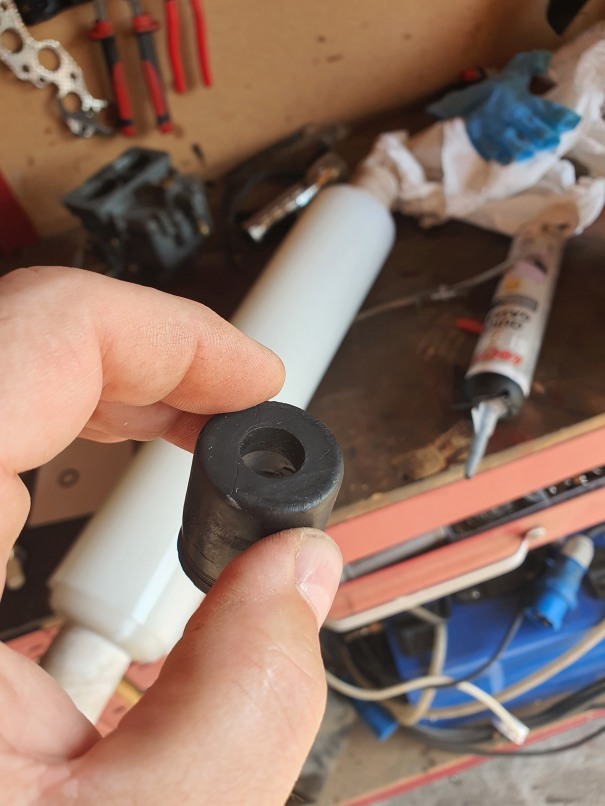

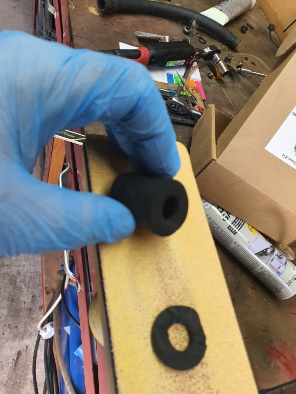

      So as I need the boot to cover it again it was time to shave off some of the thick end, time for knife and block

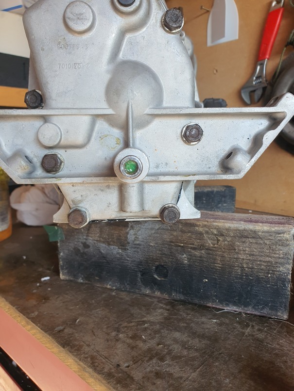

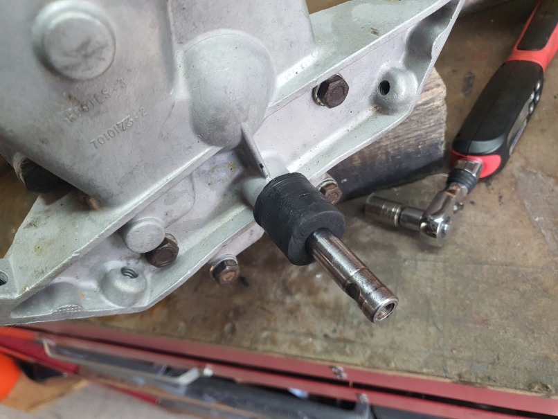

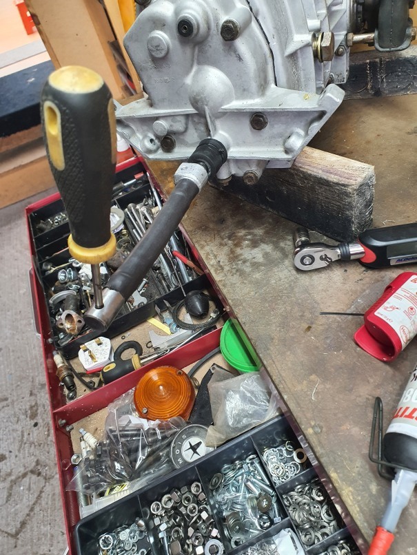

      Second problem and reason I needed the boot is rootes never seem to machine anything in the centre !

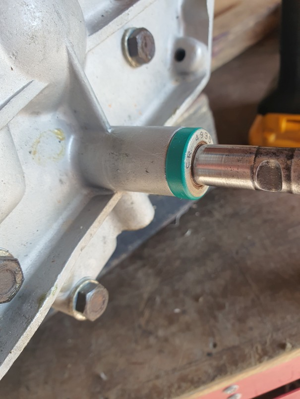

        As I said I still need th boot to fix the seal in place
        Click image for larger version  Name:	20220921_101633.jpg Size:	97.9 KB ID:	20046

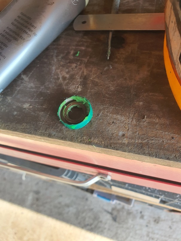

        Whatever you do, once you grease up the seal dont drop it on the floor ..... or back to the start
        Click image for larger version  Name:	20220921_102954.jpg Size:	187.3 KB ID:	20047
        Click image for larger version  Name:	20220921_102949.jpg Size:	108.6 KB ID:	20048

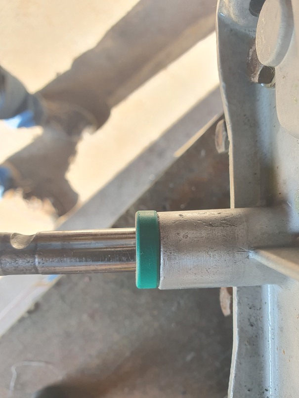

        And some instant gasket to seal things up before the standard tie wrap, the casting was scratched a little to makew a key
        Click image for larger version  Name:	20220921_153138.jpg Size:	109.1 KB ID:	20052
        Click image for larger version  Name:	20220921_153059.jpg Size:	110.6 KB ID:	20054
        Click image for larger version  Name:	20220921_153102.jpg Size:	156.3 KB ID:	20050
        Finally back in with the detent ball and spring with a little loctite
        Gears seem to engage fine
        Will fill with some oil tomorrow and tip it on its end to see if it leaks
        I was losing 1/2L at a time and sick of topping it up so if no drips we should be good to go (on flange seal and shaft)
