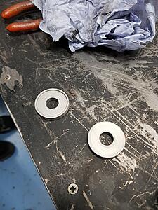

    Period Decamber Mods - Material removed from bottom face of stub axle and washer added to the top
    Click image for larger version  Name:	PIC-09608.jpg Views:	0 Size:	246.8 KB ID:	4338
    About 1/8th removed off bottom where the vertical drop bolt for the stub axle assembly is fitted through I think was instruction
    The stub axle can then pivot on the horizontal bolt
    Then to make up the gaps inside the wishbone a machined washer was used as a gap filler to prevent the wishbone being crushed when rumped up.
    The lip is only there to stop it slipping off when attached to the bone
    Click image for larger version  Name:	PIC-09607.jpg Views:	0 Size:	380.0 KB ID:	4337

      That was done by hartwell so I assume it was well tried and tested, however .... it was a quickie mod as the high pivit suspension had reall y really bad camber, if you do the mod then lower the suspension then the geometry goes to pot again
      I have seen folks thread these but there must always be gap inside the cavity which is not how it was designed to clamp in and concerns me.
      So yes it is a standard mod Bob, thes days i would sit the suspension on lowered springs first then find a distance for neutral camber so its only pushed a little neg when diving in a corner.
      Sit the car on stands under the wishbones and on its suspension with say weight of full tank of fuel, put stub axles in and find a hight that suits first.
      Then see if the camber needs adjusted and test remove material to suit keeping measure, then make padding washer to suit car.
      Those washers used to sell as kits.

          I had read about it on forum years ago , it's a mod well within my capabilities ,probably best to get the car up and running first . I thought that the spacer washers were tapered (from memory) not so easy
          Thanks
            Bob, no they are flat with a lip, like a hat, just enough so it does not slip when it is sent into the isnide of the bone, you could do the opposite and machin a little recess

                You may say that's being finicky . But if it all pivots on horizontal through bolts, then you do change what at the moment is a square face to the wishbone clamping , effectively you would need to shape bottom of carrier with an angle and insert spacer\washer above with same taper, l know we are only talking small amounts , but if it's worth doing
                  Good point Bob. If there was a taper I did not notice.
                  One from some literature showing the original Rootes part nymber from the washer and the other Peters own work keeping note of dimensions
                  Two images courtesy of Peter nunney, cheers Peter
