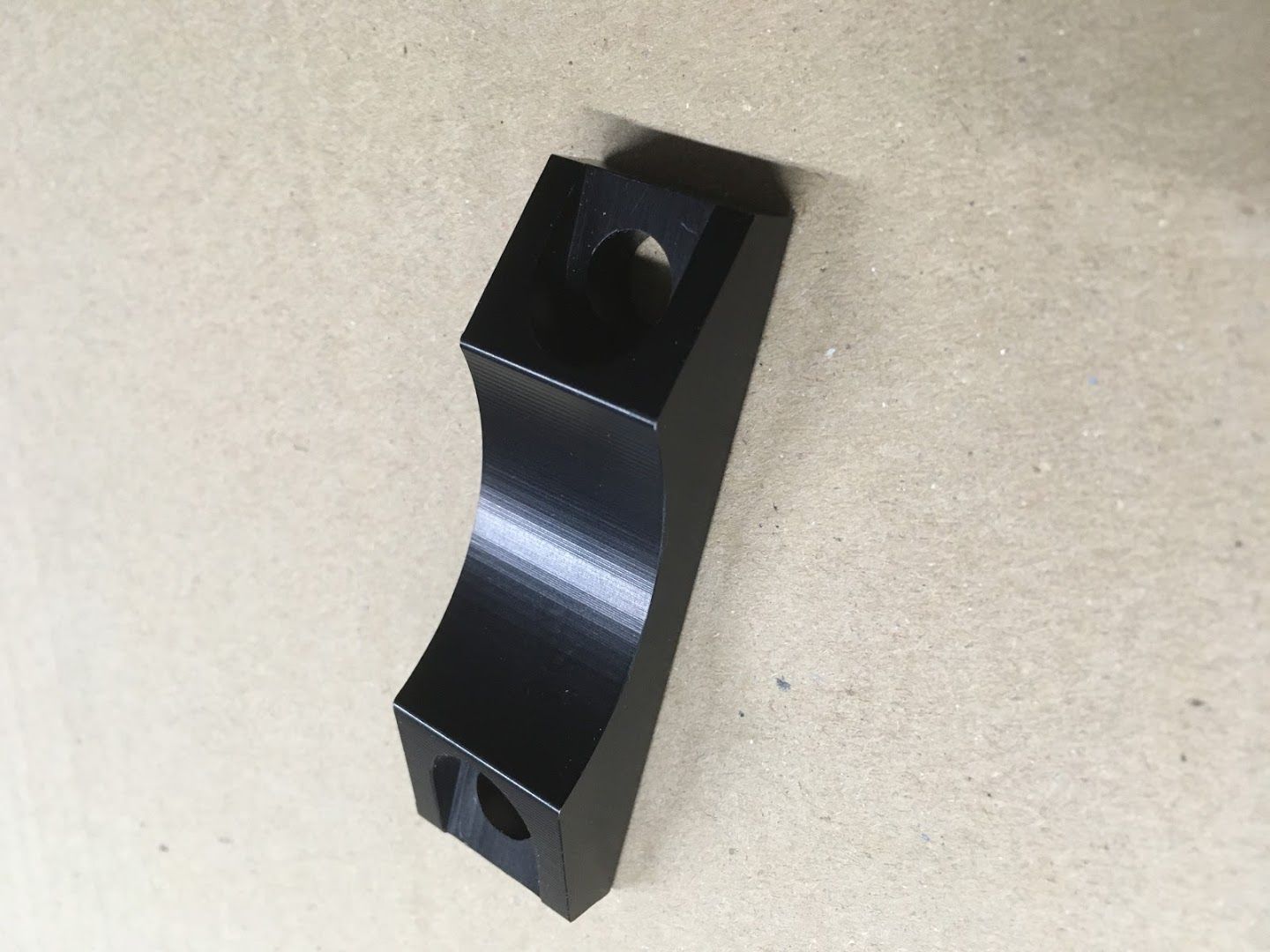

Billet rack mounts
    Billet rack mounts
    https://photos.app.goo.gl/SXYj3GGMybrnGL6u8 Replaces the monkey metal standard items that crack and corrode.

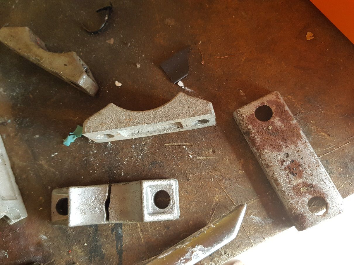

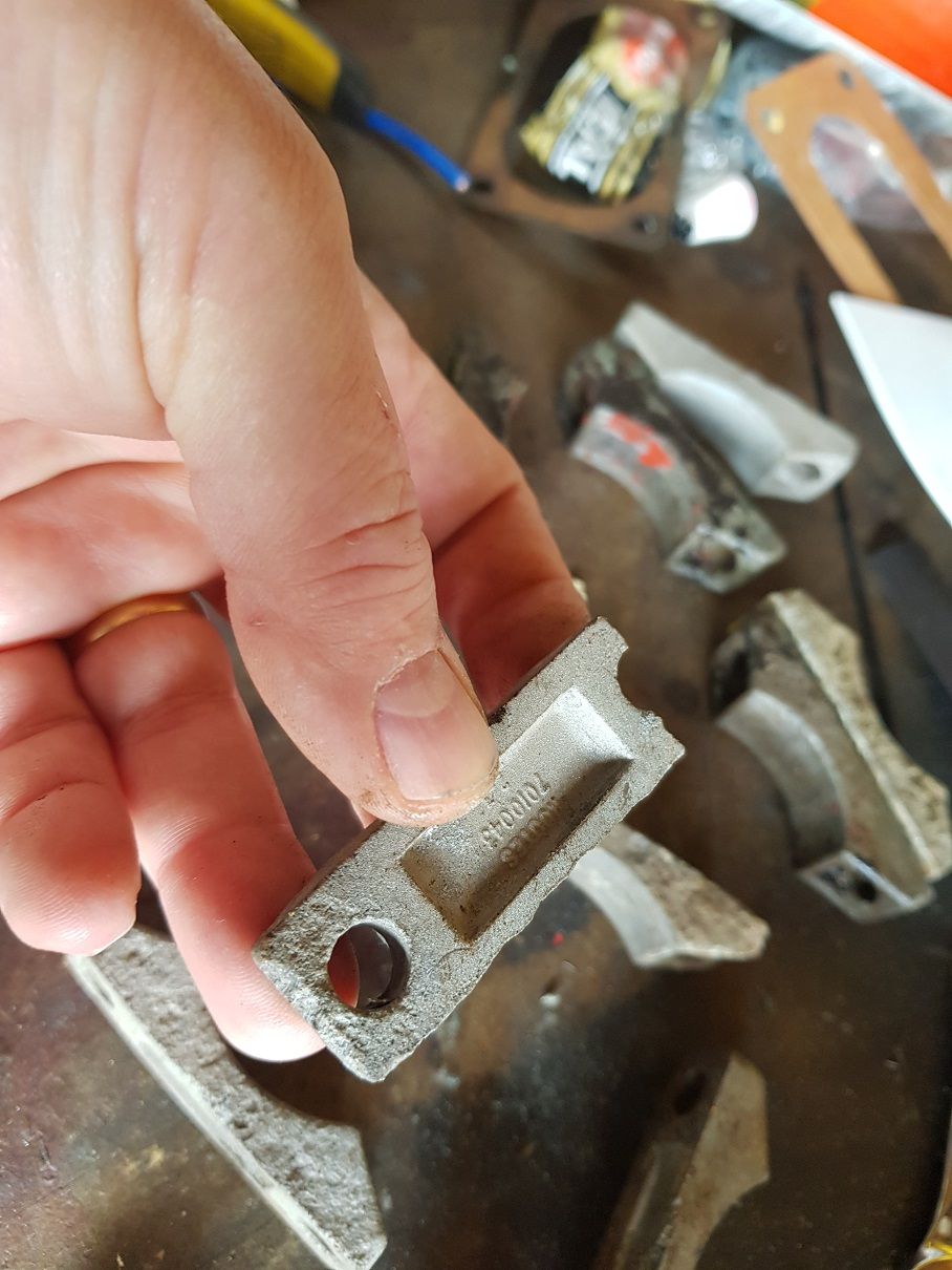

      And in case anyone wonder WHY they should worry and buy these upgraded parts here are some examples of ones I have replaced.
      Broken, cracked or pitted mounts are DANGEROUS and so many people leave them as they are or clamp the broken pieces back under the steel retaining plate.
      Then they tighten them up beyond belief so a once good piece is now broken.
      A small selection of images from ones I have changed over the years and that DOES NOT include ones I simply threw away ! These would normally have been tossed but I am still sorting through boxes since clearing out the workshop.
      Click image for larger version  Name:	20200331_125546.jpg Views:	0 Size:	113.7 KB ID:	5596Click image for larger version  Name:	20200331_125622.jpg Views:	0 Size:	145.8 KB ID:	5597
      One snapped in two and the other with the pitting so bad on the mount it has cracked/split at the end.
      Remember these came off ROAD GOING CARS !

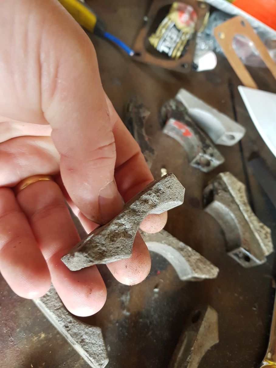

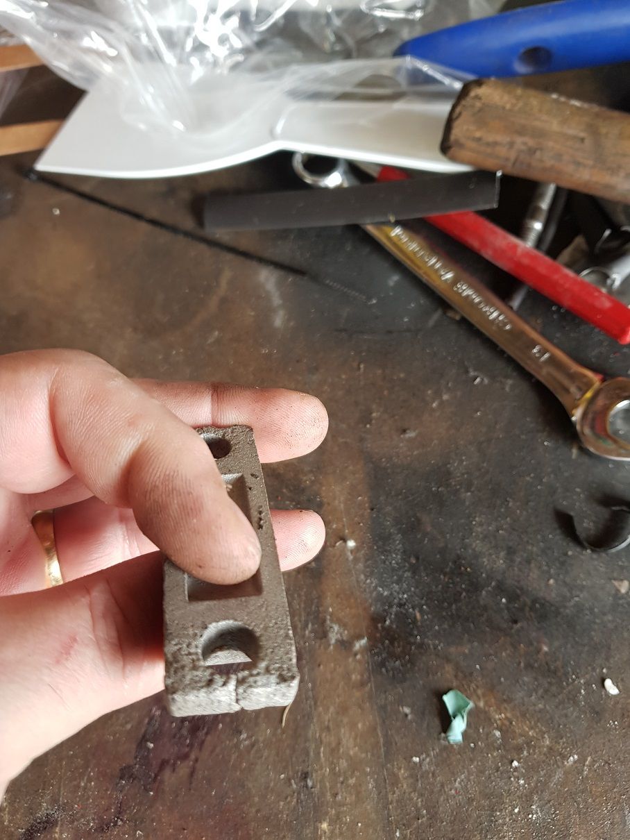

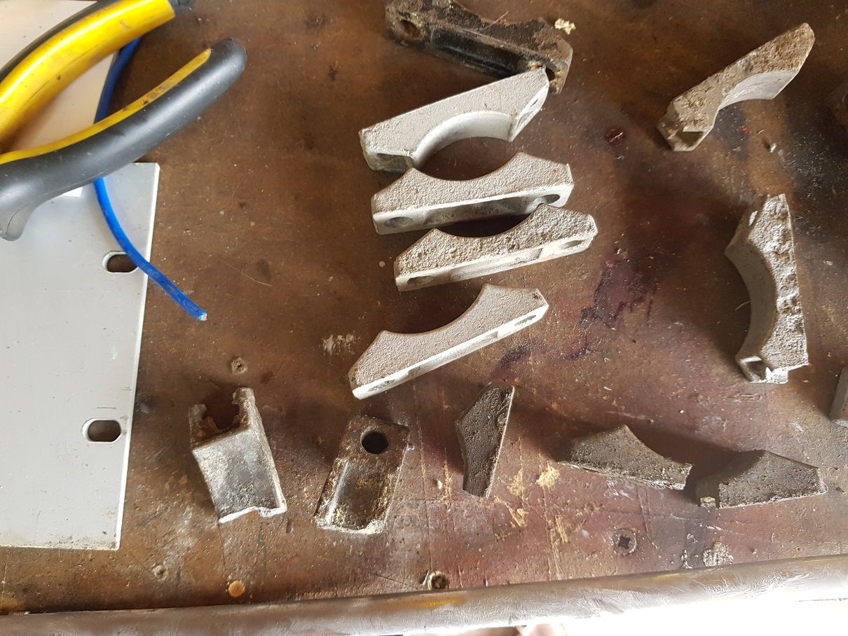

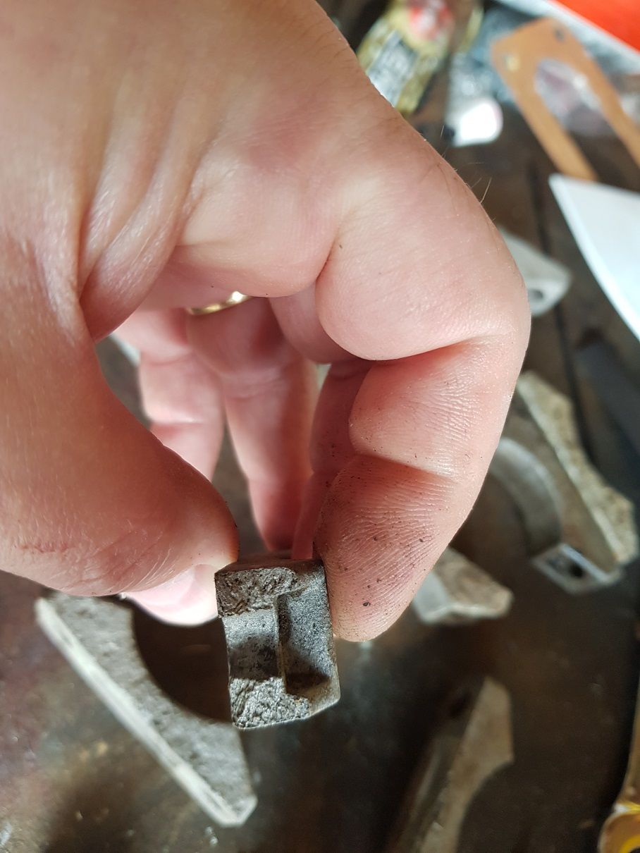

      Click image for larger version  Name:	20200331_125544.jpg Views:	0 Size:	131.1 KB ID:	5598Click image for larger version  Name:	20200331_125510.jpg Views:	0 Size:	148.5 KB ID:	5599
      More examples, as you can see from castings that are cracked, the casting is not dense at all. Hence Mikes comment "monkey metal"

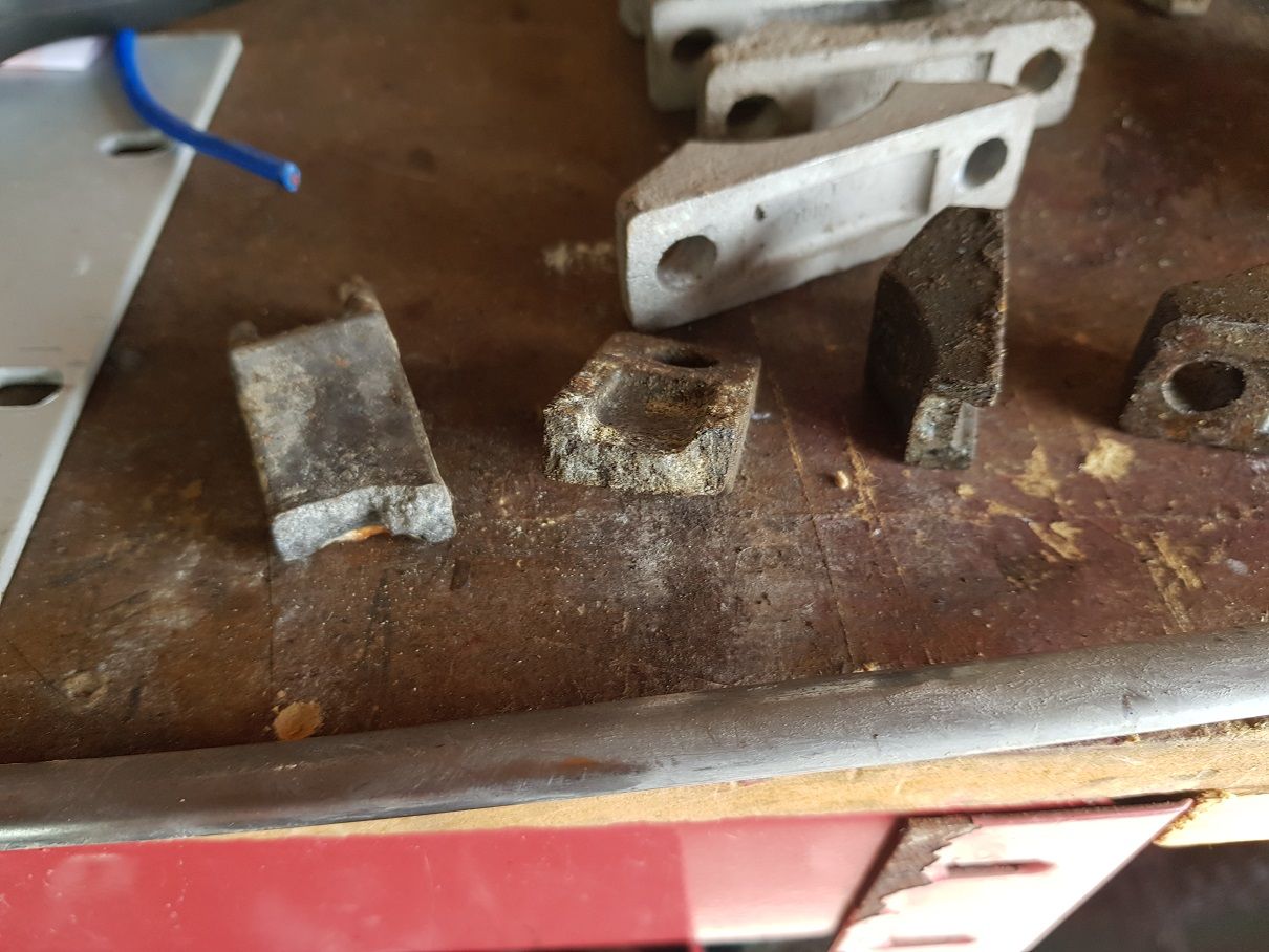

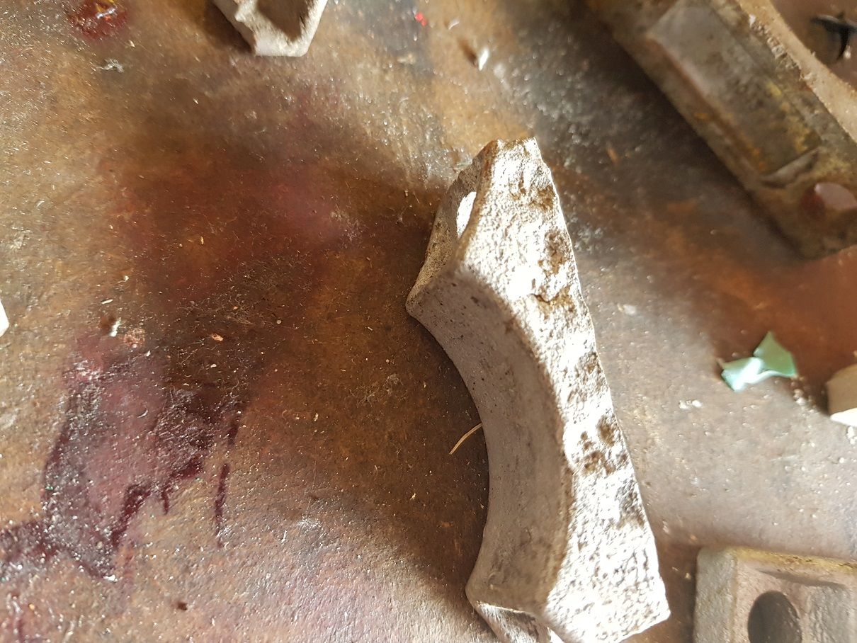

      Click image for larger version  Name:	20200331_125542.jpg Views:	0 Size:	124.9 KB ID:	5600Click image for larger version  Name:	20200331_125518.jpg Views:	0 Size:	204.7 KB ID:	5601
      See how bad the pitting is, these mounts had the damage hidden with grease and oxidisation., clear those away and the mount you have left is useless

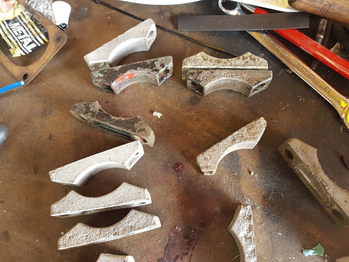

      Click image for larger version  Name:	20200331_125513.jpg Views:	0 Size:	211.0 KB ID:	5602Click image for larger version  Name:	20200331_125523.jpg Views:	0 Size:	206.2 KB ID:	5603
      More of the same.
      Note the bracket on left, I have seen WAY TOO MANY cars with these missing, That is actually part of the sturucture and the ONLY item that will hold your steering rack in any way if those castings break.
      Leave these off and you invite doom to the door step.

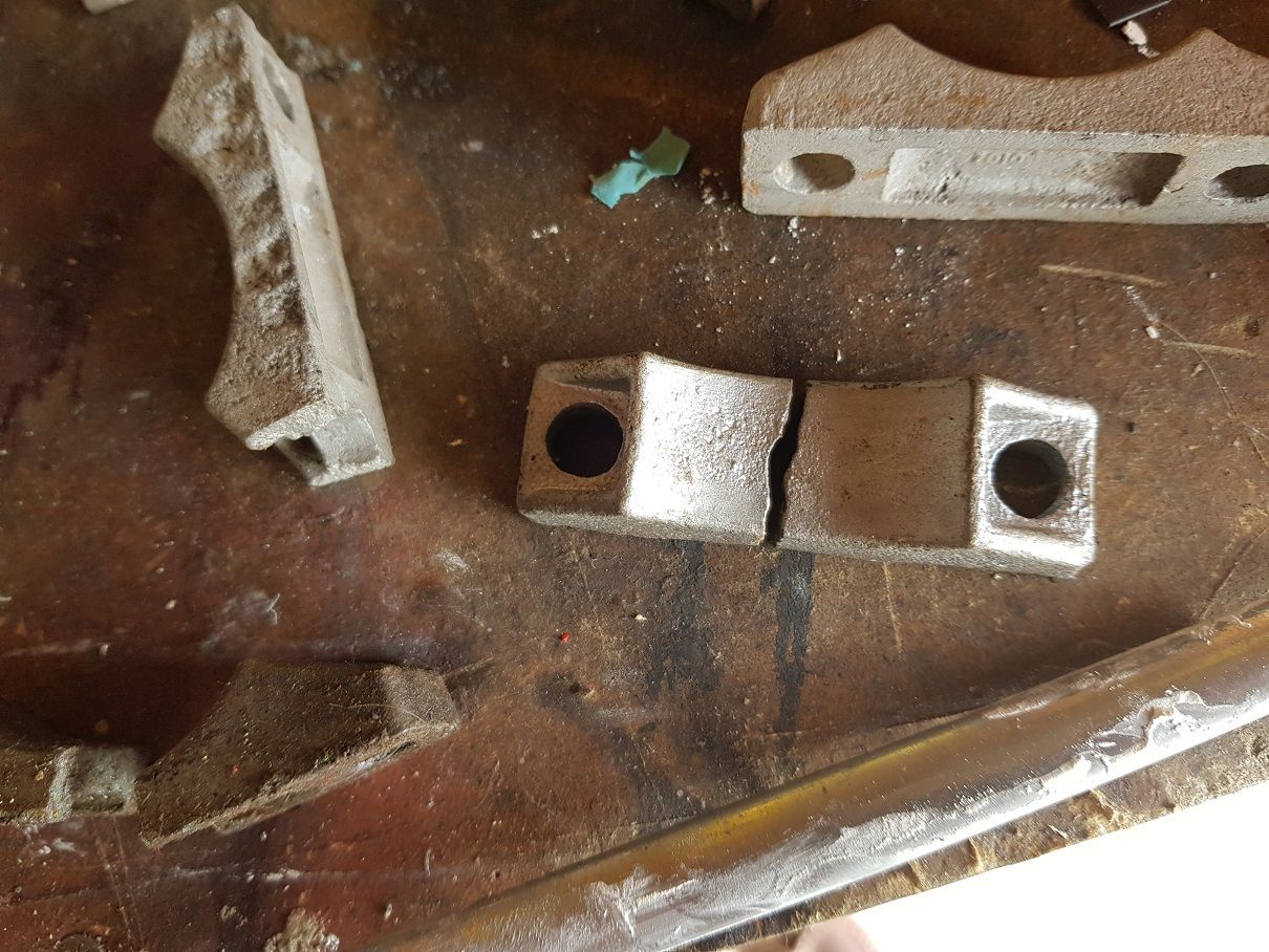

      Click image for larger version  Name:	20200331_125521.jpg Views:	0 Size:	211.5 KB ID:	5604Click image for larger version  Name:	20200331_125526.jpg Views:	0 Size:	266.0 KB ID:	5605
      Final few.
      I remember throwing out a much bigger box of these to the scrap skip (along with stuff I should have kept !)
      It is way too common a defect and one of my fears as regards this "no mot needed" eco system we have now in the classic car scene.
