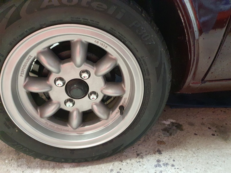

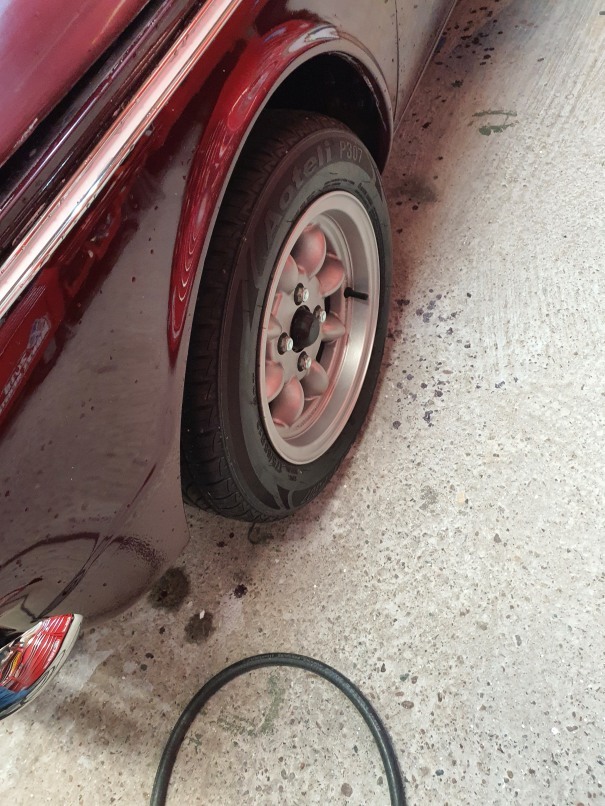

    Did a bit more on this today as someone asked about the wheels I have fitted to DDG
    Fronts are 6J x 13
ID:	18068 Click image for larger version

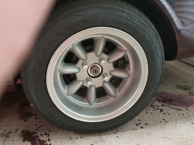

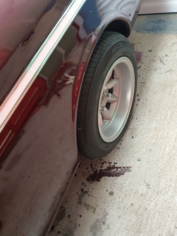

    Rears are 7J x 13
ID:	18069 Click image for larger version
    They do fill the wheel tubs nicely but I did not order them like that as the wheels were inherited and simply put on to look and see.

      6"s up front and 7"s on the rear seem to be the preferred option John rom what I have heard since ever having an Imp. Nice compromise for filling out the arches.
      I am on the lookout for a pair of 6x13 so I can replace the 7x13's I have on the front which just don't fit under the arches as they should as one of them rubs more than the other. Minilight style I have similar to yours.
        Not sure where these ones came from Col, Paul had a set of 6x13 all round on his car, then he found a set of 13x7 but the 7s are no good on the front of an imp, especially with a zero offset
        Ended up the 7 at back 6 at front combo worked well so we got the 2 cars out of them.
        He has kept the black centres, I had these ones vapour blasted to clean up (the 7 were minging, painted with dulux I think) and after blasting I had them ceramic coated clear to seal them.
        No brand on them, just say "PERFORMANCE" and the AS standard number, they are quite light though even with the tyre.
