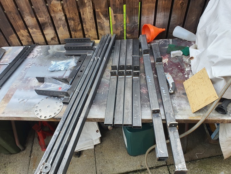

    Cleaned up now with degreaser and scote brite and then some acid etch and left over night

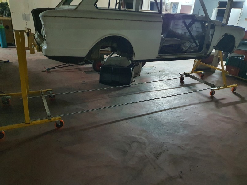

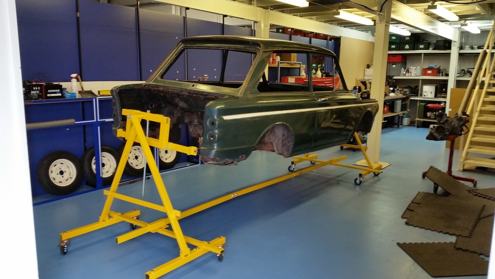

    Assembled here is the one I used in 2016

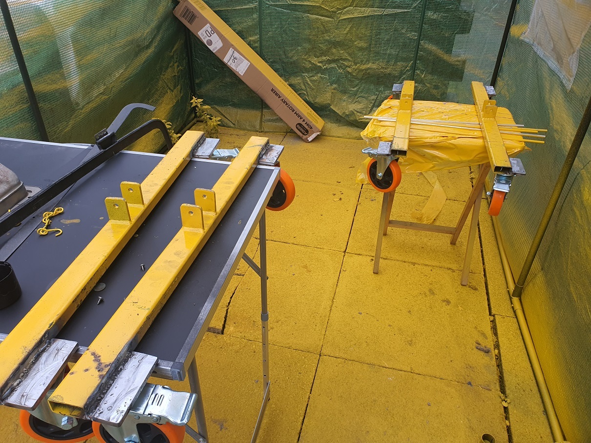

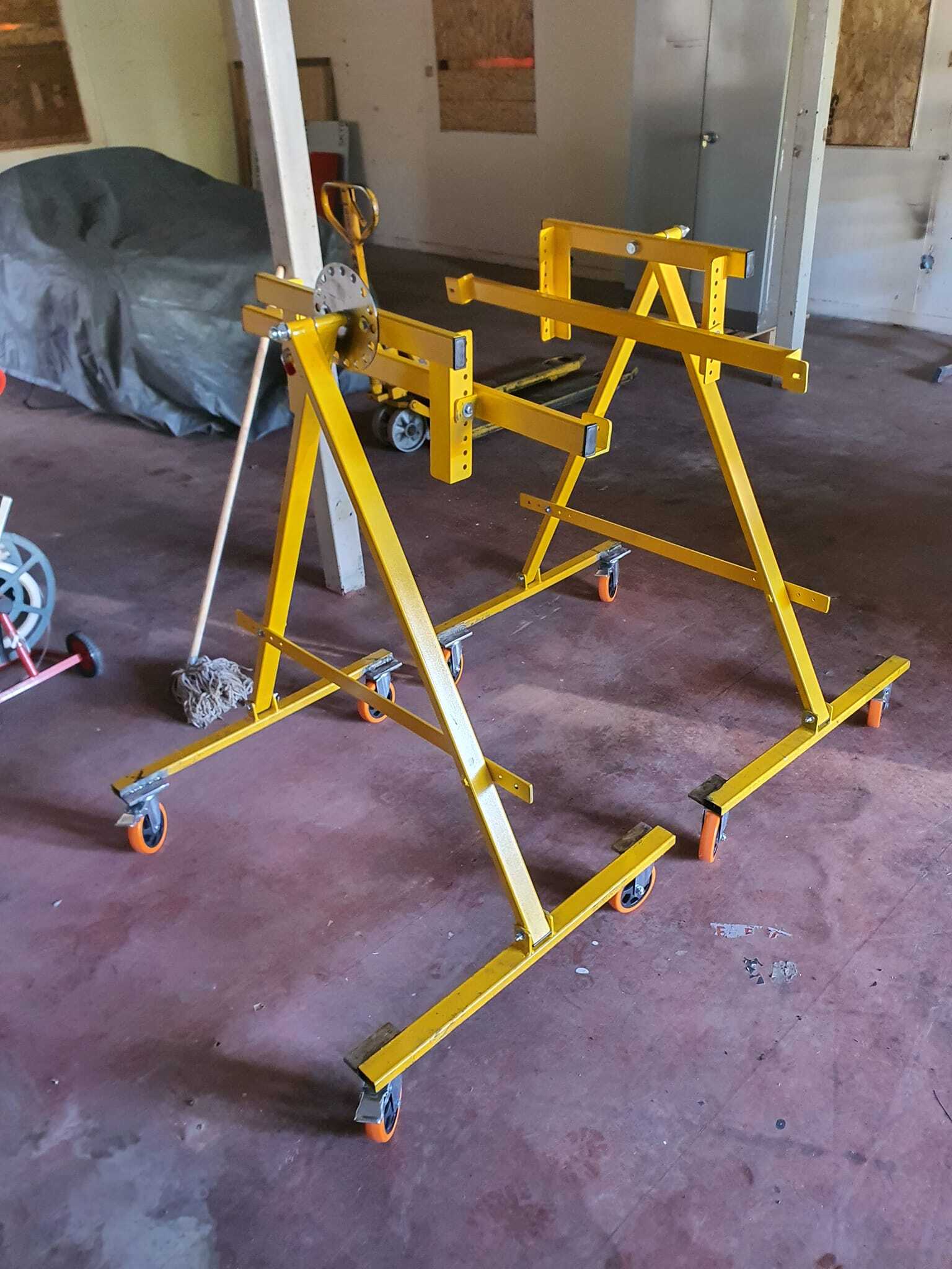

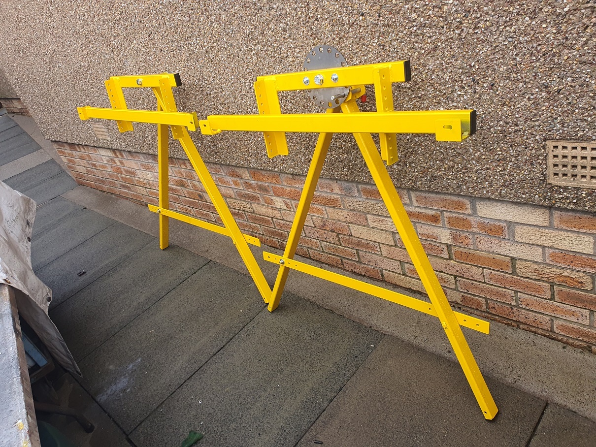

    Bare steel all coated up.
    Must admit I really like this coating
    BESA URKI RAPID 70
    Colour is a personal taste as I have never been a lover of machine room green, red or black

    Castors arrived and hopefully the plastic cend caps tomorrow
    When I did the last jig in this coating it was hit by other paint system and wiped clean with thinners, pertol, solvents, brake fluid ...... all manner of nasties.
    It even laughs at Nitromors !!!!
      Thats nearly all she wrote
      The evil fixture known as the rollowver jig, apparantly using one of these to restore your car is dooming the result to failure

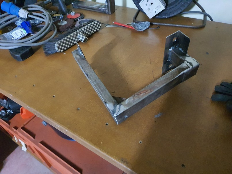

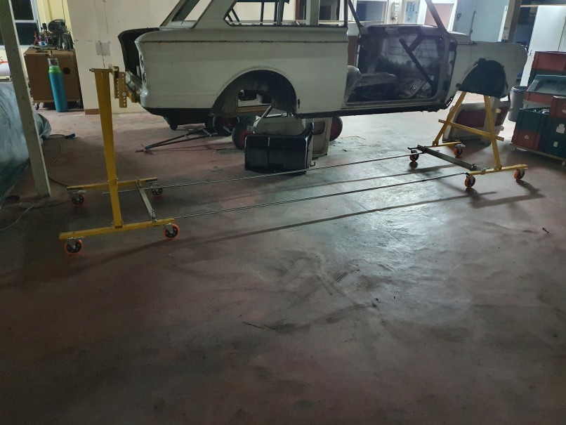

      All welded up, extensions added for the larger braked castors and just neeing painted
      I wont be able to add the cross braces and front/back braces until I can get room, ideally with a car on board so I can use the laser align tools to get it square.
      This welding outside is chronic, plays hell with the shield gas even at high frlow rates. Really looking forward to being inside again

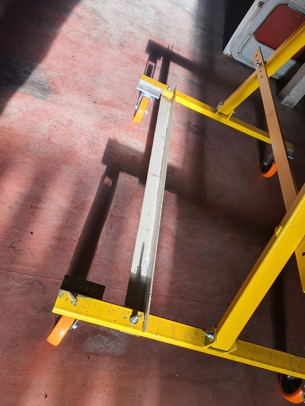

        Thats the frtame dropped off at workshop just waiting on some time to make the extra brace bars and finish re-painting.
        The brace bar holds the front a bit more securely and as I have lost my drawings I need to make it when tghe car is supported and on the frame, wont take long
        Paul commented same as me on the paint not feeling right, I thought it was just me and was down to the cold. My gut is telling me the advice of the paint supplier to use standard thinners rather than the manufacturers was bad advice as my experience with this coating is its brick hard.
        We will see, its much warmer where it is now

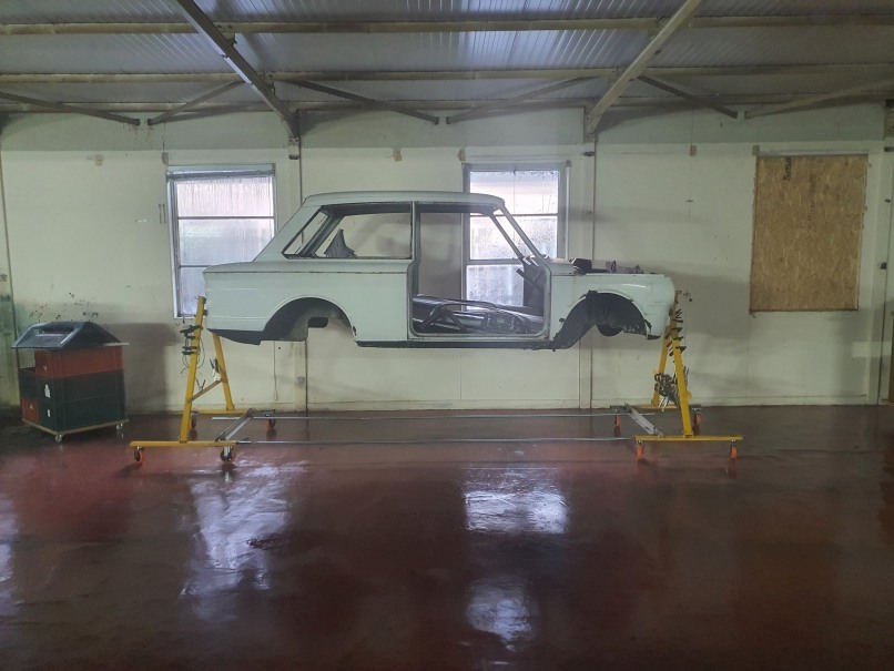

        Now to get the car
        So far about a day and half on welding, cutting and painting to get to this stage, not too bad.

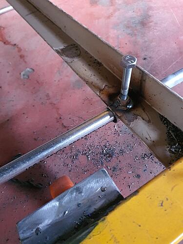

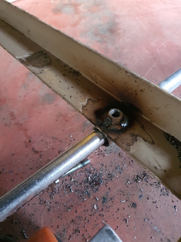

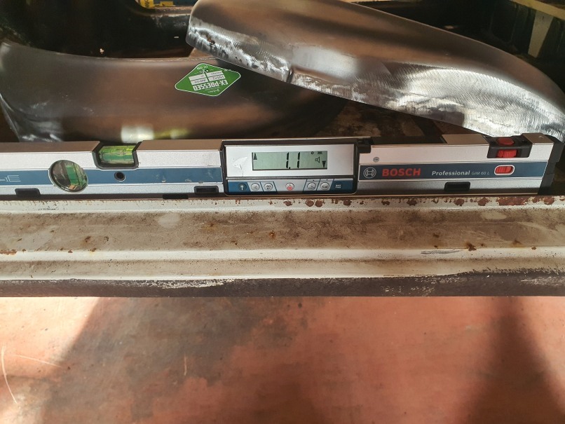

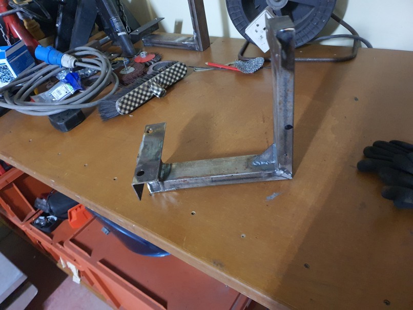

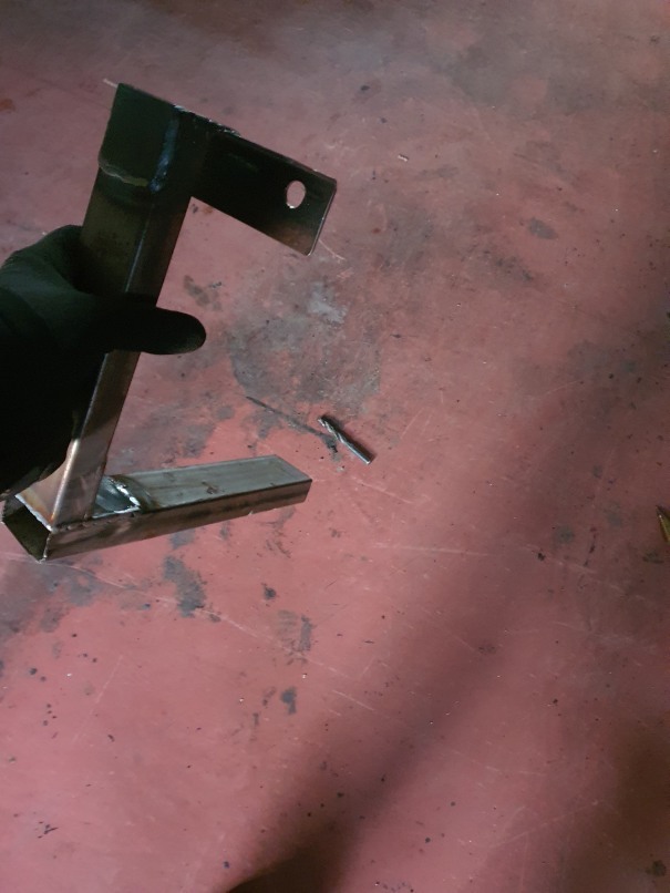

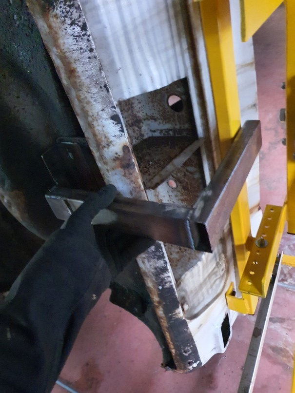

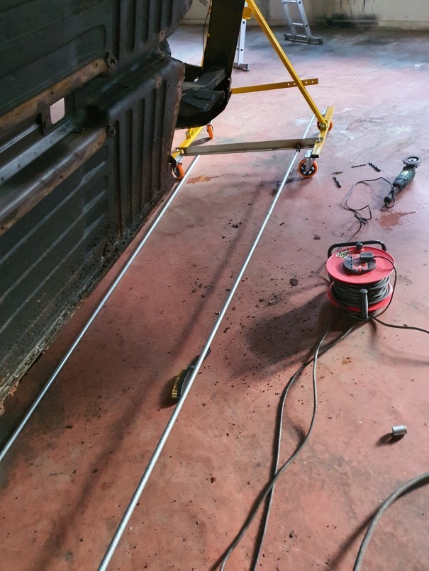

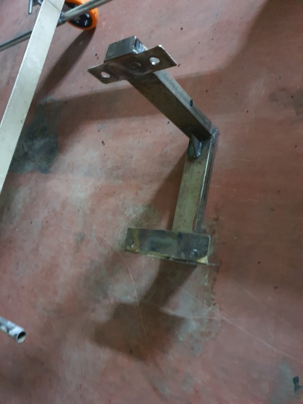

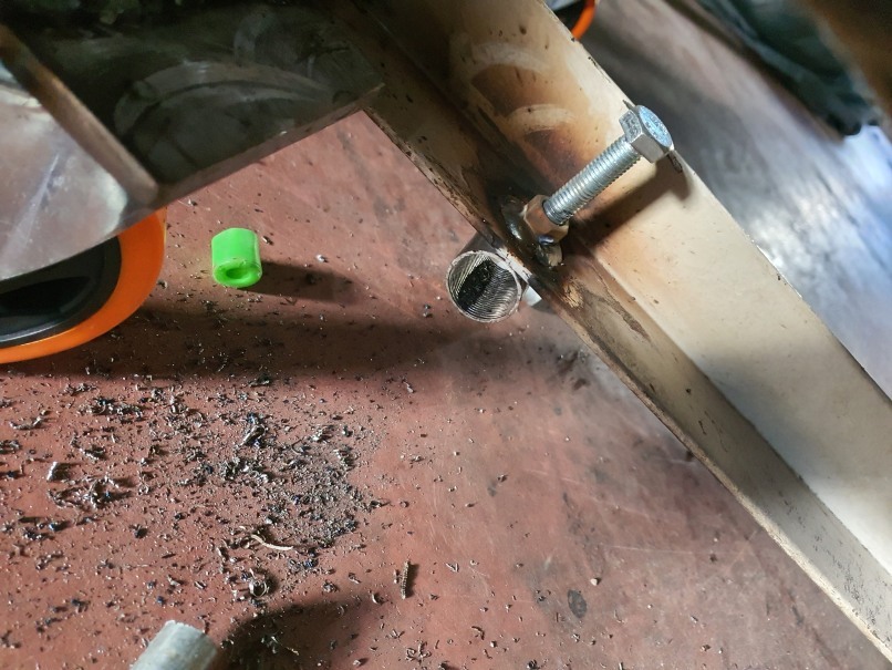

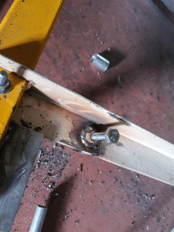

          And a few more images of the mods to let the car move around, the structures on the Imp where the jig attaches are not as strong as you would think

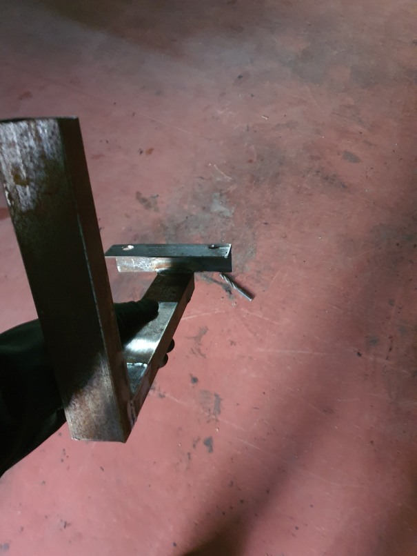

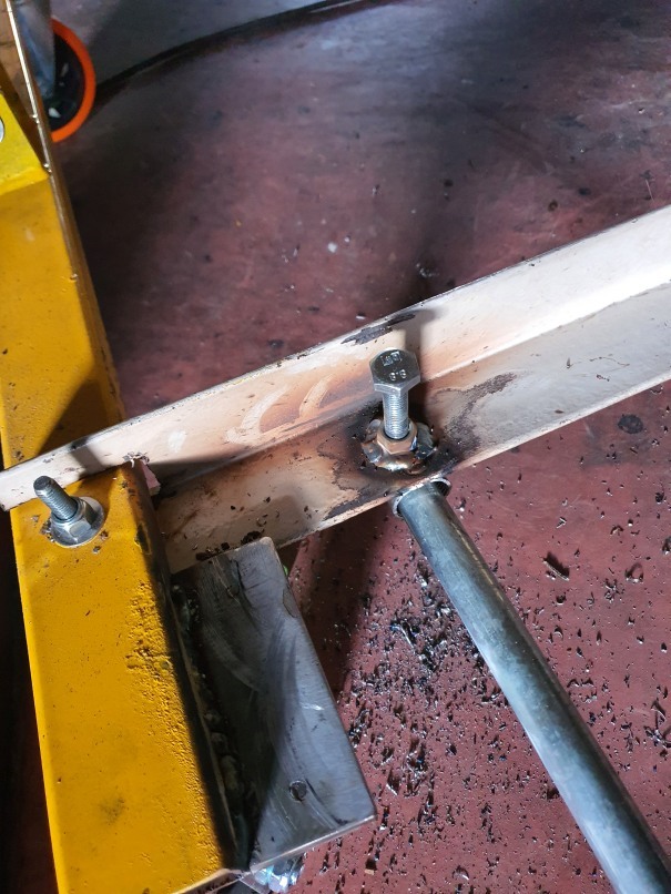

            And an extra brace for the front mounts, you really need to watch those front bumper mounts, two small bolts for a full car ??

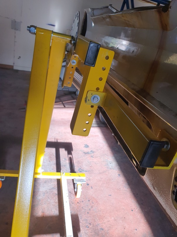

              And quick as a flash, those bottom parts are fitted
                Well done John,
                Looking good there and ready for the cutting discs and grinders now..
                Wish I could move that fast!!!
                  Blame it on the christmas chocolate binge
