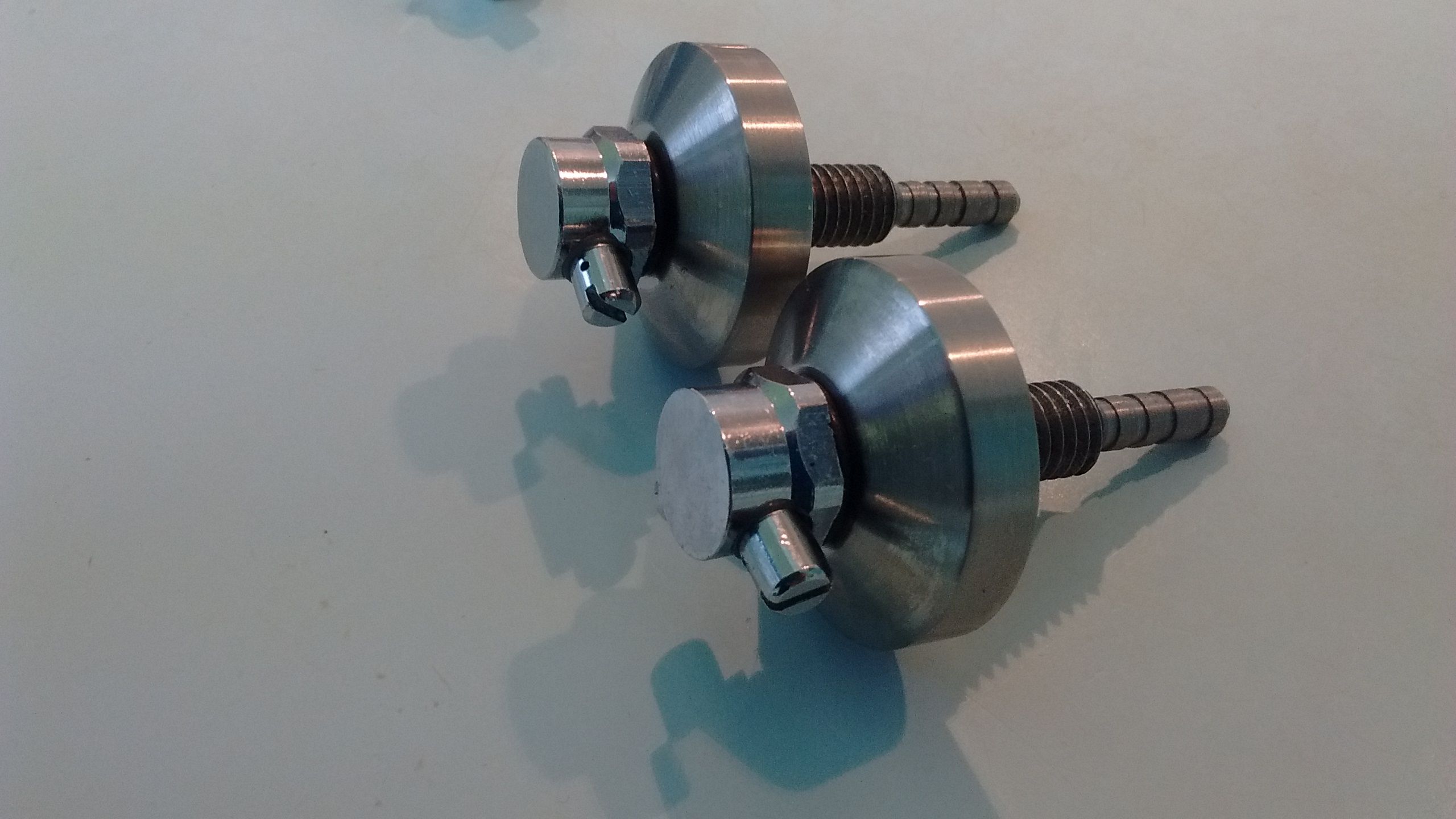

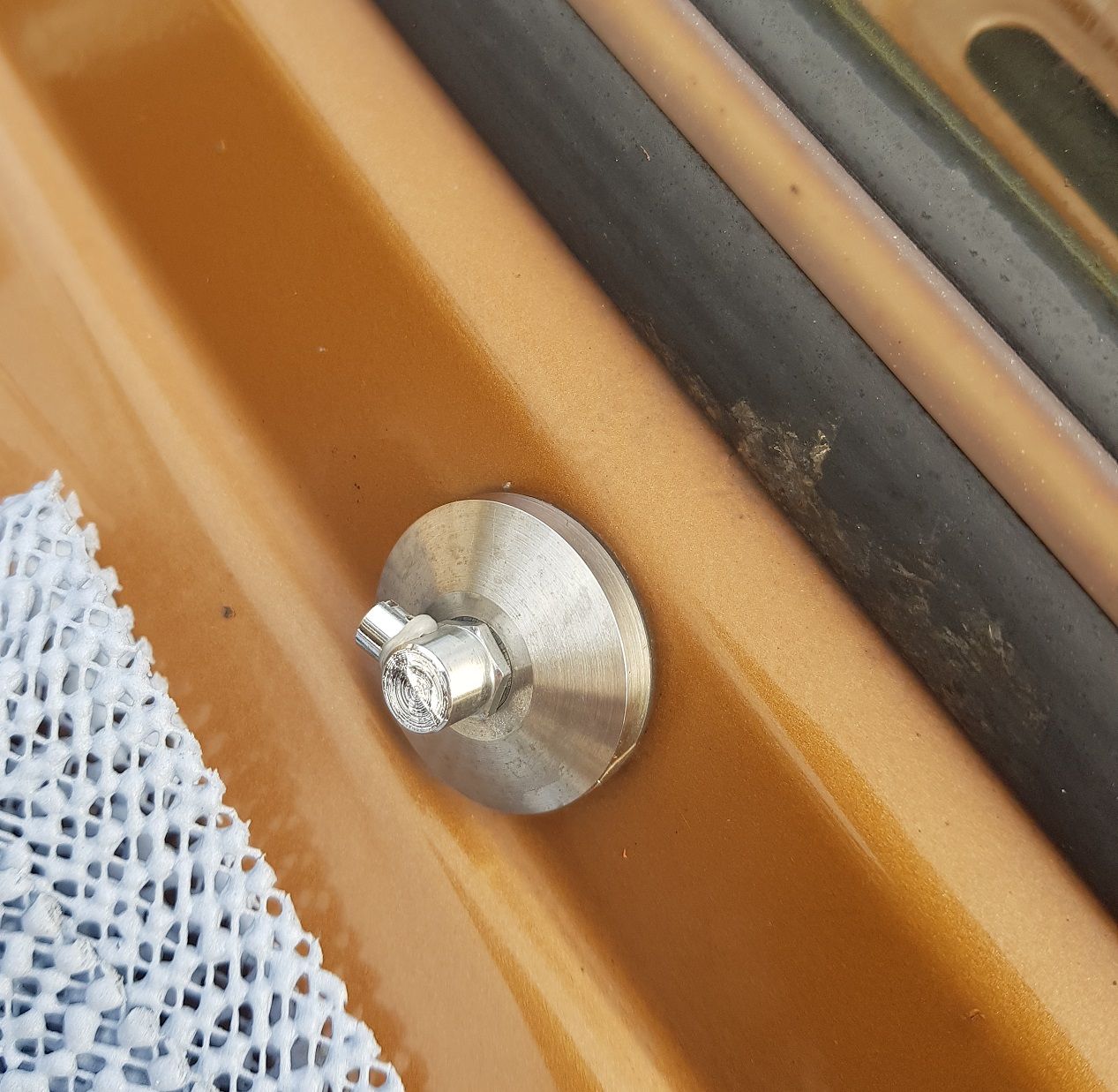

    Below as you can see I replaced my existing "pic-jets" with some new style ones from bob to see what the difference was like.
    On Boris I already have them installed for a long time now but as a single side mounted jet. It was interesting to see how the pattern on these went as there is no vertical adjustment to speak of,

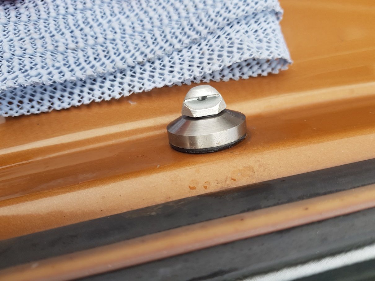

    Standard jet (single) that i selected originally
    Click image for larger version  Name:	20200201_125534.jpg Views:	0 Size:	270.2 KB ID:	3668 Click image for larger version  Name:	20200201_125812.jpg Views:	0 Size:	450.6 KB ID:	3669

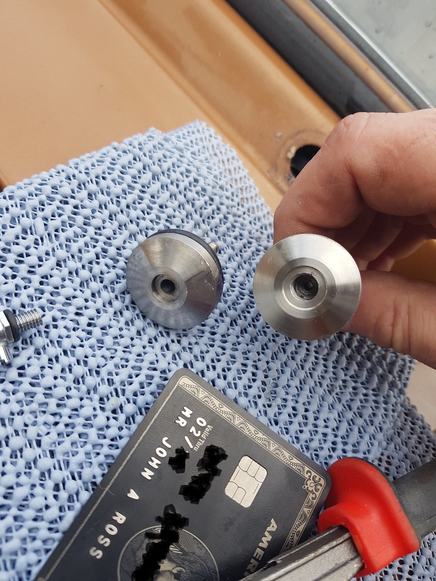

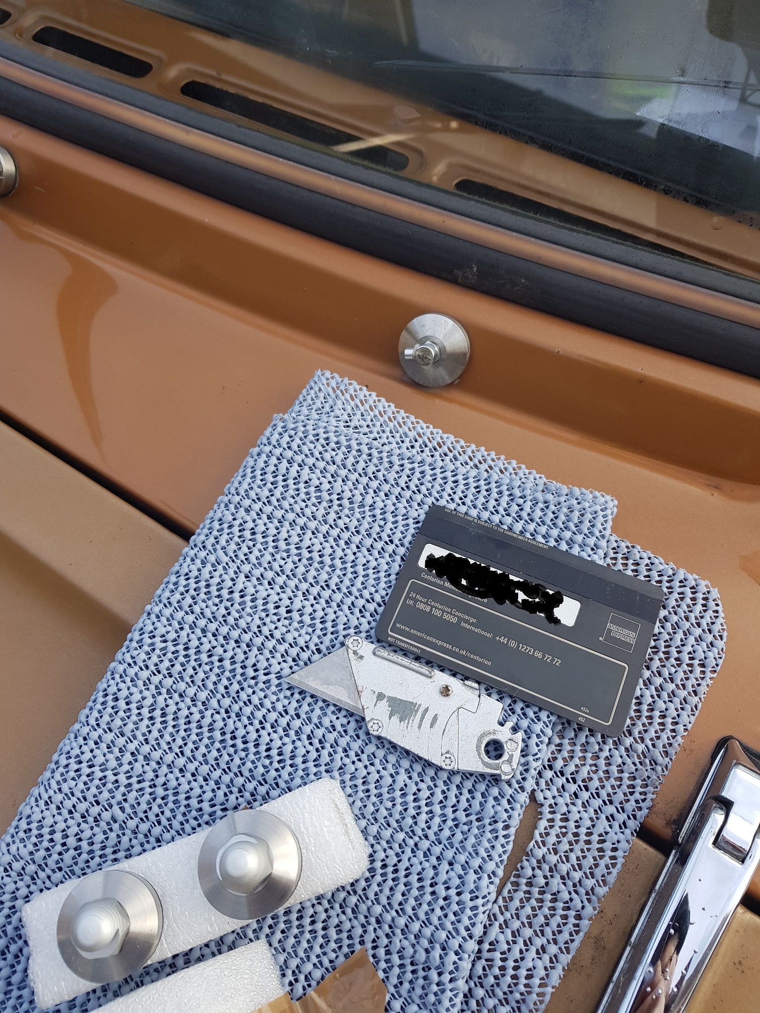

    Installation process is just the same, loosen off jet holder body, get in behind the jet and O ring with metallic blunt edge (i used my credit card) as it needs a firm push to free off the clips behind, the sping material is pretty strong.
    Removal of existing jet (same process as standard one as clip is the same)
    The new jets rhemselves have a different fixing from the other ones so need a matching jet body

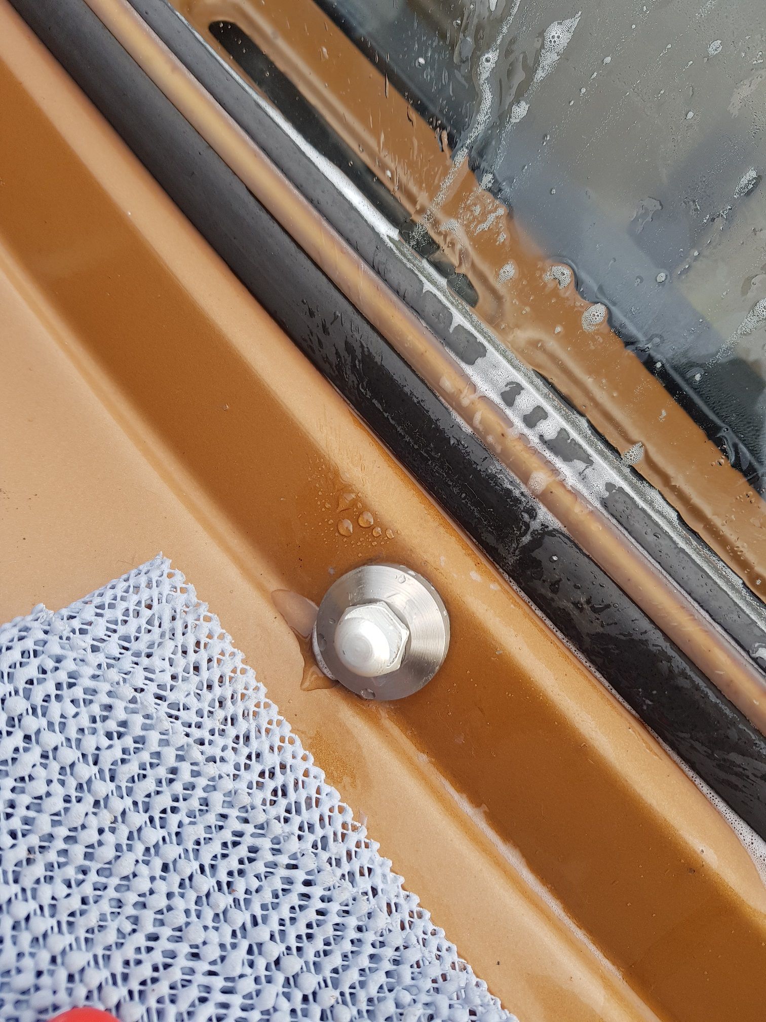

    Thats the new ones in
    Click image for larger version  Name:	20200201_130646.jpg Views:	0 Size:	133.6 KB ID:	3677 Click image for larger version  Name:	20200201_130739.jpg Views:	0 Size:	562.2 KB ID:	3679

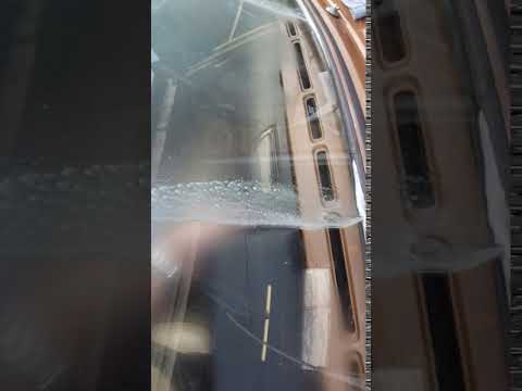

    New spray pattern on passemger jet, standard jet on left
    One comment I would make is the new jests seem to use a lot more fluid at one time, could result in less sprays needed but more likely result in a bigger washer bottle needed, the little bag inside Boris bonnett wont last long !

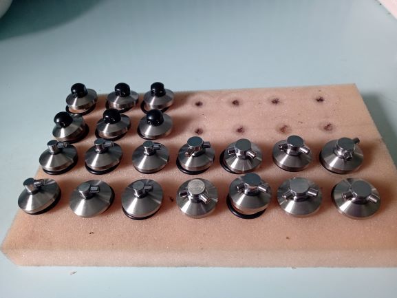

      The single jet chrome unit has a 5mm thread , it is the only one that size, all the other types have an 8mm thread , l have stocks of single jet chrome but haven't fitted any to housings yet .
      l have just made a batch of 10 cars worth , 7 sets with 8mm thread with 3 sets left unmachined should anyone want the single chrome jet which l am now allocating as a special order.
      Also made a few of different design that will fit fibre glass boot lids (Petulas) also looking at fitting Marcos .

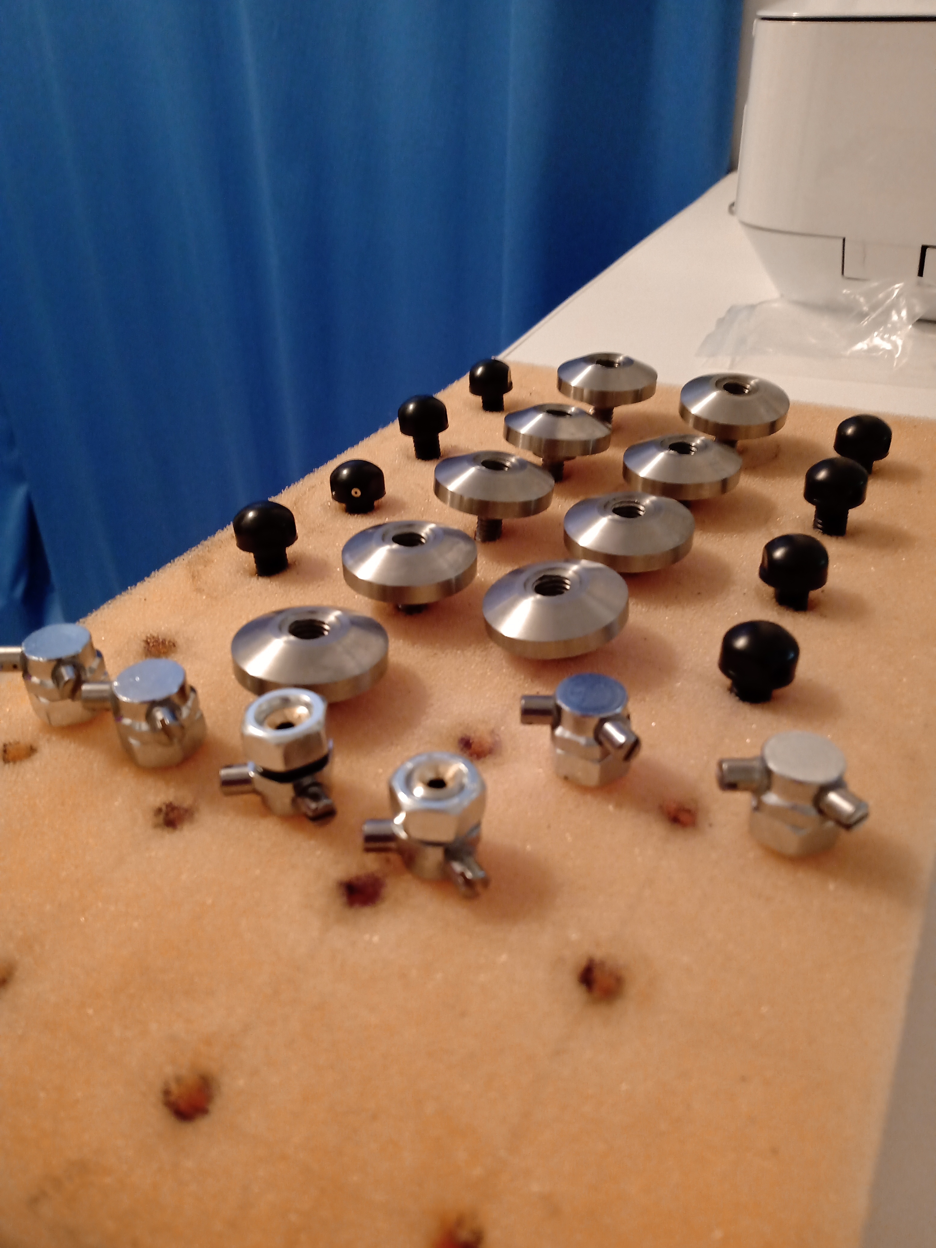

        Put together this little package today , some finished ,some not , some modified jets ,some not yet modified , also pictured two styles for boot\bonnet mounted on fibre glass , one pair being sent out for fitment to Marcos ,the other probably going on Petula​ pictured also shows two cars worth of sump\ gearbox magnetic drain plugs.

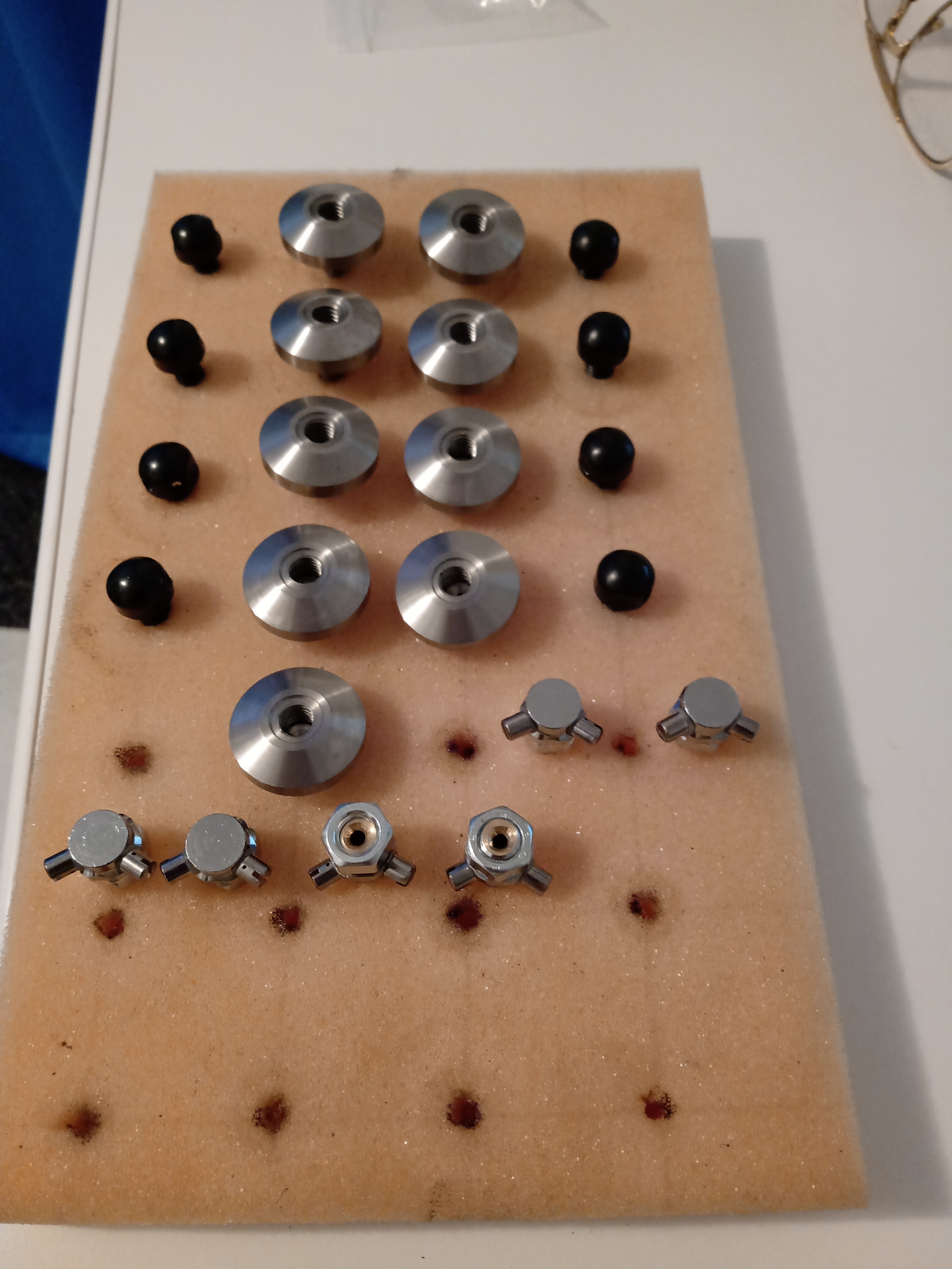

          After a flood orders for washer jet kits completely emptied the shelf , l've made a small batch and jets just arrived so l'm up and running again on ebay with double jet
          plastic and double jet chrome , need to make some more housings for single chrome jets.
          4 1\2 sets , one ended up in scrap bin .

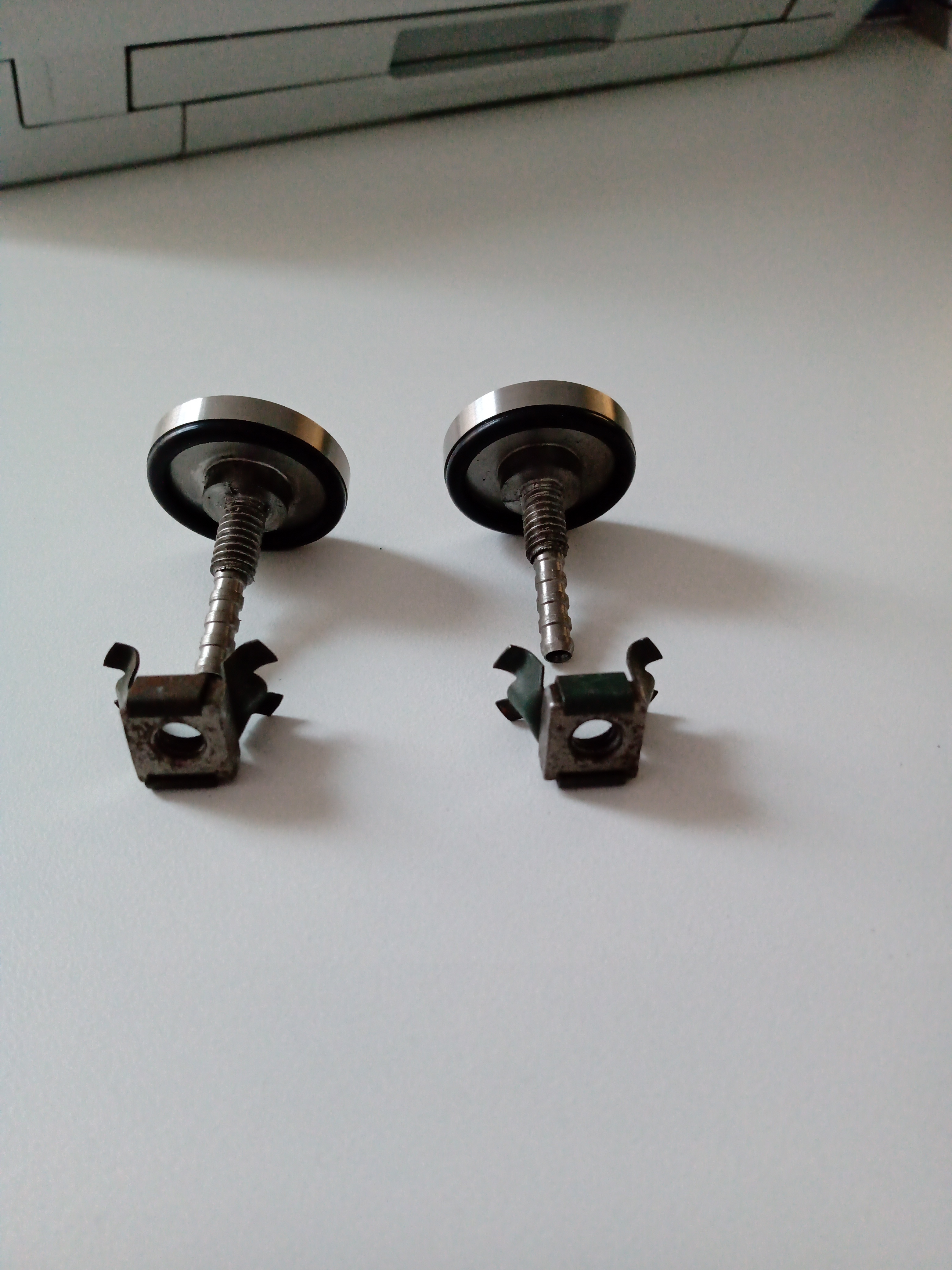

            Pictures of clips for those that haven't ventured that far into replacing the jets
