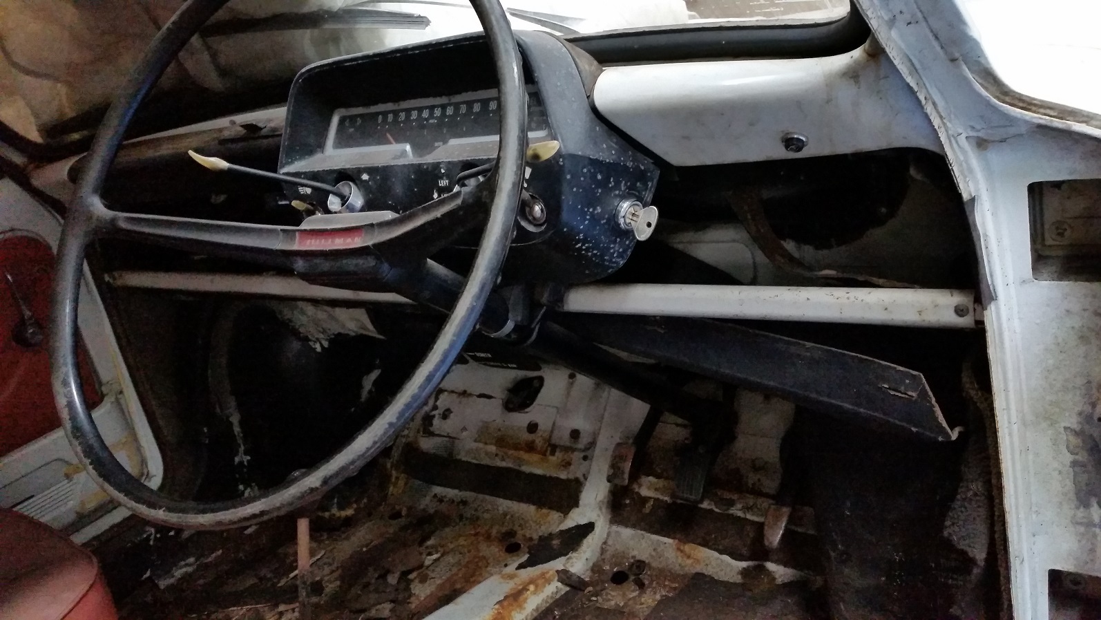

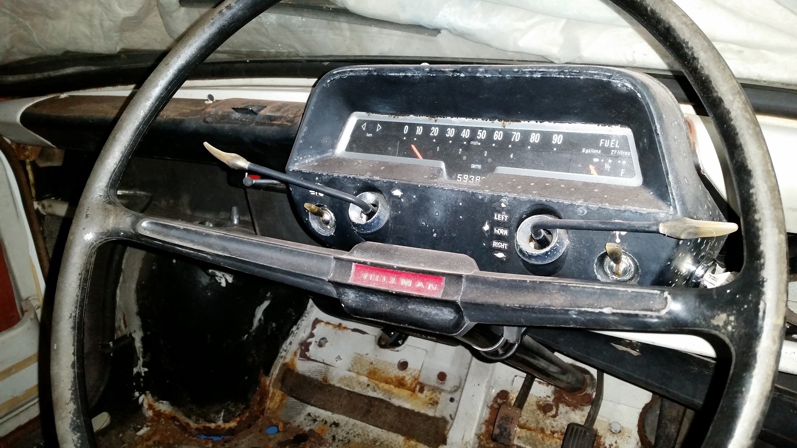

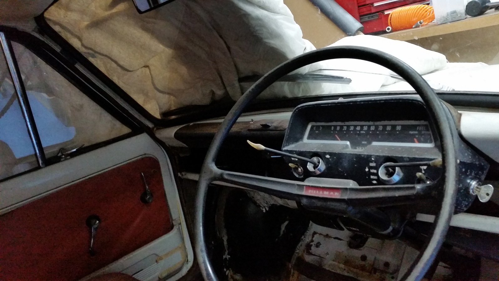

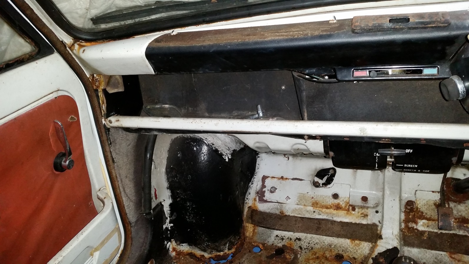

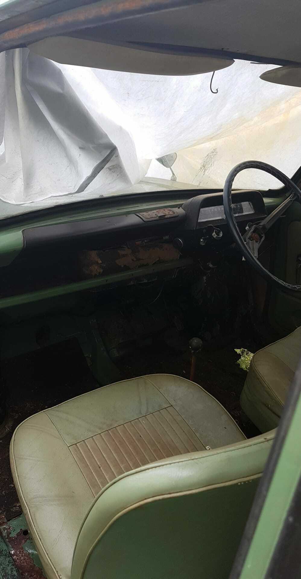

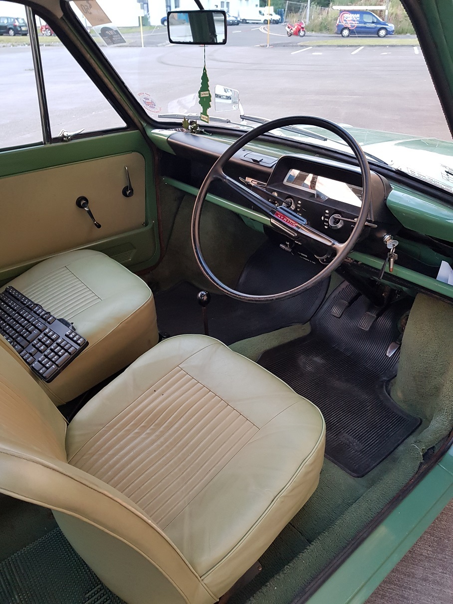

    Early MK 1 dash areas are sometimes called "metal ended" as the right hand side of the binnacle (assuming RHD vehcile) has no pad and only painted.
    See two examples of MK 1 dash here
    Click image for larger version  Name:	PIC-09110.jpeg Views:	0 Size:	88.6 KB ID:	8759Click image for larger version  Name:	PIC-09022.jpg Views:	0 Size:	373.3 KB ID:	8760
    Click image for larger version  Name:	PIC-00497.jpg Views:	0 Size:	366.3 KB ID:	8761Click image for larger version  Name:	PIC-00498.jpg Views:	0 Size:	346.5 KB ID:	8762
    Click image for larger version  Name:	PIC-00501.jpg Views:	0 Size:	427.5 KB ID:	8763Click image for larger version  Name:	PIC-00481.jpg Views:	0 Size:	458.9 KB ID:	8764

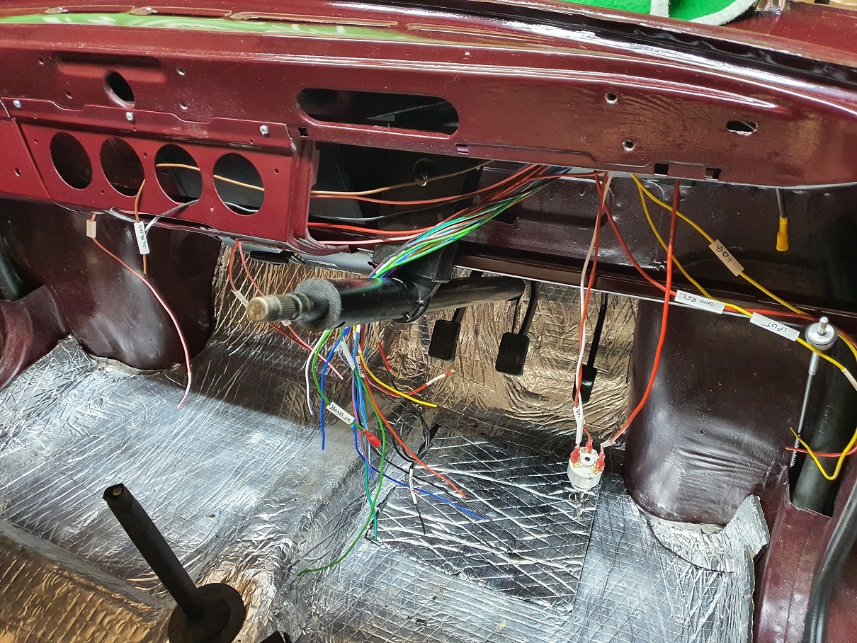

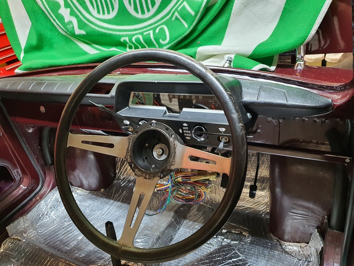

    And examples of a MK 2 binnacles (end 64 onwards)
    Click image for larger version  Name:	PIC-08154.jpg Views:	0 Size:	371.1 KB ID:	8766
    Click image for larger version  Name:	20200523_191908.jpg Views:	0 Size:	581.3 KB ID:	8767Click image for larger version  Name:	20200517_193220.jpg Views:	0 Size:	493.5 KB ID:	8768
    Main difference is the method of mounting the binnacle, the early ones bolts upwards from underneath and is capped with a thing cover plate.
    The later binnacle the top cover plate and mounting hardware is a single unit and bolts horizontally onto the square surface on the front

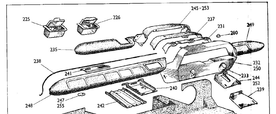

    Here it is in the parts manual, this is quite confusing as it shows all options in one drawing but the binnacles are quite different and cannot be swapped without some effort
    Click image for larger version  Name:	parts.jpg Views:	0 Size:	133.2 KB ID:	8769
    Typical parts for MK 1 "metal end" binnacles
    Part 231 - Binnacle rear included vertical screw fixings from under binnacle
    Part 232 - Binnacle front
    Part 235 - Centre dash cover panel - secured from front with standard screws and special cup screw covers.
    Part 237 - Binnacle cover plate
    Typical parts for MK 2 binnacles
    Part 245 - Binnacle rear includes horizontal mount flanges
    Part 250 - Binnacle front
    Part 248 - Centre dash PADDED cover panel secured from rear
    Part 249 - Right hand dash PADDED cover panel secured from rear
