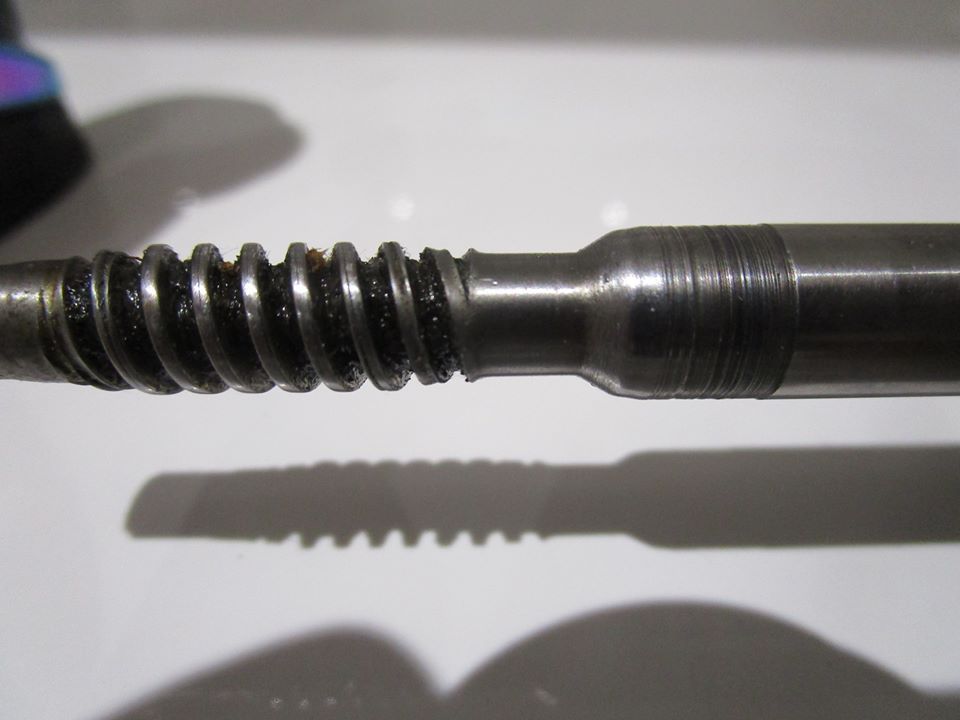

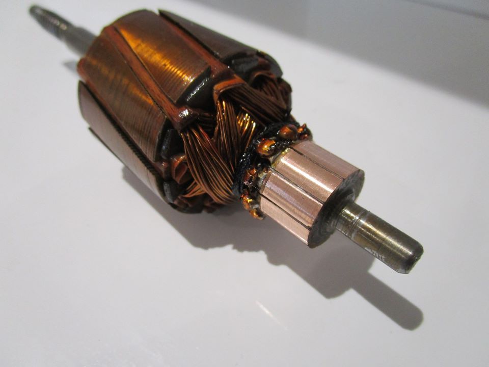

    So the Singers wiper motor was making strange noises and this was tracked down to a worn armature shaft .
    No probs as we might have some at work and after much hunting found a S/H one with a near perfect shaft , winding was shot thats no issue .
    Also they have been a tad slow , wether due to the shaft wear or something else im not sure however every test I did came up with nothing , no stiff wheelboxes or cable , voltage fine etc etc .
    Anyway as the armature needed a rewind and having got the original winding spec I altered it in the hope of more speed .
    And it worked - almost too well ?, nice to have decent wipers at last

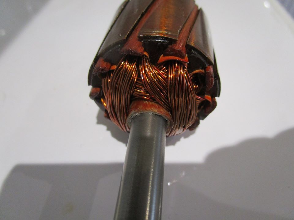

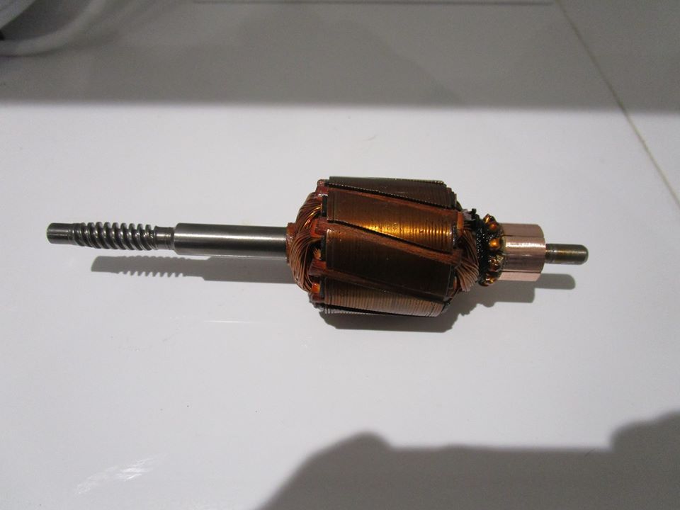

    One very worn Shaft , ----------------------------------------------------------------- its replacement was perfect ,this image is after the rewind obviously
    Click image for larger version  Name:	88259181_10222225087715790_8872090793473474  56_n.jpg Views:	0 Size:	51.8 KB ID:	4739Click image for larger version  Name:	88060266_10222225088075799_1807438086309675  008_n.jpg Views:	0 Size:	44.1 KB ID:	4740
    Comm turned and undercut Tother end , known as the Comm end -------------------------------------And this is the back end
    Click image for larger version  Name:	88438119_10222225087875794_1805833177290244  096_n.jpg Views:	0 Size:	52.3 KB ID:	4741Click image for larger version  Name:	87974762_10222225088115800_7854934489288409  088_n.jpg Views:	0 Size:	54.6 KB ID:	4742

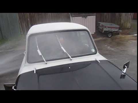

    End Result

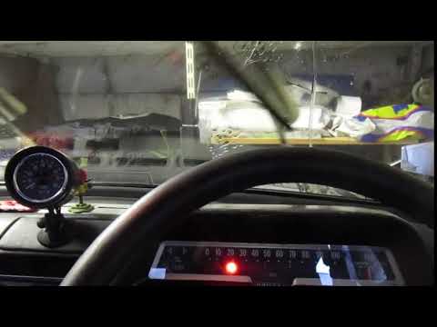

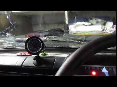

    As they were on the old armature , this is engine off. rather slow to say the least
    Much Better , same as above , engine off - background noise is my neighbour who decided just then to pressure wash his car
    And end result, sorted !

          Your a magician Dave, Pat, the winding was done at 10V so -2 from where it would be at rest. So was thinking boost converter and do 14V at rest (12>14V boost)
          Should be same effect. My worry is that Daves biggest upgrade is the removal of the 50 year old shellac or varnish and a nice new coat of insulation and baked.

            Thank you , yeh ive got the winding spec if anyone wants to have a go Lucas never even varnished the windings , its loose in the armature . Its done on the cheap really . i use top spec insulation , double coated wire , slots are pegged in and the varnish sets the windings solid - its cooked for 10 hours after its been soaking in it for a day and left to drain off .
