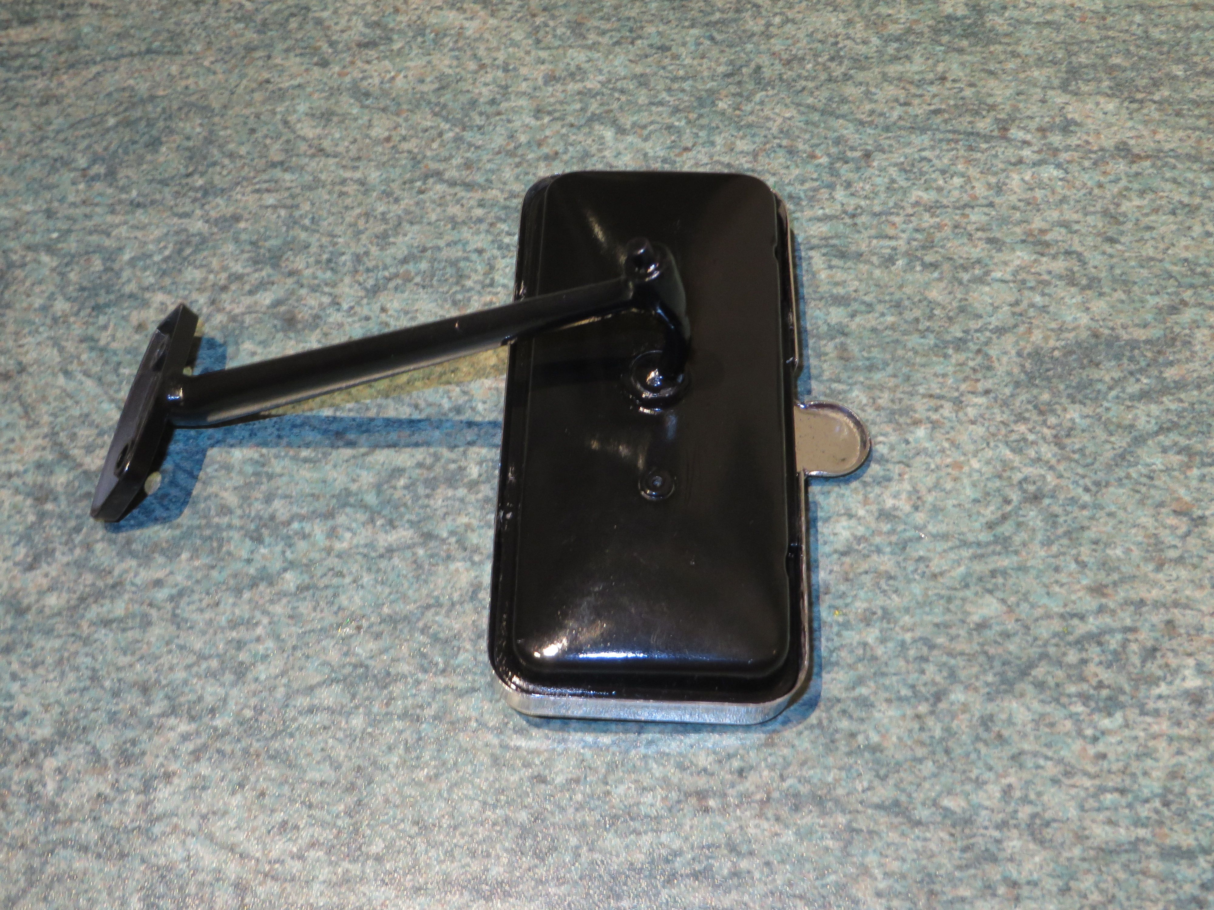

    With the increasing use on moderns of HID headlights and retina removing DRLs a dipping interior mirror seemed a must .

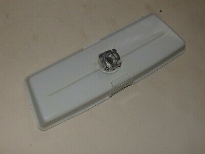

    Wingard who made the Imps interior mirror did do a dipping Mirror that fits straight onto the Imp stem . it was for a Reliant Scimitar ( in black ) and sadly for us poor folk MK1 RS Escorts and Lotus Cortina MK1 and 2 ( in light grey ) , they now cost 3 figures although ive recently got one cheap black one via ebay for Barnaby but as yet its not arrived - il let you all know what its like .

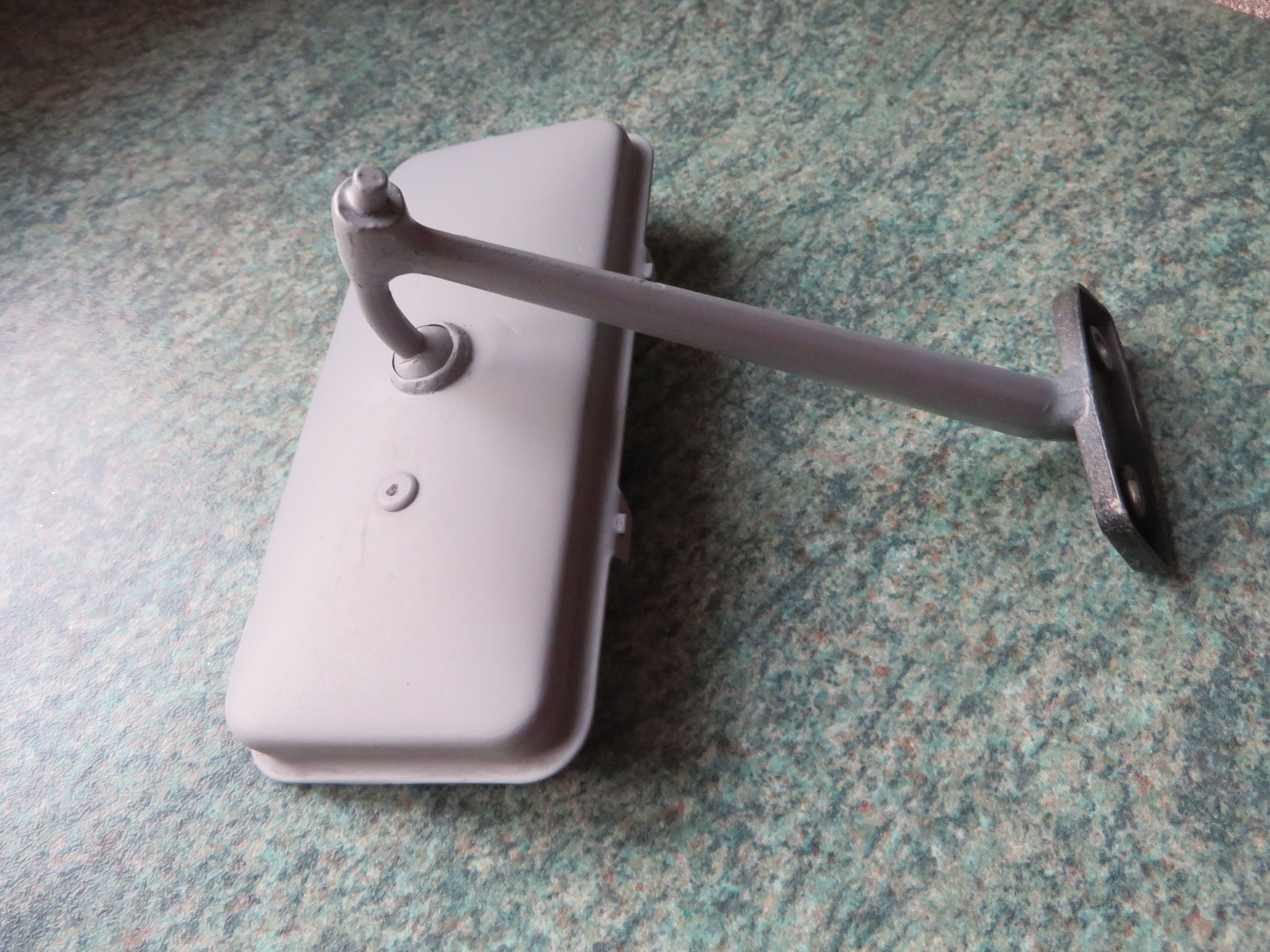

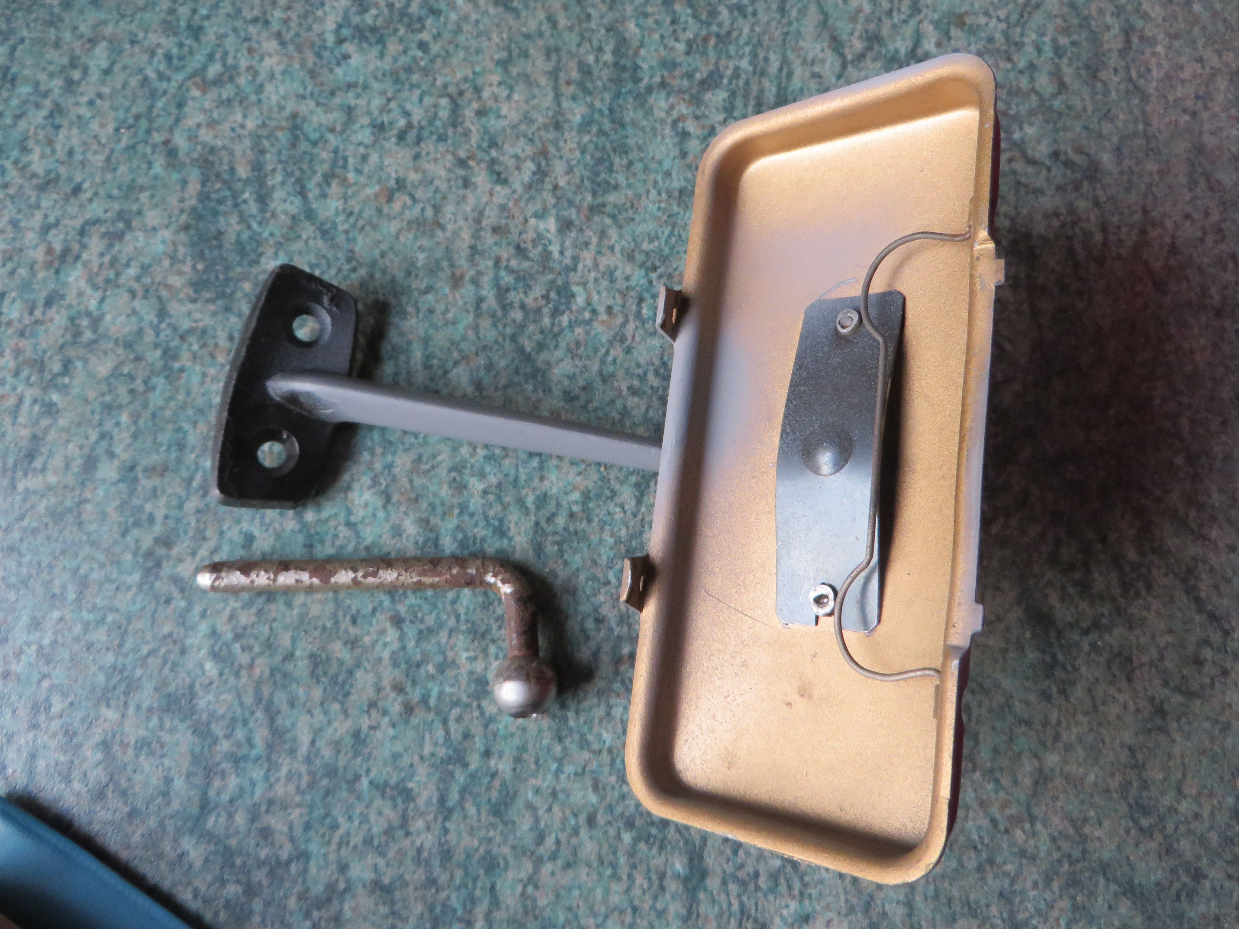

    Anyway I wanted something posher for the Singer and found an early Wingard mirror an Beaulieu which happens to be for an XK150 Jag , ball size was identical and it comes apart . It took a lot of thinking to get the Imp stem in it , basically make the hole bigger in the mirror back , fit the stem through the hole and then close it back up as it was .
    It worked well and whilst the mirror itself is only the size of a standard Imp mirror its perfectly usable and doesnt vibrate .
    I did try a Lucas screw on one and whilst it fitted fine it did vibrate rather badly so had to go
    Click image for larger version  Name:	IMG_8430.JPG Views:	16 Size:	1.47 MB ID:	6859Click image for larger version  Name:	IMG_8429.JPG Views:	6 Size:	1.51 MB ID:	6860Click image for larger version  Name:	IMG_8433.JPG Views:	7 Size:	1.83 MB ID:	6861Click image for larger version  Name:	IMG_8437.JPG Views:	6 Size:	926.7 KB ID:	6862Click image for larger version  Name:	IMG_8436.JPG Views:	6 Size:	970.0 KB ID:	6863

ID:	6866 The Reliant / Escort ones came in light grey or black

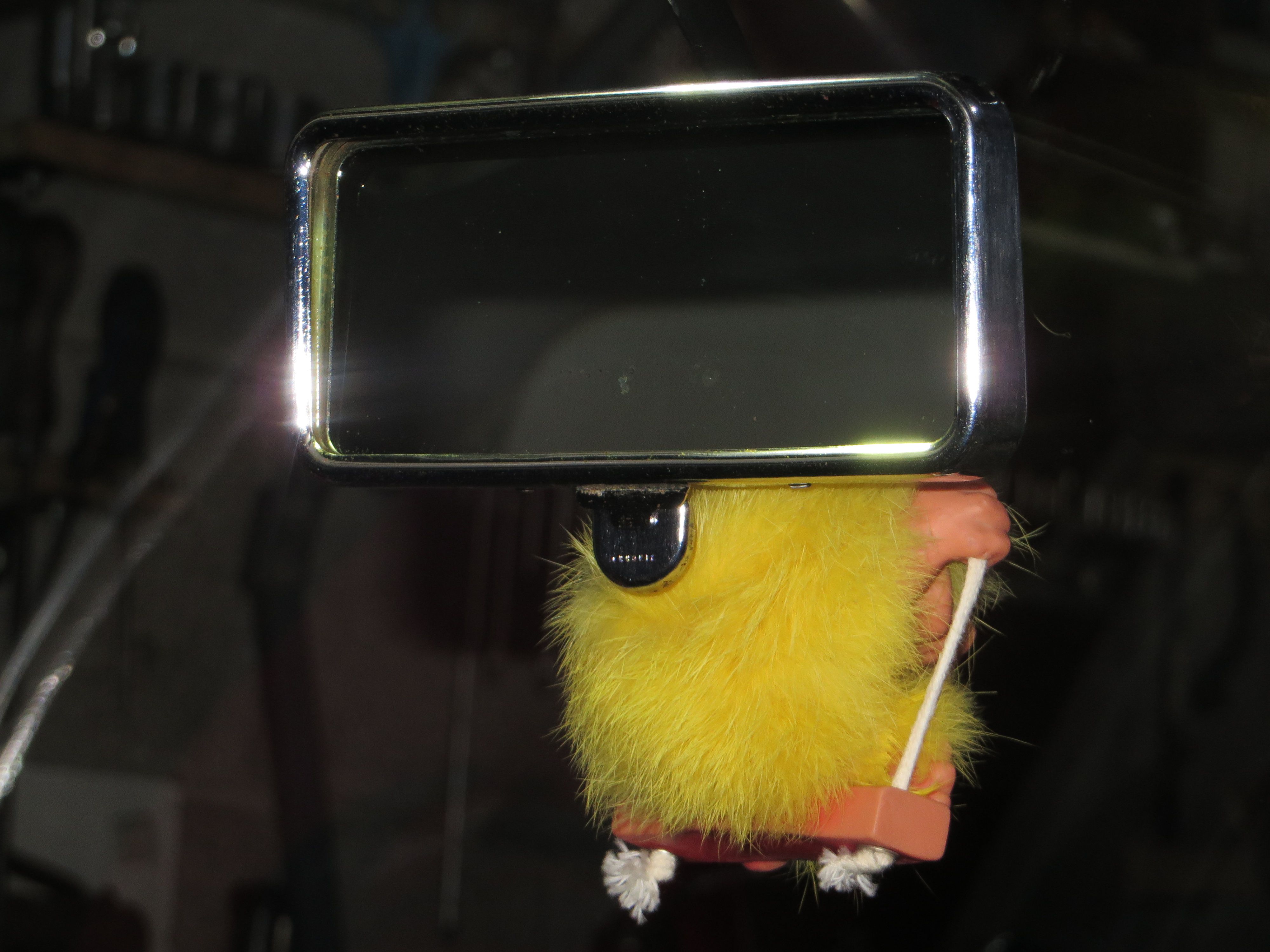

        Back to that dipping mirror.
        I mentioned a while back that Wingard did a dipping mirror for a Scimitar in black and also in grey for Lotus Cortinas .

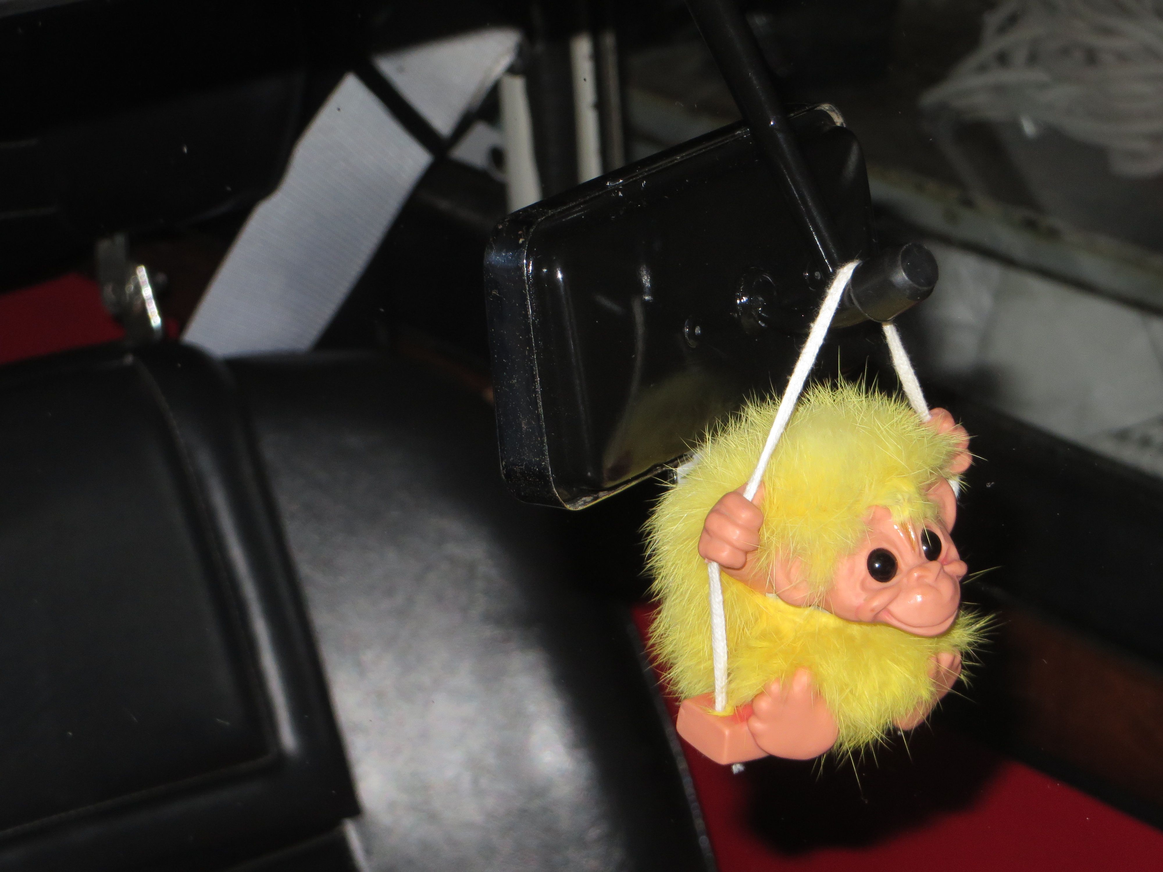

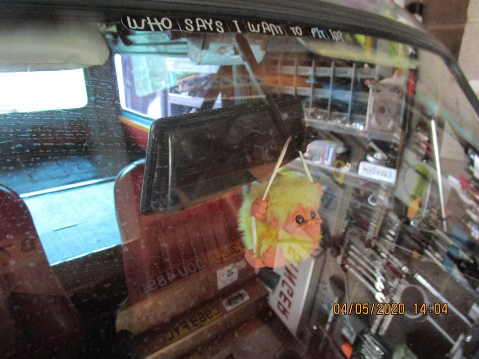

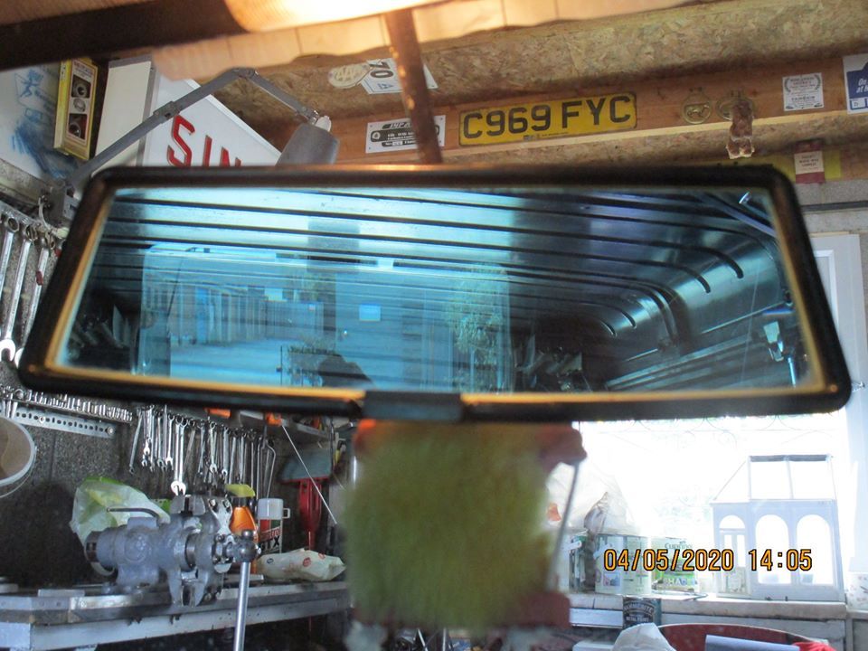

        Anyway I got my grubbies on one and guess what---
        Fits straight on the Imps mirror stem , its bigger , its dipping - whats not to like ( Monkey not included )
