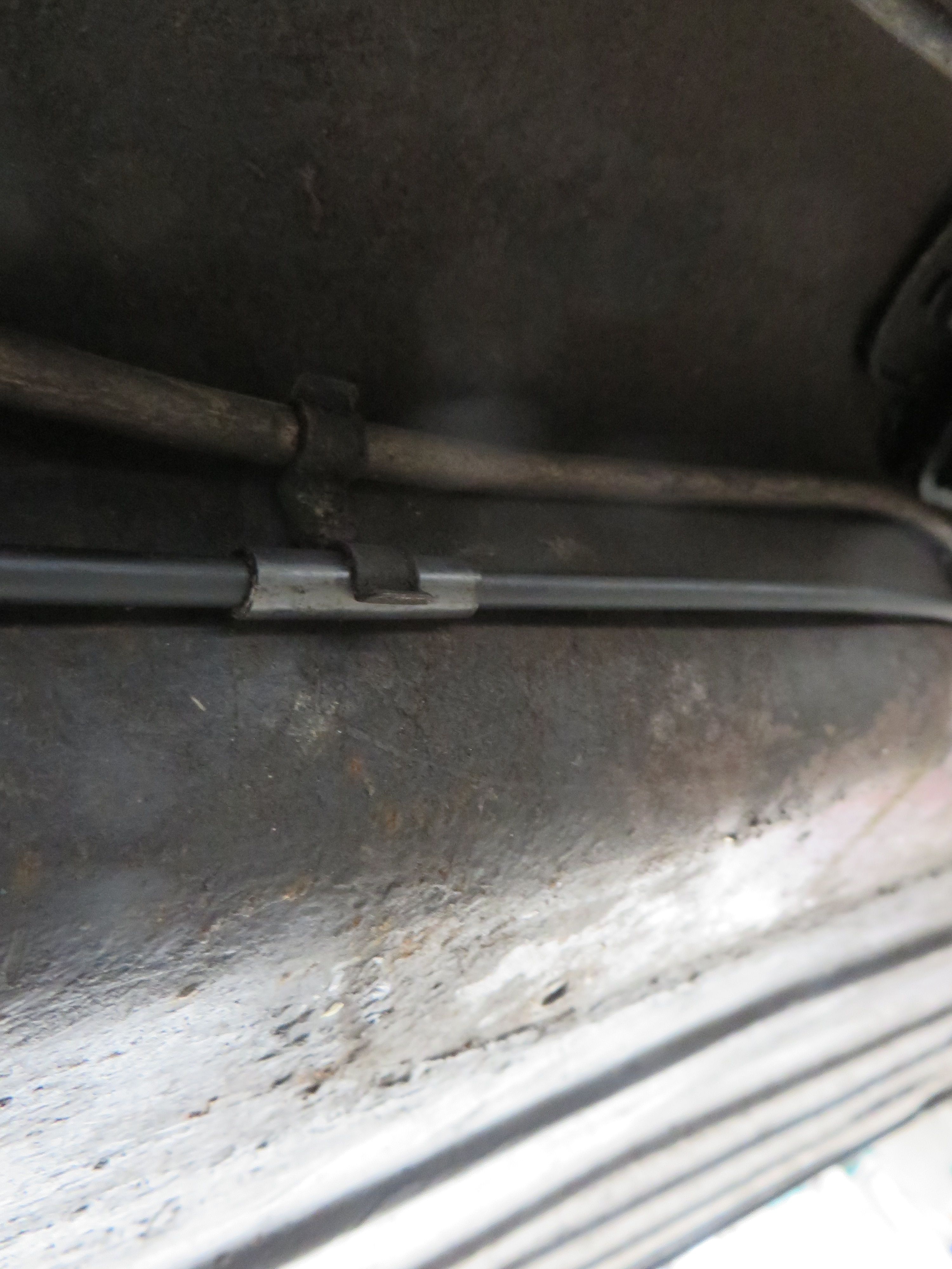

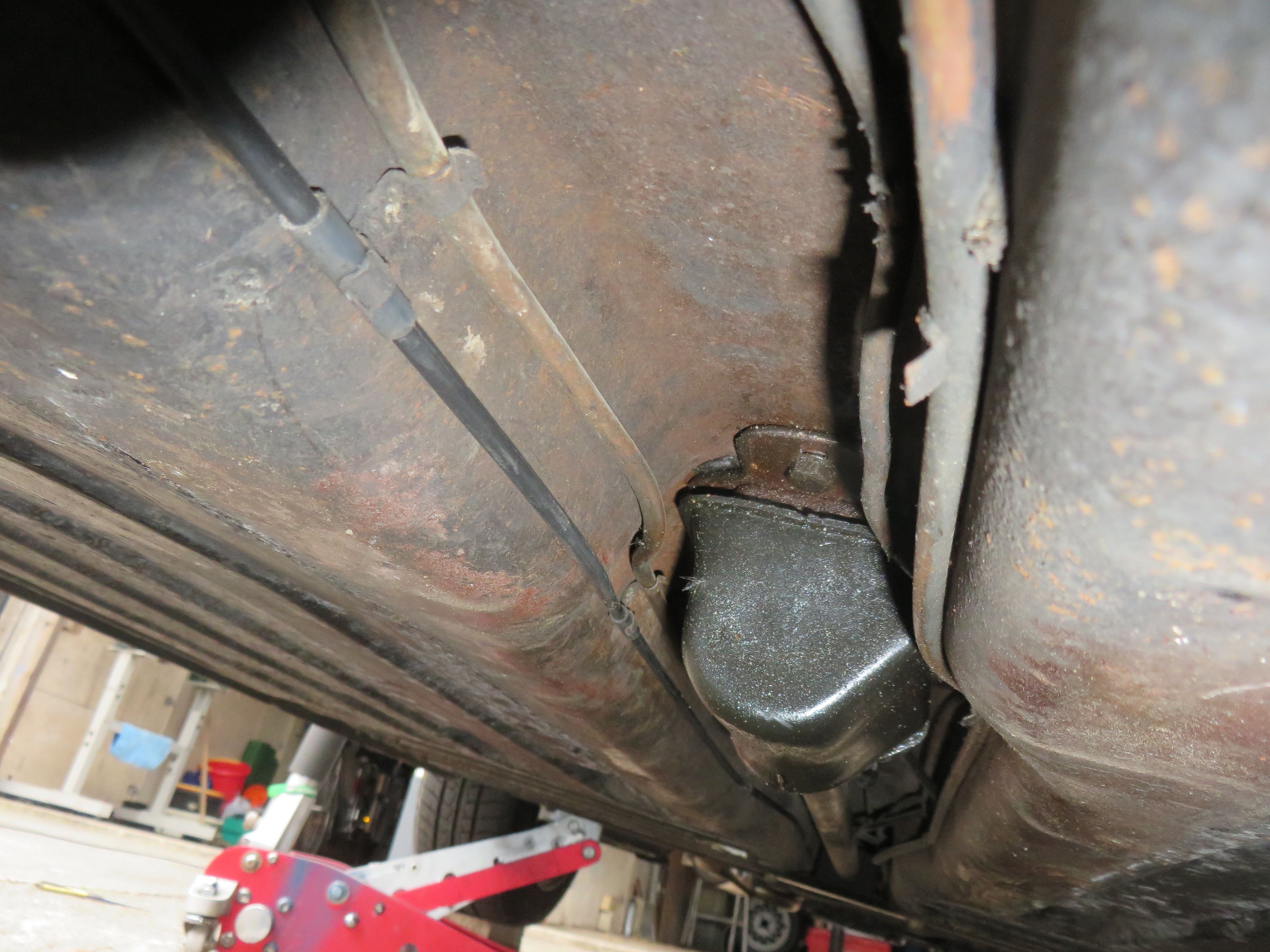

    The only issue is its thinner ( but stiffer for a better response ) so it doesnt fit the floor clips .
    No problem though , count the clips and add this amount of one inch lengths of washer bottle pipe before fitting , use WD40 or a small amount of grease when you slide it on then you can move it to the clip positions when its fitted .

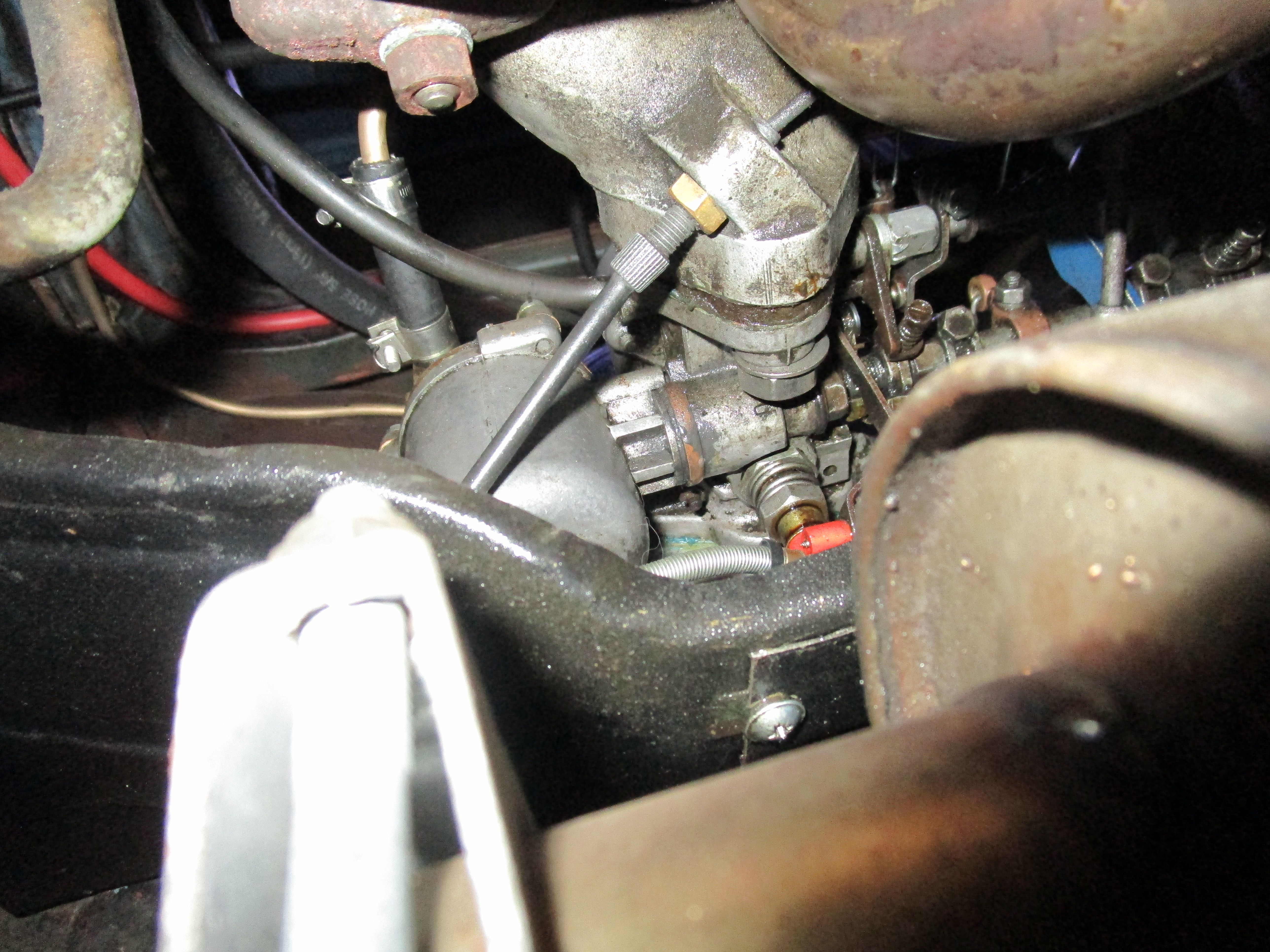

    Whilst your at it get a brake adjuster for a side pull brake , drill the bracket slightly so the adjuster fits through , or you could tap it too the same thread as the adjuster ( for Solex or 28/36 or twin SUs as Strombergs already have one ) , makes fine adjustment easy and a ten second job .
