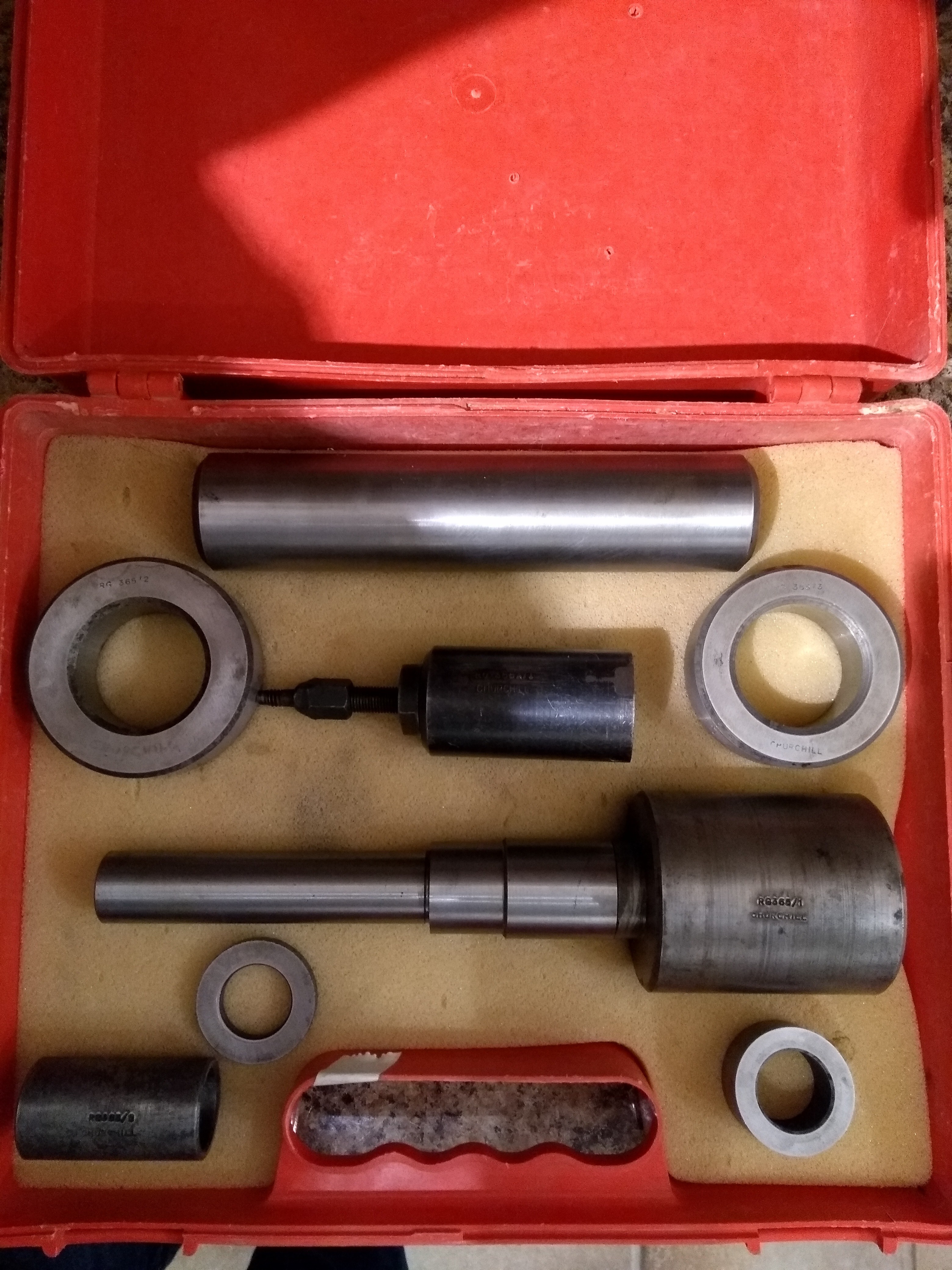

    Tools required to rebuild the transaxale for sale or can supply drawings so as to remake them

    Hi does anyone have the tools required to rebuild the transaxale for sale or can supply drawings so as to remake them
    ive spoken to Bob he has nothing he suggested I contact Ron Aspinwall , I've messaged him but hav had no reply

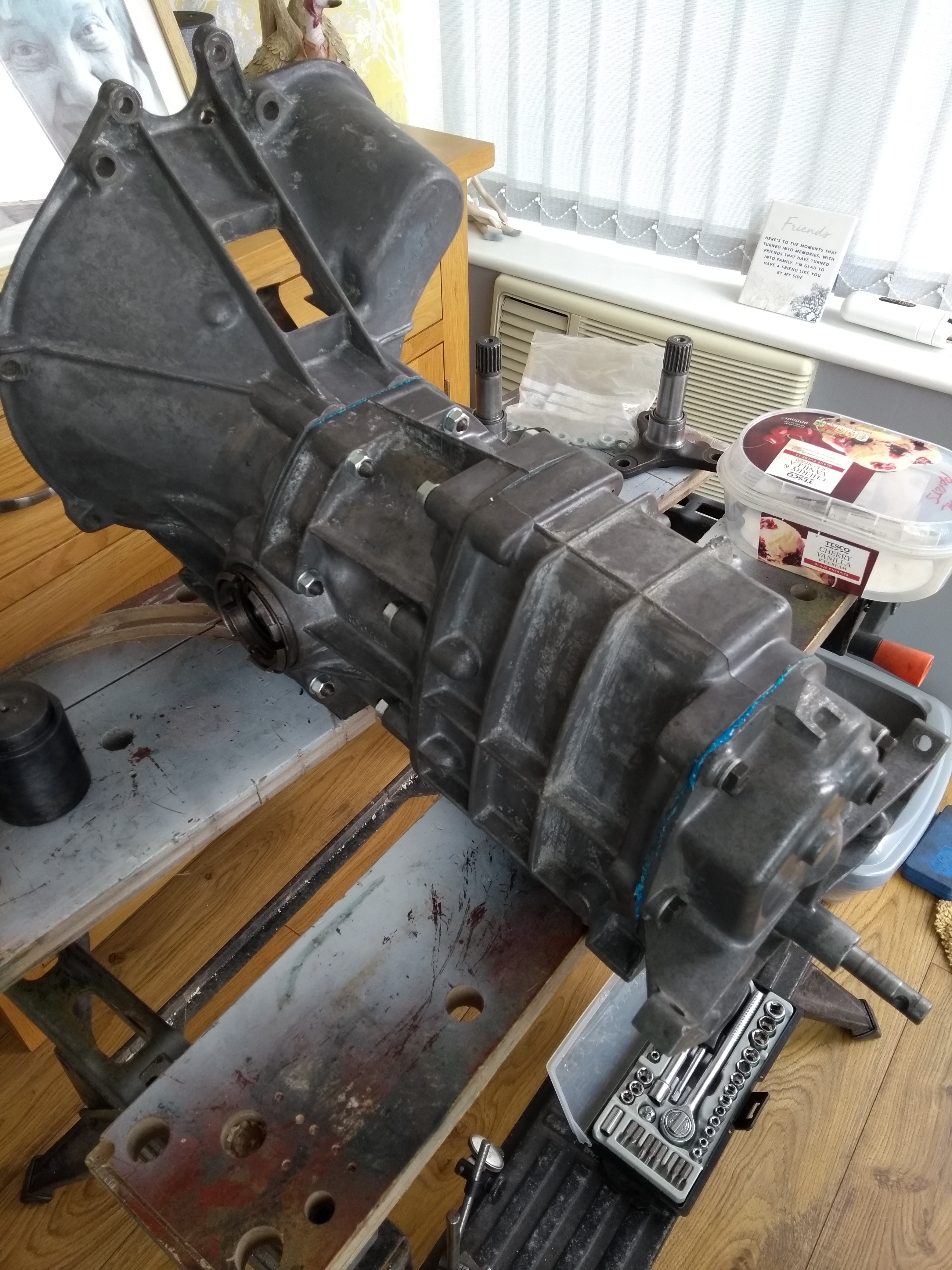

        Always wanted to do the transaxale it's just got one step closer Click image for larger version

          Great stuff Gary, I have heard it said the correct pullers, drifts and so on are not needed but I cant see how the job can be done properly without them.

          Bob Allan also has the RG365 listed for sale (two sets) whch is the gearbox assembly jig. You asked him if you can borrow one to copy ?

          Looking for ward to some naked transaxle pics

            I asked Bob he has nothing now RG 366 is there too and I have all the drgs for the others but you can probably do it without them it's the pinion tool RG 365 you can't do without if you want to do it properly
            I would never attempt it without ,if I couldn't get the tools I would have sent the box for refurb
            After a little bit of tuition yesterday I understand how important the tool is now

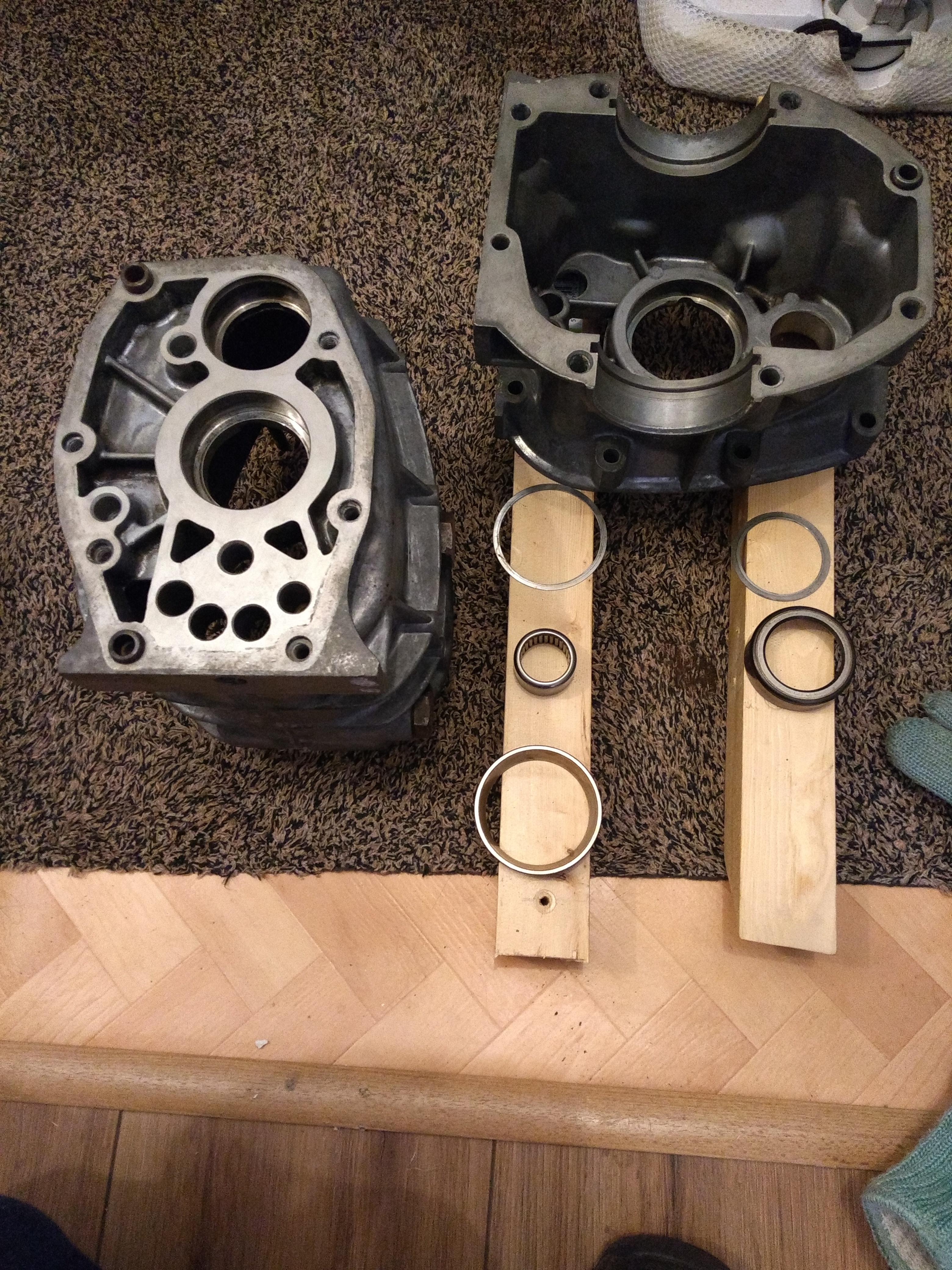

              Ah, I dont think Bob has updated his parts list yet then as he had2 RG365 listed at £350 and £250.
              He at least has a good list of parts and shims/washers and just along road from you

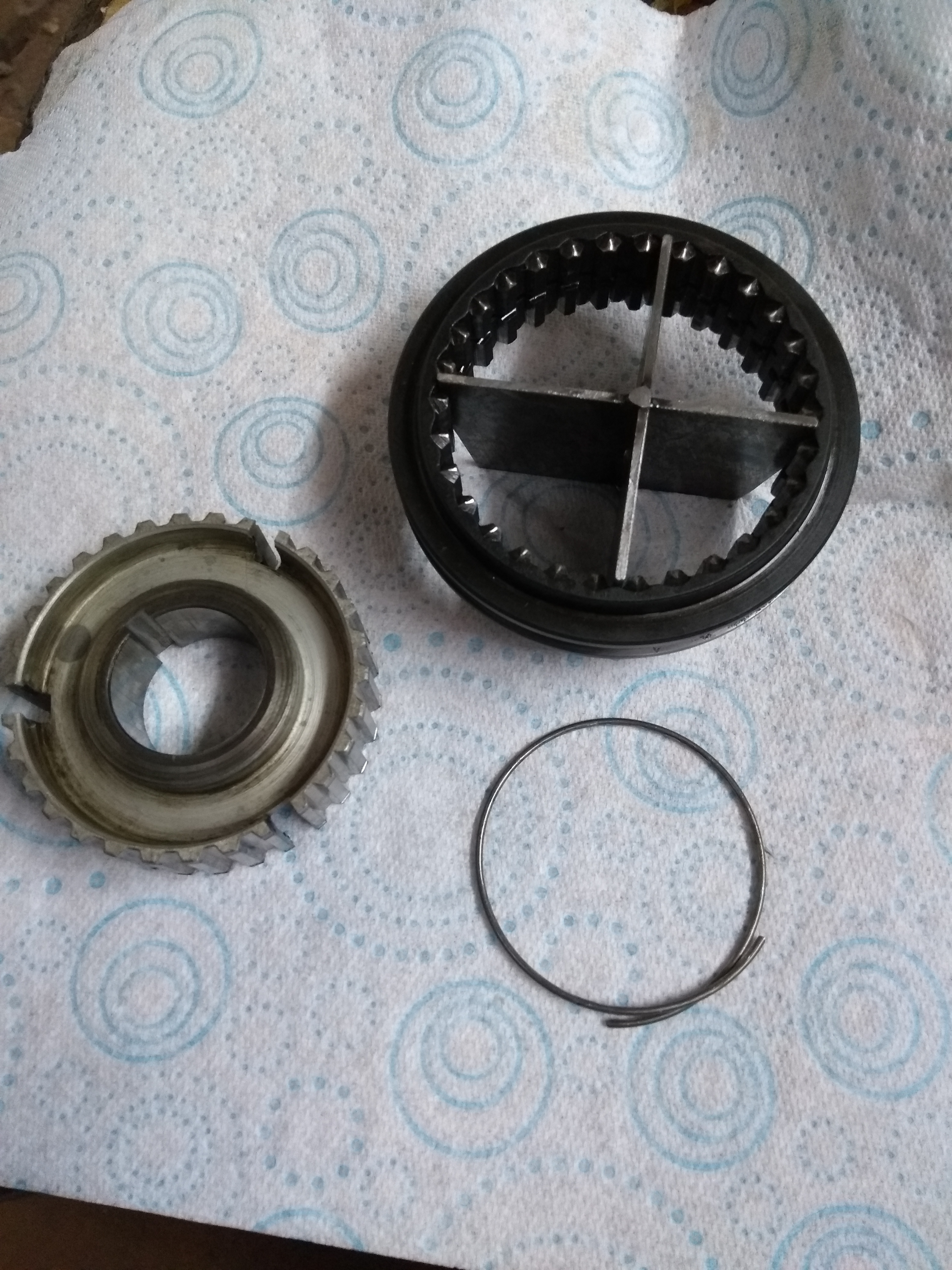

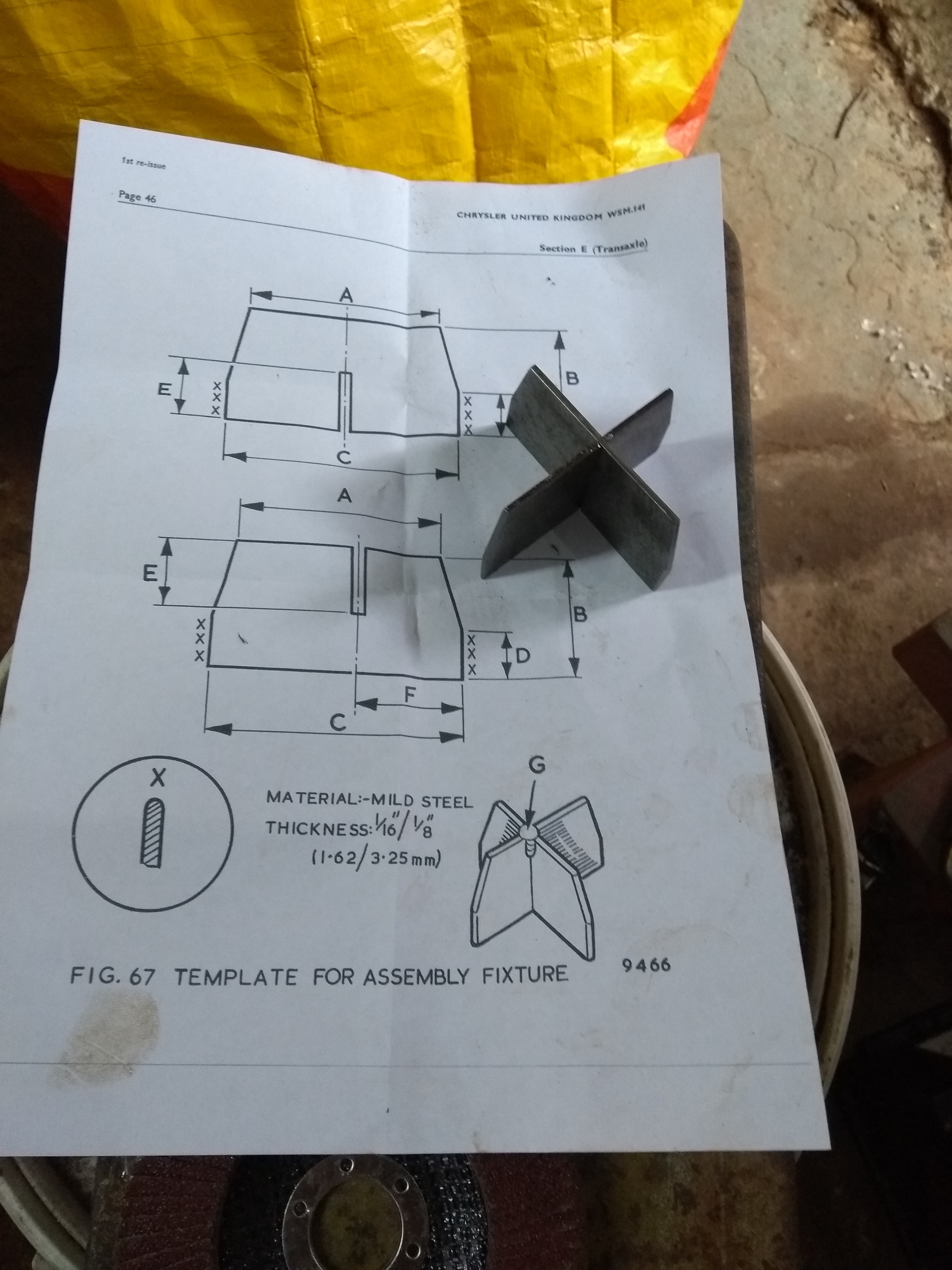

                Hi made this tool up today to the dimensions in the manual it for reassembly of the later synchro hubs
                if you look at the c dimensions on both pieces if 1 slot if offset they can't possibly be the same . As the top 1 that is equal about the centre is a snug sliding fit across the diameter of the hub the offset 1 has to be smaller
                No time to finish today when I sort the correct dimensions I'll post it
                best regards GaryClick image for larger version  Name:	IMG_20200915_172046829.jpg Views:	0 Size:	2.73 MB ID:	10207
                  Gary is this just to build up the layers and then slide onto the shaft ?

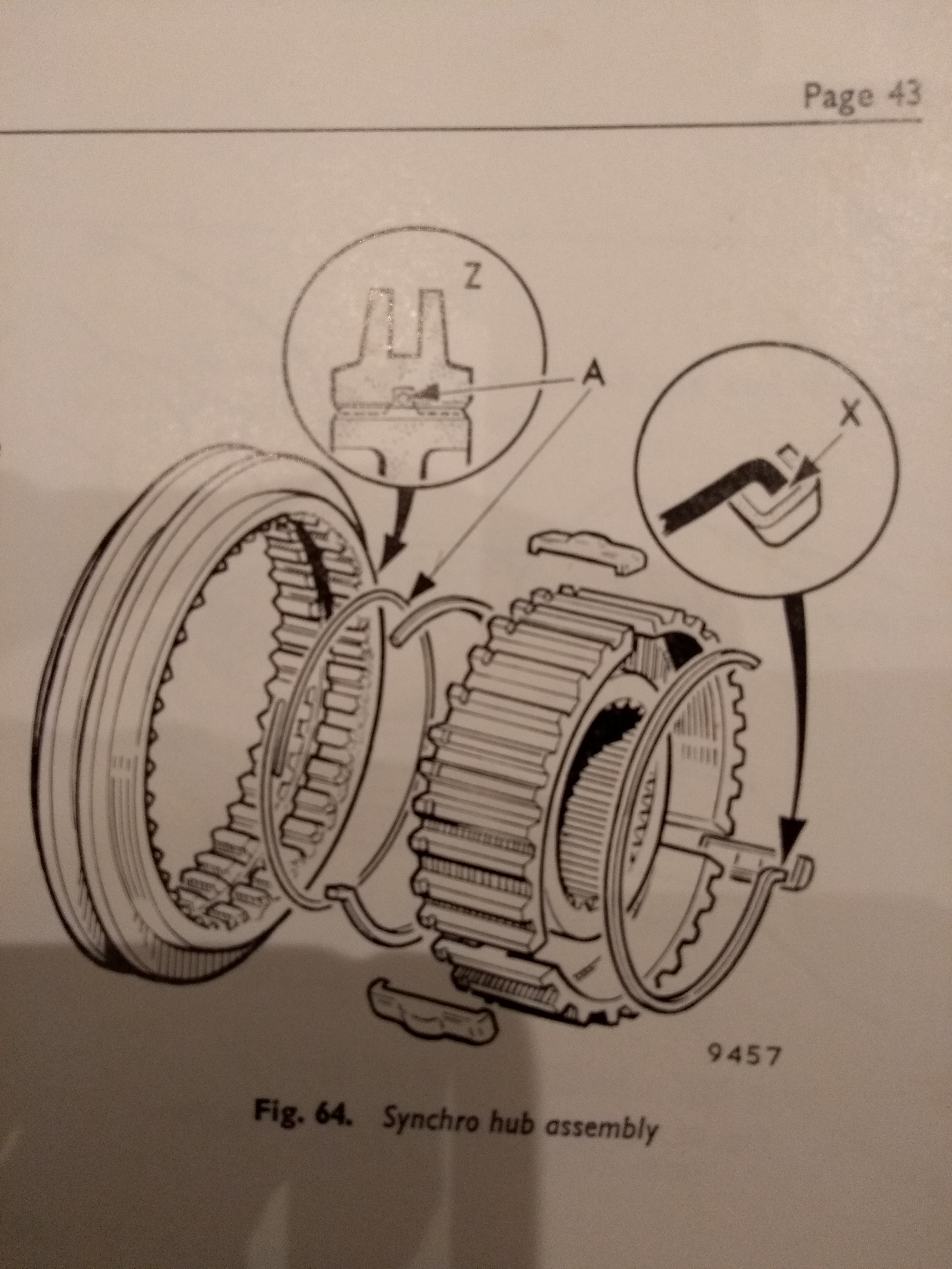

                    On the later synchro the sliding keys don't have springs and balls they have an internal grove in the bulk ring ,a thin snap ring type spring fits in it this is to hold it in place while you fit the 3sliding keys
                    • Gary Whitaker
                      aka Tiker
                      • 15 April 2020
ID:	10211 it's to hold Ain place

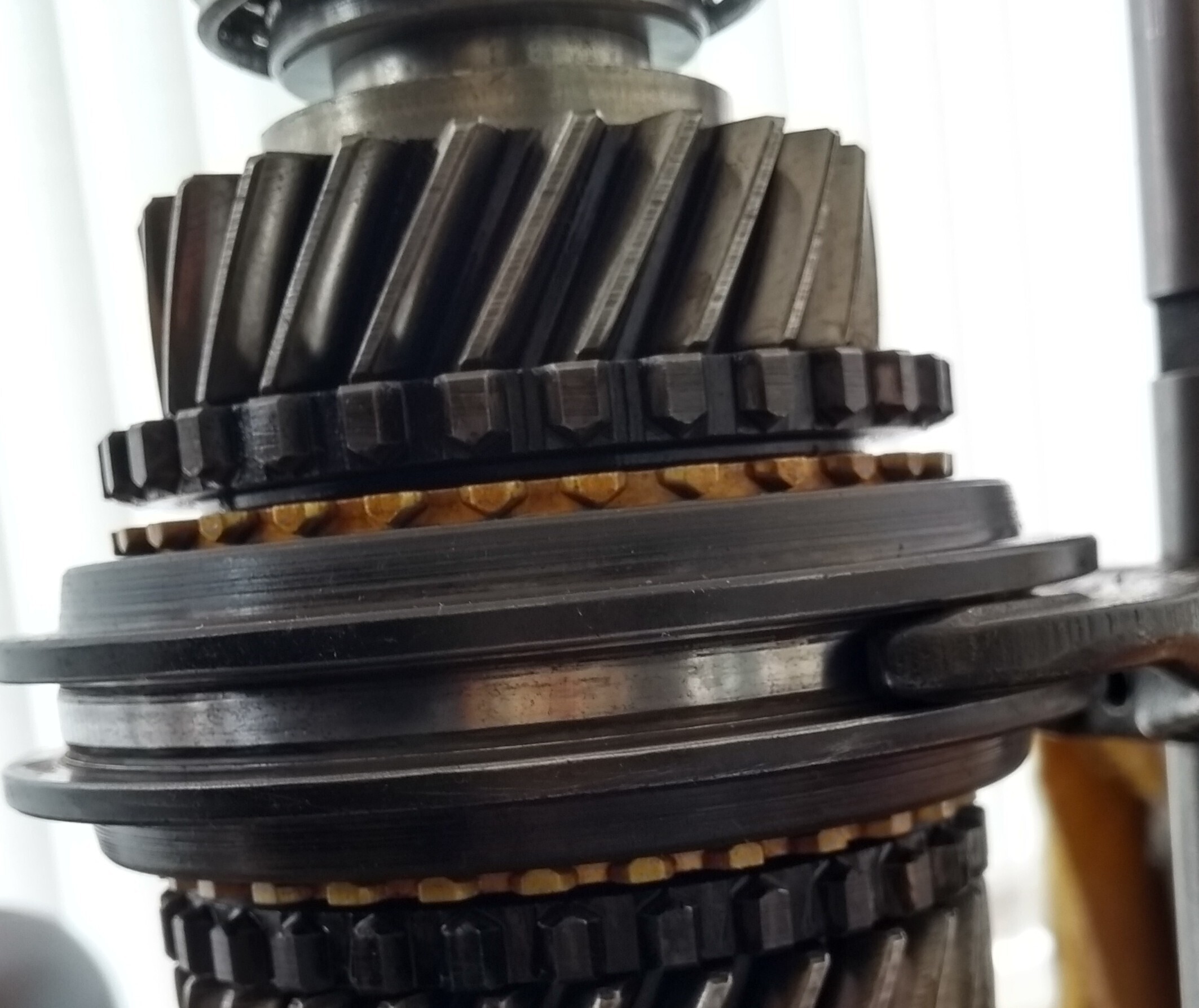

                          #13
                          Top C Dimensions is 71.8mm
                          it does work I've just tried it? Click image for larger version
                            #14
                            Nice, you will have the box rebuilt in no time.
                            I will love seeing it go together Gary, its one of the few jobs on the Imp I always managed to never get right.

                              #15
                              Click image for larger version  Name:	image_4015.jpg Views:	4 Size:	4.39 MB ID:	10494 Tapped all the bearings out today ,put them in the oven at 100degs for 20 mins says 30 in manual but aluminium transfers heat so well it only needed 15/20 minutes no special tools just suitable size sockets reversed so they've got a good flat end and they came out ​​​​​​ easily. You can also see the pinion head and tail shims
