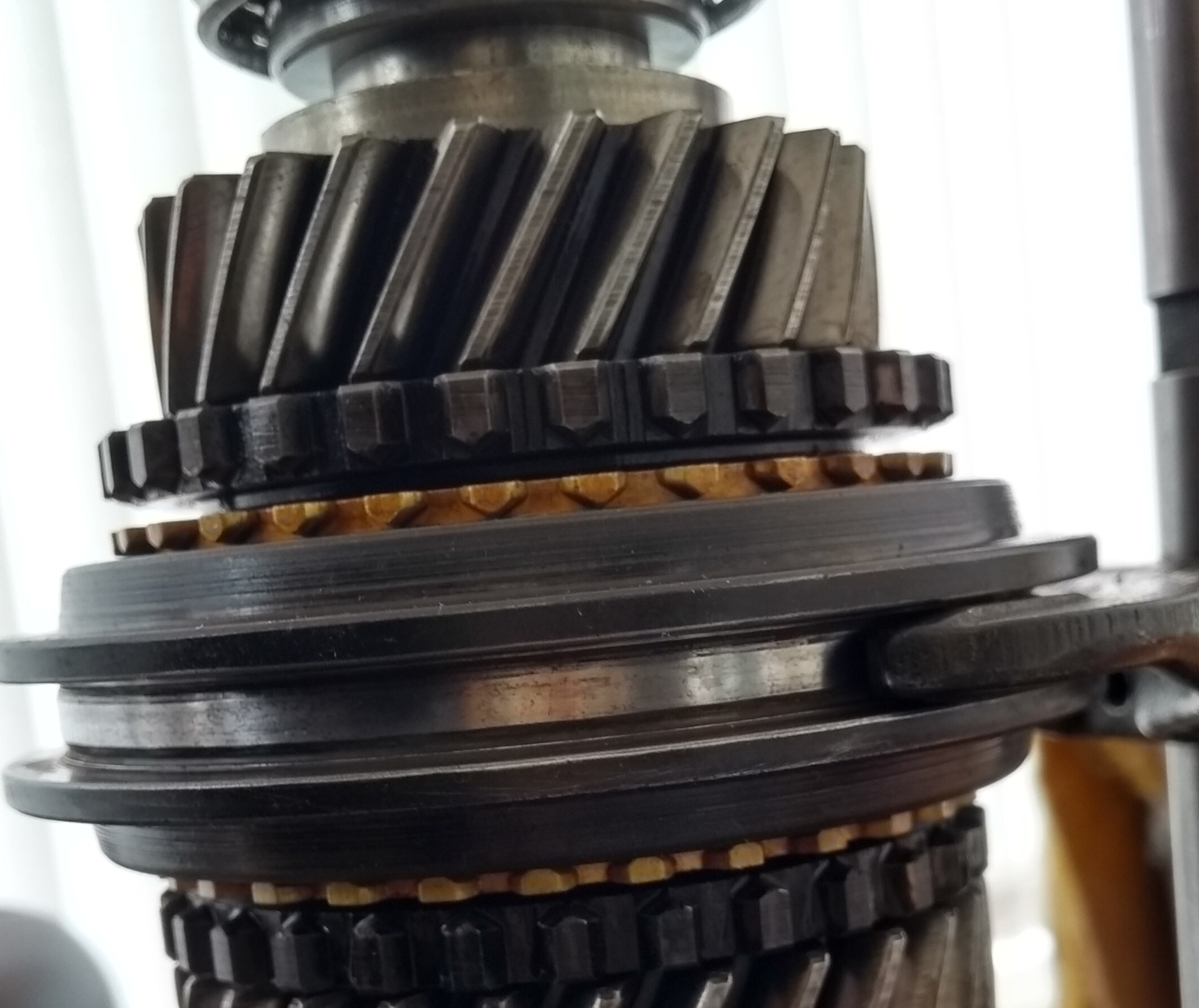

    This pic shows the gear teeth in good uniform condition Click image for larger version

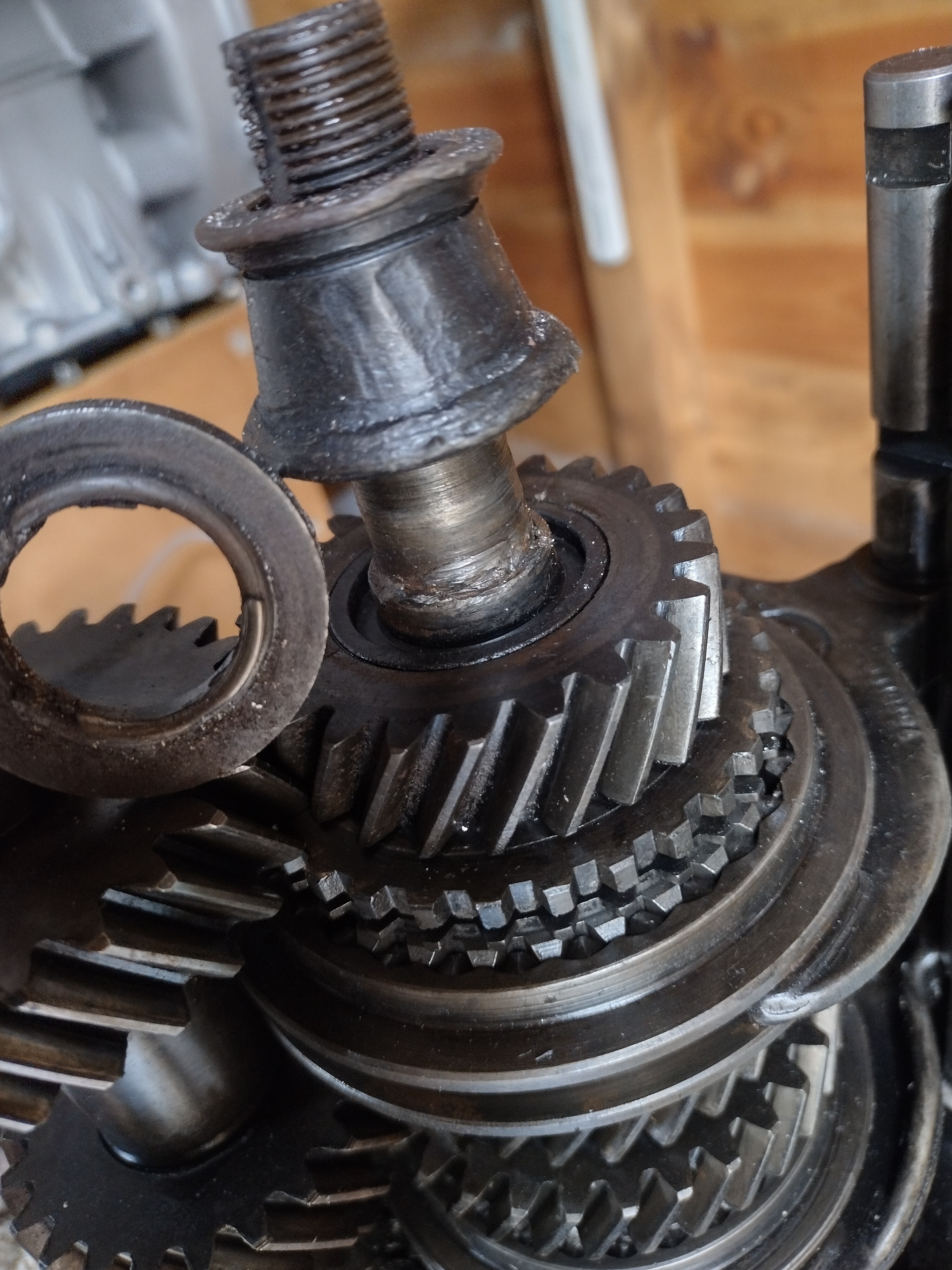

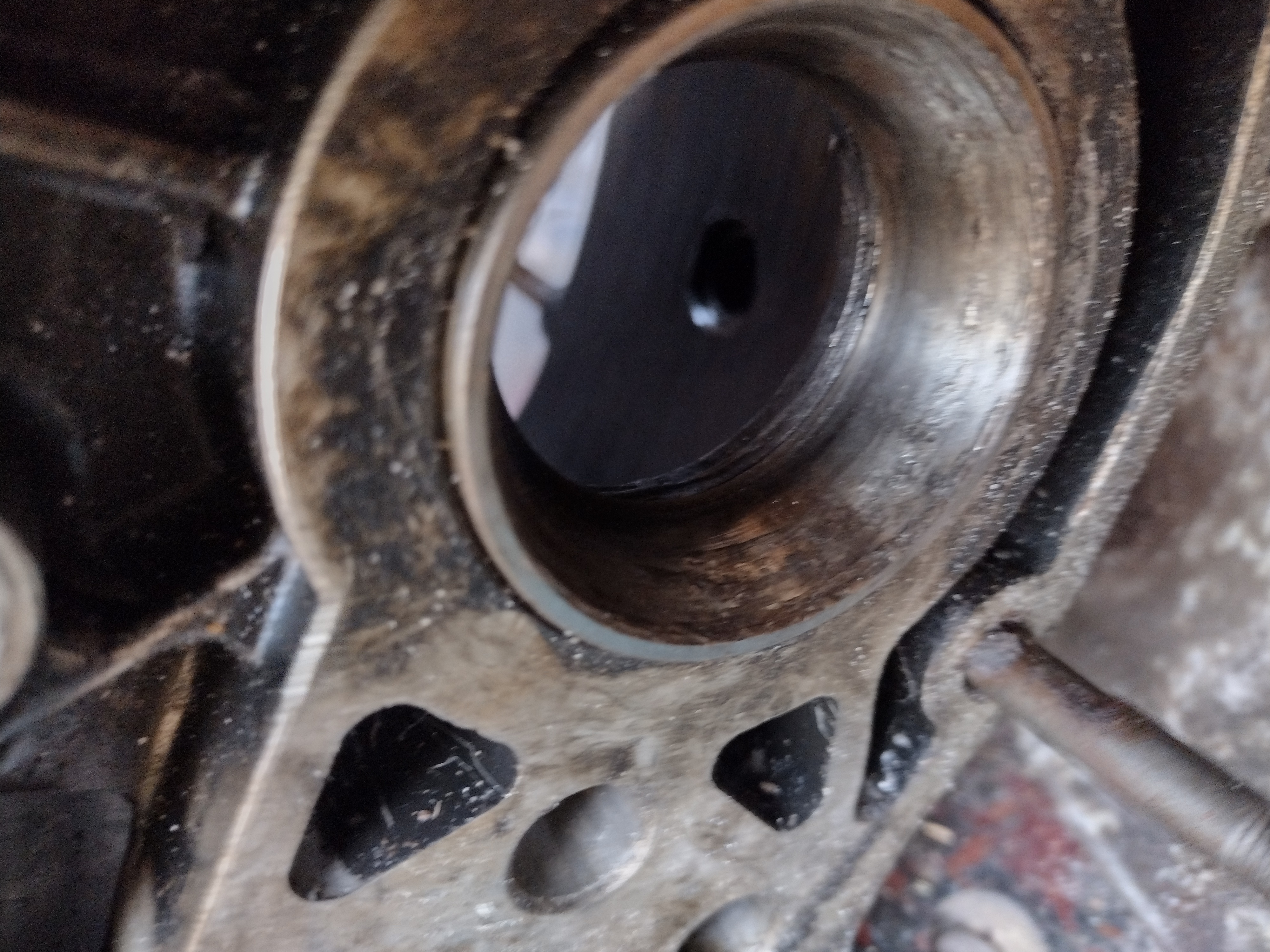

            Just an update on gearbox disasters just pick two boxes up when I strip the first one down it was a mark 3 box with Mark 1 bits inside unfortunately it looks like whoever put it together hadn't done the preload correct on the rear pinion bearing therefore when running it got very hot and welded the bearing to pinion shaft and the shaft to the thrust washer so it's toast unfortunately that's a real shame because the crown wheel opinion are in perfect condition Click image for larger version  Name:	IMG_20240414_173253121_HDR.jpg Size:	3.50 MB ID:	24029 Click image for larger version  Name:	IMG_20240414_173157604_HDR_1.jpg Size:	2.66 MB ID:	24030

              There were always rumors of the last of the transaxles being put together with "leftover parts" maybe the rumors actually have some substance
