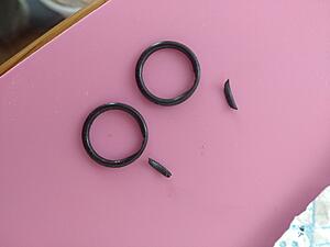

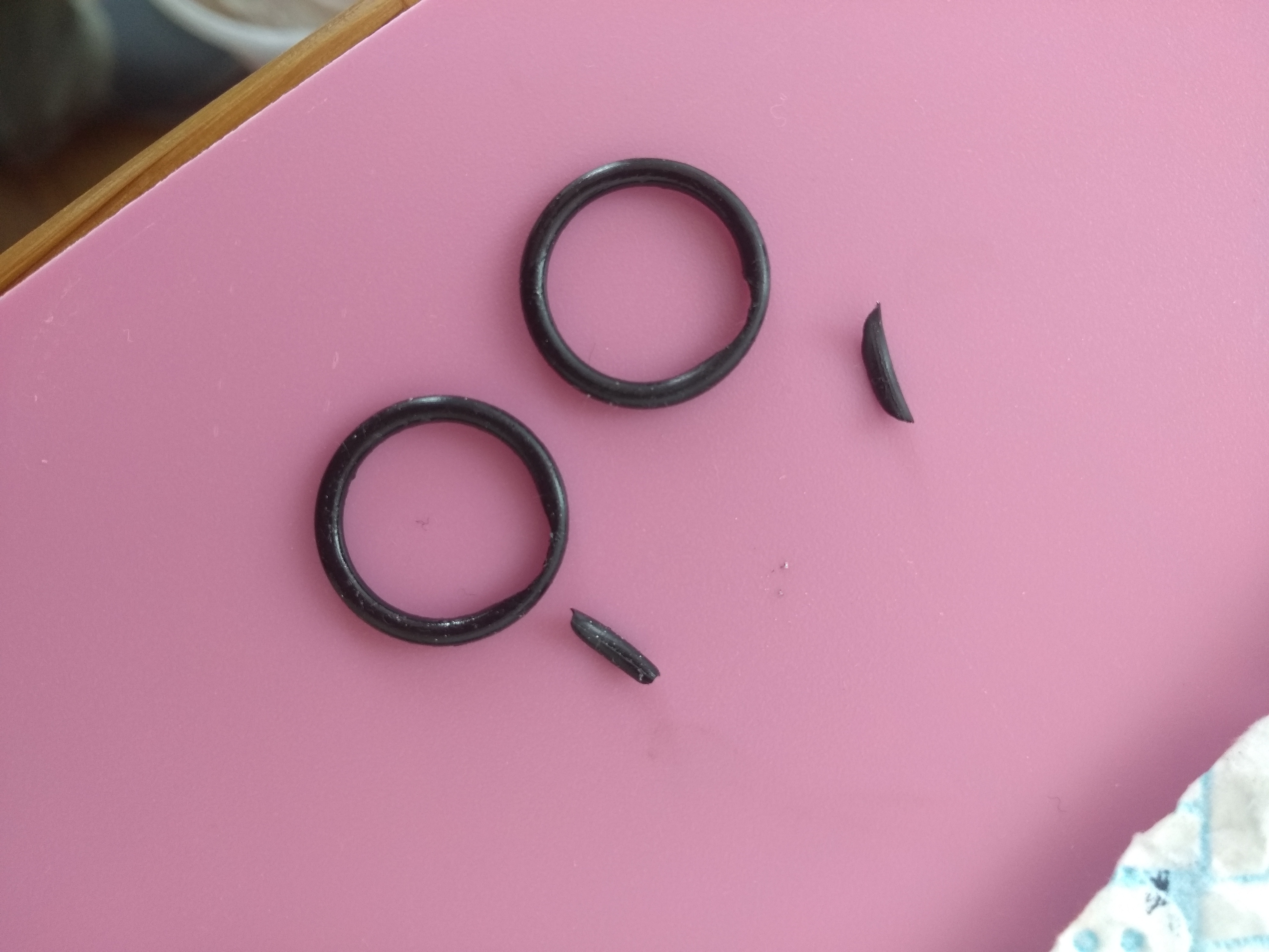

    Had a bit of trouble with the o ring in the end cover as I pushed the end cover over the shaft the cut out for the bolt cut the inner o ring , checked for burrs and smother it of but did it again put some tape round but could not get it through just shredded the tape and cut the o ring
    Thinking on the lines of bit shrink wrap just on the end .

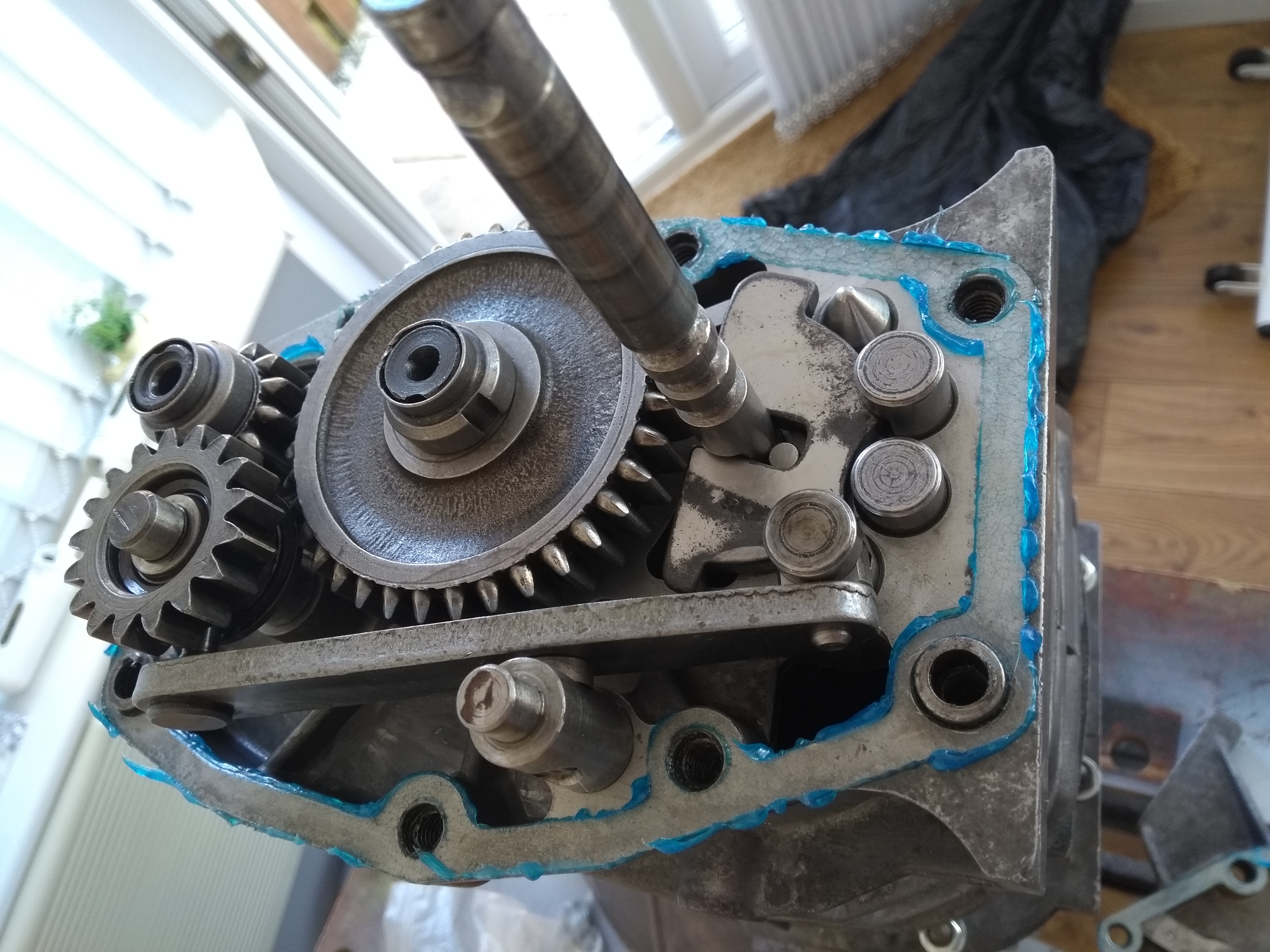

          #214
          Taken the back cover off to get to the o ring
          the Hylomar blue is really good but it doesn't come off without solvent
          After 3more goes noticed the o ring was not central in the bore ,so put another cover on ,went straight on
          On close inspection the groove was not machined in line with the bore , looks like the tools picked up too Click image for larger version
ID:	14952 not a good o ring groove it must have always been like that Shoddy workmanship

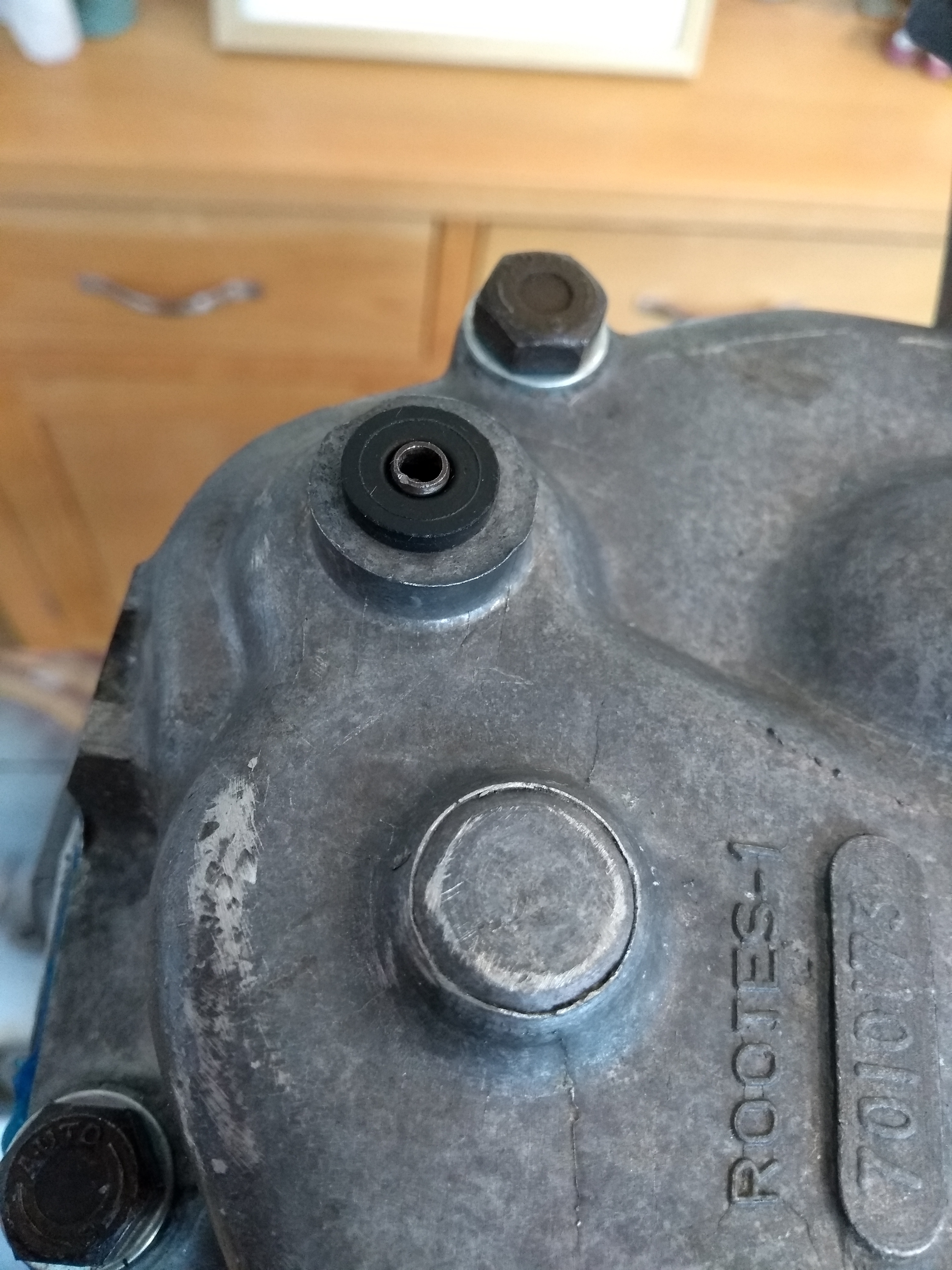

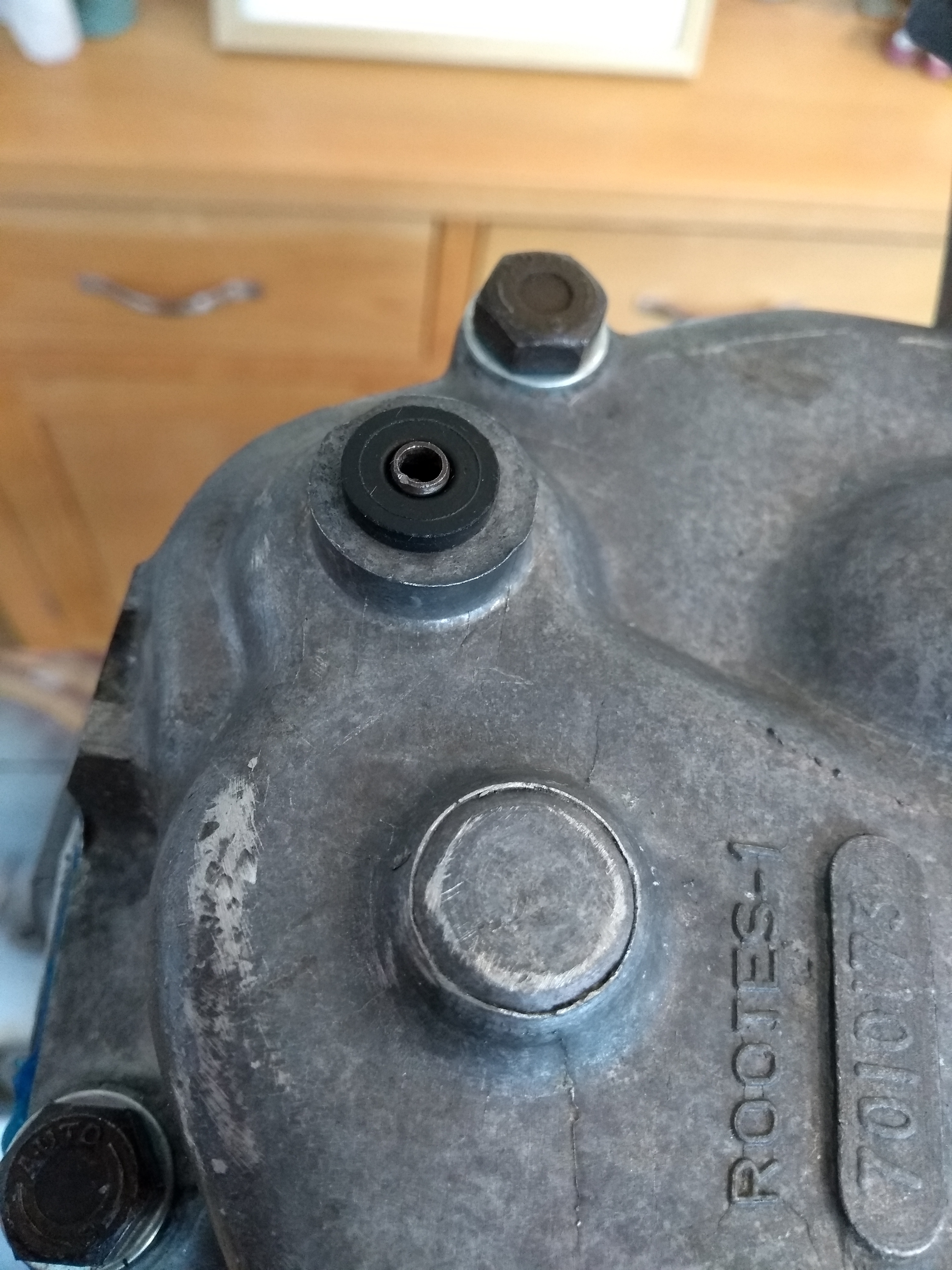

            Fit the breather tube check it's clean also when you're cleaning the input shaft heat clean the hole in the end it goes flush Click image for larger version

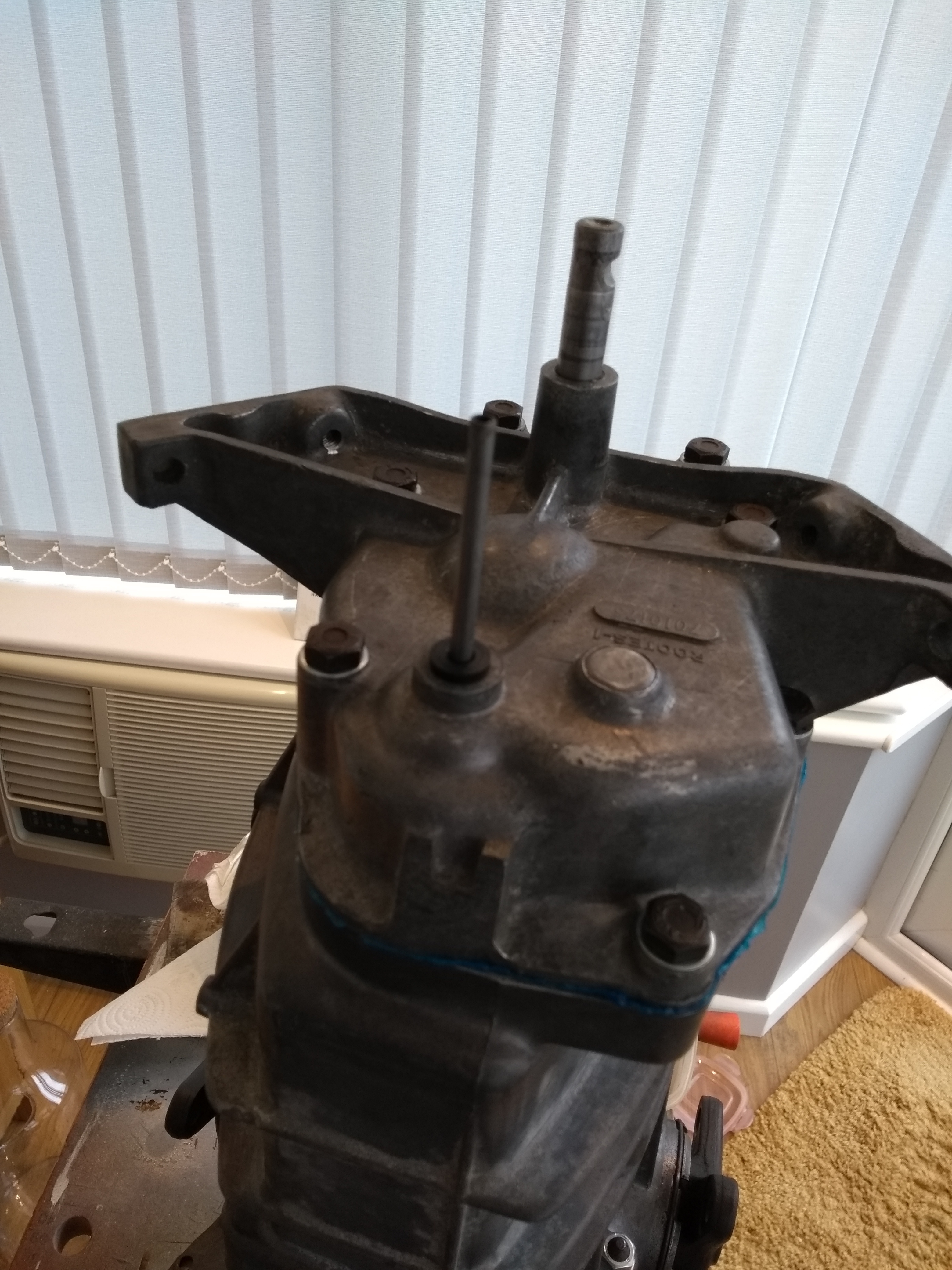

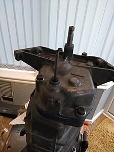

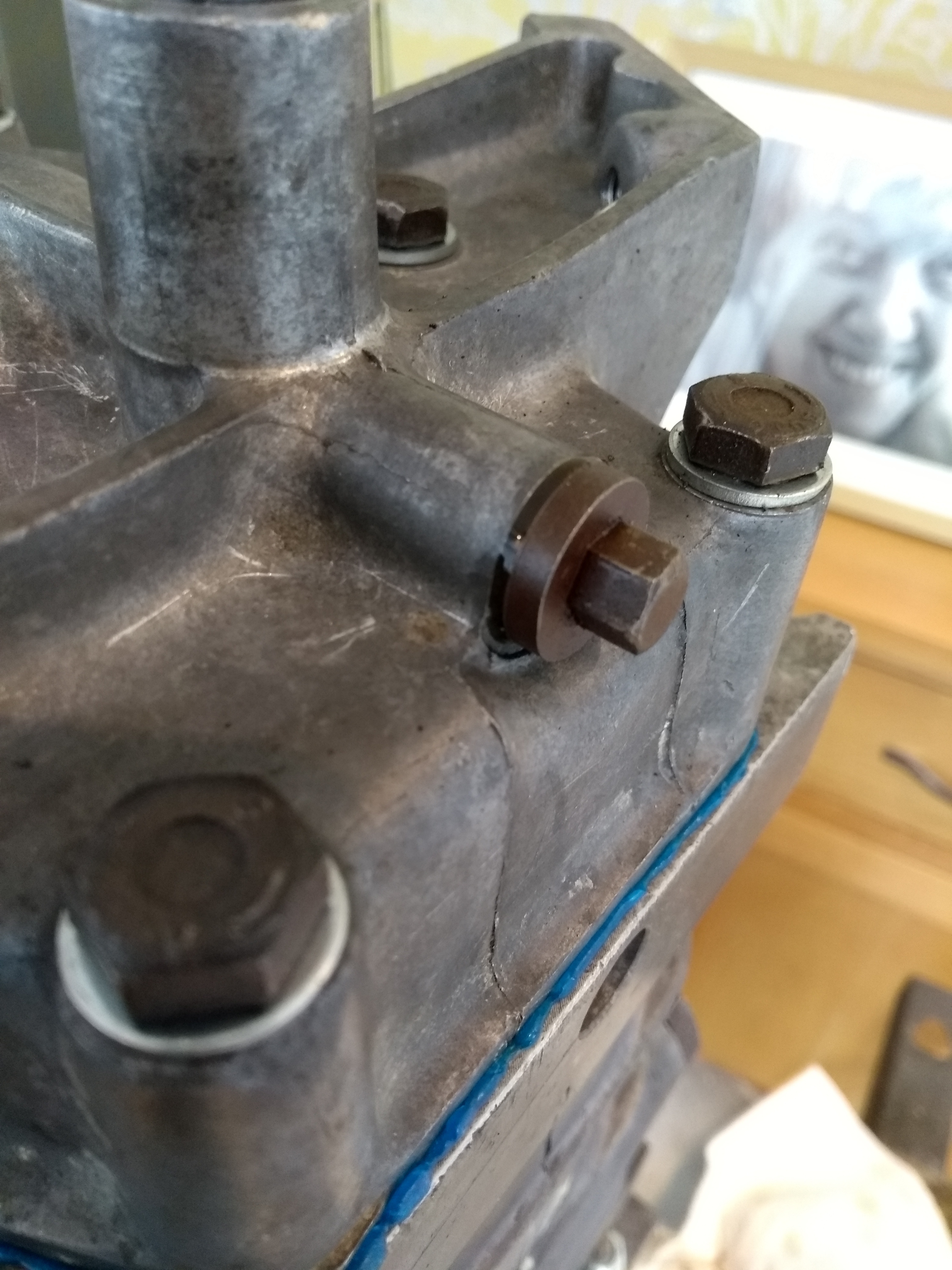

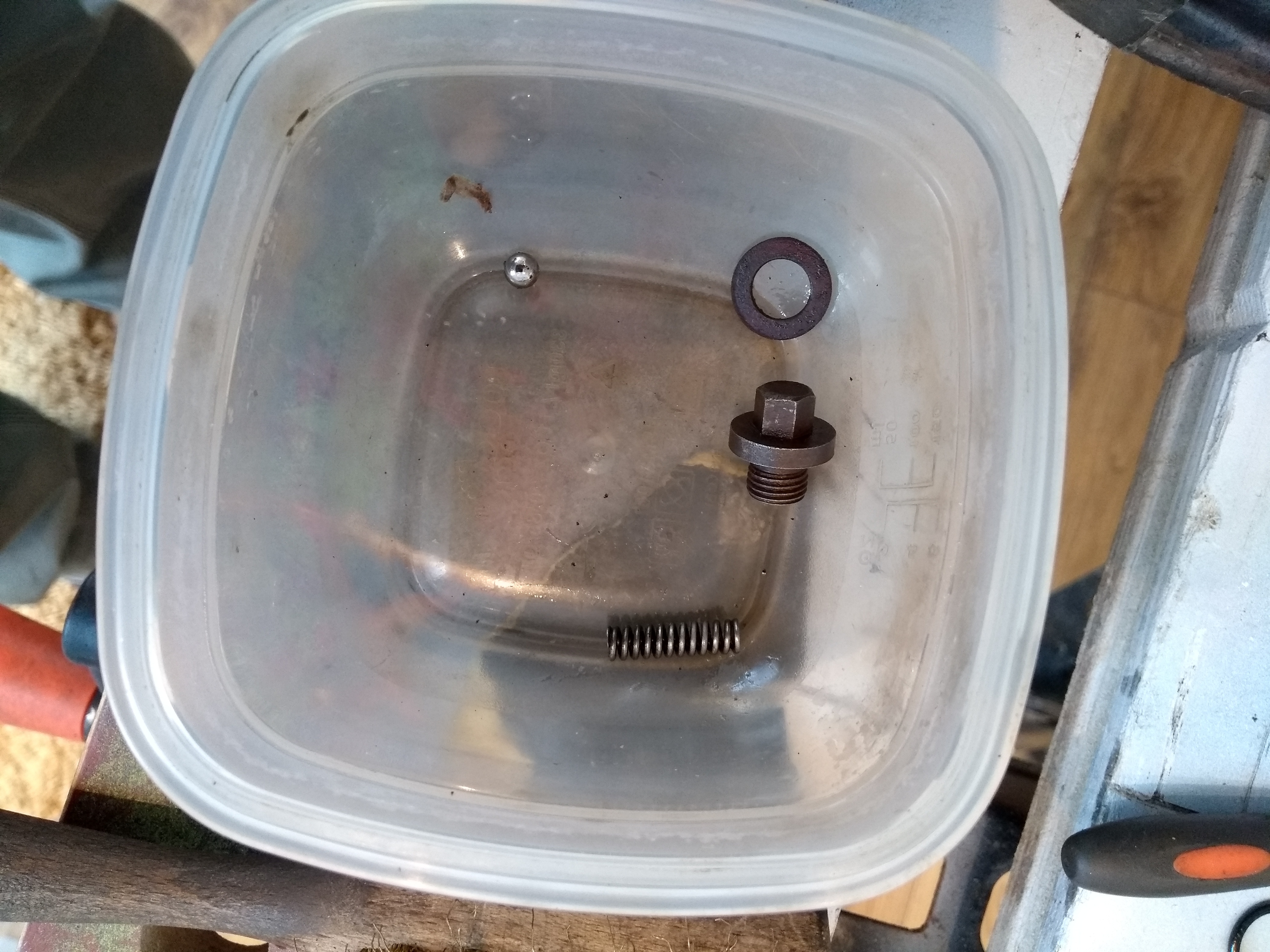

              Fit the selector rod ball spring washer and nut .
              there is a tab washer that fits on the side but don't know how effective it is I am using thread loc Click image for larger version

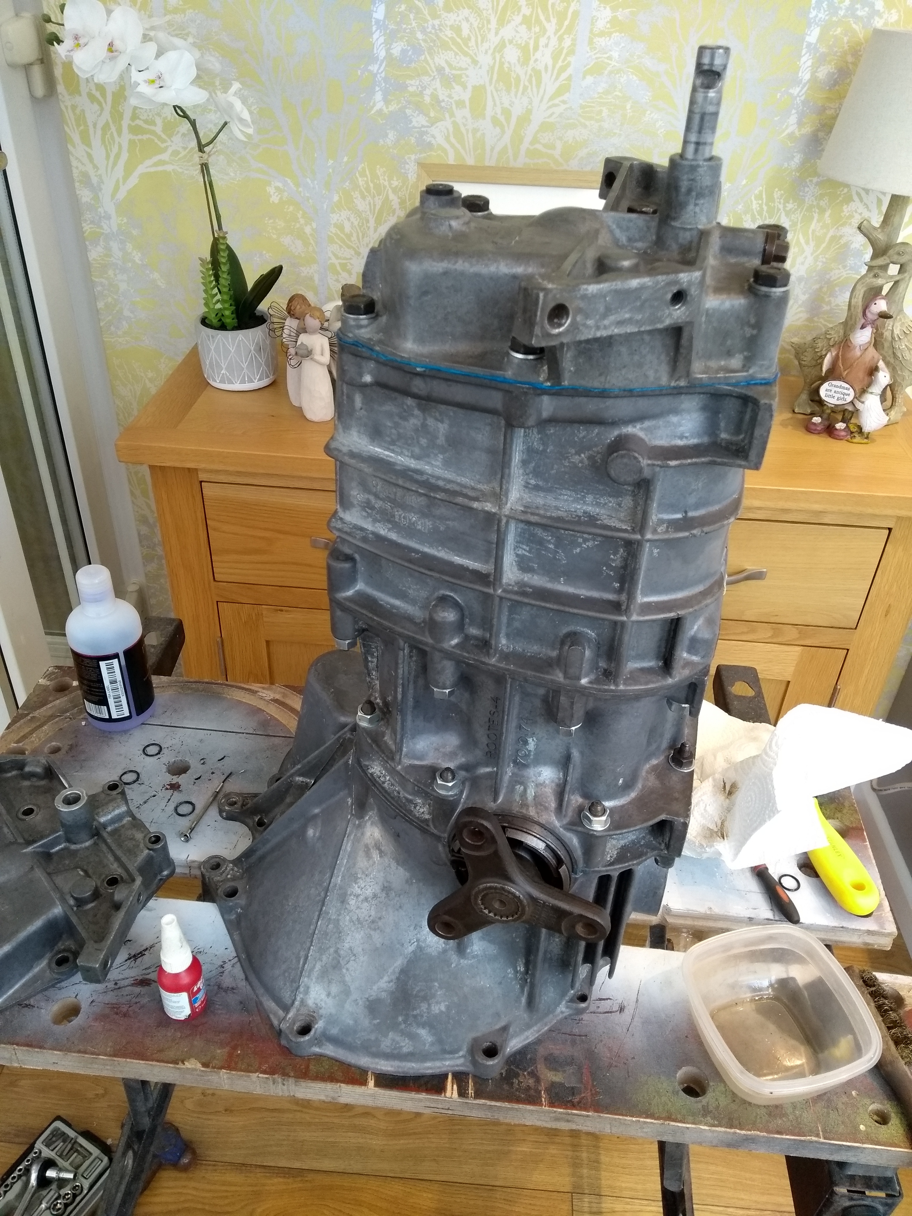

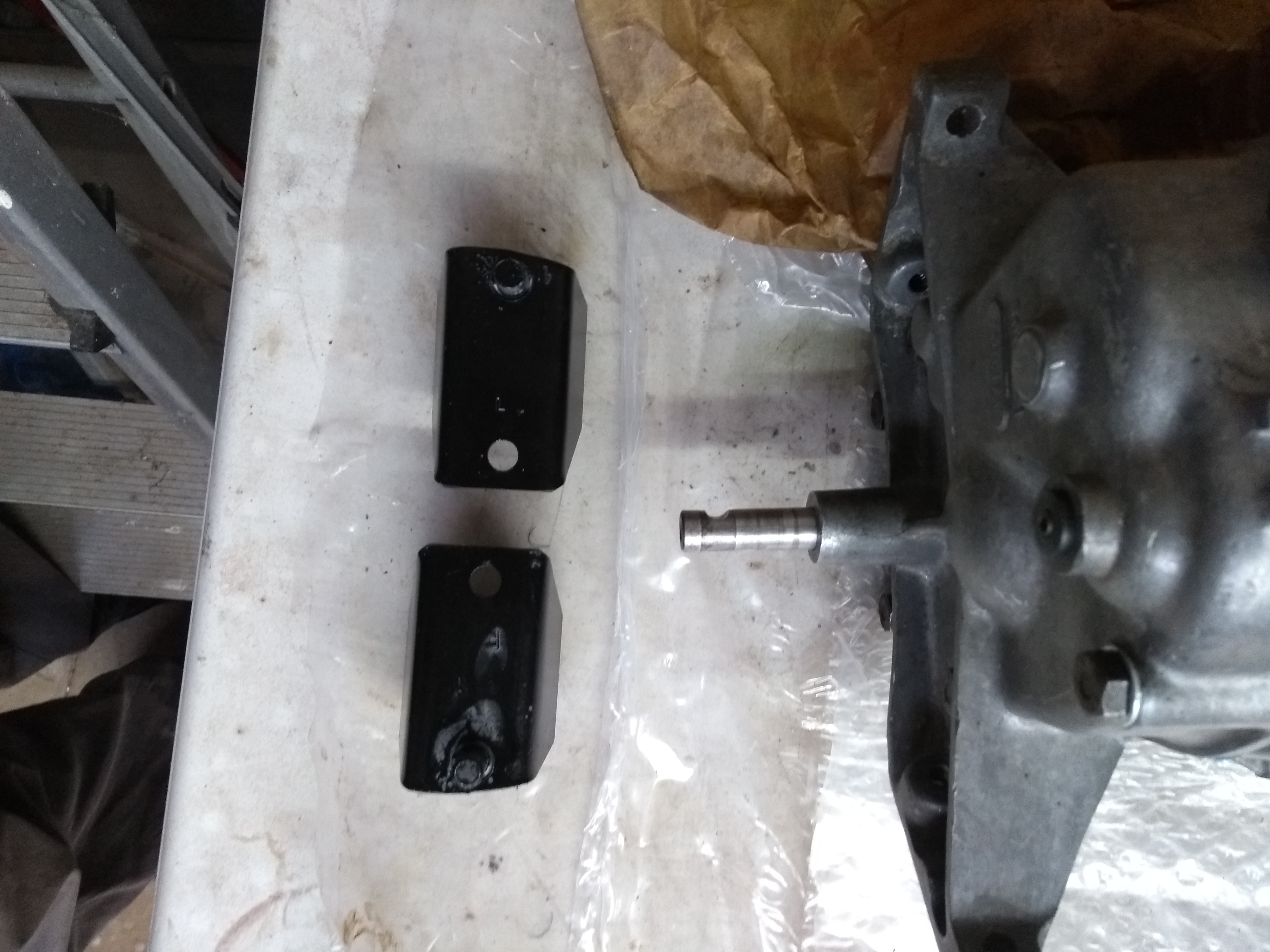

                    Well I may have built the transaxale but now I need help .
                    which is the correct way round for the mount ,is it as pic left/ right as viewed or is it the other way round
                    Best regards Gary Click image for larger version
                      • 4881
                      #220
                      Should be marrked Left/Right cgary and its as per car side (right passnger)

                        #221
                        That's great that's correct as per photo

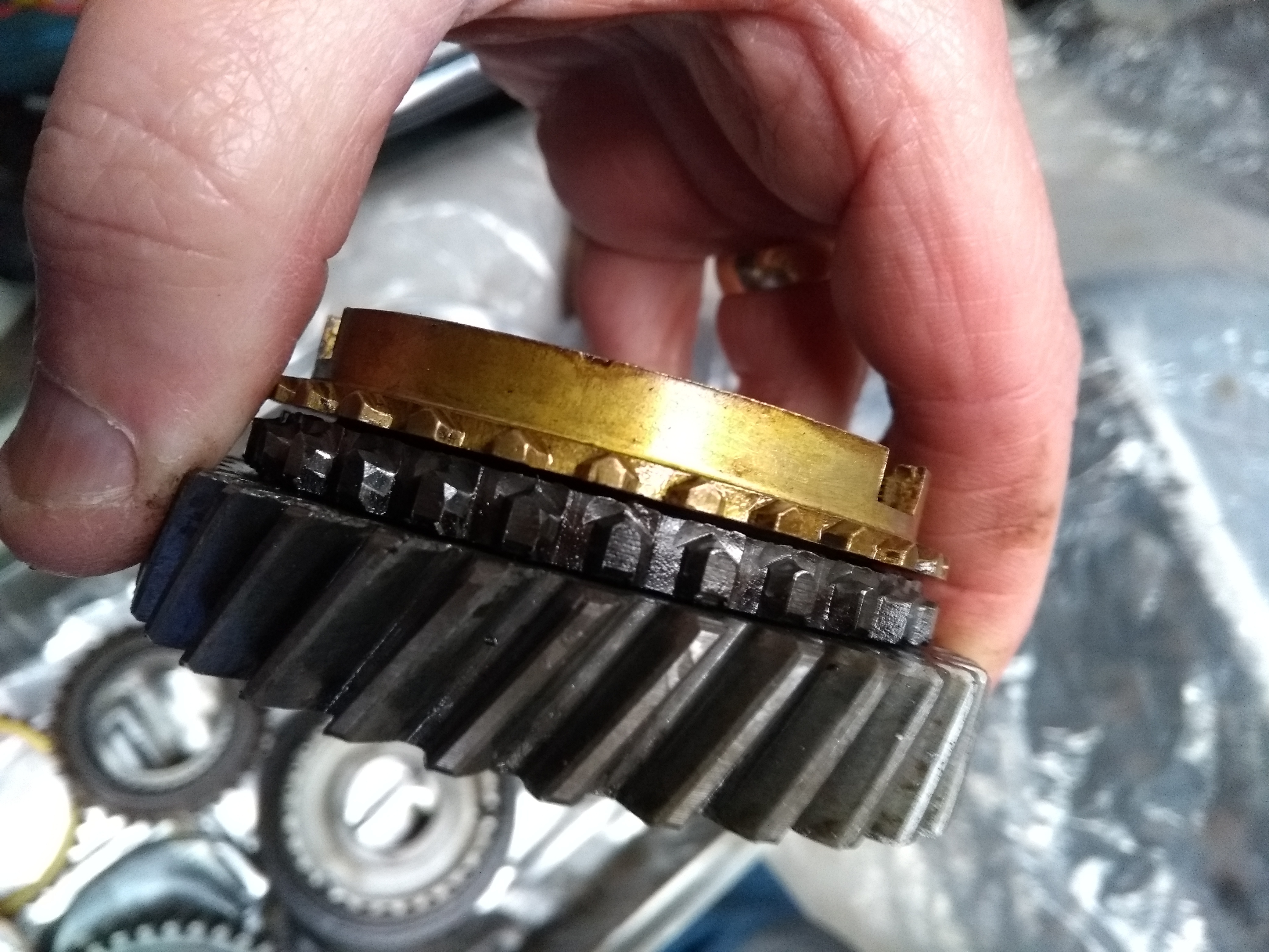

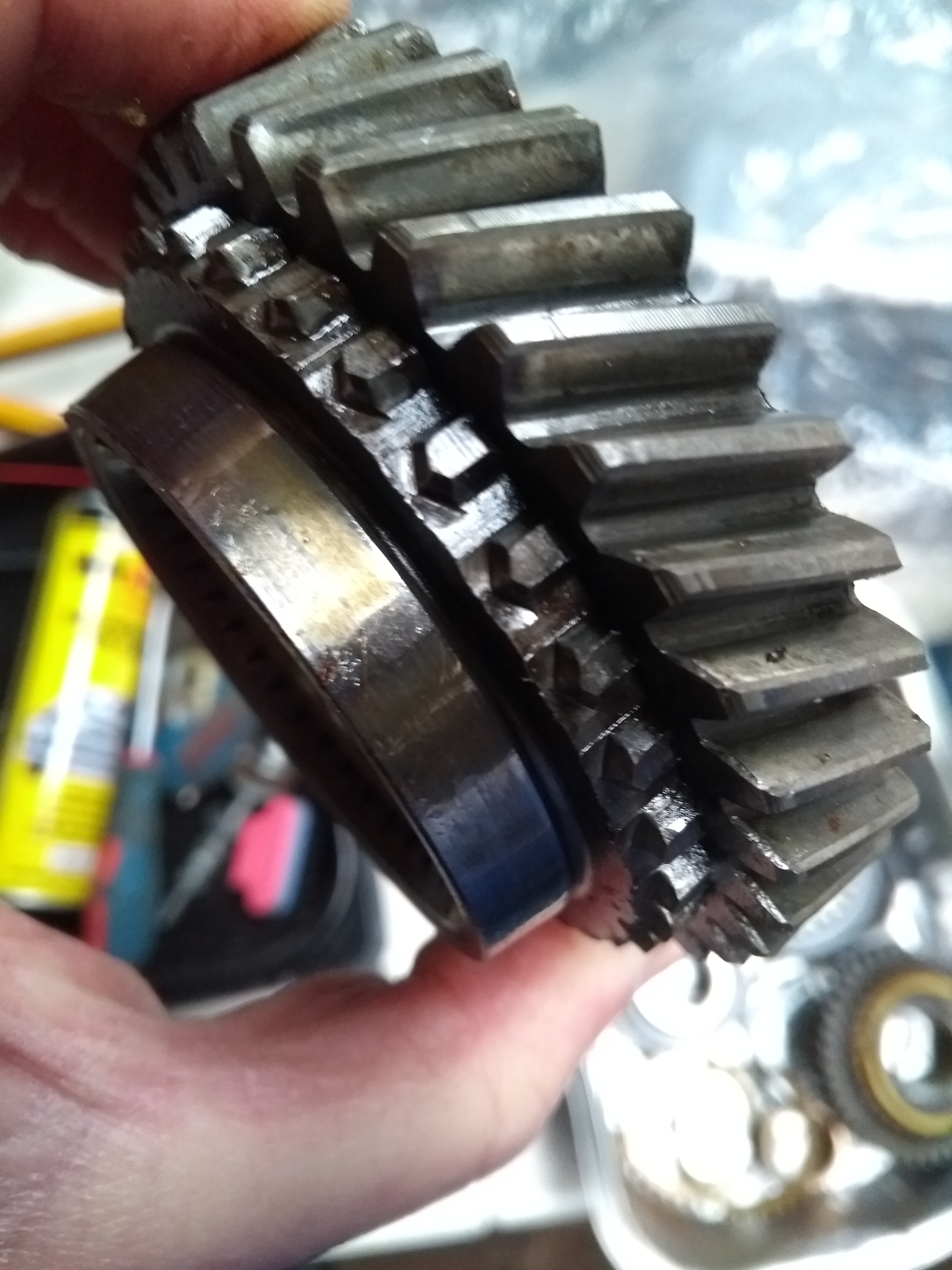

                          Worn components
                          note the pointed teeth that locate in the synchro hub have not been spinning at the correct speed due to worn bulk rings and have crashed and damaged the gear Click image for larger version

                            #223
                            Hard to see on the pic above but they are worn on one side and the bulk ring has no gap on the face of the gear

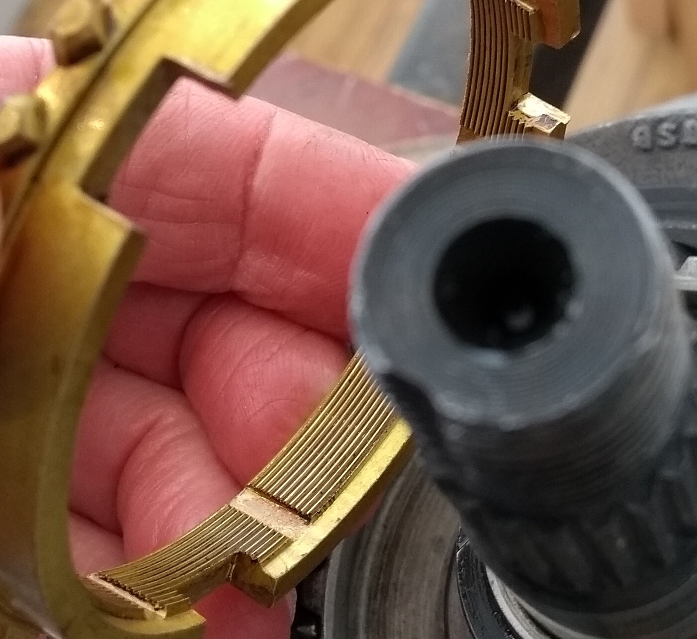

                              #224
                              This bulk ring is in good condition note the rings inside like a screw thread these cut through the oil when they engage the gear to start it spinning at the correct speed to change gear if the screw thread is flat topped that's wear and thus reduces the clearance gap on the face of the taper on the gear this causes it to moves closer to the teeth before getting up to speed and crashes the gear Click image for larger version  Name:	IMG_20210428_134455206_BURST000_COVER_TOP~2.jpg Views:	0 Size:	333.6 KB ID:	15528
