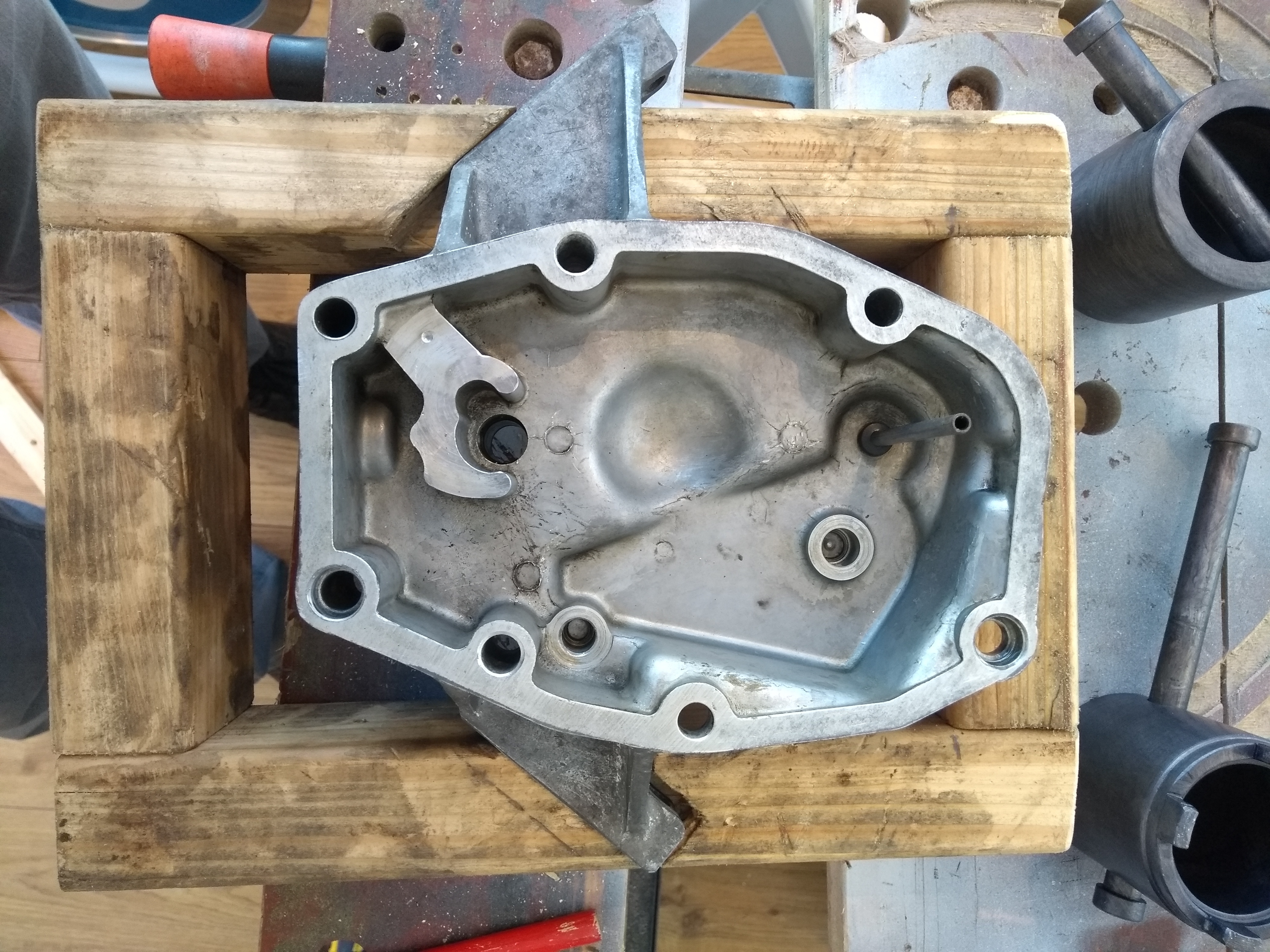

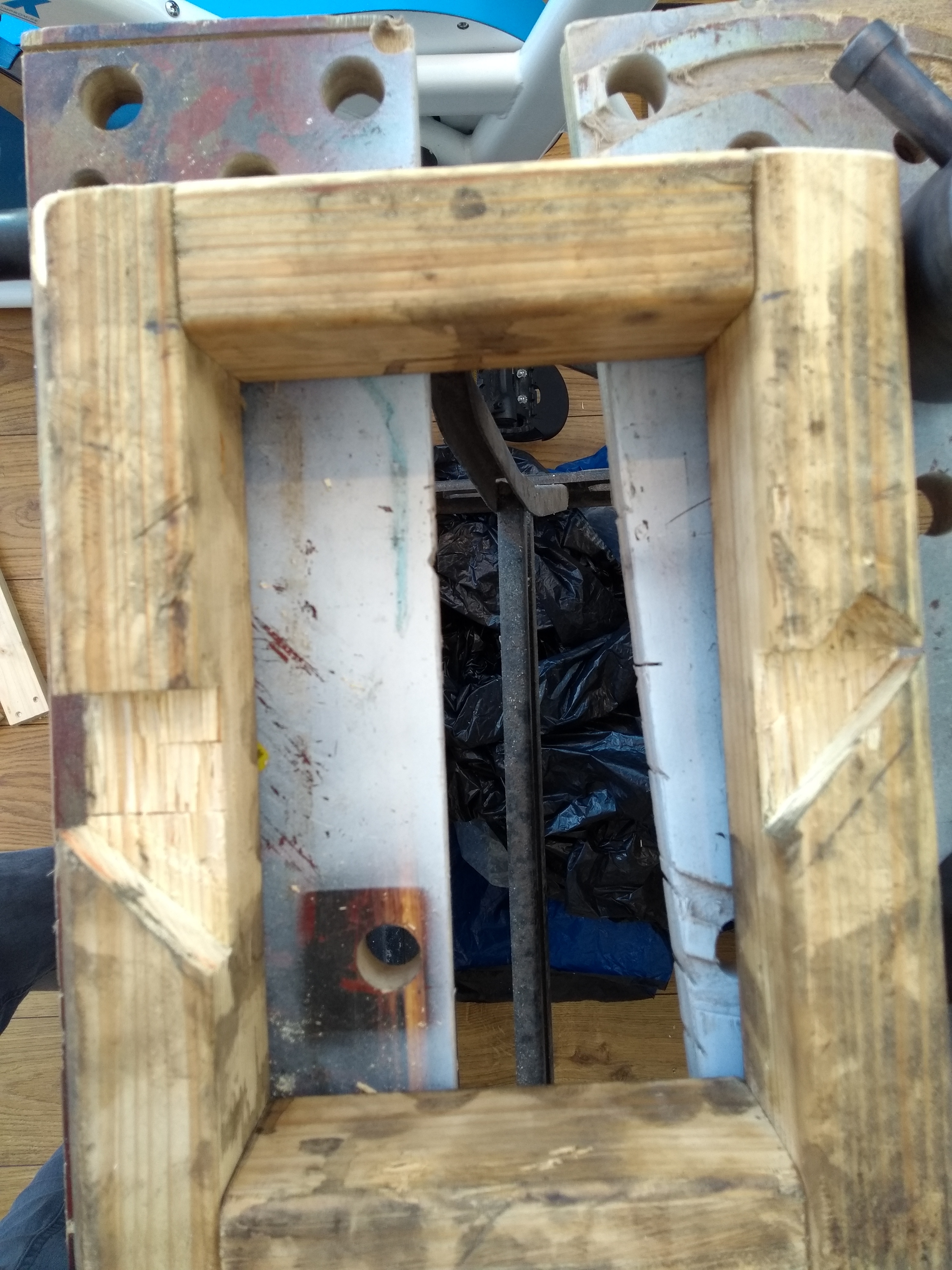

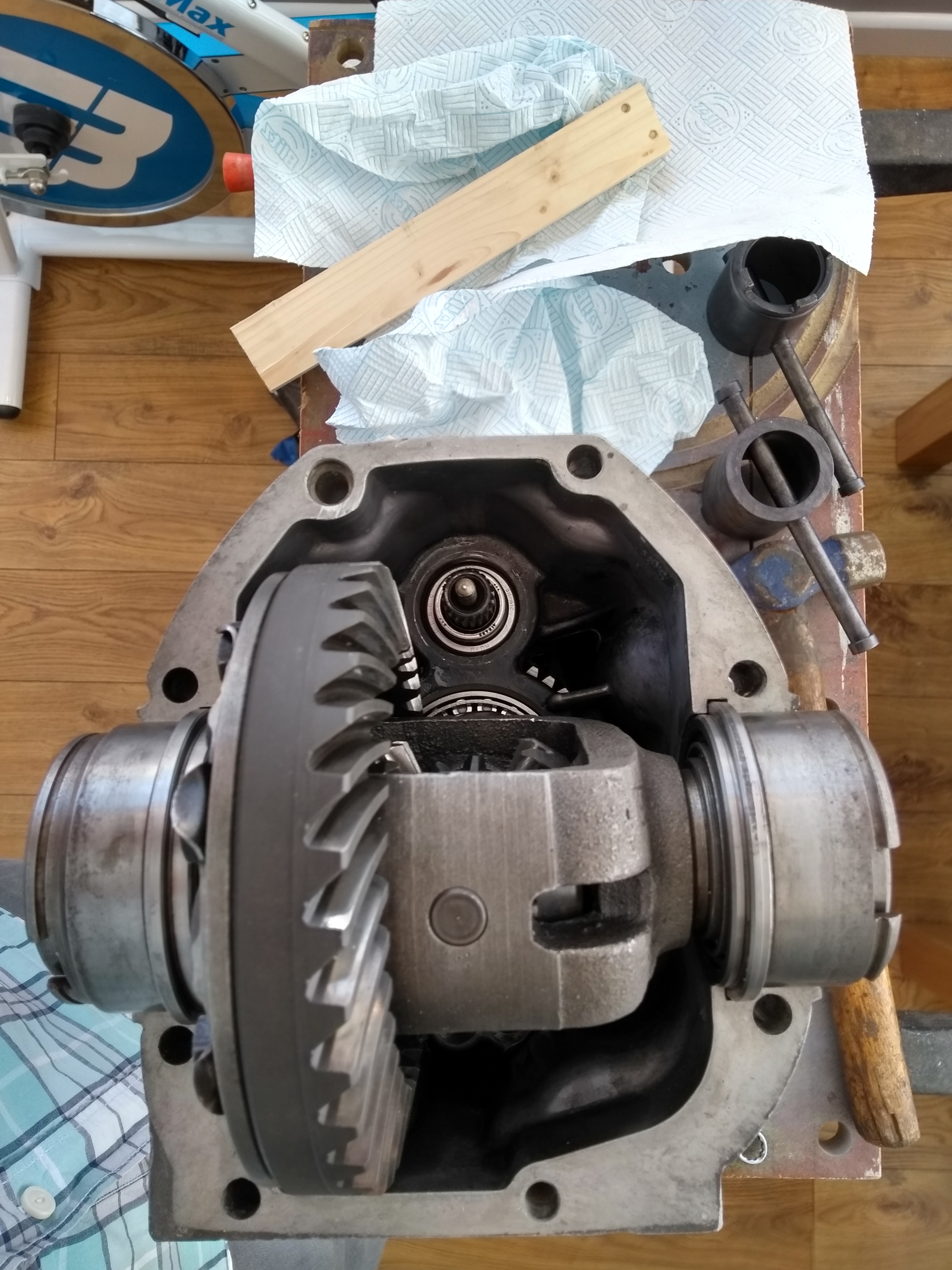

              When fitting the diff it's handy to be able to stand the box vertical some bits of spare wood make a useful stand Click image for larger version

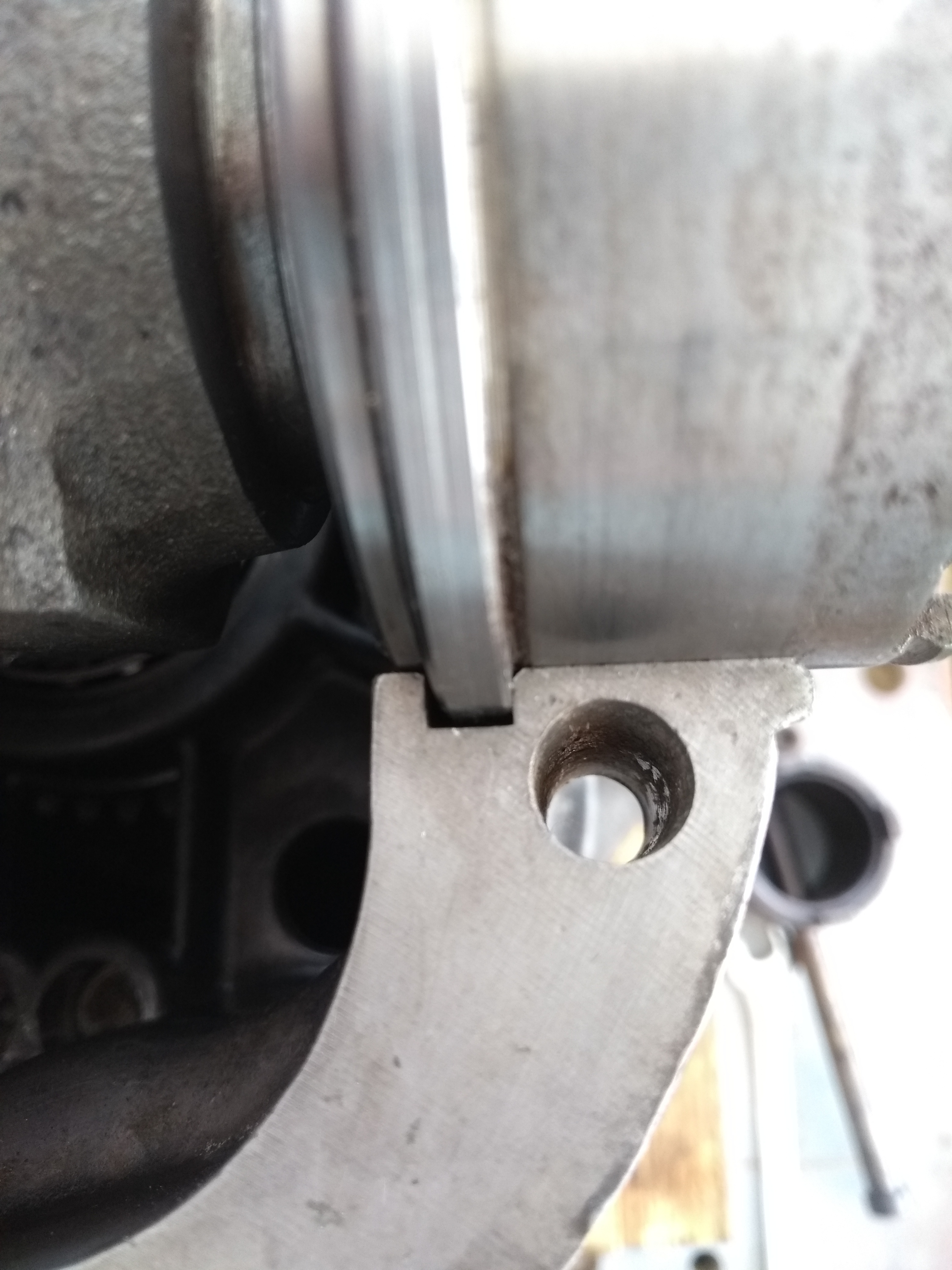

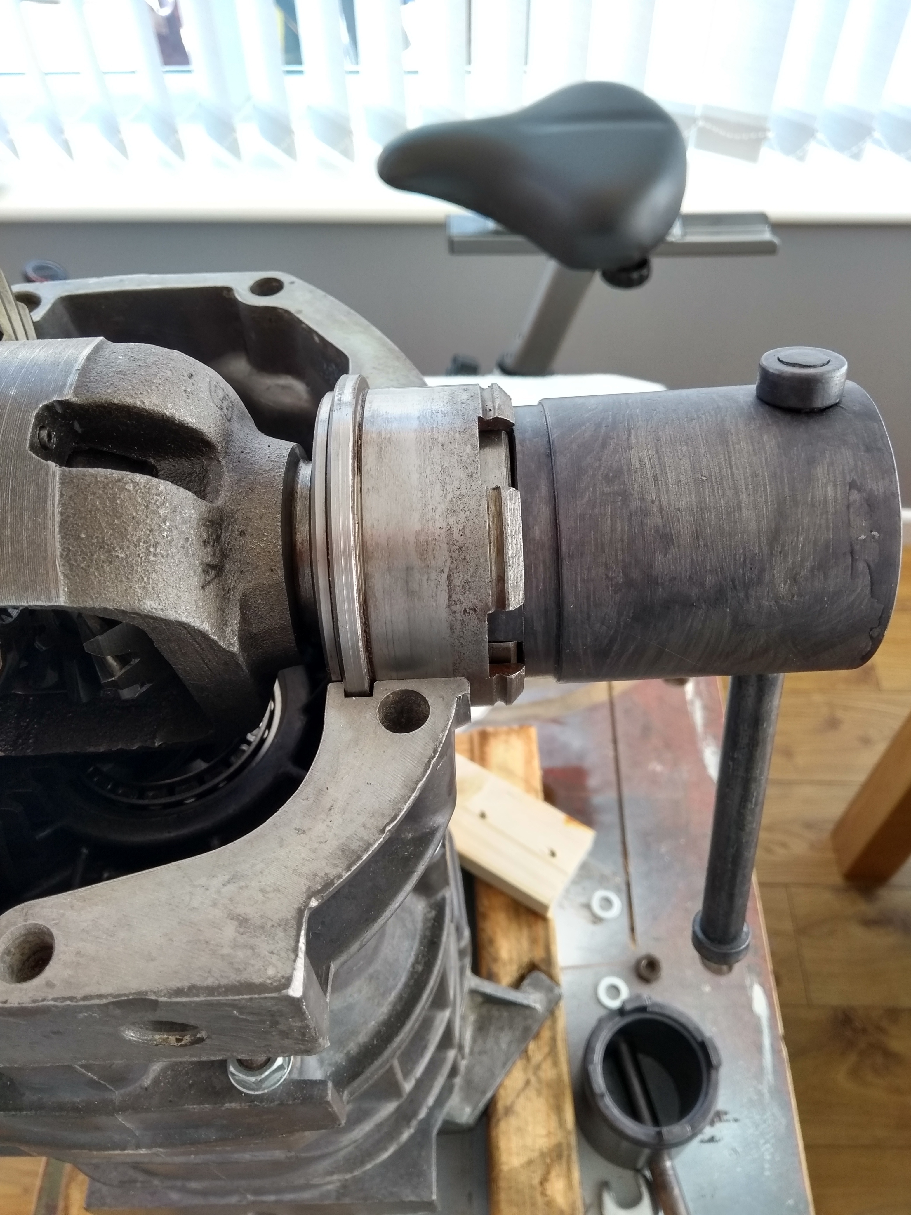

                Normal you would fit the input shaft and fit the belhousing casting tighten the nuts hand tight then wind in the inner screwed sleeves to to push the outer sleeves out in the location grooves ,but you wouldn't be able to see that so I'll do a dry build to show what happens and how to get true nip

                  Oil the bearings and wind the inner sleeves in to protrude inwards 1/16" 1.5mm fit the cages on the diff and lower it into the casing Click image for larger version

                    Check that there's clearance between the crown wheel and pinion .
                    now wind the cage side in, as the outer bearing case contacts the taper it will push the outer screwed sleeves to the outside of the grooves when resistance is felt this is true nip,and your sleeves should be at the outside of the grooves.
                    At this point you tighten the nuts fully and start to set the preload and backlash
                    Hope that kind of explains it Click image for larger version  Name:	IMG_20210505_141918788_HDR.jpg Views:	0 Size:	2.58 MB ID:	14697

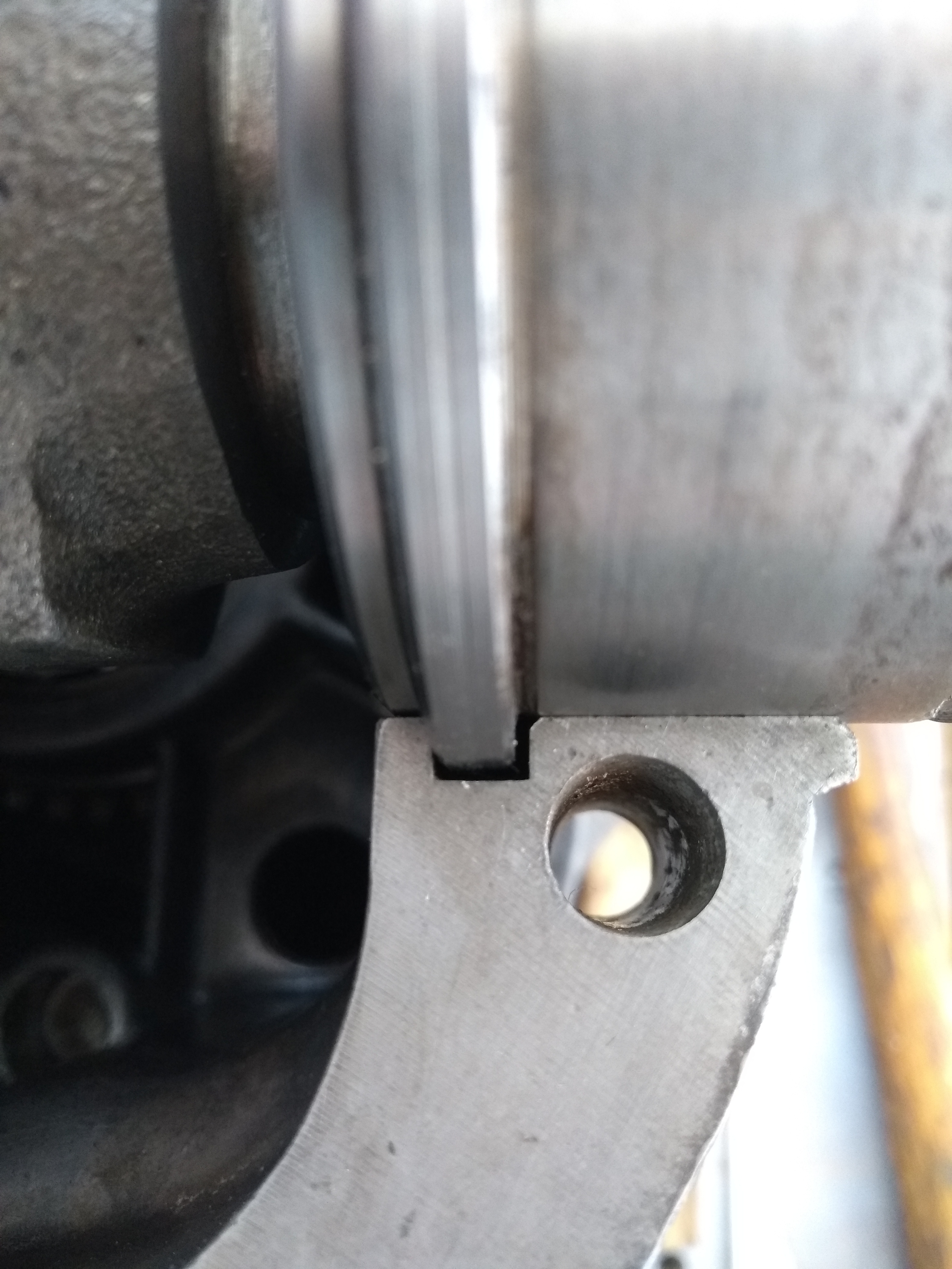

                        #176
                        Now at true nip ,note gap has now been taken up Click image for larger version  Name:	IMG_20210505_141946025.jpg Views:	0 Size:	2.40 MB ID:	14702

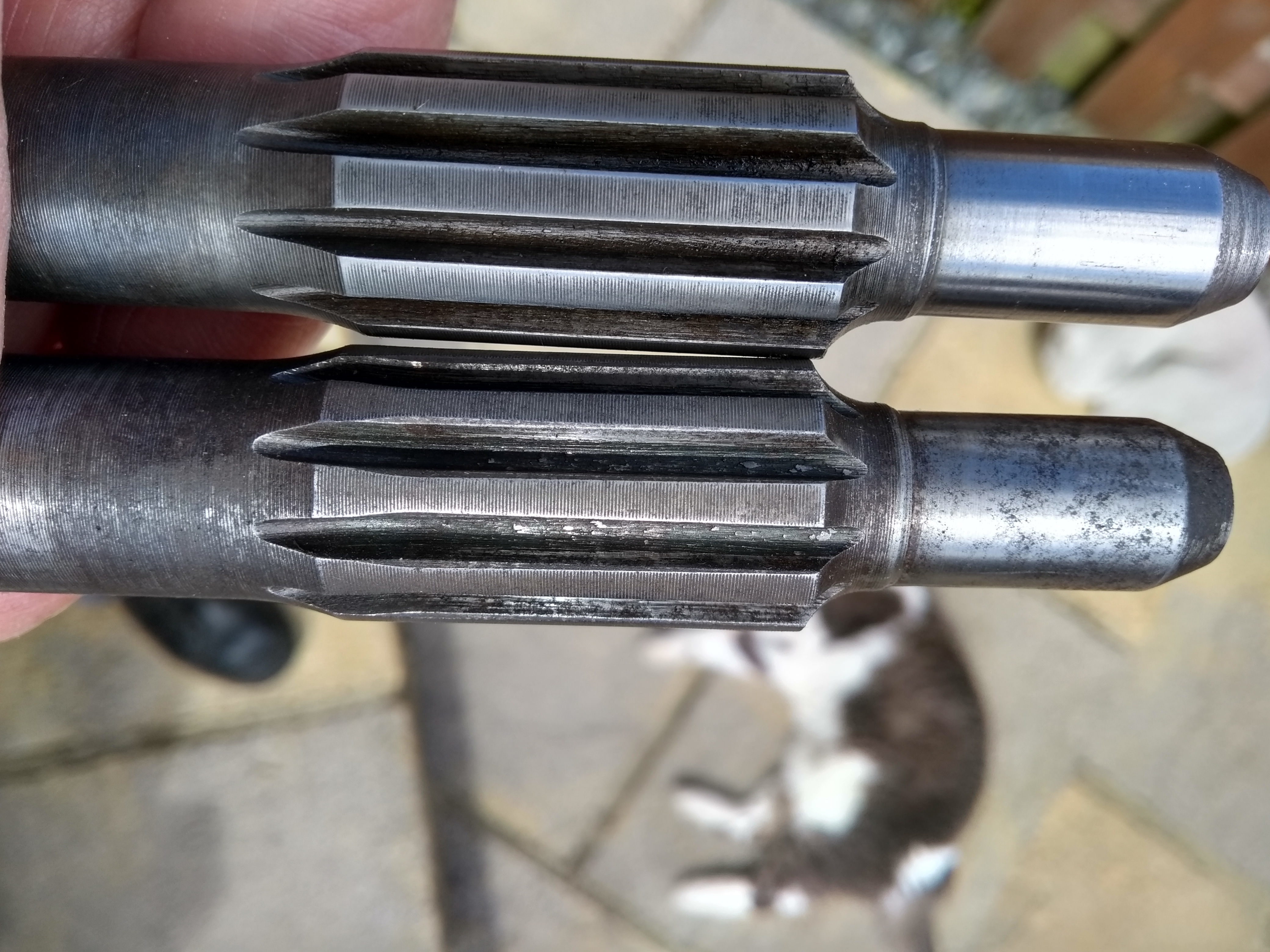

                                Next is the clutch side of the input shaft .
                                Give it a good clean and examine the splines for wear as you can see in the photo the difference with the splined thinning with wear Click image for larger version
