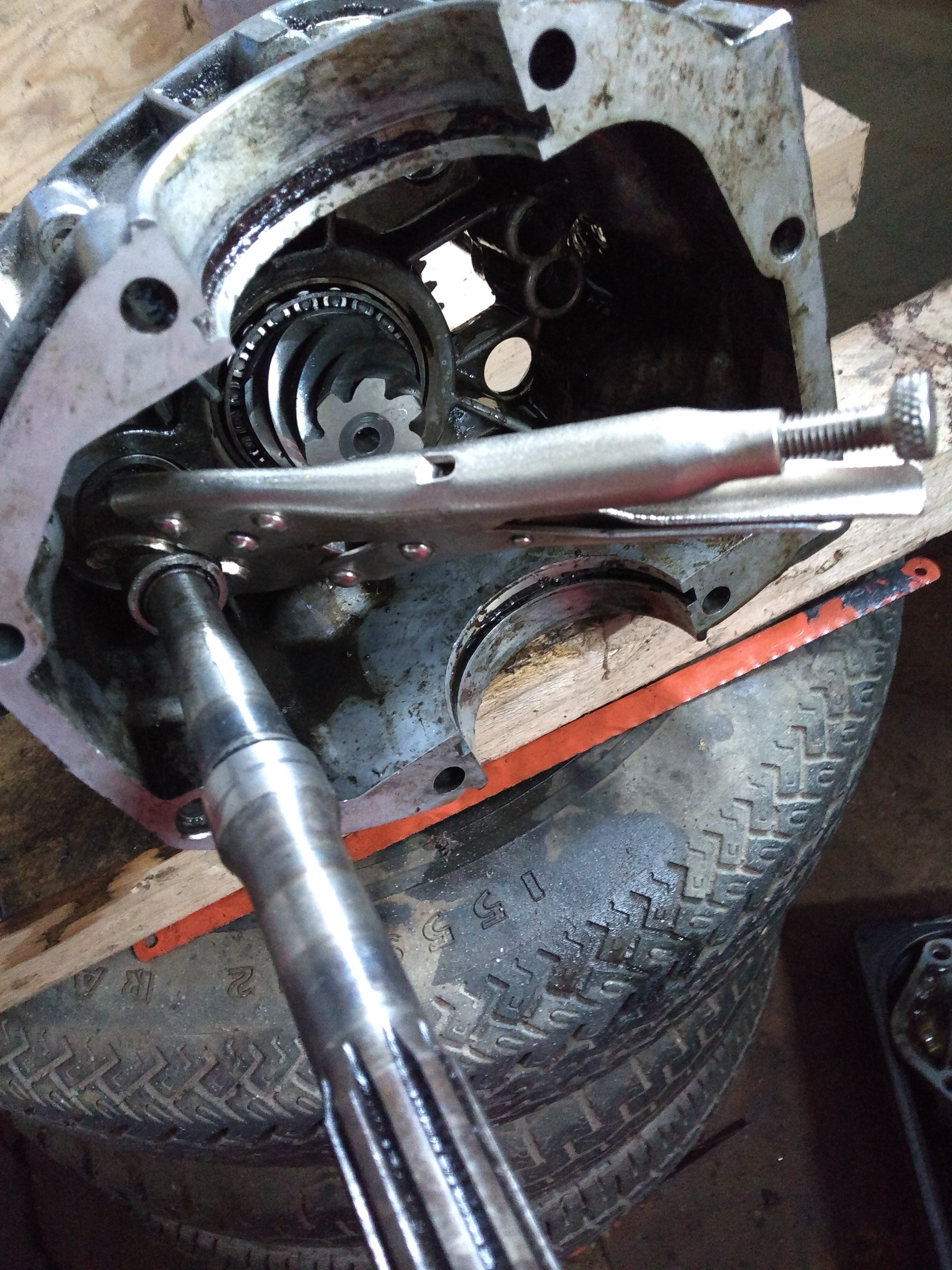

      The only bearing I've had trouble with is the larger diff bearings the smaller one has 2 cut outs cast into the cage that was straightforward with a 2 legged puller
      But the larger one the inner casing has a flange with only about a 3 mm undercut I couldn't get the puller on even when I ground it down a bit
      in the end I got a slitting wheel and ground it across to weaken it and put a little bit of heat into it without going into the cage which then allowed me to give a quick hit with a chisel and it moved up the shaft a bit .job done

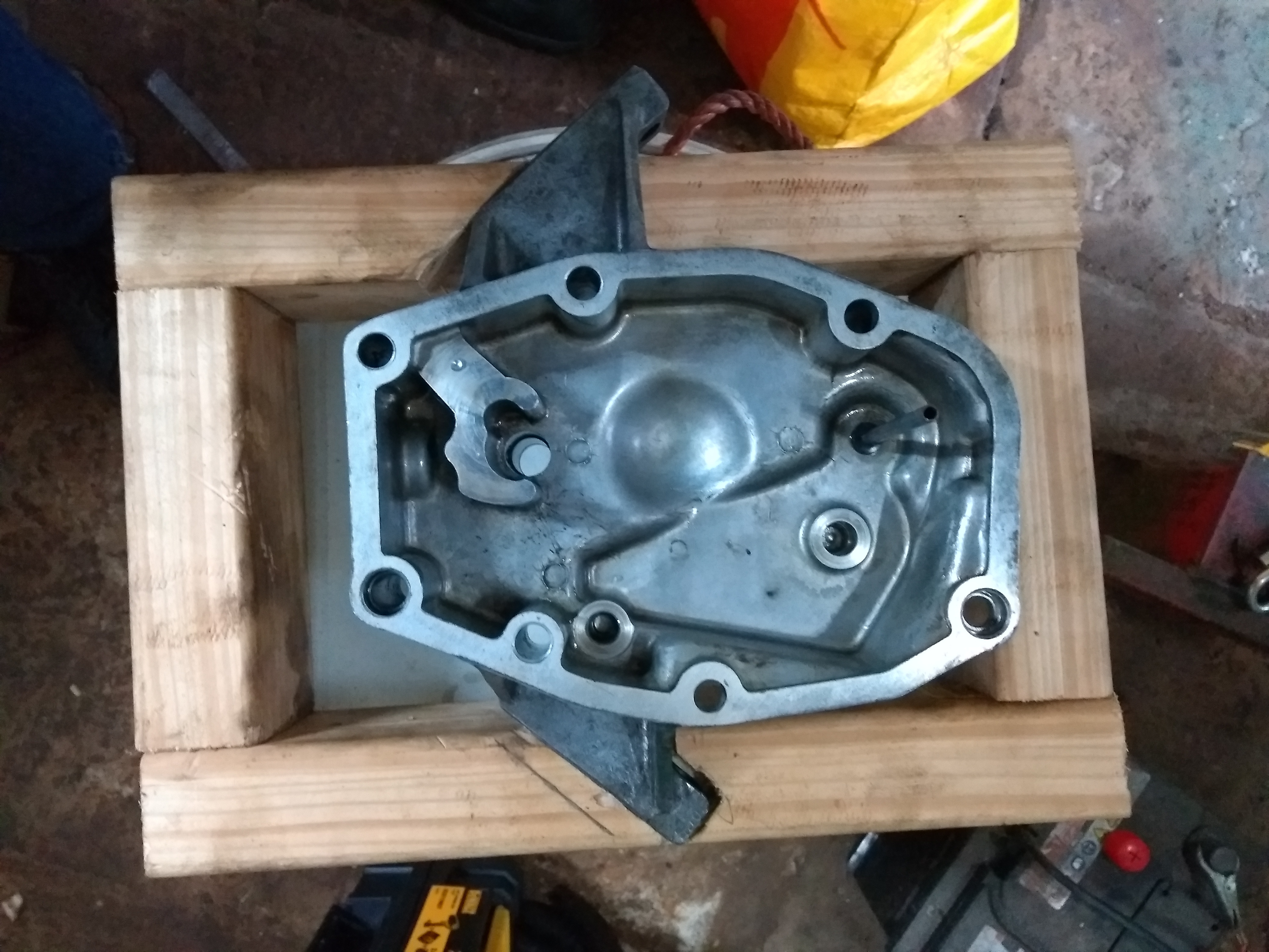

              Ordered the other tools needed to do the box bearing and made this simple support that Dave suggested to stand the box on when assembling
              best regards Gary Click image for larger version

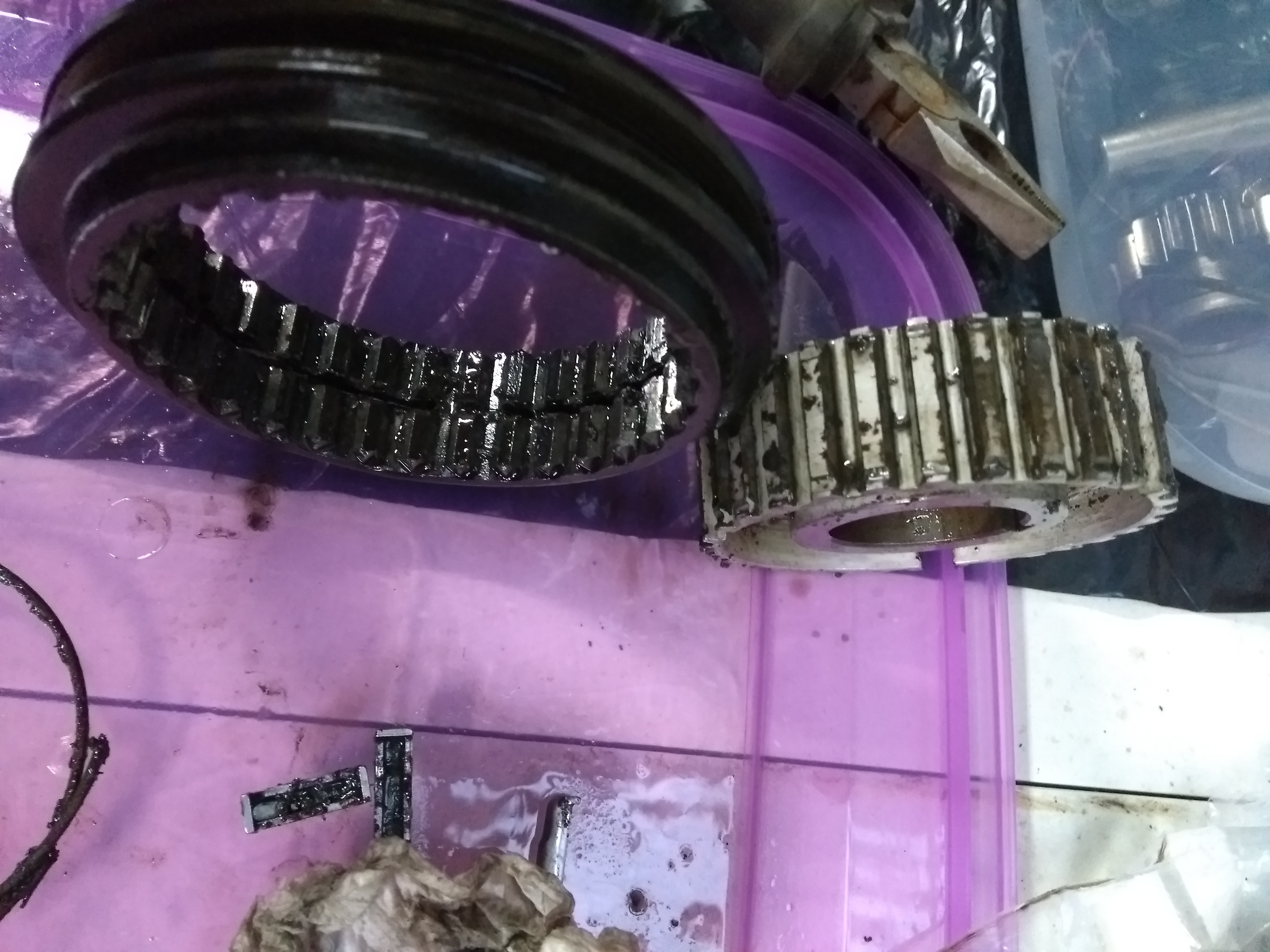

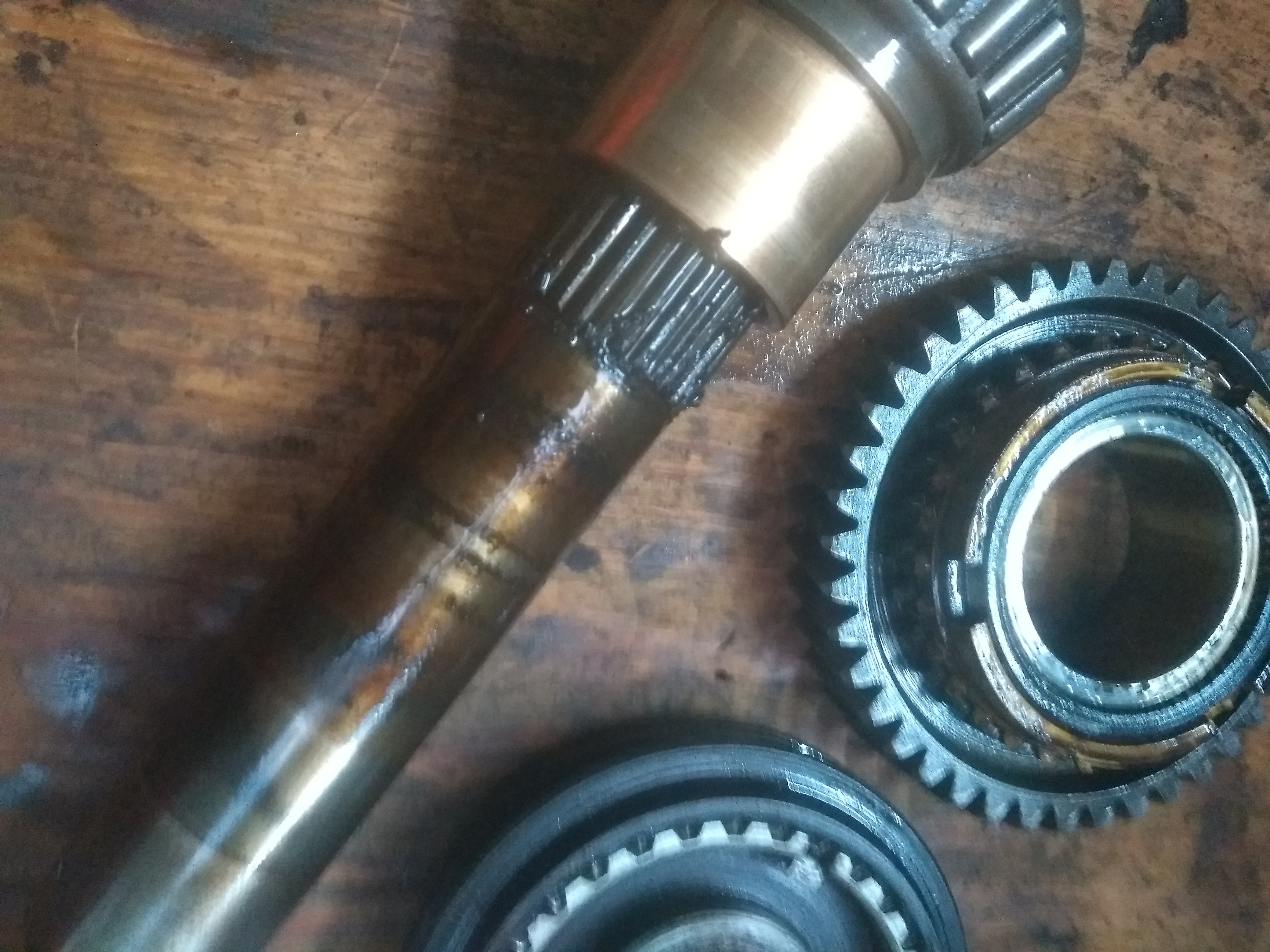

ID:	11001Click image for larger version  Name:	IMG_20201027_161916631.jpg Views:	0 Size:	3.39 MB ID:	11000 Finally stripped down the other box ,this was what I thought was the good one .
                        There was some good oil in but once I got it open it was full of sticky black gunge nothing would move it was all in the syncho hub ,the muff coupling would not slide back to reveal the locking ring one side managed to get the locking ring off about an hour I had to use mole grips and a mallet to slide it up the shaft all the bronze bearings on the pinion shaft we're stuck solid it's a good job I didn't put in the car Click image for larger version  Name:	IMG_20201102_155953677.jpg Views:	0 Size:	3.06 MB ID:	10996

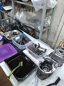

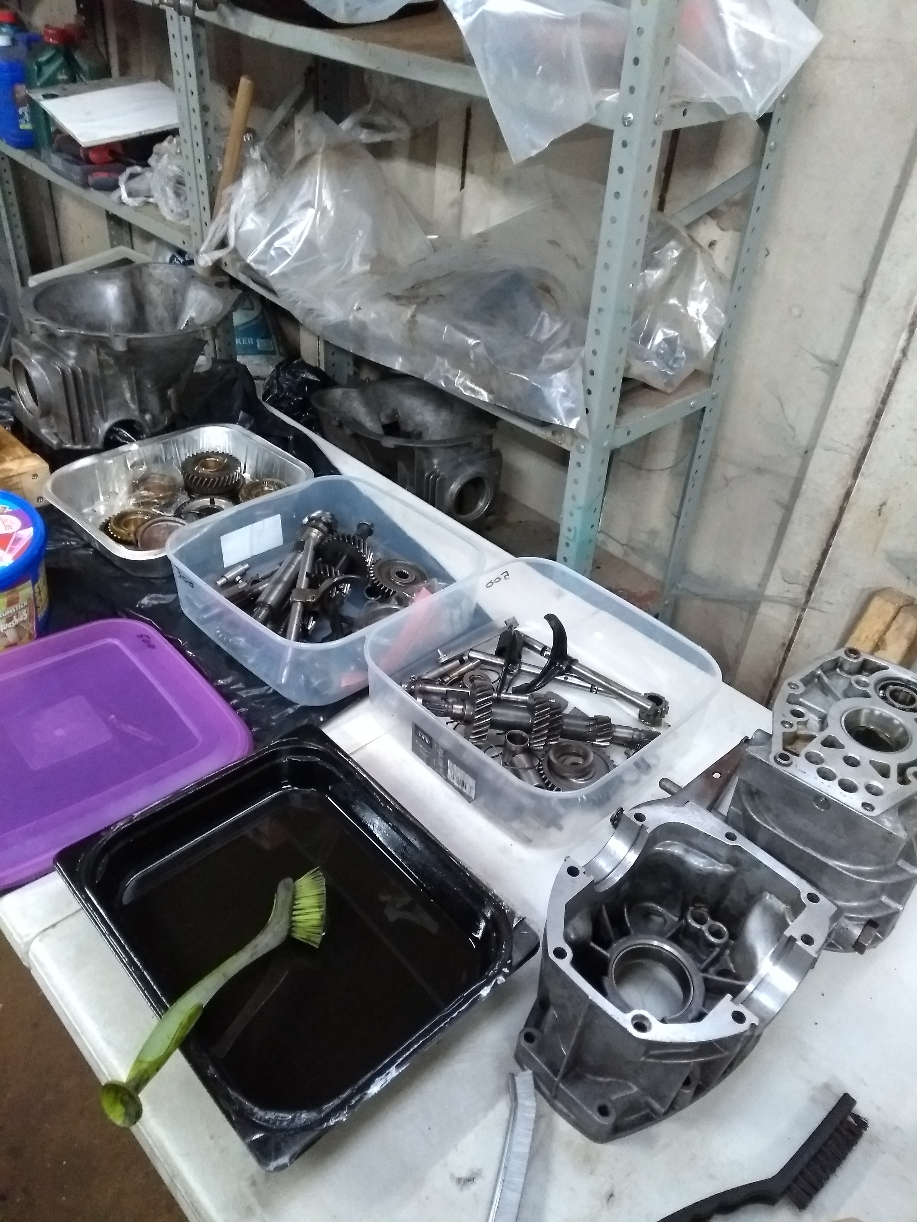

                          All cleaned now and in separate boxes Click image for larger version

                            #28
                            Gary, great work. Yes unfortunately only way to tell if the box is good is to take it on road, even then the black gunge always seems to live in there.
                            Pat will be well happy seeing it that organised, I tend to be a little less sorted PMCG
