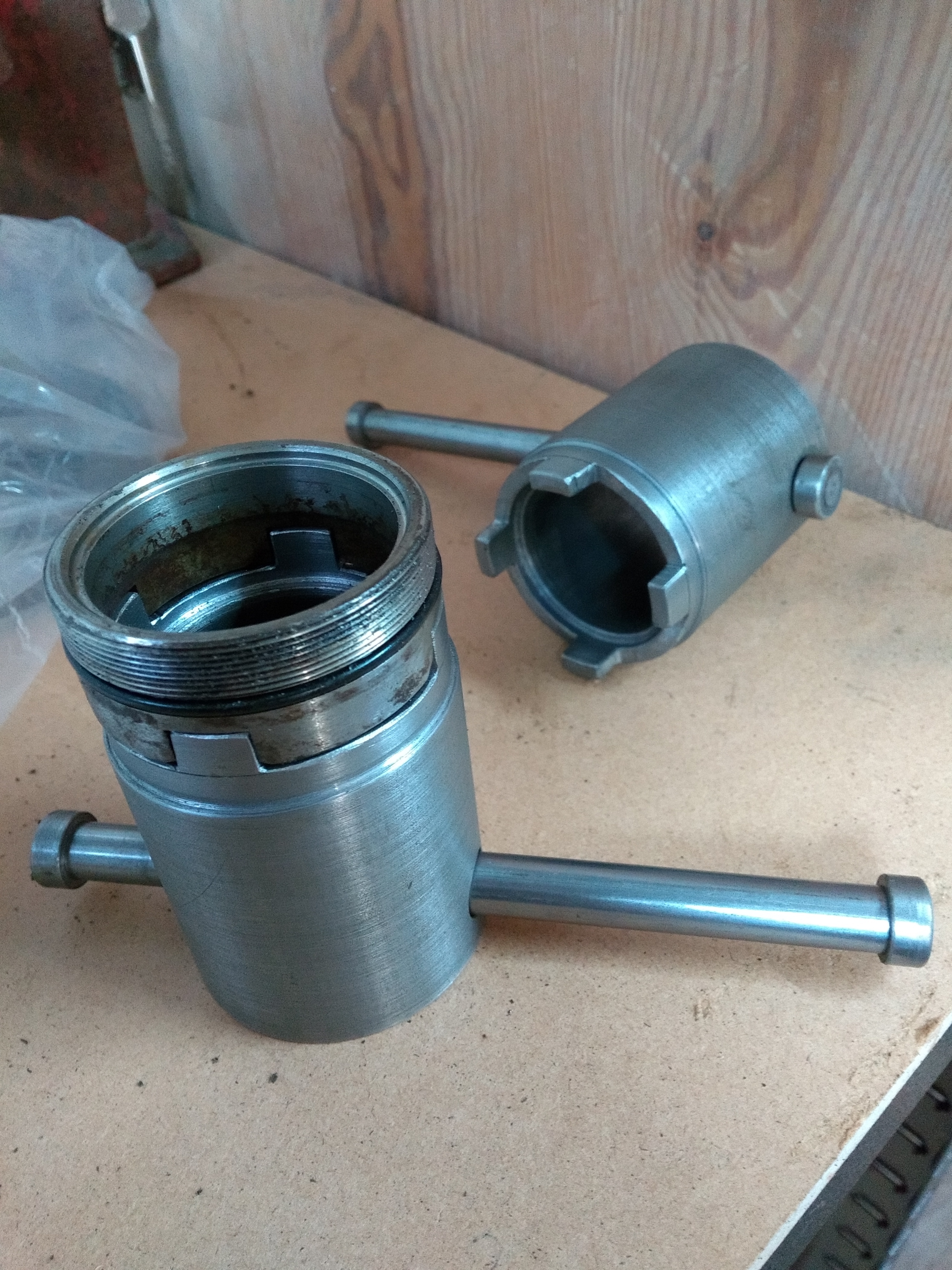

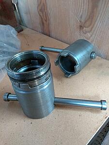

    RG373 Hypoid and pinion bearing tool For backlash setting and preload of bearings.
    these were probably the most difficult to remake as I have no milling machine but in the end they came out better than expected

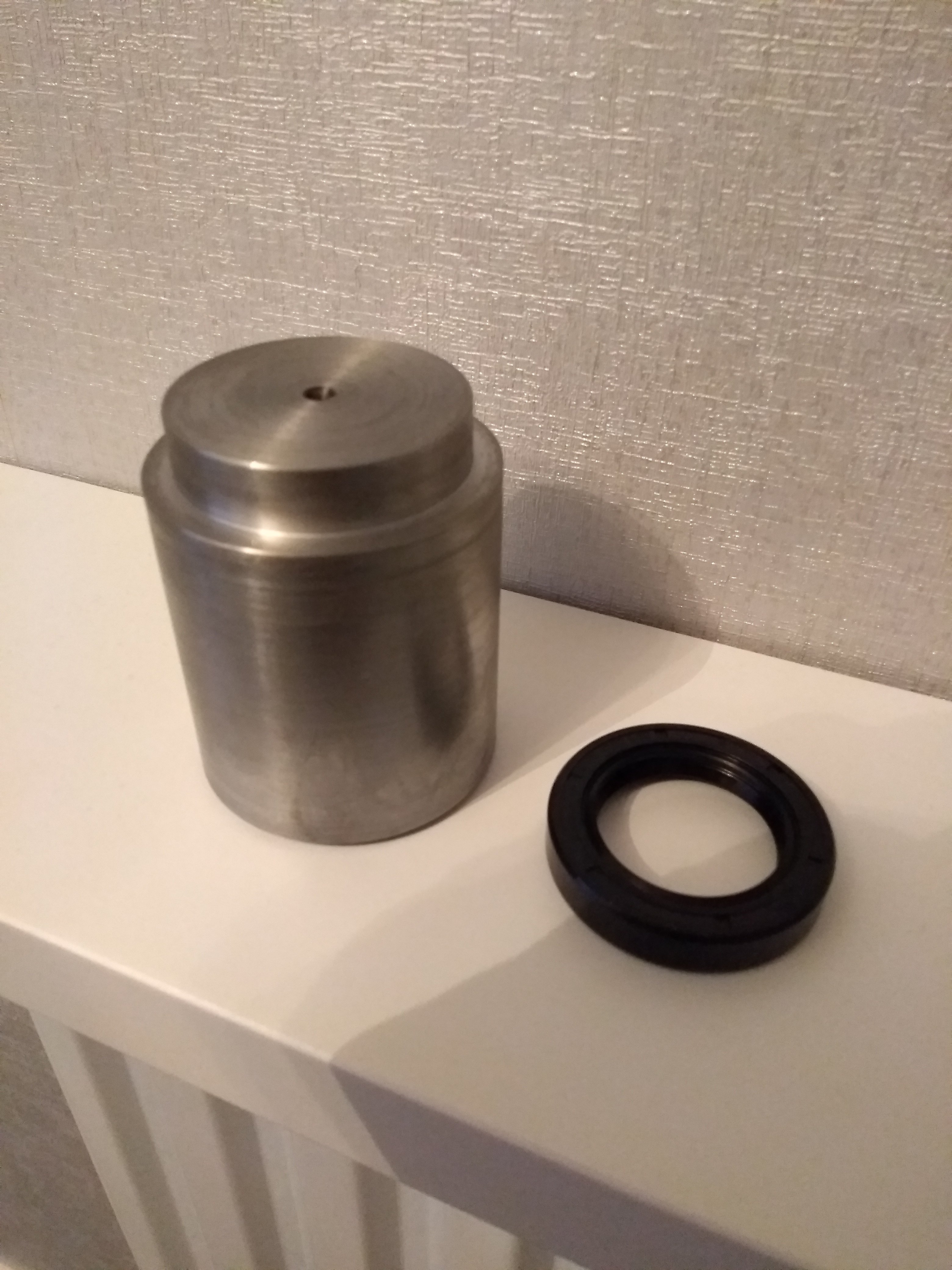

      RG366A is for pressing in the Hypoid oil seals into the screwed sleeves.
      think a lot of people will have this one Click image for larger version

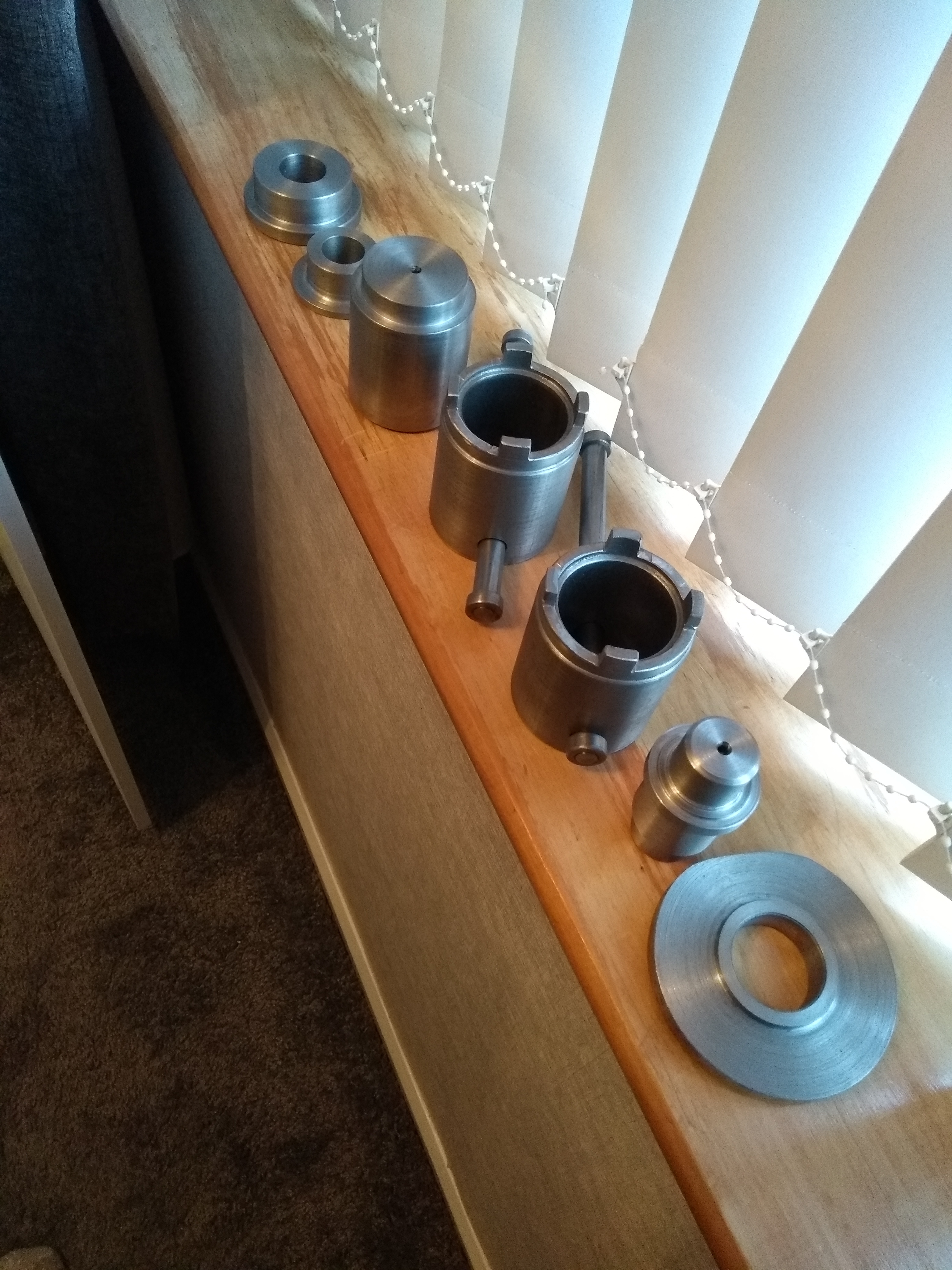

        That's all of them so far Click image for larger version

          The last one is RG372 Input shaft oil seal fitting tool ,but I'll have to order more steel for that one it's quite long

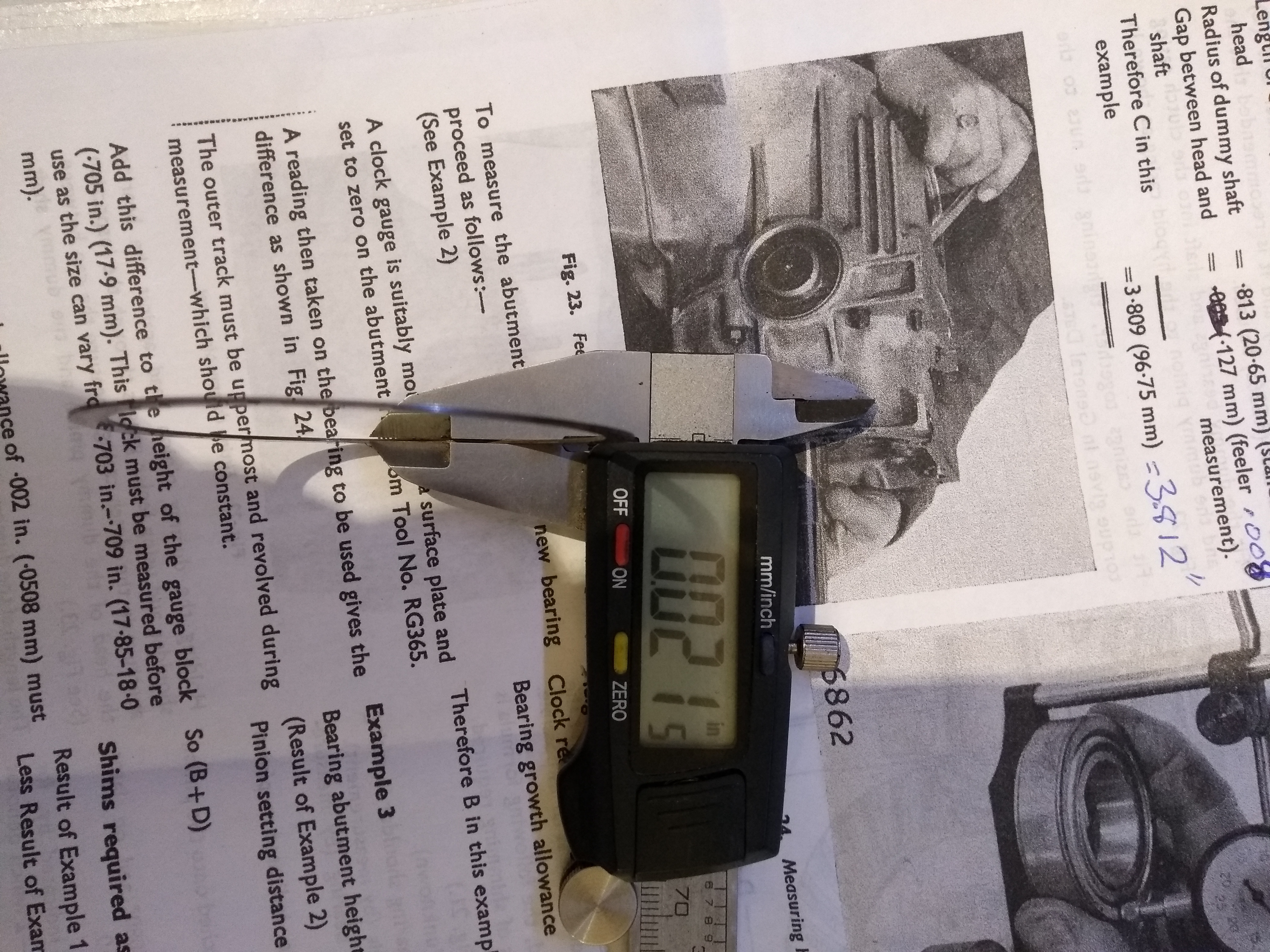

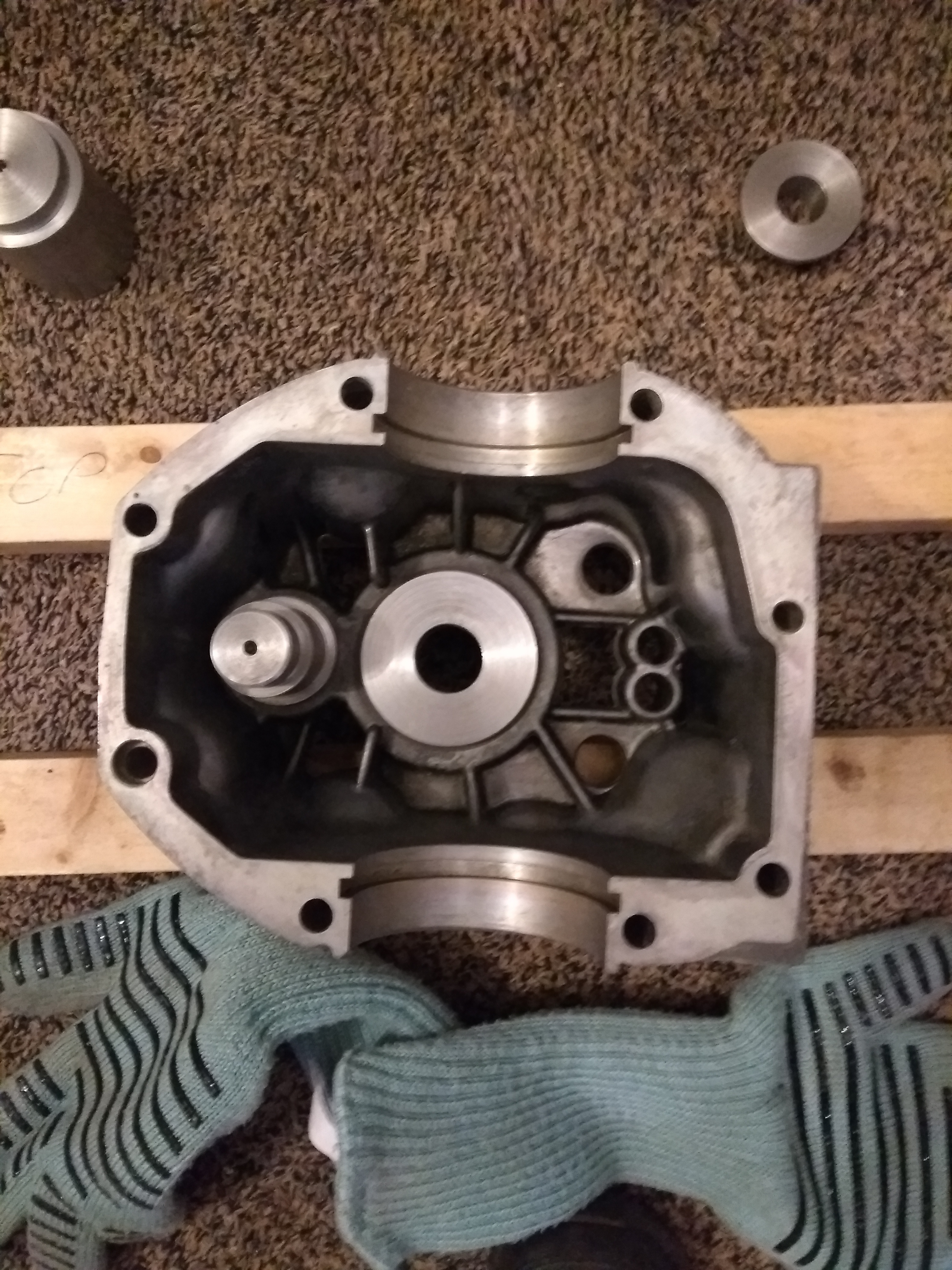

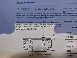

ID:	12862 Fitting bearings today I've worked out the shim required for the pinion shaft bearing and it has worked out the same as the shims that came out.
            Mike is most likely correct that the bearing tolerance are much the same today as they were them it's the boxes that had the issue Click image for larger version  Name:	IMG_20210223_132049487.jpg Views:	0 Size:	3.90 MB ID:	12858

ID:	12868 I mentioned earlier that the tail end bearing should be made up to .032" as per photo but none of the boxes I've stripped had any shims near this in fact this box had no shim's so we are back to tolerance issues in the production line I will not put any shims in and we will see if it is correct later when setting the preload.

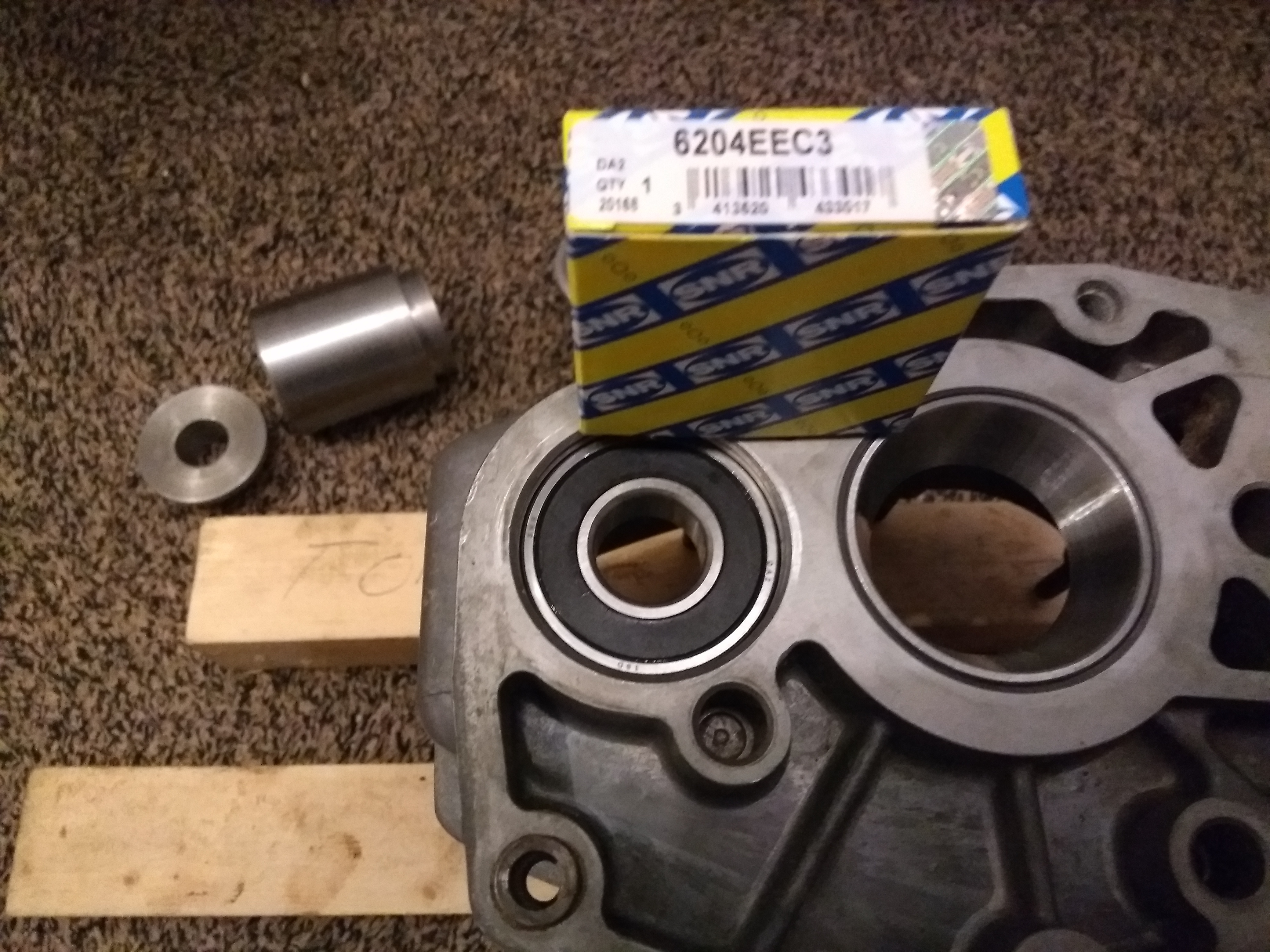

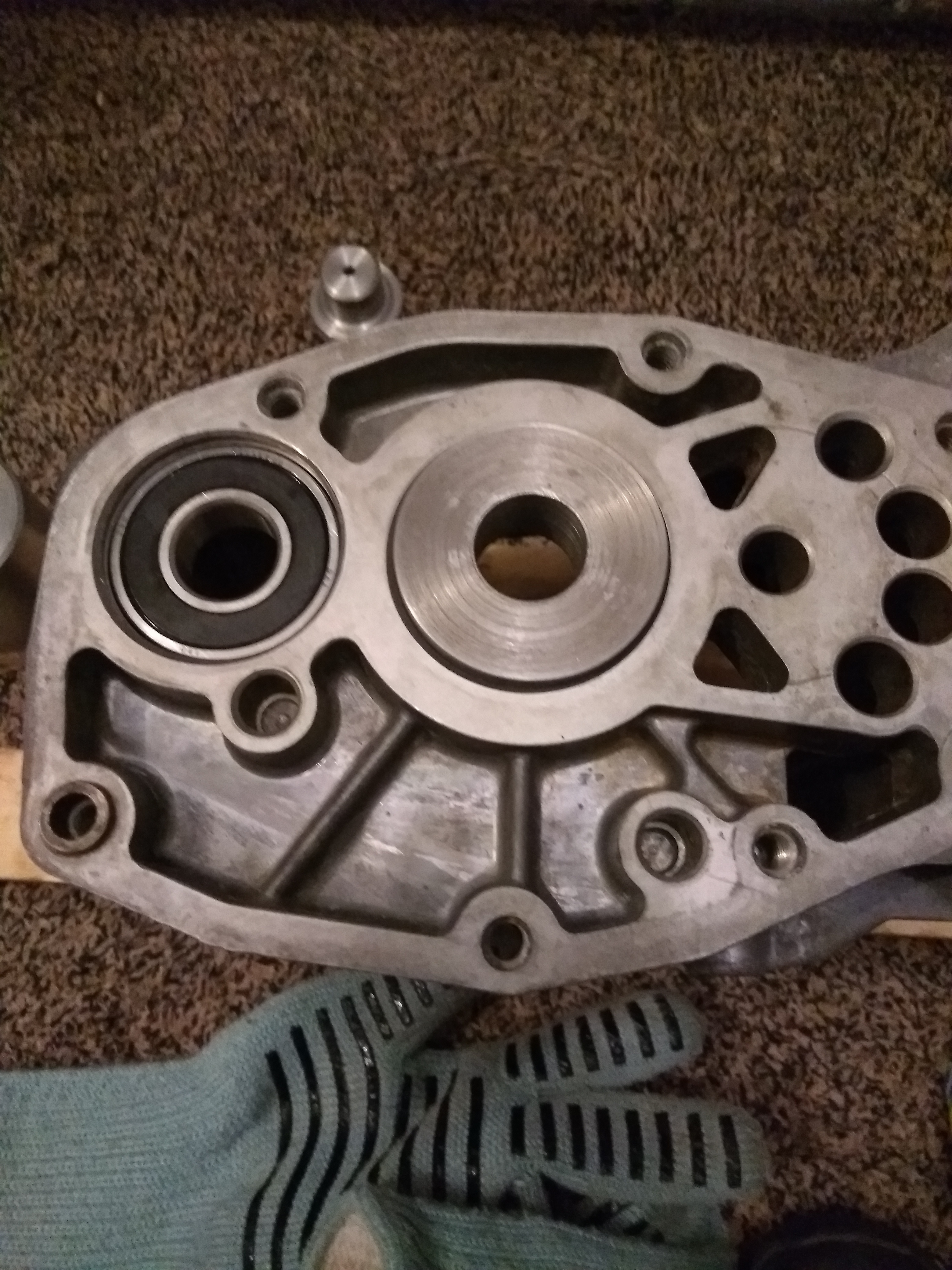

                    Click image for larger version  Name:	16140902558328006284571684763706.jpg Views:	0 Size:	3.28 MB ID:	12872 Don't forget the ballbearing 6204 is a C3 high temperature mine has side shields Dave weedon suggest this as this is the one that gets oil starvation the shields or not oil tight oil will get it but it may prevent it disappearing so quickly one things for sure the other one doesn't work there always knackered
                    it's up to you Iam not saying definitely do it like this.
                    Make sure you put the circlip back in?
                    Click image for larger version  Name:	16140901304668334072306968316228.jpg Views:	0 Size:	3.30 MB ID:	12870

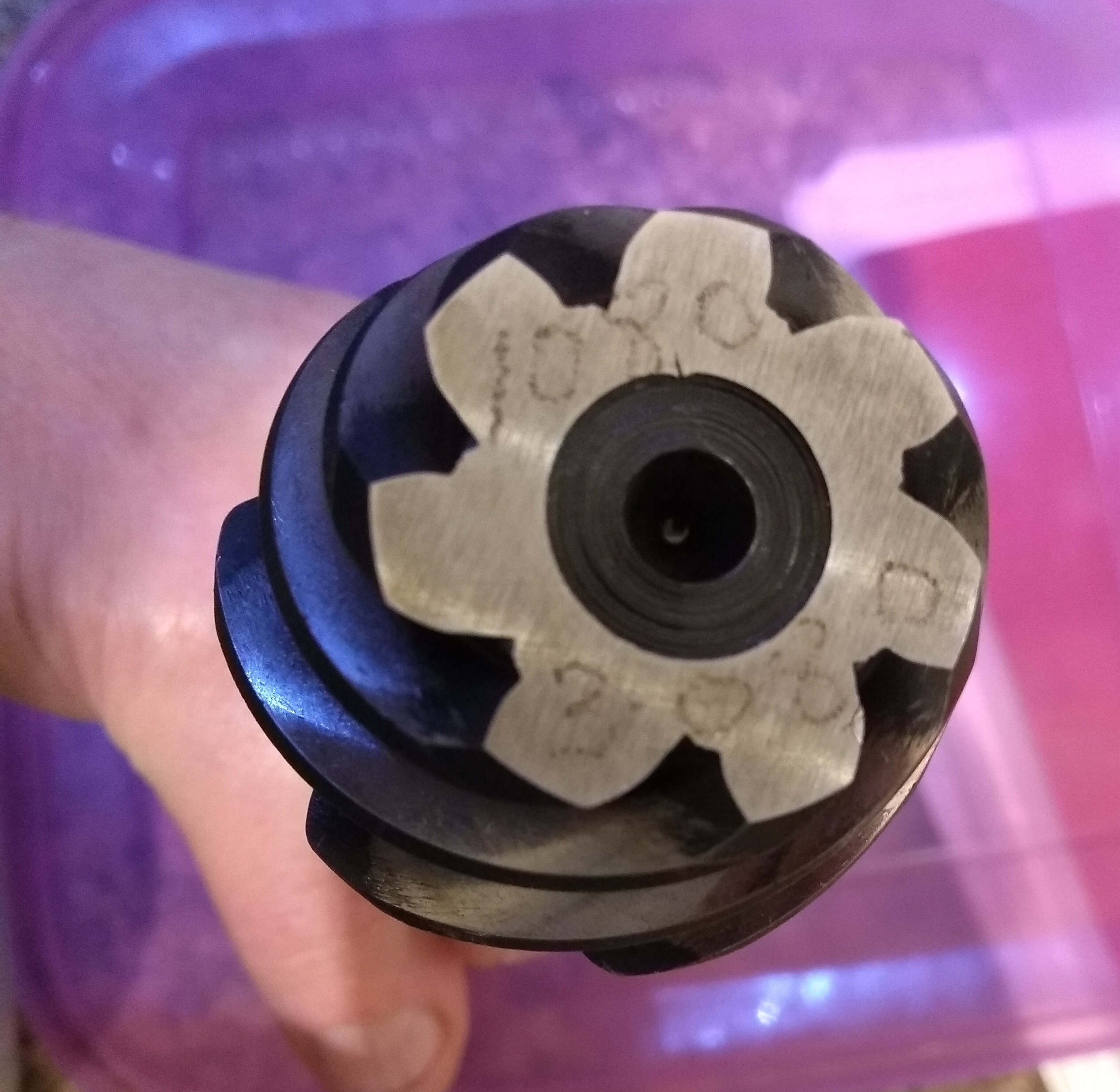

                      Sorry forgot to mention the pinion and crown wheel distance is 3.080 std but this can change you need to look on the top of the pinion shaft head it will be stamped with a number that matches the crown wheel as they are a set in this case it can be seen as 1080 the distance is also stamped in this case it is STD 3.080 later boxes were stamped with a 0 for STD then a + or,- .002" to indicate +or- STD size
                      best regards Gary Click image for larger version

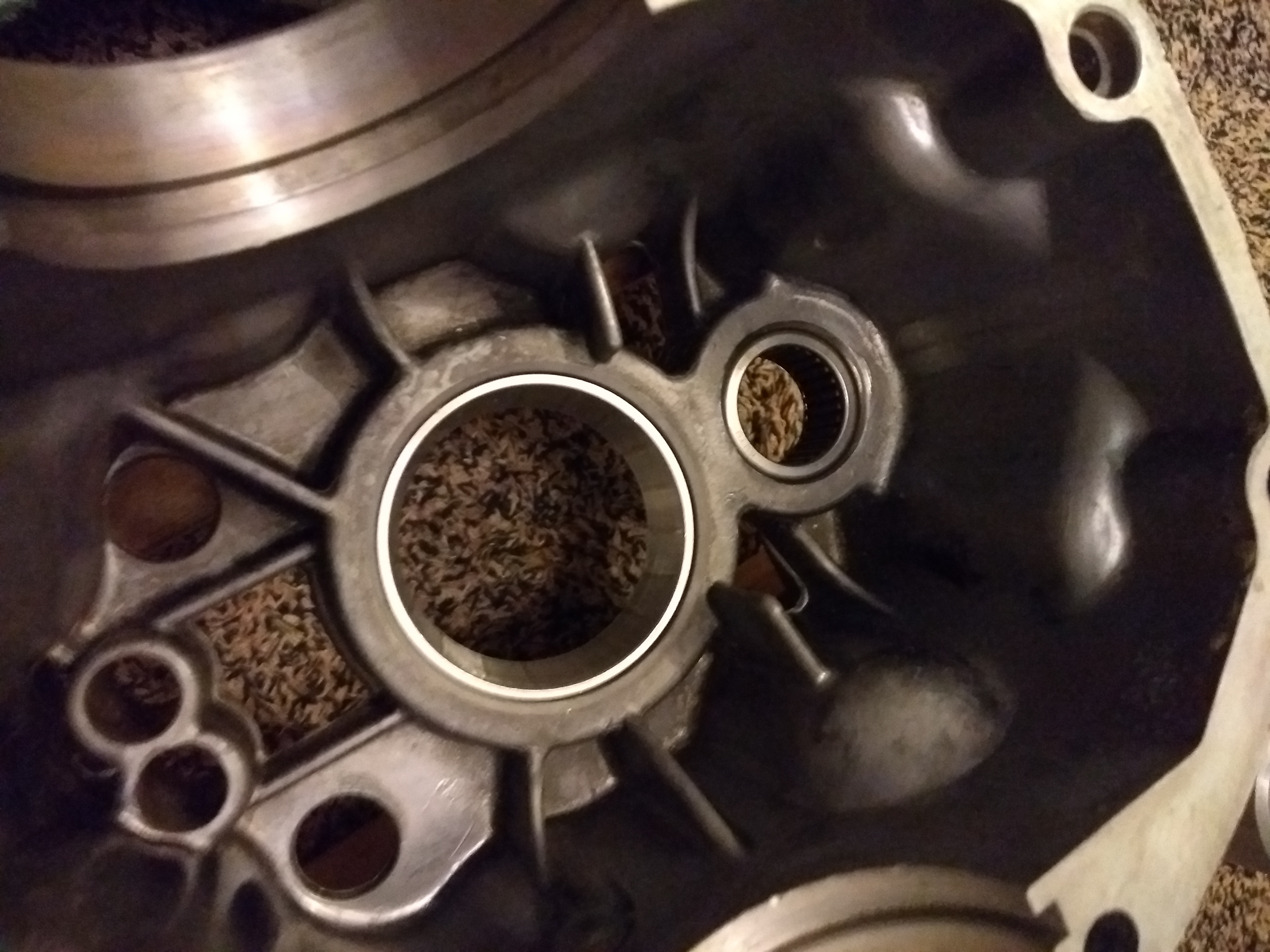

                              See facebook if you like - I put up some pics plus a video over there. It was the frontmost brass tube. It has a notch for the woodruff key, and it became mangled up - I think I made an assembly fault. Seems important to first fit the brass tube, and then slide the gear on top and do not lift it up again.
                              The mangled up brass tube made the gear shaft to be loose, lots of play in it, and the rearmost gear just next to the wall then rubs against the wall. I found some alloy swarf in the oil which made me wonder because the oil was renewed 40 meters ago.

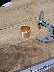

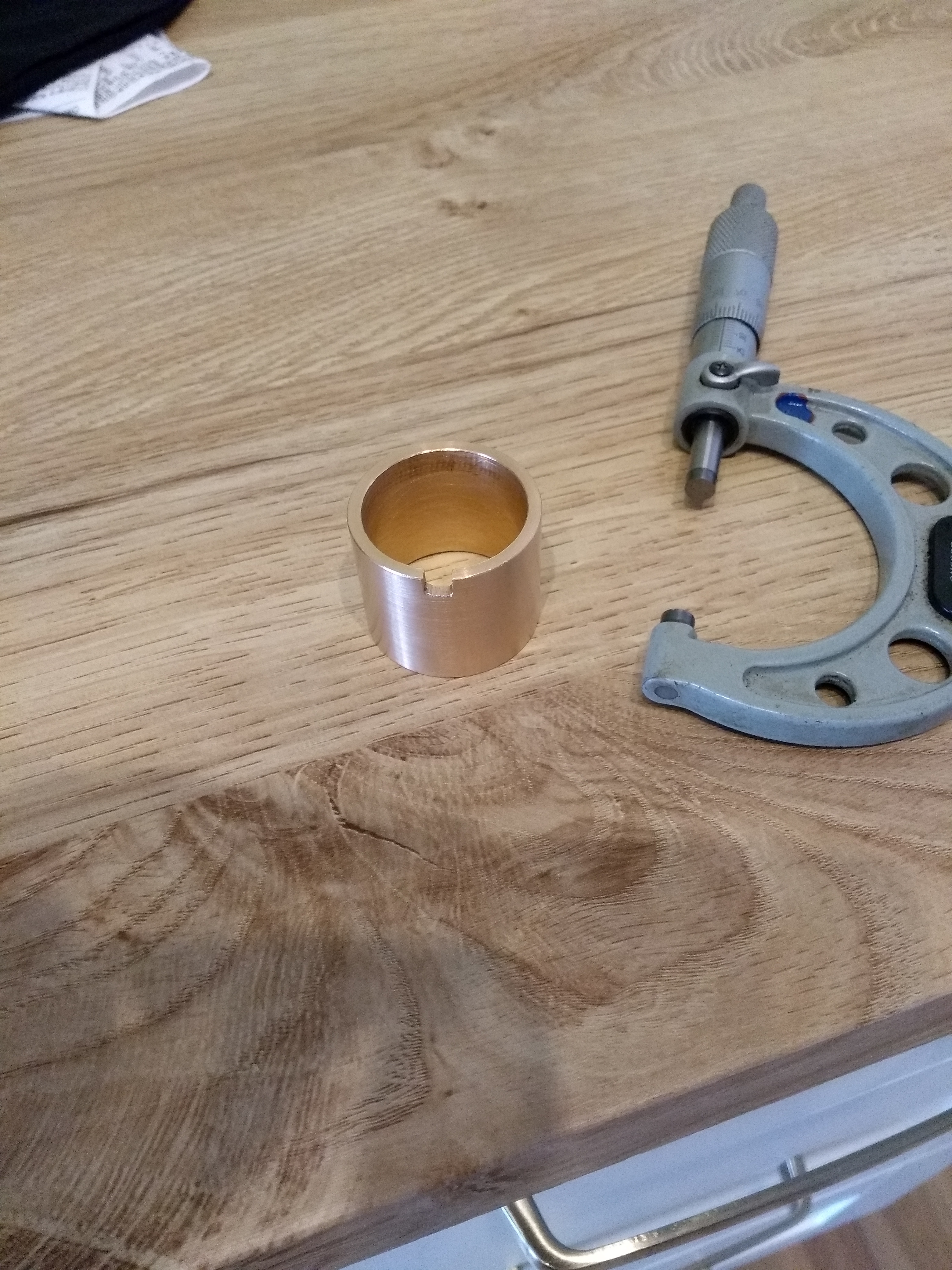

                                Hi just to let you know this post has not gone flat ? Iam still working on it just been busy with other things I'm afraid. The box is part built now but the 4th gear bush which is new was undersize and highlighted an issue with the bush crush allowance which I'll show later,so had to make a new one. Iam now very happy with the method for making these accurately and without any run out when I've finished I'll put a set on the shelf if anyone needs some .
                                unfortunately when building and making components I have to workout how things work ,not just fitting the correct shim because it tells you I have to understand why and what it is for and how it effects the other components but I am getting there now .
