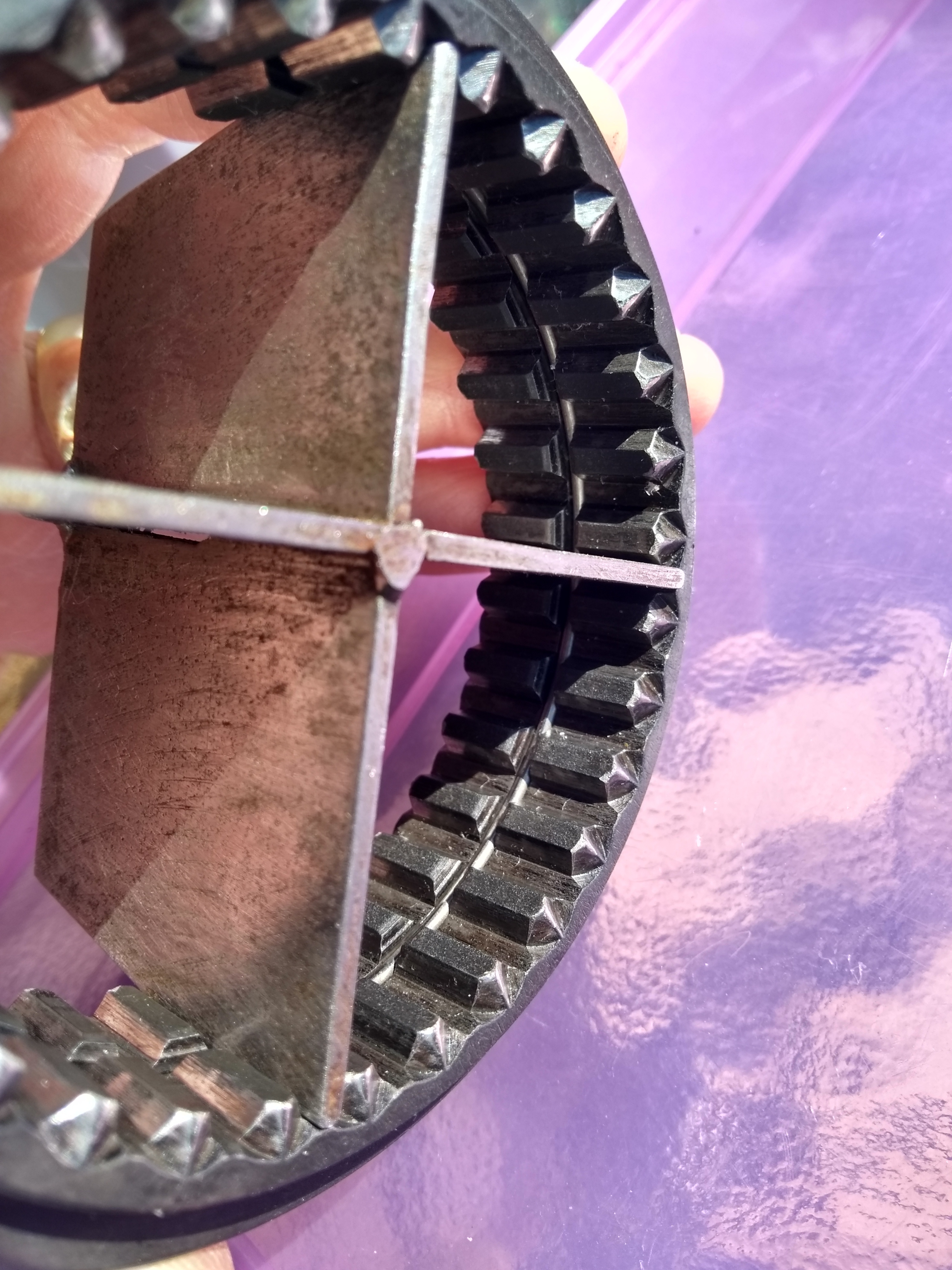

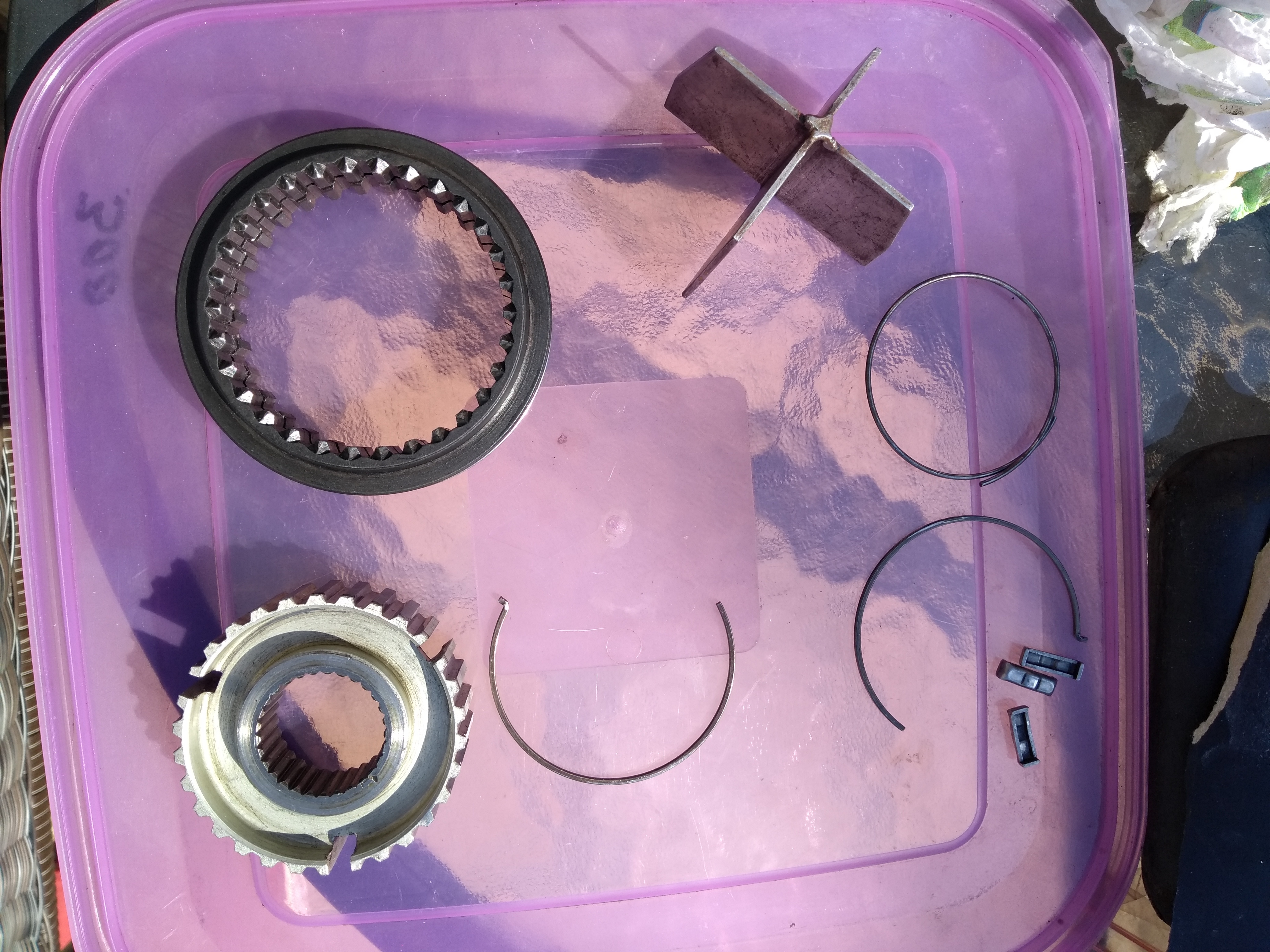

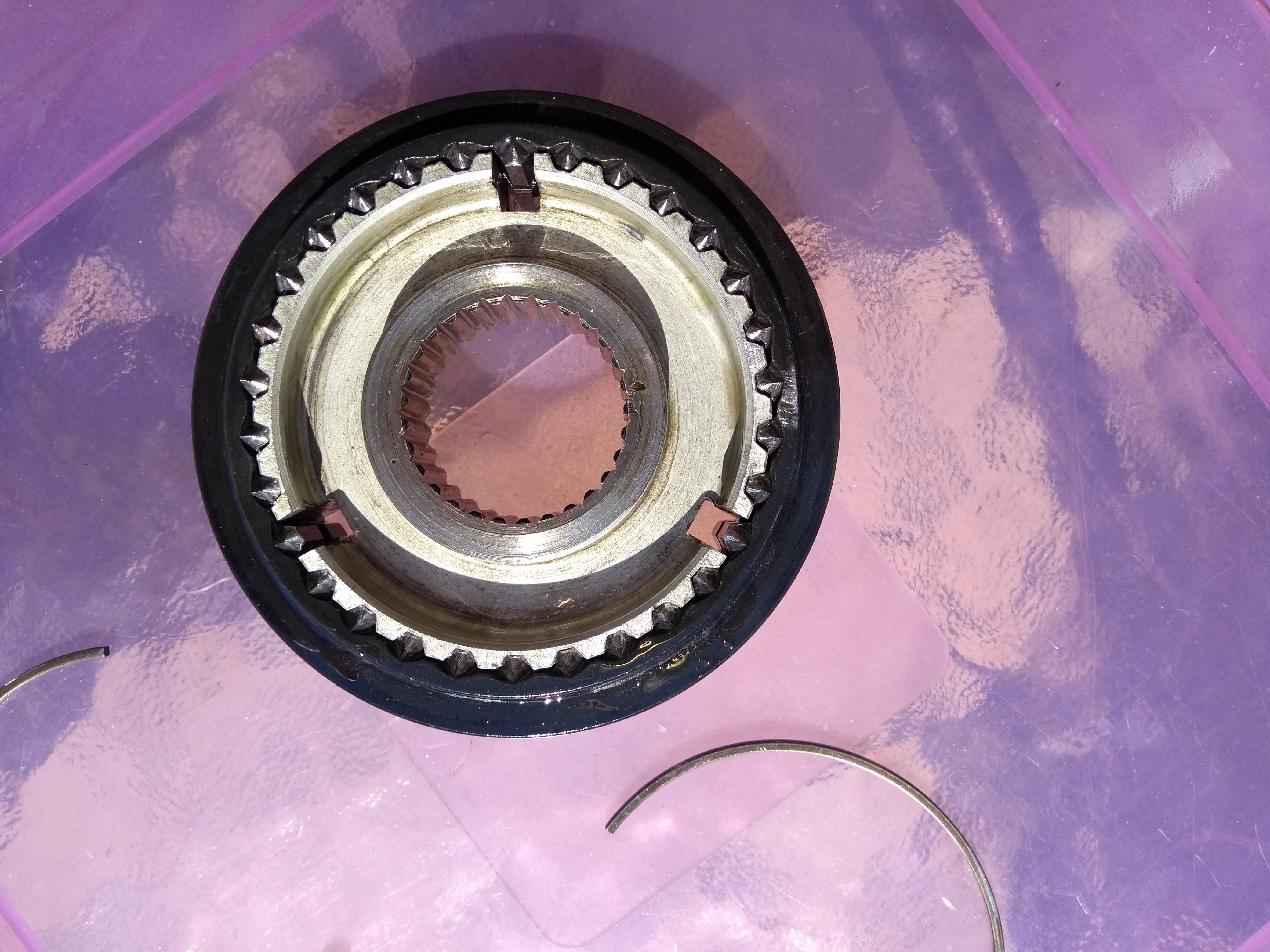

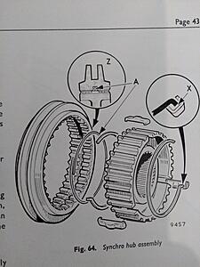

    Next is 1/2nd synchro hub but first it needs building back up and you need the tool as described in the manual to put the centre spring clip in Click image for larger version  Name:	IMG_20210419_115134118.jpg Views:	0 Size:	3.18 MB ID:	14490

      Put the spring clip in the middle and gentle push the tapered end through the ring gradually expanding it in to the groove position the ends of the spring in one of the smaller quadrants Click image for larger version

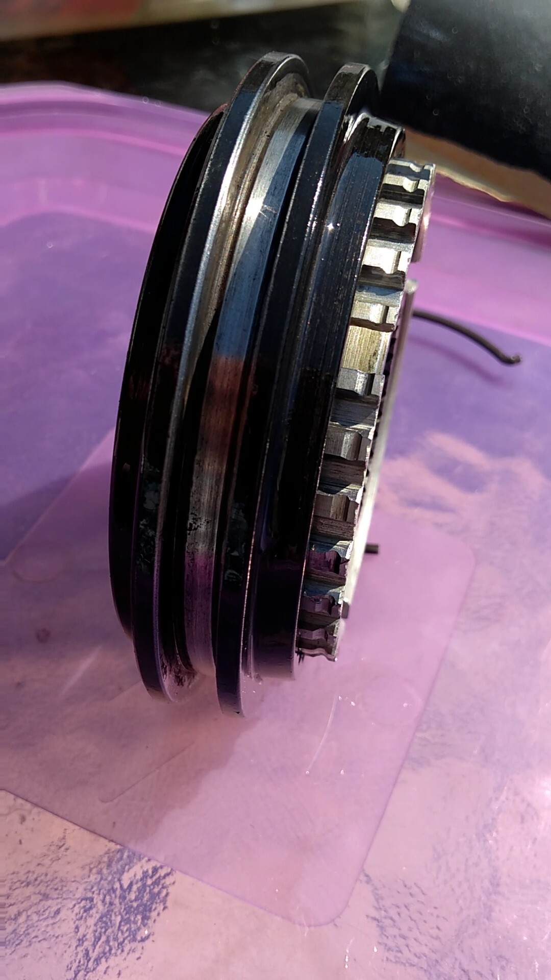

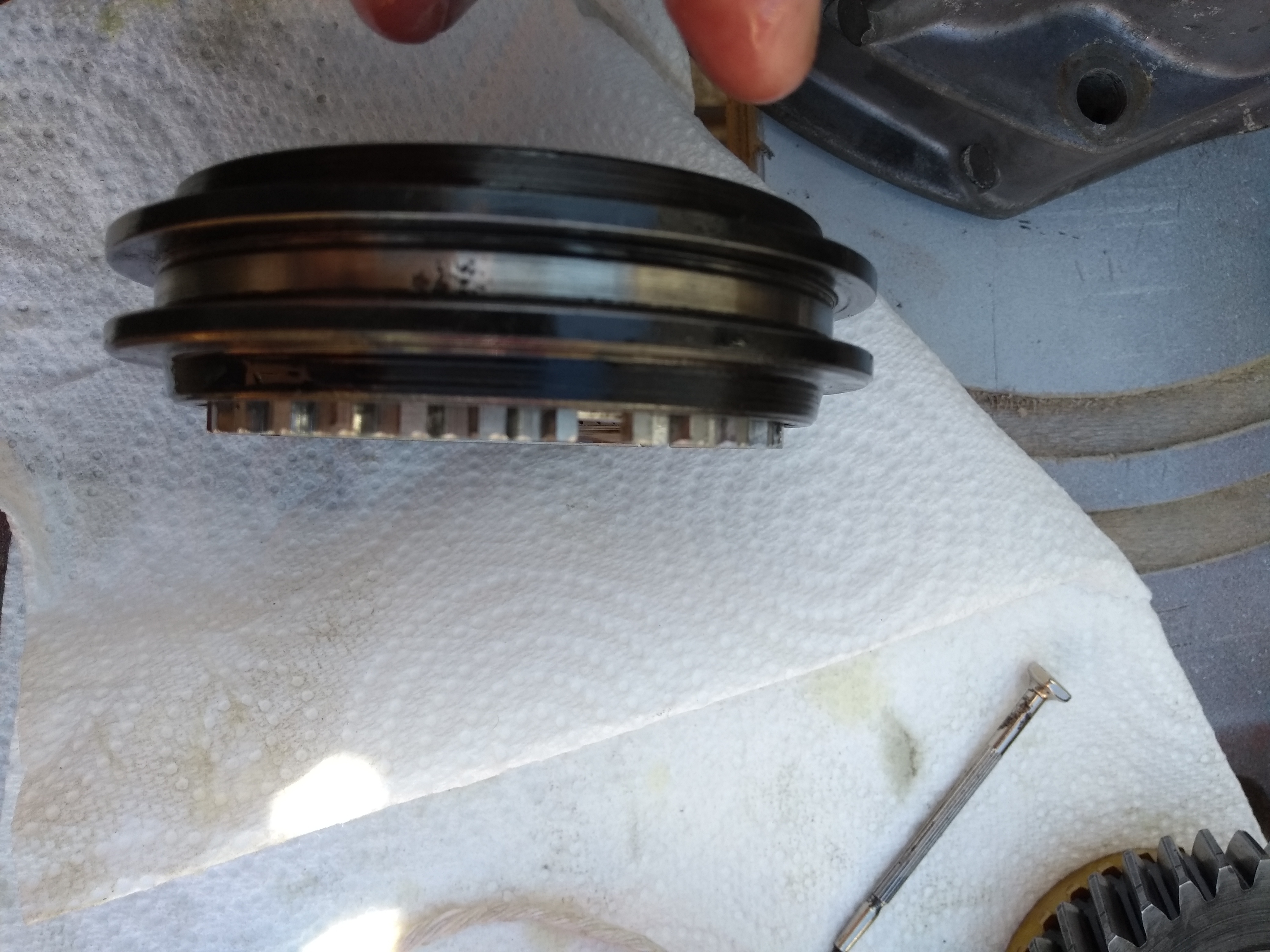

        Now place the centre on the table put the ring over the top and push through , you may need a small screwdriver just to push the ends of the clip in the groove .
        don't worry if it springs out one of mine went straight in the other was a pig Click image for larger version

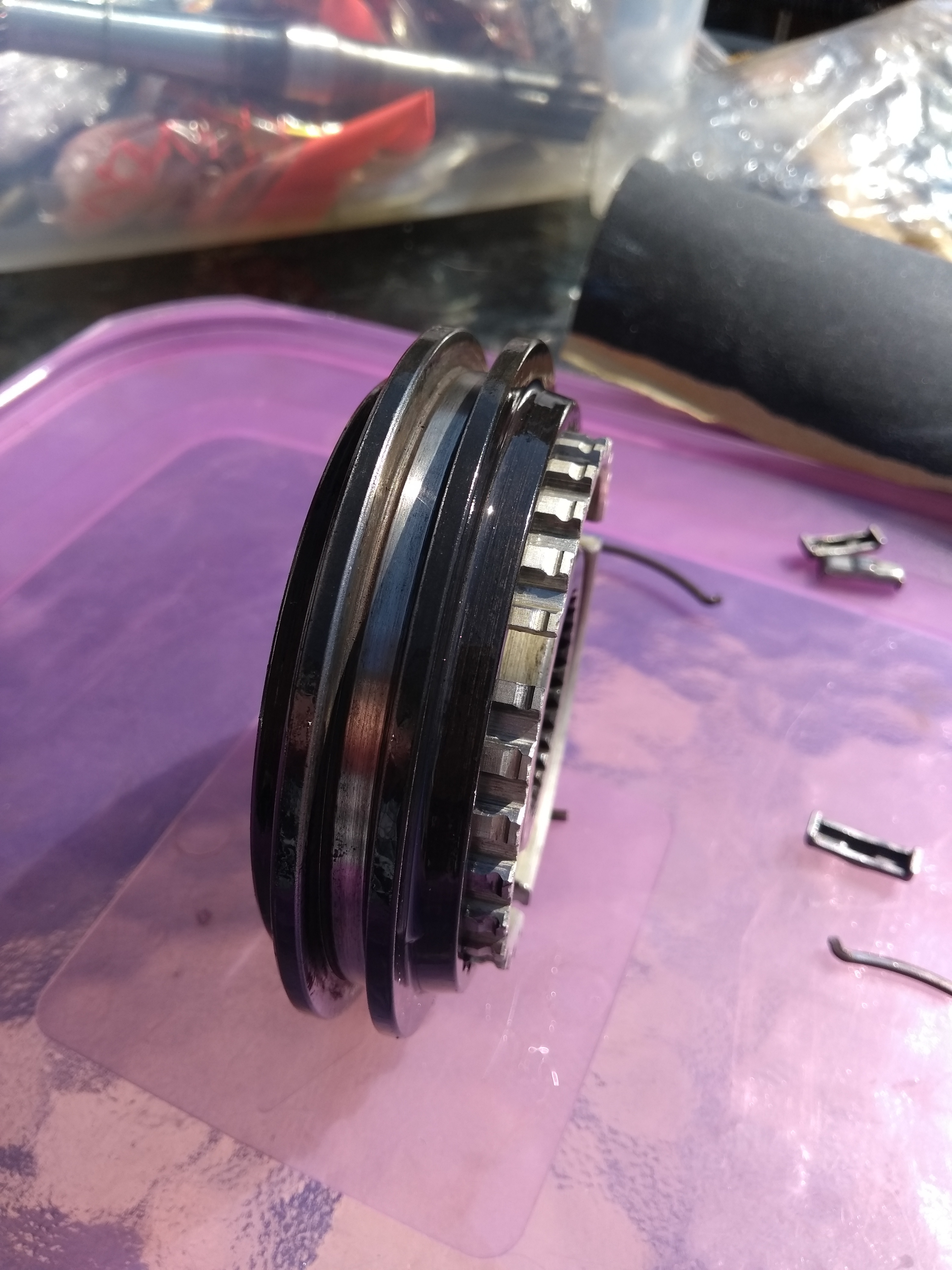

              Next you put back the 3 sliding keys unfortunately I forgot to take any pics but it's described well in the manual just make sure the bottom of the clips are not resting on the inside of the key I had to grind a little of mine if there are any marks on the OD of the clips stone smooth you can't get them new so you have to use what you've gotClick image for larger version  Name:	IMG_20210501_093108311.jpg Views:	0 Size:	3.40 MB ID:	14508

                They should now push through with a click as the middle ring drops into the outer groove then push back with the same pressure .
                Be careful with 1/2 sliding sleeve as it only has one outer groove and if you're not careful it will push straight through and the clip will spring out ? everybodys must have done it at sometime don't forget to oil as you go, not to much Click image for larger version  Name:	VID_20210419_121500450_exported_767~2.jpg Views:	0 Size:	265.8 KB ID:	14510 Click image for larger version  Name:	IMG_20210422_141745233.jpg Views:	0 Size:	2.46 MB ID:	14511

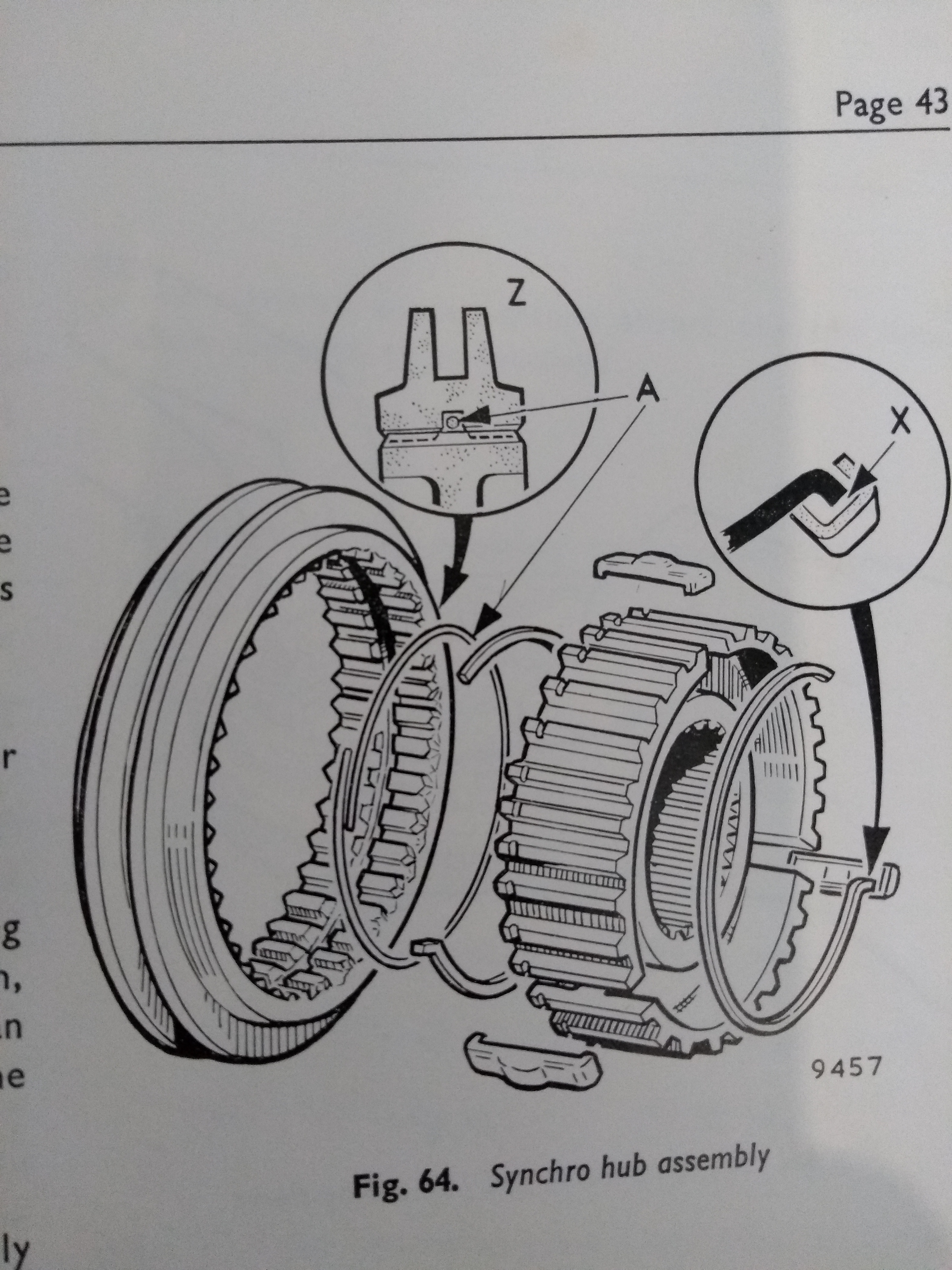

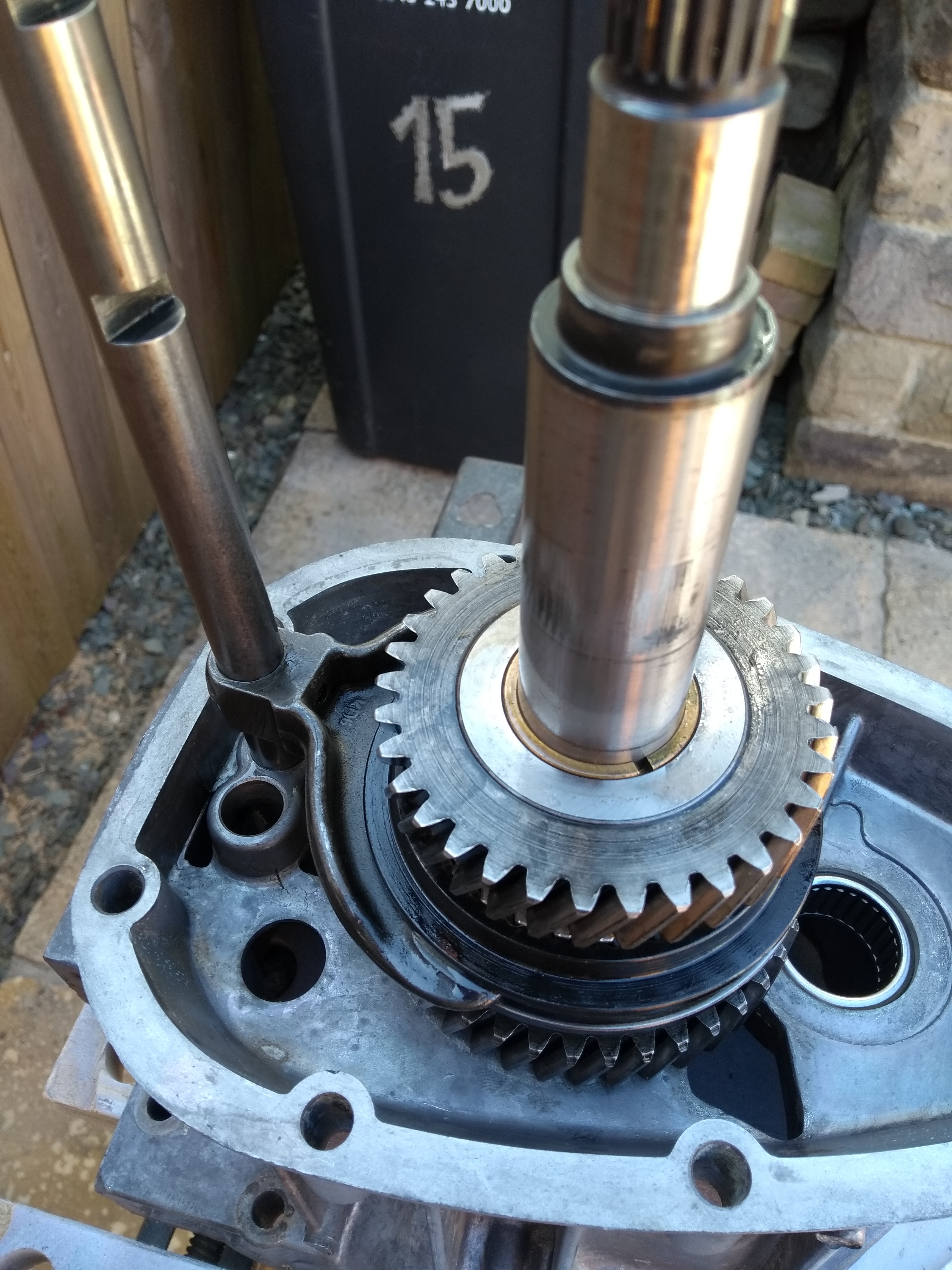

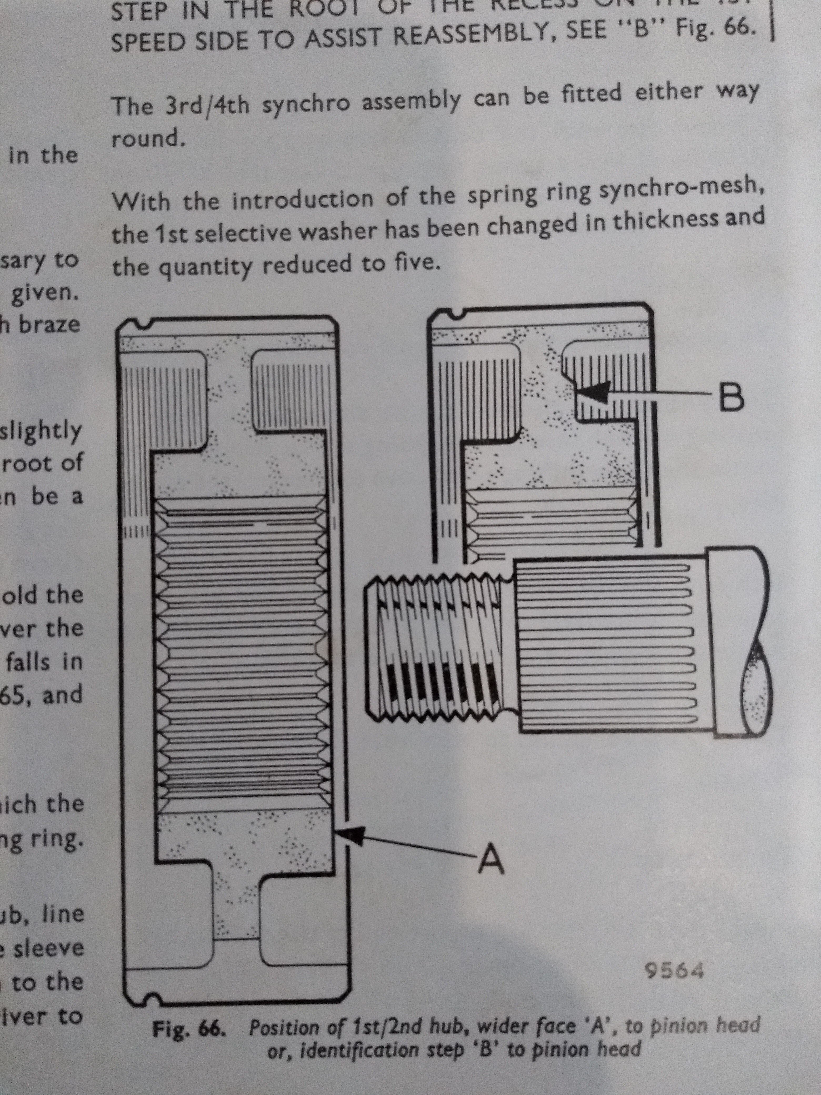

                  Slide on the shaft make sure the outer groove on the sliding sleeve faces away from the pinion head as per drawing in the manual at the same time fit the selector shaft Click image for larger version  Name:	IMG_20210422_144908407.jpg Views:	0 Size:	3.05 MB ID:	14515 Click image for larger version  Name:	IMG_20210501_093055734.jpg Views:	0 Size:	2.41 MB ID:	14514

                    The selector shaft lugs should measure.250" the groove in the synchro hub should measure .270" so check for wear

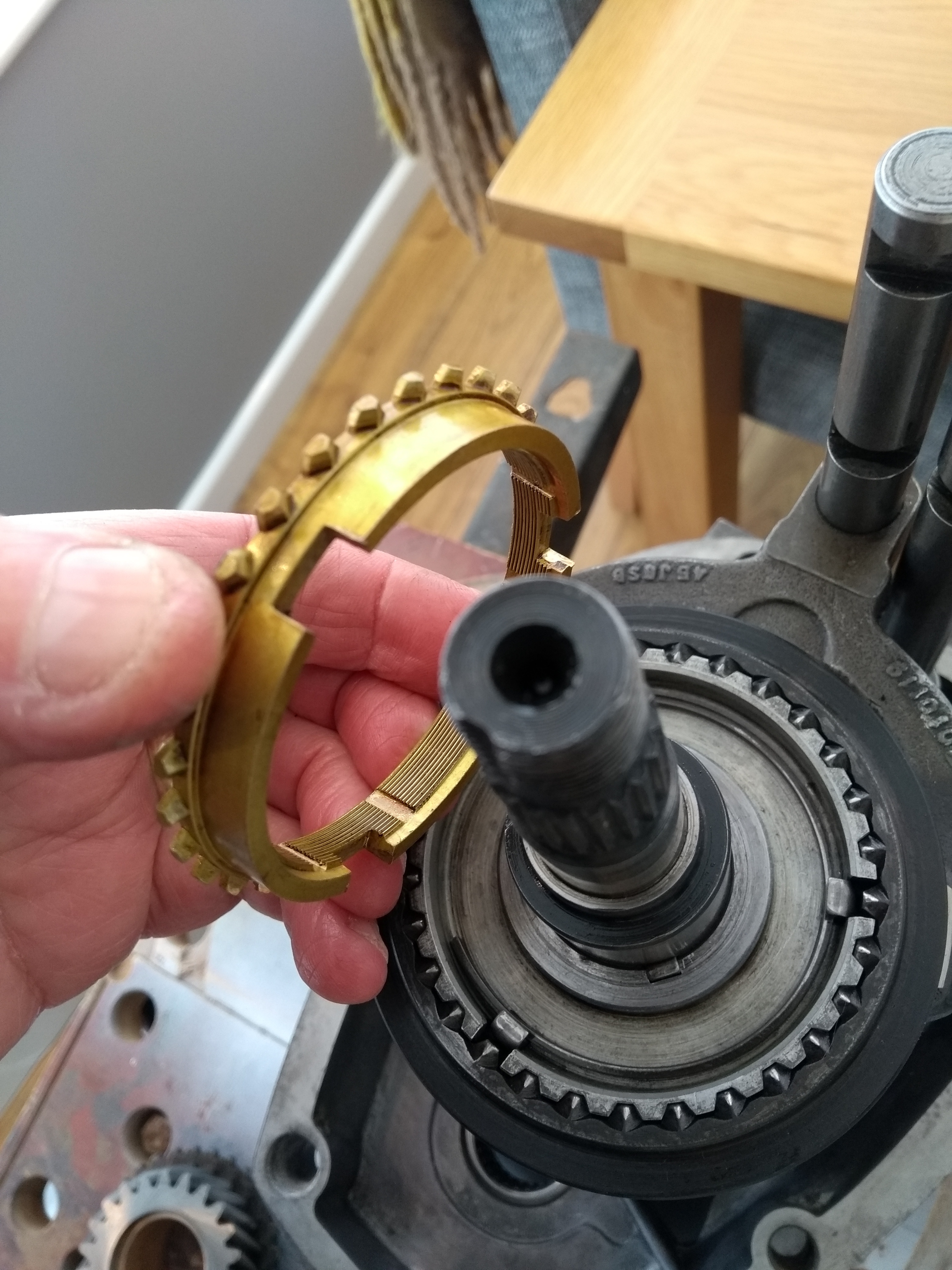

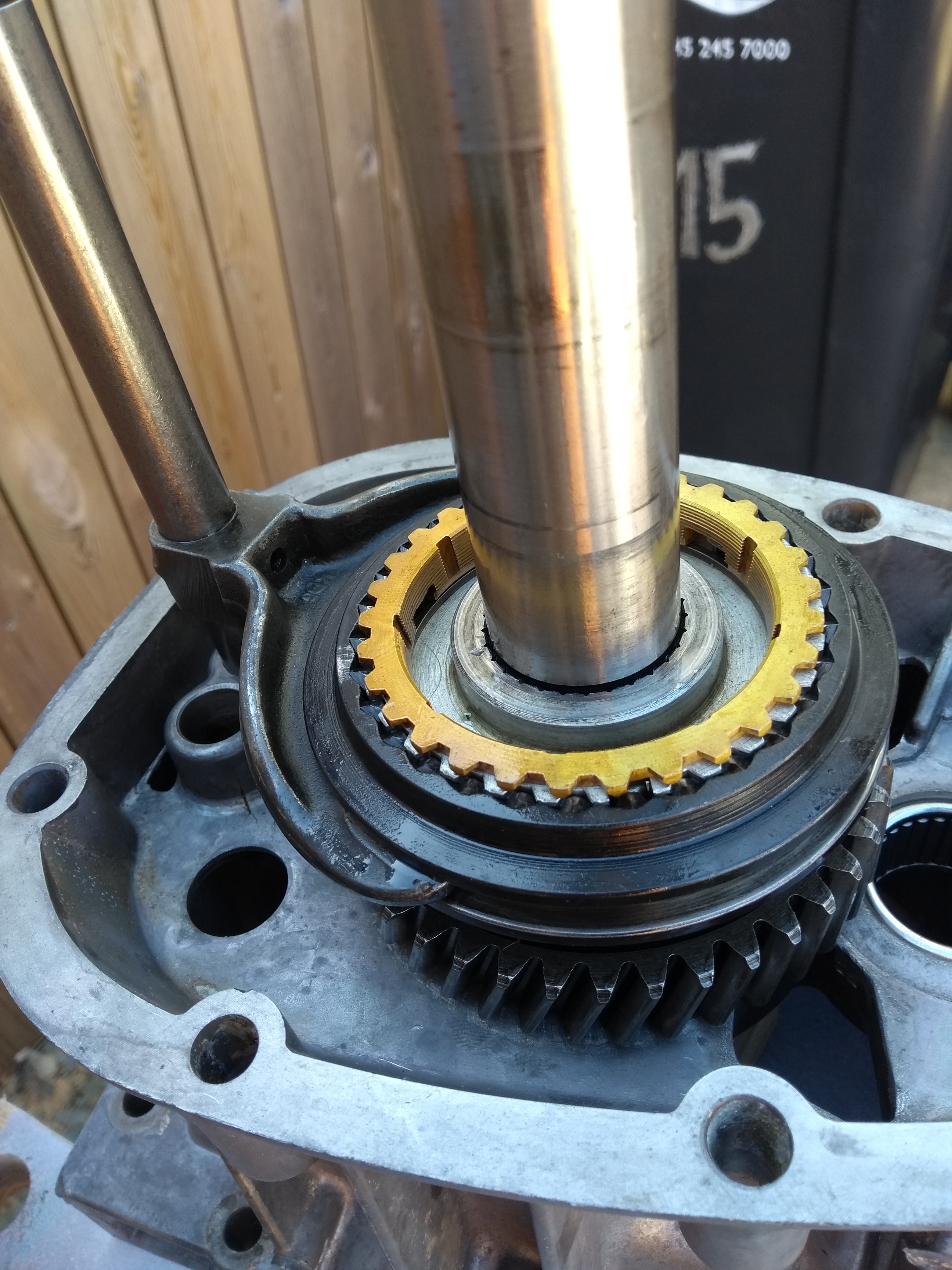

                      When you fit the bulk rings make sure the 3slots locates over the 3 keys

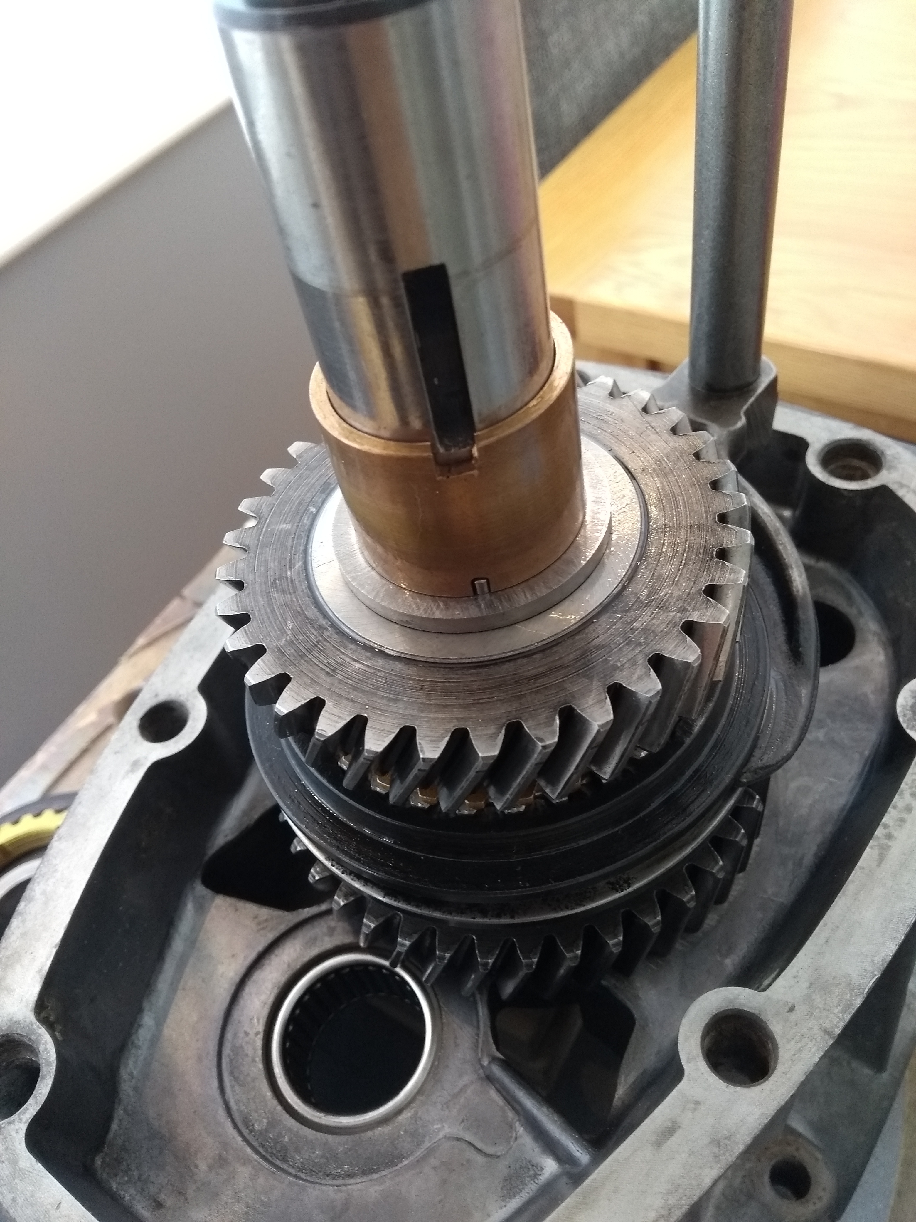

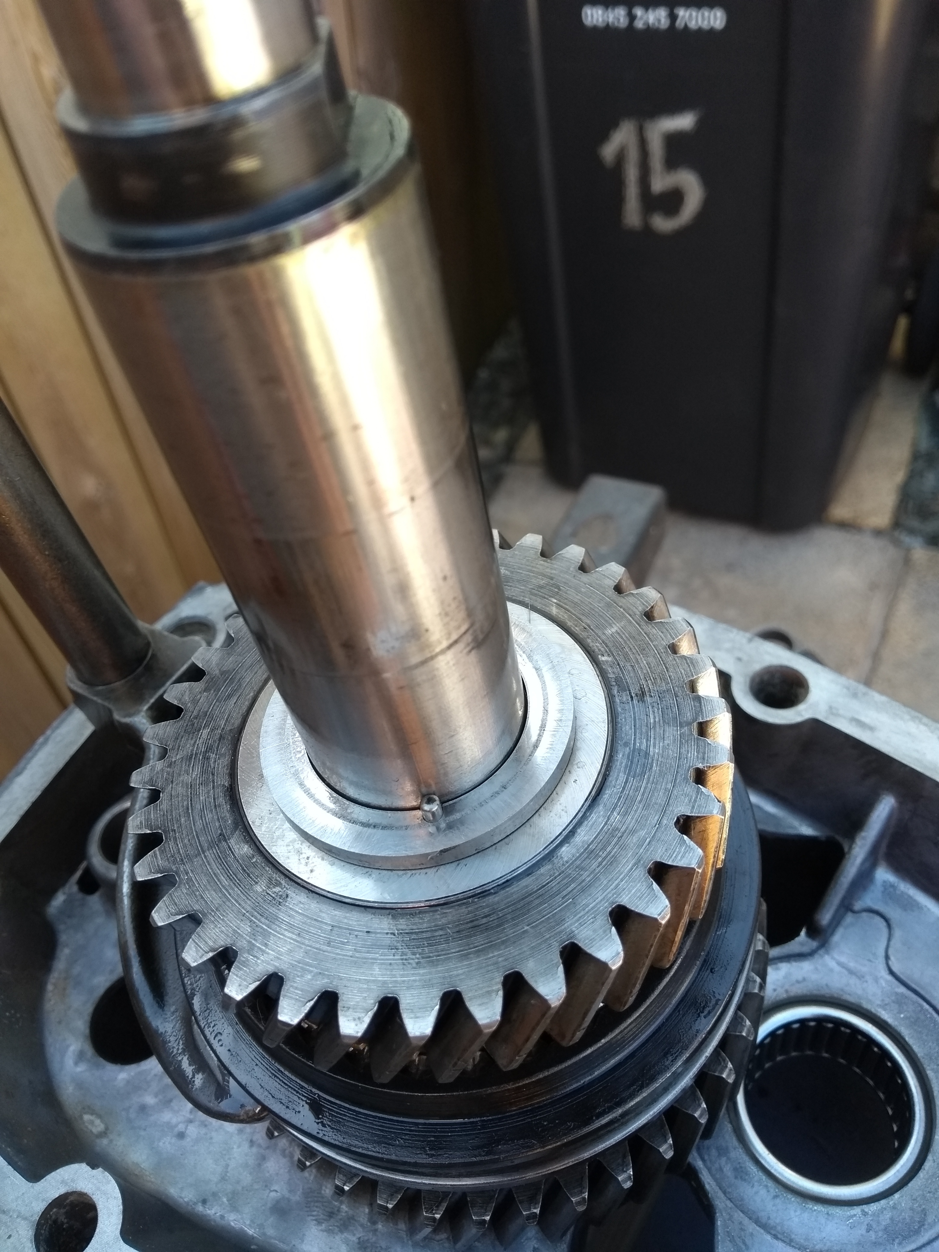

                        Next fit 2nd gear bush and gear plus a little oil Click image for larger version
ID:	14520 the one with two pin holes in

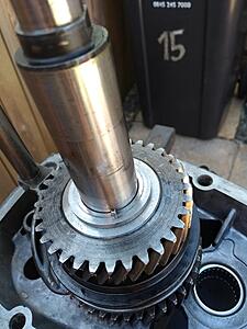

                          Fit the 2 pins and 2nd selective washer Click image for larger version

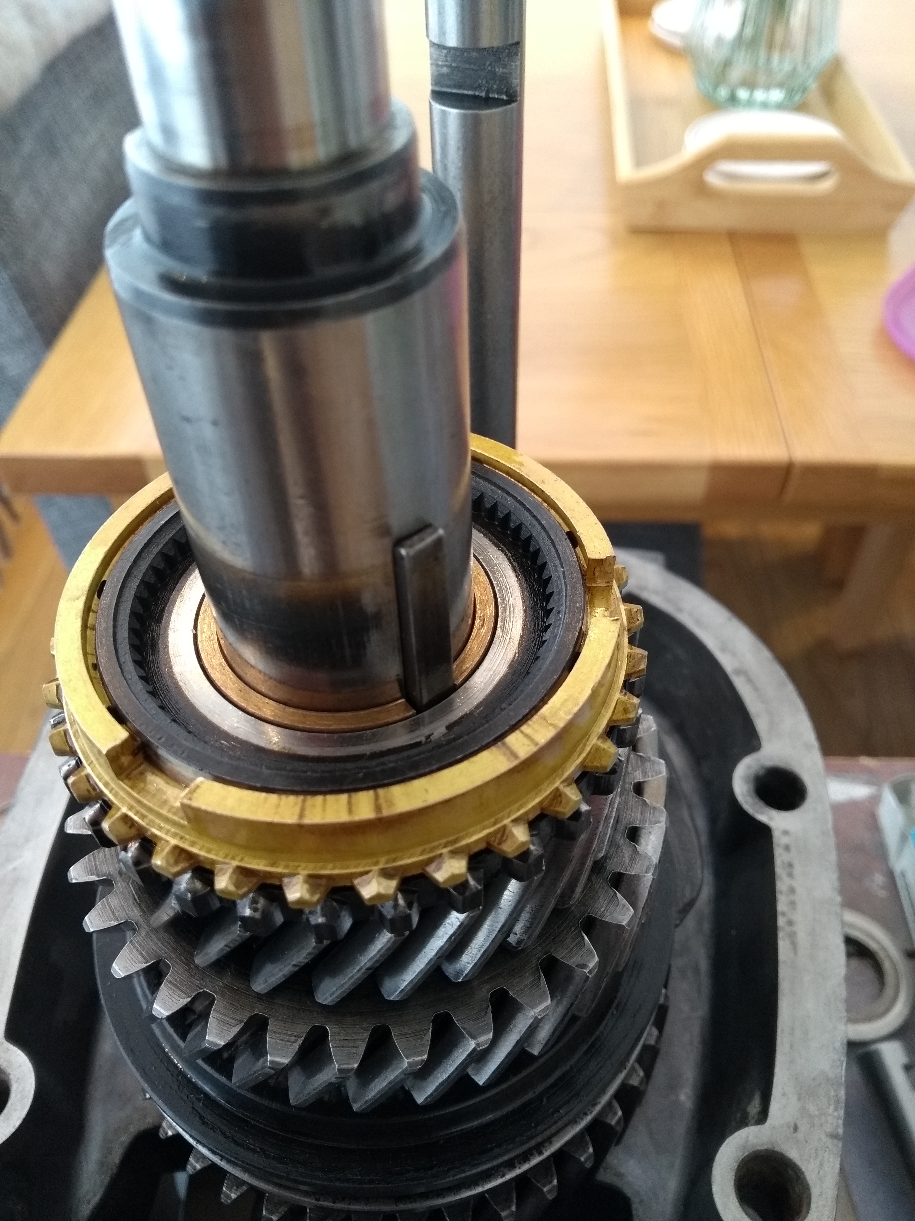

                                Now fit the 3/4th synchro hub with the selector fork make sure you locate the 3slots on the bulk ring over the keys Click image for larger version
