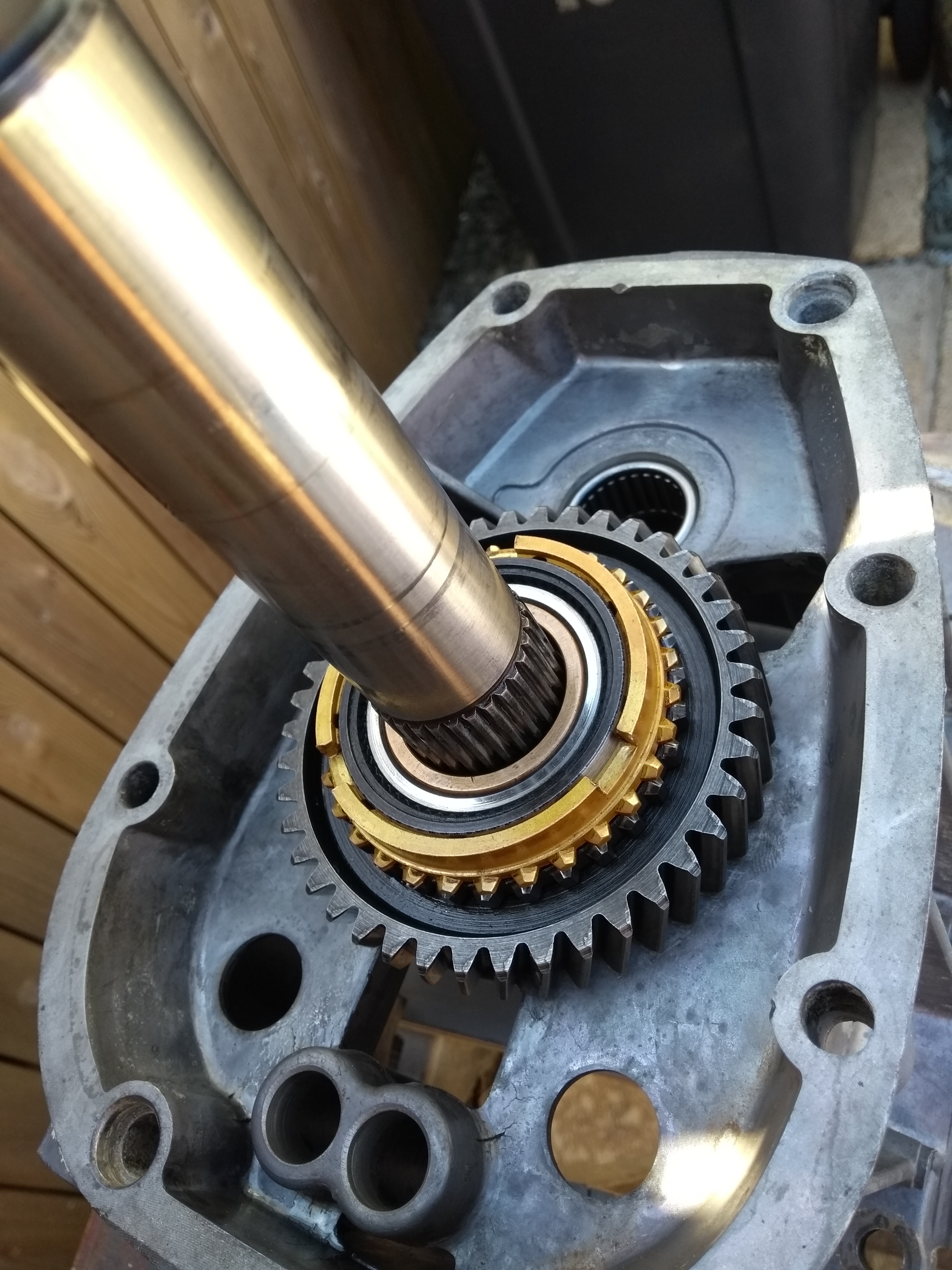

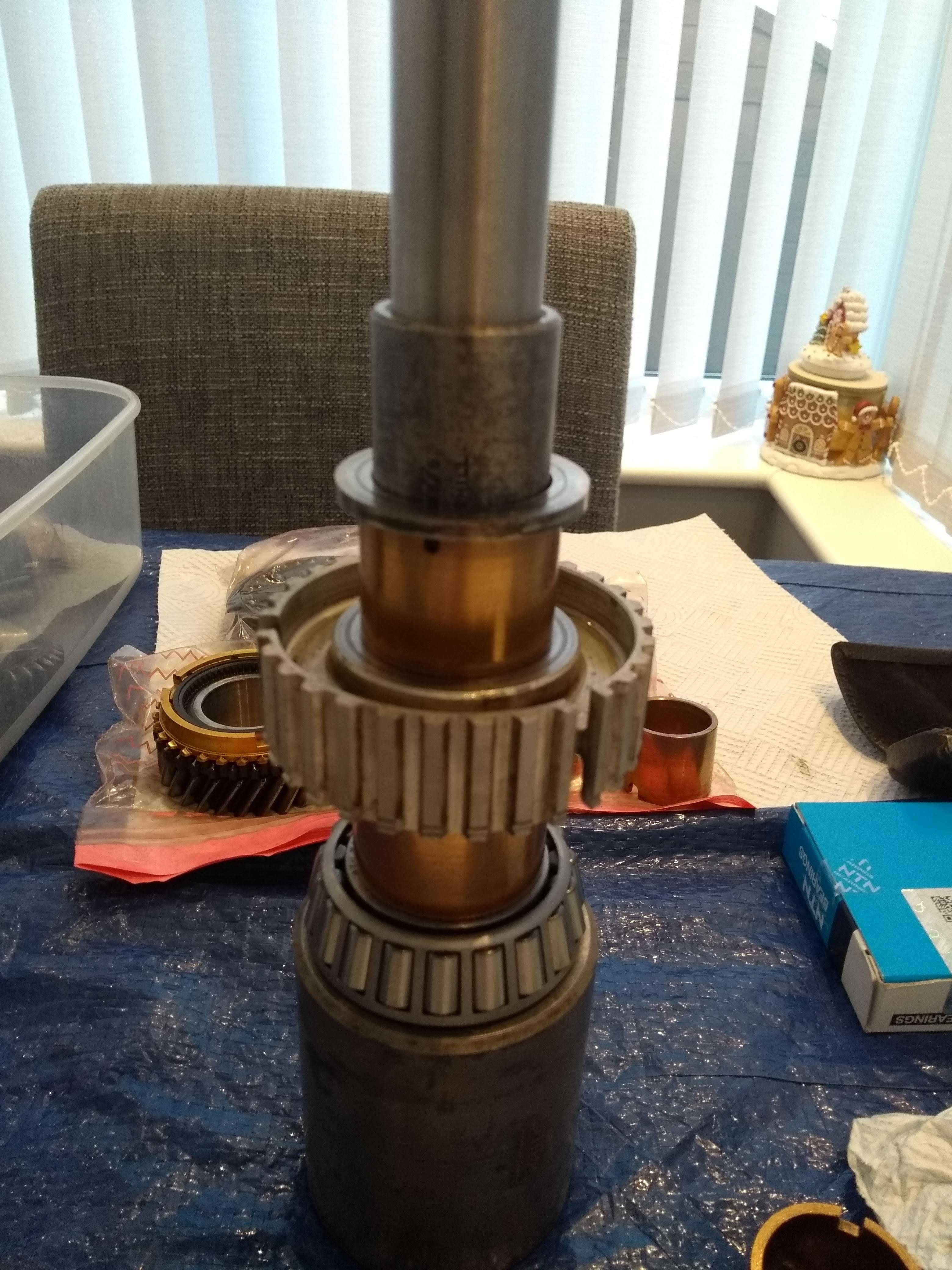

ID:	14463 Hi ok now to start building the main shaft because we are fitting new bearings we have to recheck the the selective washers am also fitting new bushes as mine were worn .
          In the pic's you will see old bushes as it's just to show how it's done ,this is a later box so no 3rd selective washer.
          We use pinion head tool again for this
          1st fit the bearing
          • Gary Whitaker
            aka Tiker
            • 15 April 2020
            #110

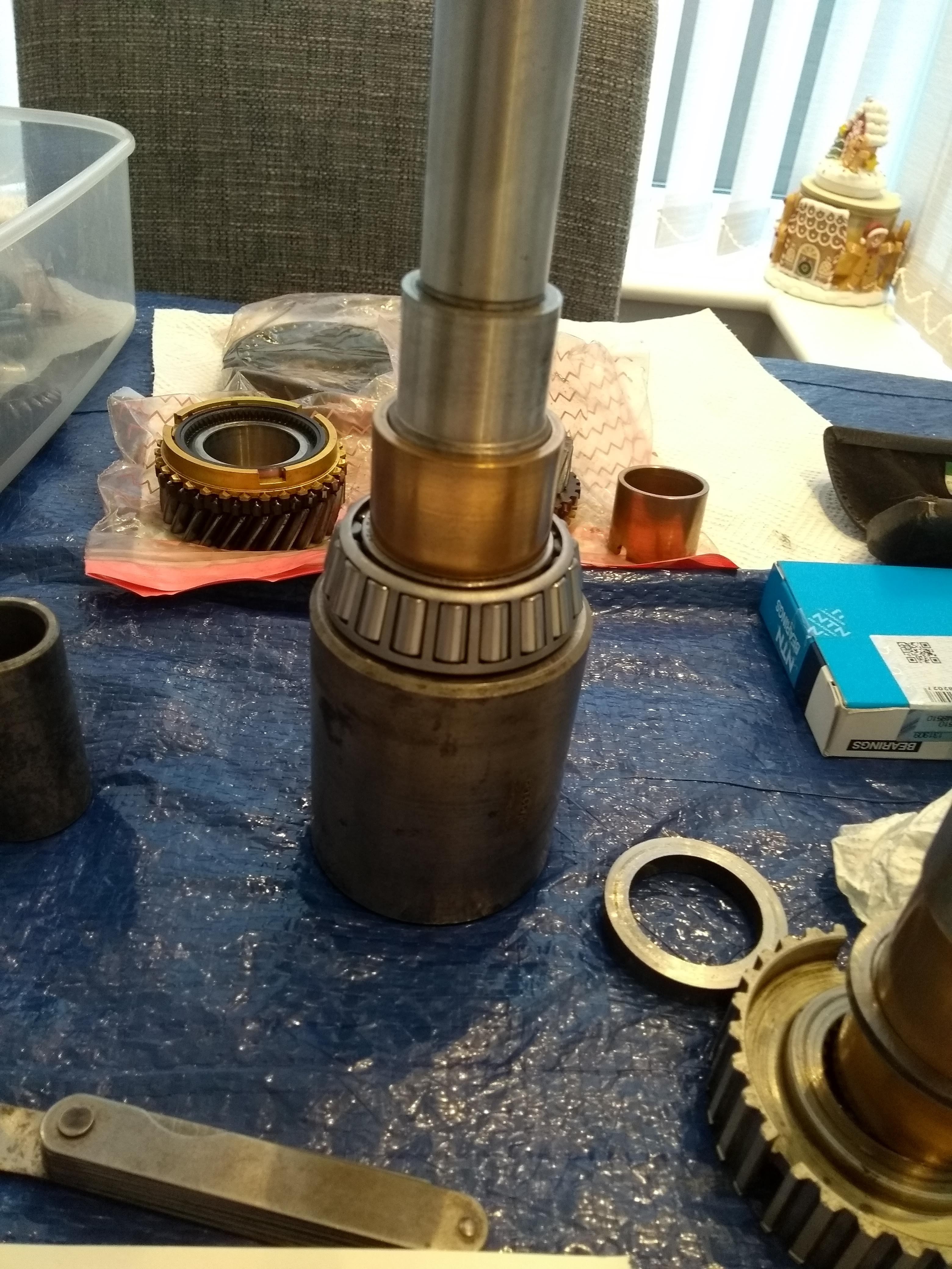

              Then 1st selective washer Click image for larger version

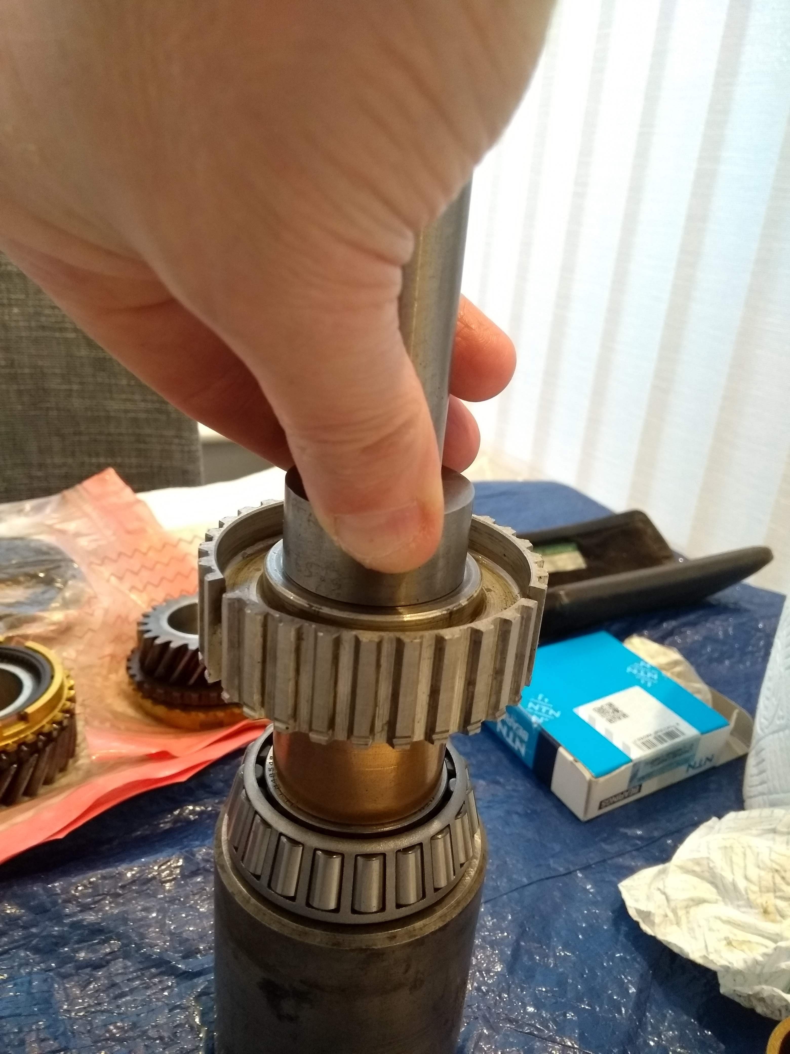

                Next is 1/2nd synchro hub this is the one that only has one groove in the outside diameter Click image for larger version  Name:	IMG_20201214_144934586.jpg Views:	10 Size:	902.2 KB ID:	14469

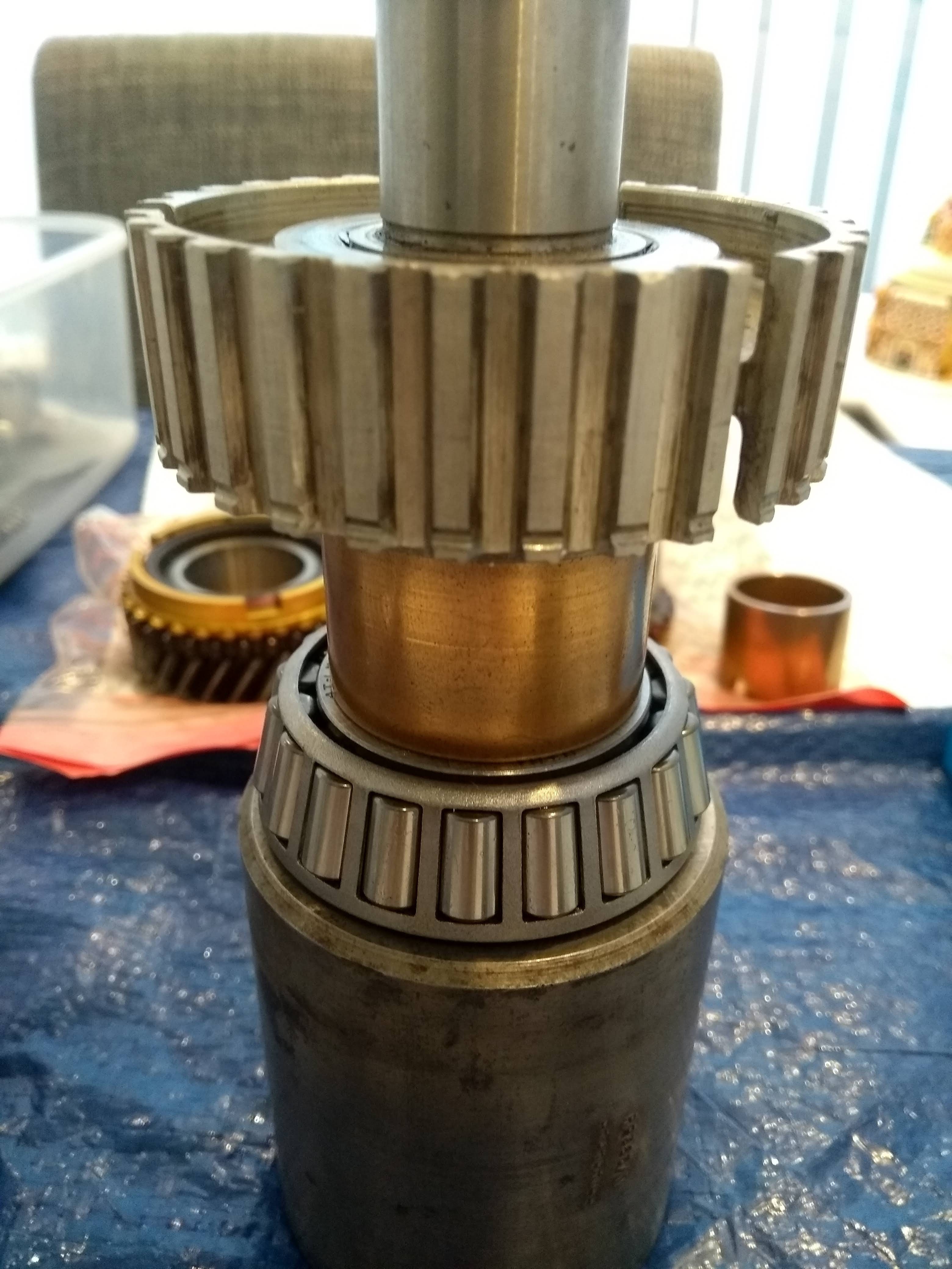

                  #113

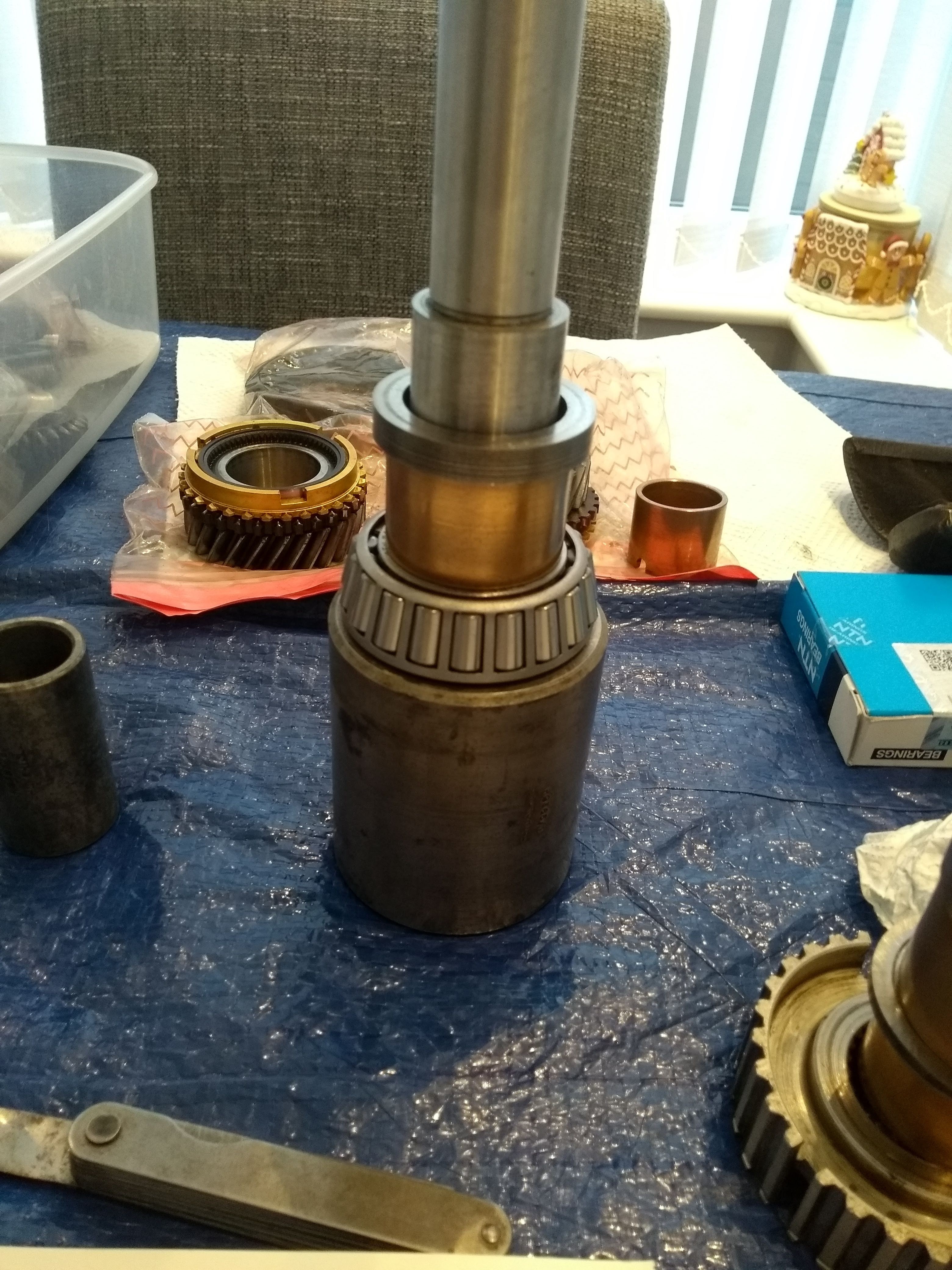

                  Now you have to use the spacer from the tool to push down and feel for end float ,change the 1st selective washer to just get a dragging feel Click image for larger version
                  • Gary Whitaker
                    aka Tiker
                    • 15 April 2020

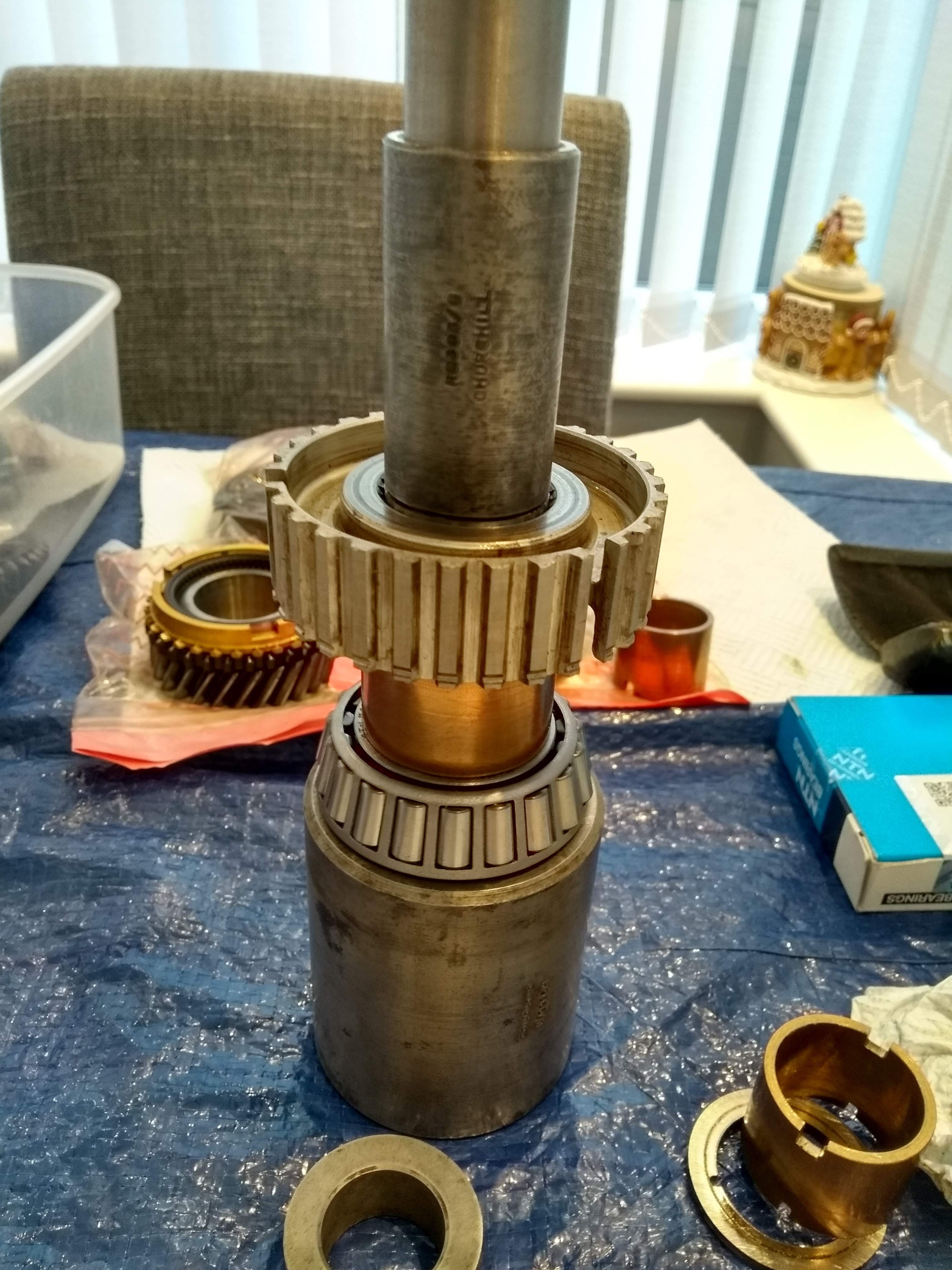

                    #114

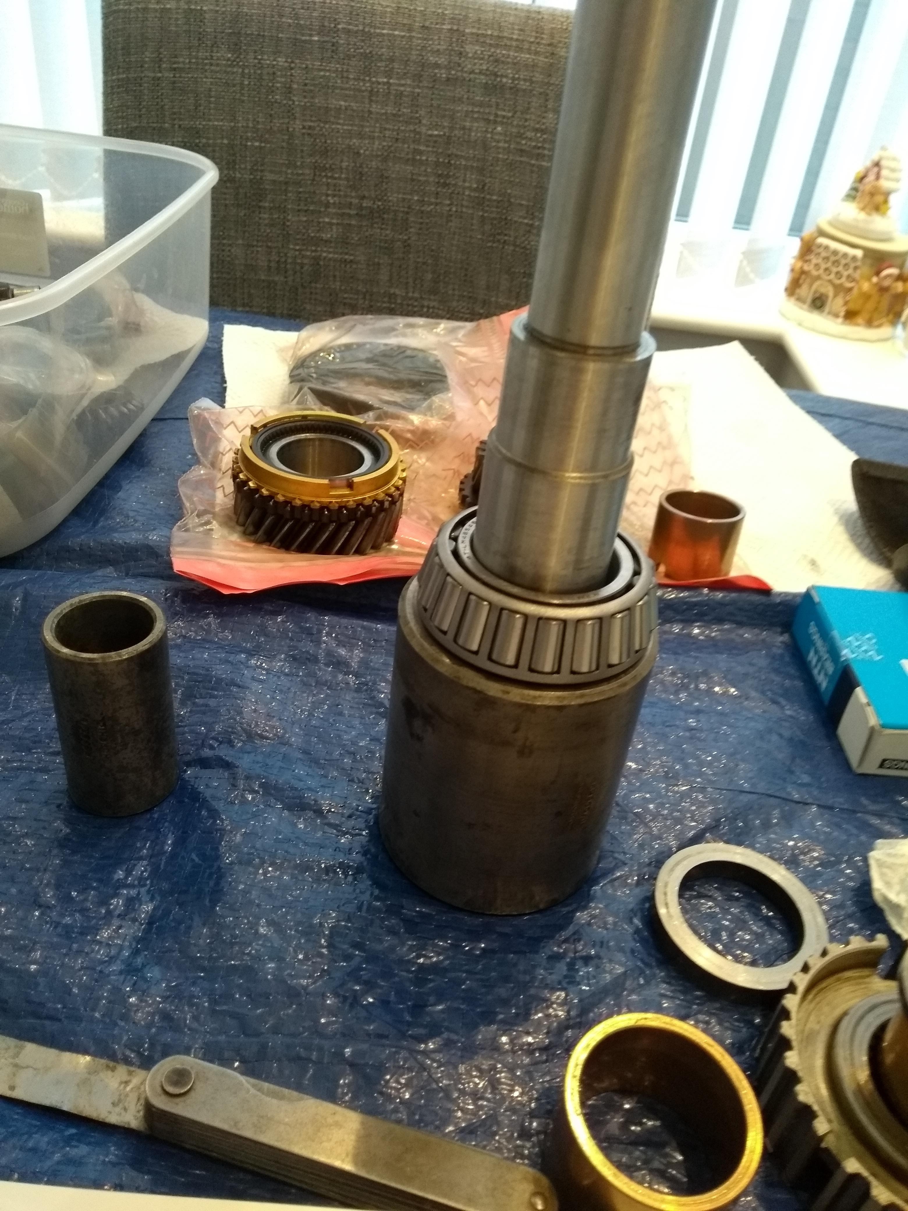

                    Now for second gear bush the one with the two small slots but it slides over a spacer tube again which comes with the pinion head tool Click image for larger version  Name:	IMG_20201214_145017698_HDR.jpg Views:	0 Size:	1.45 MB ID:	14474
                    • Gary Whitaker
                      aka Tiker
                      • 15 April 2020

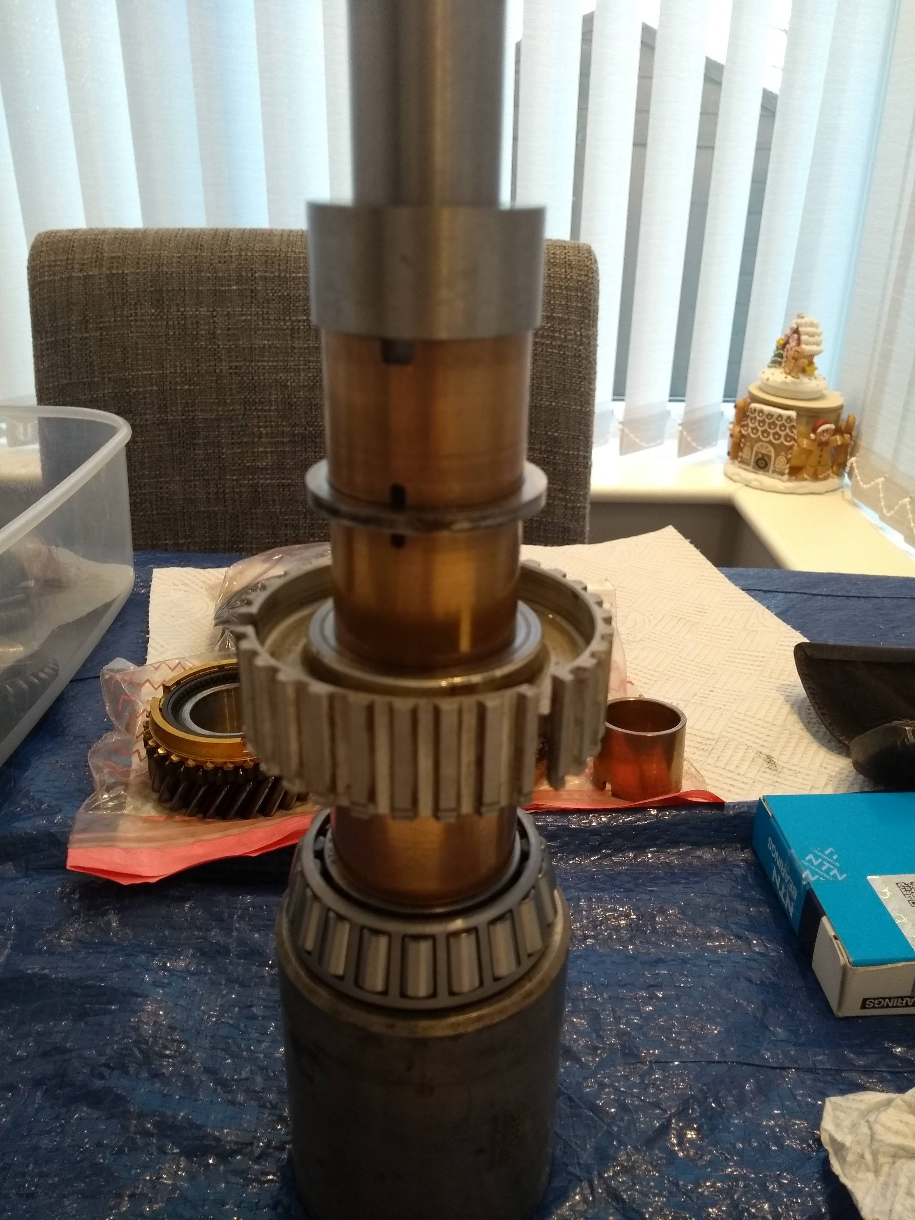

                      #115
                      Bush and selective washer the only one that has two pin holes in Click image for larger version  Name:	IMG_20201214_145059954.jpg Views:	0 Size:	1.36 MB ID:	14476
                      • Gary Whitaker
                        aka Tiker
                        • 15 April 2020
                        #116
ID:	14479 Next 3rd gear bush and the spacer pushing down to check endfloat select a thicker or thinner spacer to get the dragging feel

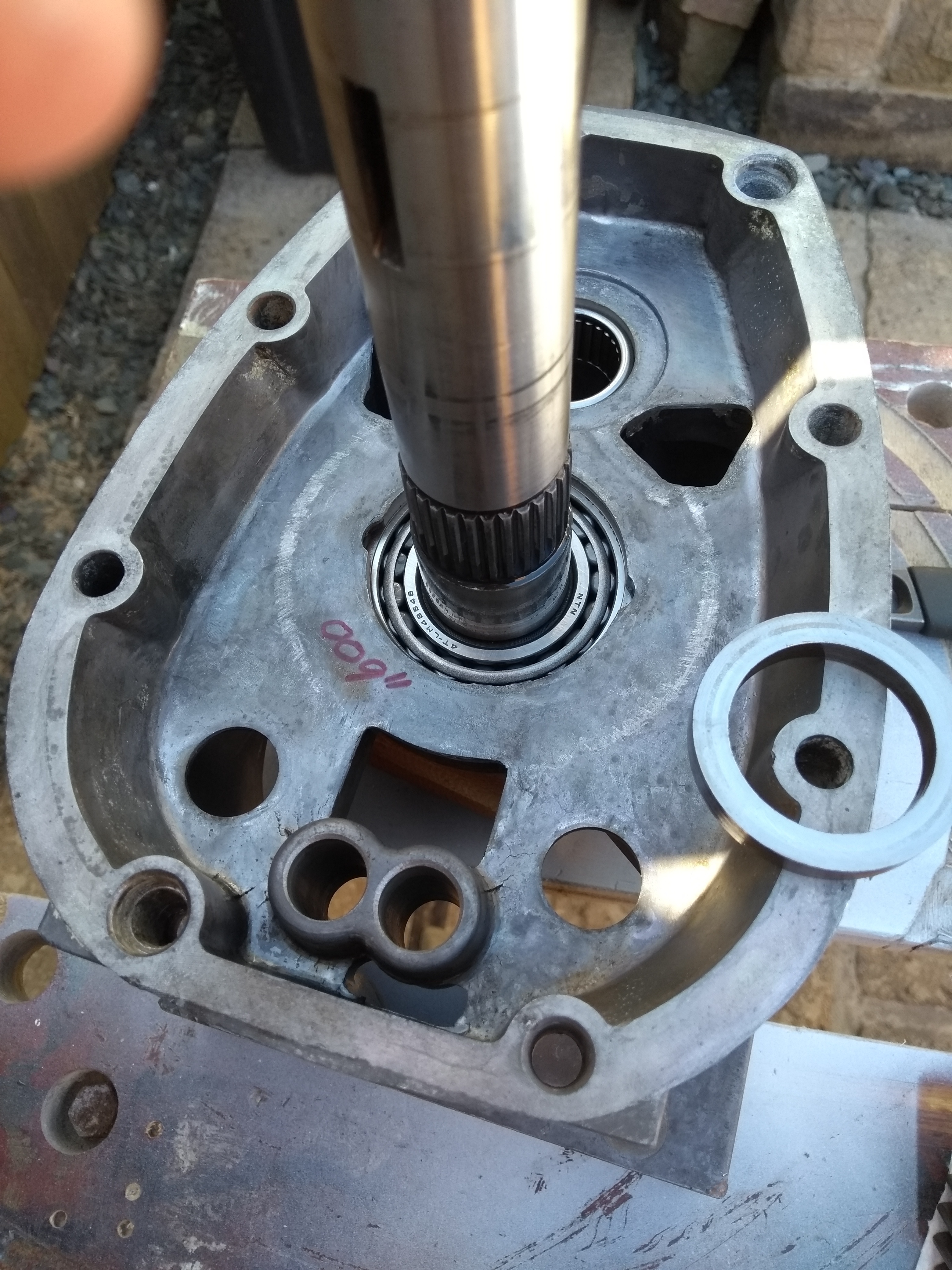

                          #117
                          Now you have the bushes and spacer selected .
                          4th selective washer is done on assembly which is next you can now fit the bearing to the pinion head
                          Put a bit of oil on fit it in the casting standing on a 2" block of wood so yo can rotate the casing Click image for larger version

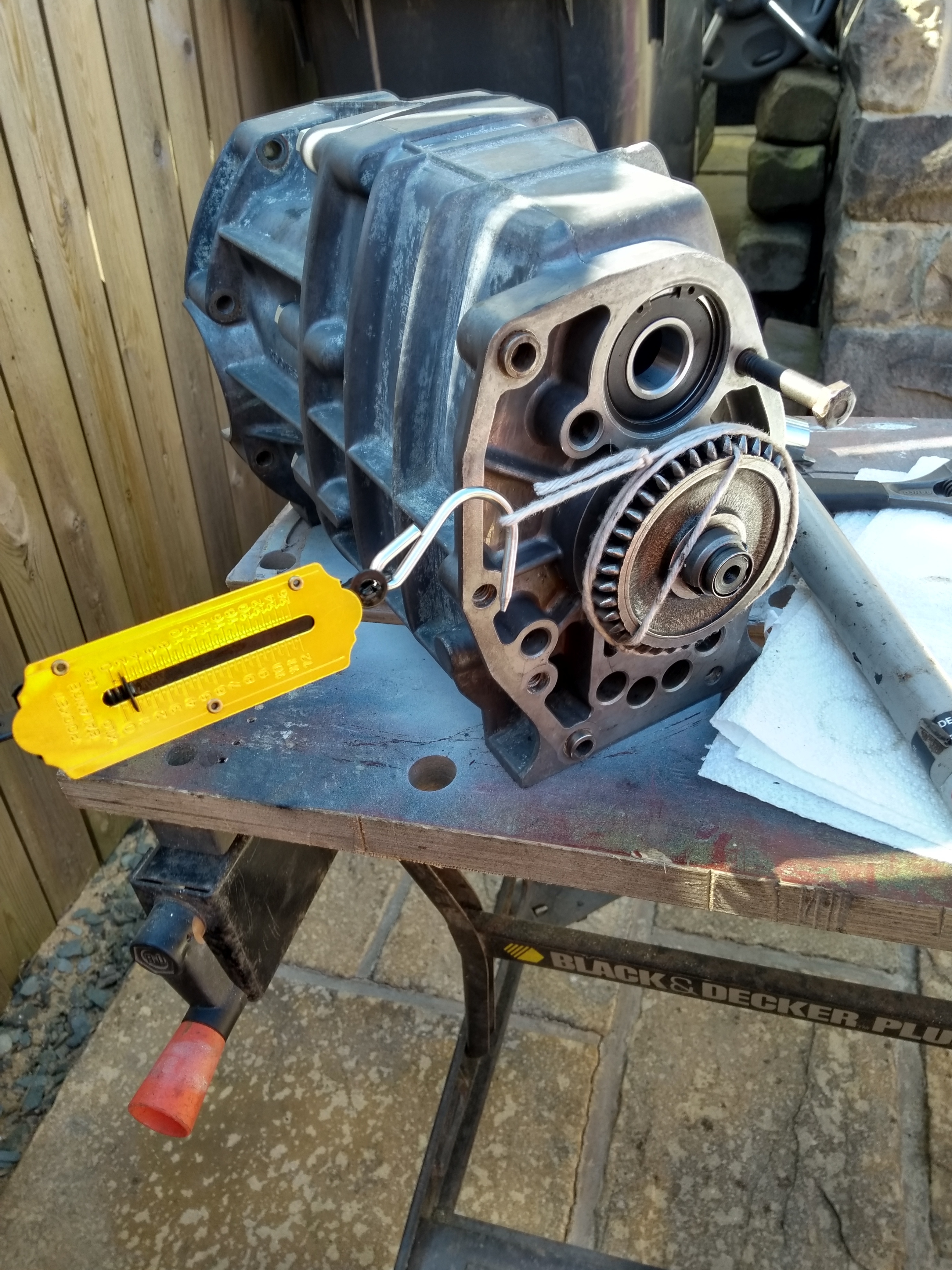

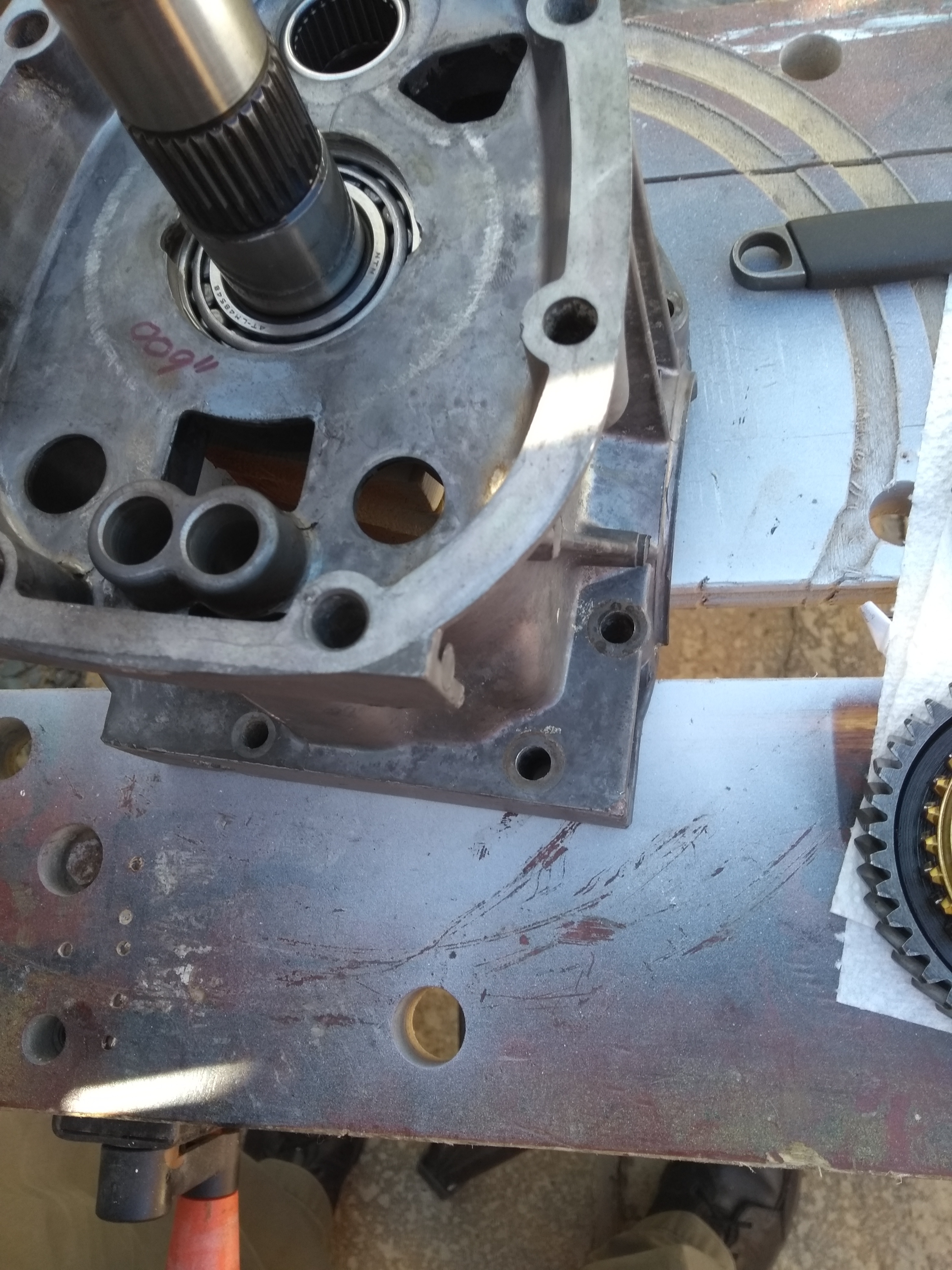

                            #118

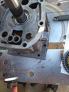

                            Now with the casting empty fit the next casting and tighten fully fit the thickest preload washer and tighten in stages as it says in the manual use reverse gear and a bolt to lock the pinionClick image for larger version  Name:	IMG_20210422_132840694_HDR.jpg Views:	0 Size:	2.71 MB ID:	14483
                            • Gary Whitaker
                              aka Tiker
                              • 15 April 2020
                              #119

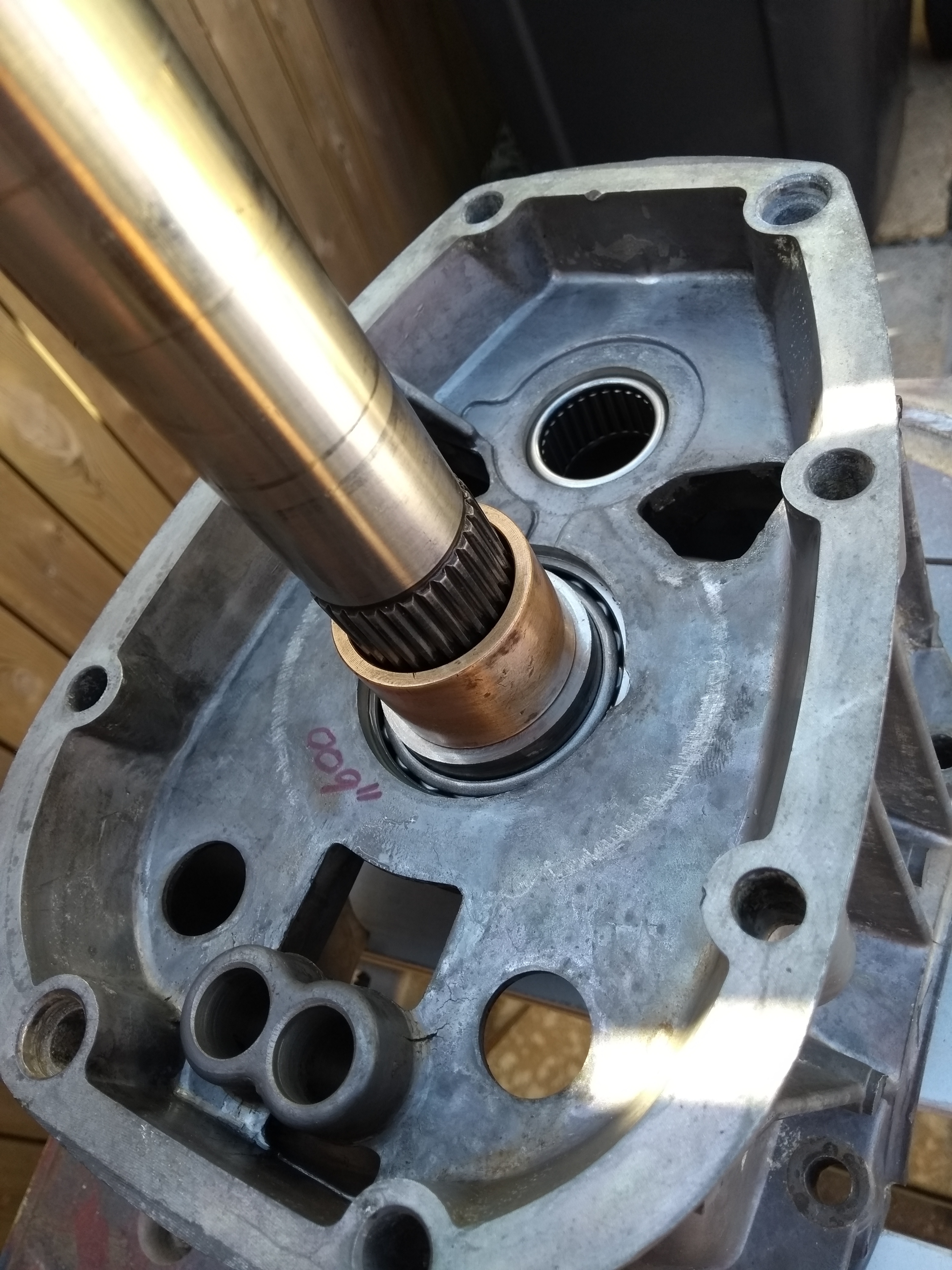

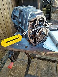

                              Now check the preload as per your manual for new bearings 6 to 12lb.
                              if you've never done it before it feels very tight to turn but you need it for the rigidity of the box and it will drop once you've covered a few miles .
                              A new gearbox needs running in just like an engine mine came out at 10lb I had to go.004" thinner than the original shim .If you remember the rear pinion bearing housing had no shims and the manual said I had to make it up to .032" that would have brought it out of tolerance for the shims to correct ,so they must have had problems holding size at the factory . conclusion is if you change the rear pinion bearing put back the same shims you took out.
                              Click image for larger version  Name:	IMG_20210422_133000051_HDR.jpg Views:	0 Size:	3.08 MB ID:	14485

                                #120
                                Click image for larger version  Name:	IMG_20210422_134017927.jpg Views:	6 Size:	3.23 MB ID:	14487Now you have your preload shim sorted you can build the box put the pinion head on a block as before and start with the 1st shim and bearing then 1st gear Click image for larger version
ID:	14512 Click image for larger version  Name:	IMG_20210422_134039913.jpg Views:	3 Size:	2.88 MB ID:	14488
