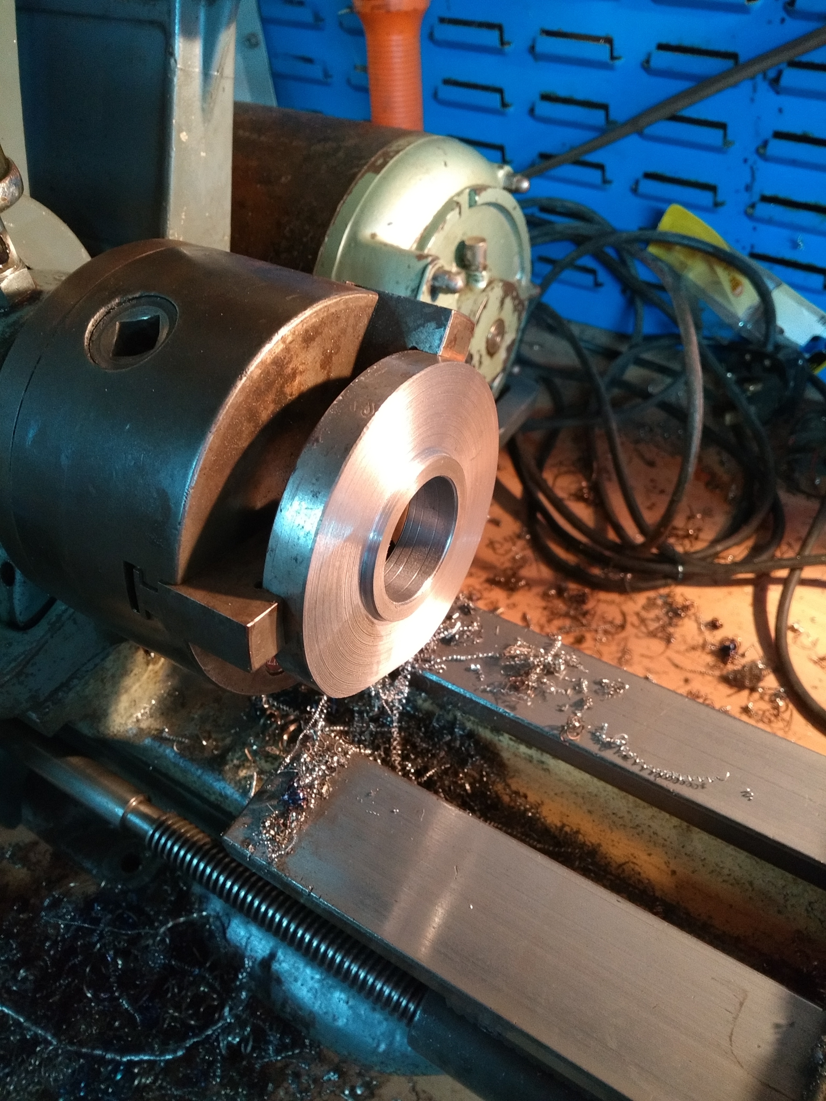

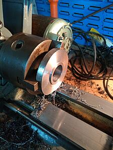

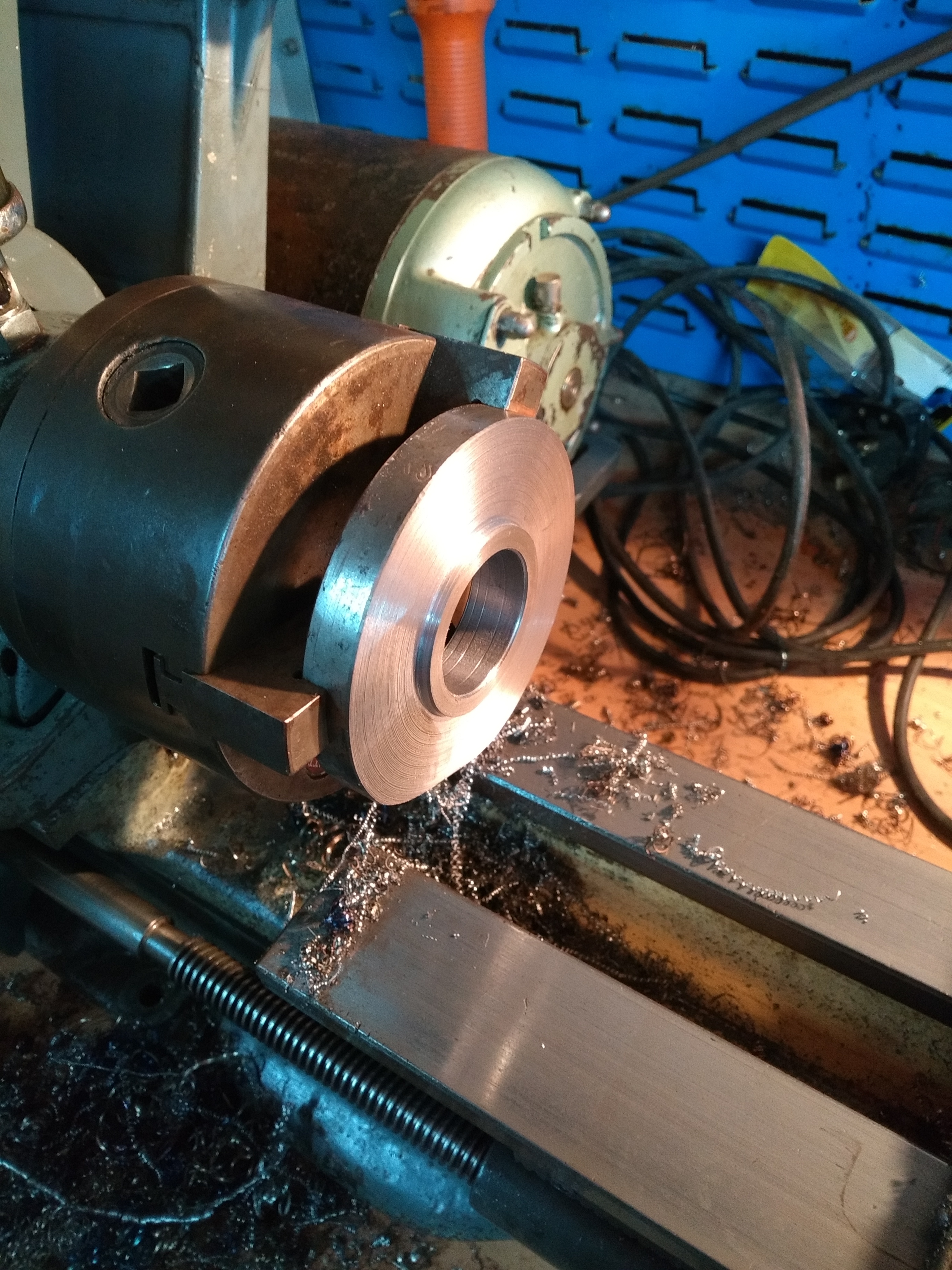

                              Hi got down the workshop today and started to make RG 363 differential small and large bearing replacer and pinion head bearing seat.
                              when I first saw this I didn't realize what it did and you don't really need it you could use a spacer but I could make it so why not.
                              It's purpose is to rest the inner bearing seat ready for pressing on the pinion shaft or the diff as they are the same size.The opposite side is just the same only slightly smaller in diameter the aim is to do it without damaging the bearing cage.
                              Very simple tool, handy but not really necessary.
                              Best regards Gary
