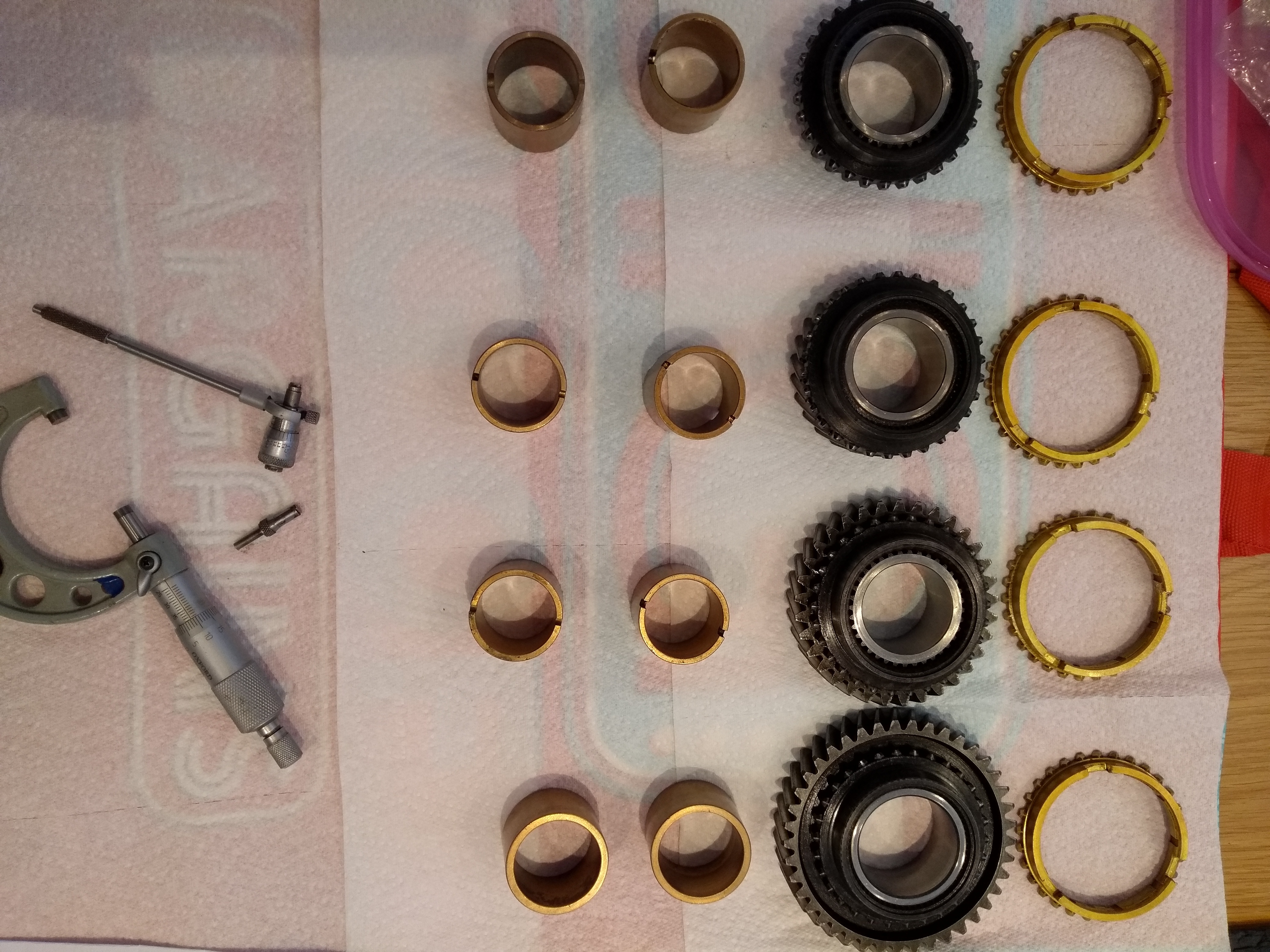

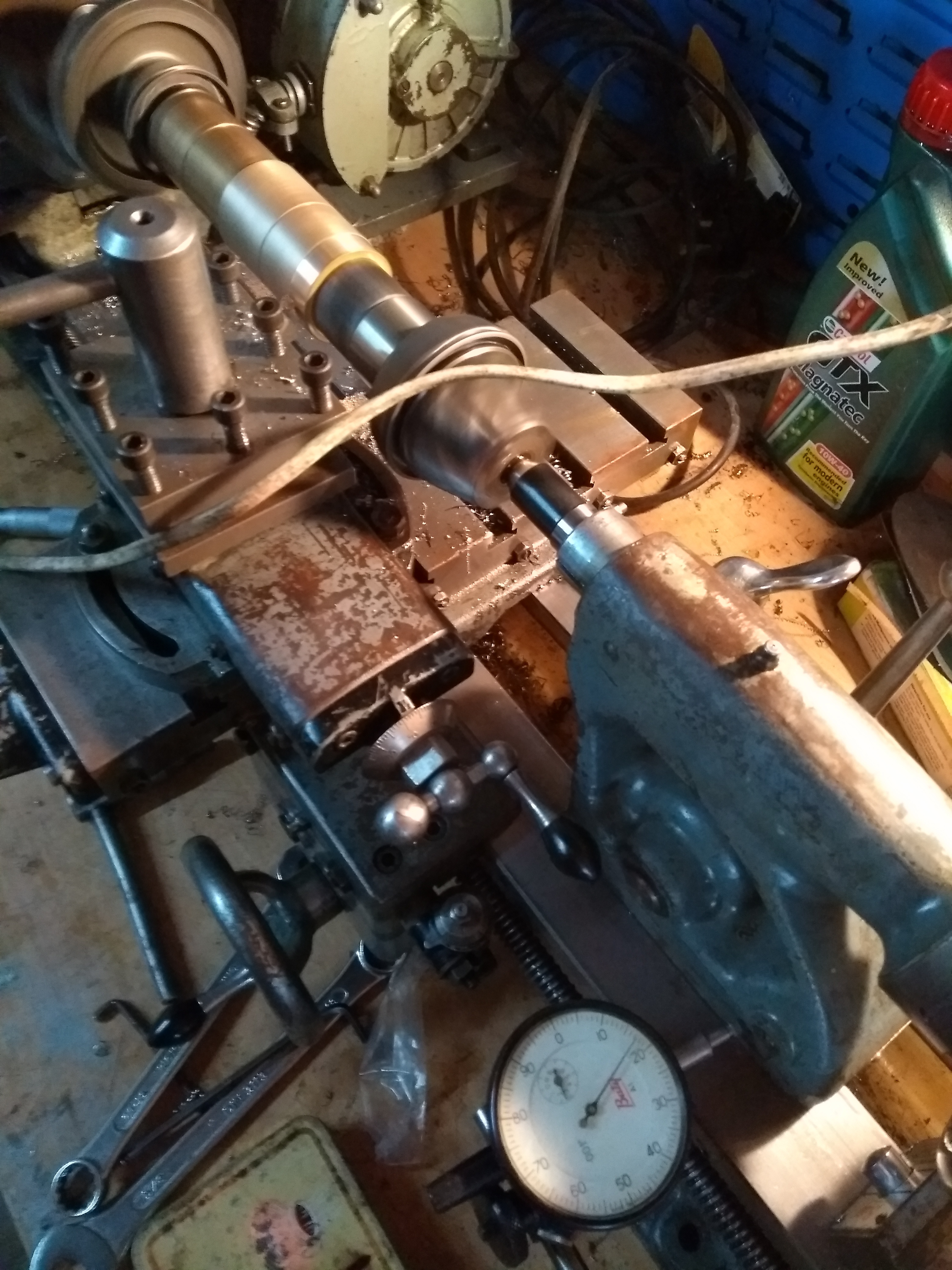

          The pinion shaft gears all run on oilite bushes and when I stripped them down there did look like wear on the bushes to cut a long story short theses are a non STD size and I had no Idea of what running clearance should be so I bought a new set from Malcolm .but how long stock will last I don't know the club only has 1st gear bush I've ordered the drawings from Rootes archives just for reference .
          they don't run on the shaft and are compressed on preload so they come out shorter when you rebuild the box. If they are to short you can't use them .
          The gear bore sizes.
          1st gear 1 35/64 = 1'5468"
          2nd,3rd,and 4th 1 25/64 =1'3906"
          The best that I can tell until I get the drawings running clearance is .0035" which seems quite big but it's running in EP80 oil plus there will be some expansion as it gets hot ??
          The pinion shaft that the bushes slide on is also a non STD size , they didn't want you to buy these except from Rootes 1st gear 1'2752
          The rest are 1'1827". Or 30.04mm so they could have made it 1 3/16 if they had wanted to
          I have a spare box so decided to make the 2nd set of bushes from STD 30 x38x30 oilite bushes and 40od for 1stgear theses are cheap and readily available
          Turning them between centers on the pinion shaft is the most accurate way to do it .
          I used a bore scraper to take out the 30mm to be a good push fit on the shaft then turned of to size
          This is still work in progress ? Click image for larger version  Name:	IMG_20210119_135032962.jpg Views:	0 Size:	3.69 MB ID:	12104

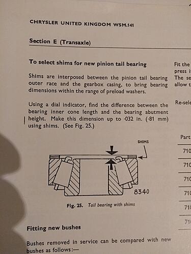

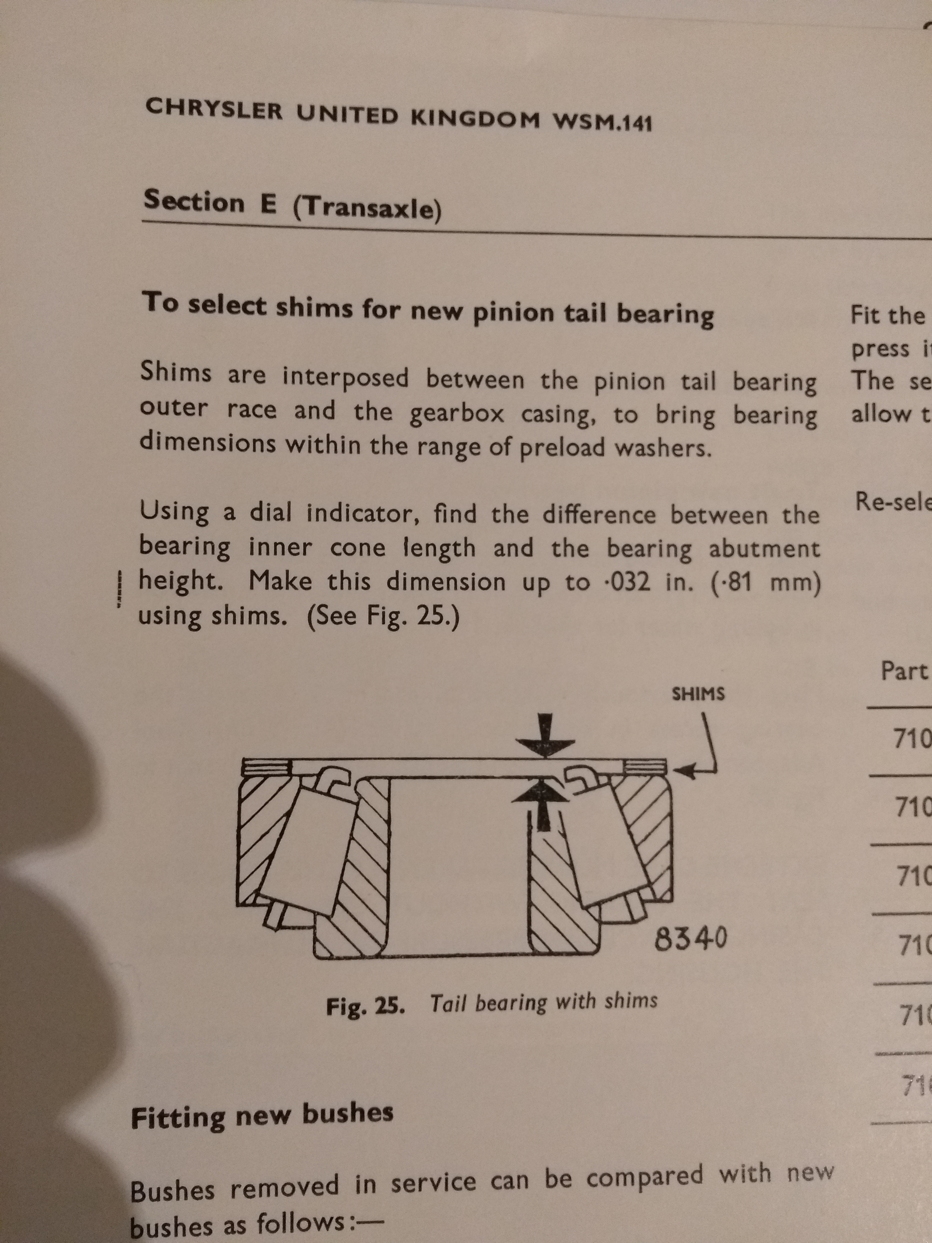

ID:	12140 Hi the next bit has got me a bit confused pinion tail bearing shims ? I think there may have been a bit of cheating at the factory .
              I'll try and explain my thinking . I am from a engineering machining background and sometimes things go wrong but not that wrongly that an expensive part has to be scraped .if you look at the manual it tells you to make up the drop from outer bearing housing to inner to .032" if the drop on the bearing is .0010" then you need .022" of shims , that's a lot of shims .I've measured the bearings I have and the old ones that came out and they are about the same but the first box had .012" of shims but the second box had no shim's at all and there was no way the bearing had .032" of drop on it .
              I think they had problems holding the tolerance at the factory , lve seen it before at some places I've worked they go to inspection they are undersize a tags put on -.008" then on assembly they put .008" less shim's in and all's perfect .
              So the conclusion is I will put back what came out for the pinion tail bearing and let you know if it works out when I do the preload.
              If I was still working I could have measured both boxes on the CMM and seen if there was a difference but I don't have the equipment at home It would be nice to talk to someone that worked at Linwood to see if it happened
              Best regards Gary

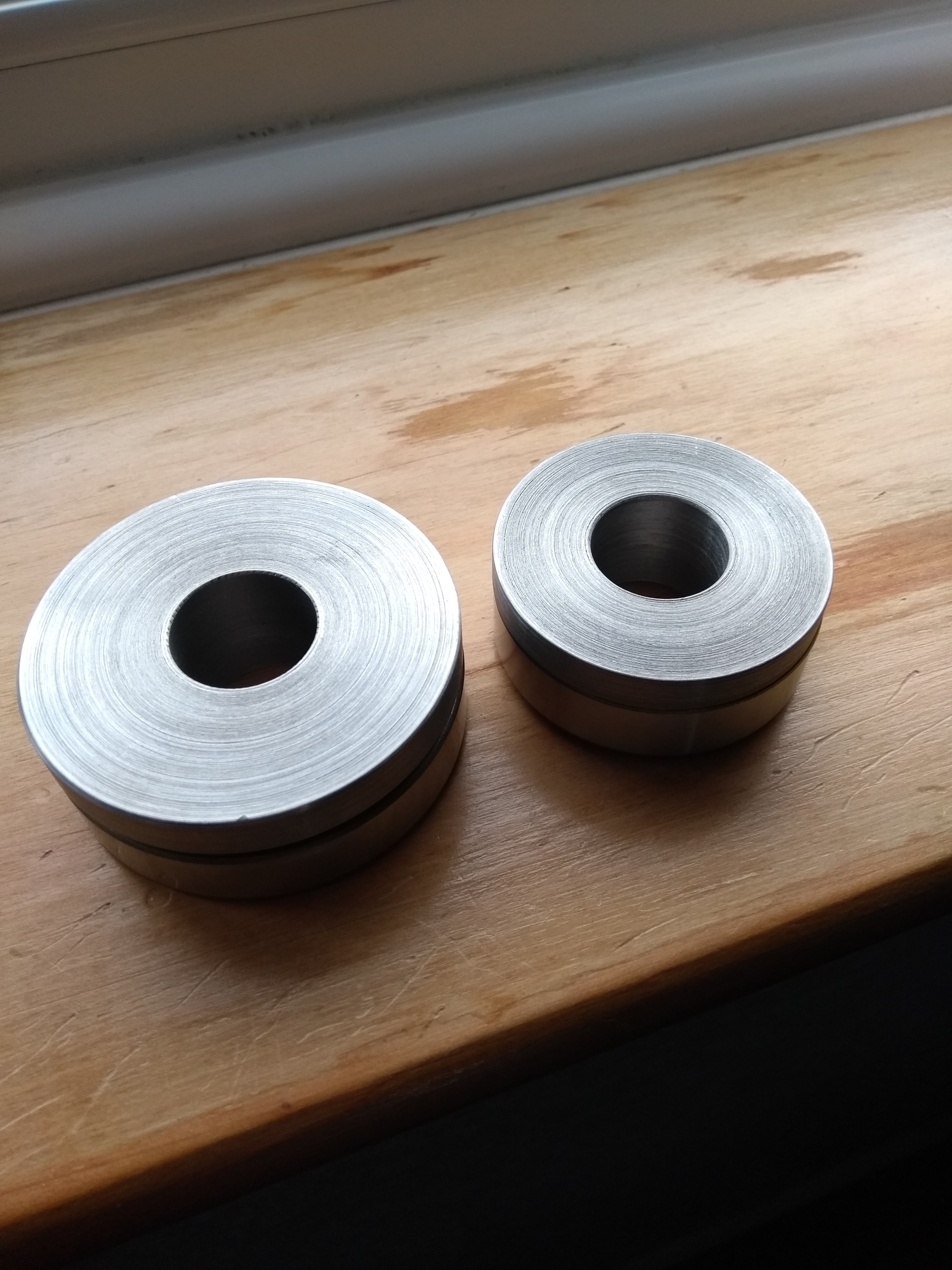

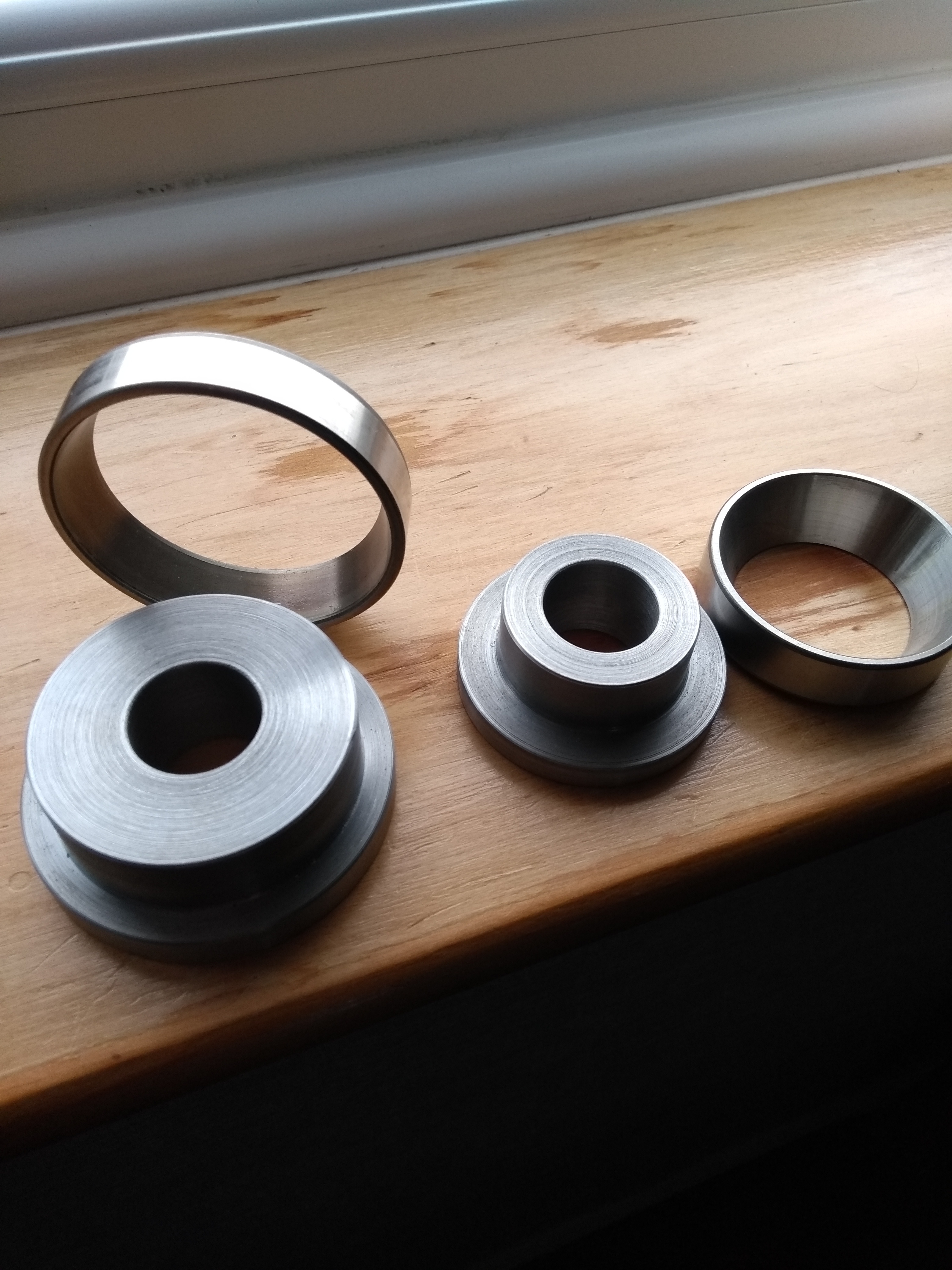

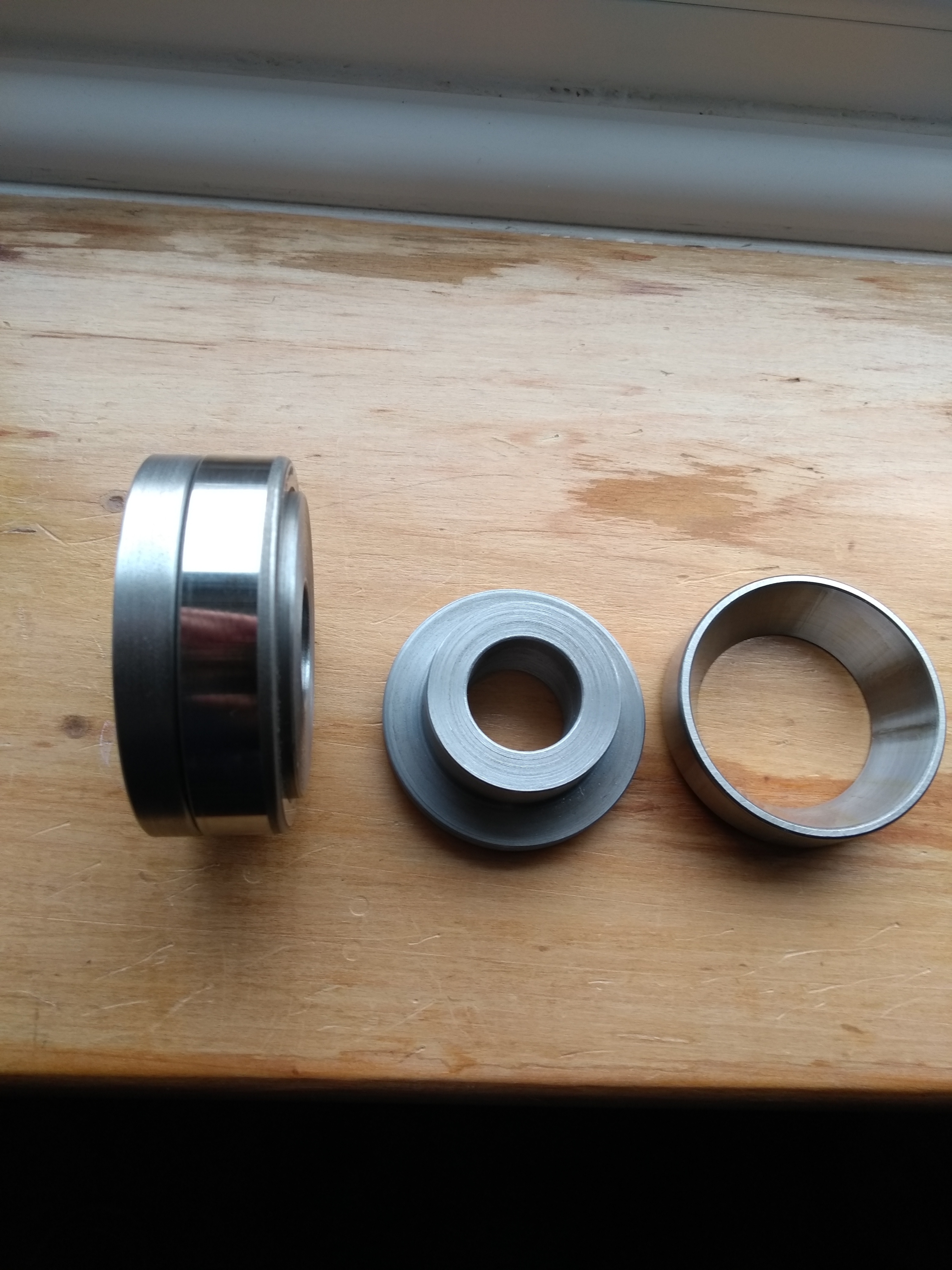

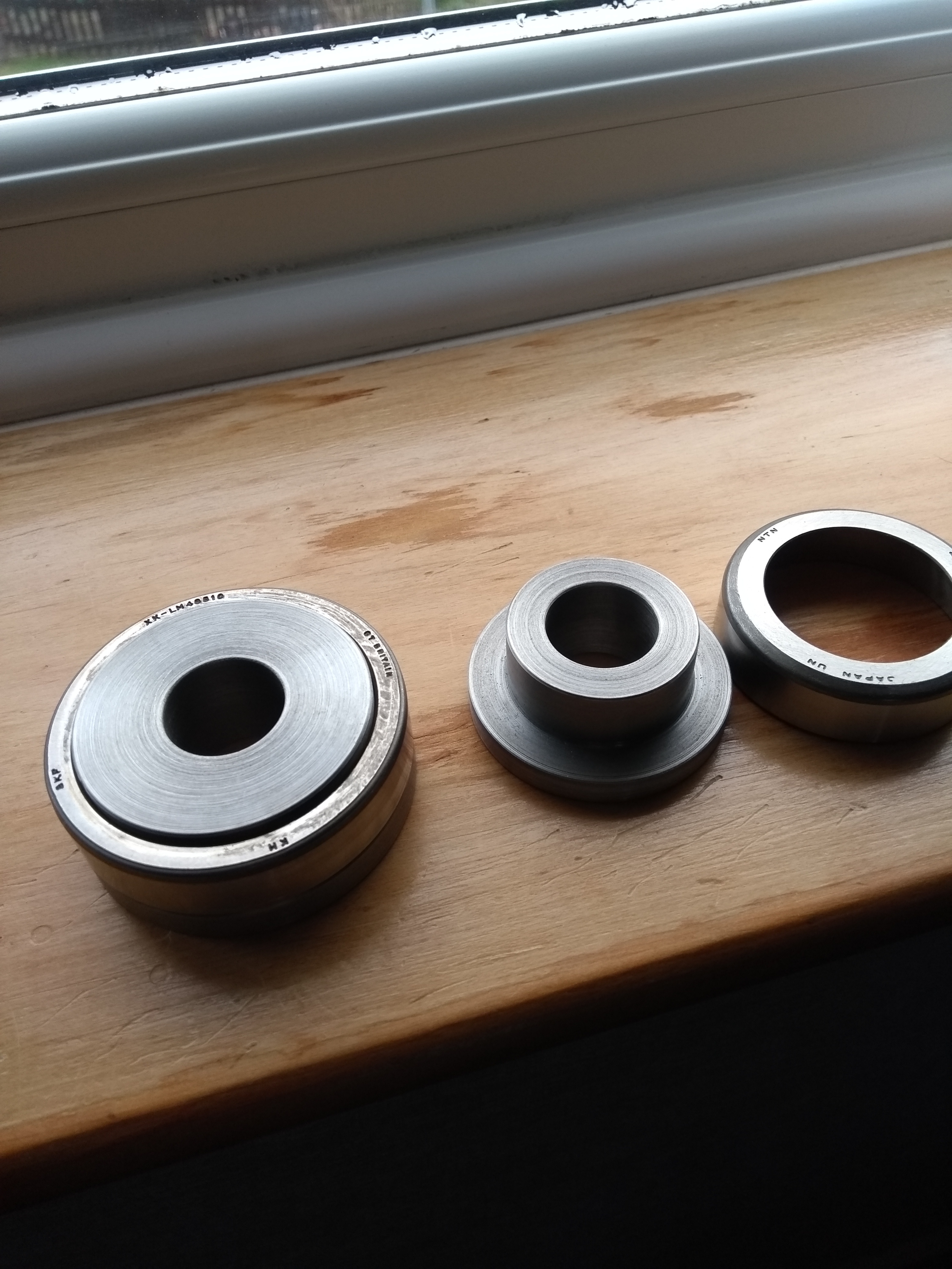

                              made copy's of the pinion head bearing and pinion tail bearing fitting tools .
                              These are simple tools for fitting the taper bearing casing ,as most of you know when fitting there is not much of the casing to tap in usually about 1 mm each side and if you use a socket it will have to be just under the outside diameter of the bearing so as to seat it completely onto the shims ,if you move to one side you could easily hit the side of the housing and damage the aluminium.
                              The purpose of these tools is to stop that by locating central in the back of the bearing casing and keep it sq
                              I don't know what the hole is for possibly to just remove some weight.
                              I've explained it best I can any questions please post Once I've made all the tools if anyone would like a set or just one please get in touch
                              Best regards Gary

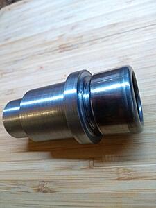

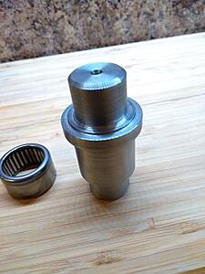

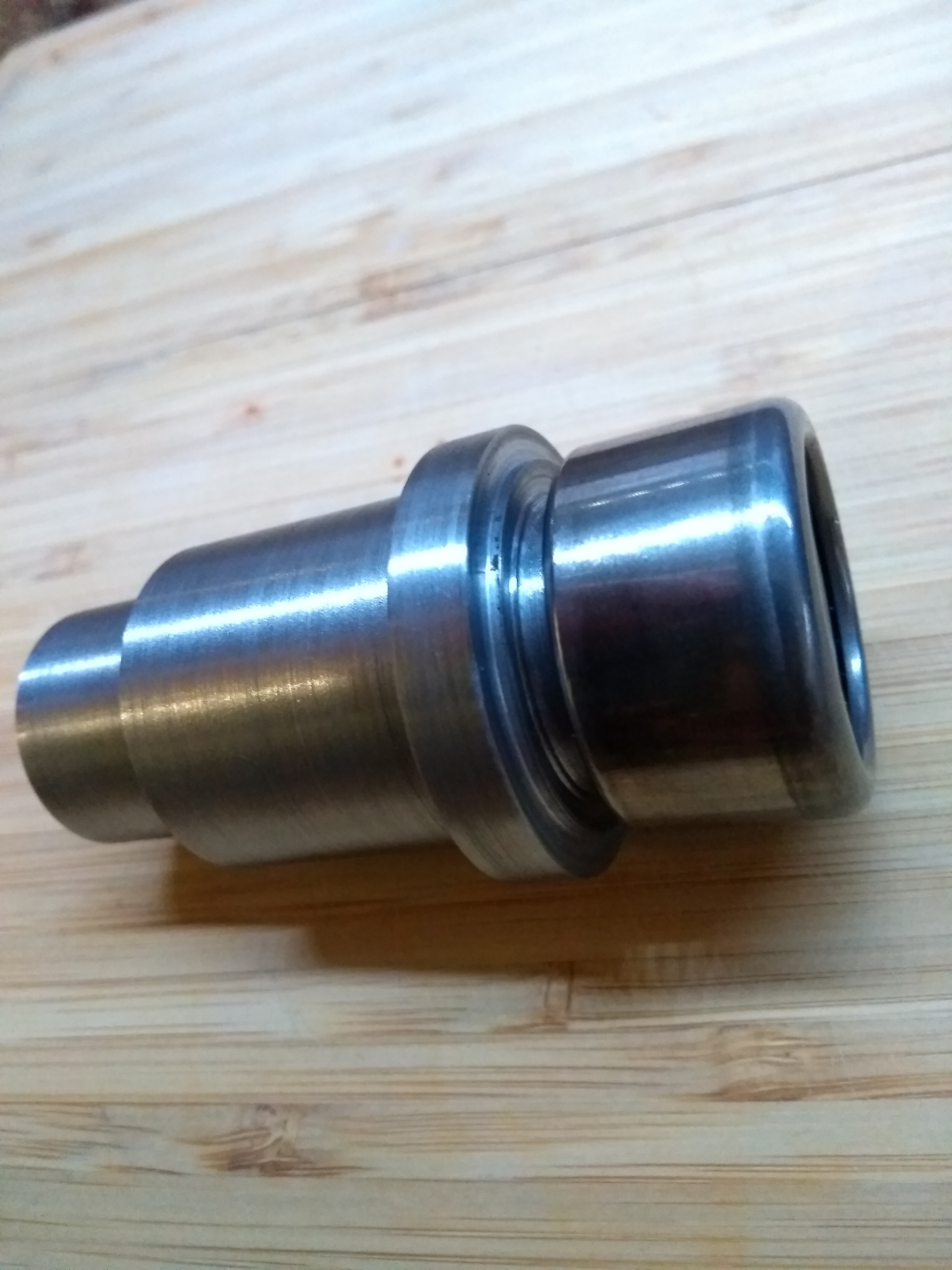

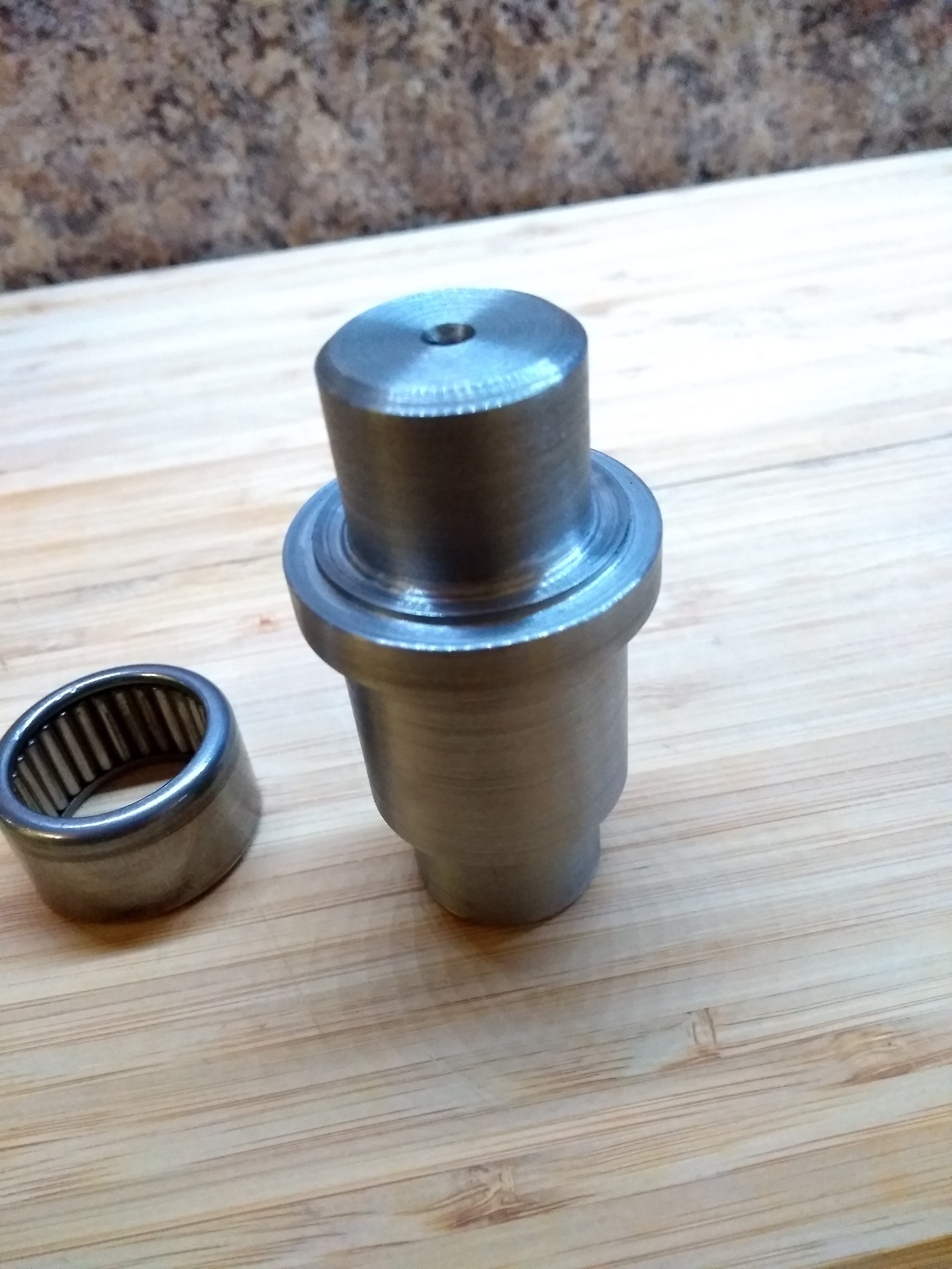

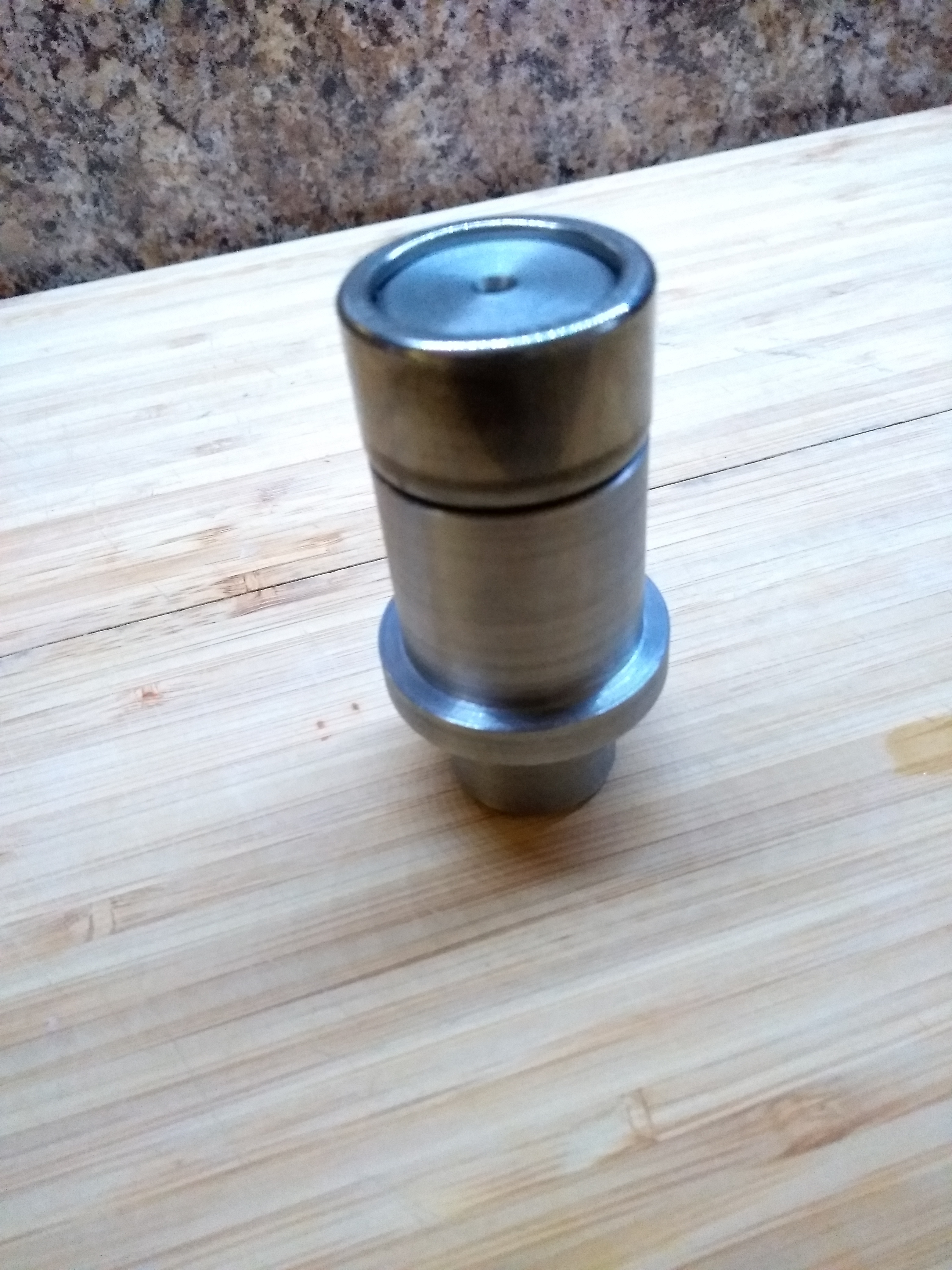

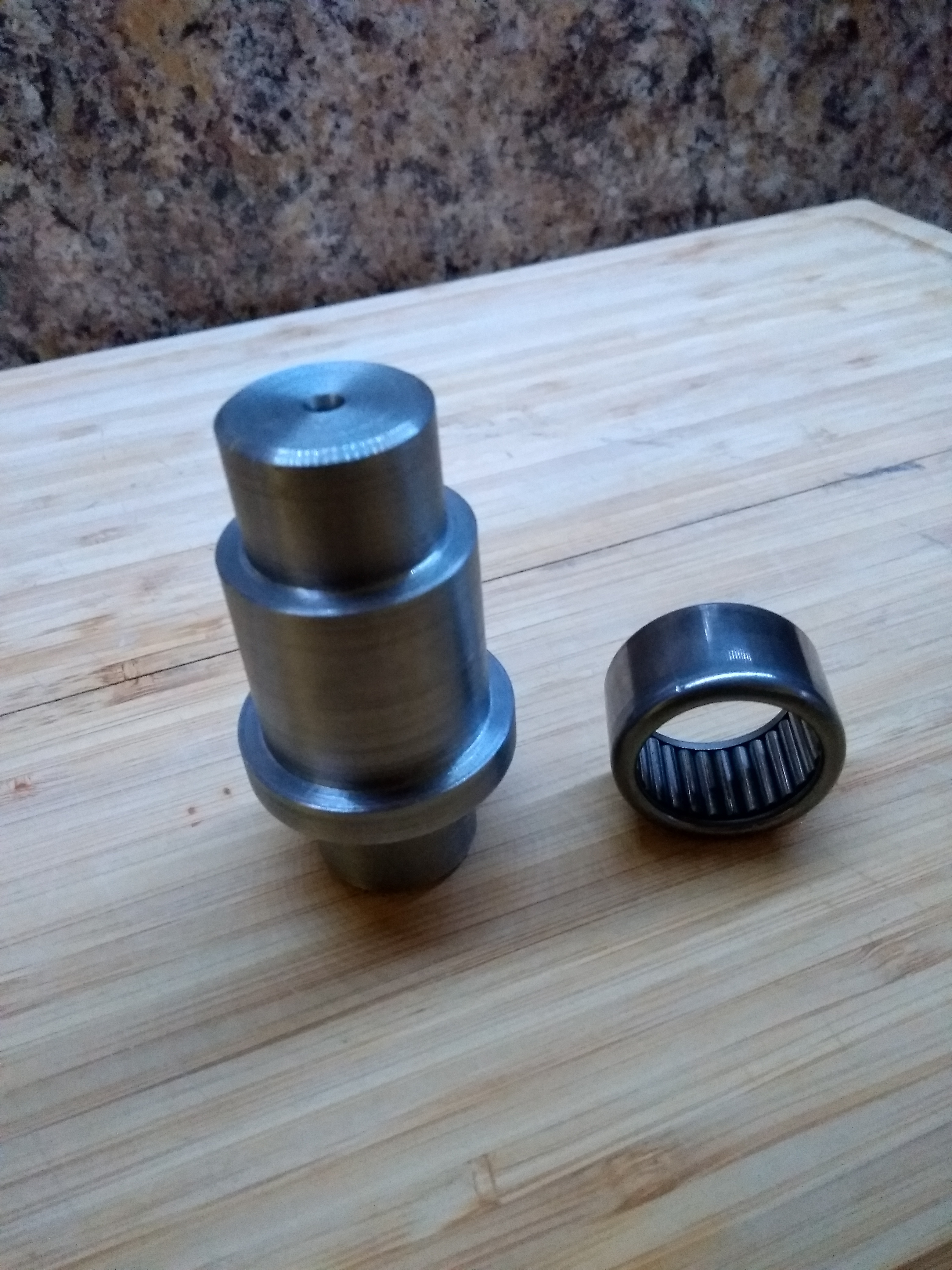

                                RG 369 Input shaft needle roller bearing removal and fitting tool.
                                Got some time today plus material for the other tools arrived this tool has one end to remove the bearing consisting of a stepped sq shouldered shaft with the OD just under bearing size so you can knock it Straight through
                                The other end has an angled face so that when the bearing is pressed or knocked in it only contacts OD corner which is the strongest part of the casing,it also has a small step to knock it in to the correct depth, but as the castings vary in thickness and the face is not machined I don't really know how this
                                works.
                                The first two pics are the fitting end and last two for removal.
                                Best regards Gary
