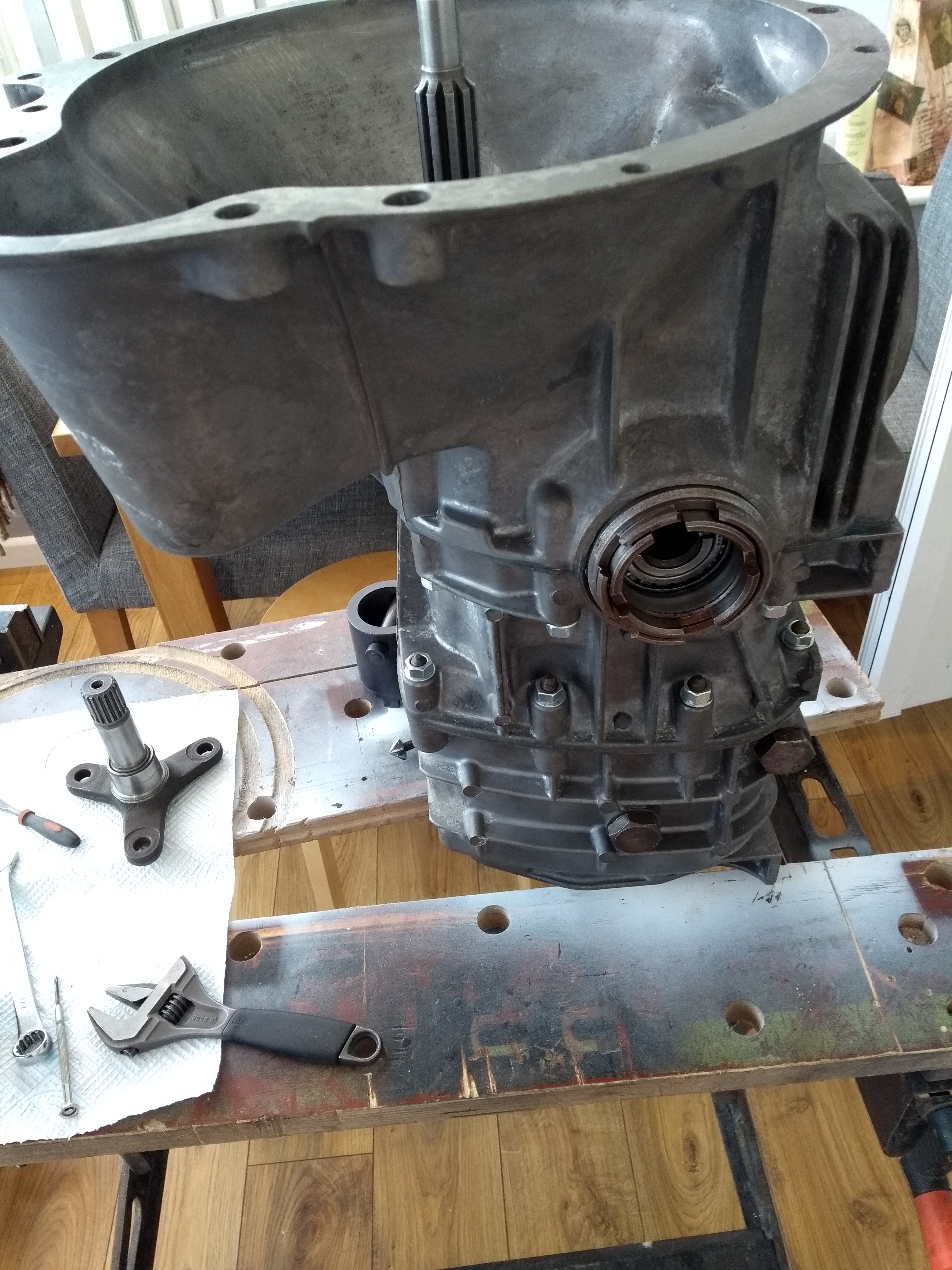

    Also check the splines and good fit on the muff coupling Click image for larger version

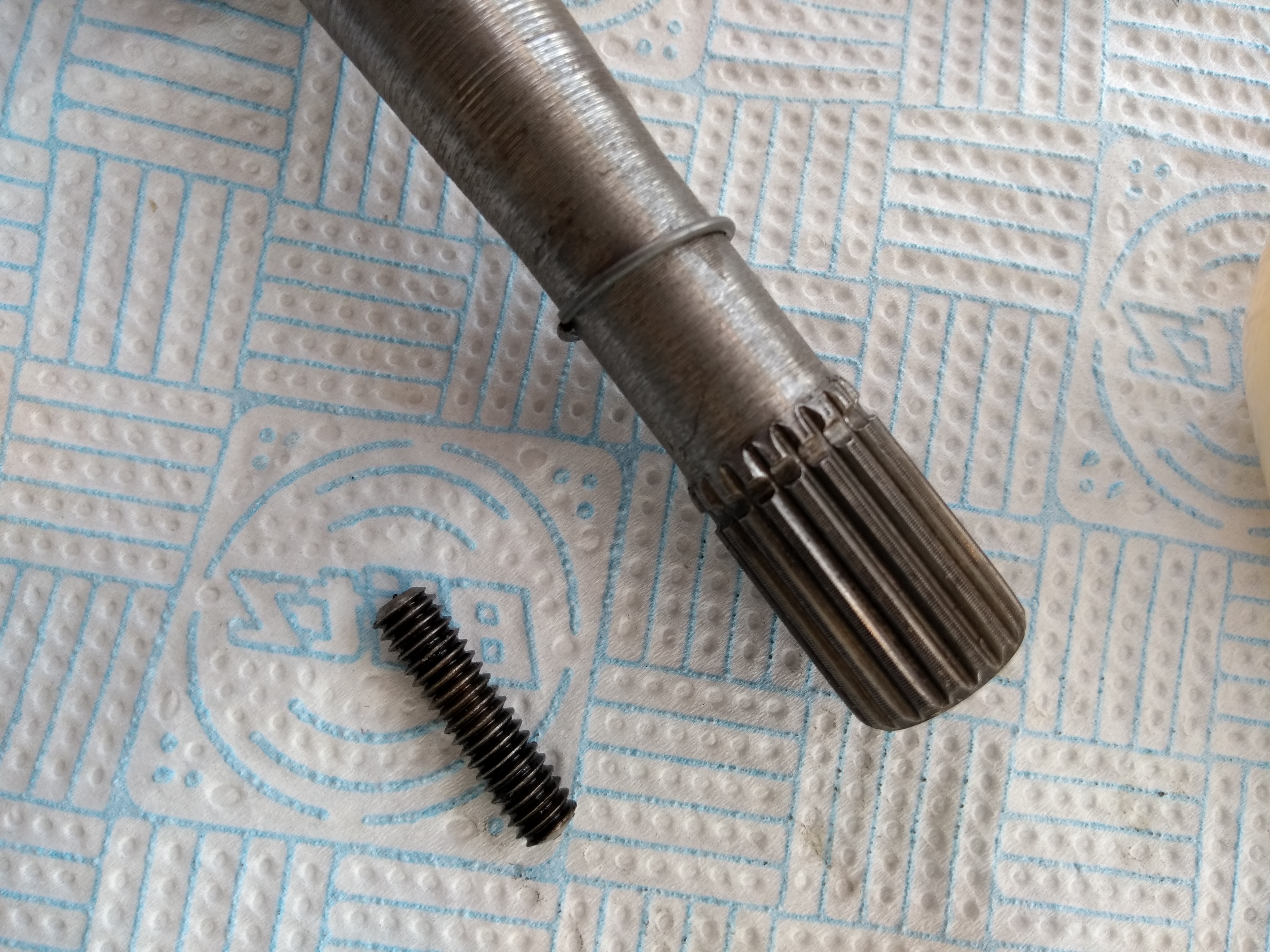

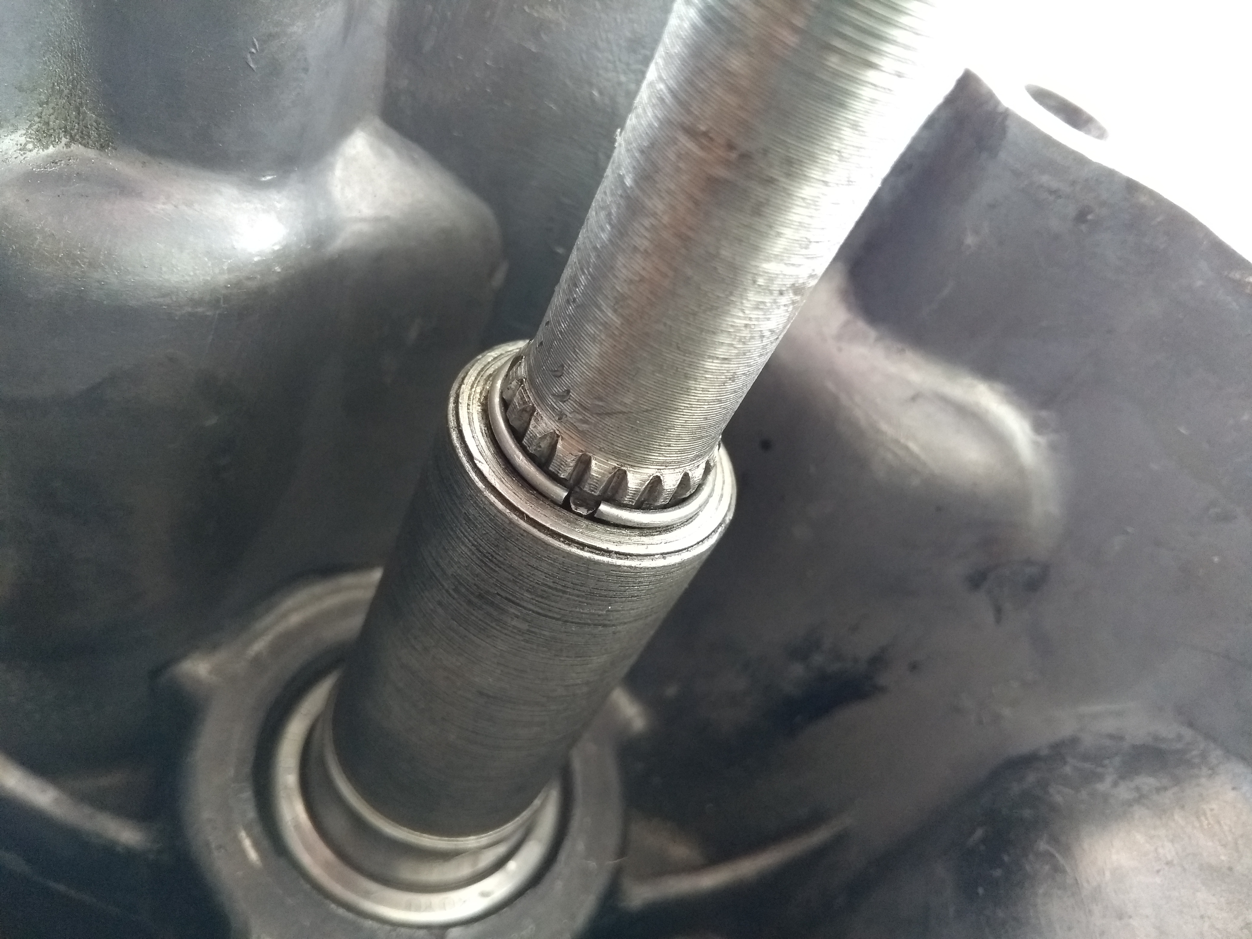

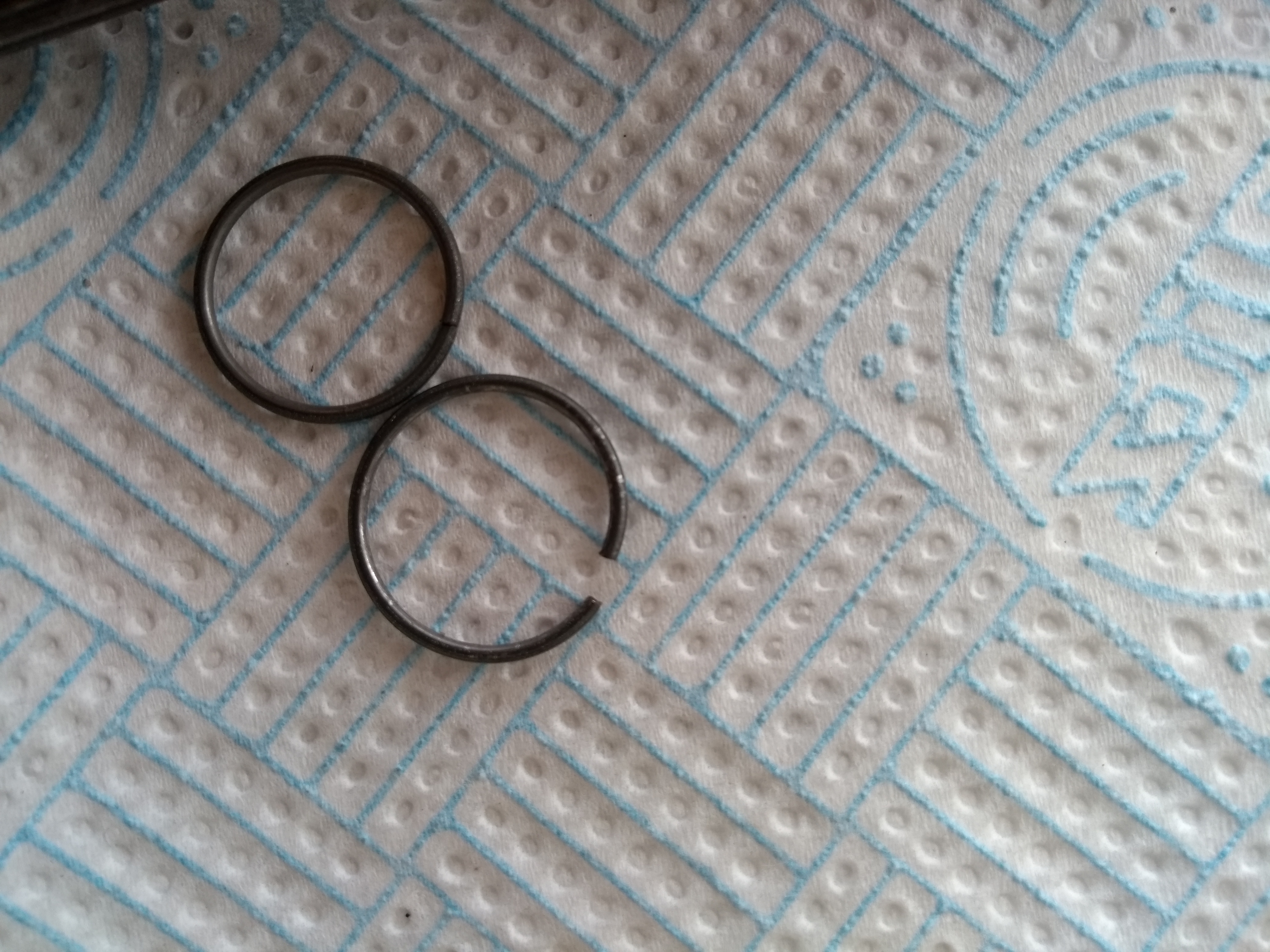

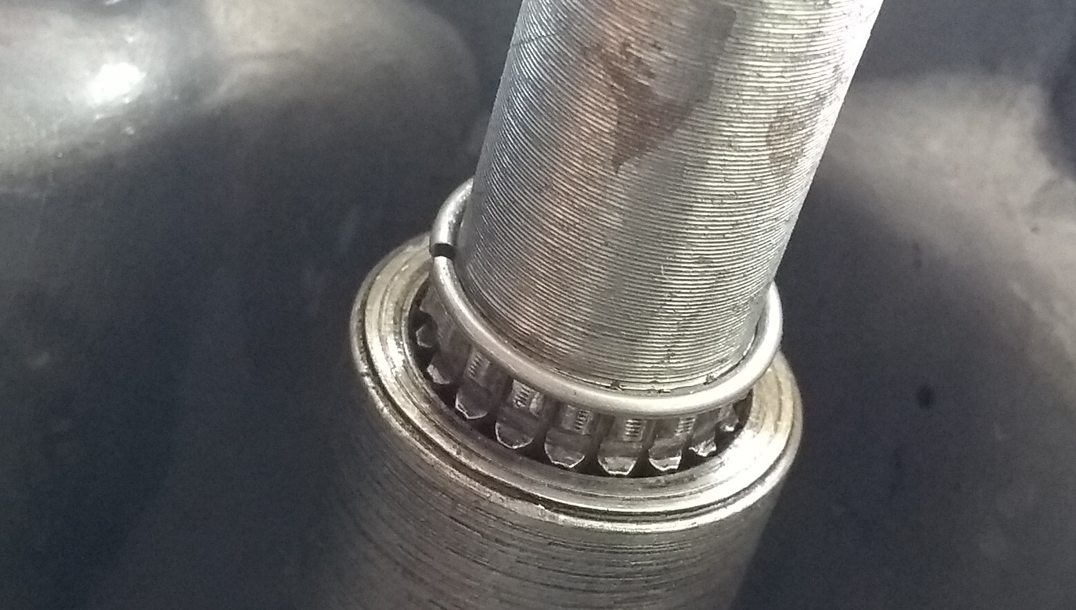

ID:	14791 Fit a new spring clip to the input shaft be careful not to strain it when pushing over the splines .
      always fit a new one they are available from the club ,10p I think it's not worth the risk of putting an old one back then slide the muff coupling on Click image for larger version

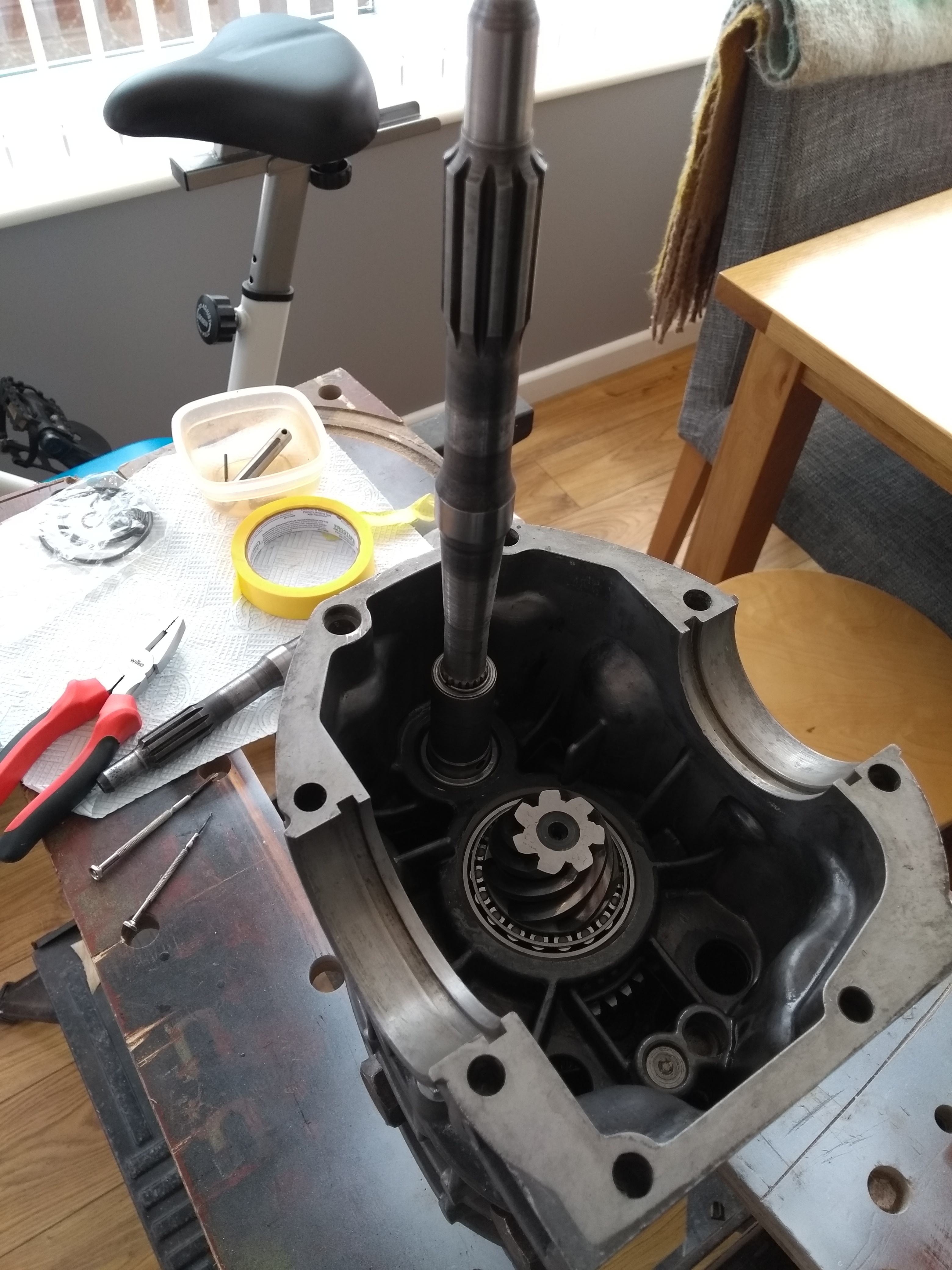

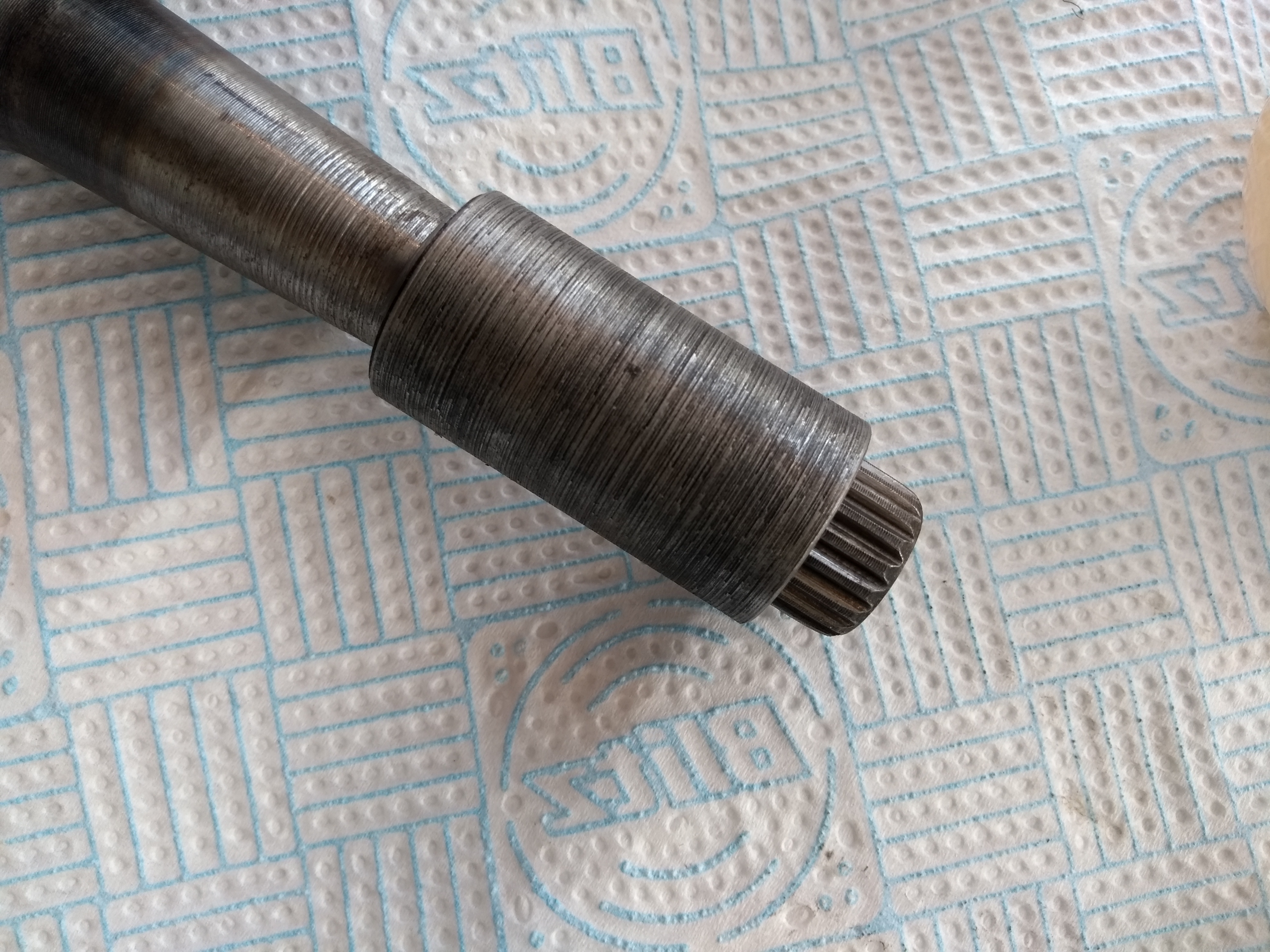

        ​ Screw the stud in one end of the shaft and screw the shaft together it's best to lock the gears ,when you feel it's touching back it off one spline and slide the coupling over the two shafts and fit the spring clip Click image for larger version  Name:	IMG_20210510_133855071~2.jpg Views:	0 Size:	279.0 KB ID:	14793 Click image for larger version  Name:	IMG_20210510_134329186.jpg Views:	0 Size:	3.21 MB ID:	14794

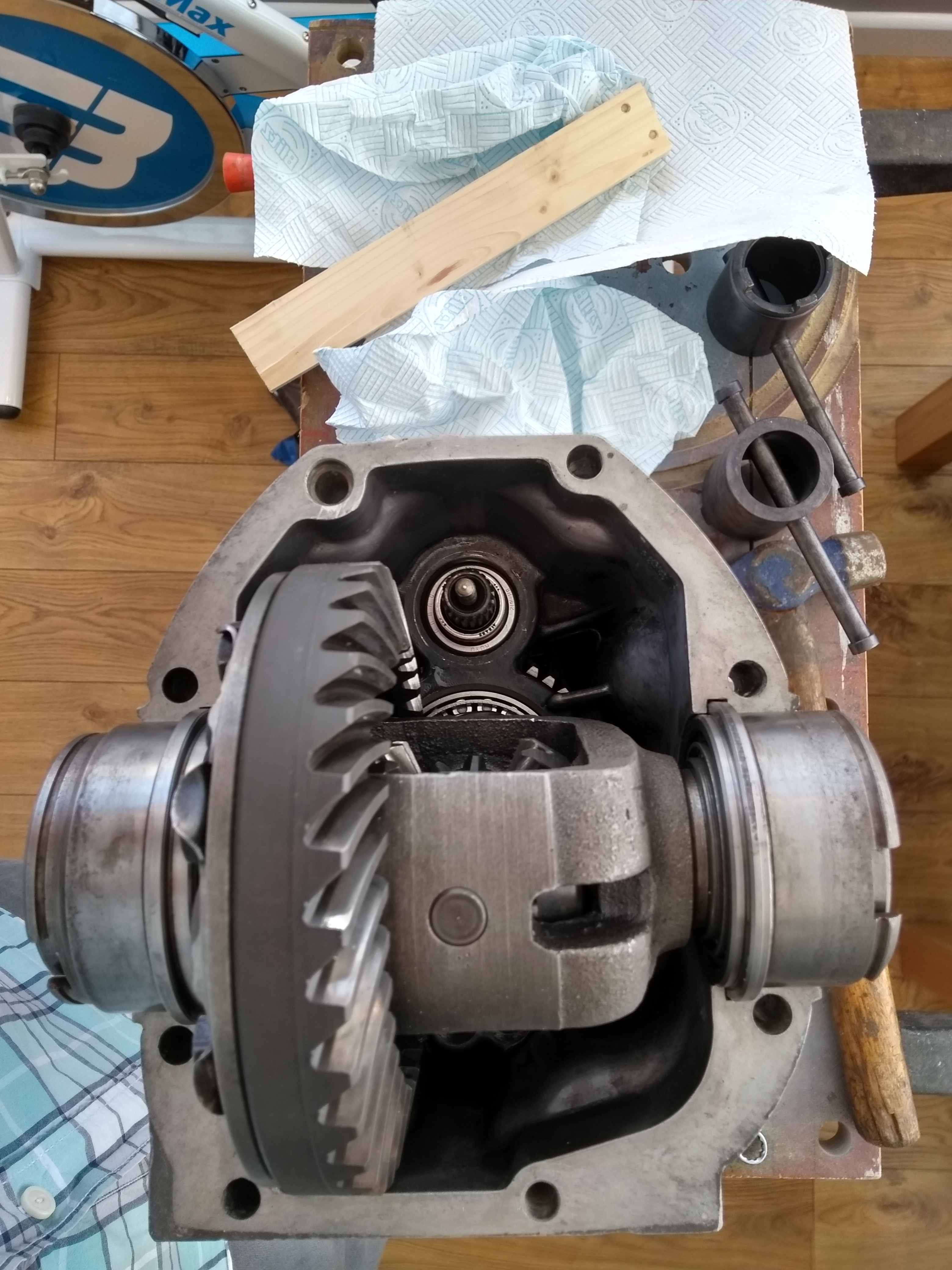

          Release the gears make sure all faces are flat and clean put a sealant on the faces fit the diff and hand tighten the nuts as we did in the dry build ,wind the cage side in to push out the screwed sleeves in there groves when you feel resistance like before tighten all the nuts Click image for larger version

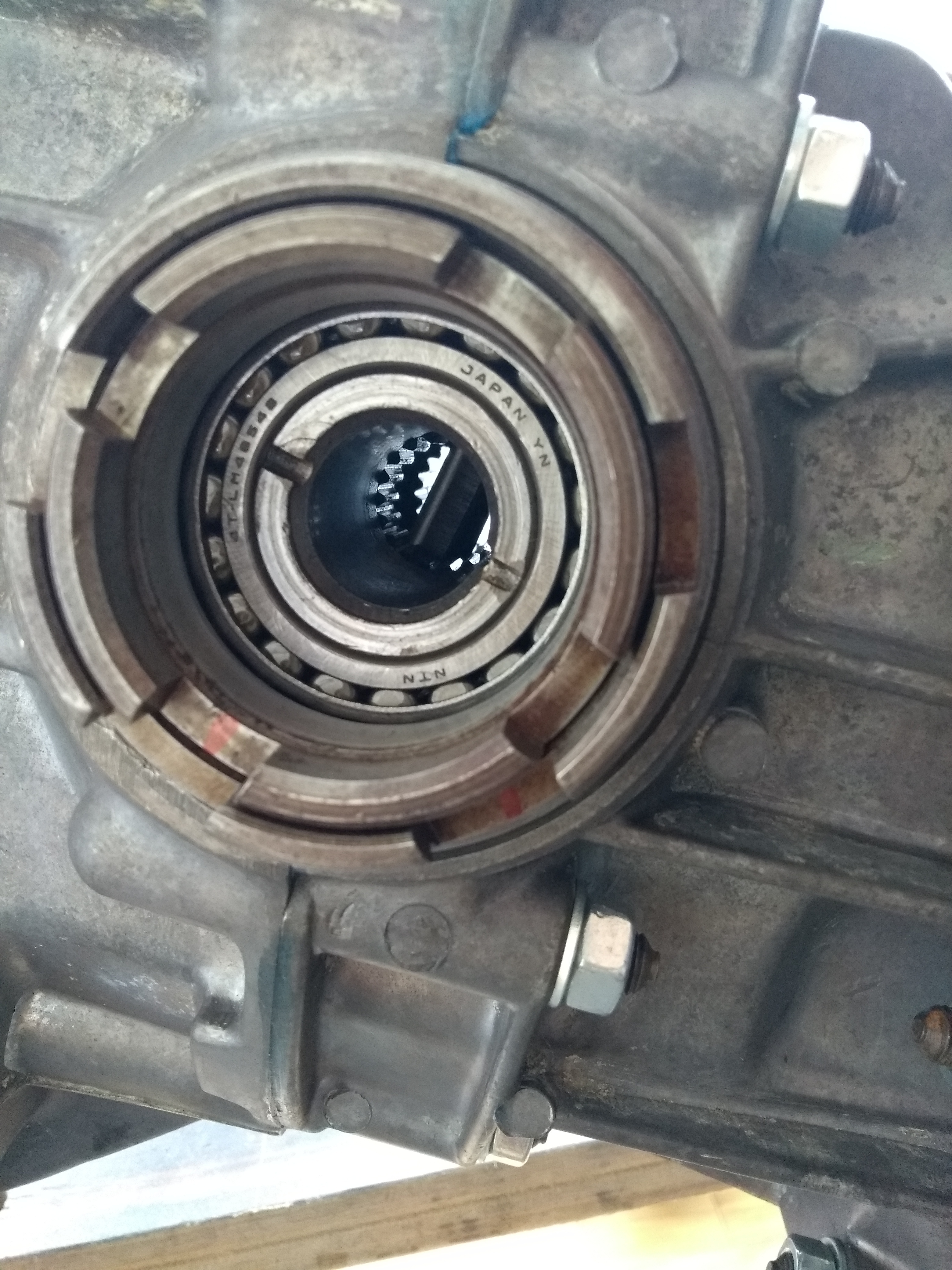

                          Ok so the nuts are tight you can now find true nip ,in other words the position when the two bearing cones are in line and just touching without any preload
                          please excuse me but does everyone know what gear side and cage side mean
                          I'm hoping someone will be reading this with no knowledge at all

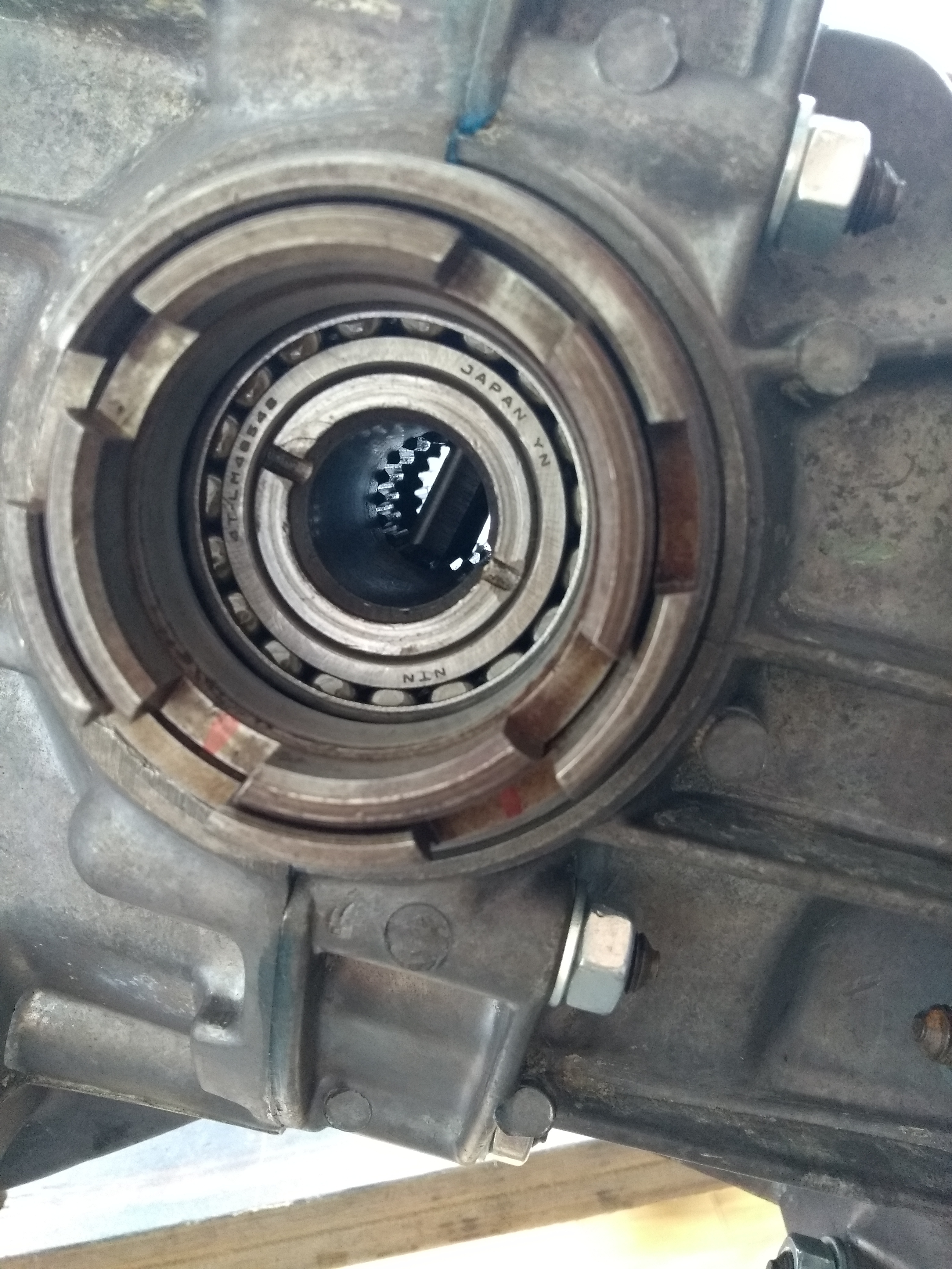

                          The gear side is the side that the crown wheel on the diff runs at and the cage side is the side that has the 4 little gears running in. Gear side on the left ​​​​
                          Click image for larger version  Name:	IMG_20210505_141803279_HDR.jpg Views:	0 Size:	2.58 MB ID:	14890
                          • Gary Whitaker
                            aka Tiker
                            • 15 April 2020
                            #193
ID:	14892 Wind in the gear side till you feel the backlash is just a little bit if you meet resistance wind the cage side out a little when you think you're somewhere near, look on the gear side and line up one of the 3 cut outs check you still have a bit of backlash
                            • Gary Whitaker
                              aka Tiker
                              • 15 April 2020
                              #194
                              Now wind in the cage side till you feel resistance and stop .
                              fit the drive shafts and turn the diff about 6times
                              This is to centralise the bearings .
                              Now see if you can wind in a bit more don't force it if it moves a little put the shafts back in and turn again
                              If you're not sure you can wind out and start again you'll soon get a feel of where it just nips on the cones this is called true nip

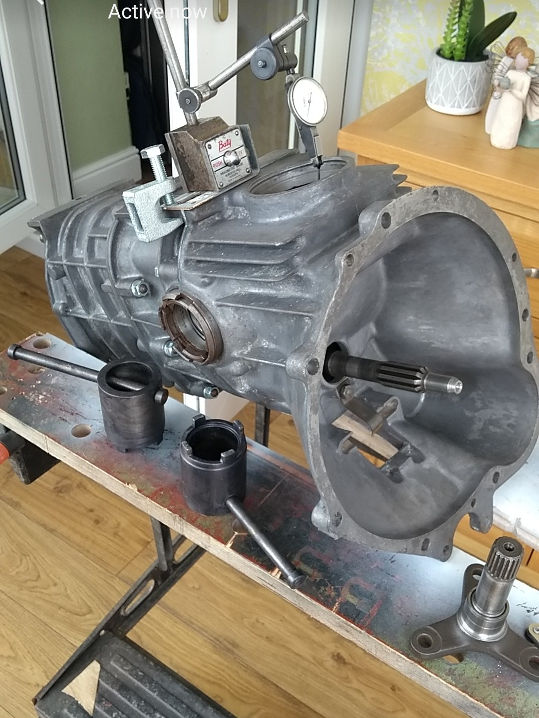

                                next set up a dti on the crown wheel check the backlash Click image for larger version
