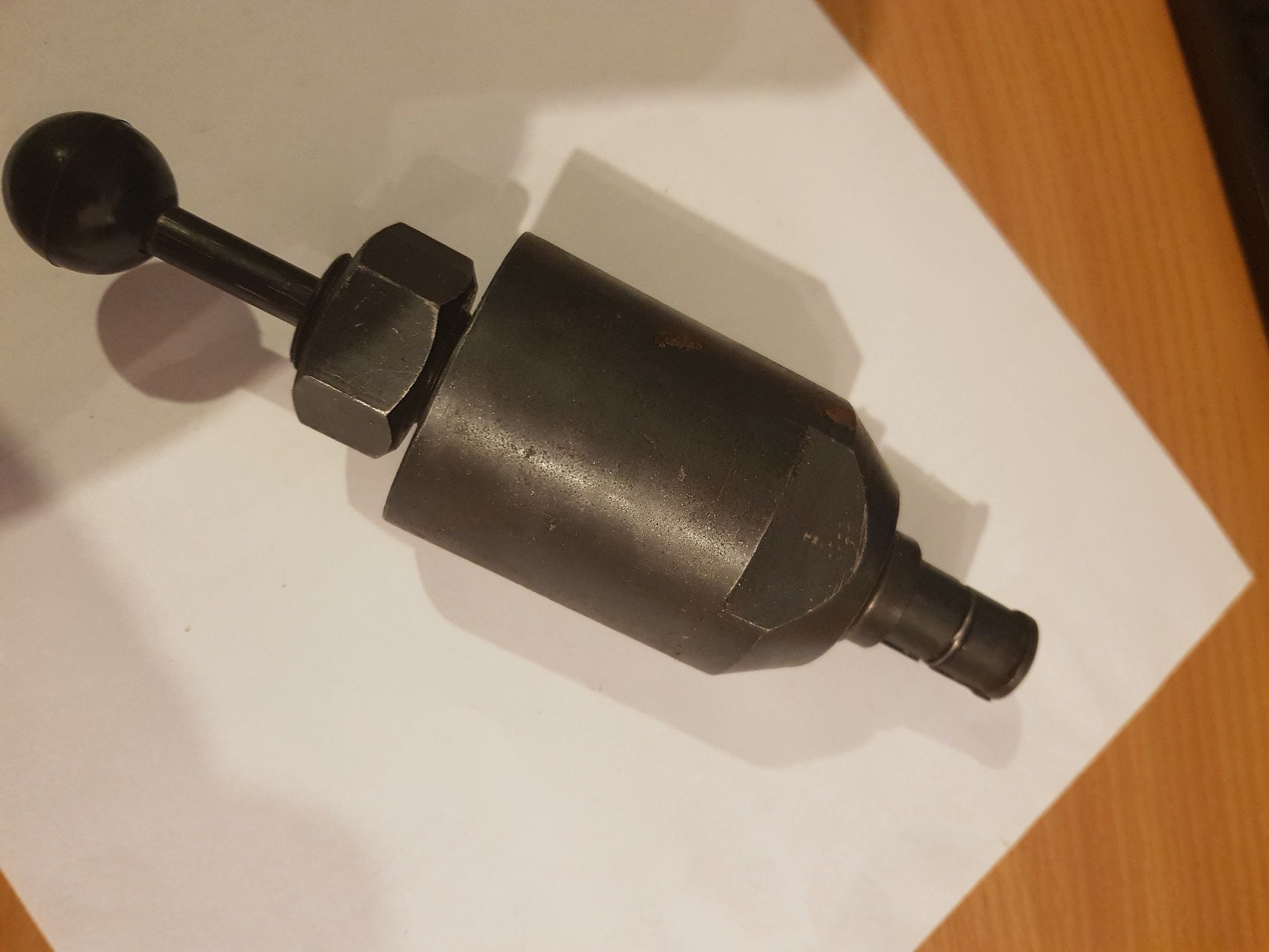

RG.536 Crankshaft Spigot Bush Remover / Replacer Oilite or Roller
Very heavy, an old transaxle first shaft can also do the trick, fill hole with grease and hammer shaft home, bush pops out easy
but replace a roller bearing much more delicate as you cannot really hammer it back in !

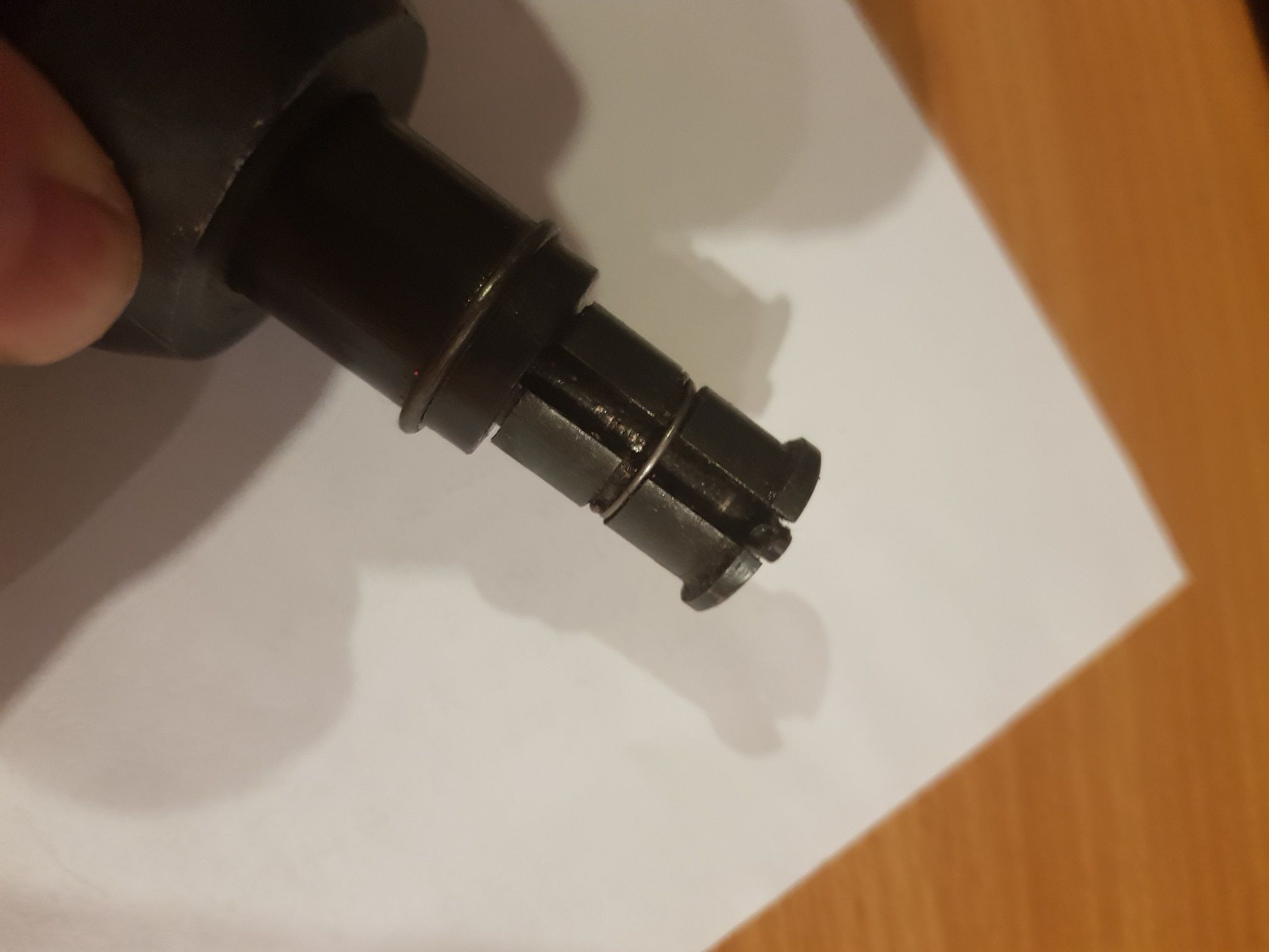

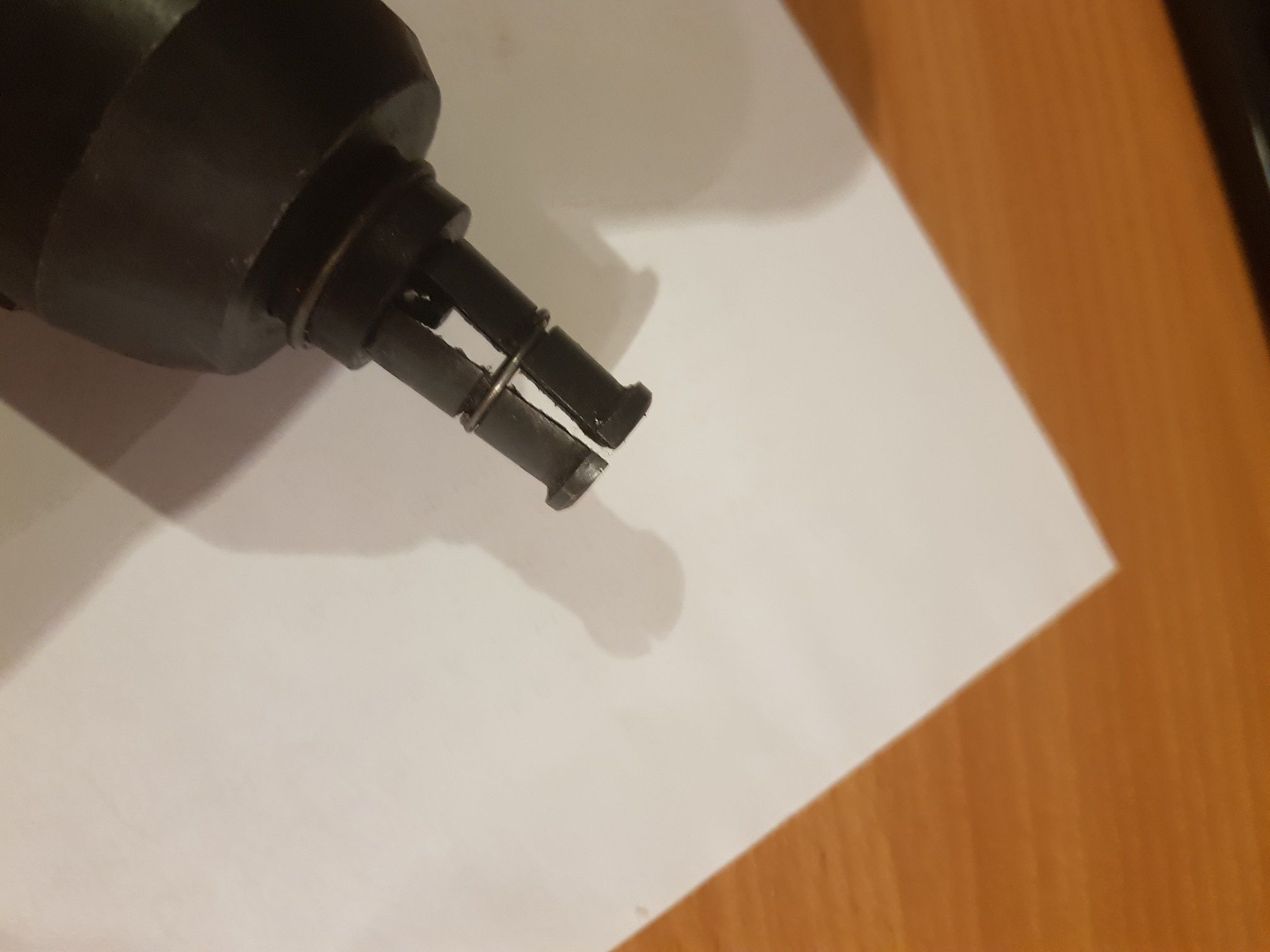

Pull back middle pin relaxes the holder at end
Add bush
Push pin forward to lock
Put part back in
Simples, not a must have tool for the box and not just for Imps either !
