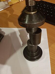

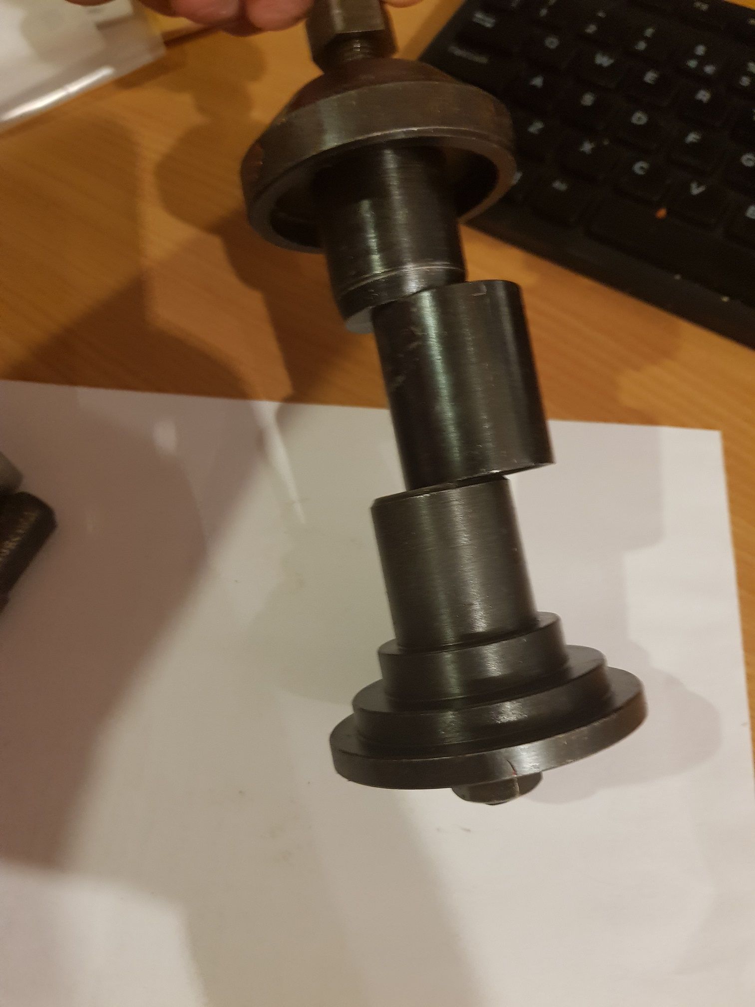

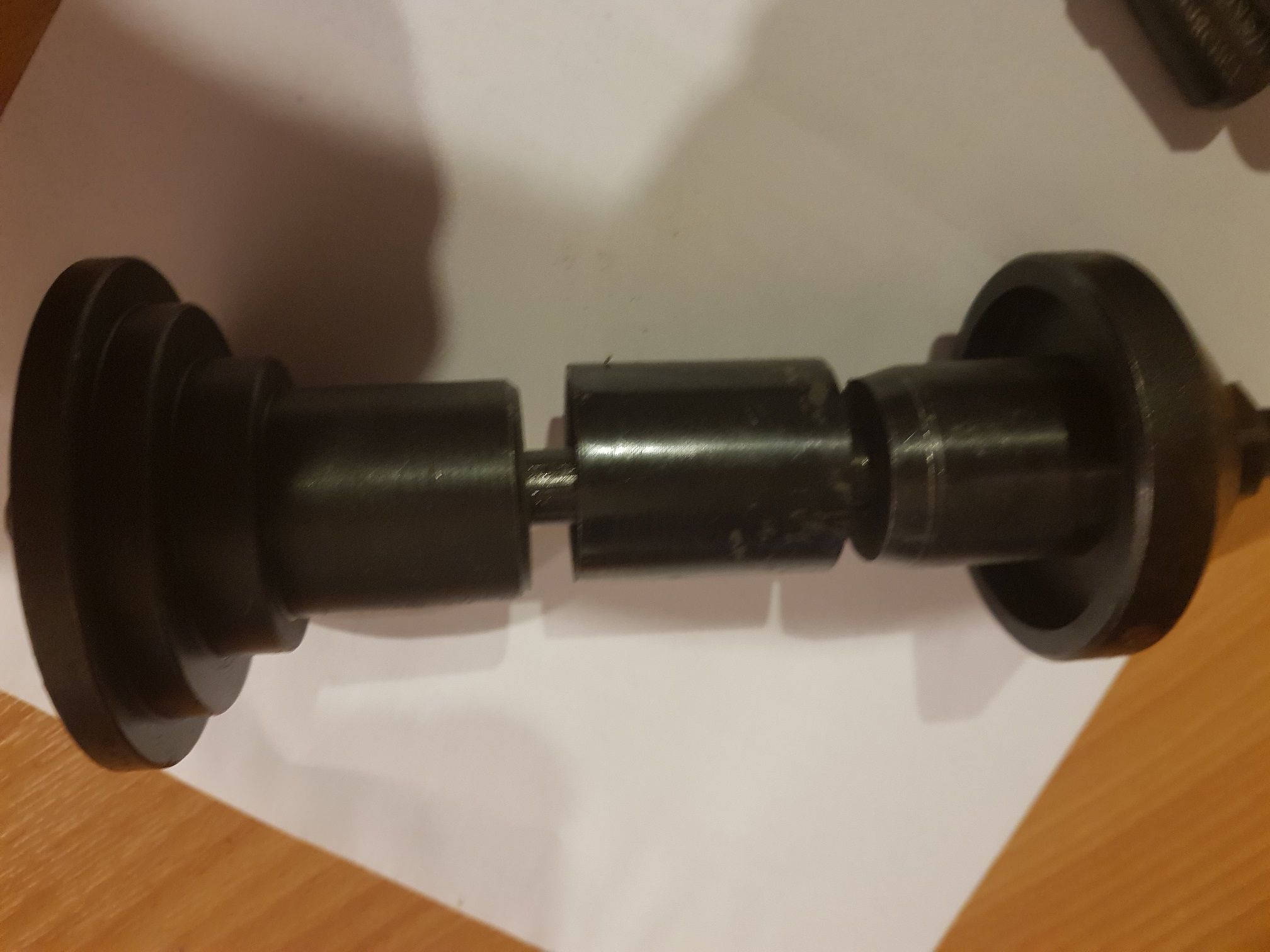

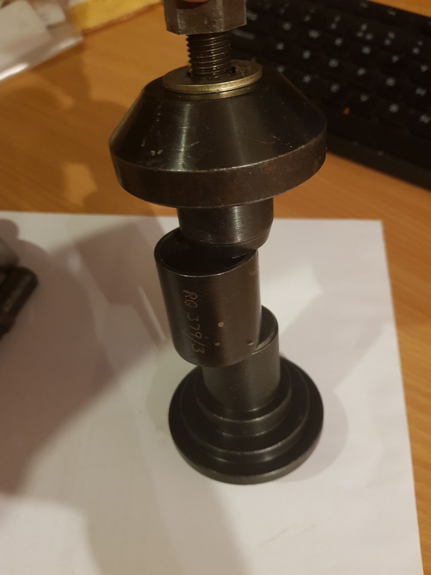

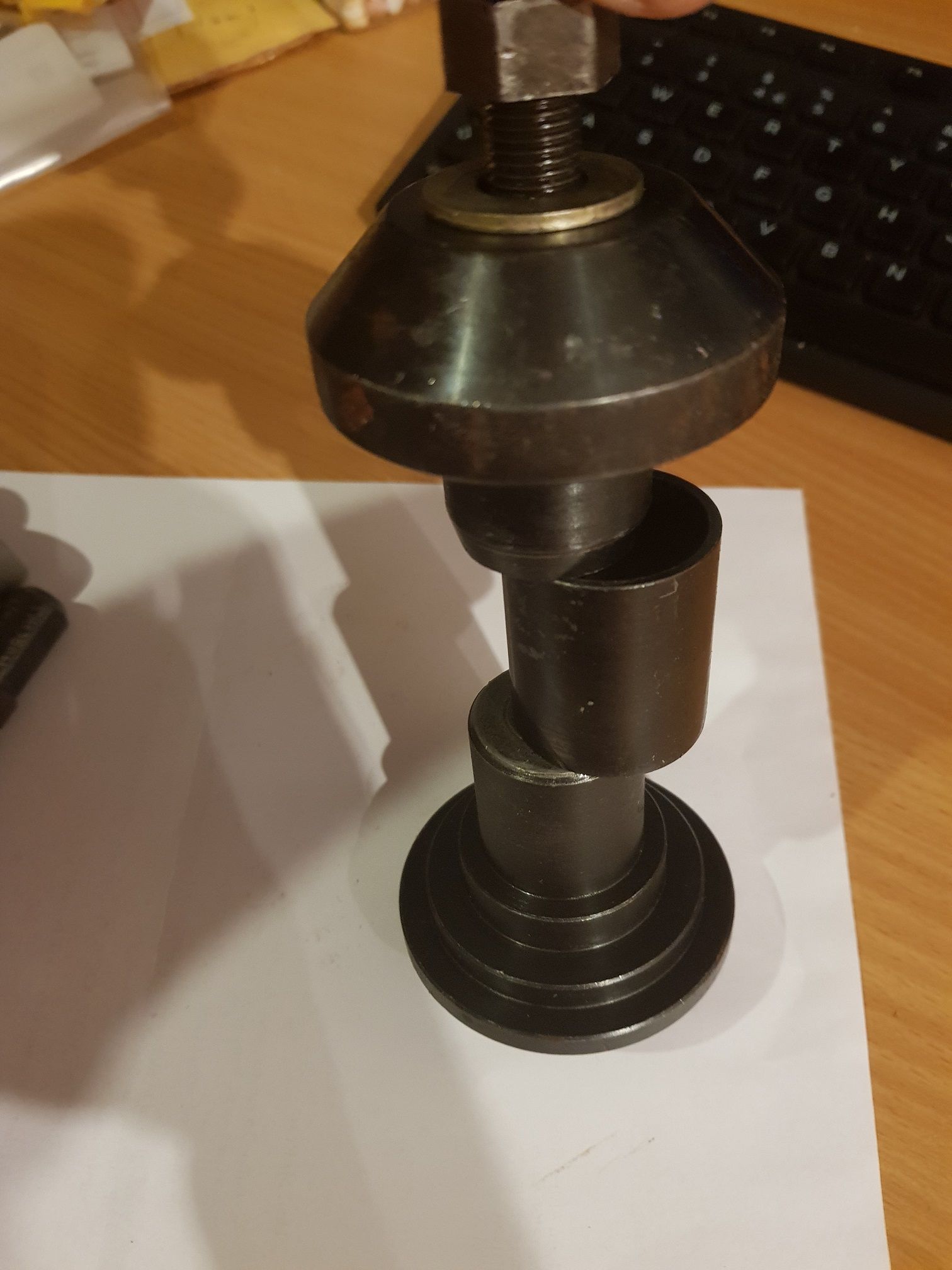

Here is what the actual beast looks like, this will set bearings and most importantly rear oil seal perfectly
I say the oil seal is the most important to set as the bearings will set themselves once the back plate is fitted and the shaft bolt tightened as the spacer sets them , but the dust seal can move easily and has been known to foul the back bearing making the shaft hard to run by hand and cause a real stink driving as it binds and melts.
