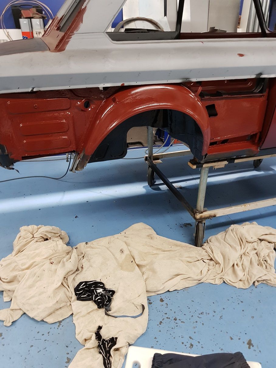

        I have sme problem Bob Petowner working with one side is much harder, on DDG 220C I did cheat a little though as complete restoration was not the goal.
        The small hole in the rear side storage pocket area is so i can bring the hose up through the back of the side pockets and then in the arch, gets rid of the kink completely
